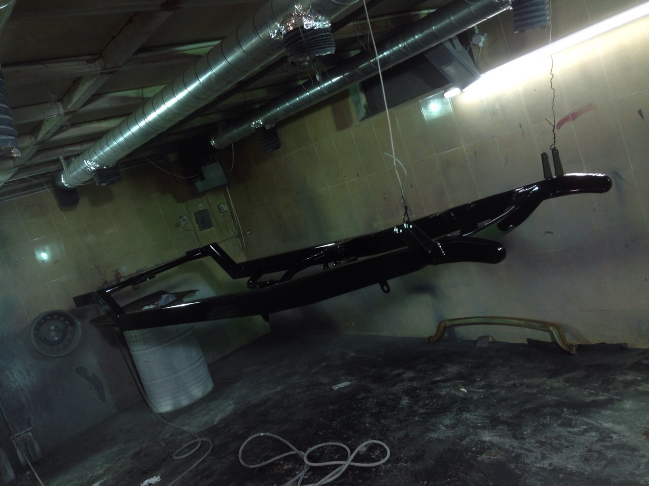

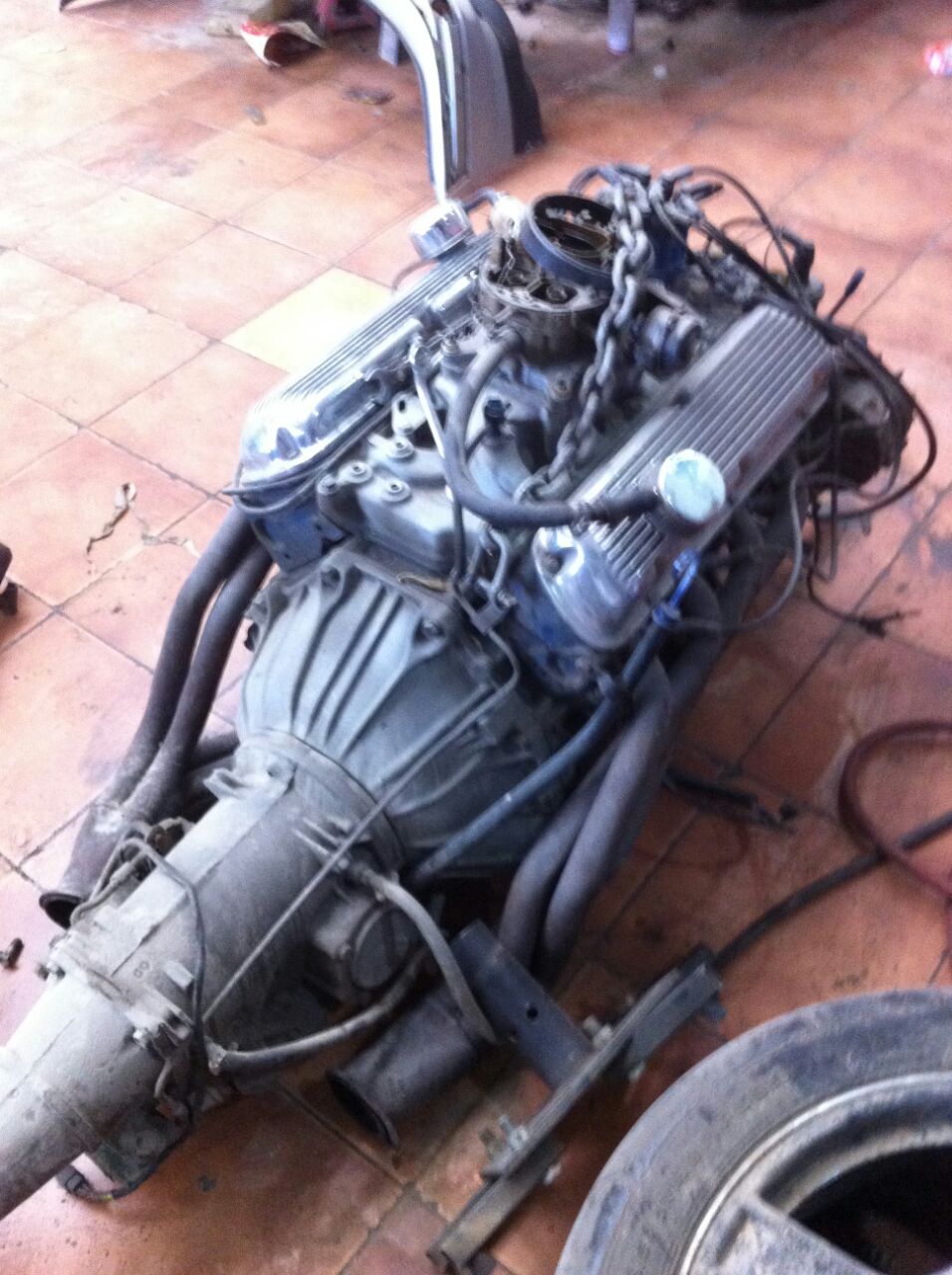

    more pictures of the project ,
    painting the frame and suspension
    and rebuilding the engine

    paint completed, started the ***embly
    IMG-20150419-WA0006.jpg IMG-20150419-WA0006.jpg IMG-20150419-WA0007.jpg IMG-20150419-WA0008 (1).jpg

    from Kuwait
    frame on the ground , not bad for 1 day :) IMG-20150419-WA0017.jpg IMG-20150419-WA0017.jpg IMG-20150419-WA0018.jpg IMG-20150419-WA0022.jpg IMG-20150419-WA0019.jpg

    Engine is ready.

    Looks great. Just love those 289's. Was just wondering why you have a clutch pedal if you're using an automatic ****** ? Frame looks really good. It's really coming together. Keep it commin'
  22. icecube
    Joined: Mar 14, 2008
    Posts: 64
    icecube
    from Kuwait
    Thanks Dino64 .
    I am using a manual t5 ******.
