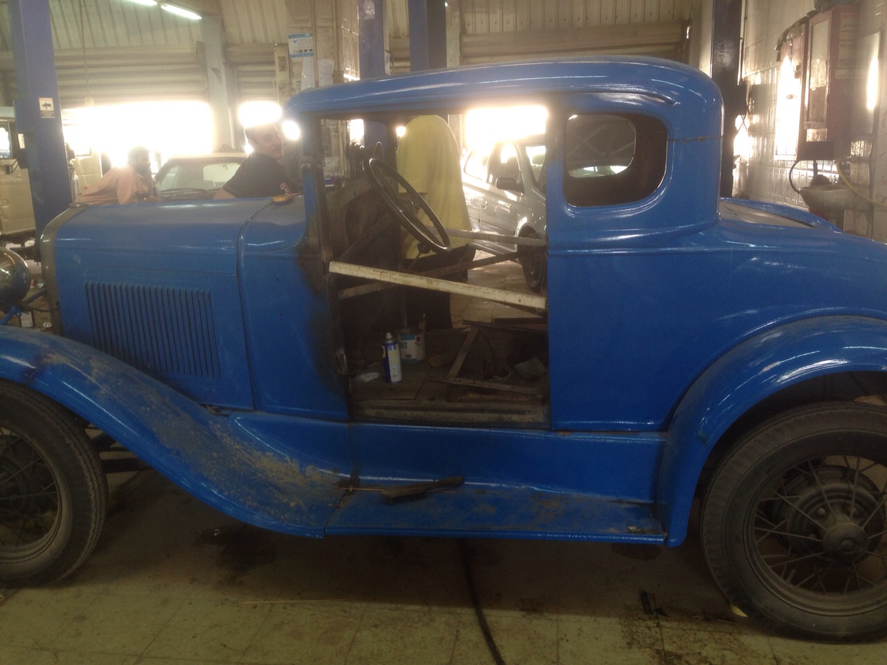

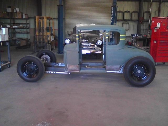

    Its time to chop the top
    this is my first time , i hope i don’t mess things up .
    its a 3" chop
    i have a picture of a car that was for sale on ebay few months back, trying to do the same with my coupe.

    Finnish chopping the top ,car looks better now .

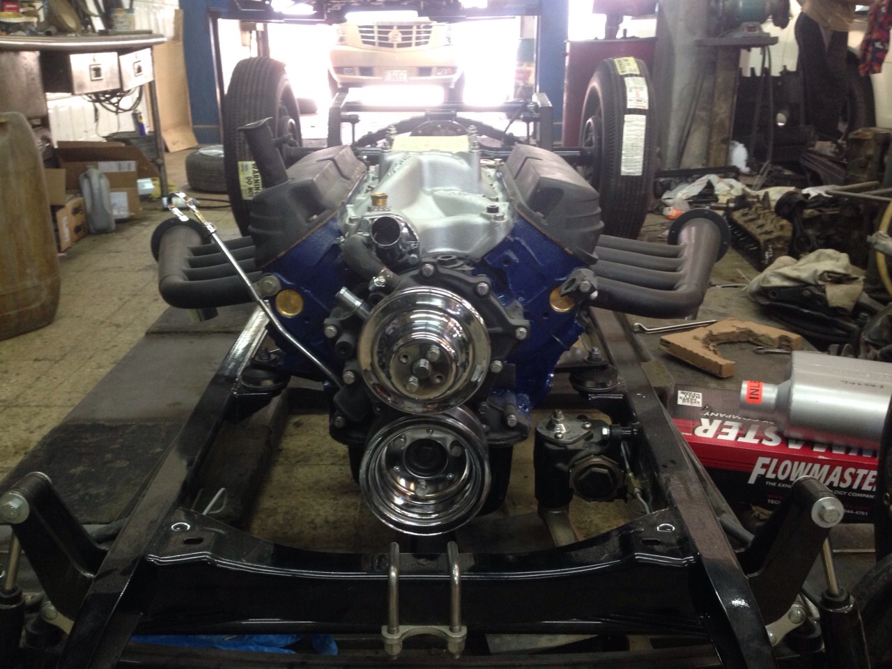

    engine in, i have been waiting for the flywheel to arrive for more than 3 weeks , orders one from speedway and it was the wrong one , i was so frustrated especially when shipping cost a triple the part price.
    i managed to find one locally today.
    now i have a problem with the oil filter ,i need to relocate the oil filter or use an adapter .
    the steering box is not clearing the filter.
    img_20150514_192509.jpg img_20150514_192509.jpg img_20150514_192514.jpg img_20150514_192519.jpg img_20150514_192528.jpg img_20150514_192535.jpg

    Lookin' good. That oil filter situation is one of many challenges to using the 289. You can get a shorter oil filter which was for a van application, but I don't know if it will clear. Looks like things are coming together... great job

    I don’t think that a shorter filter will clear, i have 1.5" of space only.

    You are of to a good start on your coupe!I noticed that you are a speedway customer. They have several adapters available for relocating your oil filter.

    i think ill use the 90 degree adapter, but will it clear the fuel pump?
    m-6880-a50 is a 90 degree adapter , the filter will be on the front , close to the fuel pump.
    do they make any 90 degree adapters where i can mount the filter to the back.

    When I put my sedan together in the eighties I set the motor over to the right about an inch and it allowed me to use the short filter and gave me more steering column room

    I can't change the motor position now , because i will have to change the position of the transmission mount also , and the frame is painted , i don't want to respray again.
    Jegs reply saying that the adapter will not clear the mechanical fuel pump.
    so i guess my only option is a remote oil filter .

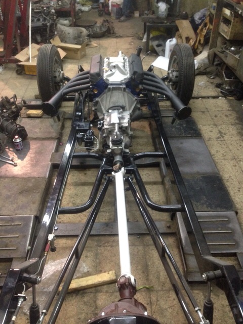

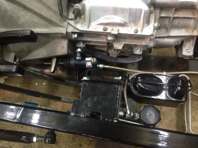

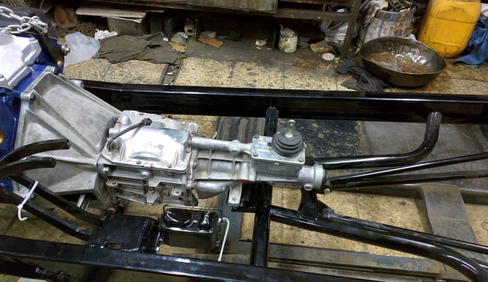

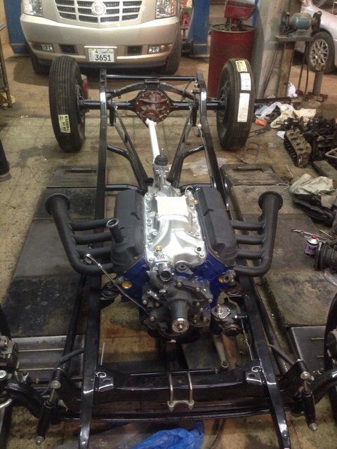

    frame is complete , engine , transmission , hydraulic clutch, drive shaft .
    next radiator and fan.
    img-20150517-wa0004.jpg img-20150517-wa0004.jpg img-20150517-wa0008.jpg img-20150517-wa0009.jpg img-20150517-wa0013.jpg img-20150517-wa0015.jpg img-20150517-wa0016.jpg img-20150517-wa0018.jpg img-20150517-wa0019.jpg img-20150517-wa0020.jpg img-20150517-wa0021.jpg img-20150517-wa0022.jpg

    Very nice build and thanks for taking the time to do***ent it for us. It looks like you are using the T 5 with the shifter at the end of the tailshaft. Have you considered if it will hit the seat? You may want to look at using an S 10 tailshaft with the shifter closer to the front of the trans. You seem to have planned your build very carefully, so I am somewhat hesitant to bring this up. But better now than a surprise near the end of the project.

    Wow, you're really moving along. Looks great. What if the filter adapter is tuned towards the rear? Thanks for the detail pics showing the hydraulic clutch set up. Where did you get those headers? Nice !

    Spitbucket , yes i am using t5 . regarding the seat, i did not think of that. i will have measure things again ,thanks for bringing this up.
    Dino64 , its not possible to turn the adapter the opposite way ,even if i could the engine mount will hit the filter.
    headers from speedway , lake headers .

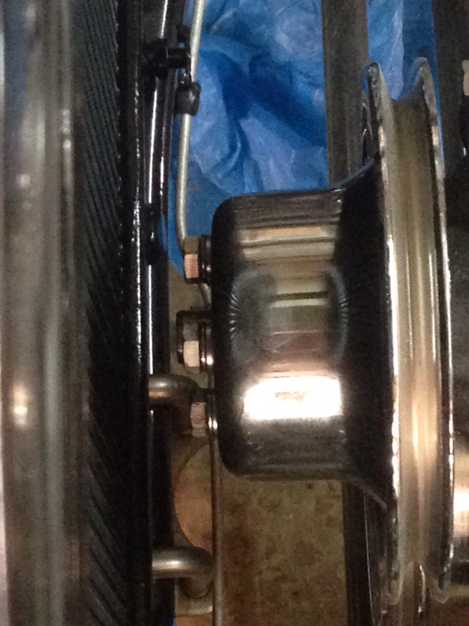

    problems keeps on coming
    no place for fan

  24. 3banjos
    Joined: May 24, 2008
    Posts: 480
    3banjos
    from NZ
    Electric fan in front. I recall someone shortening/machining the stalk. Or short pump if not already.

    Your build is coming along great- I'm all for the 3" chop ( keeps the proportions right to me). I've cut 3 up; all 3", and liked them all. Fans are always a pain in the ***- I screwed around for 2 weeks trying to squeeze one in my coupe with a flattie, and finally said the hell with it and got an electric fan. I'd rather be driving than tearing my hair out!

    after a lot of thinking i think i can use 2 electric fans 10"upper and 8" lower, not sure though .have to test fit first.

    I read in another thread that planning should start at the radiator. Set that first. Then use that to set the engine location. Then move the firewall to make it fit. Doing it that way, you don't run in to clearance problems at the fan.
    Seems like good advice to me. Bit late to do you any good now though.
