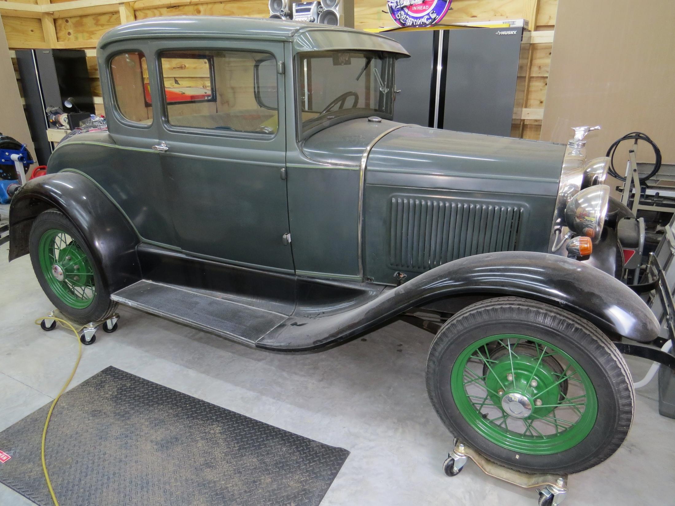

    To begin...I bought a VERY clean, original 1930 Model A back in November and just started to tear it down. The thing that surprised me was the condition everything was in, no rust and the fenders and body panels original for the main part. I decided (as I am sure most do) to try to offset some of the cost I would see on the new parts by listing the original stuff on eBay and was pretty surprised at what they brought. Front fenders alone went for $1480(!), engine/gearbox another $2,000. The car cost me $8,000 and after selling all fenders, running boards, horn, engine, hood and bumpers I have just slightly more then $5k back already. Still have the axles so am sure they will contribute a little more to the kitty. Alas I now start spending... picked up a nice Offenhauser three deuce setup and a set of rebuilt Stromberg 97s, 45 fin Buick drums and 1940 hubs/plates etc.
    I am headed to Posies this afternoon to pick up the dropped axle, springs, spindles, shock kit, steering rods and a few other bits. Hoping to get to work on these this weekend.
    So, the body/ch***is as of now has cost me $2800. I don't know how typical this is but I can tell you it was a pleasant surprise...I was expecting twice this or more.
    Oh, I also grabbed a set of wheels from Vintique wheels (15x 6 and 15 x 7) their series 14 Gennies and center caps. The original wheels finish on eBay today so I needed something to replace them. I will put cheapest tires I can on them for now un***l the build is complete. I will decide on whether to retain these wheels with new tires closer to the end.
    Pictures to follow to show car as I bought it and as it sits now minus fenders, radiator and engine. Hopefully will post more this weekend with some front end work done.

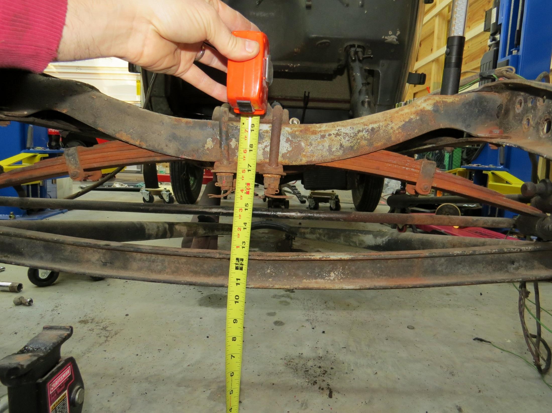

    Decided to go with 1940s Ford brakes and got a set of backplates, hubs and all hardware (basically everything except spindles) for $275. They are on the way and this is why I had to stop where I did this weekend.

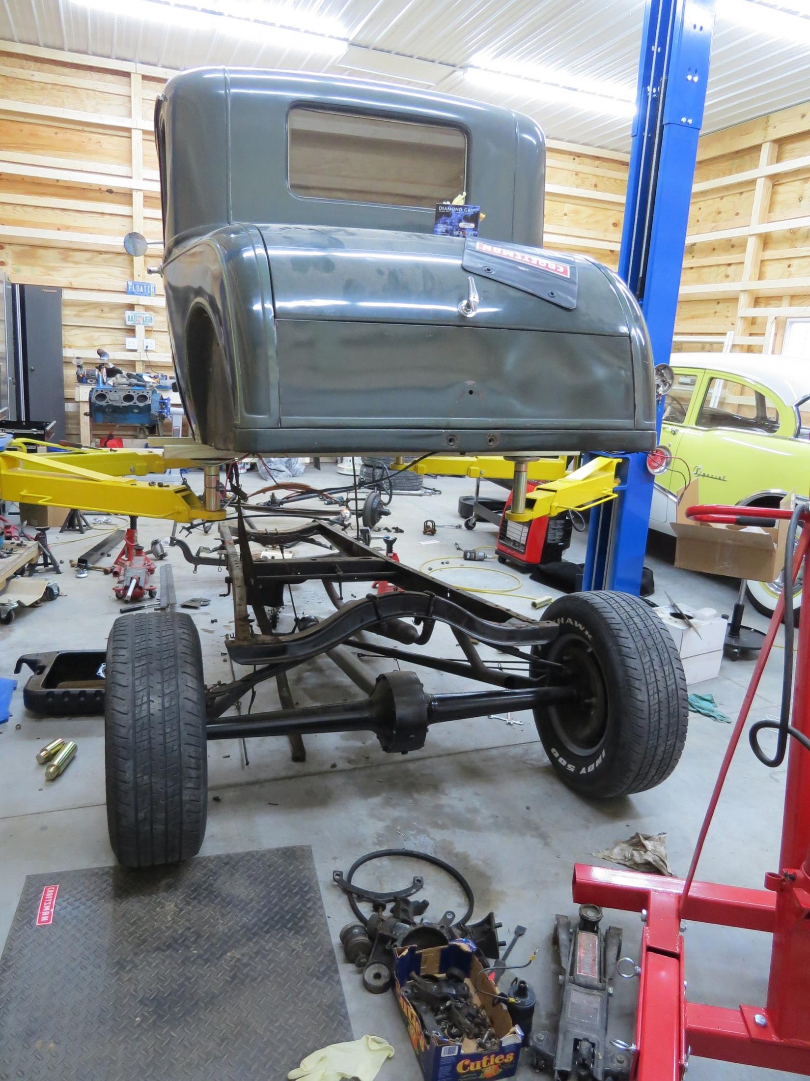

    So, this past weekend I got the original front end off the car and replaced it with new parts collected Friday from Posies. Photos below show three pieces of progress; removal of steering column/wheel and front axle etc, removal of body from frame and installation of the new axle/springs. I will be cleaning everything, just getting everything mocked up to make sure everything fits etc.
    You will see I show a measurement of frame height on original front end/wheels. I will compare once the new setup is in place to see just how much drop I get out of the axle and 'low option' Posies springs.
    Removal of the front end was maybe 45 mins work, effectively just the spring shackles. Equally, removal of the body from the frame took maybe half an hour as I had already gotten everything that connected them out of the way except the steering column/wheel. Installation of the new springs/axle took 20 mins or so, super simple. I suspect the trickier work commences once the backing plates/hubs and finned drums arrive this coming week...
    Oh, and for the eagle eyed a****st you, I also switched to my mule wheels/tires. Managed to get the tires for $50 from the local tire place.
    Next steps, front brakes. Hopefully in the next week or so. Oh, and grabbed a vintage Arvin heater on eBay this morning. I think it will add to the interior and I know the wife will appreciate it!

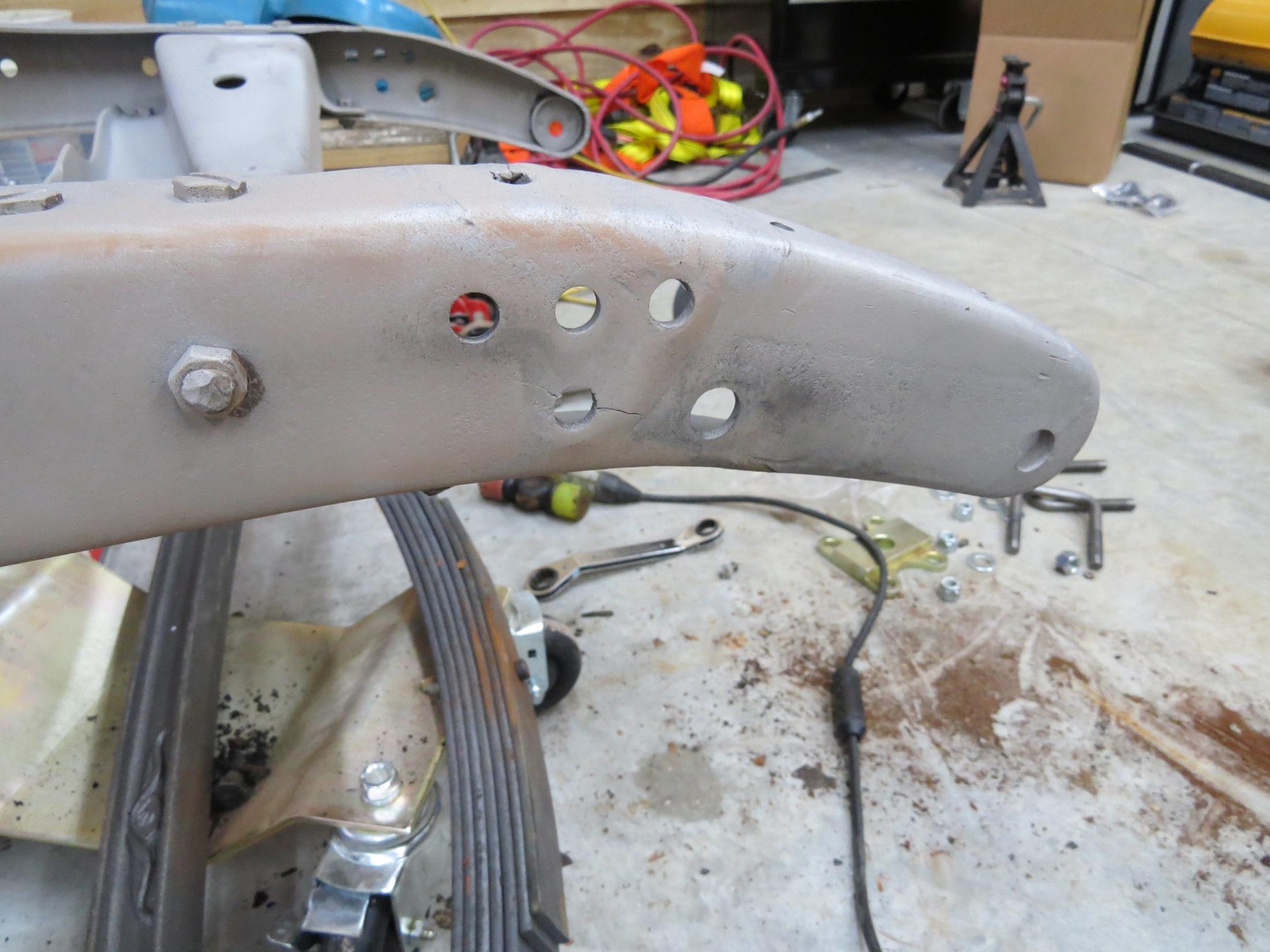

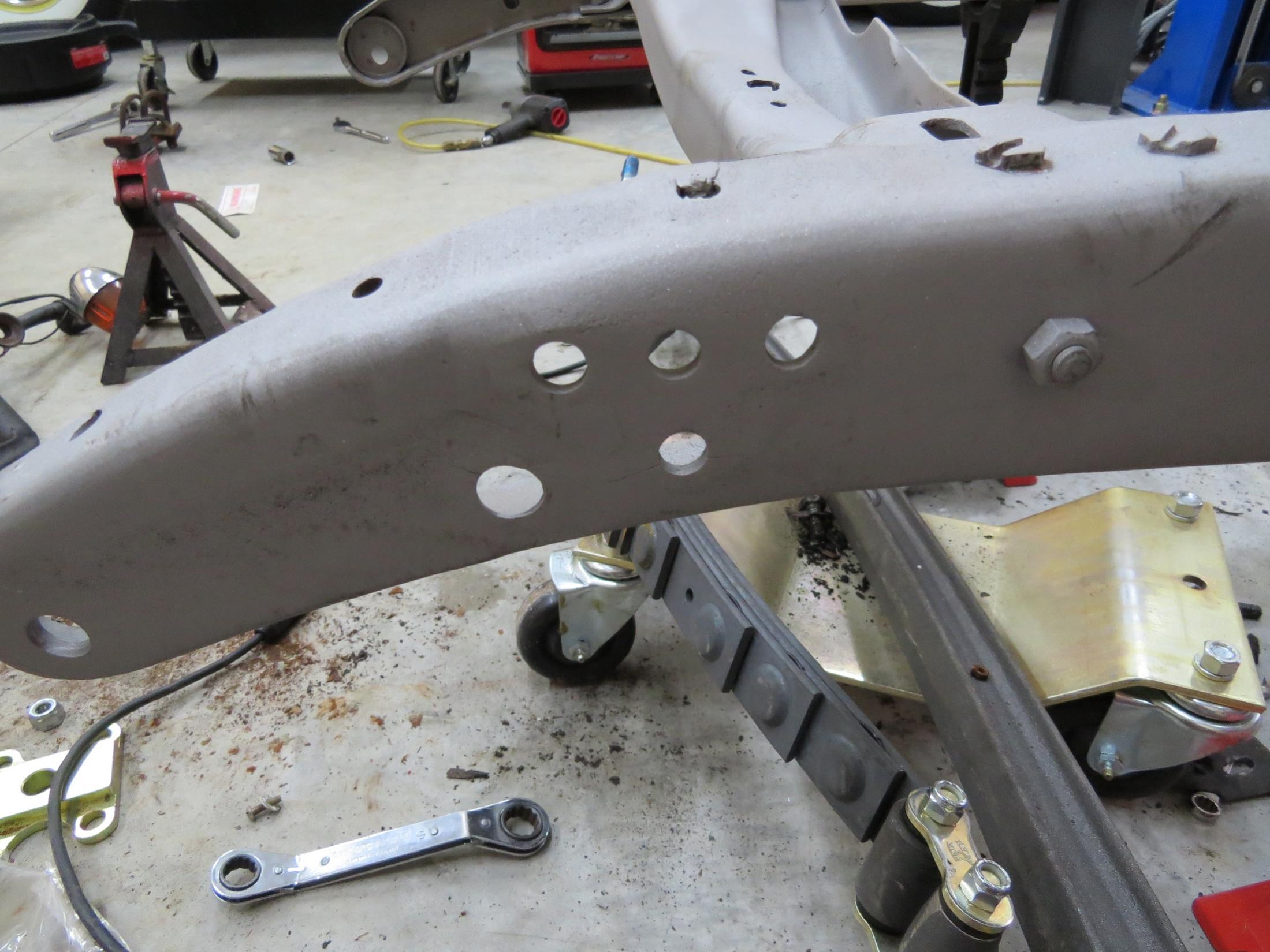

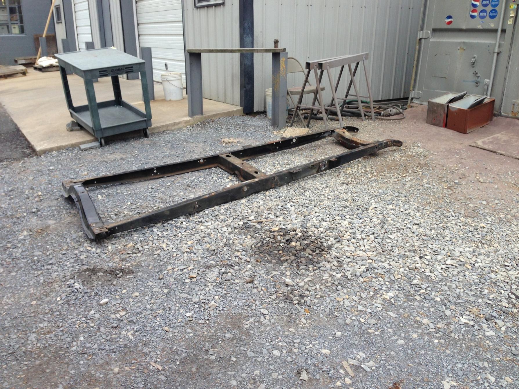

    Today didn't quite go as planned. Intended to pop out to the workshop this afternoon and clean it up form the weekend's work. Instead, somehow I got sidetracked into looking for a local place to sandblast the frame. Rang them and they basically said, 'come on over, we can do it now!', so I did.
    Popped the rear spring shackle off and and few ***orted brackets and managed to manhandle it into the pickup bed. I am sure it is easier with two people but c'est la vie...
    Picked it up after lunch, total cost was $75 for one hour's blasting. Seems more than reasonable. Expected twice that.
    It has some 'issues' but from what other HAMBers are saying in the main forum it is a decent frame and subject to some repairs will be fine.
    Ordered dimpled boxing plates (www.wolfesmetalfabrication.com/ModelADimpledboxingplates.html) which I should have here this weekend. Trying to get my head around the logical order in which to attack the frame. Seems I have several jobs to do:
    Close up unwanted holes
    Add motor mounts
    Box frame
    Repair cracks and prior 'repairs'
    Some form of X/trans crossmember
    ...and I I am sure there are 5-10 other things I don't even know about yet. How I work out which holes are unwanted is also a mystery. I am thinking I will get the car/frame/motor/trans back together and mock it all up and then pull it apart again for painting. That way I should know what is what.
    Not bad for an off day.

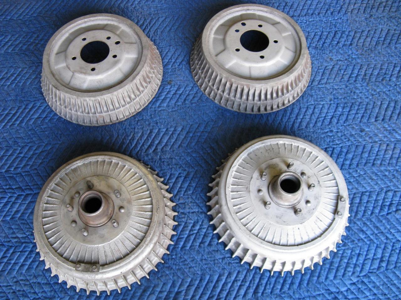

    Buick drums (fronts and rears) arrived last week and are in super condition. Will need to think a little about mounting the rears to the axle I bought.

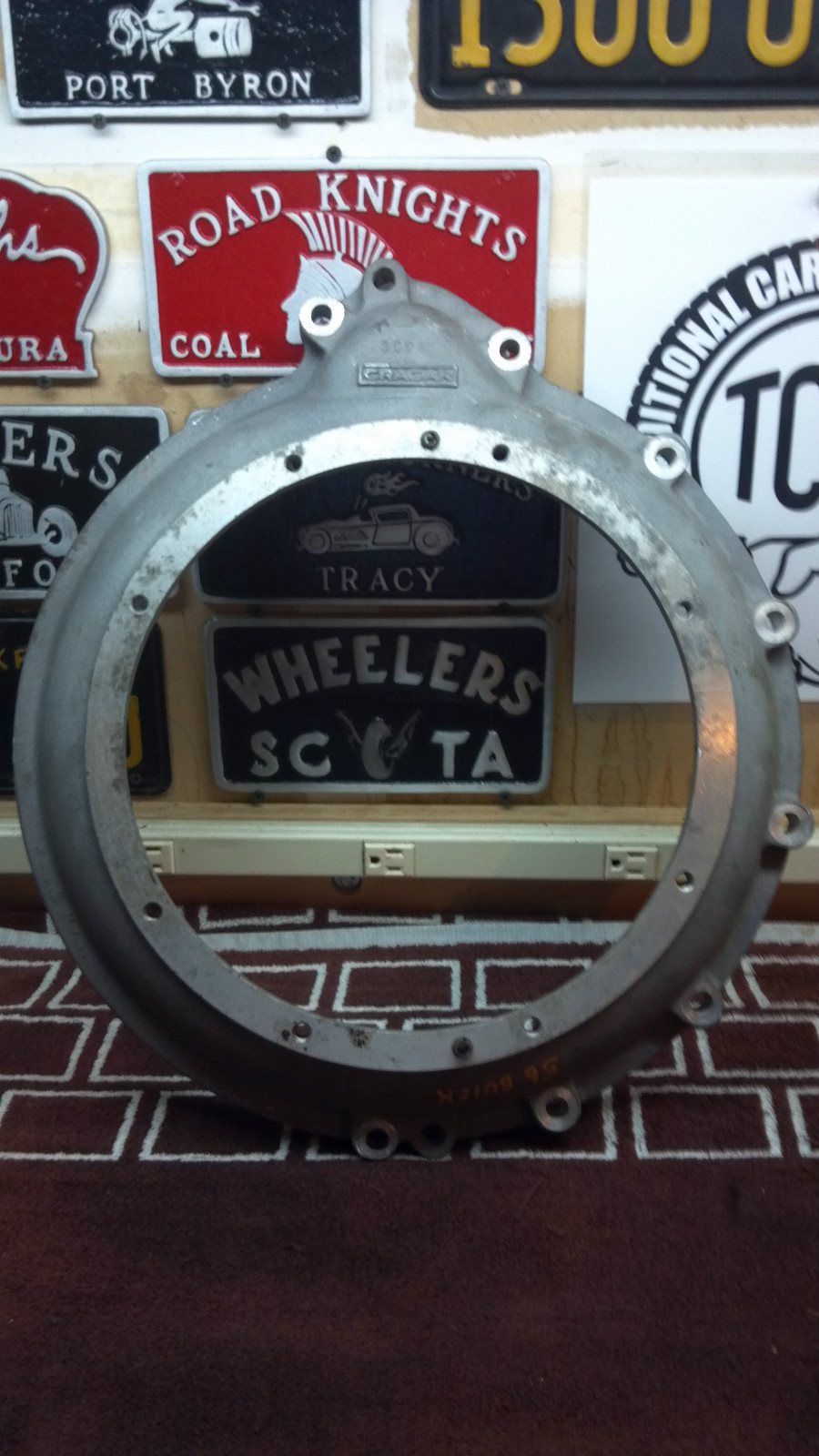

    The tripower setup ($800) is looking great, cant wait to bolt the engine together. Need to think a little now on air filters...
    Managed to get a Cragar 309 trans adapter ($120) which allows me to bolt the gearbox ($225) I also bought to the nailhead.
    It is coming together. Didn't realize I would spend so much time researching what works with what and what route to take.

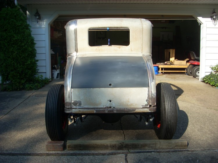

    Great build, Wex. One caveat though RE that Bronco rear end. I too am building a highboy A coupe with a 9" rear. I'd heard about Broncos, but couldn't find any, so we had to narrow a bigger one (Torino). I wrestled long and hard with what width I wanted to end up with - the slightly tapered shape of the rear quarters made it difficult to decide. I researched here on the HAMB for what width guys recommended, and the number that kept coming up was 56" housing flange to housing flange. I finally went to 55.5", and actually wish I'd done 54.5" or maybe even 54". It really comes down to the backspace of the wheels and the tires you will use, and of course the look you want tio end up with.
    I'm certainly not saying 58" won't work for you - it may be fine. I'm only suggesting that you measure, measure, measure before you start welding on the Bronco axle. Do overs on rear ends ****.

    Thanks for the input re the rear end, appreciated. I will be running a fenderless highboy and so I 'think' I am OK. I will do some more research/measuring.
    Paul

    Mine's fenderless too - I just wanted the tires tucked in as far as I could without risking rubbing on the body when the axle is higher on one side than the other - like when angling over a speed bump. That would make the wheel/tire swing in a just little bit of an arc (top comes inboard just a little), and that's hard to visualize or calculate. That all seems like I over-complicated it (I'm good at that), but I missed the mark anyway.
    I may be changing wheels soon to a pair with more backspace, which will solve my problem.

    Here are a couple of pix of what 55.5" ended up looking like on my project. Could have been tucked in some more.
