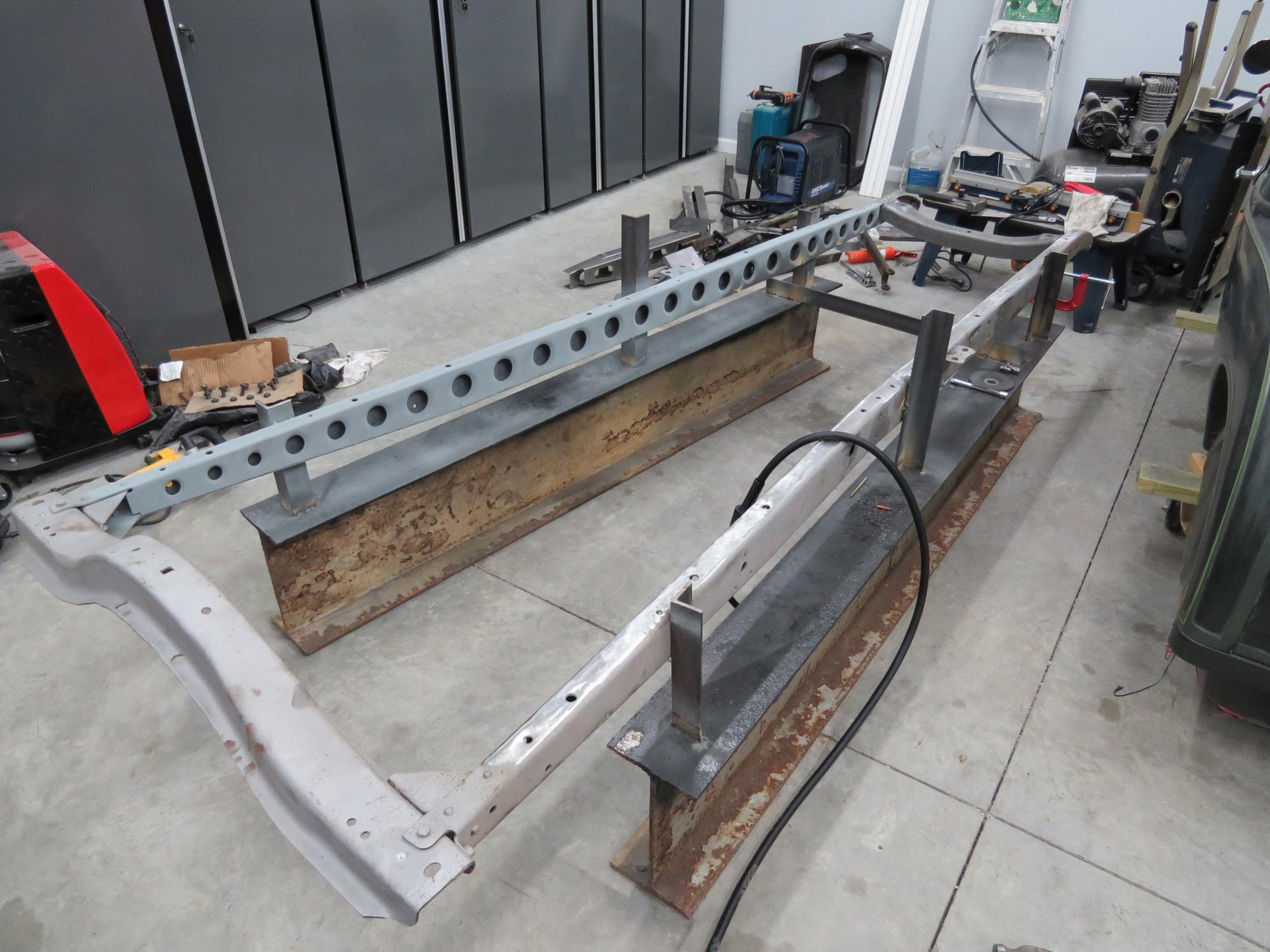

    It has been a depressingly long time since my last post and since I even thought about the rod.
    The Christmas present I bought the wife ('59 MGA) has been something more of a workload than I ever imagined. It is now road worthy and all jobs completed. So, I can turn my attention back to the A...

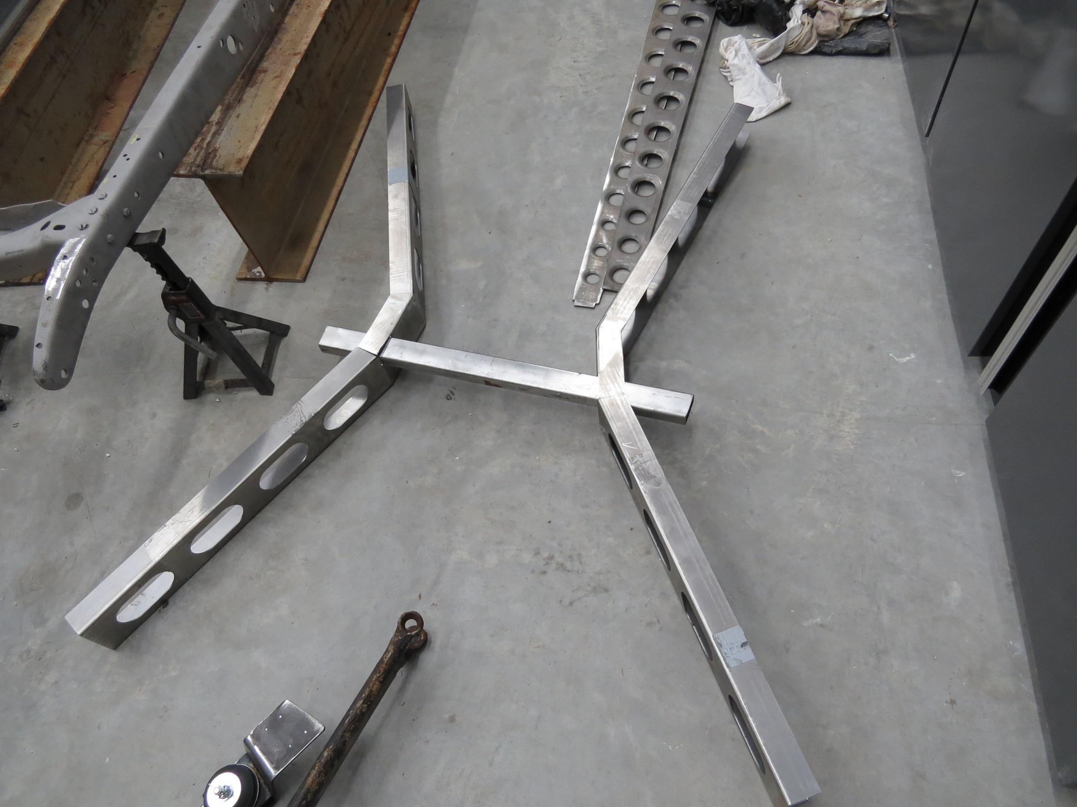

    I bought a couple of pieces of I beam and plan to clean/paint the top and clamp the frame down to them. Hopefully that will keep things straight. I have a Dagel super X crossmember which you can see in a shot. So, next steps, clamp frame down, remove center crossmember, install super X crossmember, box the frame and then start to think about the axle/suspension.
    At this rate I should be to the Goodguys events in 2020!
    As ever, feedback welcome. If I am about to do something truly stupid please let me know. This IS my first rodeo...

    Not much of an update but after finding the frame had sagged about 1/4 inch I had to use a trolley jack and raise it in the middle. I then tacked the middle to two more posts, keeping it solid AND straight.
    Bought a few cans of Krylon high zinc primer and will be priming the boxing plates this afternoon. Then, I need to hold the plates up to the frame. I already know there are several places where the lower rail has been introduced to something hard, at speed, and there are a couple of waves. Need to use something to straighten it out. Then, welding time!!!!! My hope is that the boxing plates will be on but maybe not finished, this weekend. Then, I turn my attention to getting the cross member in place. Lots of measuring etc.
    Not sure what the next step is supposed to be; front suspension? or, maybe mockup engine/trans? I will do some digging on here and see what I find.

    Well, this is all I have for now. Tacked one of the boxing plates in yesterday afternoon before getting called away.
    Sprayed inside of frame and boxing plate with a high zinc primer. Welded on just fine. The fit of the plates is superb, clamped into place easily. Hoping to have the remaining three tacked into place today or tomorrow. Thinking of doing a trip to Posies to pick up a new front cross member. The original has a couple of cracks and I would sleep better knowing there are no hidden cracks up front.
    Trying to get my head around rear suspension next. Ladder bar is likely the way I will go. Posies needs to know spring perch width which I haven't got a clue about how to calculate....baby steps.

    The boxing is almost finished. Should have it done today. Then, I will be installing the Dagels crossmember. Hope to have that tacked in place tomorrow.
    In talking with another HAMBer I have discovered that I really need to finalize my choice of wheels/tires and set the frame up at ride height. Then, I can place the axle and see whether I need to move the rear of the frame higher. I have been informed a '40 spring has a lower profile and this might allow me to avoid major surgery on the frame.
    Will post an update after this weekend's work has been completed.
