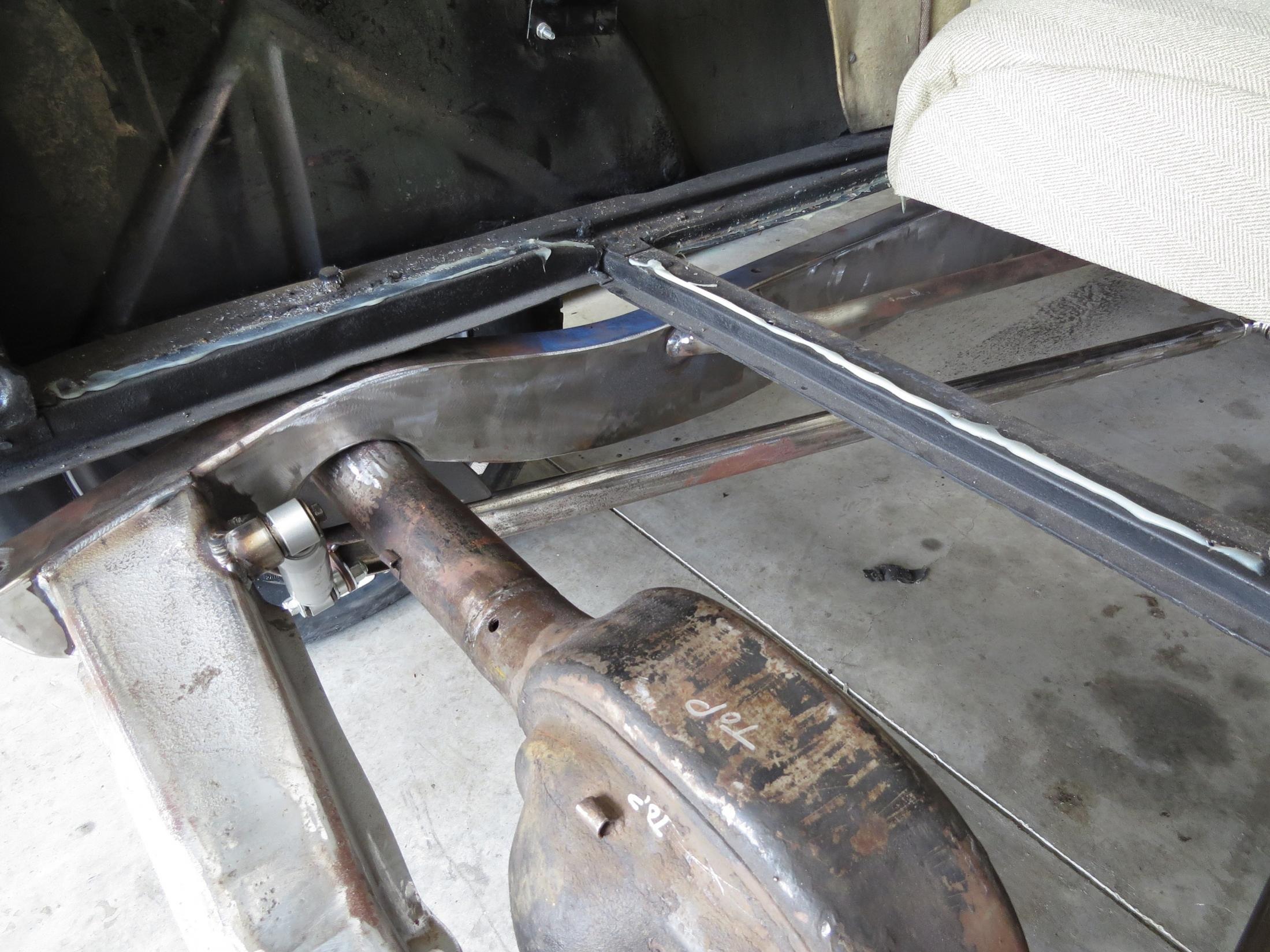

    OK, been bouncing around a few things as I am now in limbo.

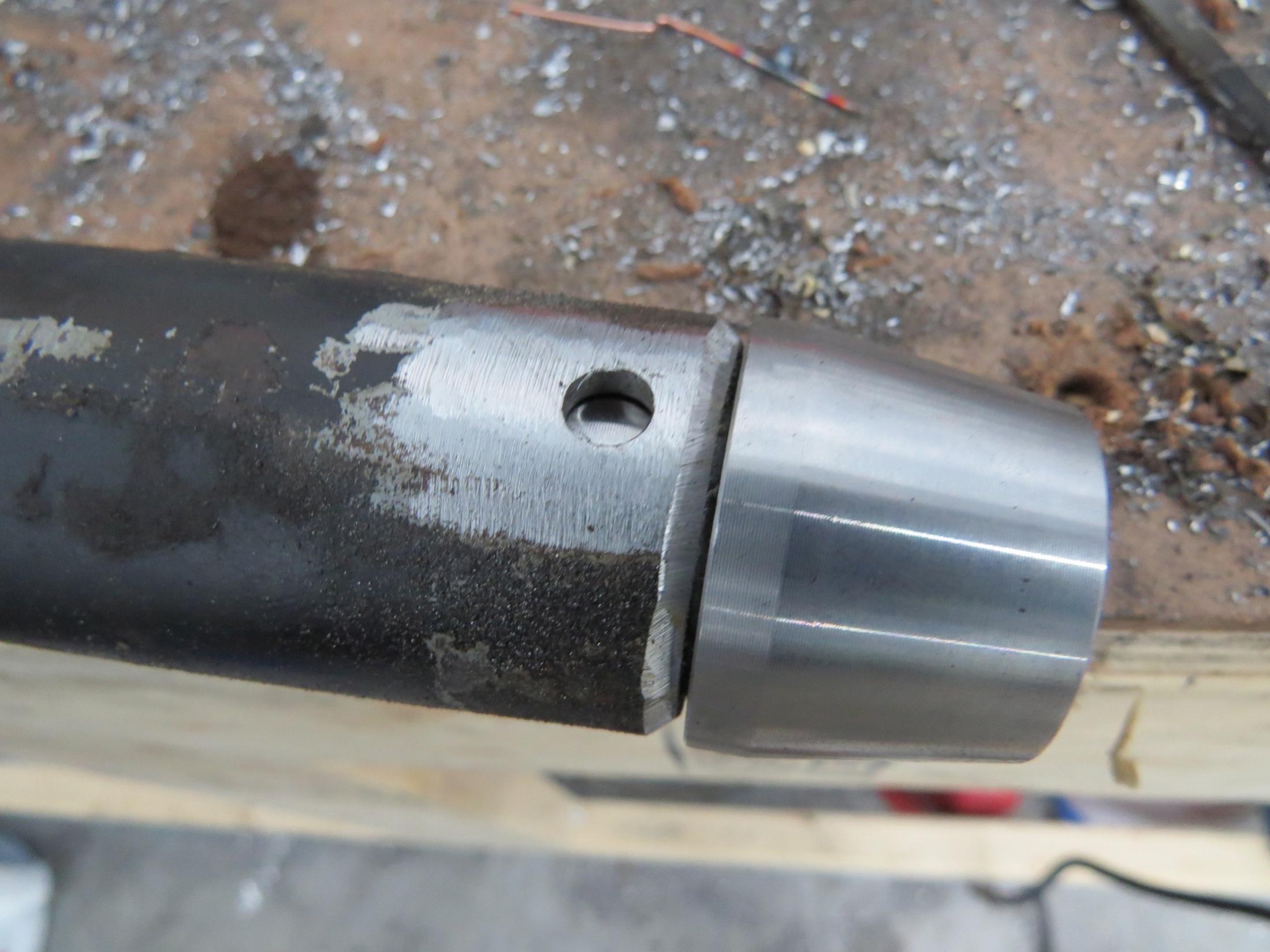

    The new 32 frame wont be here for 3 weeks so I decided to turn my attention to some misc items...

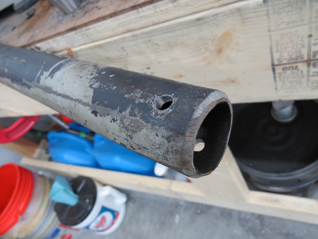

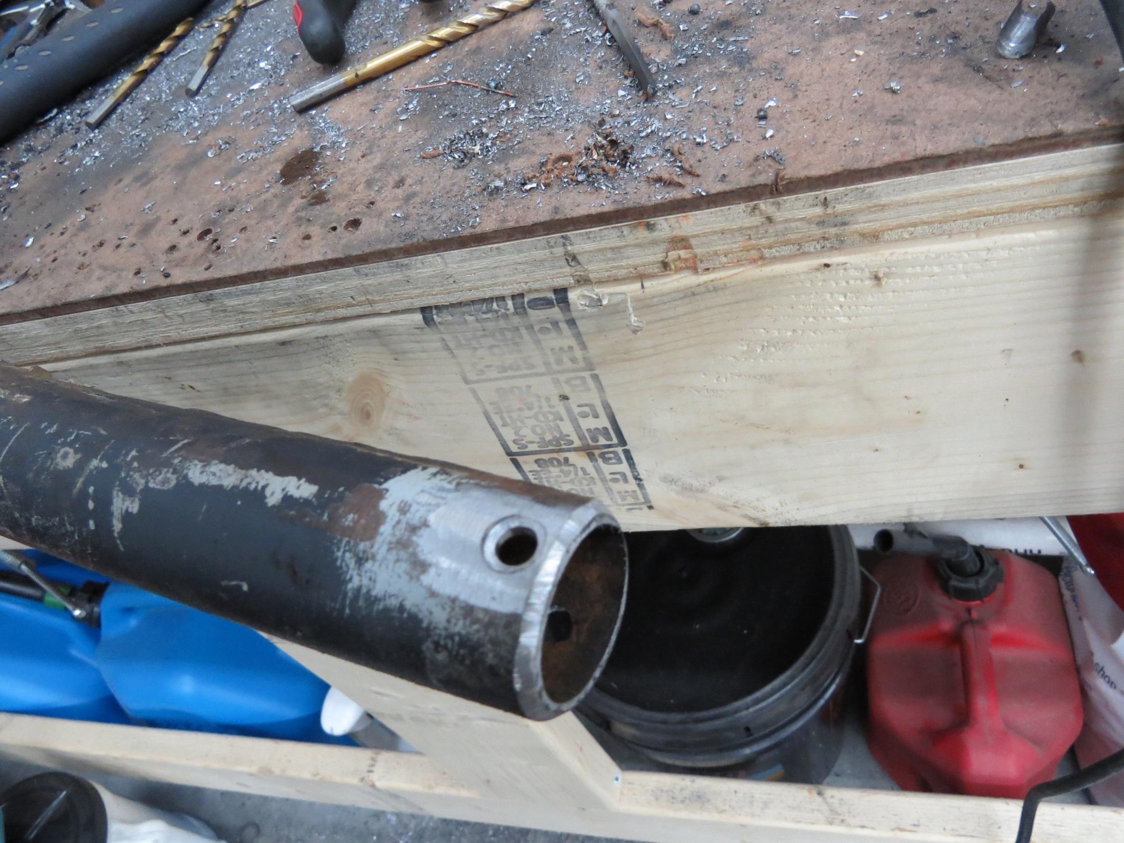

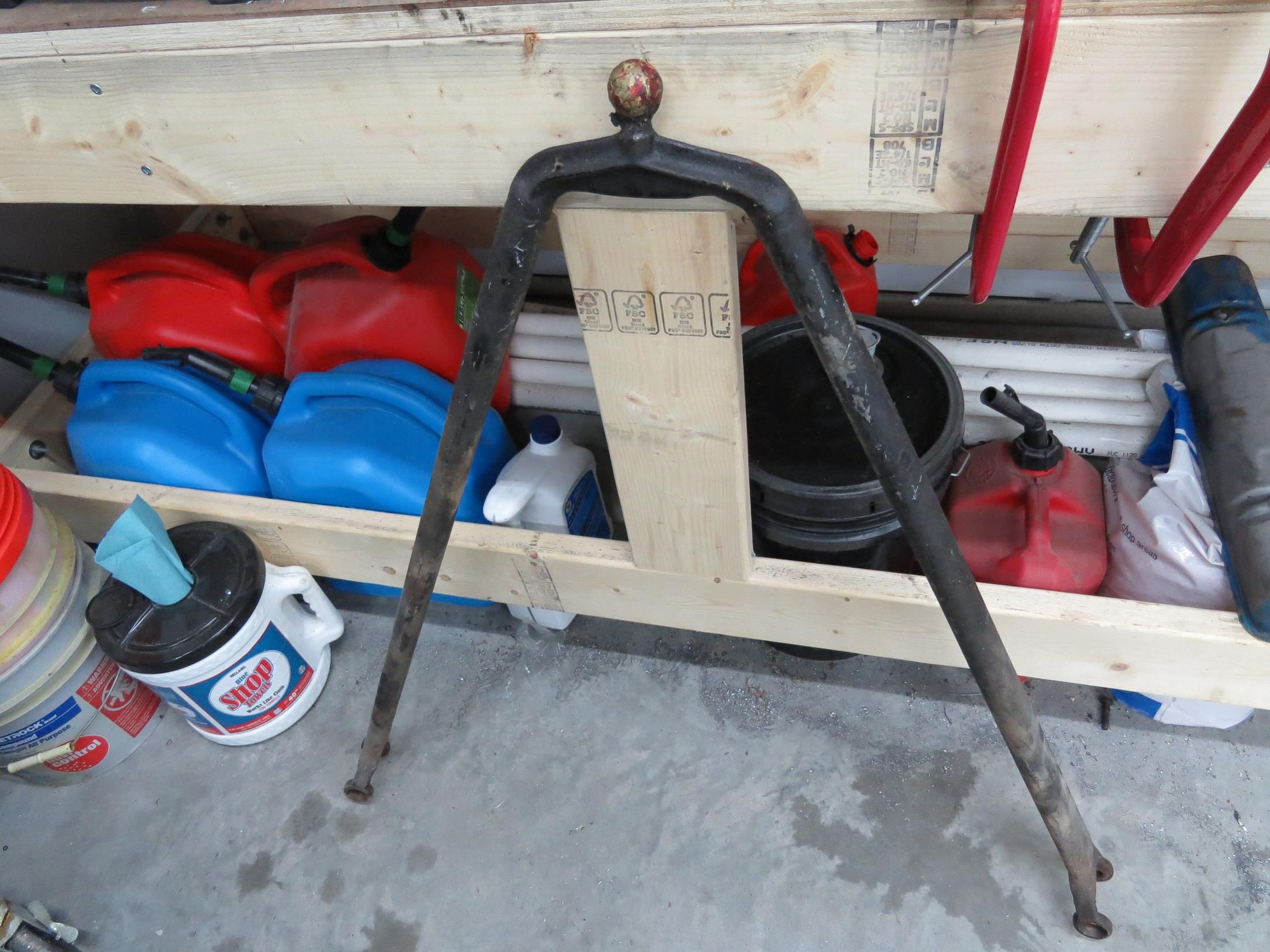

    First, the wishbone. I split it and welded the bungs in place. The photos below do***ent the process but essentially I cut the bones, trimmed one to ensure they were both an identical length. Chamfered the ends to help weld penetration, drilled some holes for bung welds and welded away. I will try to decide what finish I will give to suspension parts etc in time but for now will dress the welded area a little and paint to prevent rust, then, on to the next job...the Buick drums.

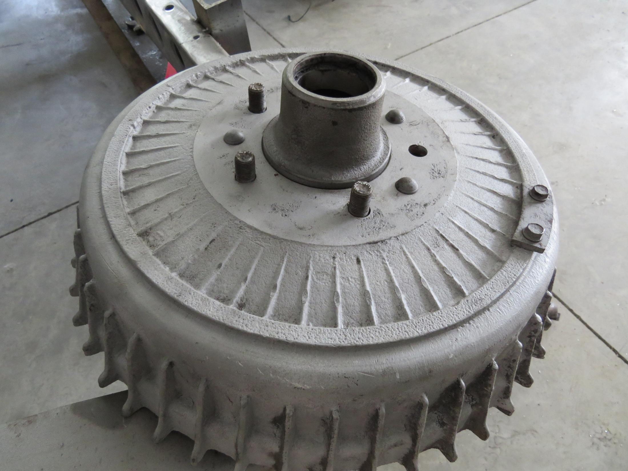

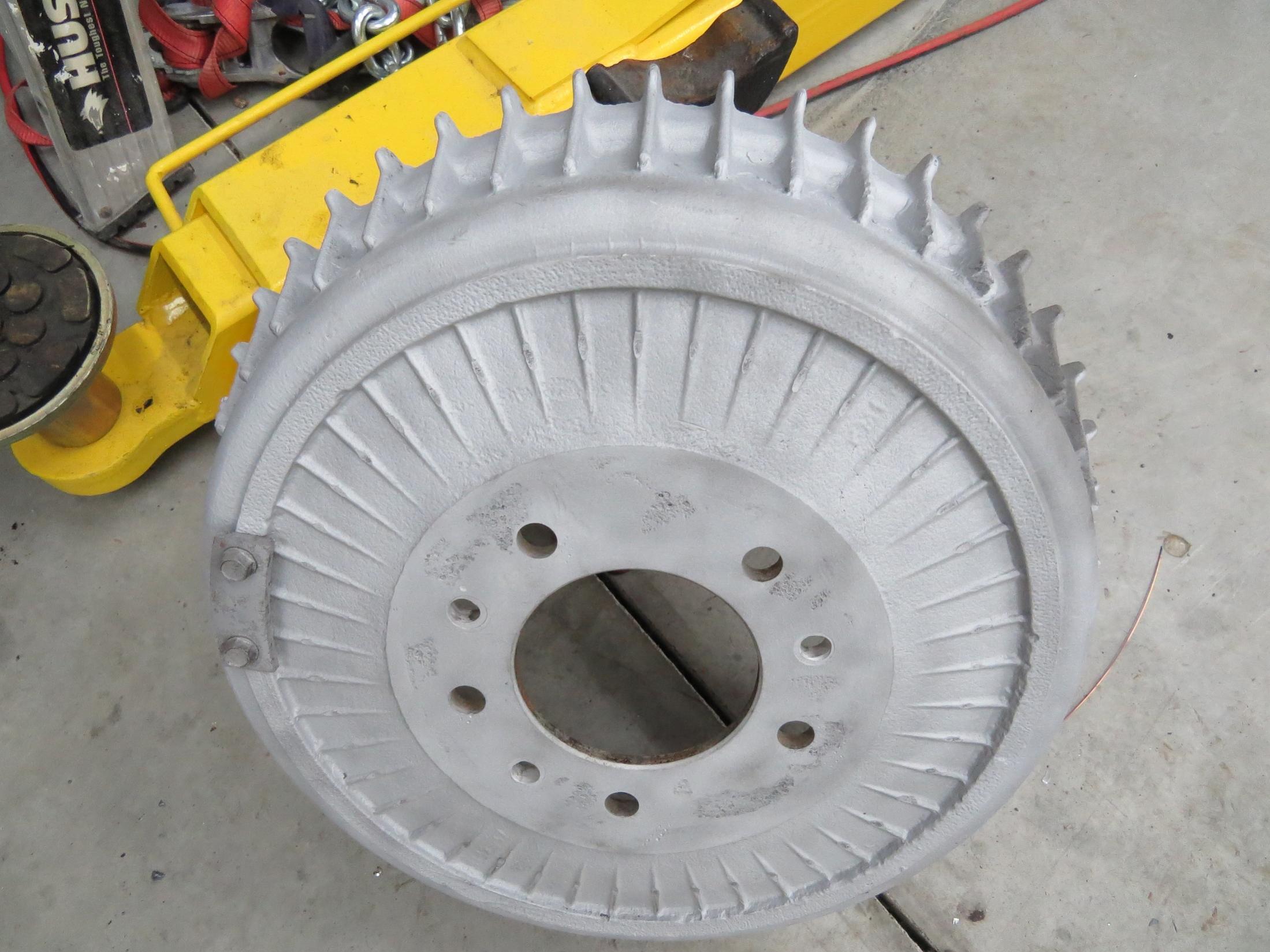

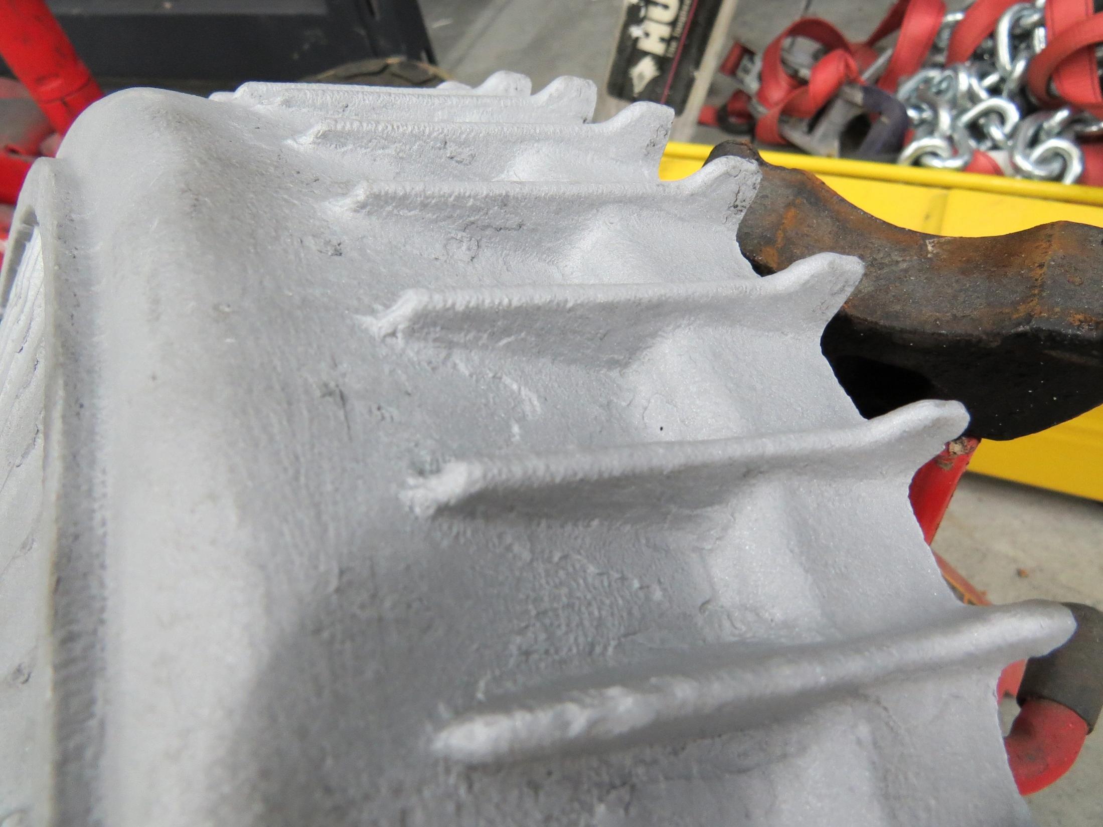

    OK, Buick drum conversion.
    I thought I would be able to get the drums and hubs ready for machining but it seems I goofed. I hhave 1940 hubs and need 46-48 hubs. For those reading this that are, like me, new and wondering what the difference is. It is simple, the 1940 hubs fit inside the drums and the 1946-1948 hubs fit outside the drums. Those that fit inside the drums required some machining which could weaken them. So, I bought a pair of 46-48 hubs this morning through HAMB and will wait for them.
    In the mean time I decided to remove the Buick drums from their hubs. Drilled out the rivets and persuaded the drum off. Be careful whe doing this in case you damage the drum.
    I gave the drums a bit of a clean. They came up nice BUT the finish is rough. I am ***uming polishing or some kind is in order. I will research.
    Next step? Well, once the 46-48 hubs arrive I will send them and the drums off to the machine shop. They will need to do two things. First, remove a little metal around the outside of the steel line (see final photo below. This allows the drum to sit into a groove around the outside of the backing plate. They will also have to enlarge the center hole in the Buick drums for a snug fit (apparently a 1-3 thou interference fit) to the Ford hubs.
    Then, when I get them all back, I will need to drill new holes through the Buick drum to match the Ford hubs. I can use the old rivet holes to bolt the drum to the hub. That should have it done.

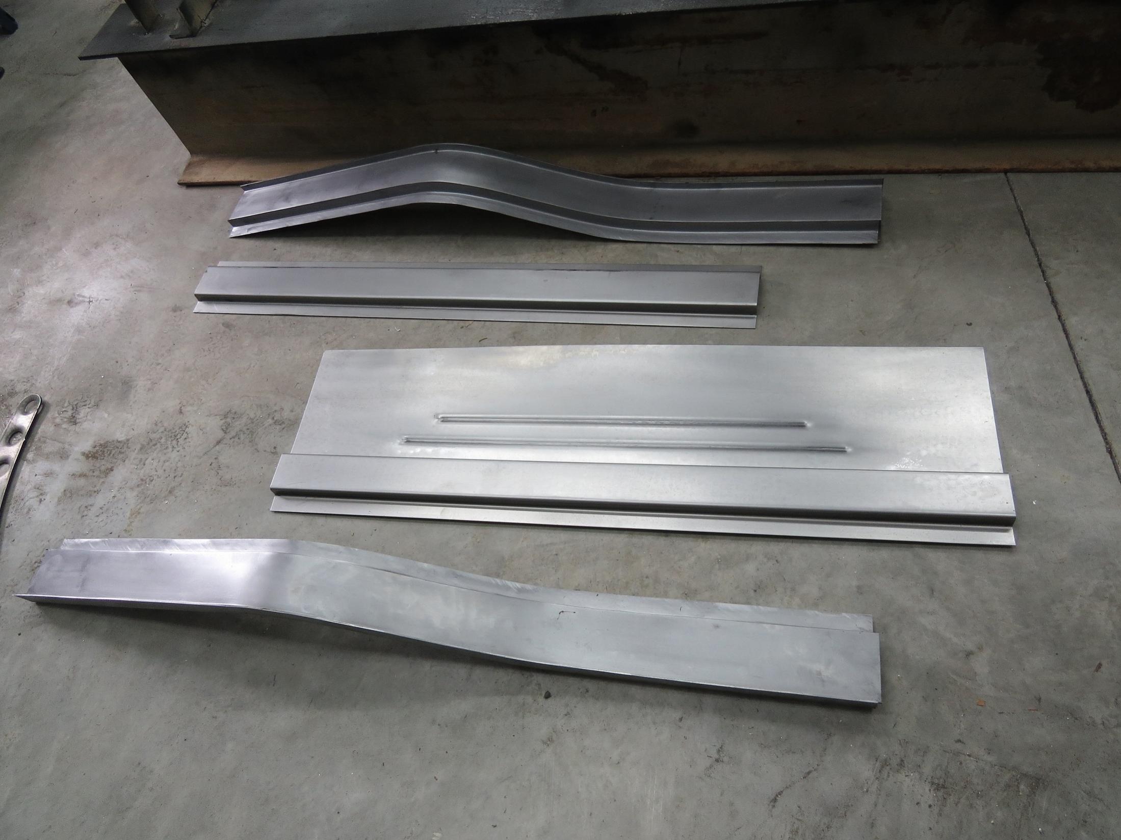

    Final post for today... my new rear sub frame rails arrived. These, or some home made derivation, are needed to fit the earlier body on to the 32 frame. They are super quality and will hopefully make the job far easier.

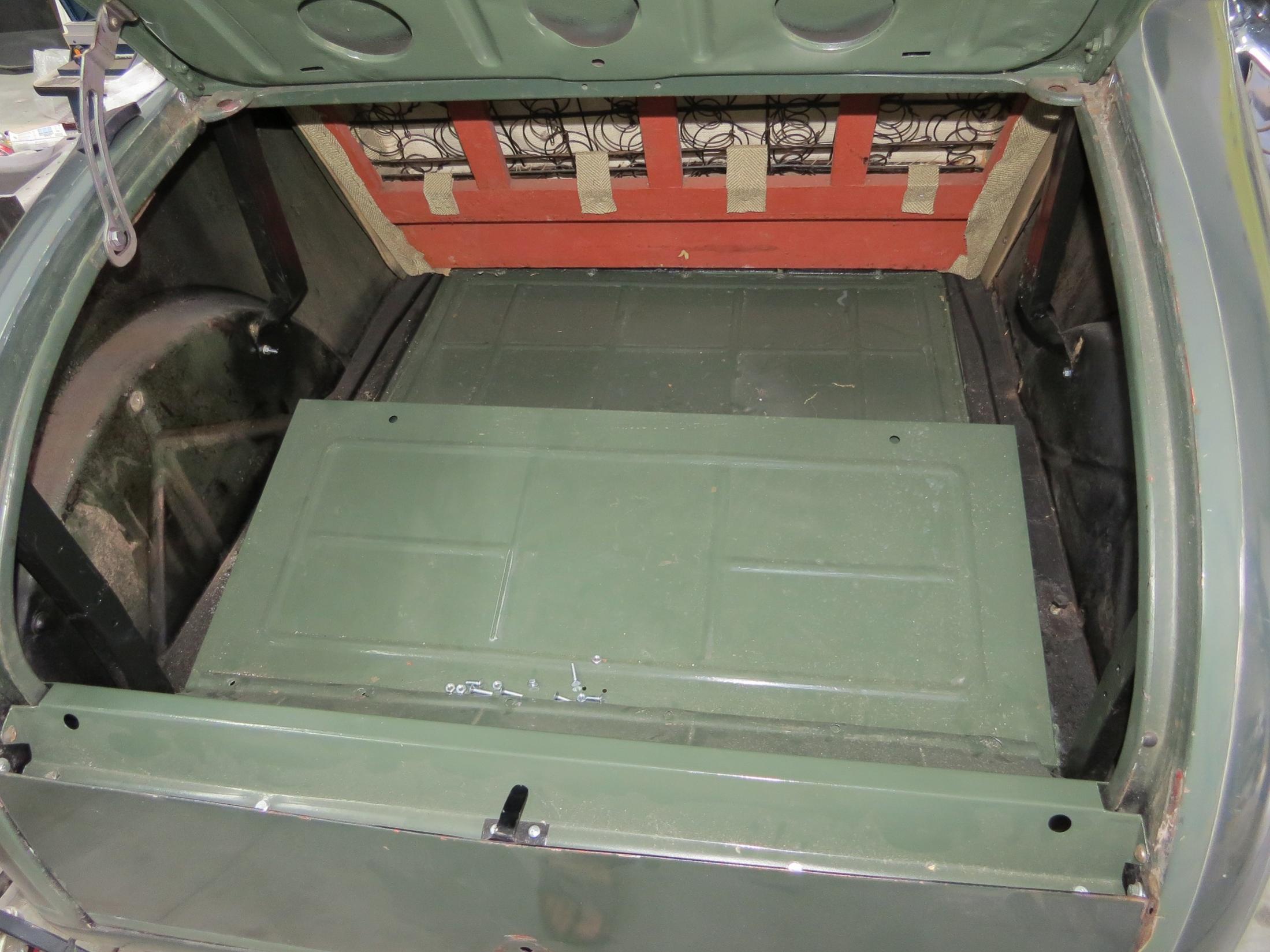

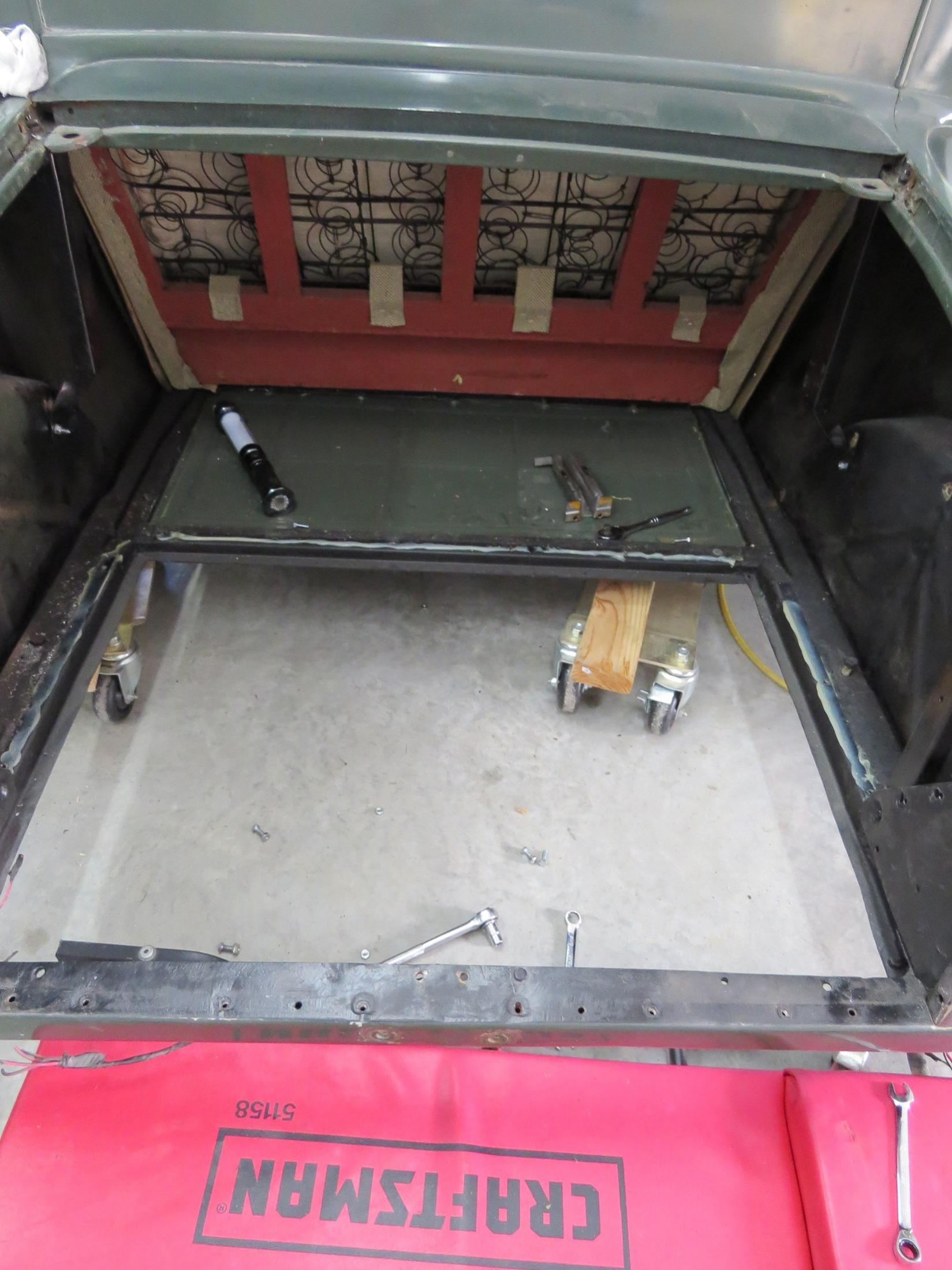

    Starting stripping the rear end of the body to keep busy whilst listening to the amazing FA Cup Final.
    Will remove a couple more panels tomorrow but other than that, I am done for the weekend. The reason? I bought a roadster, see last photo! Decided I couldn't let the summer go by with my not being able to enjoy a rod. I take delivery tomorrow lunchtime... :D

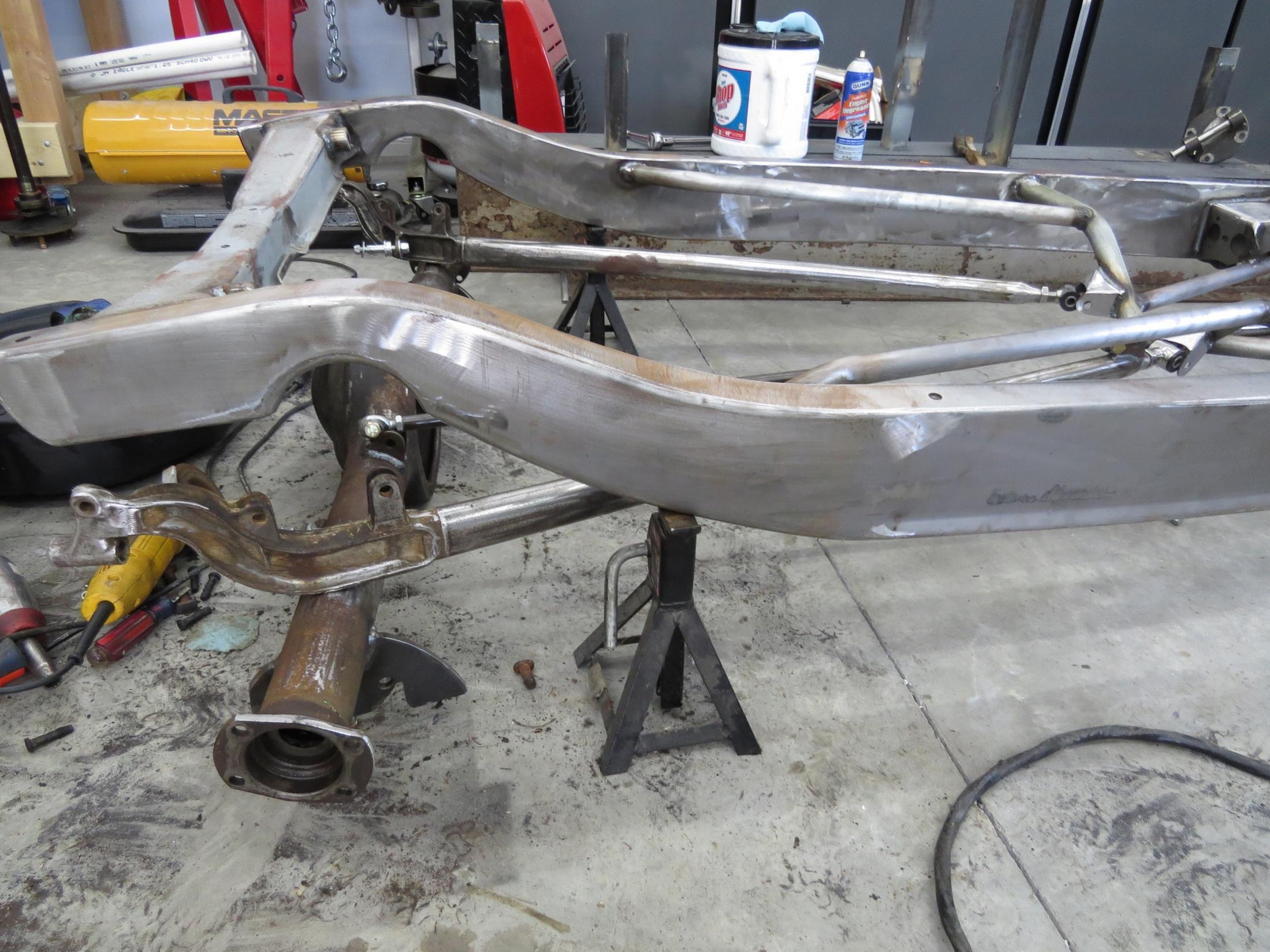

    After yet another lengthy delay I am hopefully in a position now to start building up the frame.
    I had a 2 month delay after the initial 32 frame I ordered was, being diplomatic, not what I ordered. I got a new one from Dropped Axle Productions and it is superb.
    Here are some shots of it freshly in from Ohio. I will try to turn it into rolling ch***is in the next week or two. Some highlights. I have switched to 35-40 front wishbones to position the axle, they are longer and help with the look and caster setting.
    On the rear the axle is held in place with 36 ford rear wishbone radius rods to keep a traditional look.
    Will try to get some time on the frame this week and see if I can't at least get the front end together by the weekend.
    The new frame has a reinforcing plate beneath the top surface so I can drill and thread it for body mounts. Saves having to insert nuts into an already boxed frame.
    Need to put something temporary on the frame to prevent surface rust setting up. Will do so this week.

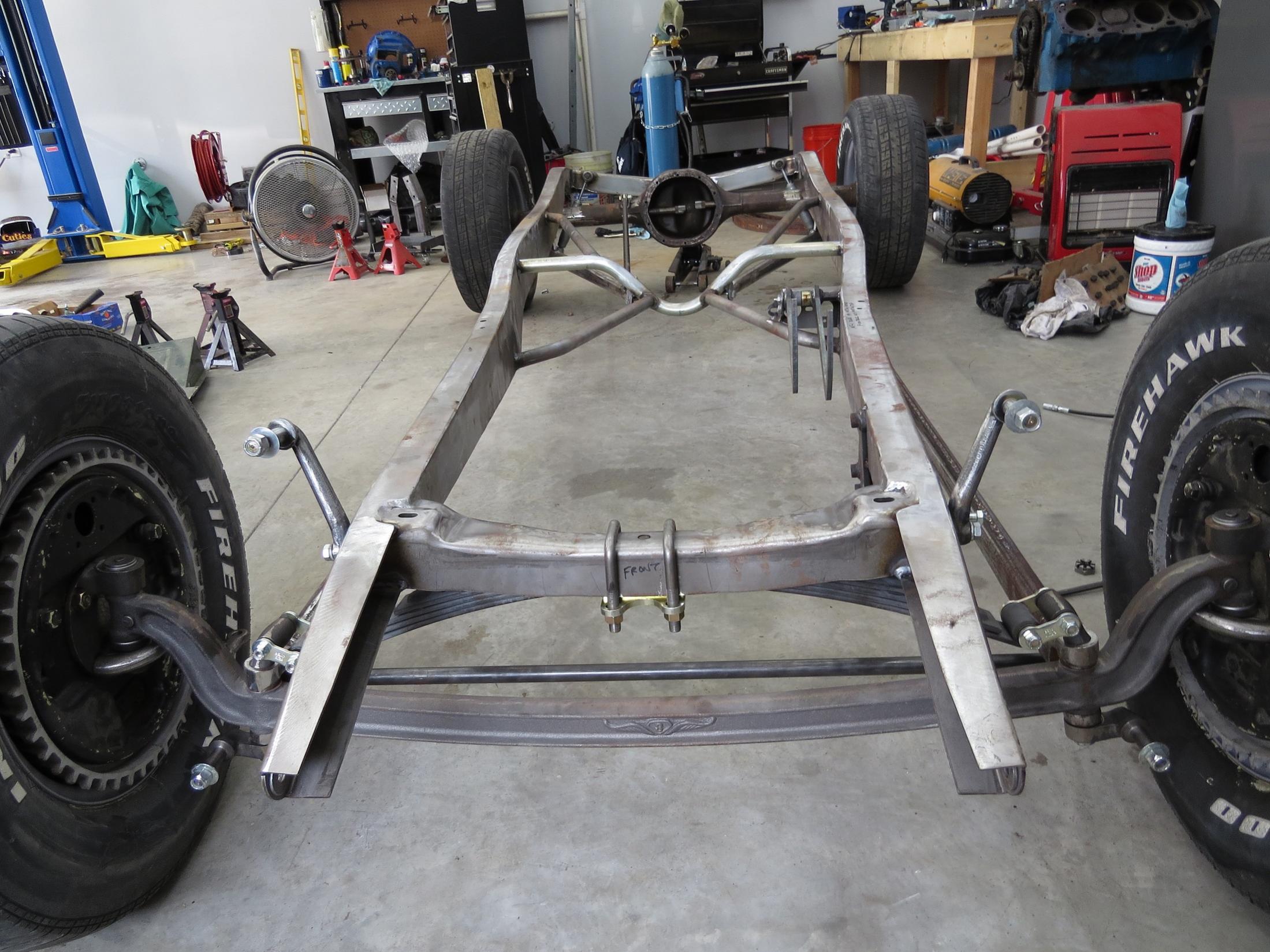

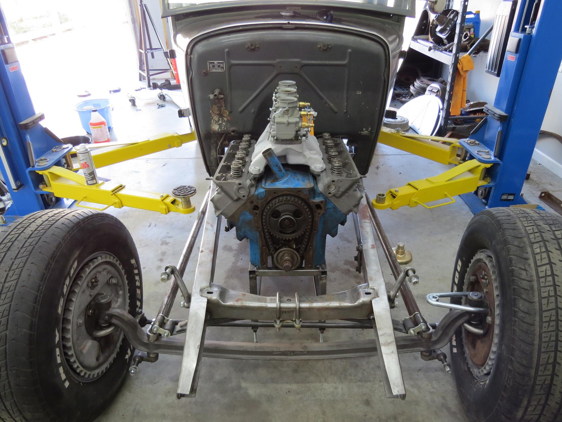

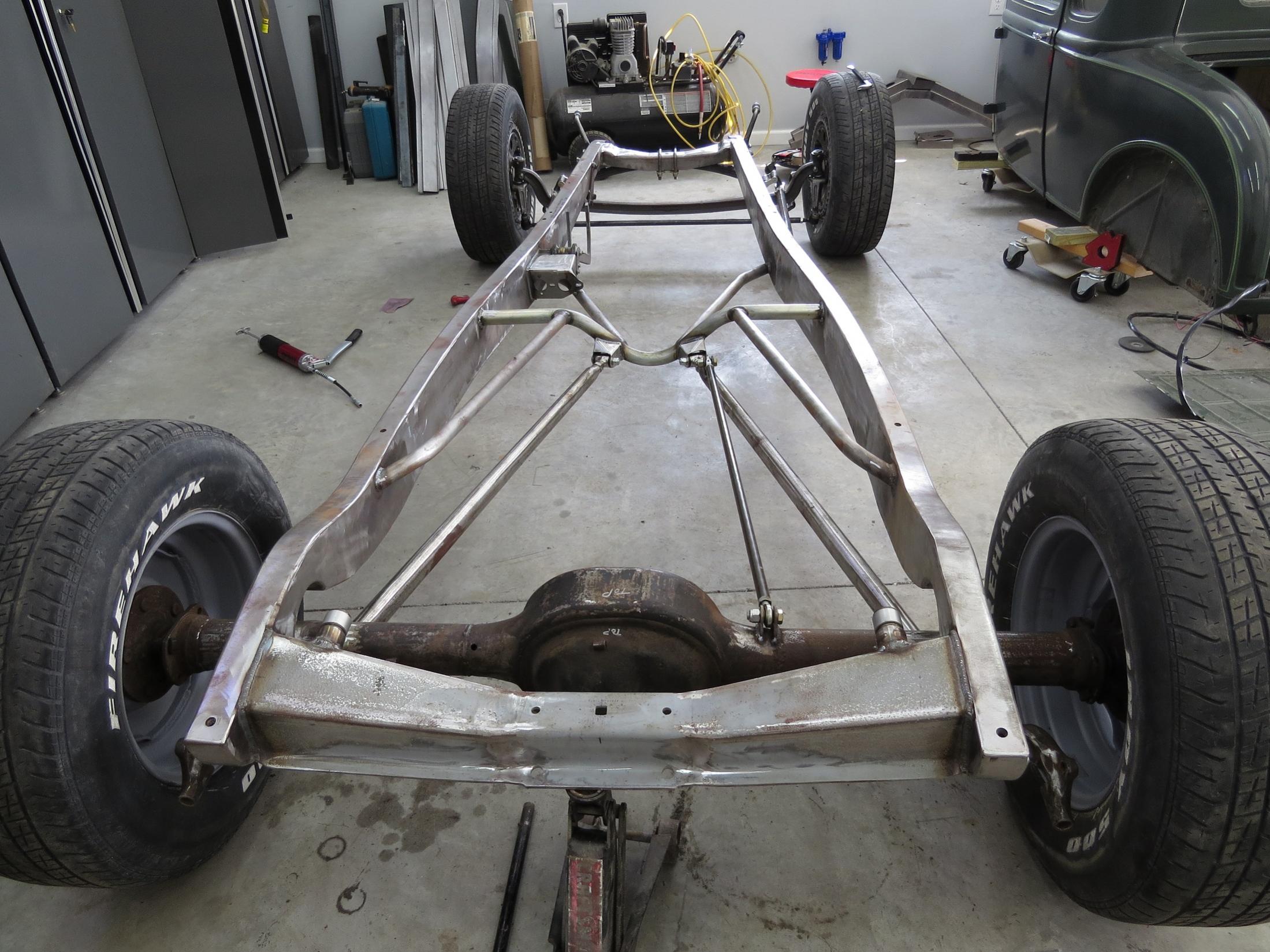

    Been a productive day despite temps in the mid 90s and high humidity. I managed to get the front end together and most of the rear end, to the point the ch***is is 'rolling'...kinda. The 1940 spring I got needs to be rebuilt and being a lazy sod I didn't even look at it till now. So, the rear end is attached courtesy of the shocks and nothing more till the spring is done.
    The front end was a breeze except the shocks which are too short. I will measure up what I need, bearing in mind the engine etc will likely lower the front by 1-2 inches I would think. I will re-check to ensure I didn't screw up something on locating the lower shock mounts but they look OK.
    I didn't bother installing the brake hardware for this mockup, I dont know what is typical. Seems a waste of time to do that as I will be stripping it all down again once the major components are in place. If there is a reason to install the brakes let me know. I will of course need to install the wheel cylinders so I can hook up the brake lines but the shoes/springs seem OTT?
    The wheels are just mules and it is a shame they cover the Buick drums but that is temporary, the drums look great. I am STILL trying to finalize wheel/tire sizes and once I do, I will grab the final wheels so I can tweak my dollies that I use to keep the frame mobile and at ride height.
    Steering is also on my list. I have decided on a 48-52 F-1 steering box. Managed to pick one up complete with column and steering wheel for $150. This will require some changes to the existing steering arms. The one on the p***enger side is setup for cross steering (which you can just see on the final photo) so I ***ume that means I simply cut off the second, unnecessary tie rod hole, leaving me with the single rod traversing the car.

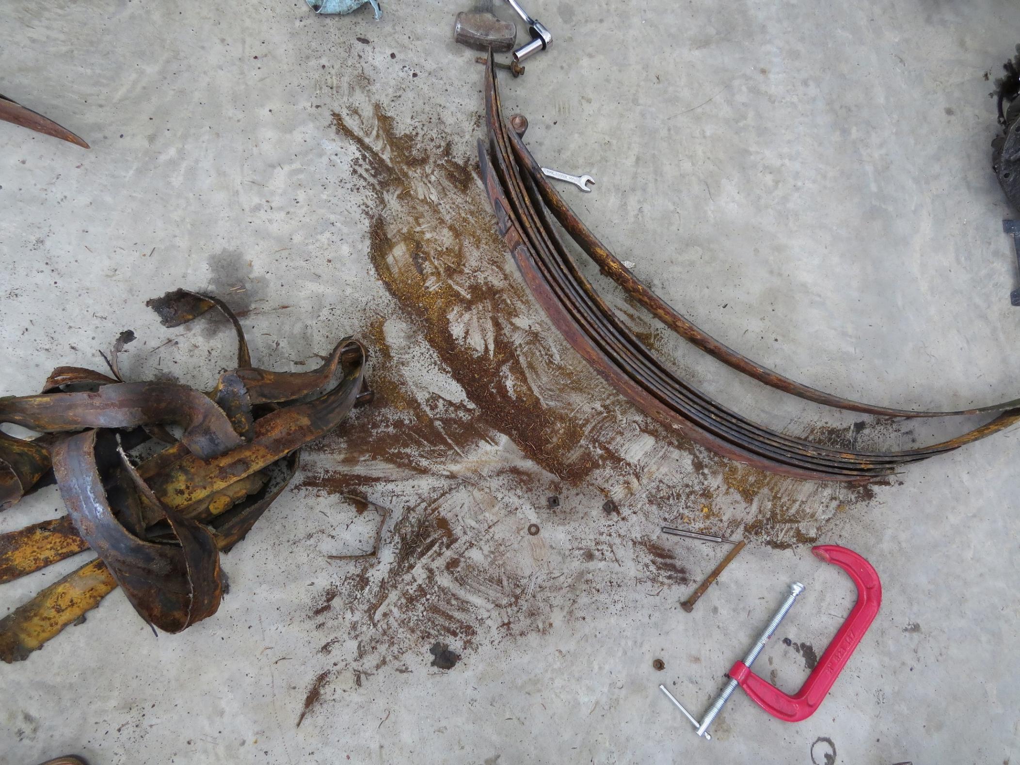

    So, next steps... rebuild the 1940 spring, work out which and how many leaves to leave in and try to get the rear end properly in place. Then, lower the body onto the frame, using the rear wheels aligned to the wheel arches to position it properly. Then, I suspect I will be cutting the rear end of the body to get the Steadfast Mfg kit in place. Once the body is sitting on the frame, I would imagine lining up the engine is next. Small steps but moving in the right direction finally.
    Incredible, had the car 9 months and this is the first time I have felt I am bolting things together instead of stripping things down.

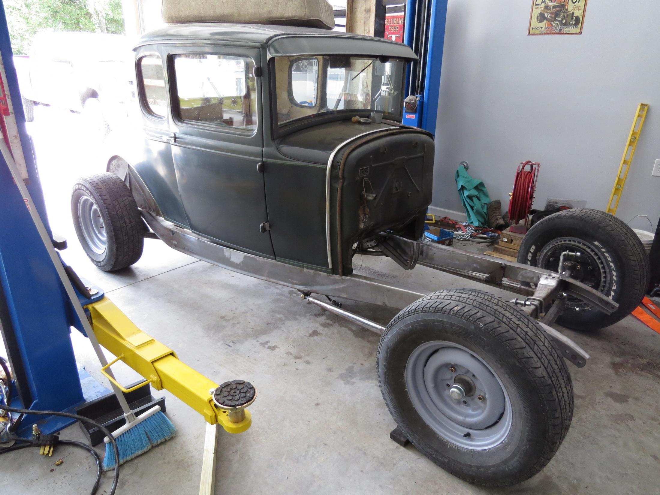

    A semi-rolling ch***is and the body sitting 3 feet away? Too tempting!

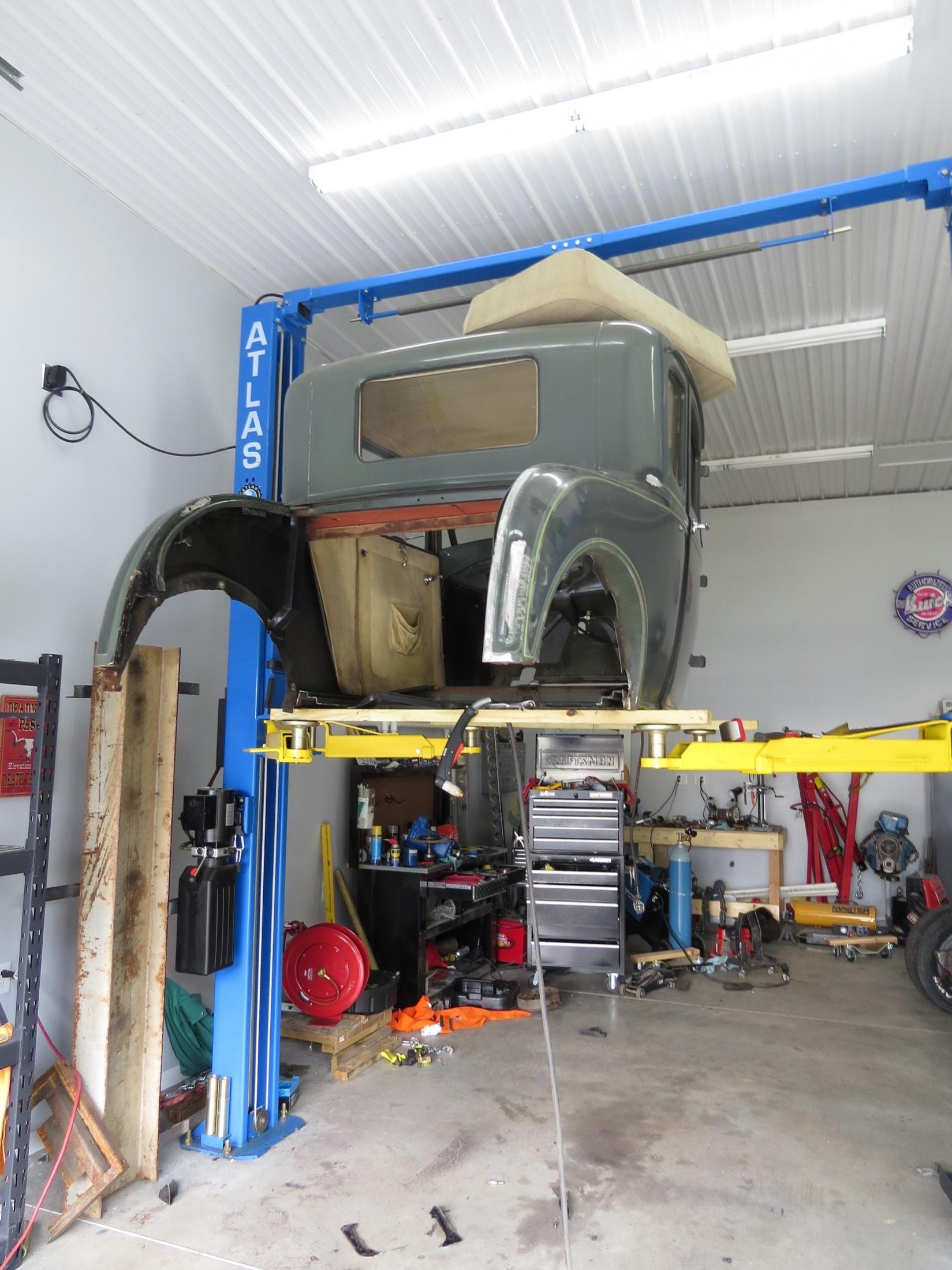

    Put the body up on the lift, rolled the ch***is underneath and voila, the mating process.
    Almost, the rear needs surgery to allow the '30 steel to sit flush on the frame.
    The pinch done by Dropped Axle Productions seems to be solid. Need to line it up perfectly but it looks like it will work just fine!
    Again, need to tweak the positioning to get the rear wheel centered in the rear arch but close enough to take a few photos.

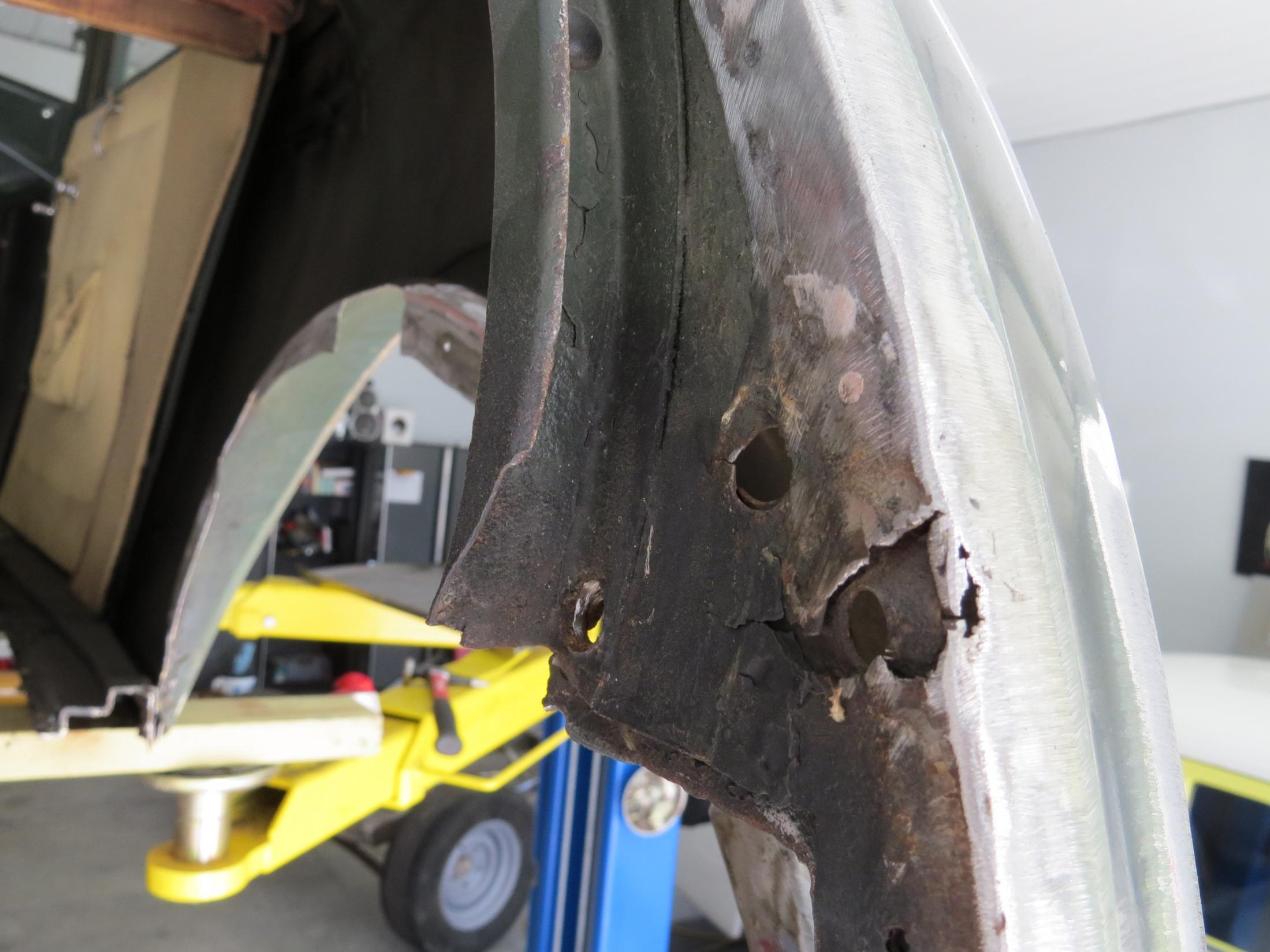

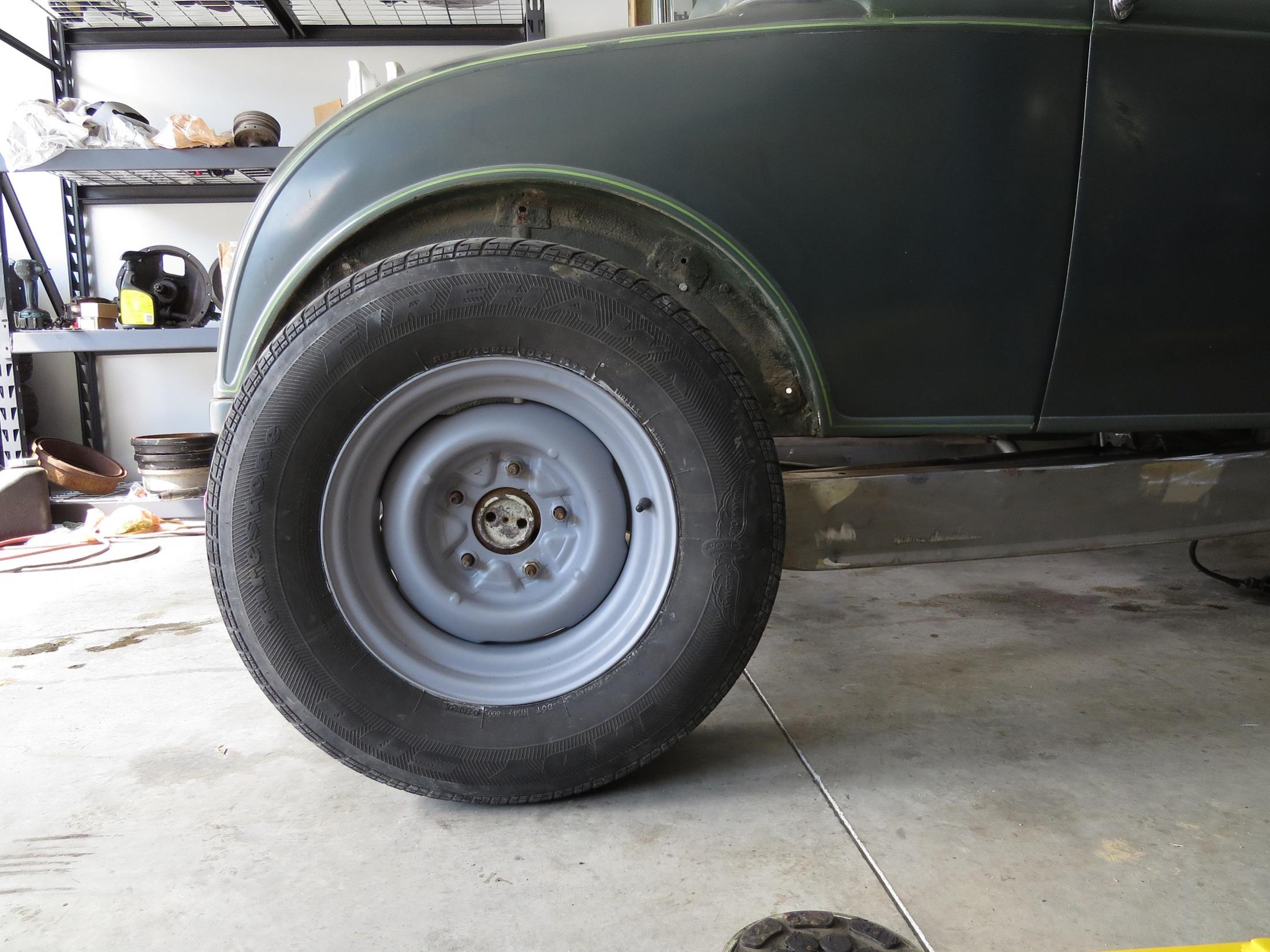

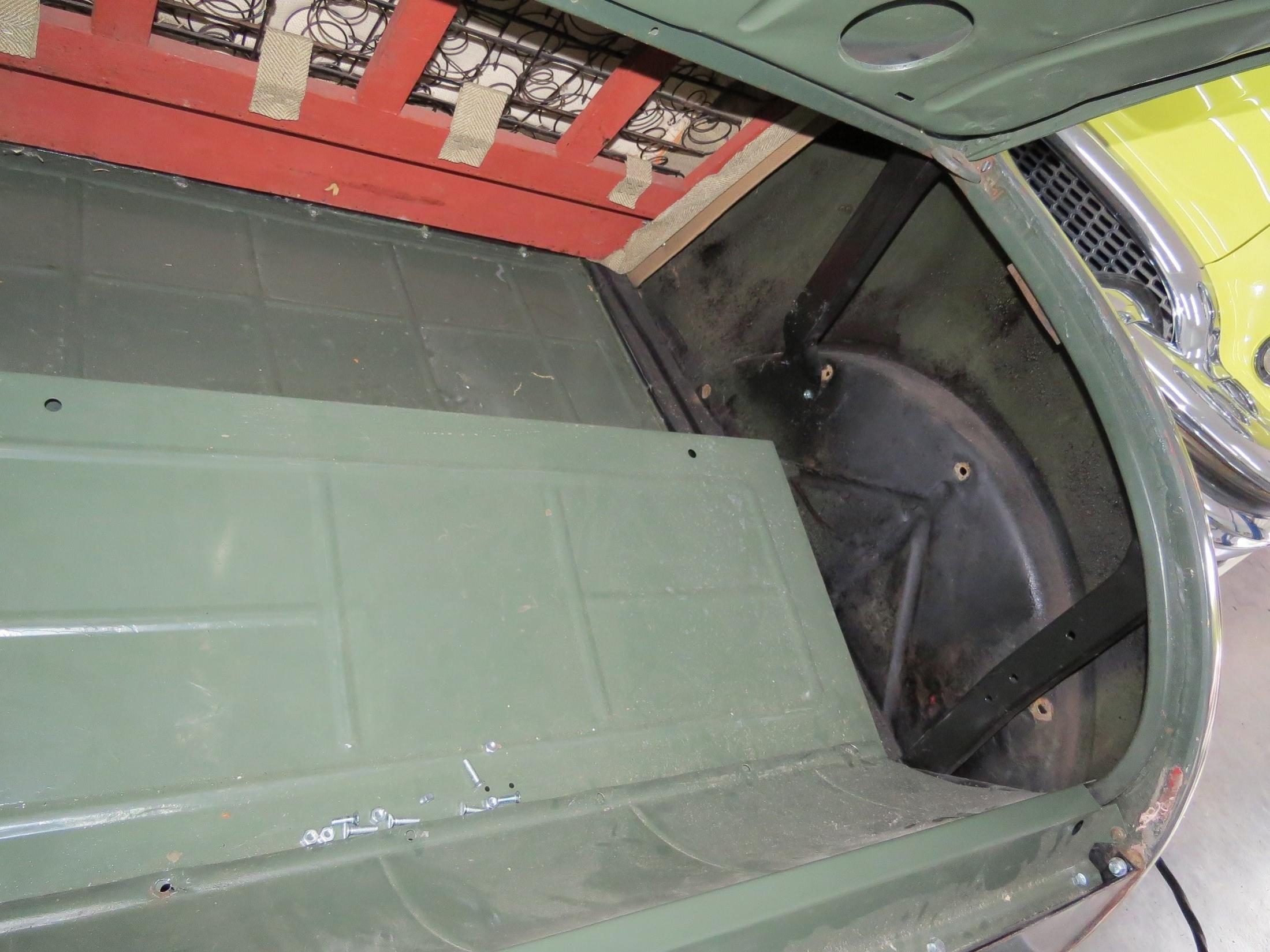

    Got sidetracked this weekend with life but managed to spend a couple of hours out on the coupe. I knew things would look worse before they would look better and so here the rear end is, lighter and with less rust.
    I have cut out the wheel wells including some odd reinforcing patches that had been brazed into place, hence the cutouts in the well area. I will fill these with some pieces. This is WAY beyond anything I have tackled in the past but I am feeling confident, for now...
    Having the lift is a M***IVE help. Being able to pop the body up in the air whenever I want to work on it is more than a little bit helpful.
    Hoping to start tacking in the first wheel well this coming week.

    Is it the angle of the camera? or does the rear end need to be moved forward or body back
  21. wex65
    Joined: Dec 19, 2012
    Posts: 1,144
    wex65
    from WV
    Body and frame not yet fixed to each other. The frame was simply rolled underneath for effect.

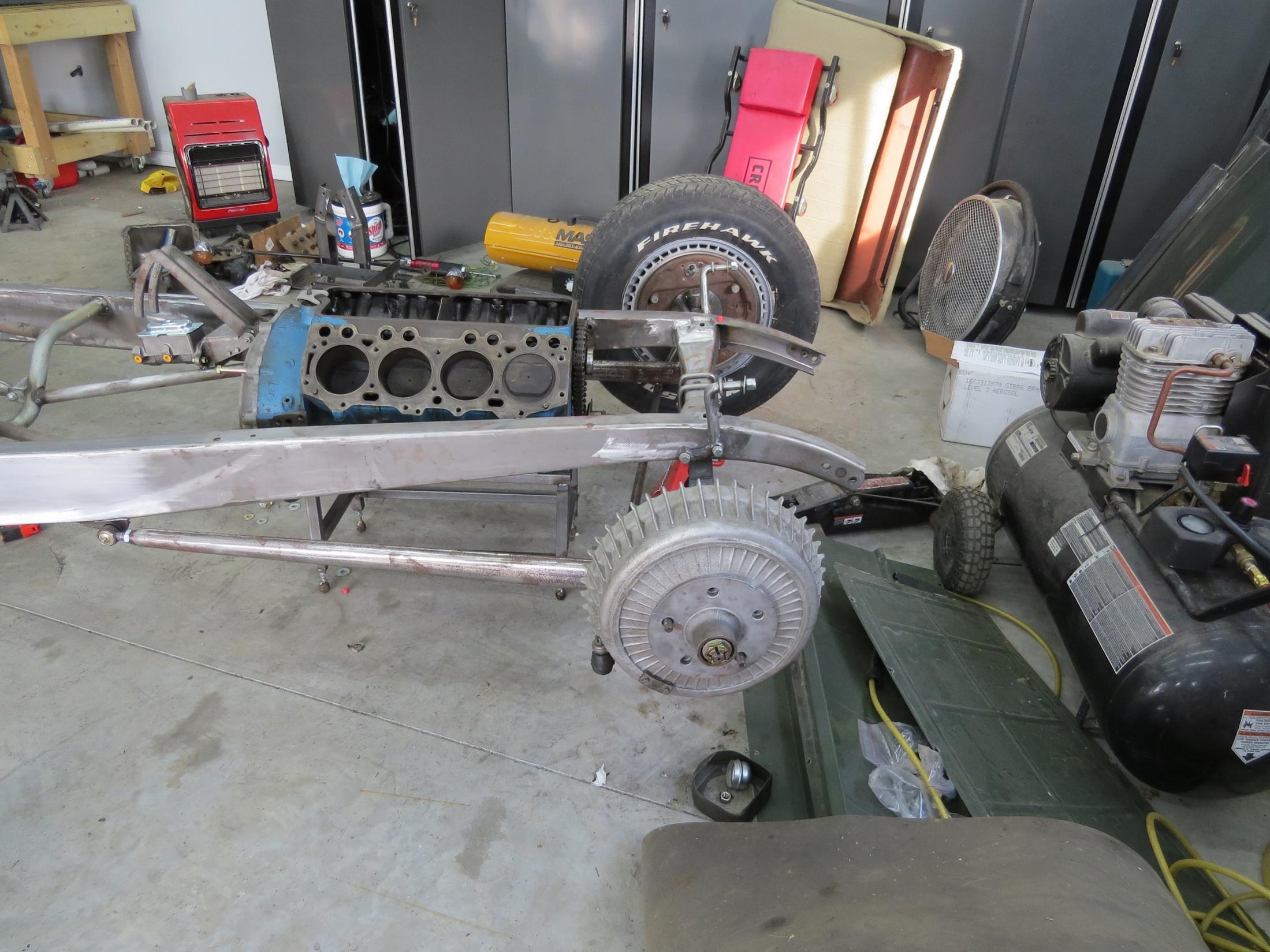

    Well, the build continues, albeit it at a glacial speed.
    I have all brakes in and had to get a replacement 46-48 backing plate as I realized one of mine was a rear with cutout for the parking brake. An ad on HAMB and a few bucks later I had a second pair en route.
    On the rears I obtained all new brakes and drums from a Bronco restoration place (rear is from en early Bronco) and on the front I got all new parts from a couple of places (Macs and C&FG Ford).The Buick drums were resurfaced for good measure.
    Sad confession, I put one of the inside oil seals/caps on BEFORE placing the inner bearing inside and then wondered why the hub wouldn't go into place... New one is on the way and explains the one wheel still off at the front.

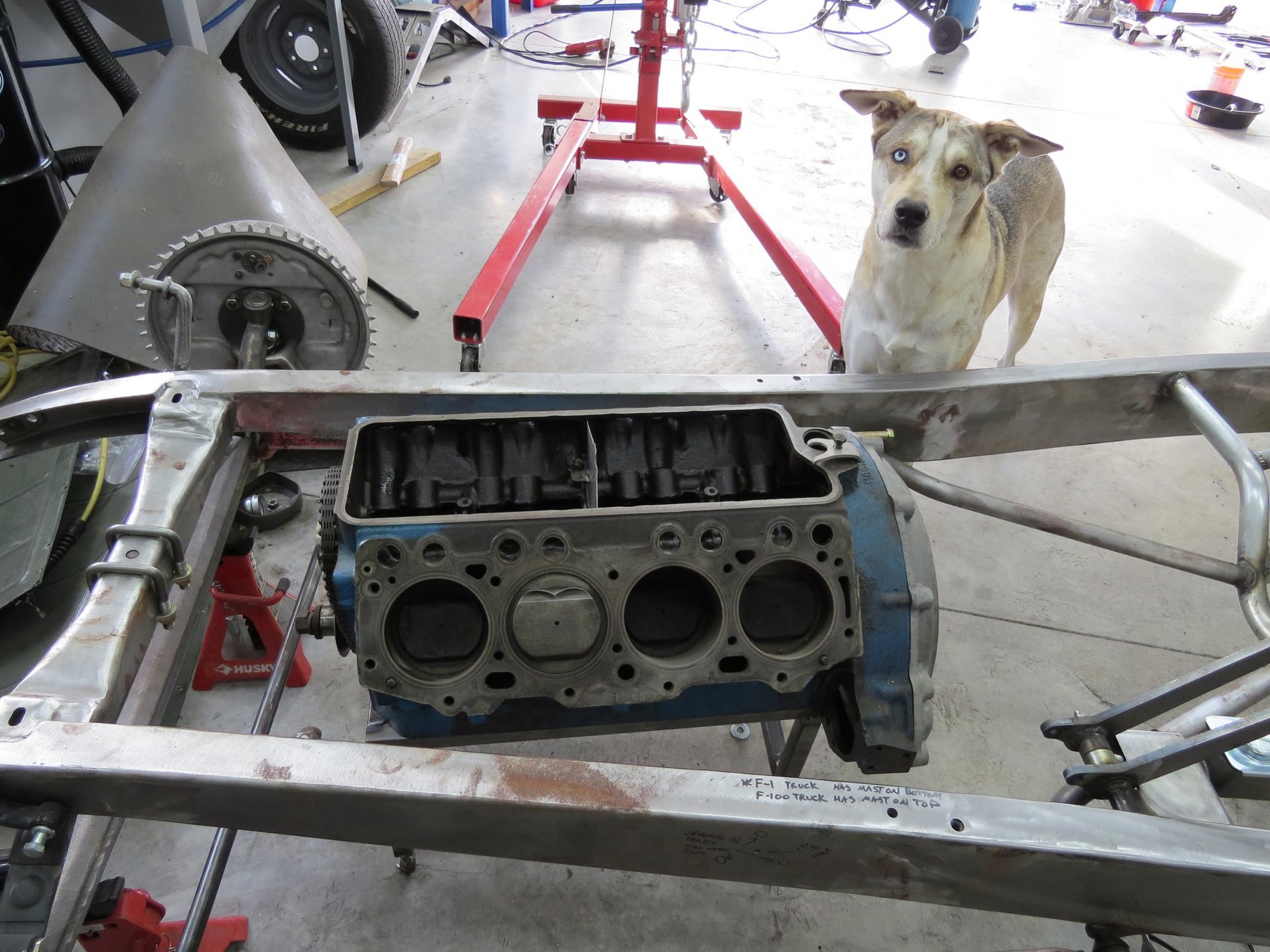

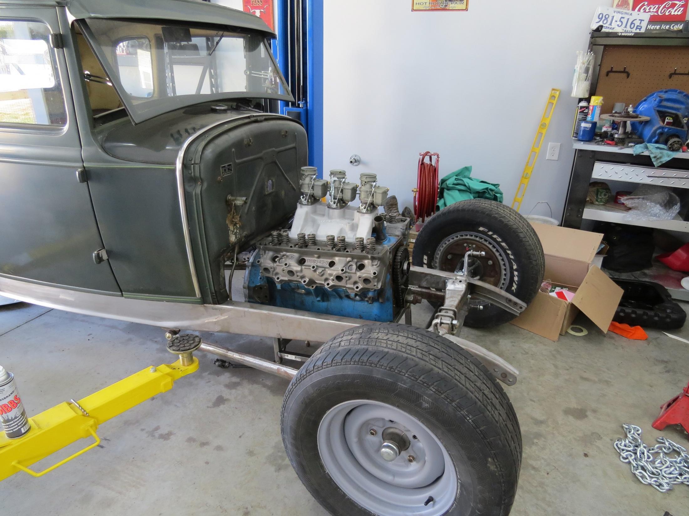

    I fabricated a little dolly for the engine complete with adjustable studs at each corner so I can adjust it to get it perfectly positioned. Lifted it between the rails to see how much (or little) room I had.
    And...well, thats about it.
    I will be ordering some flat plate to start making up some motor mounts. The engine needs to slide forward a touch but I will wait till I get the other wheel bearing/wheel back on and the frame is mobile.
    Then, mount the motor and gearbox. I will mate a gearbox I have to the engine this week so it is ready to go.
    Need to go read about motor placement/angle next to ensure I get the relationship between motor/gearbox and axle correct.
    Oh, and the dog tried to help...

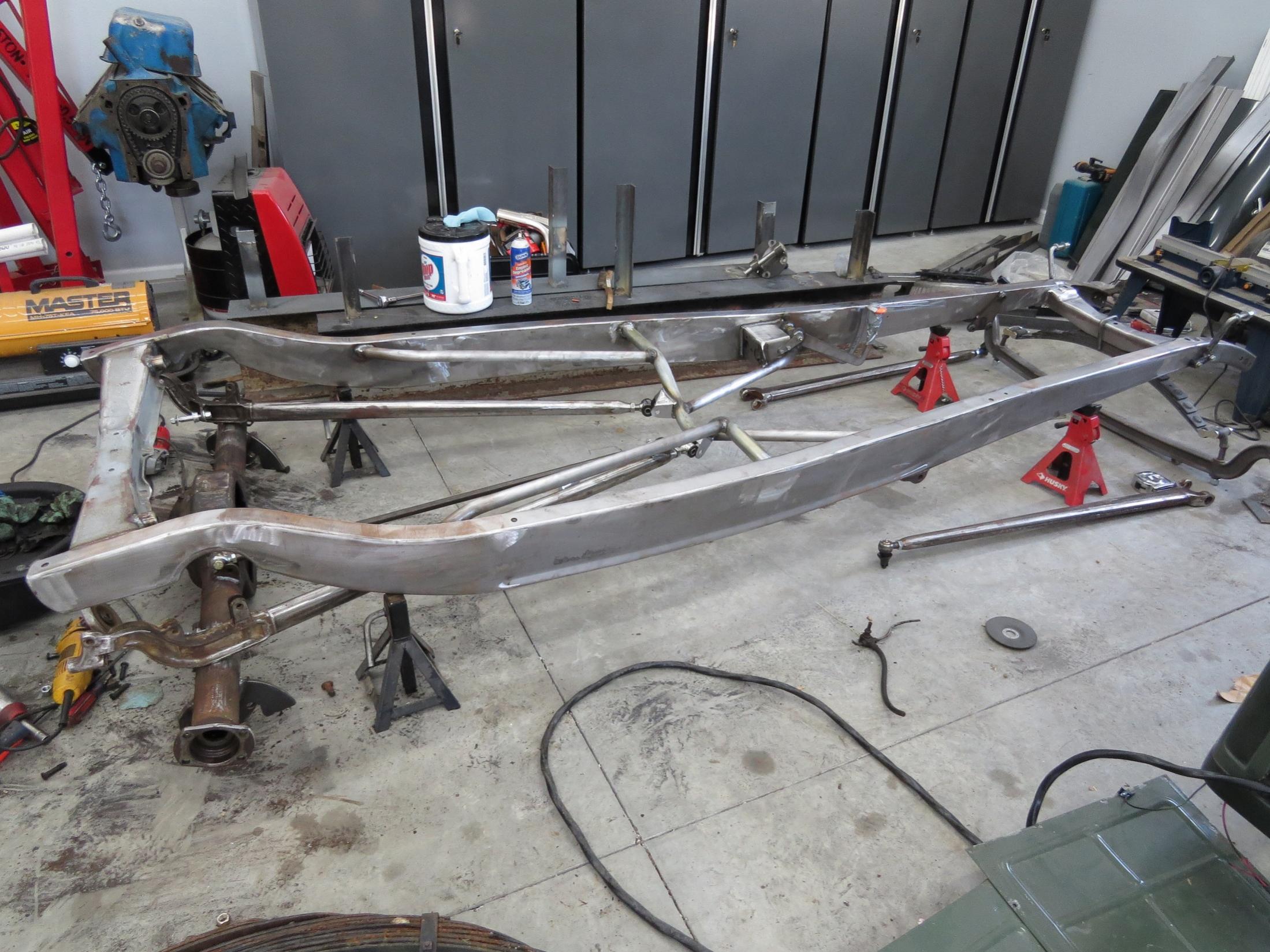

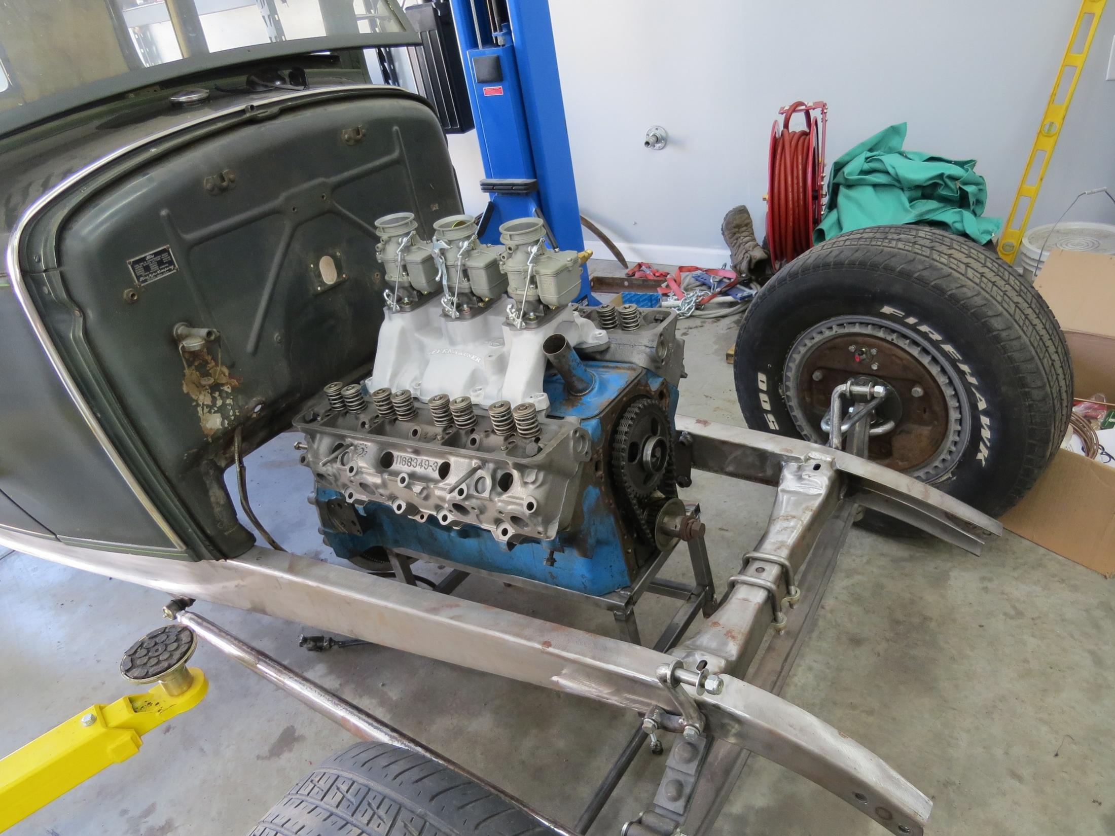

    Quick update for little more reason that to include photos in the build thread.
    Will be adding engine peripherals to get a better idea as to correct positioning and how much further the needs to go to the rear and higher.
    Will also FINALLY have to bite the bullet and get the wheels/tires so I can mock this all up at correct ride height.
    Nice to see the engine roughly where it will go though...

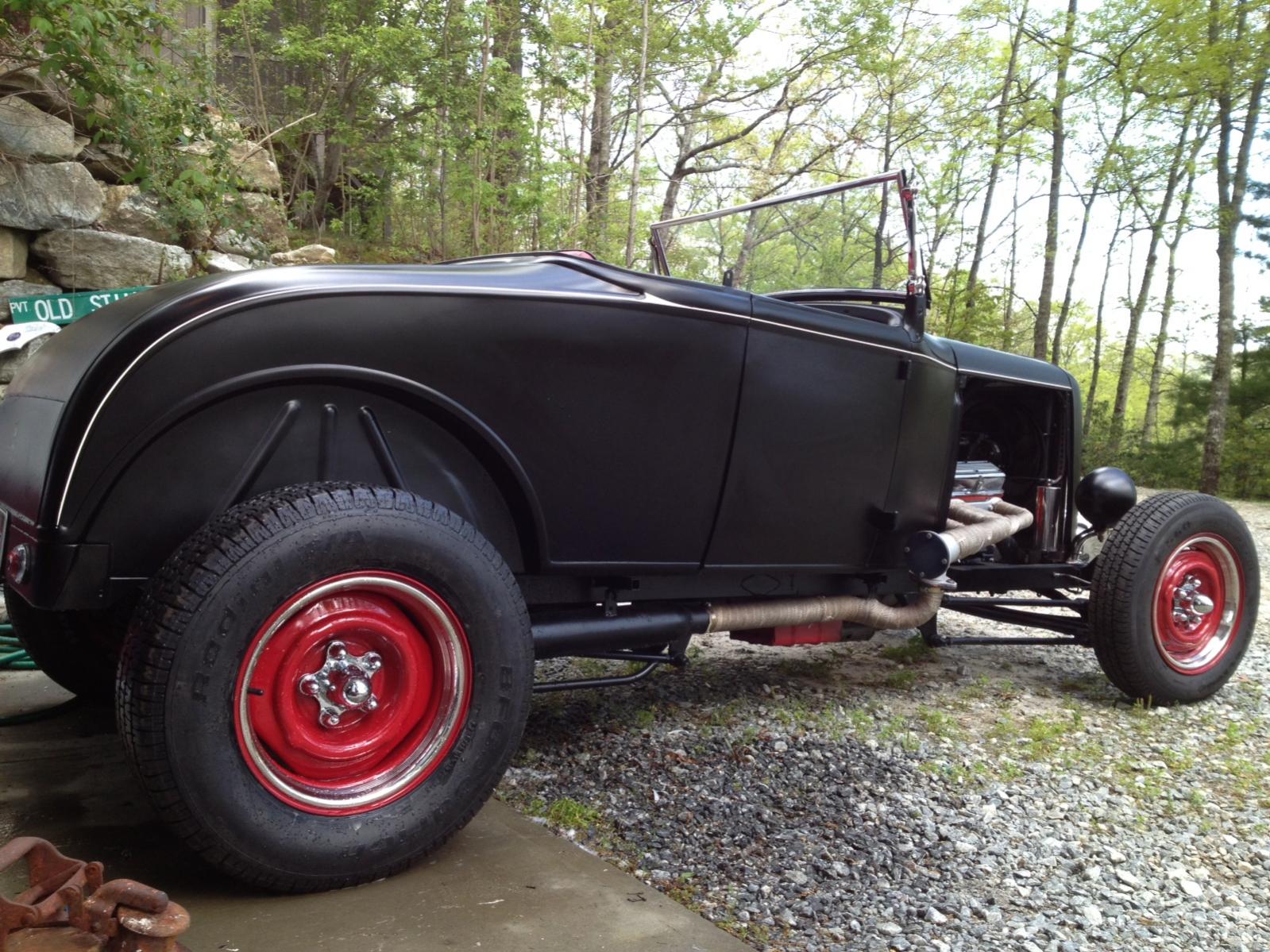

    OK, a long overdue update and one that I think will surprise a few...
    2013 resulted in little work being done to the car and the work that was done was contracted out to a local welder to get the steadfast mfg kit in place....
    I run two businesses and down time is sometimes very sp****, this is having a major impact on my progress, or lack of it.
    Here we are in March 2014, the steadfast kit is still sitting on a shelf, the car is still pretty much as you see it in the last photos above and my frustration at the lack of progress has caused me to relook at the project and consider how to get to the end goal some time before 20 years!
    So, I took the plunge, found a 1930 steel coupe already sitting on a 32 frame, with a 37 flathead, 47 transmission and a 57 rear end. pictures attached. There are things about it I don't like and that is fine. Switching out the brakes, radiator, steering, headlights etc are all manageable tasks that I can accomplish with the time I have. I can clean up the engine significantly too. I can then, next winter, trailer it to someone to get the roof taken down a few inches.
    So, I will likely switch my front hubs/Buick finned drums onto this car. Switch out the radiator for a 32, change the wheels as the car has zero stance and a few more things.
    I know this seems like surrender but again I am trying to be a realist in terms of what I can get done. I would rather be making SOME progress than staring at a body for the next 5 years.
    I will then end up with my original body/frame/nailhead/intake setup and as the weather warms up decide what to do with them... I am sure they will find a good home.
