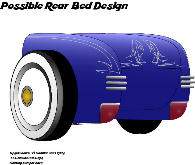

    and here's a stupid bed design. I am not 100% on this. Merely an Idea

    Thats definitely a possiblity. I have yet to even get a visor. haha

    cool idea! I think it will be more obviously a removable hard top car in roadster form, but it should be pretty well hidden with the top on. The bed idea seems like it would put the lights aweful low for most idiots on the road to pay attention to...just something to think about.

    Don't know 'bout the bed design, but it would make a really neat trailer.
