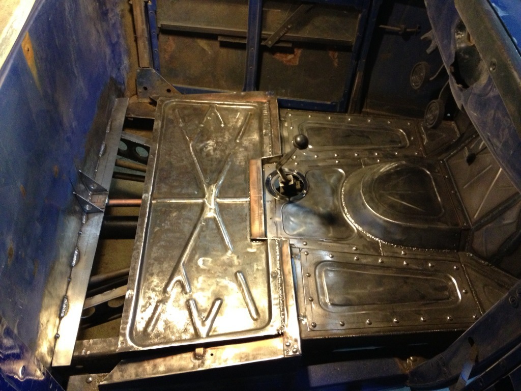

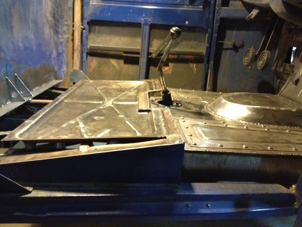

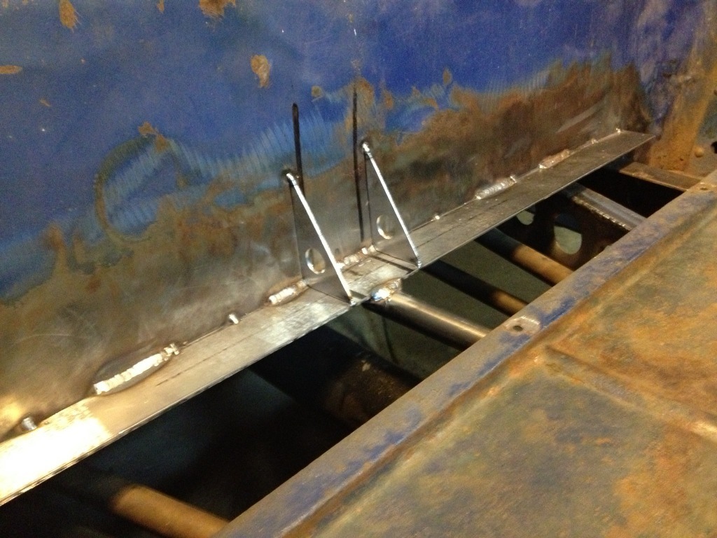

    Small update. I'm back at work after a long break so progress will be a bit slower.
    I decided to use the original handbrake lever which has a broken pawl spring, so I ordered a replacement along with patch panels for the cowl.
    I mostly finished the trans cover and started working on the floor where the seats will live. I'm trying to use the original seat pan since it looks better than anything I could make.

    Hey everybody, quick update. I welded in most of the remaining floor structure under the seat area and also cleaned up the original floor panel and welded it in place. Still some work to do but it's coming along.
    Here's the truck as it sits today. The window is rolled down 4-1/2" from the top of the door. I think I like this for a chop, but I'm holding off until I get the bed set on.
    That's all for now. Next big project will be the fuel tank; it's going to sit under the bed, ahead of the kick up. Thinking 16ga steel sheet.

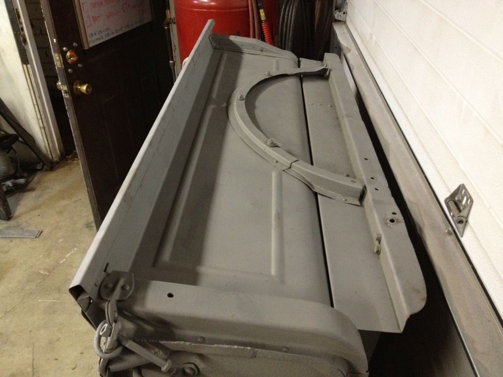

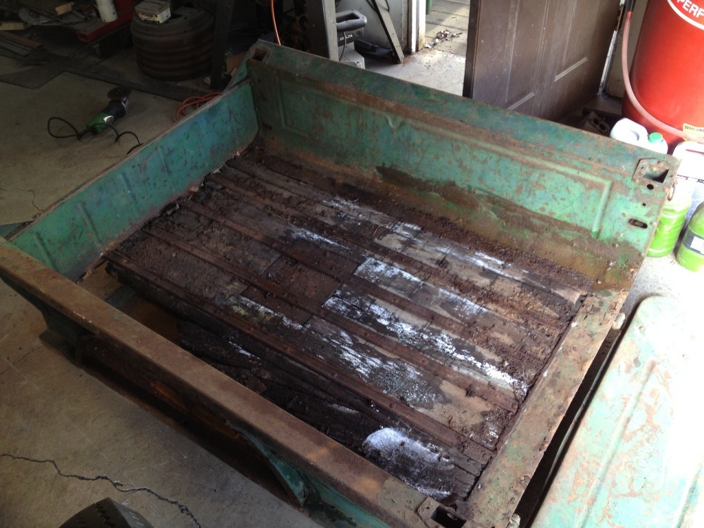

    Small update. I started looking seriously at my pickup bed; it's been wrapped up since last fall. It had a big piece of diamond plate tacked in (only tacked, thank goodness). It actually protected the bed more than anything.
    Once I removed it you can see what looks like original wood, along with rust in the usual places.
    I'm planning to take inches out to get it more in proportion with the rest of the truck, but it needs to be cleaned up first. I dropped it off at the blaster's this morning.

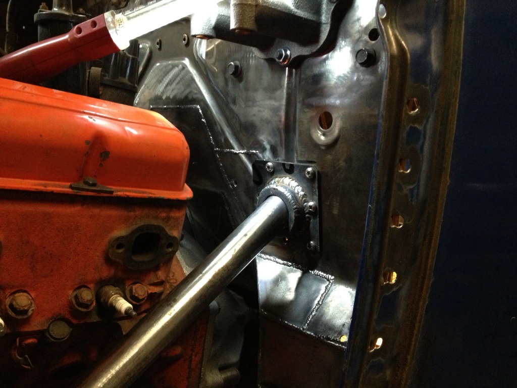

    I also made this adapter to go from my original column drop to the 1.5" column I'm using.
    And I started on this firewall p*** through.

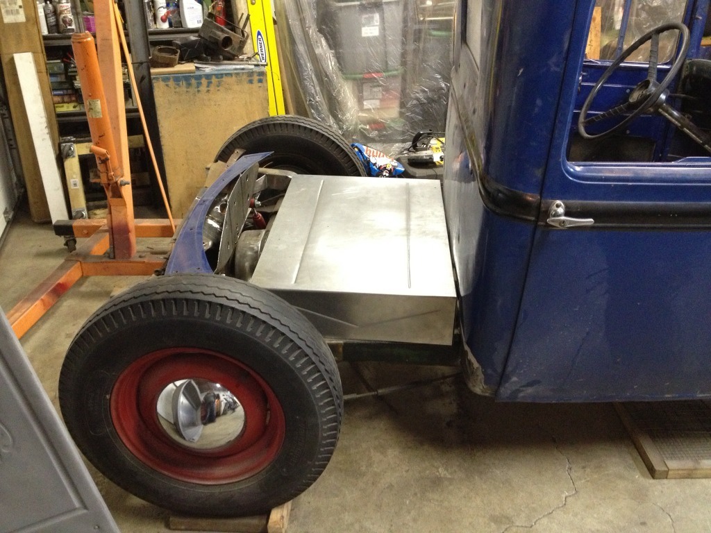

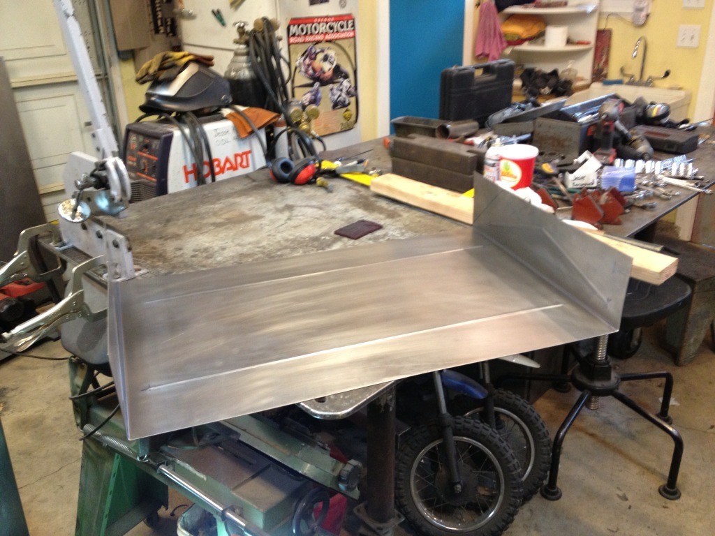

    Ok so I got some work done on the fuel tank, it turned out like I pictured it so I thought I'd post a short update on how it's put together.
    I'm using 16ga cold finished steel. I wanted to minimize the amount of welding, so there's just a top and bottom; only two pieces! Plus baffles.

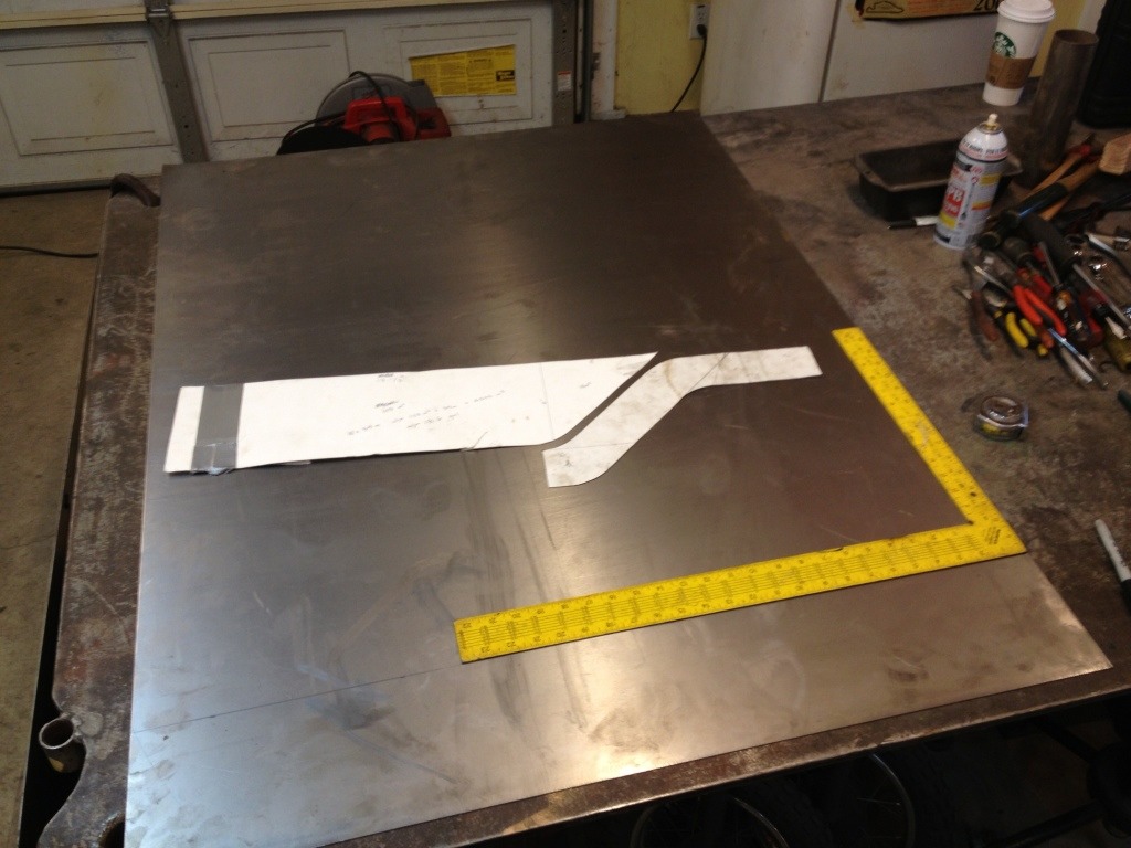

    First of all I went to my friend Jesse's house since he has a manly home-built press brake that will bend 3-foot widths.
    As I may have mentioned previously, I intend to put the tank under the bed, ahead of the 6" kick up. You can see my templates in this picture; the one on the right represents the height and profile of my frame, the left one is a side profile of my tank.

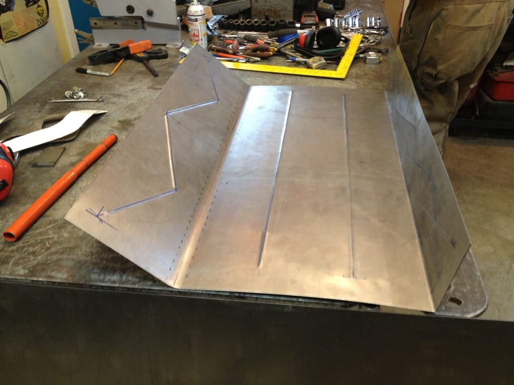

    We started on the bottom first. Rolled some basic beads and bent a 90-degree and a large radius 45-degree.

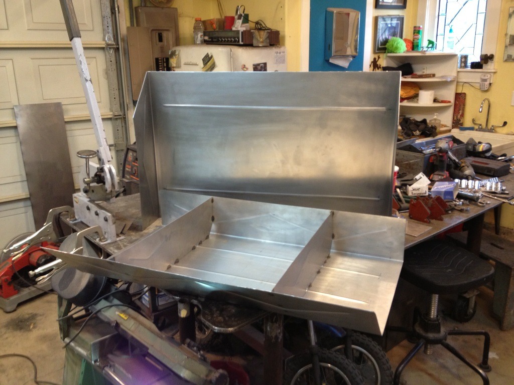

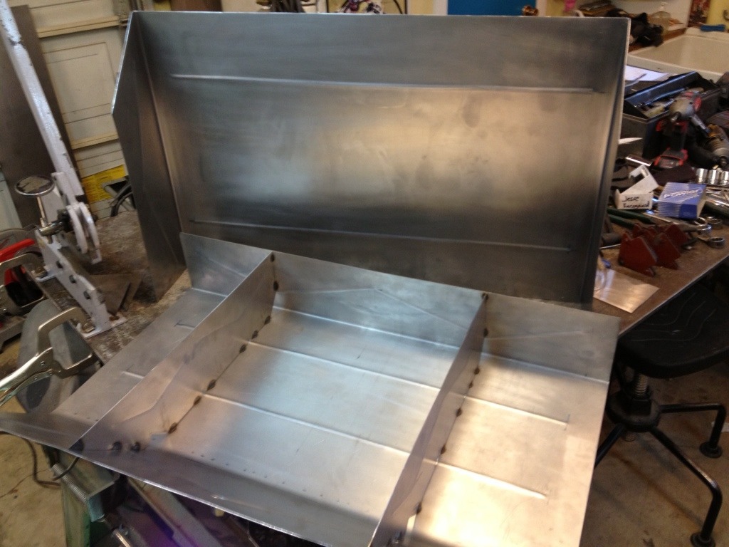

    Next we tacked in some baffles and left openings in the corners.
    The top and sides are one piece, did some triple measuring, more beads and two bends.
    And here's the pieces all mated together. I'm not welding them until I get my fuel sender and fill tube.

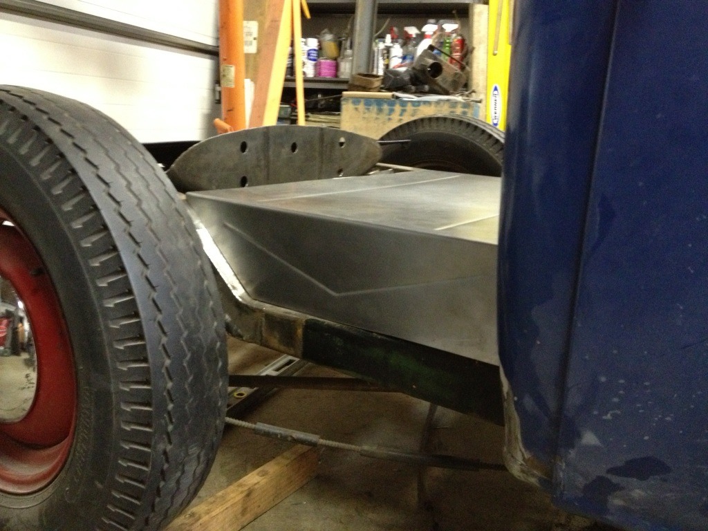

    I got home and checked the fit. I must have been a little careless because it BARELY fits, but it's ok. Also, it's friggin HUGE, around 18.5 gallons. Should be good for a long road trip.

    Ok so here's what the tank looks like on the frame. The bit of frame that sticks out will be combination bed mount/tank hold-down. Still need to make a little tunnel to give the driveline some space.
    And some shots of my bed, rapidly becoming rusty again in this humid NW weather...
    The bedsides are pretty nice, lots of repair work to do elsewhere. For now it's looking like I'll take 7" out of it instead of the usual 9". I'm thinking if I do that a 4' something could lie flat back there, seems like things come in 4' lengths, don't they?
