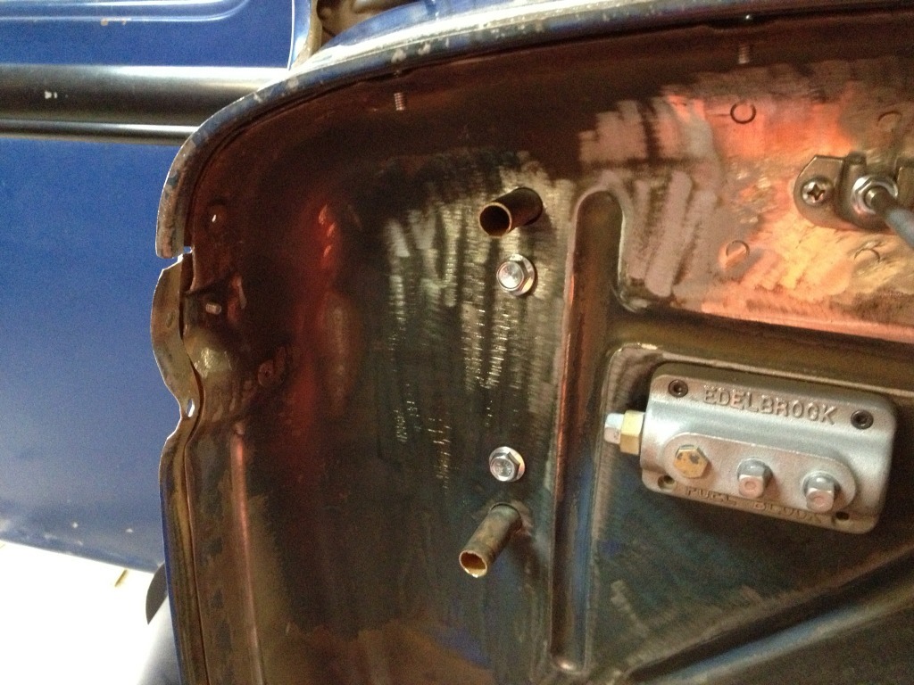

    Did some more work on my tank today, ran around all over town looking for parts, buying fasteners (wrong ones), then going back for more. First few pics are the pickup tube and fuel "bung" I came up with. Made out of junk lying around.
    This is just a 1-1/4" spacer with a 7/16" hole. I tapped 1/4" NPT, drilled a hole in the side and put in a piece of tubing.
    Welded it up, added a 90-degree bend and a hold-down tab.

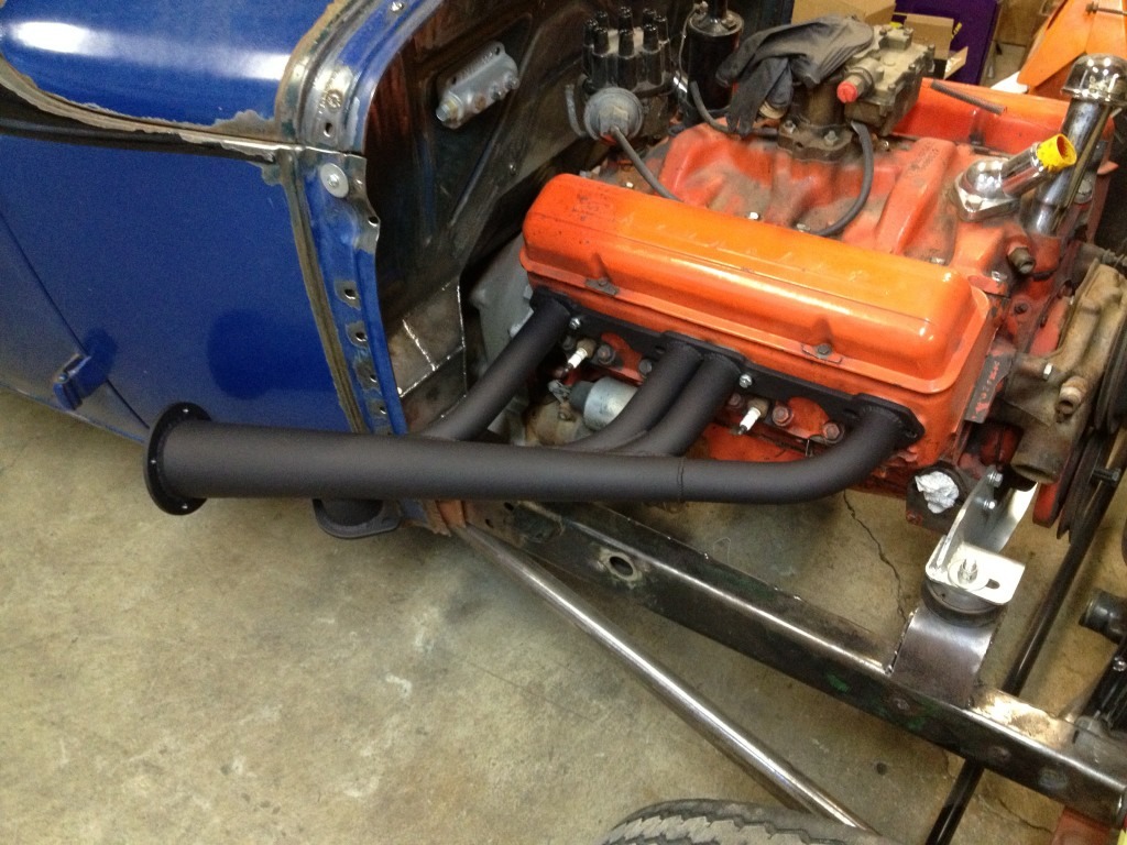

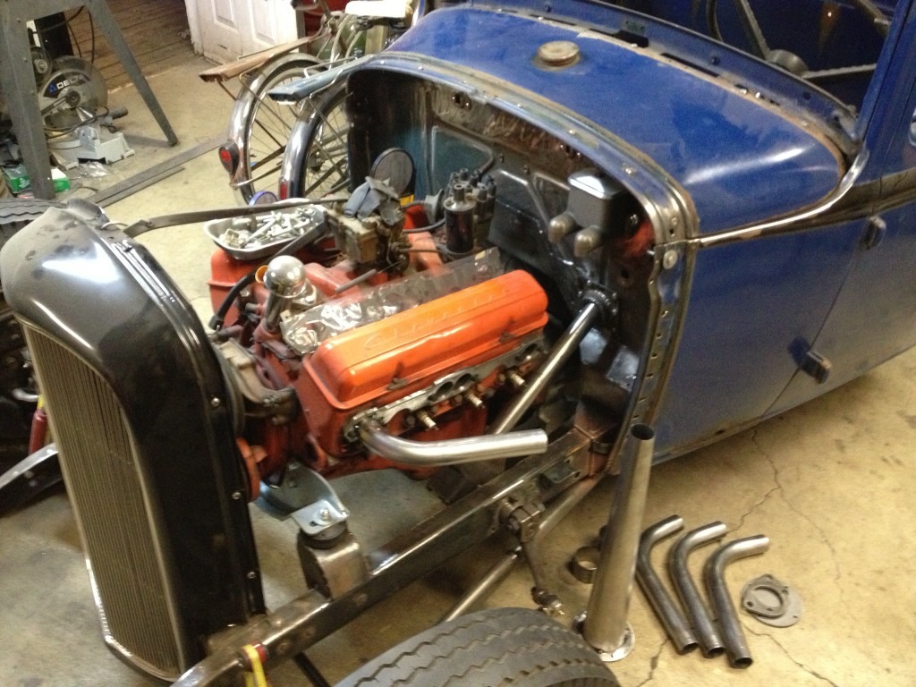

    Welded up my headers today. They came out ok, not too bad for a desk jockey with a mig welder :D
    Dumping the primaries straight into the cone is illegal, so there was lots of tube fitting. Lots of work but was fun.
    Aaron

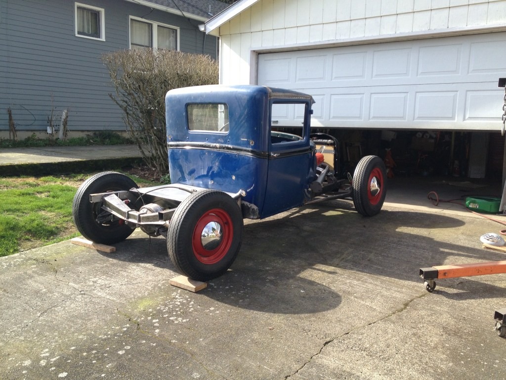

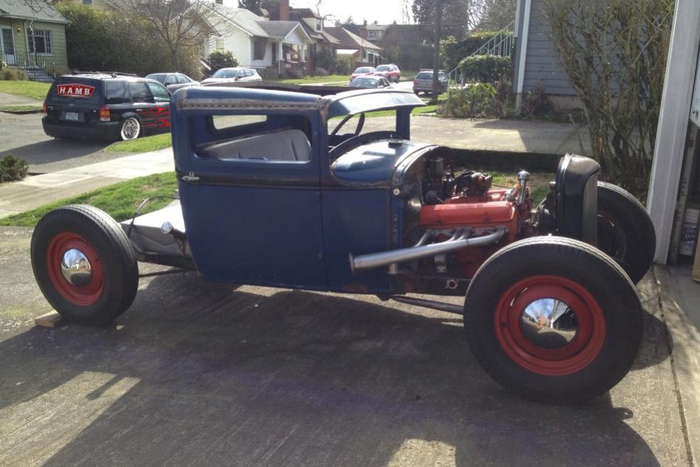

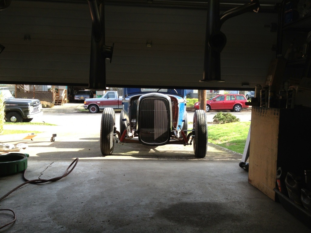

    Thanks guys. Small update; I was out of town part of the week so I'm trying to get back at it.
    Pulled it outside for the first time since last fall.
    I think the grille is about 3/4" too high :(

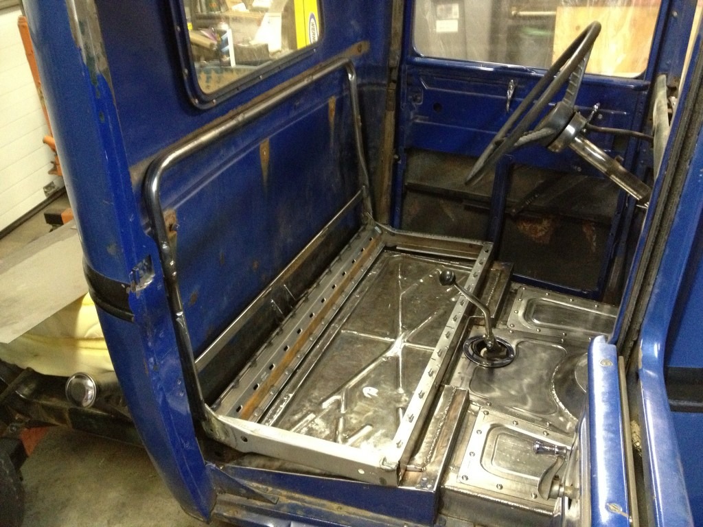

    I managed to get a little done on my seat frame tonight.
    Here's what I started with (from earlier post):
    It's a regular old minivan 2nd row seat frame. The width was ok, but I wanted it to follow the taper of the body and match the seat "riser", including my bump-out for the shifter and trans cover.
    I cut the front part off, pinched the sides and made a new front part that matched the profile.
    Also added flanged holes because, well, they're cool.

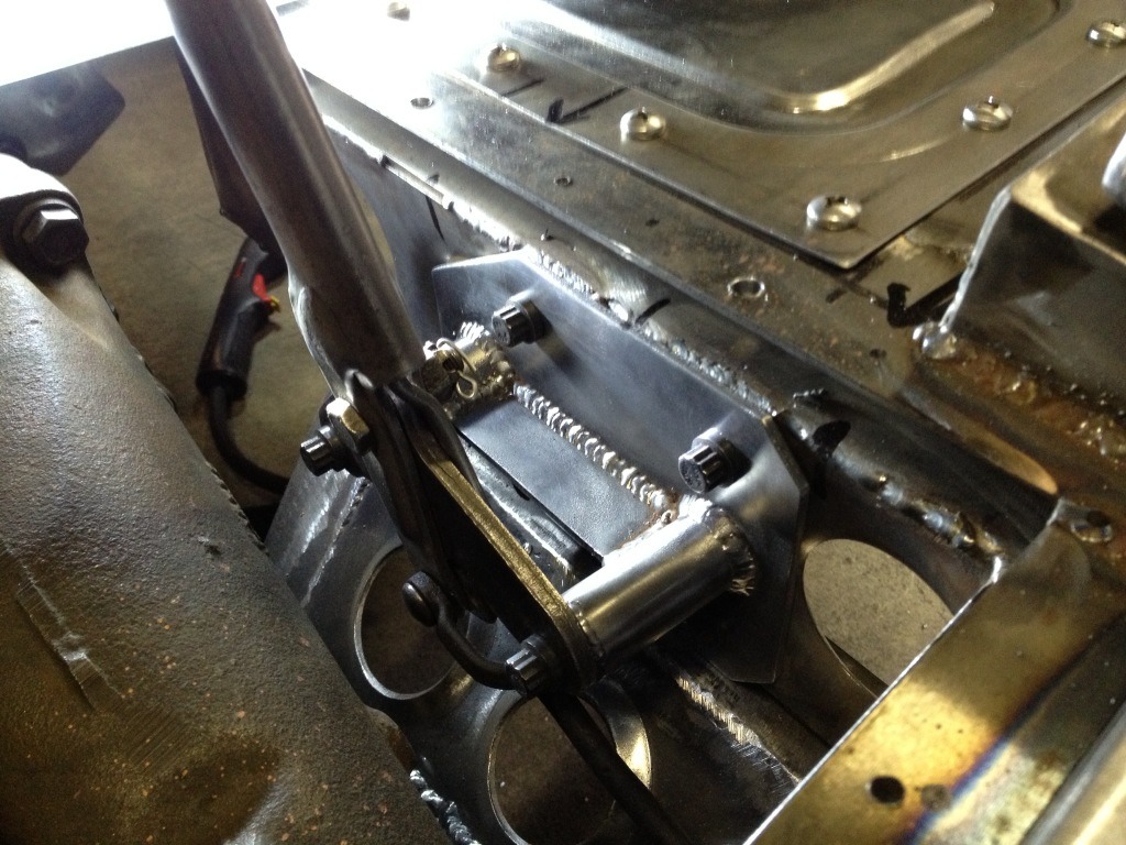

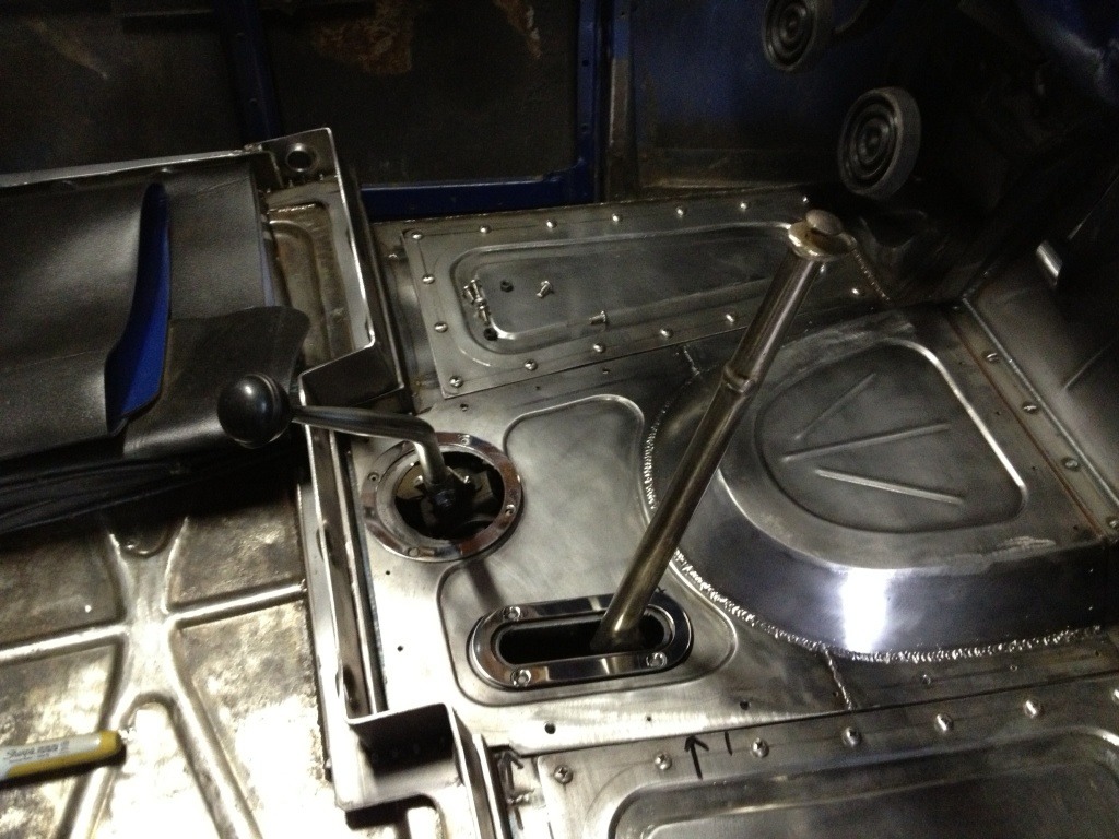

    Got some done this morning. Worked on the parking brake handle.
    I started with my original ***embly; I took it apart, cleaned it and replaced the detent spring. Next I made a mount that bolts to the frame.
    Bolted up.
    And put the cover back on, made a hole for the boot.
    Off to the hardware store, going to make some strut rods...

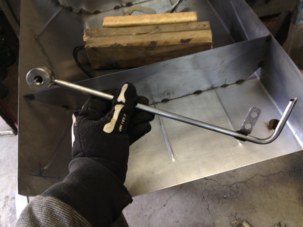

    More updates.
    Got my strut rods and bracket made.
    Mounted my heater as well

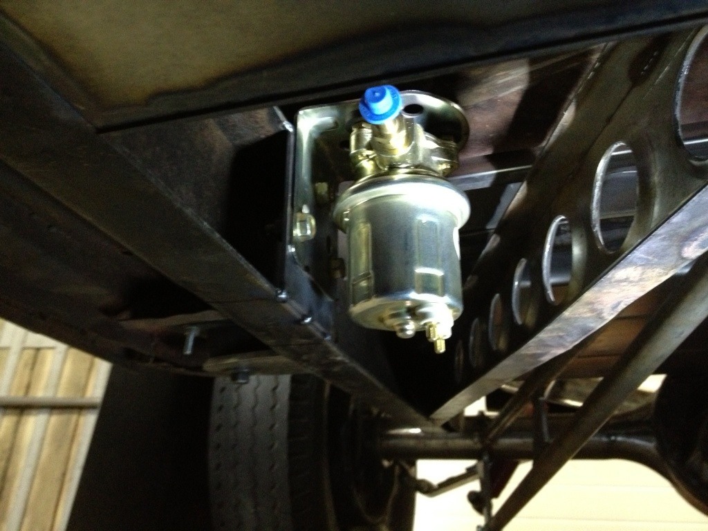

    Grudge
    Targeting May 11th, which I believe is the Portland Transmission show. Trying to get something done basically every day until then. Made a list:
    Fuel pump.
    Josh, will you still be here in April?
    Aaron
    volvobrynk likes this.

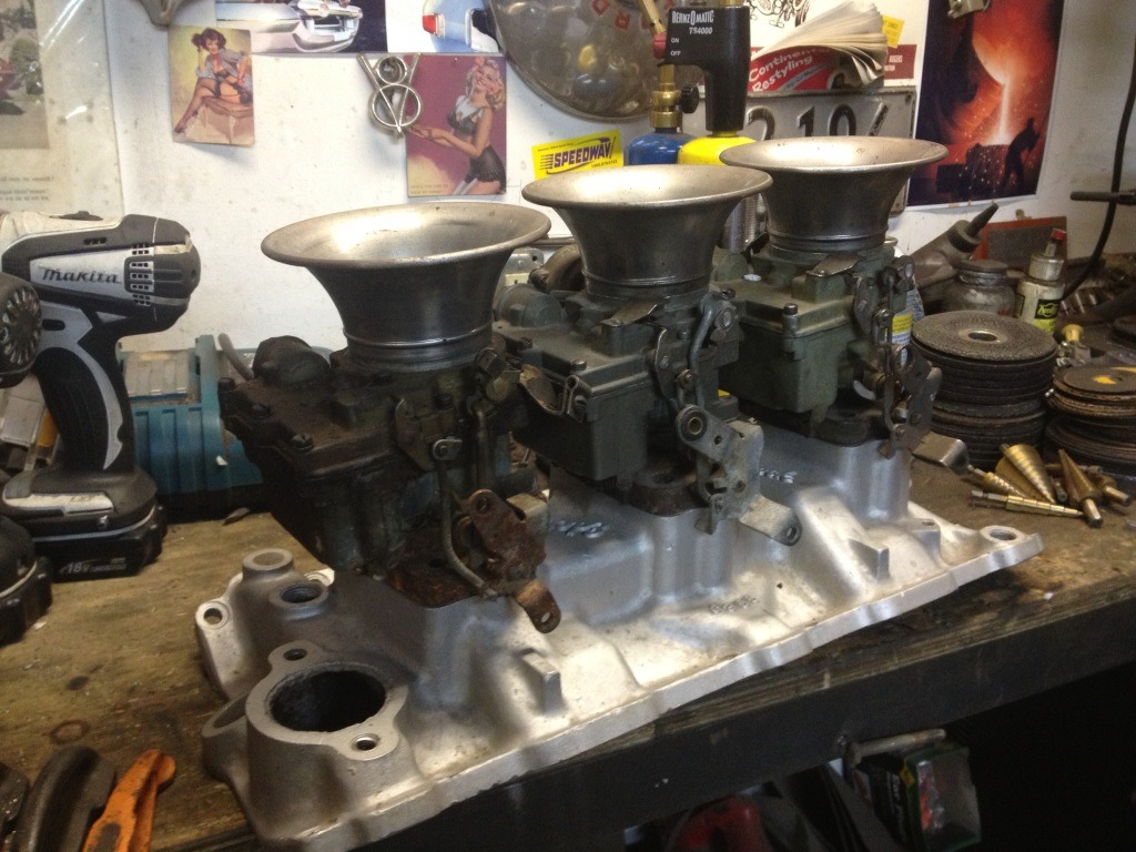

    New toy. I hope I can make it work. It came with three un-stuck and one stuck 2GC's (for parts). I've also got the original 2GC on my 265.
    It also came with new extended throttle shafts and progressive linkage. The intake is a little rougher than I thought in the coolant-port area, hopefully won't leak. Its too soon to tell if I have remorse.
    This will be my first attempt to convert "non tri-power" carbs. I've read there are thick throttle plates, modified base plates, etc. but I will try to make it work without any of those kits.

    Small update. I think I'm finished with my seat frame. I made some brackets for the back that bolt to the body, and follow the profile. The cushion will be formed so that it fits inside the frame and conforms to the shape of the body.
    Ignore the ugly cushion, it's temporary.
