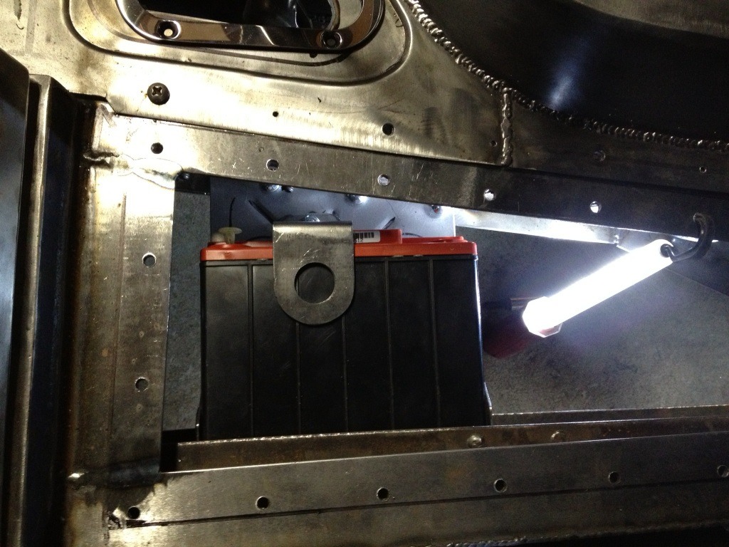

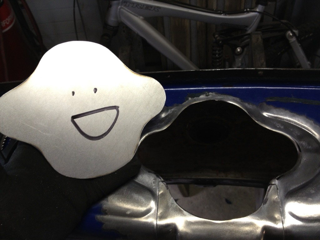

    One of the goals I set for myself on this build was to keep the bed free of a battery and/or fuel tank. As you know, a channeled pickup doesn't leave much space anywhere else. One option was under the dash, but I chose under the cab.
    I built my "x-member" with this in mind; I wanted one side to hide a battery.

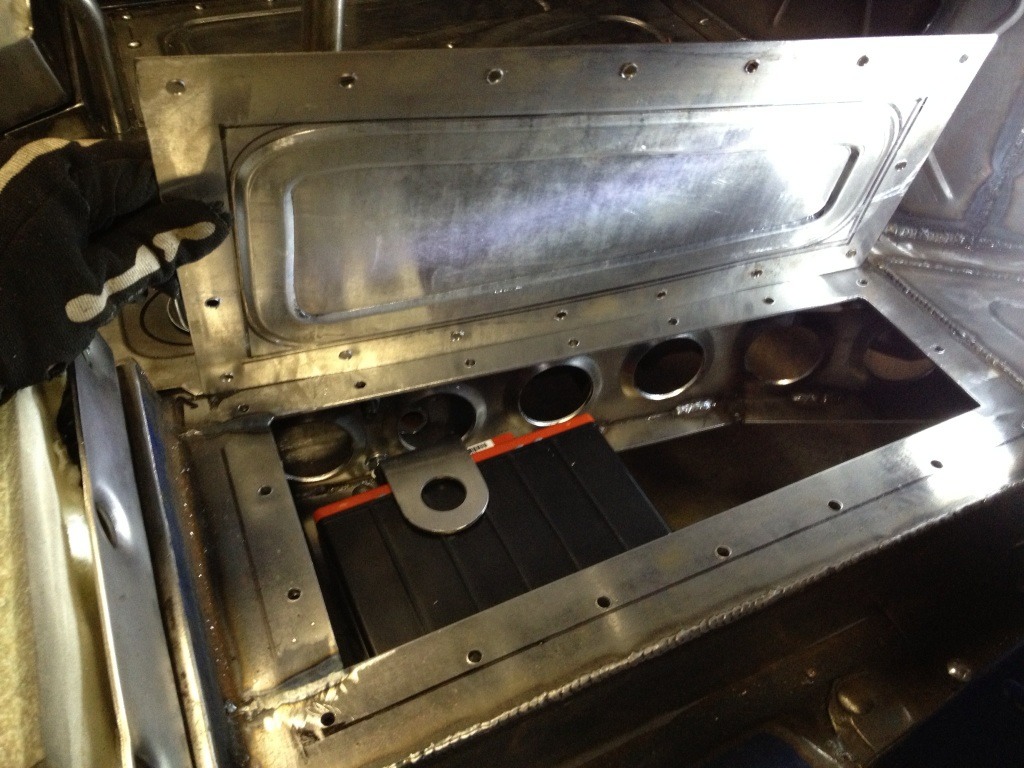

    The panels on my floor are removable so you can service the battery (I guess I mean replace it) without crawling under.
    Here's the battery I'm using.
    Internet lore says it will work, as does the 5-second amperage rating. You can mount it on its side, which I have to do so it doesn't stick down below the frame.
    Here's what I came up with. I like making unnecessarily complicated brackets :D

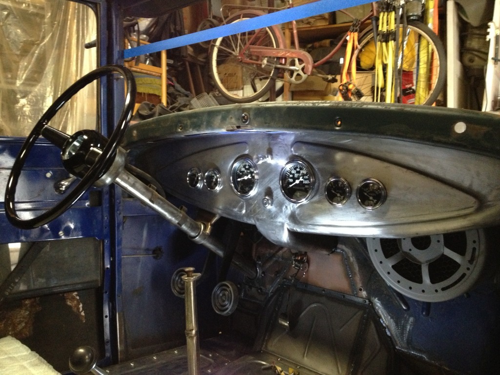

    Tomorrow I modify my dash "Casny style" for my gauges.

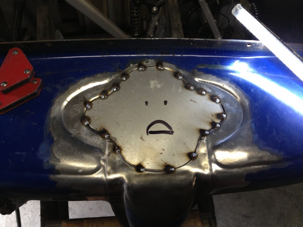

    Going to hold off on making holes, not sure what layout I want yet.

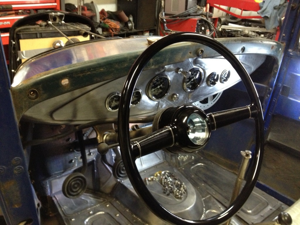

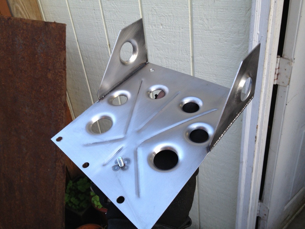

    Mounted my gauges, I think it looks pretty good.
    Still knee deep in carburetor parts plus I'm trying to get my 49 back on the road so won't be much progress this weekend.

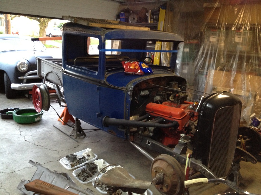

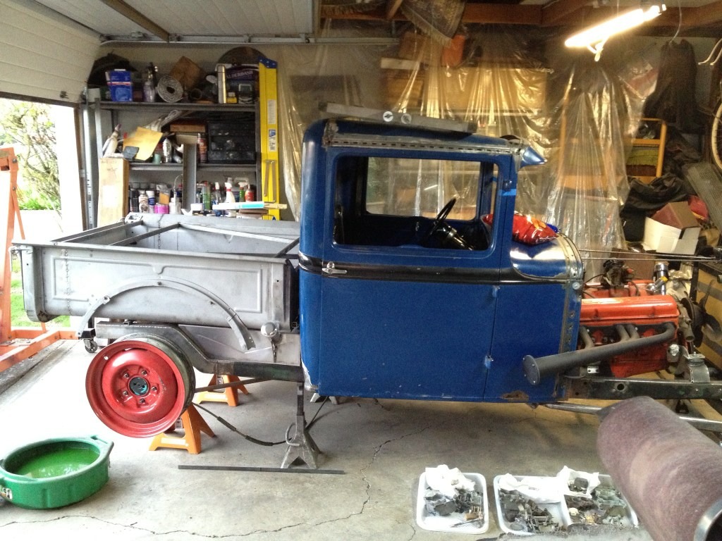

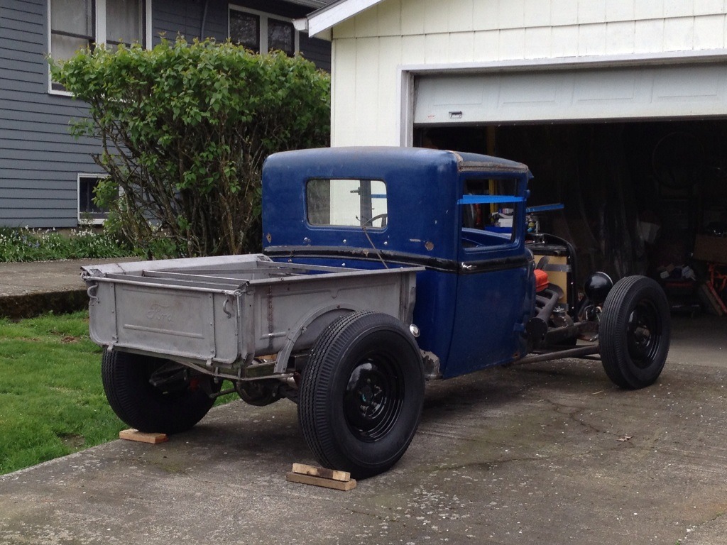

    Small update, it's not going well. I got sick (still am), traveled for work, excuses, excuses.
    I started on my pickup bed, took most of it apart and took out 7".
    Started rebuilding the rear cross-support stamping.
    I don't have all the detail pictures but it's all tacked together. I set it on my frame and I think it's sitting too high. Would like your feedback on that, I'm operating in a vacuum.
    Bought some Firestones today and got my wheels back from the powder coater, pics later.
    Aaron
    volvobrynk likes this.
  25. It's tough to say if the bed is too high until you put all the wheels/tires on and set it on the ground. Then sit on a chair 20 ft away and have a look. :)
  26. Grudge
    Joined: Jun 26, 2008
    Posts: 436
    Grudge
    I like it, I think the 7.50 x 16" tires sort of balance it out. What do you guys think?
    Aaron
  27. tdylan28
    Joined: Feb 18, 2012
    Posts: 11
    tdylan28
    I think it looks great with the bed at that height. The top of the bed follows the belt line nicely.
    Sent from my DROID device using the TJJ mobile app
  28. I think it's right on the money at that height Aaron.
    Sharp truck!
  29. Grudge
    Posts: 436
    Grudge
    Thanks guys, yeah I think it looks pretty good. The next question is how much chop. It'll be somewhere between 4" and 5".
