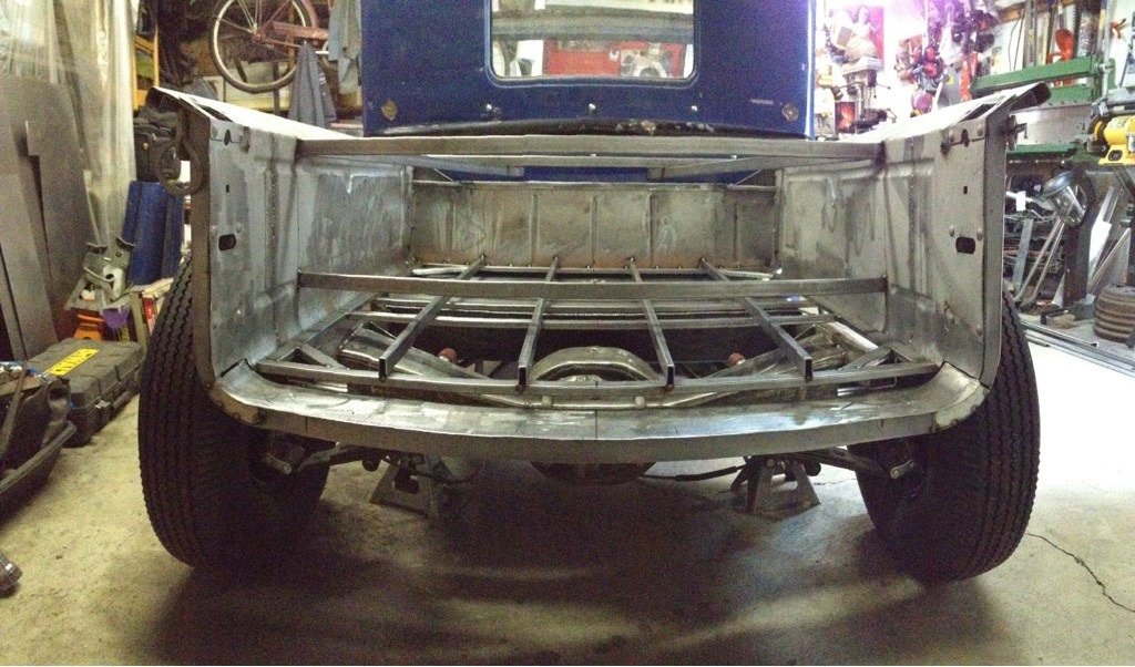

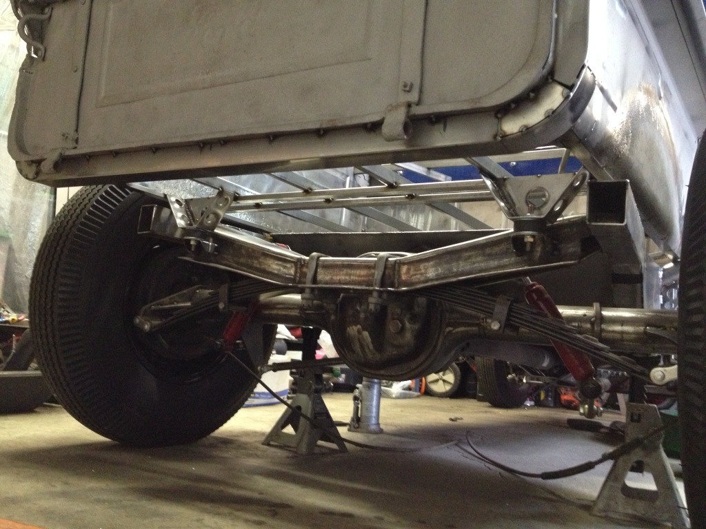

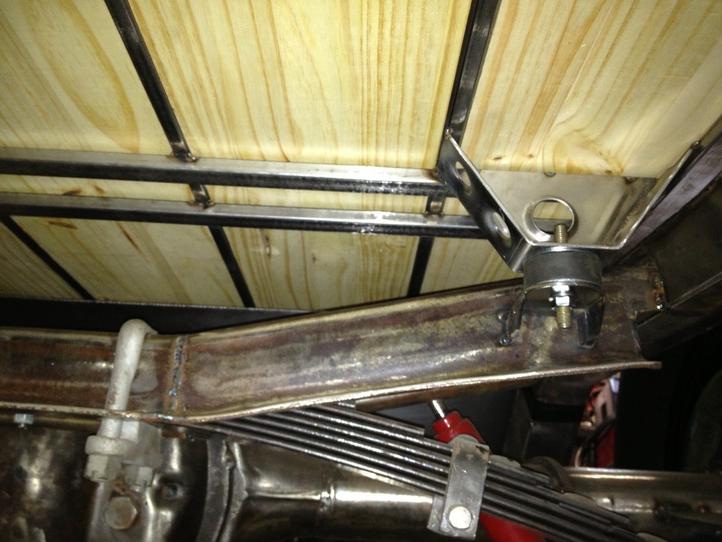

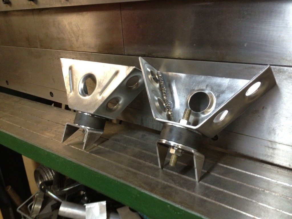

    Finished my bed mounts. Took forever just to square everything up. Seems like the whole thing is off by 1/4" everywhere :D
    Started on the structure
    Mounts
    The bed looks ok, I definitely will need a panel below the bed to cover the tank, mounts and to lower the body line behind the tire.

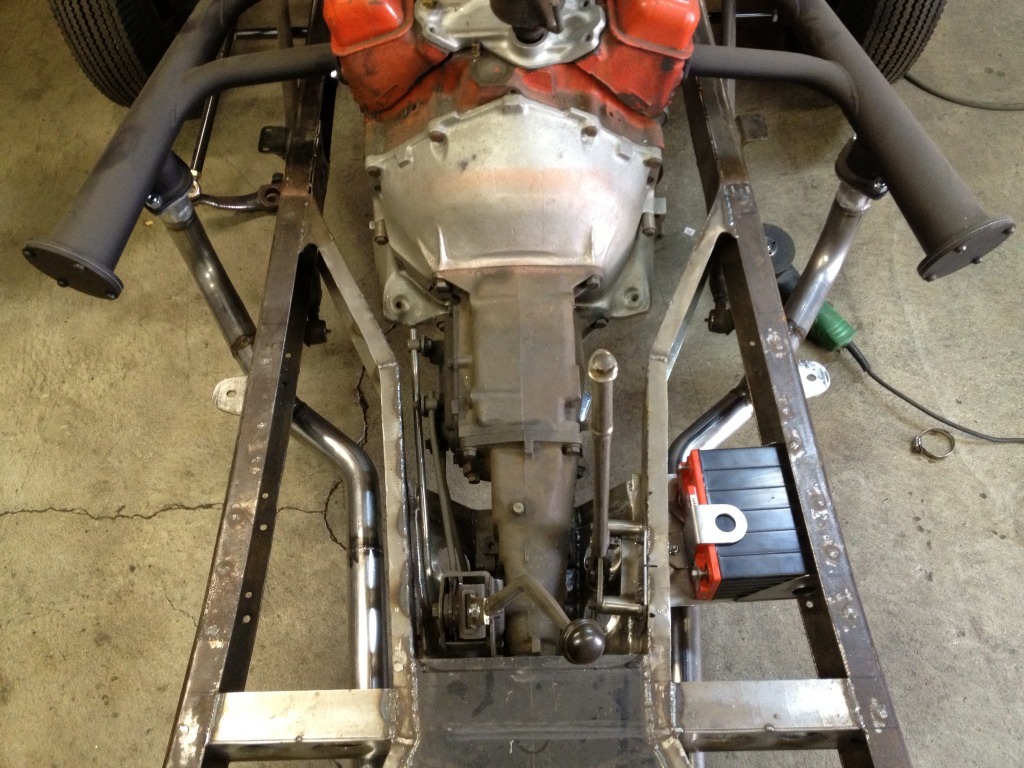

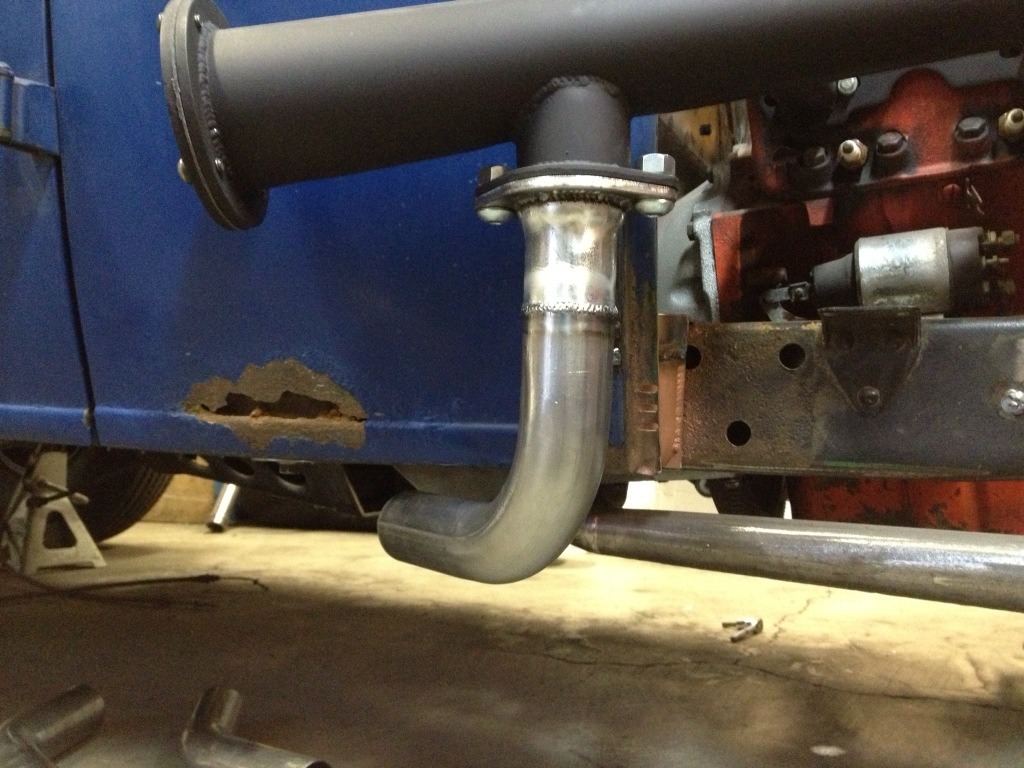

    Family stuff today but did manage to start on my exhaust. Got both sides done like this.

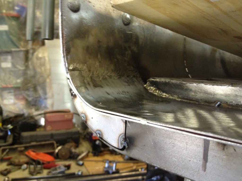

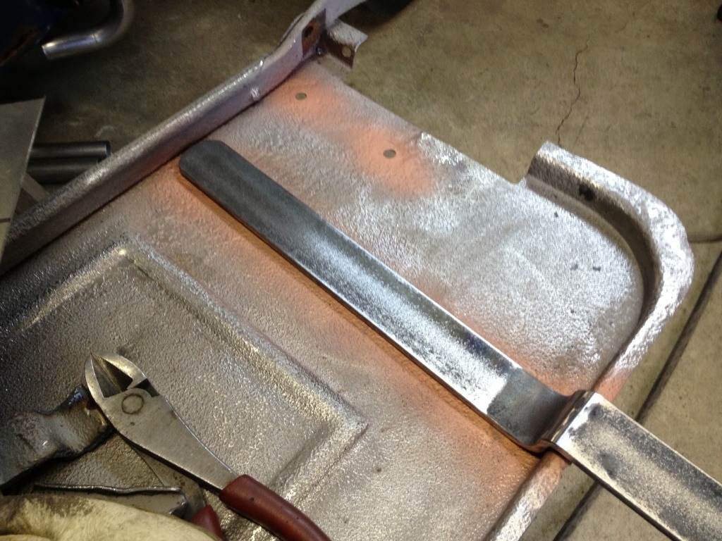

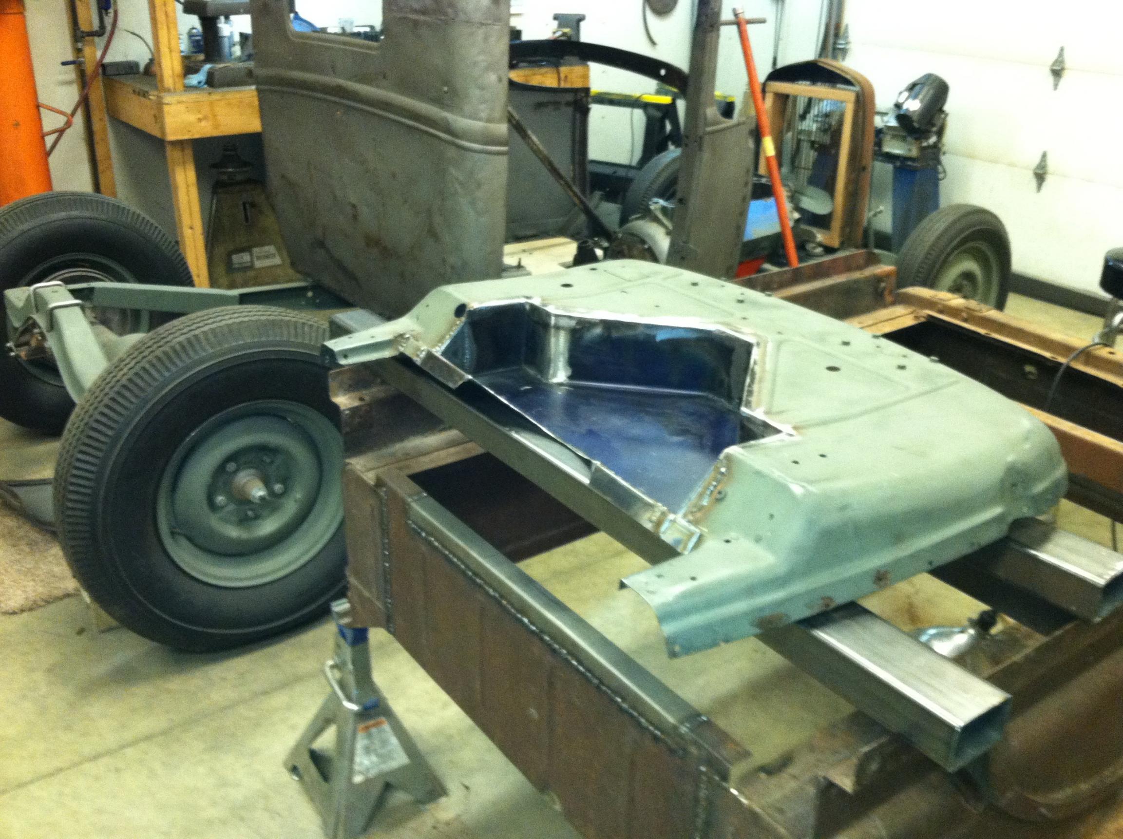

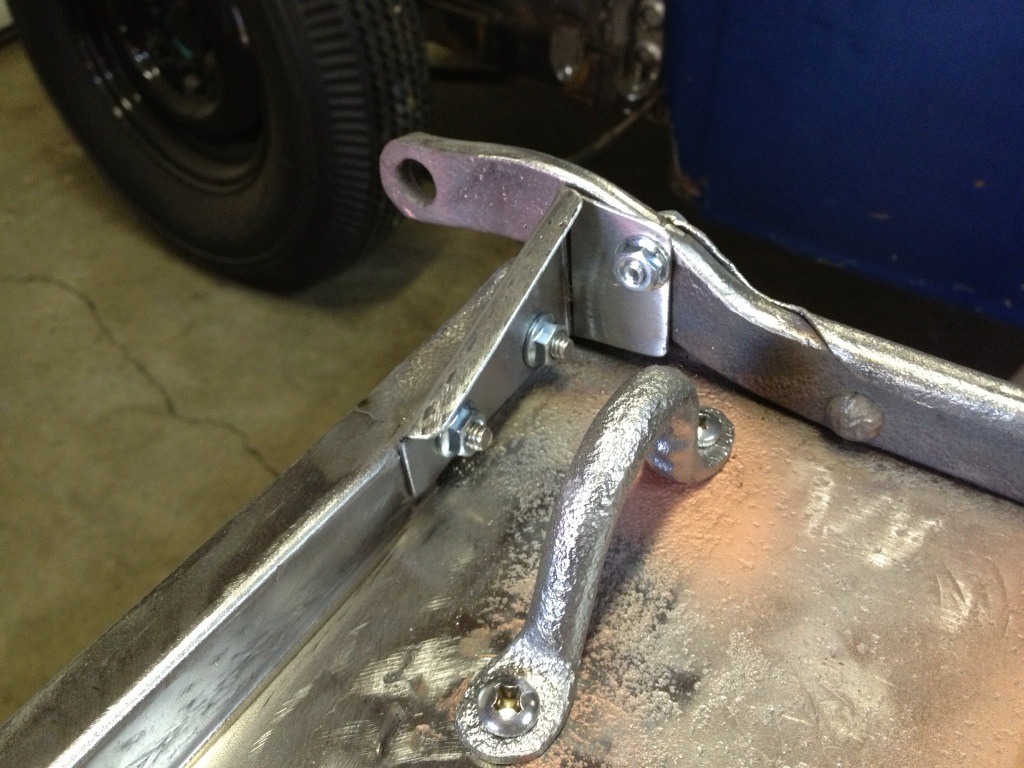

    Didn't cross anything off my list but did manage to start on the tailgate.

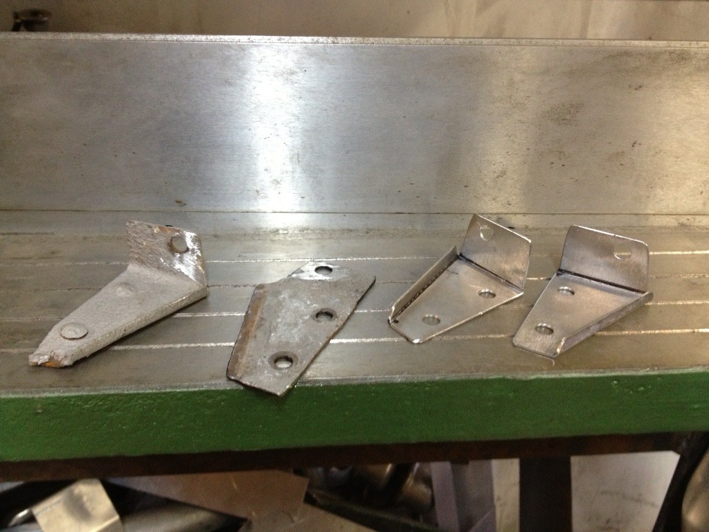

    Started with this, was sand blasted early this year. Very bent and broken, several bad patches.
    Spent a couple hours with hammers and wood blocks straightening it (BTW I'm no body man, more of an ape with a hammer). Also cut out the worst of the worst.
    Made some new patches.
    Also started on some new hinges.
    Started to put it back together. Still need to make the corner reinforcement brackets and grind the welds.
    Aaron

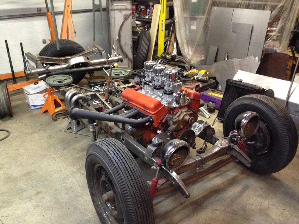

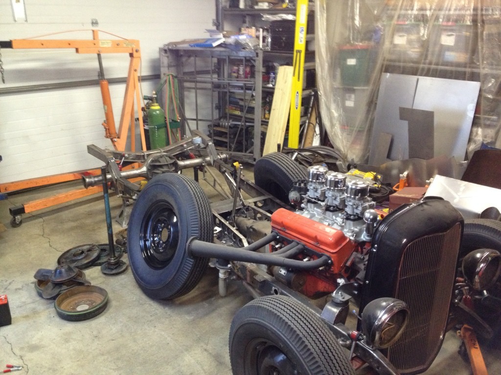

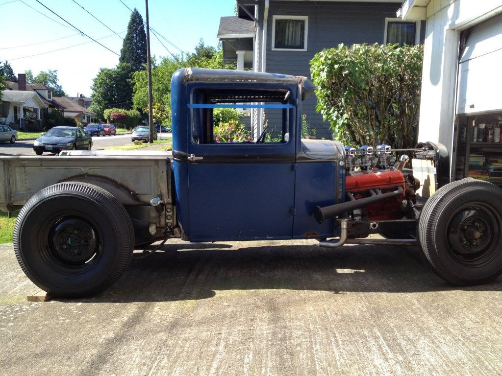

    Small update, spent the morning cleaning the garage and making room for all the parts I'm about to take off. Figured I'd roll it outside and snap a few pictures before I blow it apart.

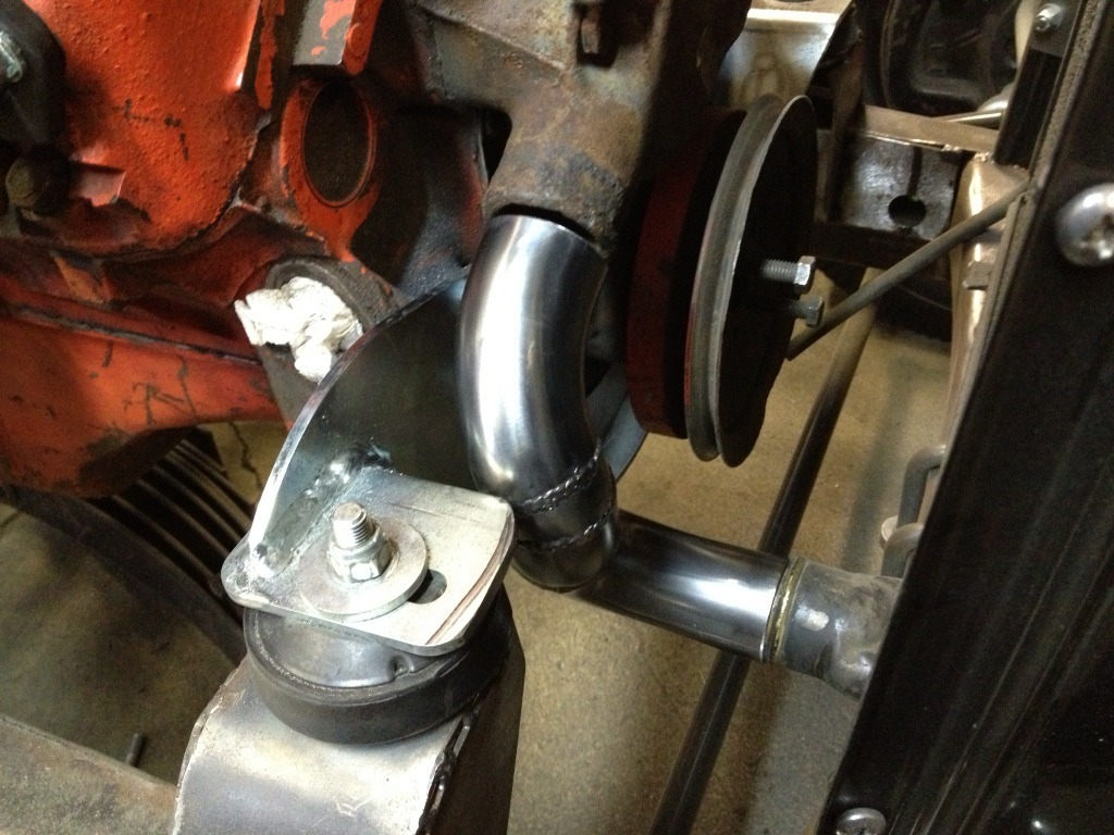

    Did some exhaust work today

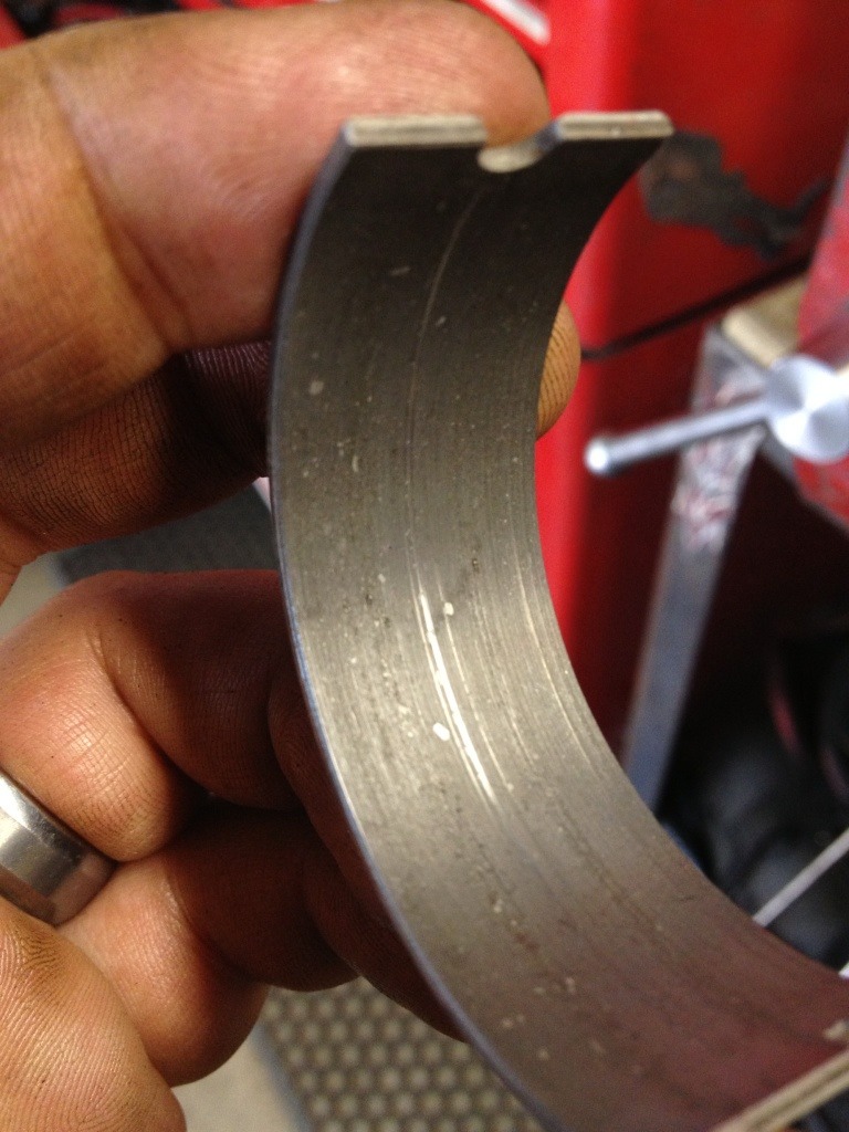

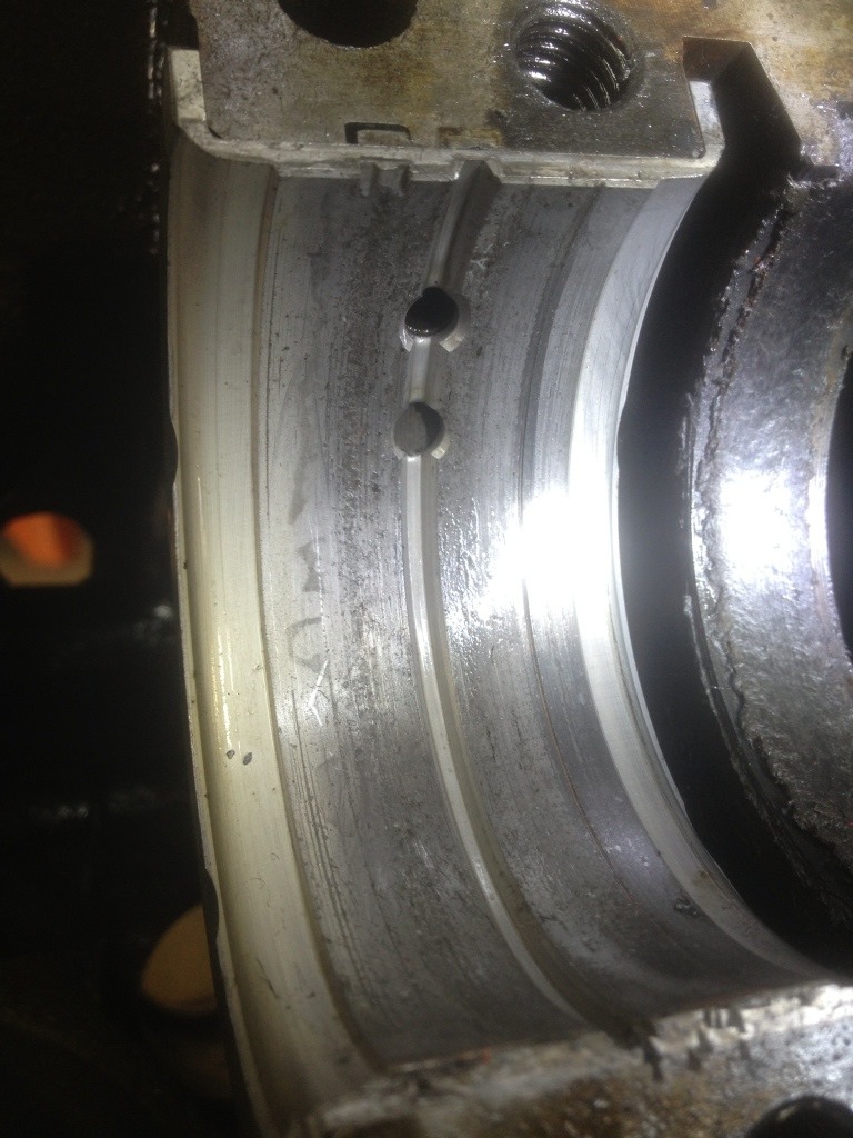

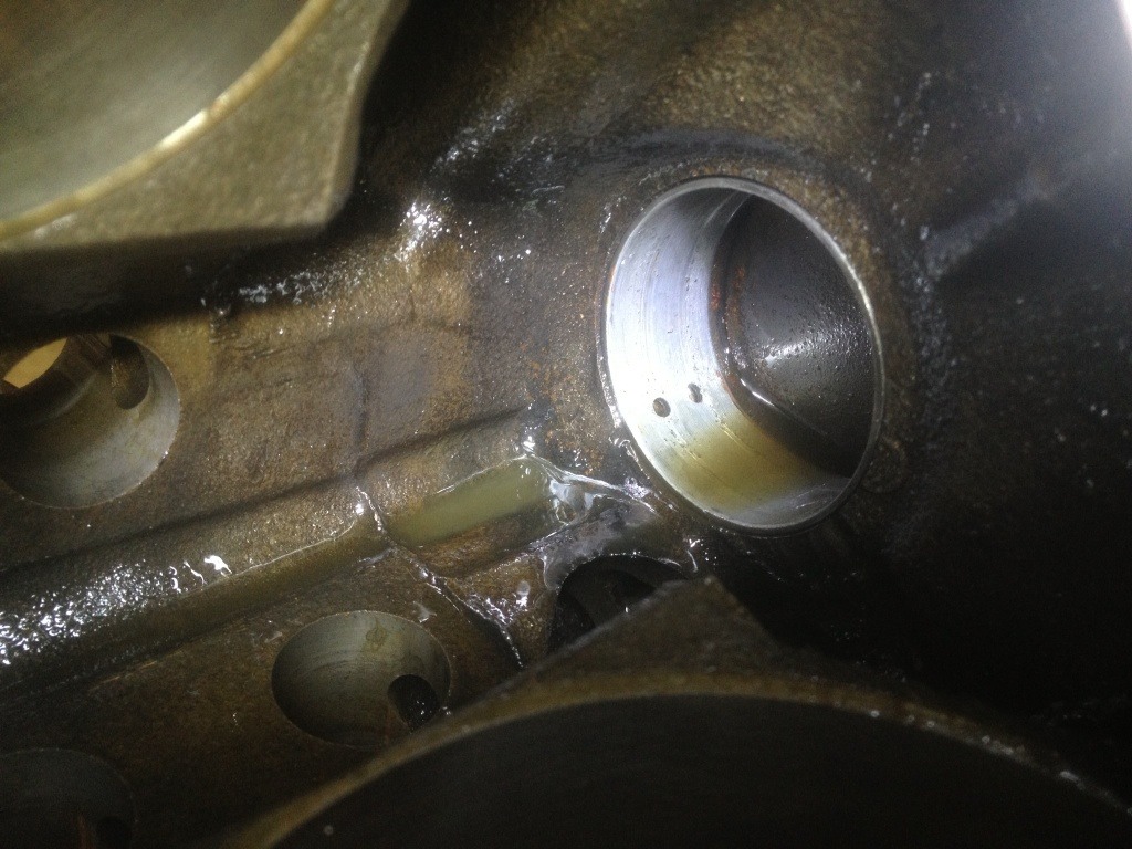

    Well I decided to pull apart my motor and check everything over. I'm glad I did, bearings are toast. So now this is turning into a rebuild instead of just a gasket job. In my day job I'd call it "scope creep". I will be installing a bolt-on cartridge oil filter, this looks like a result of dirty oil.
