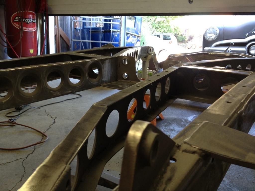

    I'd like to give an update of all the work I've done but I haven't gotten much done.
    I spent some time on a filter/regulator setup for my compressor. Just trying to get ready for painting my frame. It's a little overkill, but that's ok.

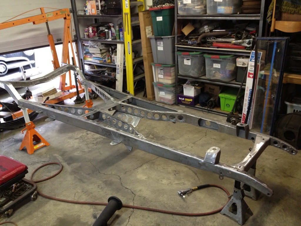

    My frame is ALMOST ready. I welded the brake hose tabs on and started grinding and cleaning it up.

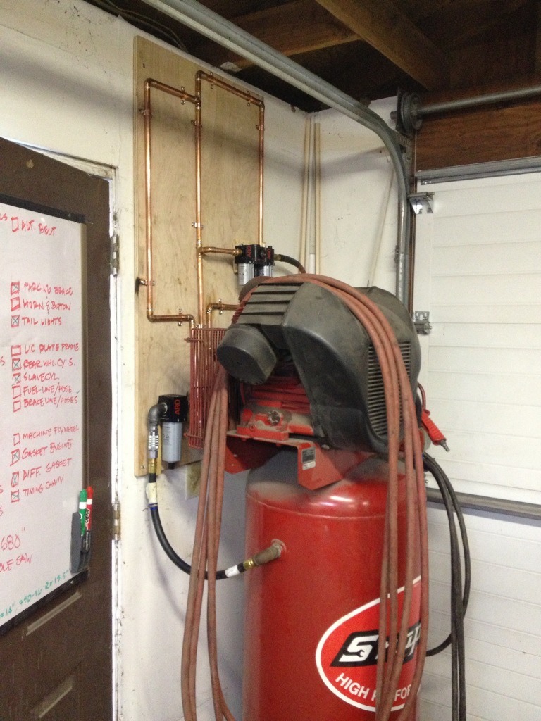

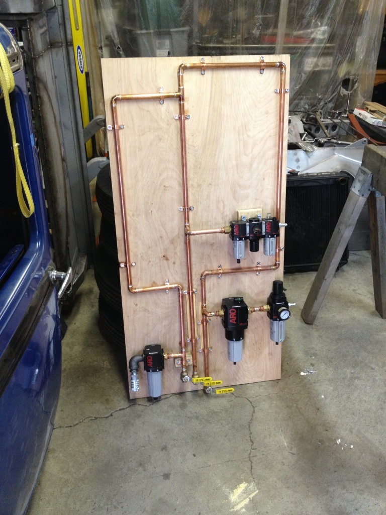

    Hey grudge... I am interested in you compressor setup in the first pict. Can you tell me more about it? I was going to add a splitter with a dryer on one and a lubricator on the other. But then I saw your set up with the pipes routed the way they are. Was curious as to why you set this up this way.

    To be honest I could have done a better job. I've never done copper soldering before so I took this as an opportunity to learn.
    First of all, the BEST deal on filters, dryers and regulators is here:
    http://shop.ingersollrandproducts.com/parts-and-accessories/aro-fluid.aspx
    Keep in mind that the port sizes are usually weird and you'll need to adapt down/up to the tubing size you're using.
    OK, now to the logic of my layout.
    The lower left is a general inlet filter, this is where the compressor outlet attaches. The filter is a 5 micron with an automatic drain. On the filter outlet is the main air line, I put the outlet above a drain valve so any condensation has a place to go.
    The idea behind the vertical tubing is to give water a chance to condense as it cools, and then drain to one of the drain valves. I could have paid better attention to adding a slope to the horizontal runs, but like I said I've never done copper so I ran out of patience after a long day.
    My air tool supply is running through the combination filter/regulator/oiler in the upper right. I don't use this for anything except air tools.
    The lower two components are for my painting air line. First is a 0.3 micron filter, next is another 0.3 micron filter/regulator. I use this for my plasma cutter and (hopefully) for painting.
    I mounted everything to a 3/4" piece of plywood in case I move, I'll just take it with me.
    Let me know if you have any other questions.

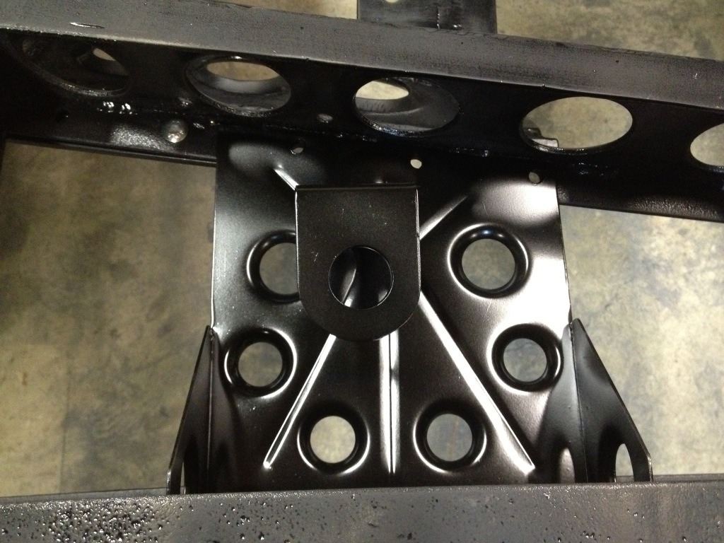

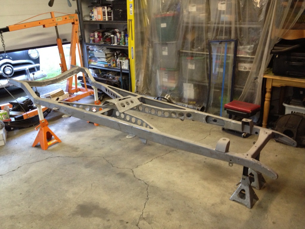

    Conveniently, the CG of my ch***is is at the geometric center of my midship crossmember.

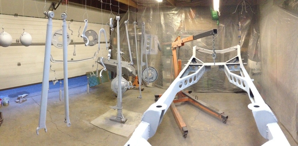

    Well, sandblast + Ospho + self etch + primer + ch***is black will hopefully give me a decent coating.
    Ospho is cool stuff
    My wife asked if I was making a wind chime :D
    I said no, I'm making modern art
    Aaron
    volvobrynk likes this.
  12. Grudge
    Joined: Jun 26, 2008
    Posts: 436
    Grudge
    Well there it is. Only took 16 hours :D
    It's a little too glossy. Maybe some scotch brite in the future.

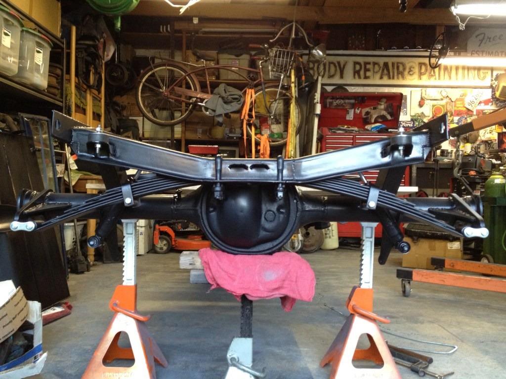

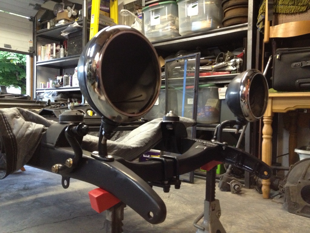

    Hey Josh, was one of the longest and worst days I've spent working on it so far. I've pretty much sworn off any painting projects that ambitious, at least in my garage.
    Got some re***embly done today!
    Hope to get my front suspension put together this week.

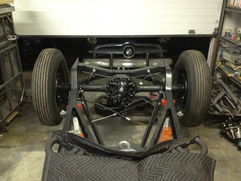

    I achieved rear wheel bolt-onage. Finished the axle bearings, seals and rear brakes. Couldn't resist bolting them on.
