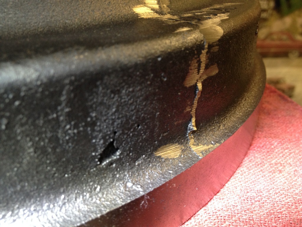

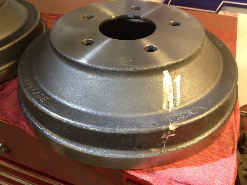

    *Package arrives* "Cool my brake drums are here"
    *Unboxes one* "Wow these are nice"
    *Unboxes other one* "What is this ****!?"
    *Looks closer* "Seriously what the ****!?"
    *Looks even closer* "..."
    *Can't believe/dissatisfied* "Even I won't run this ****"
    I think the quality guy was napping when this one p***ed by. Sort of ironic that it's right next to the "U.S.A.". I don't think I'm being too picky to ask for no obvious HOLES in my brake drums. Also, whoever went to town with the grinder should have said something.
    *Plans to call vendor tomorrow*

    The thing is, these things aren't cheap, so I expect a bit more.
    To be fair, the vendor I bought from just gets these from a supplier themselves, and never has a chance to look at them. I'm not going to name names because it's a reputable outfit and I'm sure they'll make I right (accept the return at no cost to me and send me a new one).

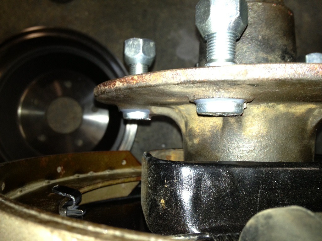

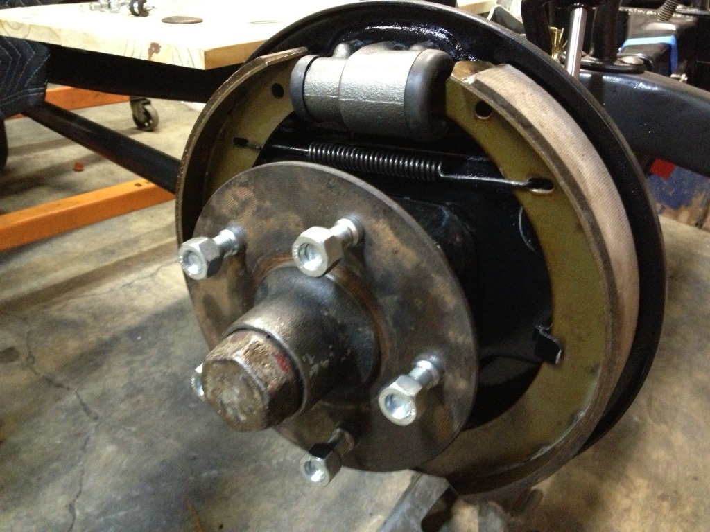

    Thought I'd share what I did with my front hubs. I searched this forum trying to figure out how to convert to new drums. People say to use some special hub bolt but they're on back order, so I figured a different way.
    As you know, OE hubs/drums are swaged or swedged or whatever together.
    I cut the wheel studs off and used a sheet metal cutter to remove the "mushroomed" part of the stud. After that they tap out.
    I bought 10 Dorman studs, Autozone p/n 610-153.1 ($1.50 each)
    I drilled the hubs with a 39/64" bit. I also used a bench grinder to put a flat spot on each stud.
    The shoulder sticks through the hub enough to grab the drum nicely.
    And when you put a wheel on there's a nice amount of thread showing.
    Getting there...
    Aaron

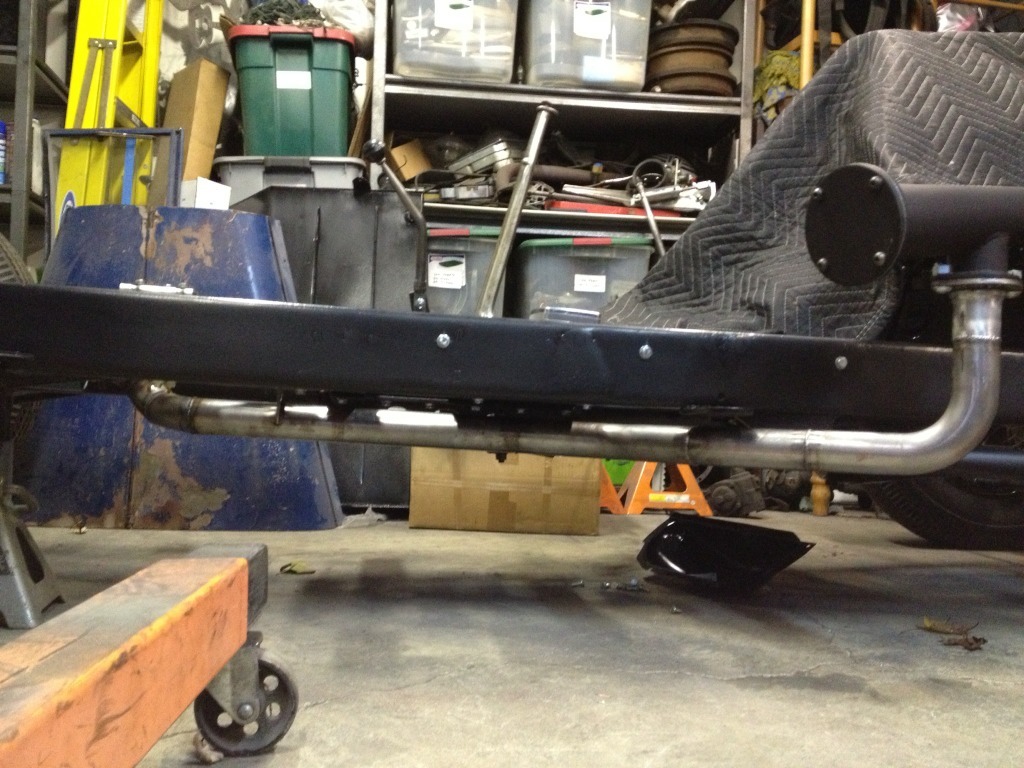

    Did a little exhaust work. Got 22" Smithy's, snug fit
    Made some flanges
    Cut up some mandrel bends
    Next step over the crossmember, maybe this week
    Aaron

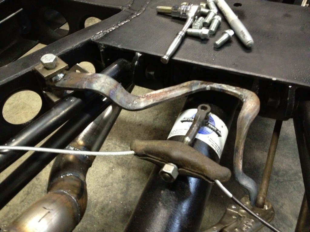

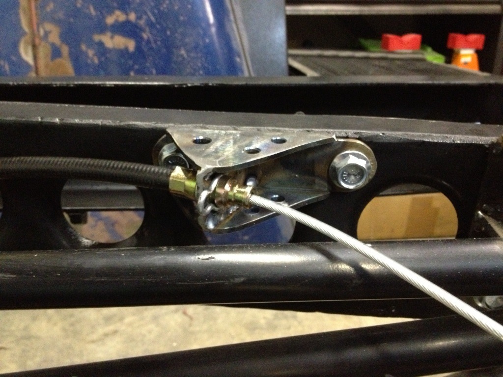

    Made some progress today on my parking brake. I was stupid and didn't mock this up before I painted everything, but fortunately there's no welding needed on the frame.
    Made two of these brackets for the cables. I "aimed" each cable toward the center.
    Here's the pivot for the lever arm.
    Recognize that lever? Yeah it was my stock 'A' brake pedal. Twisted it up and it worked out ok.
    Top view. I still need to finish up the connections.
    Aaron
