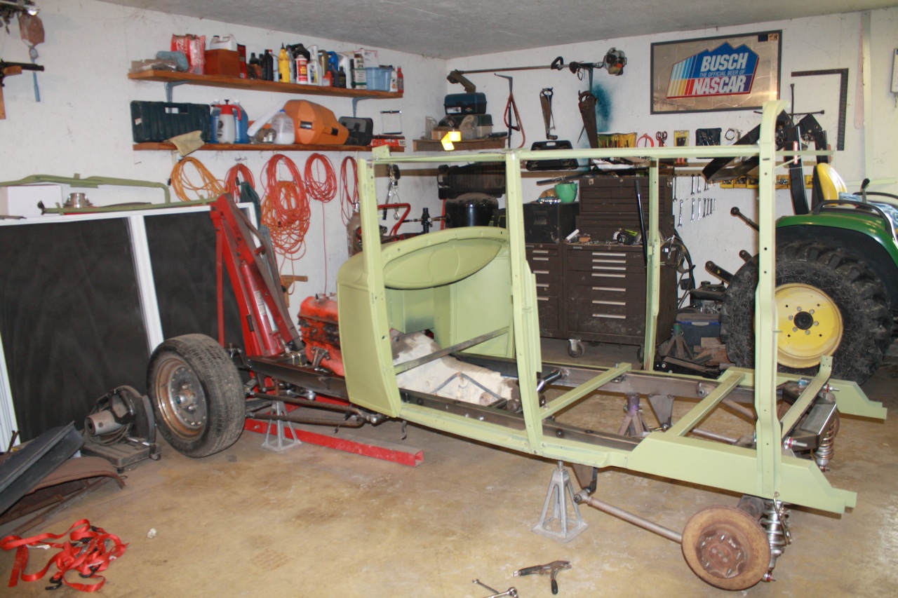

    I have been reading on the Hamb for a while (wow I can't believe the talent on here) . We bought a couple sedans off here and are starting our first Hot rod build You've inspired me . I've built stock cars and late 70's chevy pickups but this is my first rod. My 9 yr old son plans to drive it regularly when he turns 16, we are both having a good time with this build so far, he really gets involved. I have more pics to load. So far I purchased a pete and jakes frame and 4 inch drop front, with the extra parts I sold. The car came with a 9 inch with disc brakes and 4 link / coil over setup. The original frame was plated with a mustang front not usable. I wanted to build a frame but took the easy way out ( figure I have plenty to do without it) I have engine front end and rear tacked in place. Plan to chop it 3-4 inches providing I can fit, we channeled roughly 3.5 inches. The firewall was already cut( wish it wasn't). I am thinking of putting a flat firewall, and t******* back to right in front of the cowl band maybe an inch. I am also thinking of moving the body and rear end back 1 1/2 -2 inches? What is your thoughts ? any problems I'm not seeing?
    I am also back and forth on the electric fan, I like the looks of a mechanical but space is tight. The tires and wheels are mock up only, the front are the height I want back we plan on 2 inches taller 30 inches. We are not running fenders. Plan on a 32 grille shell ( I know it will look like all the rest and not quite welcome on here but we like the look and plan to drive the tires off of it) especially the back ones. I will take all the help I can get so please criticize.

    You have plenty of room for a more traditional mechanical fan...

    You will have to cut more firewall out! Distributor removal! You do not want to have to pull the engine to work on the distributor! Or go to a Ford engine!

    If you insist on the bow-tie motor you will definitely need room for the dizzy. I also vote for losing the 3 rib crank pulley, go with a single rib and install a mechanical fan. You will thank yourself in the future if you lose that electric fan. Just my $.02. Cool build. Have fun with it. CTJ

    I plan to go with a single crank pulley, that engine is a rebuilder.I just stuck it in there for mockup. Plan on having the alternator mounted low . I'm still undecided on the fan. I'm tossing around returning the electric and going mechanical. Here is a couple pics of what we started with. As you can see the original frame had a little to much work done to it. I had originallly planned to use the ford engine and trans to be different but it was stuck. I came across a fresh 350 cheap. We are on a budget so it will have to do for now. Thought I would throw in a pic of when we recieved our new parts a little excited. We spent black friday at the local s**** yard and found a roof I cut the skin off. It was tough to get a 9 yr old boy out of there with all the treasures. Had to clean up the rear end also and mount new brackets. I was able to reuse the 4 bar setup just had to shorten the bars.

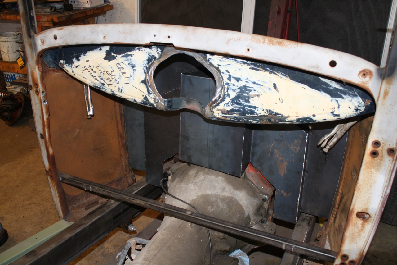

    Been getting a little done. Tore it apart learned how to do electolysis to remove rust.have All the rust replaced but the bottom of the doors. ( still scared to try them yet) some stuff I am not to happy with
    But it will have to do. In the process of building a floor now,then mount the seats.

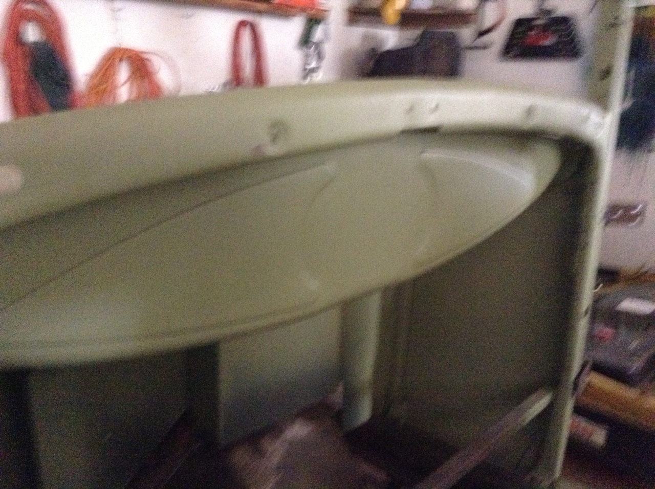

    Having a little trouble loading pics. I struggle loading pics as bad as building hot rods. None of my patch panels are finished the welds still need sanded and body filler.

    I also made my own firewall. Not really happy with it, I don't plan to run an H.E.I. but thought I would leave room for 1 and tall valve covers. Now I think it looks terrible. Hopefully the 6-71 and dual Holleys will cover it up.
    I can see making a lot of changes on this car, but I have to keep going forward or I will never get to drive it.

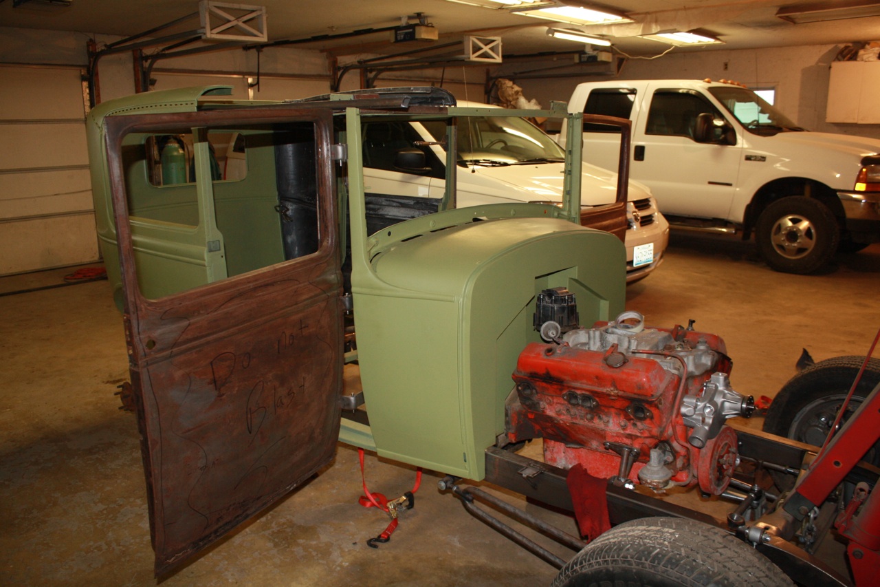

    Here is where we are at the moment, getting ready to work on the floor.We shoved it outside to decide on a chop height .Looks like 3- 4 inch is in the plan. I still have to learn the art of metal bumping also, hopefully I can find someone to show me how :)
    And we still are undecided on wheels but these are close to the size tires.
