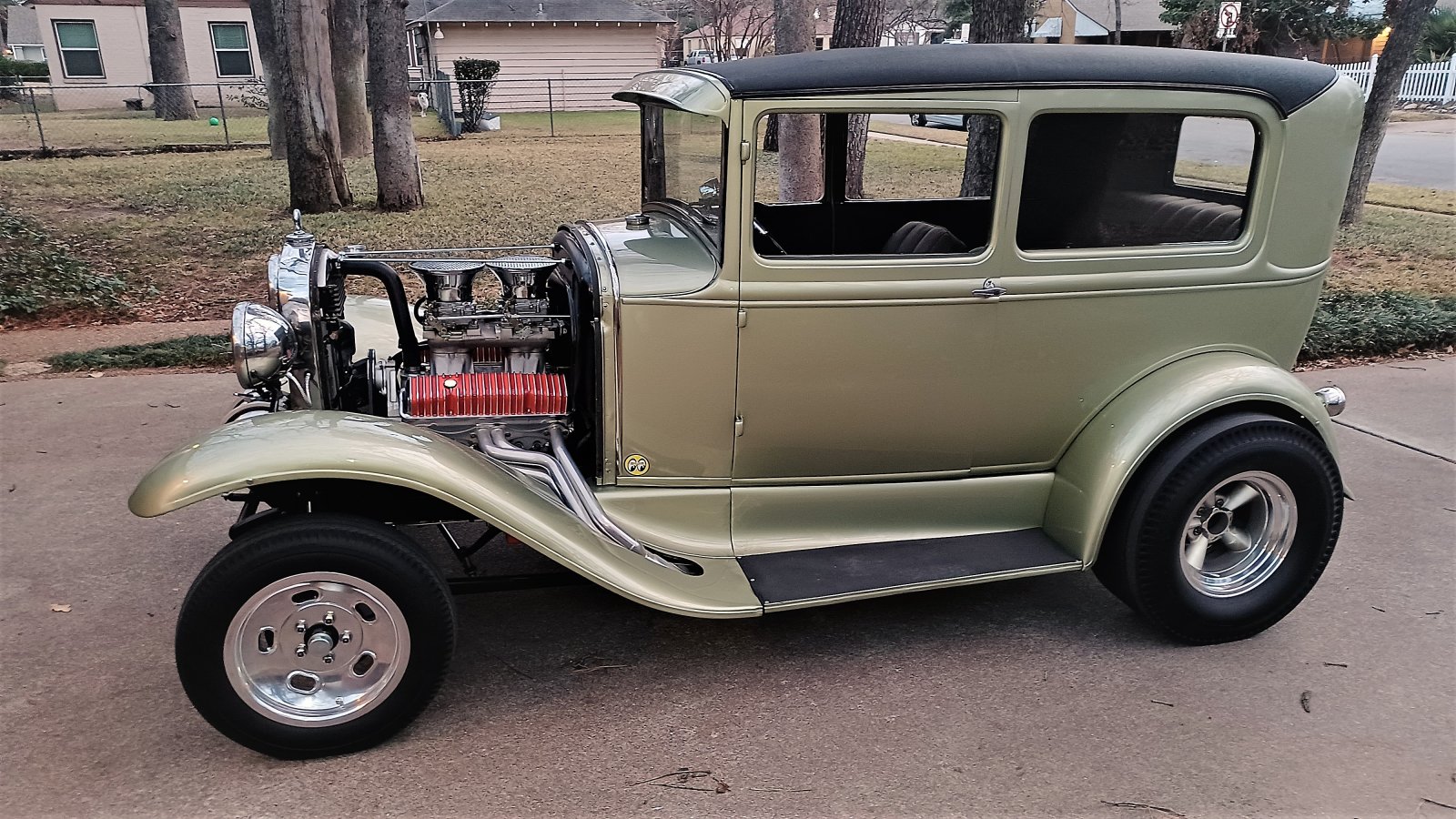

    Just a little update. Let's call it "fun with paint." :) The car has been so good that I really haven't needed to change much on it. But I felt it needed some color in a few places.
    The Americans were full polished. They looked great, but a little modern-ish on this car.
    I wanted more of a '60s look. So my dad and I mixed up a very pale gold and sprayed the spokes. This photo makes them look MUCH more gold than they really are, but it's the only one I took of them getting painted.
    The 383 in this car has always run great. But a few weeks ago, the outer ring of the harmonic balancer came apart. I needed to pull a bunch of things apart to fix that, so while I was there, I decided to do a little clean up and dress up. The engine compartment has aluminum heads, aluminum intake, aluminum water pump/riser, aluminum radiator, silver carbs, and silver ceramic coated headers. That is a lot of gray!
    I always liked the way the flash of Chevy orange from the block and pan contrasted with the green of the car, so I expanded on that a little bit. I got some Spotlite Kustom finned valve covers, and sprayed them in alternating Chevy Orange and Chevy Red Orange stripes. Yes I am insane! I painted the heads to match the block. I had the headers recoated in a thermal barrier and then sprayed them white. I also cleaned up some wiring and hose routing.
    I'm happy with how everything is looking! Really has a '60s vibe to it. I know the tunnel ram isn't exactly era correct, but I like it. So sue me. :)

  4. It looks awesome.
    How about more header details? Jet hot coating or something else? Silver or white? What did you spray them with? VHT? Satisfied with the results?

  5. Gotgas
    Joined: Jul 22, 2004
    Posts: 7,238
    Gotgas
    from DFW USA
    A local powder coating guy blasted and coated them with a ceramic "primer" that he uses before applying topcoats to parts. He said this provides most/all of the thermal protection, but it is a grayish tan color. I sprayed them with Rustoleum High Heat Satin White from a rattle can. :) This was a recommendation from a friend of mine that races in a regional SEGA-like race series. I just painted them and put them on last night, but so far so good ;)

  6. I would have advised against removing the Corvette valve covers, but after seeing the result, you nailed it! The engine compartment looks way better. And the wheels look better too. You're right, too much shiny and gray.
  7. Gotgas
    Posts: 7,238
    Gotgas
    from DFW USA
    Thanks Dan! I had the same thoughts, so I kept the Corvette covers for now. But I'm starting to really like these for being so distinctive. The more I look at them, the more they remind me of the crazy 60s drag scene. I think they're going to stay :cool:

  11. Looks great! Any finished photos of the wheels on the car?

  12. Gotgas
    Posts: 7,238
    Gotgas
    from DFW USA
    It's not a great one, but this is about as good as I have. :)
