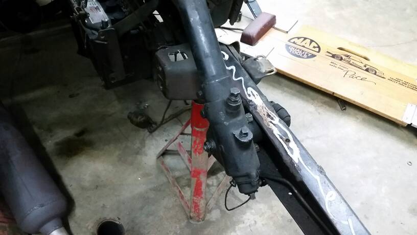

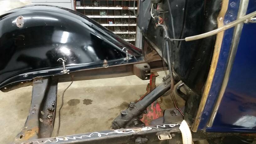

  22. jt1949
    Joined: Apr 13, 2009
    Posts: 185
    jt1949
    Removed the steering column and box today.
  23. BenLeBlanc
    Joined: Sep 24, 2014
    Posts: 537
    BenLeBlanc
    Sweet.
    Take this with a grain of salt, but this is what I have heard, because I just went through this.
    Check your worm gear, as well as all others for wear. Some pitting is ok; there are bolts on the outside that tighten up the adjustments. Same with shaft and everything else. You must have a two tooth, and that is better than the seven.
    From what I have heard, an F1 box can be even worse than a model a box if done poorly. The F100 box is also large.
    I have heard and what I am doing is that I am replacing all of the tie rod/drag link ends with the Teflon links. I have heard that these really help out, so much so that you can sidestep purchasing a different box. F1 boxes are 500 bucks now.
    Any more input would be good, as this is just what I have heard.
    verde742 likes this.
  24. 62pan
    Joined: Jun 8, 2008
    Posts: 914
    62pan
    I just redid the steering box in my roadster for the second time. It leaked bad, I replaced the O ring on the sector shaft where it bolts to the frame with a lip type modern seal. I also went with a shortened pitman arm. What a difference in steering, super easy to steer now. Still have the steel type ends for the tie rod though.
  25. verde742
    Joined: Aug 11, 2010
    Posts: 6,591
    verde742
    the F1 box here that bolts in, and has advance and throttle (looks just like stock) costs $950.00 here in Chandler, Az.
    when standing outside (dr.side), turn steering wheel and watch where column and wheel meet, does it (climb)? There is an adjustment on most '29's,"30's, and '31's, very touchy or it will bind.
    Take that "climb" out, it will steer better.

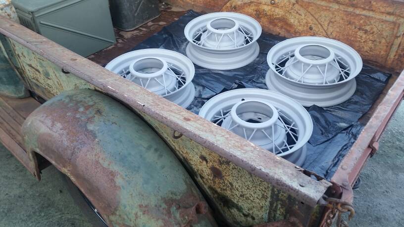

  29. jt1949
    Posts: 185
    jt1949
    Beutiful day here in Oregon. Went and got my 16s back from the blaster today.... they need a little work but look pretty good.
