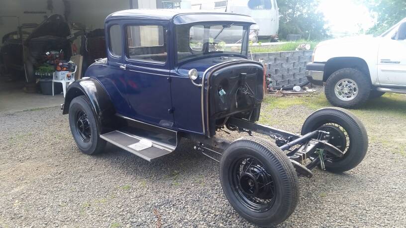

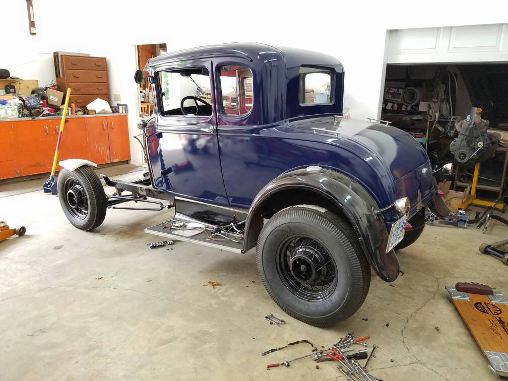

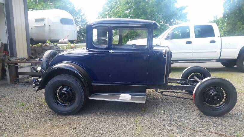

    Dreaming and scheming. ..
    brEad, Jeff34 and 47flyer like this.
  2. Nailhead Jason
    Joined: Sep 18, 2012
    Posts: 4,521
    Nailhead Jason
    Make sure you sit inside it and make reving engine sounds! It helps motivate!

    Posts: 292
    Garagekulture13
    I wish I had those wheels and tires!

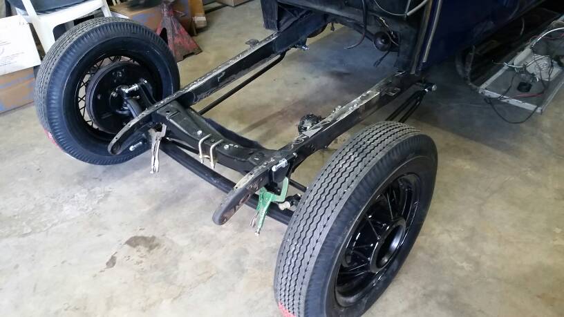

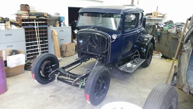

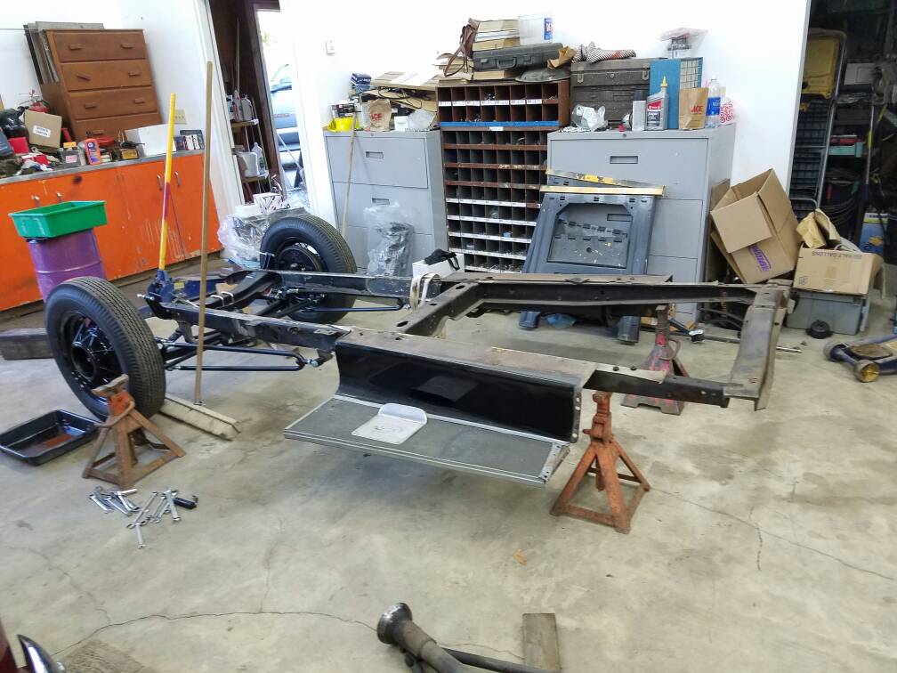

    Got the front end mocked up this weekend. Need to tackle getting the **** down now.

    Steering column in with a new shaft turned down to dd shaft at the box end.

    Looks like you are having fun. Subscribed.
  7. 31Apickup
    Joined: Nov 8, 2005
    Posts: 3,687
    31Apickup
    Good progress, should sit nice.

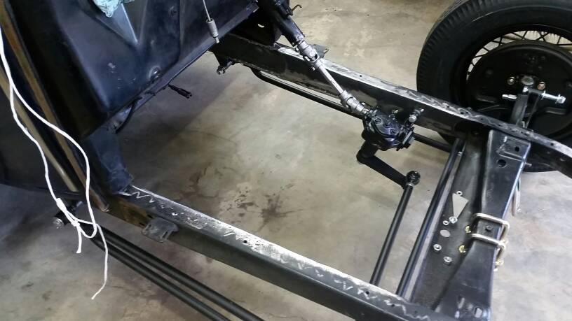

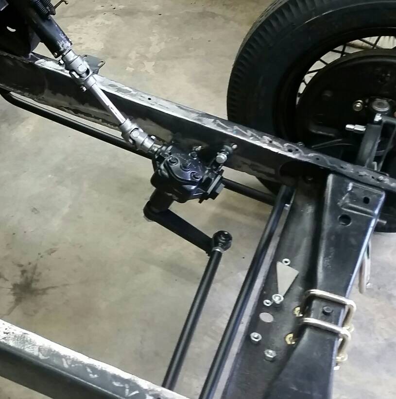

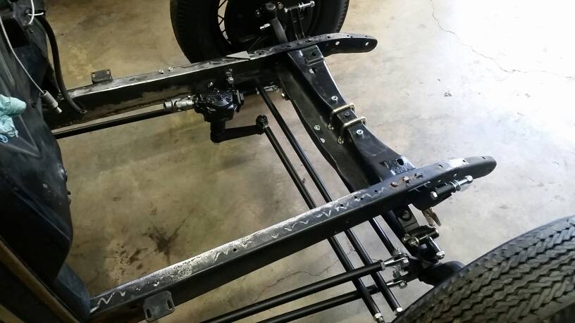

    Could you show a little more detail on how you mounted your steering box and where it is located? I made my adapter plate to put the top bolt over the rail and now I think it needs to go under because of my engine mounts.

    I got all the front end stuff from pete and jakes...

    I went a little lower just for that reason.

    Thanks! I may have to do this. Currently my steering shaft is in line with the center exhaust port on my flathead.
    How is it mounted on the other side and did you do anything to make it perpendicular to the front axle or did you just mount it flat to the rail?
  17. jt1949
    Joined: Apr 13, 2009
    Posts: 185
    jt1949
    I mounted it flat to the rail... I am using those u joints to connect it from the box to a dd shaft to another u joint to the steering column shaft... figured that angle wouldn't matter too much.
  18. patmanta
    Joined: May 10, 2011
    Posts: 3,882
    patmanta
    from Woburn, MA
    I totally spend like 2 hours getting my plate to 3° because I thought it MIGHT be important... and I tend to hyper-focus on things like that when I start fabricating little things apparently.

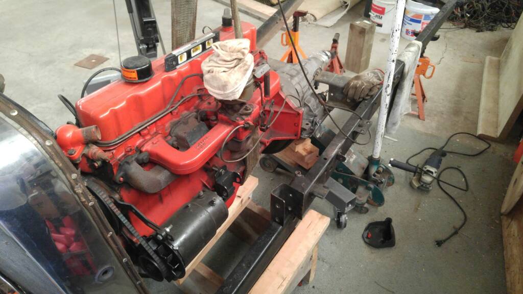

    I decided to go with a 153 ci chevy for the engine in this one. I've used these before. Great little motors.

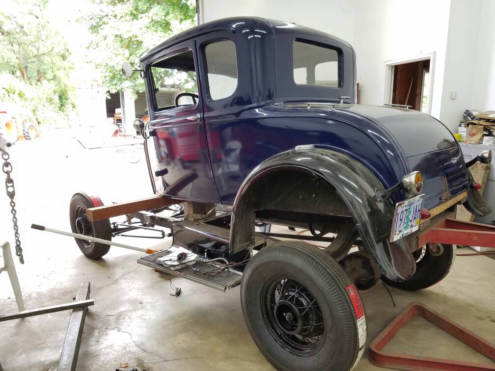

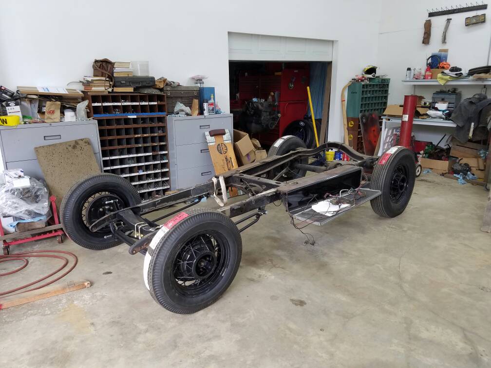

    Body off today.... next changing out the rearend.

    Coming right along!

    I've got a 194ci for mine.
  24. 1931fordtruck
    Joined: Jul 6, 2013
    Posts: 347
    1931fordtruck
    '62 Chevy 194ci with power glide trans. 25,000 original miles.

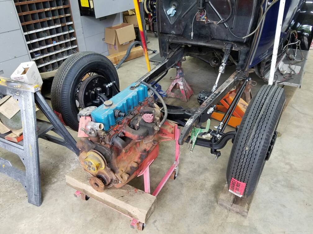

    Mocking the motor up today.

    How did you do your rear end, what set up?
  29. jt1949
    Posts: 185
    jt1949
    I'm using a 97 s10 rearend. Going to build a triangulated 4 link with coilovers. Hoping to get it low enough without modifying the frame.
  30. 1931fordtruck
    Joined: Jul 6, 2013
    Posts: 347
    1931fordtruck
    I'm using an S10 rearend as well, 4 link setup, and a '38 ford front leaf spring. I am undecided on weather its going to be a spring above or behind. I have to mock it up and see which is going to be better for the stance i am going for.
