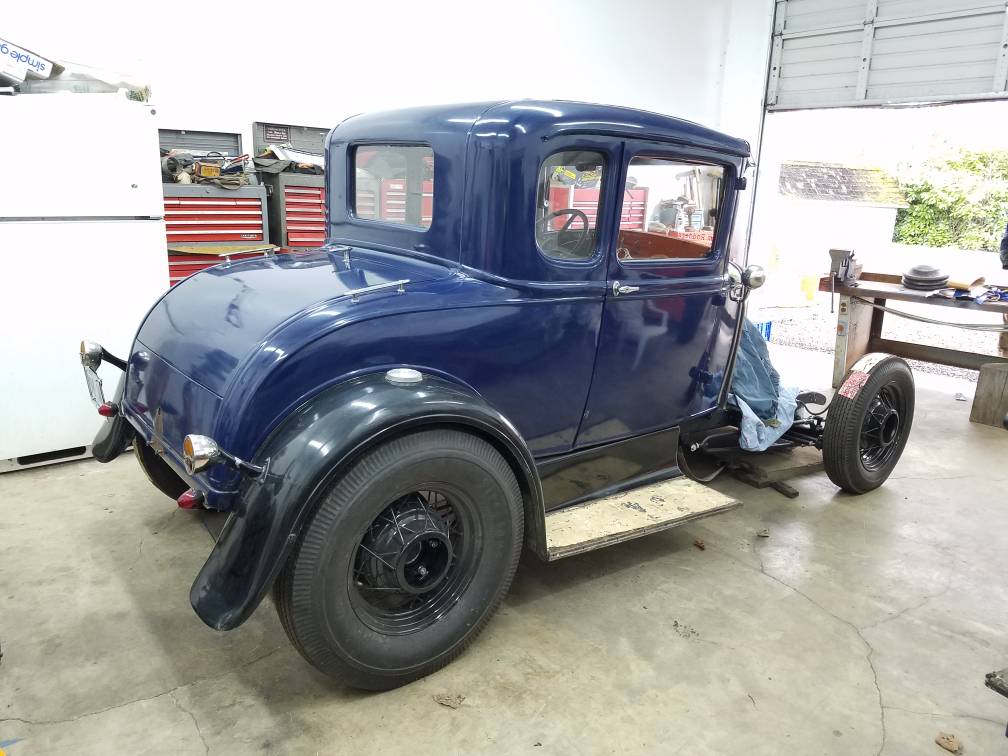

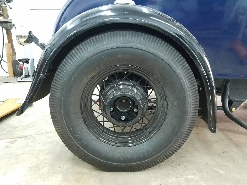

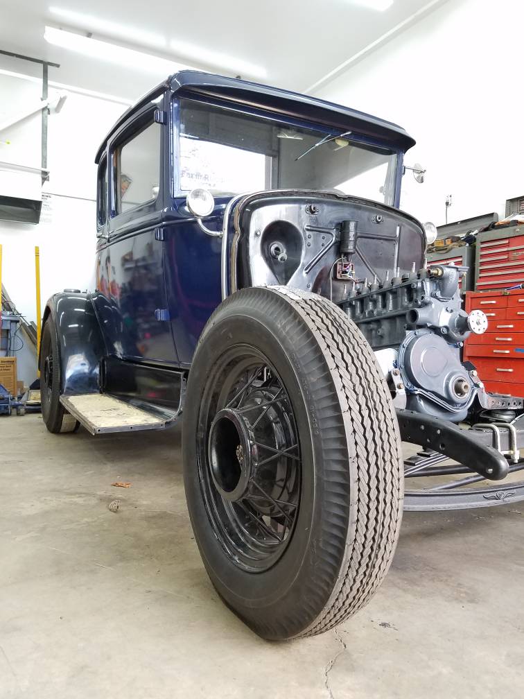

    Got the rear axle centered up in the wheel wells today. Also set the ride height with the coilovers and the pinion angle. Finished up the pedal clutch and brake ***embly. And talked on the head. Fairly productive day

  5. CoolYourJets
    Joined: Dec 16, 2016
    Posts: 179
    CoolYourJets
    What kind of t-5 did you get? I'm thinking I might copy you and put one in too. Thanks
  6. jt1949
    Joined: Apr 13, 2009
    Posts: 185
    jt1949
    I used a t5 out of the late eighties S10.. some modifications needed to be made to the input shaft on the transmission to accommodate the clutch disc. But works great

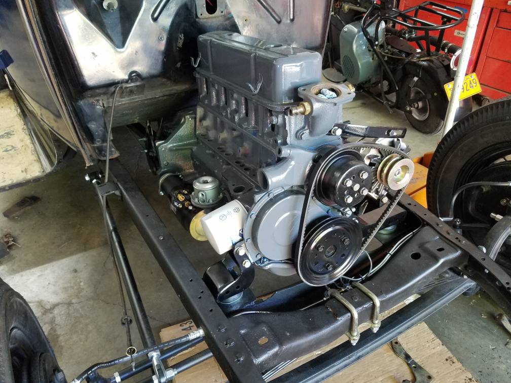

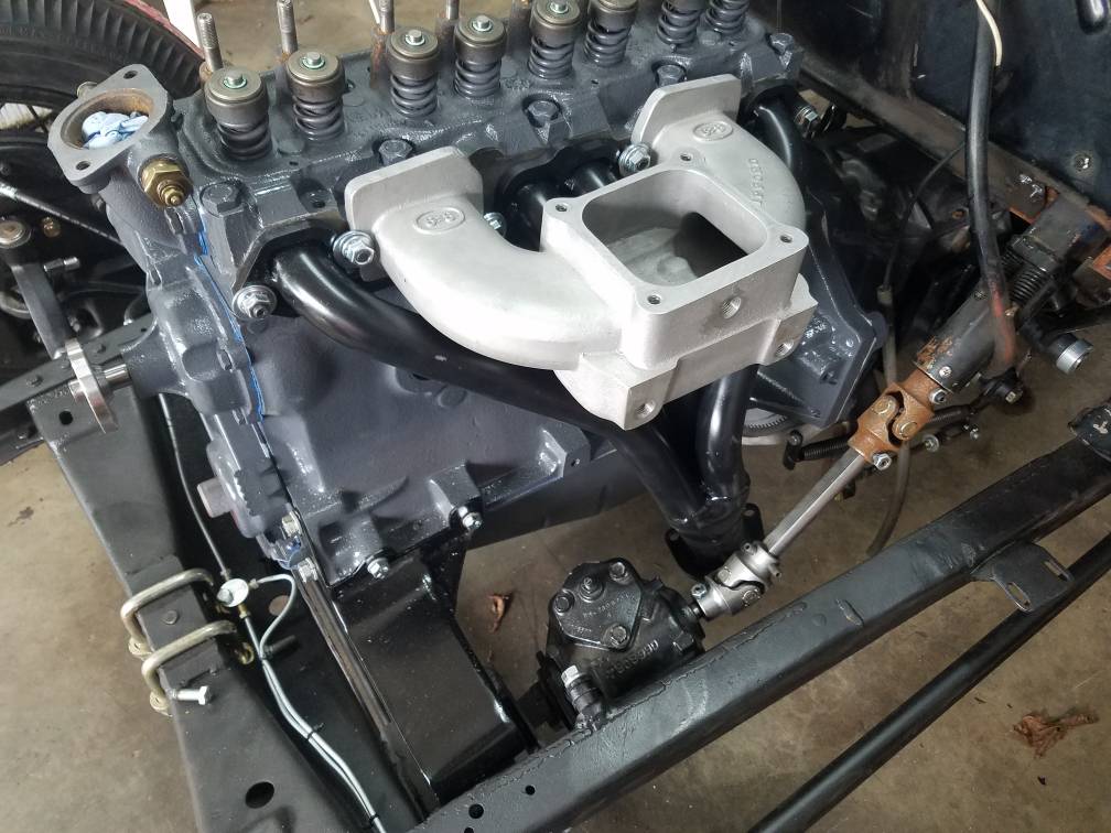

    Fitting the Clifford performance intake and exhaust header.. steering linkage in and working with no interference. [​IMG][​IMG]

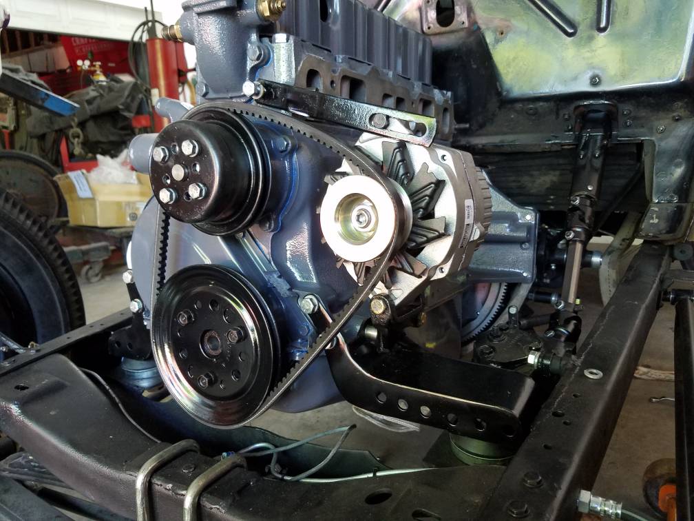

    Found an old alternator bracket that was almost perfect for this application. The last project I use one of these engines in gave me fits trying to line up the pulleys. This one is being easy so far.[​IMG][​IMG]

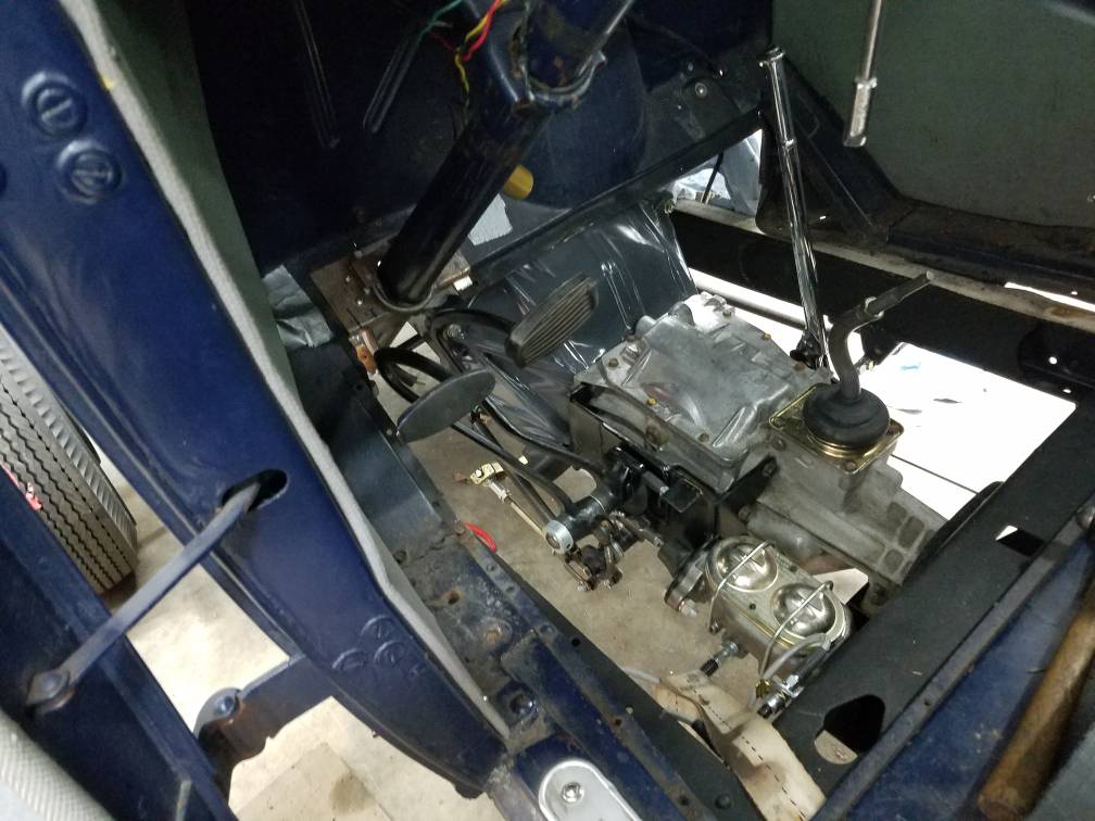

  29. jt1949
    Posts: 185
    jt1949
    Jeff34, waxhead and brEad like this.
  30. Crusty Chevy
    Joined: Aug 28, 2007
    Posts: 1,339
    Crusty Chevy
    That is an awesome pedal set up, can you give some more specifics/close ups? any flex issues not having support from the left? What a space saver, I love it.
    RoddyB34 likes this.
