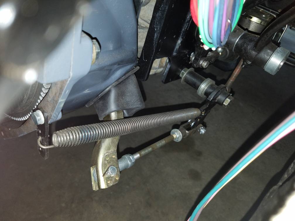

    I was admiring the brake/clutch pedal mechanisms myself ,,there's a lot going on in a small area,,

    I hope it works as well as it looks, I still think it is a great space saver and if over built should be reliable with minimal flex. Bravo.

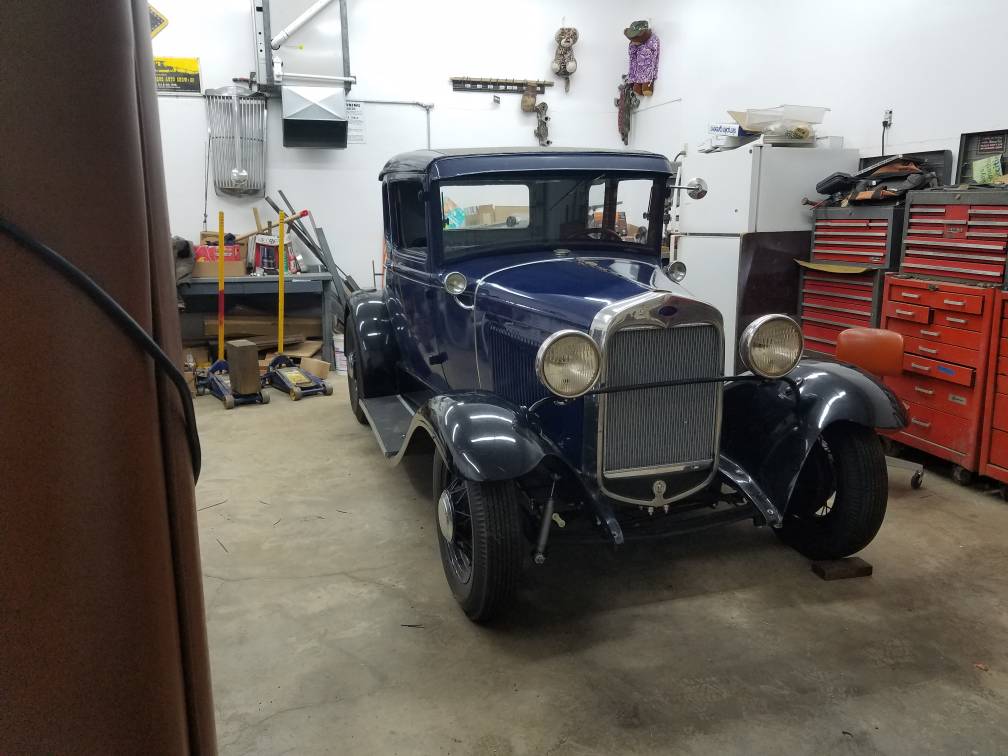

    About half done with wiring now and i am pretty happy with the al***ude now that it is back on the ground! 20171127_153607.jpg 20171127_121131.jpg 20171127_121354.jpg

  11. low down A
    Joined: Feb 6, 2009
    Posts: 500
    low down A
    there's a new thread on here how tires and with stance make a car. your car is a perfect example of that, nice job it needs nothing else

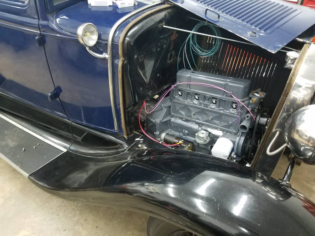

  18. hammerd 31
    Joined: Sep 19, 2016
    Posts: 51
    hammerd 31
    Nice coupe, be sure to check those starter bolts often. That engine in a boat application has a bracket that mounts to the block on the threaded hole by the fuel pump and the long bolt that holds the starter together. With out that support it will loosen and sheer the starter mounting bolts. Seen it happen many times, just my 2cents.
  19. jt1949
    Joined: Apr 13, 2009
    Posts: 185
    jt1949
    You are totally right on that. I have this motor in my 36 Ford pickup as well broke two of those bolts before I got it squared away. Just found a bracket the other day for this one

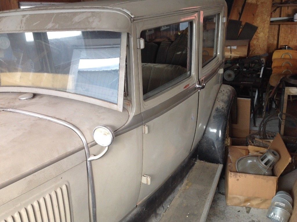

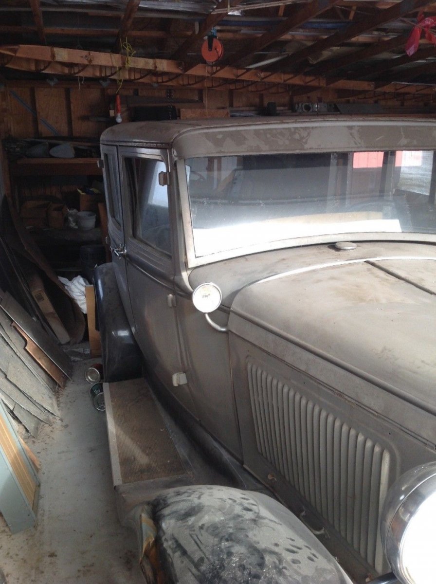

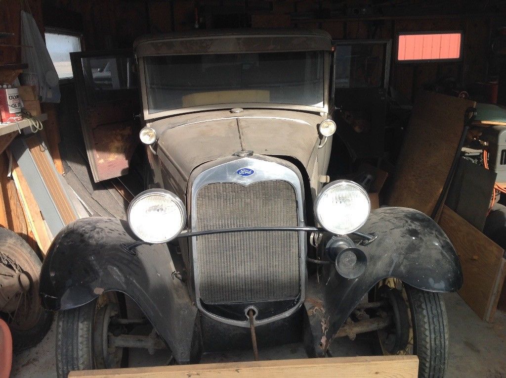

    Not to knock your thread off track, but I just bought a 30 Briggs. I am building a nice banger engine and this will be my project. I have been following yours and like the way it turned out. I will start a thread on the build later as it will be a couple months before I start.

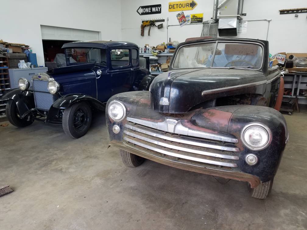

    Having to share shop space with a crusty old 47' convertible... kids! [emoji23][​IMG]
    Sent from my SM-G930V using The H.A.M.B. mobile app

  25. CoolYourJets
    Joined: Dec 16, 2016
    Posts: 179
    CoolYourJets
    Can you post a pic of that bracket?
