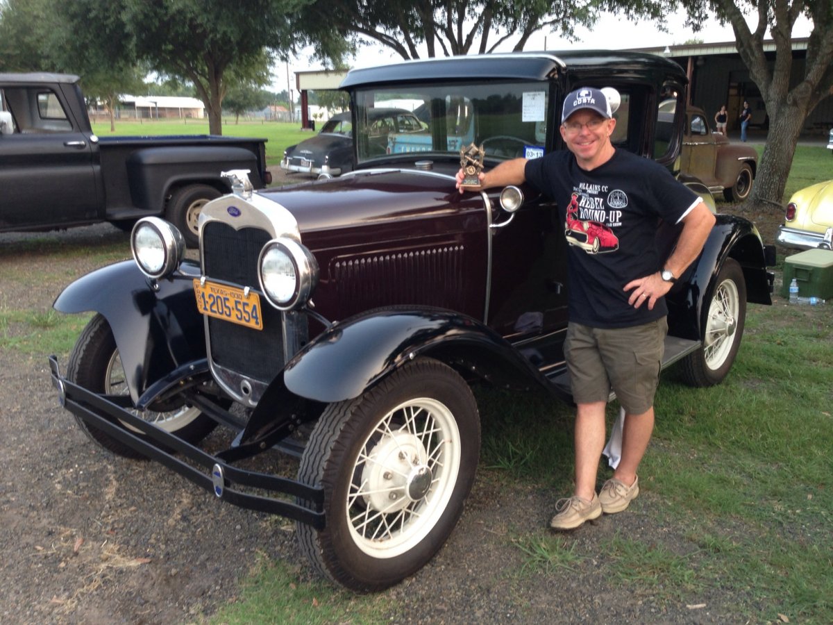

    Alright,
    So after another weekend at another car show, I have finally successfully talked my old man into rodding his 1930 Model A. He loves the car, but hates driving it with the 4 cylinder in it. I've been given the green light to start with the rebuild of the car. I've got a 401 Nailhead going in it along with an automatic transmission (he requested an auto transmission). So, now my question for all y'all, what can I pull a rear end out of that will fit? Also how much can I get away with dropping the front end? It'll stay full fendered. He doesn't want to change anything with the way it looks on the outside unless its a little fatter tire and wheel. I also want to get away from the mechanical brakes and put some juice to them all around. Help me out y'all! I gotta start putting together this budget for him so I can begin this before he changes his mind!
    This is him with the car.
