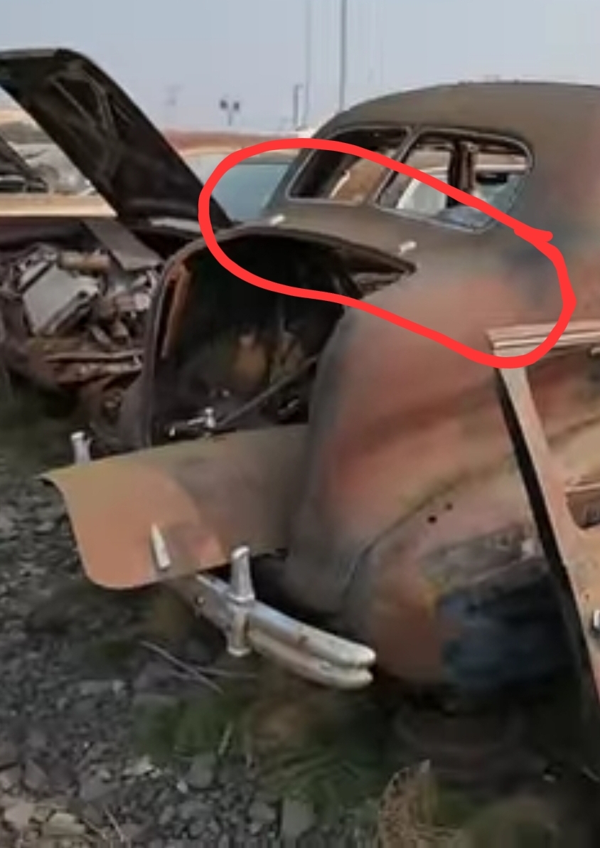

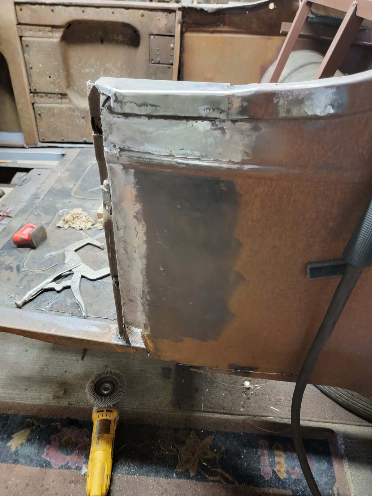

    Made some progress in the back...I have been trying to figure out how I was going to make this all come together. I knew it would work somehow but had to play with it. It took a piece from the back of a 39 buick to make it work. 20230107_124740.jpg Compound curves, no english wheel. 20230107_135903.jpg Still a ways to go and a lot more cleanup but this is gonna work! 20230107_141001.jpg 20230107_150735.jpg 20230107_151213.jpg 20230107_151229.jpg 20230107_151229.jpg 20230107_151233.jpg 20230107_151301.jpg

    The donor of the magic piece haha the car is now, 25 dodge, 26 chevy, 27 chevy, 37 ford, 39 ford, 39 buick, 49 lincoln

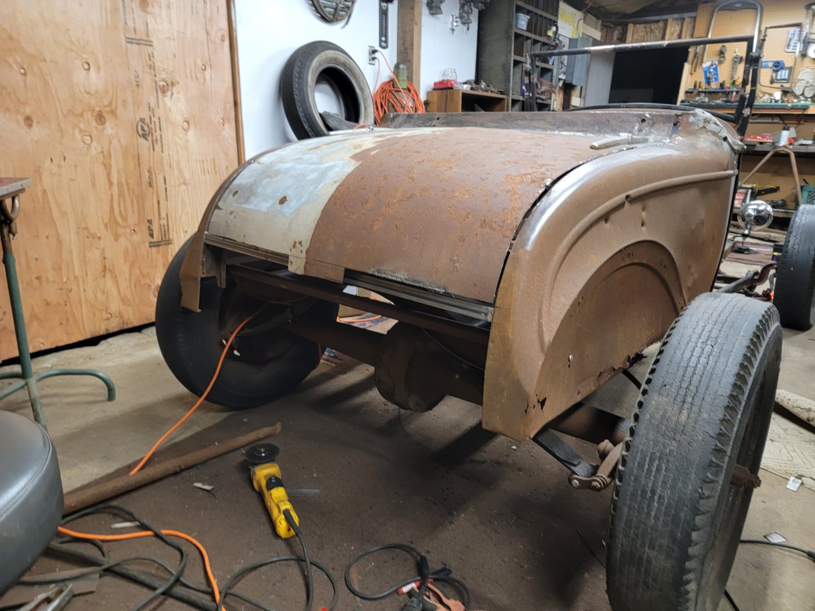

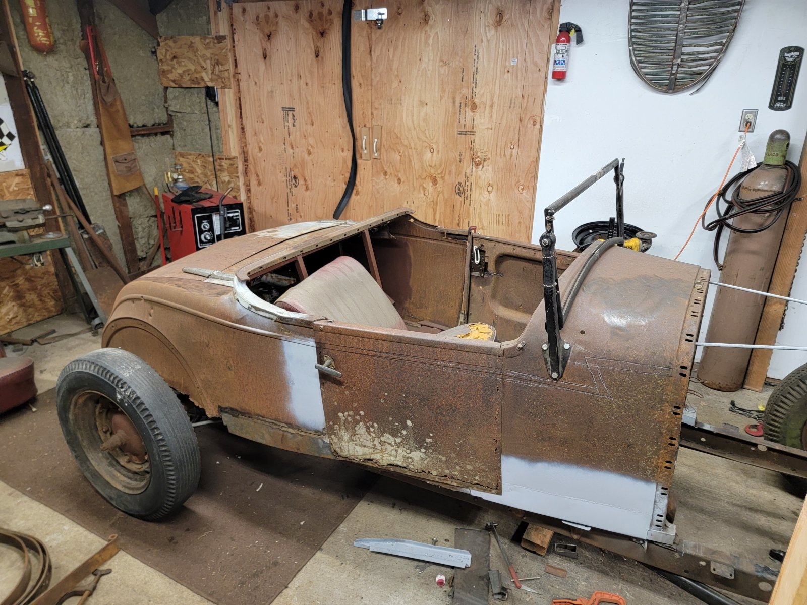

    Started on fitting it all together today, slow work but no big issues... 20230108_154459.jpg 20230108_154713.jpg 20230108_154906.jpg got it about halfway. I dig the profile... 20230108_154911.jpg oh and heres a pic of the underside for those of you who think I never clean metal 20230108_154722.jpg

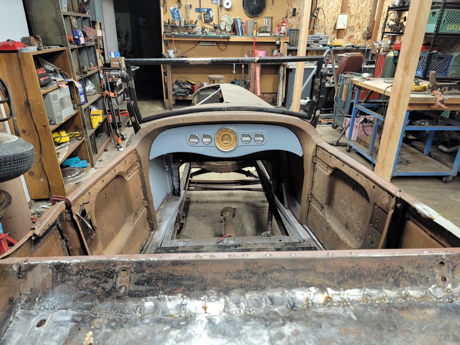

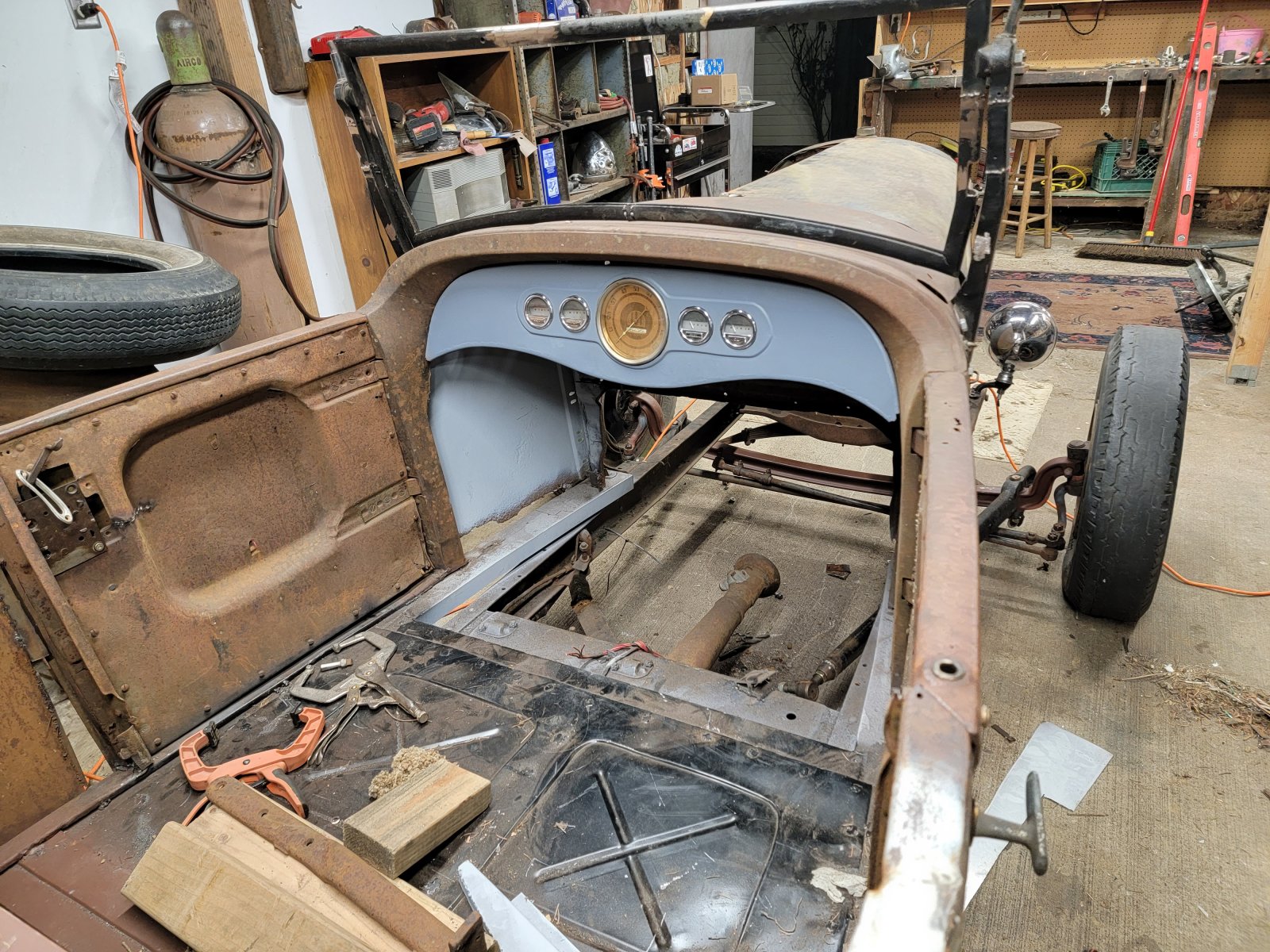

    Finished the dash (mostly) tonight and got to see it in the car! Speedo is 36 nash, guage pods are 50 merc I think. Even did a video on it 20230115_232817.jpg 20230115_232814.jpg 20230115_232810.jpg

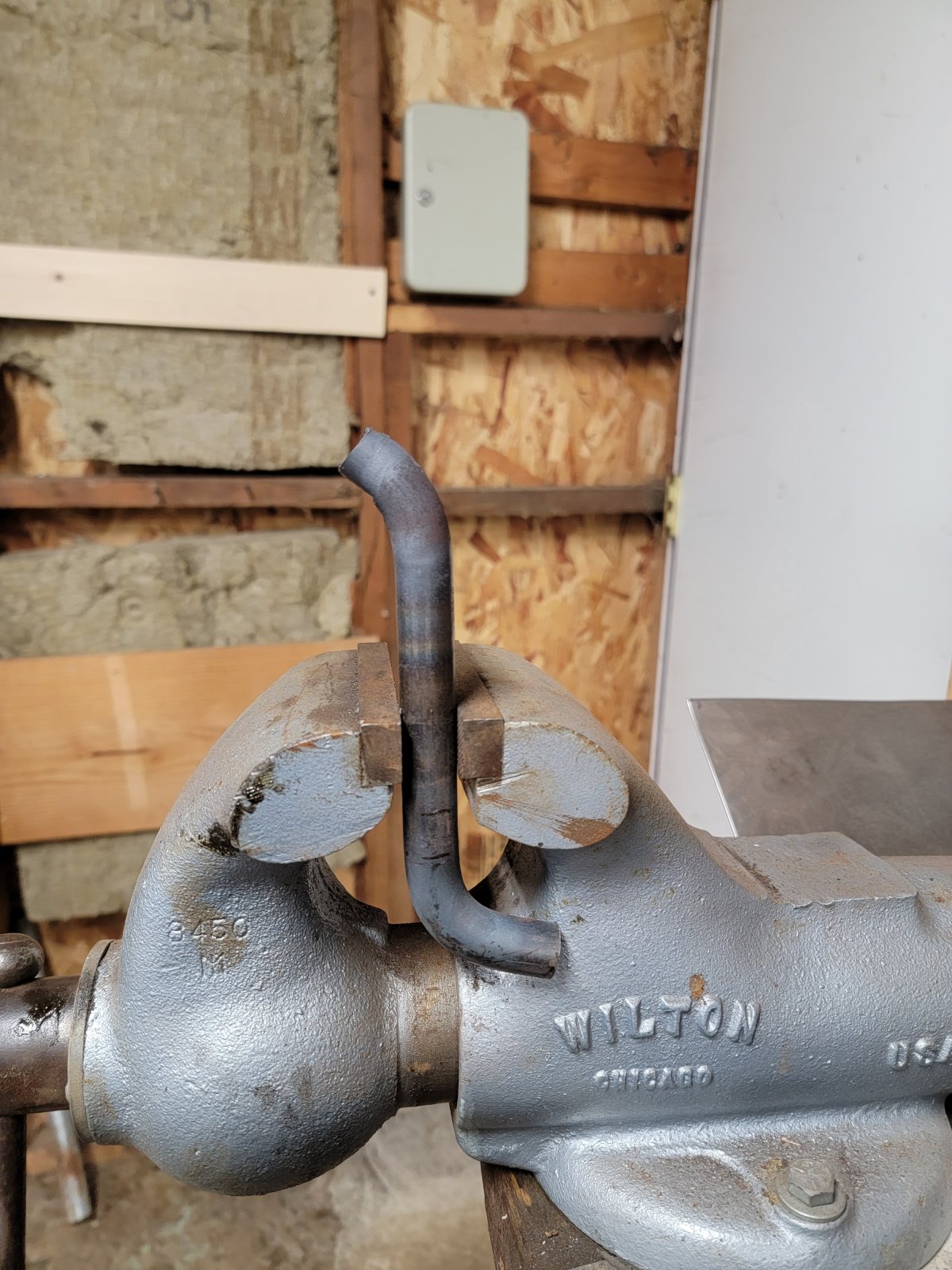

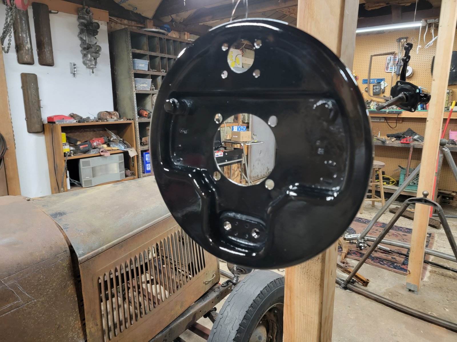

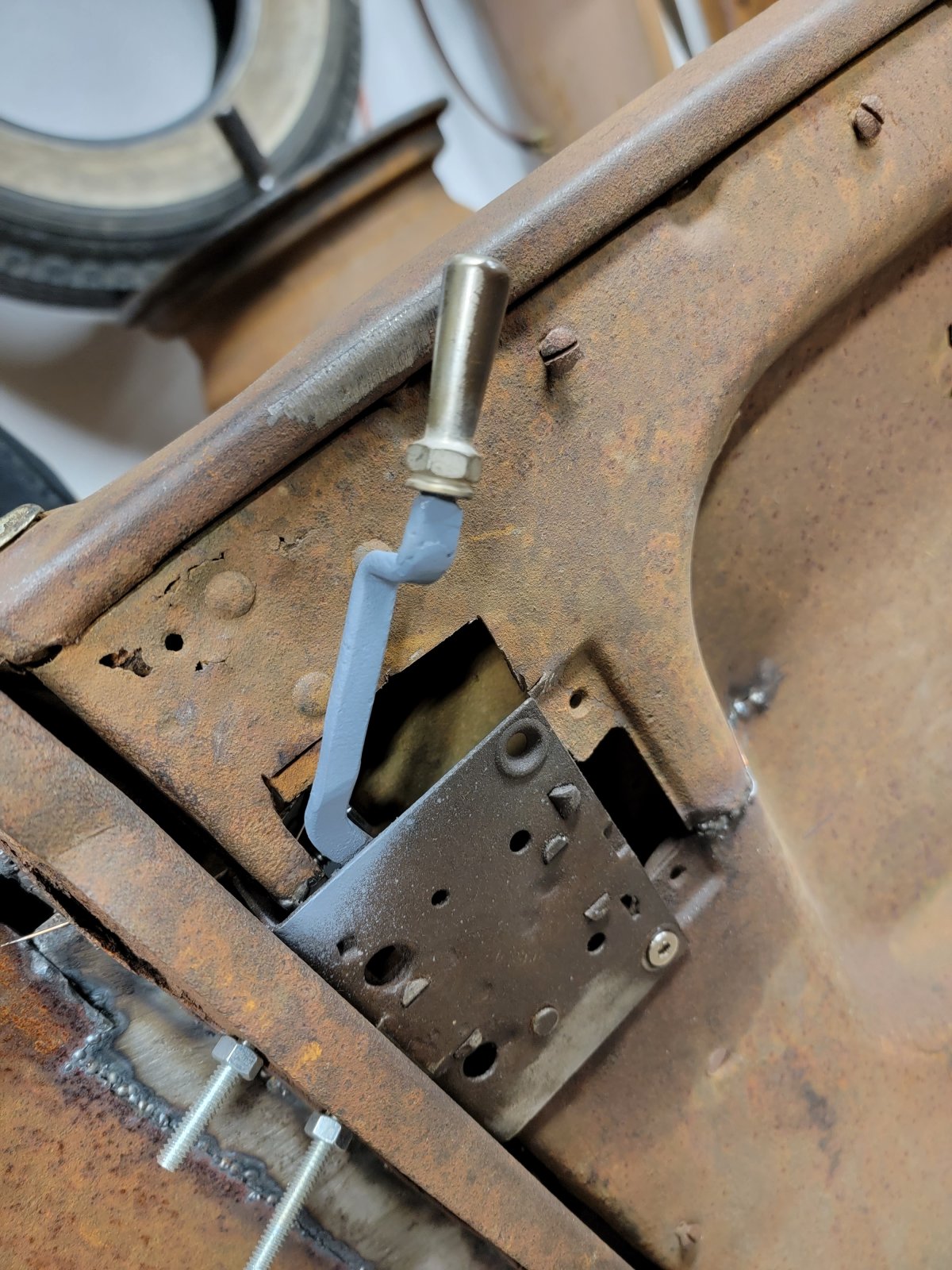

    Little progresses tonight, got one of my backing plates stripped, primered and painted. 20230118_013156.jpg I finally put the catch on the drivers side so the door latches. 20230118_013131.jpg 20230118_013123.jpg I also started on a scratch built set of f1 shock mounts. 20230118_005334.jpg 20230118_013300.jpg The originals and repops cost more than I wanna pay for a little piece of metal so I just decided to crank out a pair myself, total finished cost will be about 3-5 bucks

    Video on the f1 shocks

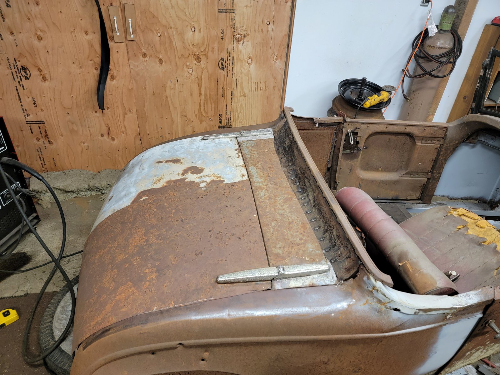

    Welded in a patch panel and added an interior door knob tonight. Small victories but progress! 20230124_003417.jpg

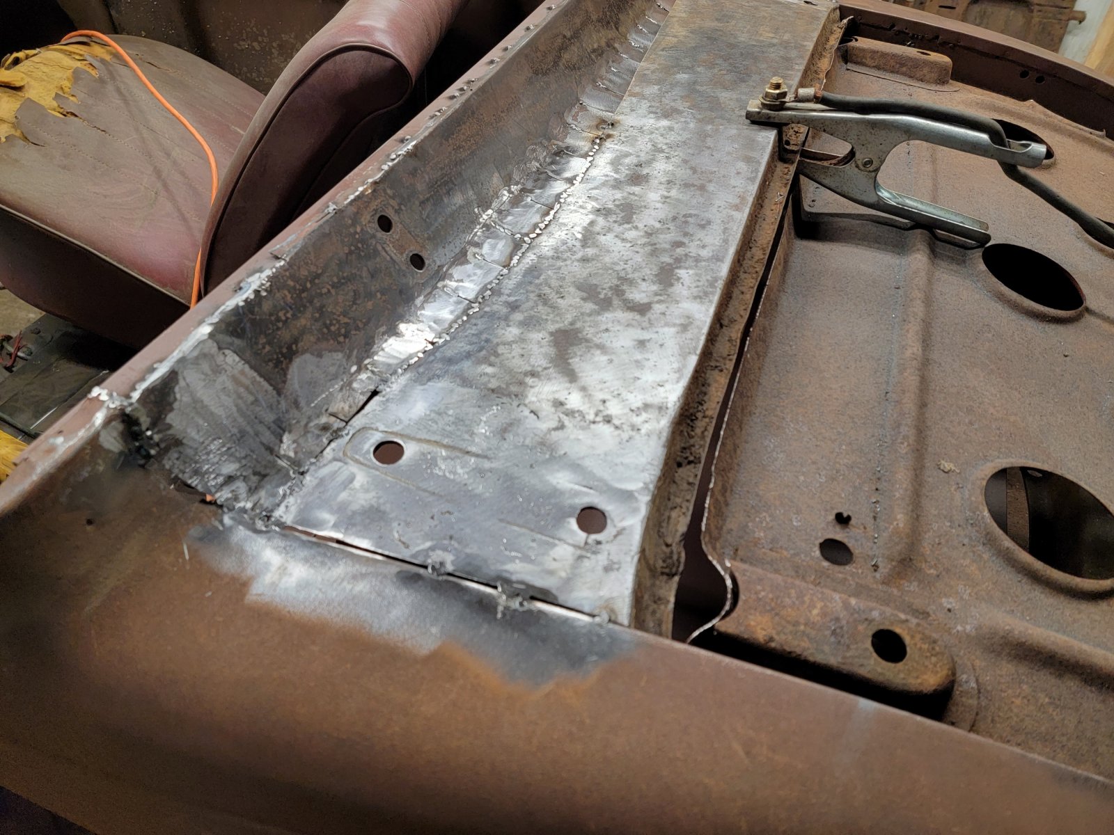

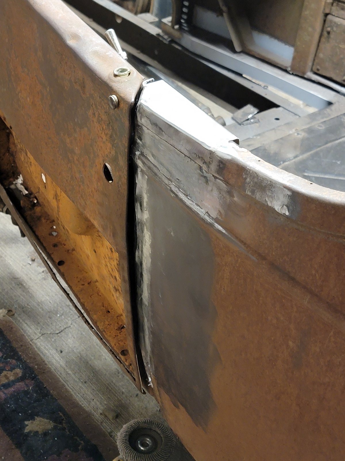

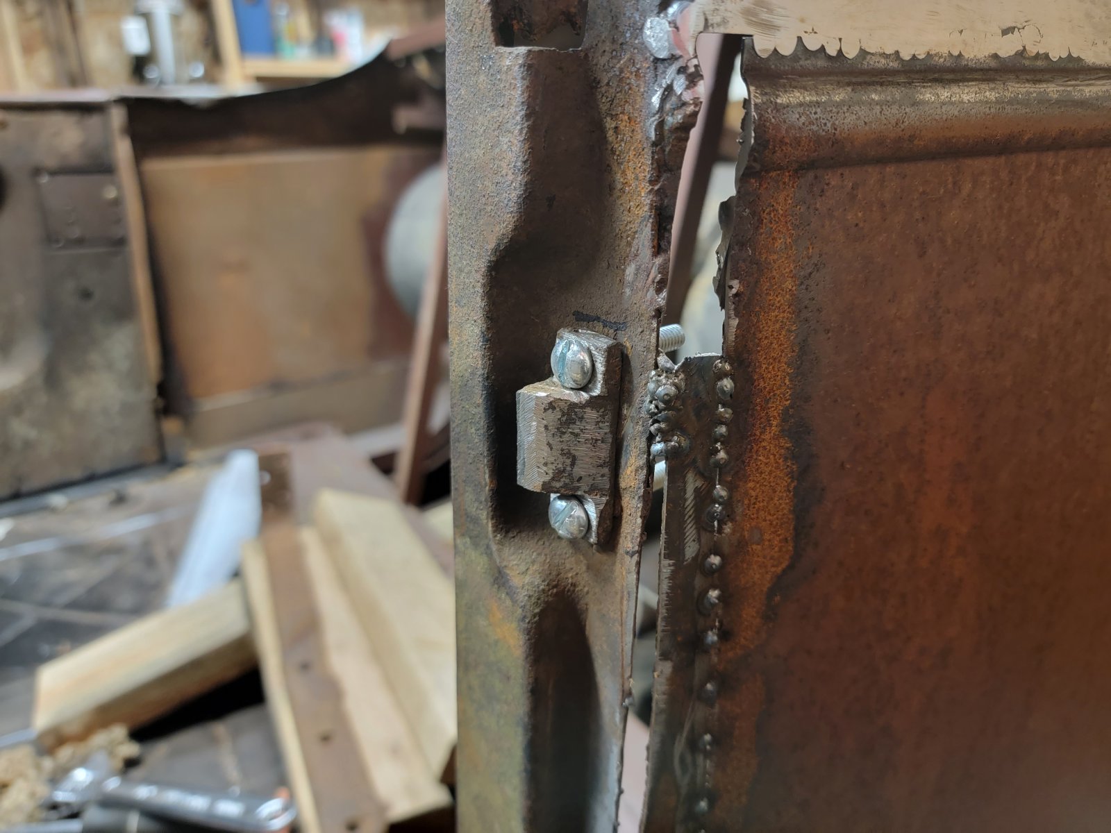

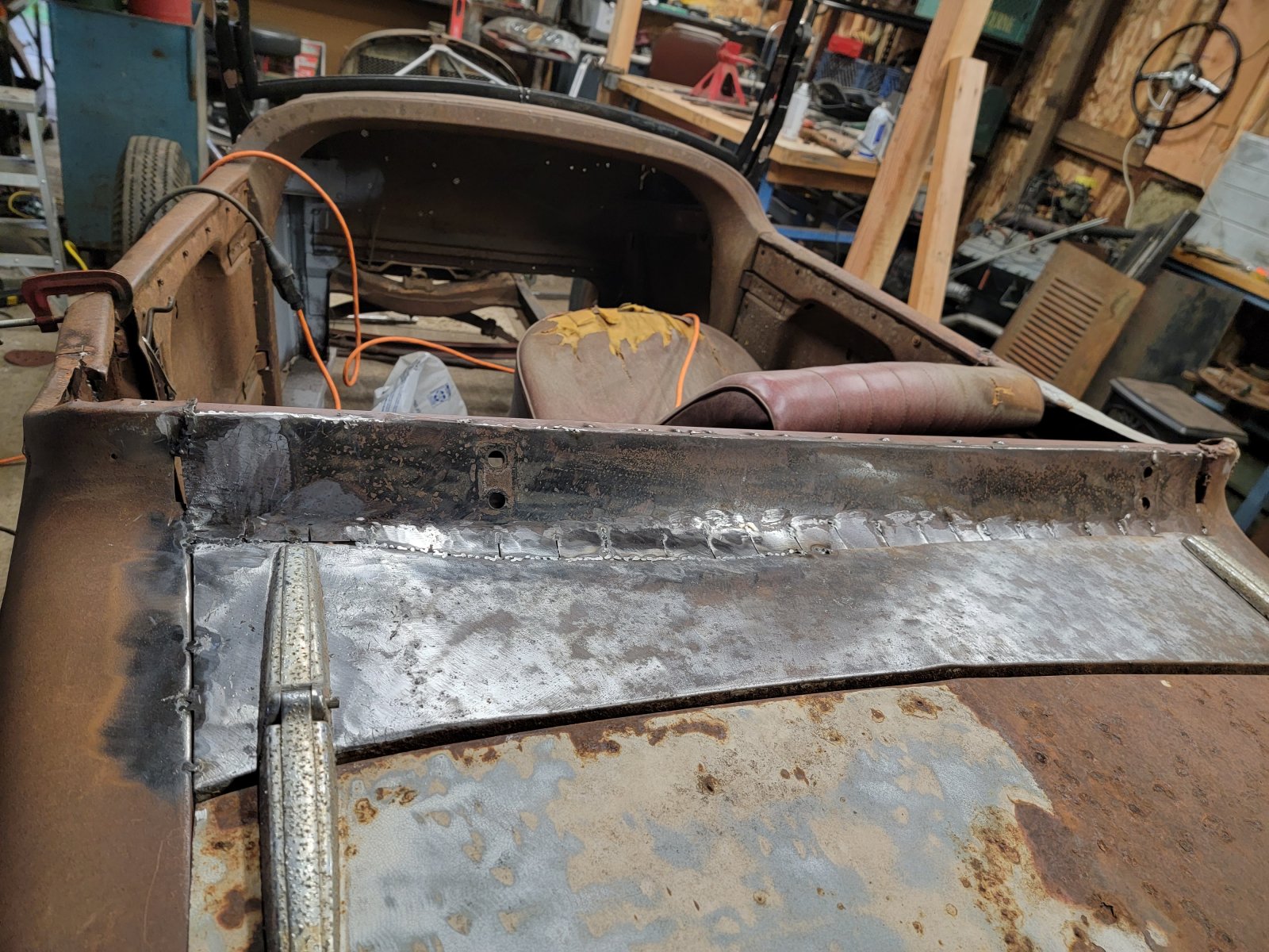

    Cpl more patches, b pillar is finally sturdy enough that the door latches on its own when you slam it now instead of having to hold the latch open. Will obviously need a little more grinding and sanding but you get the idea. I also lowered the b pillar to match the door height. It was about 1/4" proud before 20230124_095402.jpg 20230124_095027.jpg

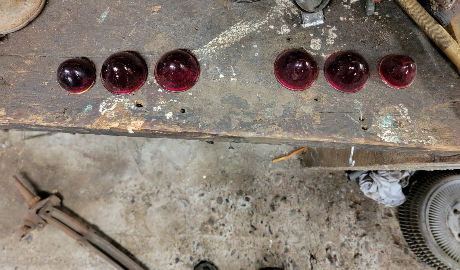

    Have a tail light plan, going to run these 6 beehives, 2 bigs and a little each side. All 6 lit as tail lights but dual filaments so I have brakes and turn sigs 20230216_120930.jpg
    Will likely french em 3/4" too

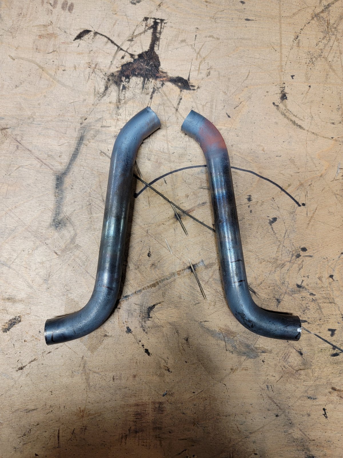

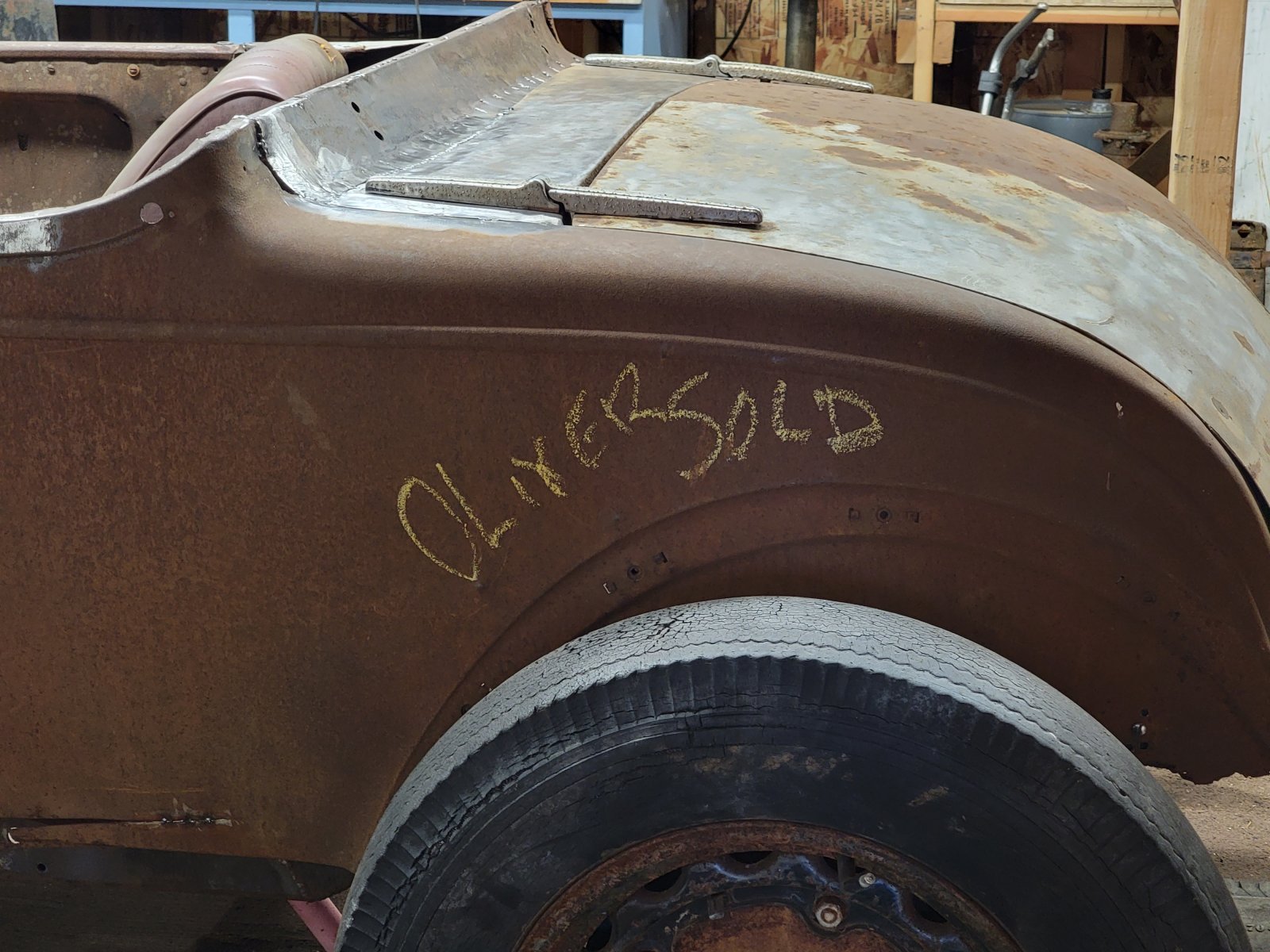

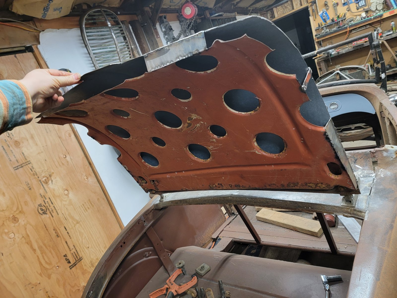

    Little more progress today, temp mounted my split bones (will weld eventually) 20230223_122605.jpg 20230223_122559.jpg also started work on the trunk lid!
    Love that 49 lincoln inner structure, looks like a custom dimple die setup

    Snuck back out and made more progress. It is slowly becoming a trunk lid! 20230223_182250.jpg 20230223_182148.jpg
    Once I get the basic structure solid, I will pull it off and make it pretty! 20230223_180218.jpg
