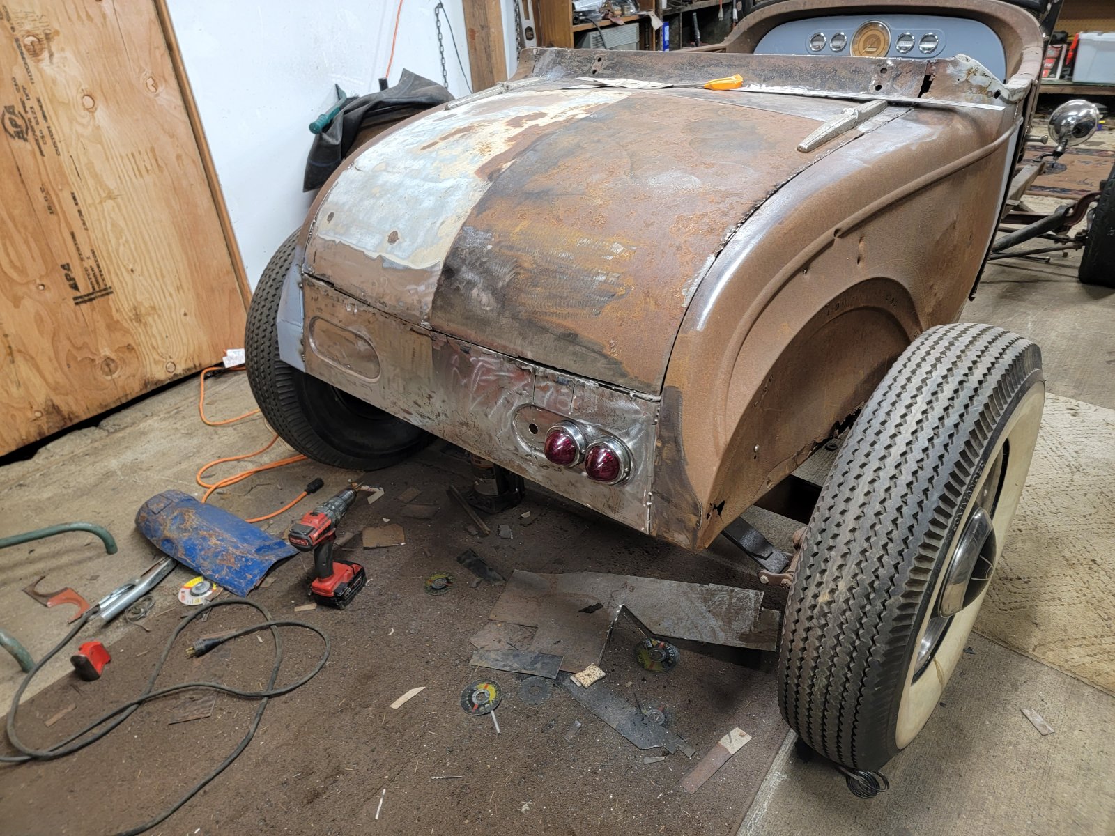

    Tacked in my tail light panel to see how itll look... glad I did! Cpl things to fix! 20230402_144438.jpg 20230402_144453.jpg 20230402_144532.jpg Gettin there!

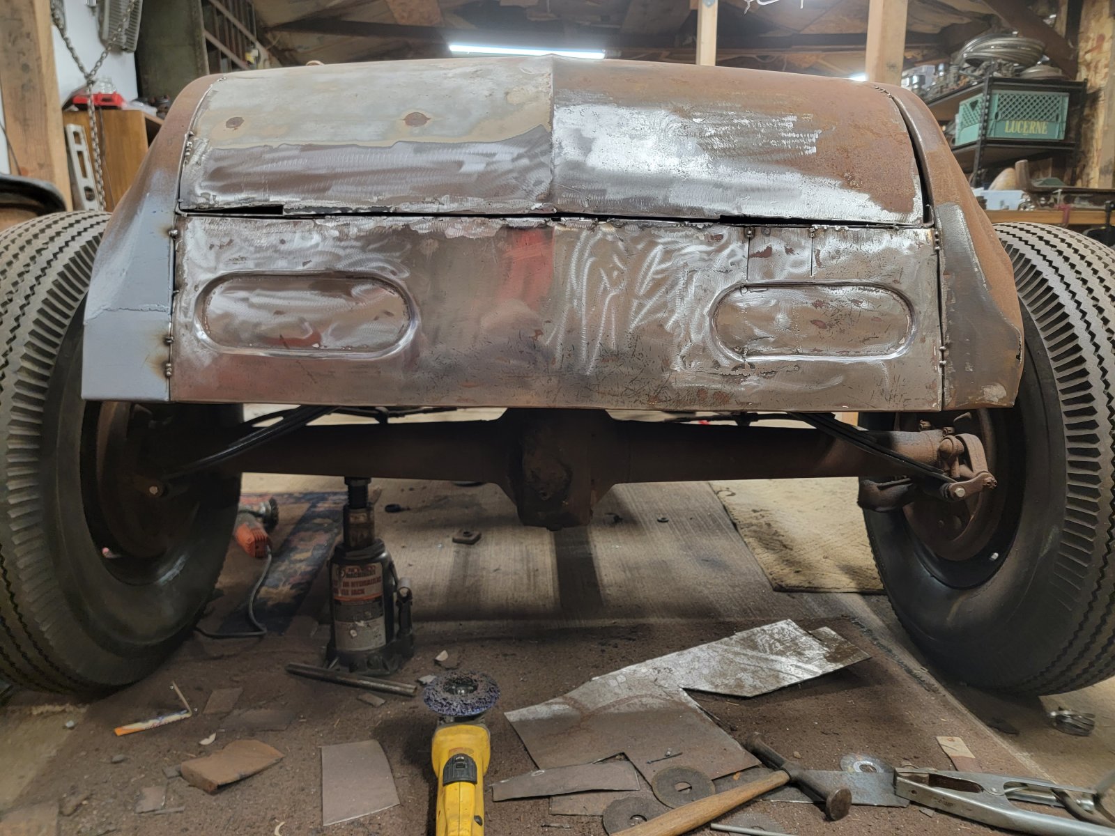

    Did a little tail light fitting....need 4 more yankee 975 housings... 20230411_203710.jpg 20230411_203720.jpg 20230411_203725.jpg

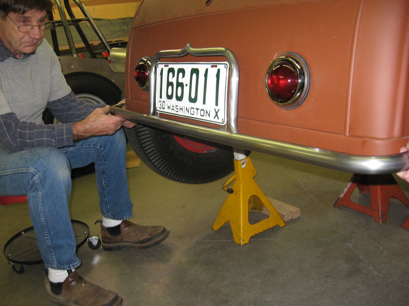

    With the peak in the deck lid, that peak in the rear bar would match up nice. I know a guy in Oregon that could help with that. IMG_1568.JPG
    Six Ball, rod1, EVL401 and 5 others like this.

    No way! I have a screenshot of that exact nerf bar, was gonna do something like that and wraps around the tail lights. I dig it! Getting an argon bottle and stainless wire

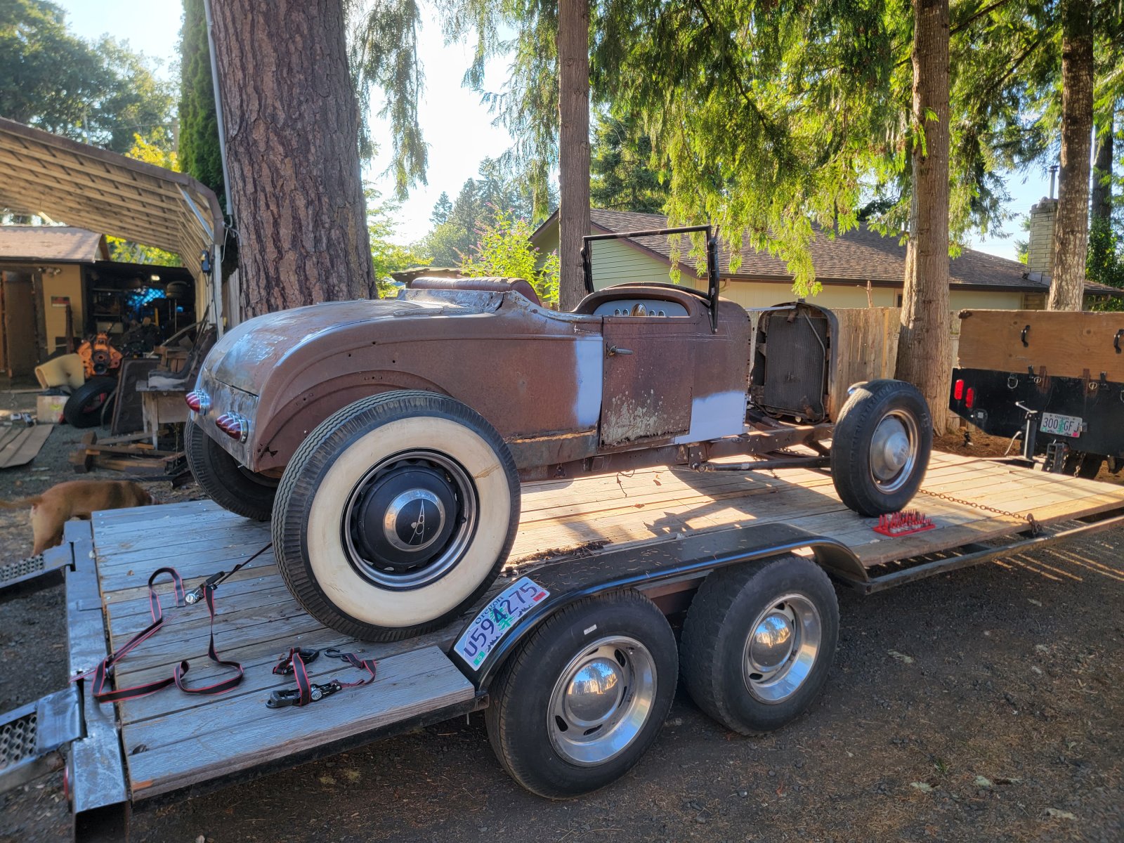

    Score!!! Got this 36 banjo as part of a trade with an open drive conversion only problem is, it came with a bad*** little 59ab 60 over bore just needs a cam... big part of me still wants to run the lincoln 337 but i have a 39 trans in a tub in the corner.... decisions decisions 20230416_103704.jpg

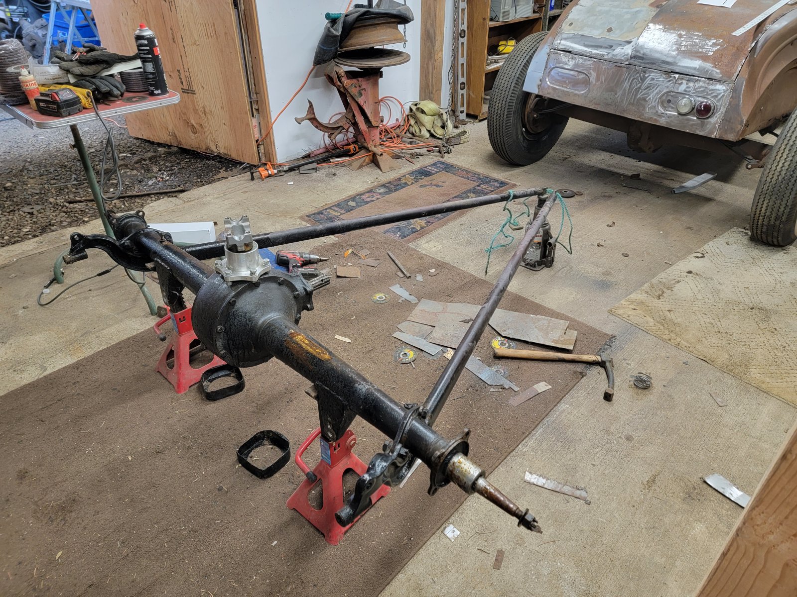

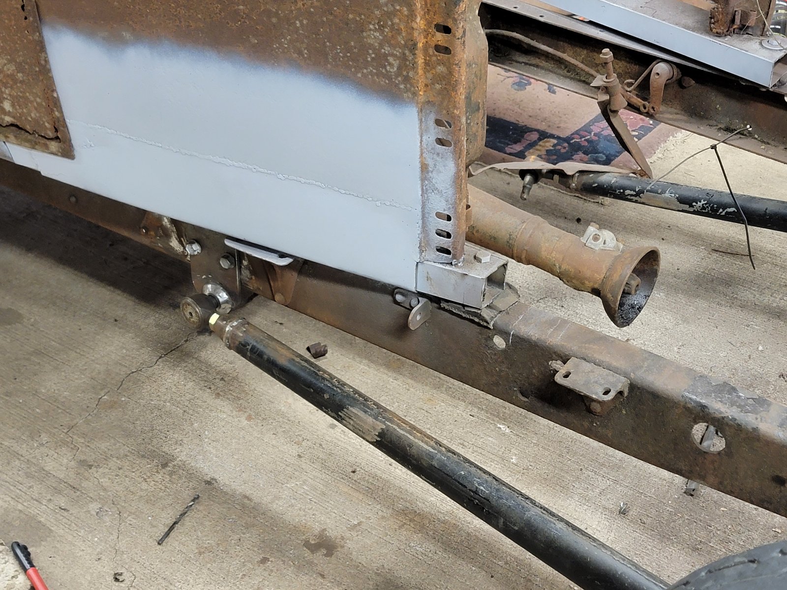

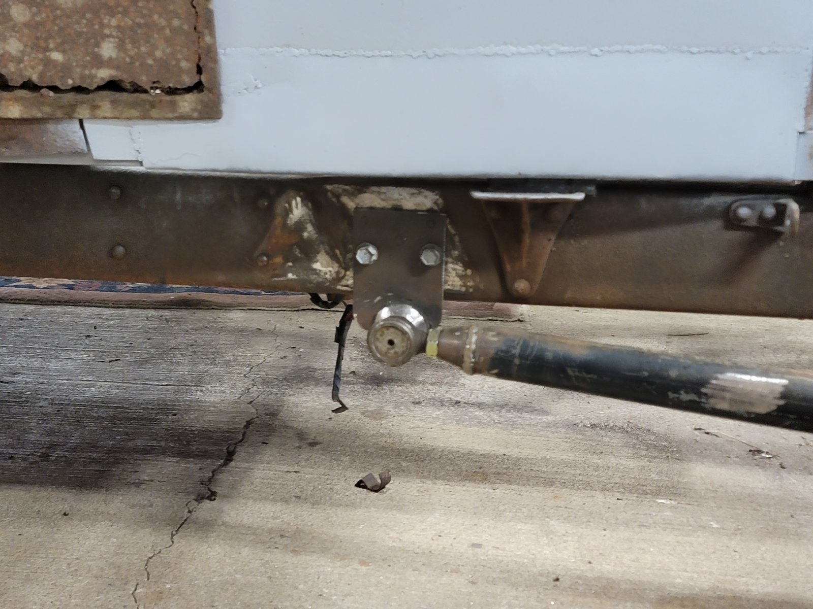

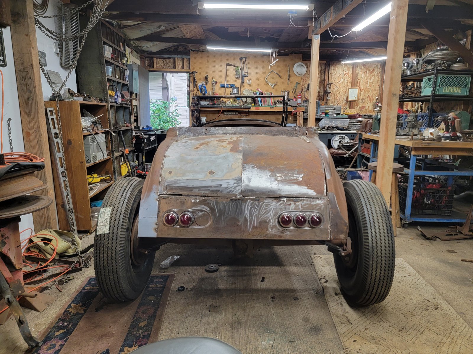

    Thinking at this time is I am going to run the bones and a single torque arm. Also planning on shortening the bones and using a front wishbone ball and mount much like this image I stole from one of stripers posts back in 2008 Screenshot_20230420-234102_Chrome.jpg
    Just seems likely to have the best ride and with the torque rod, should be plenty strong.
