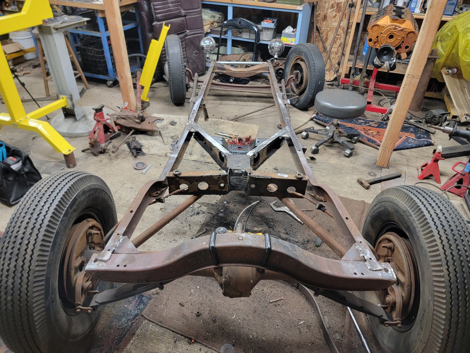

    Got two gussets in today, rear bones in, x member is set enough to stick the engine and trans in to check my work! Exciting stuff! 20231107_164323.jpg 20231107_164016.jpg

    Well...its in...which is cool! Its also 4-5" too far back haha who was holding the measuring tape!? Still progress and Ill get her moved forward Screenshot_20231110-205004_Gallery.jpg 20231110_173530.jpg

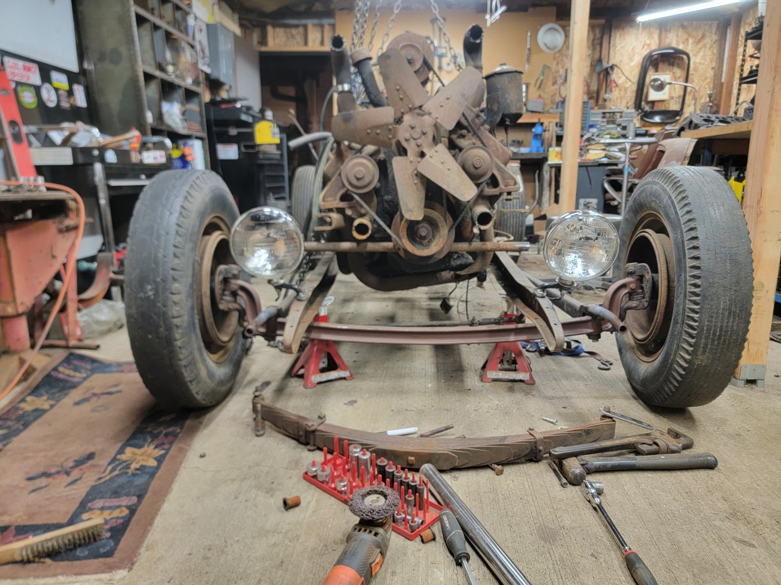

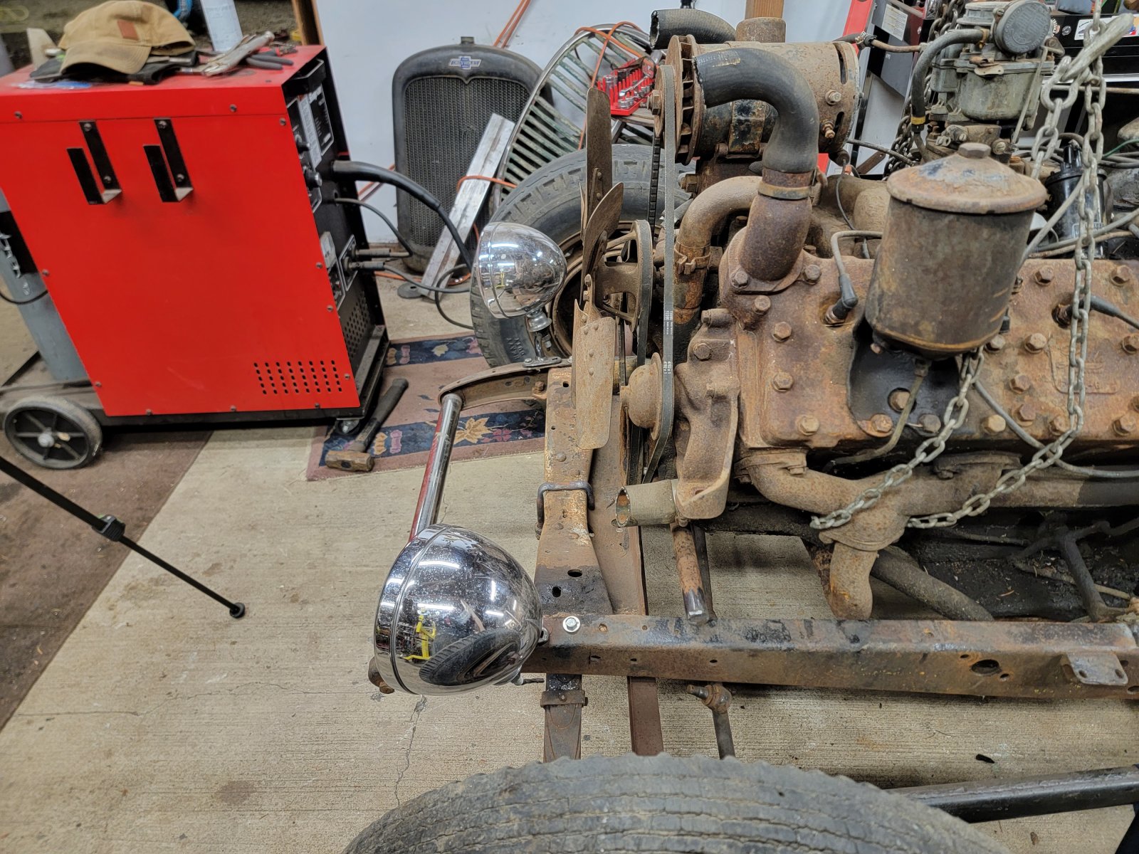

    Thanks for the kind words! The repairs were quick and painless and are now complete (mostly) 20231111_193535.jpg red mark indicates firewall location...

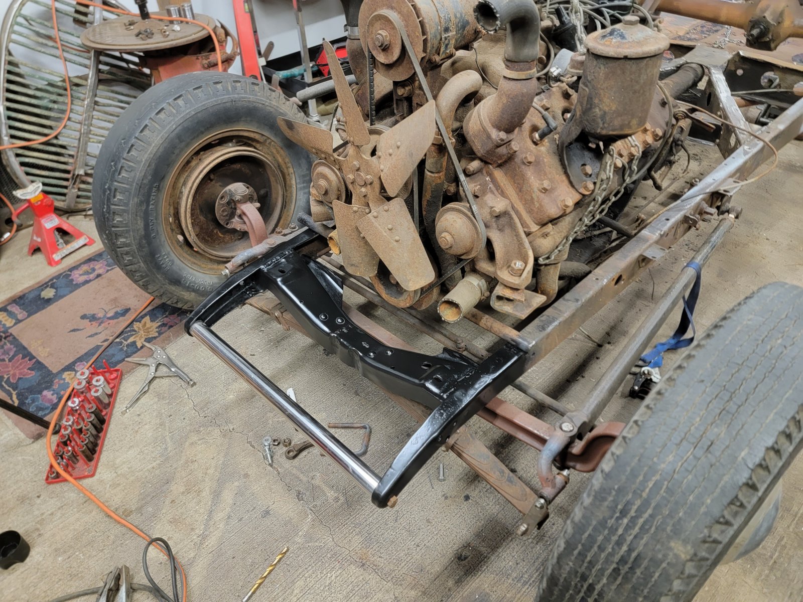

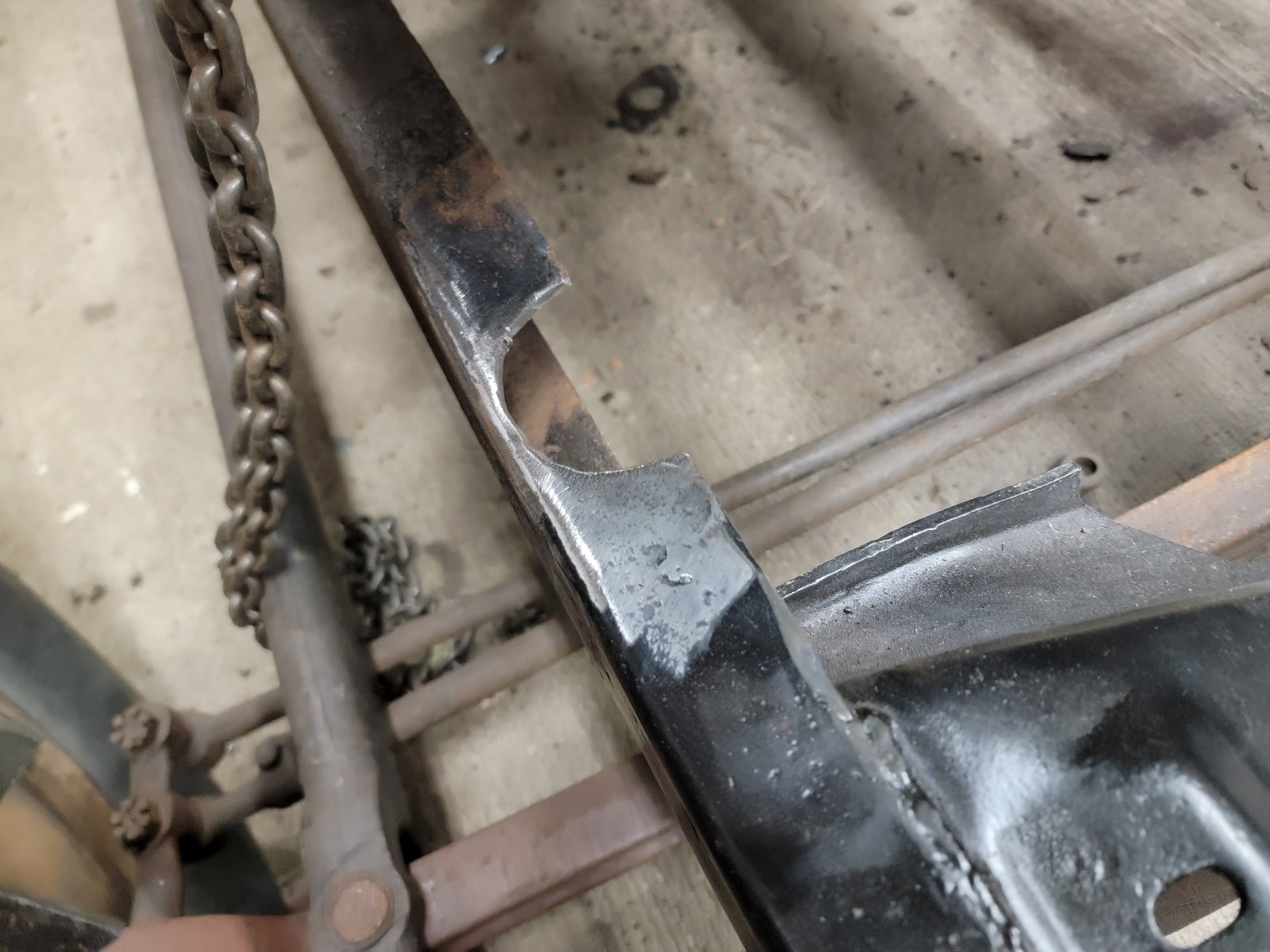

    oliver westlund

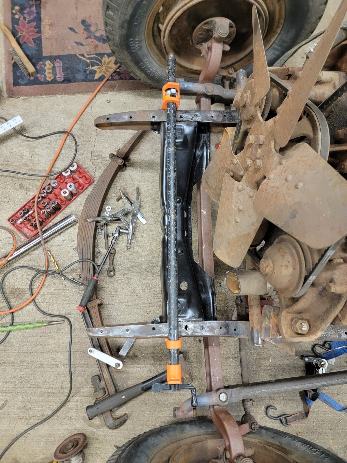

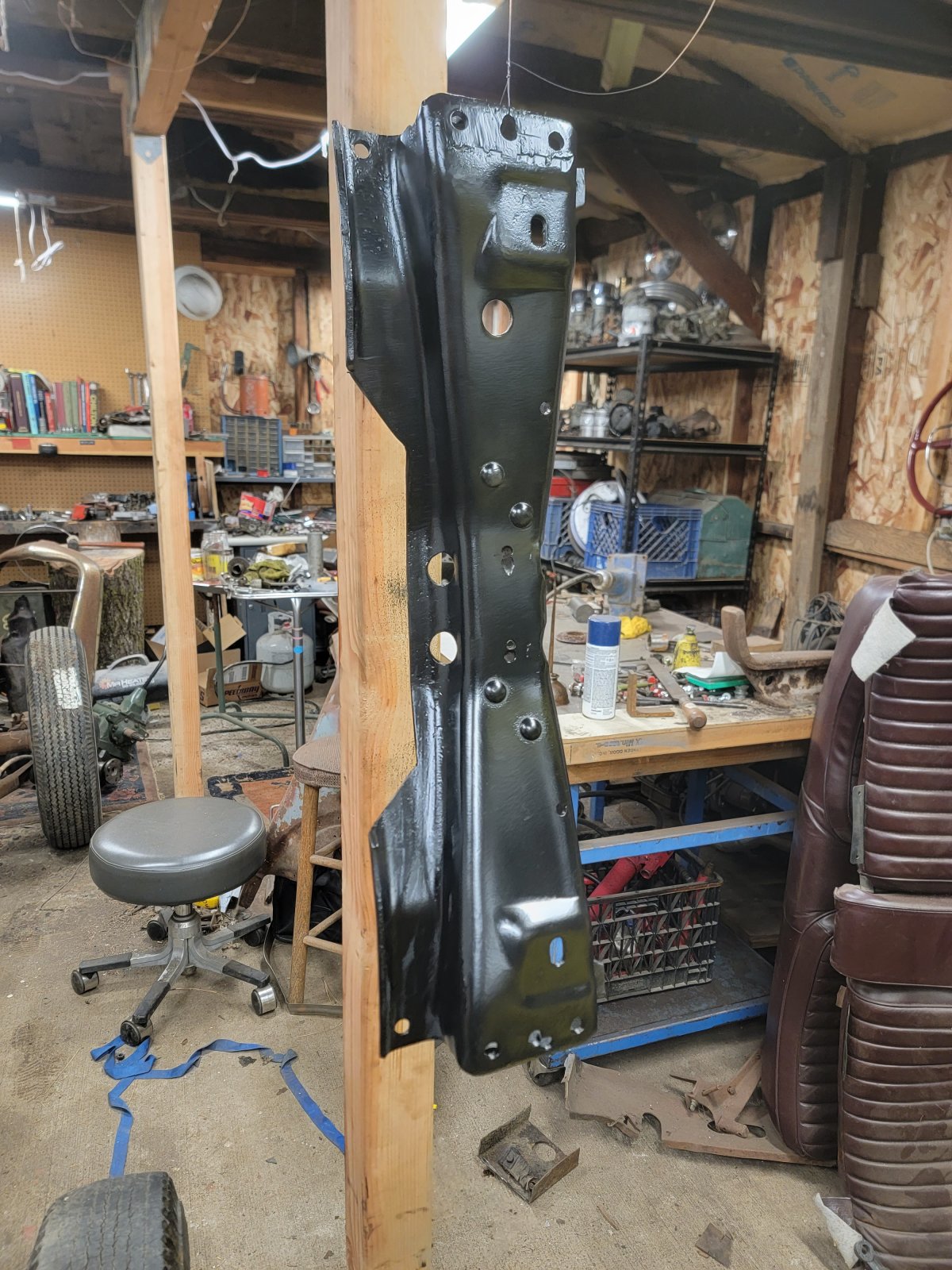

    Pulled the front crossmember tonight. V-grooved then welded the crack, cleaned it up and painted it. I also cut a relief into it to clear the front axle
    20231112_201342.jpg While it was out I also heated and bent the front spring hangers to the appropriate angle

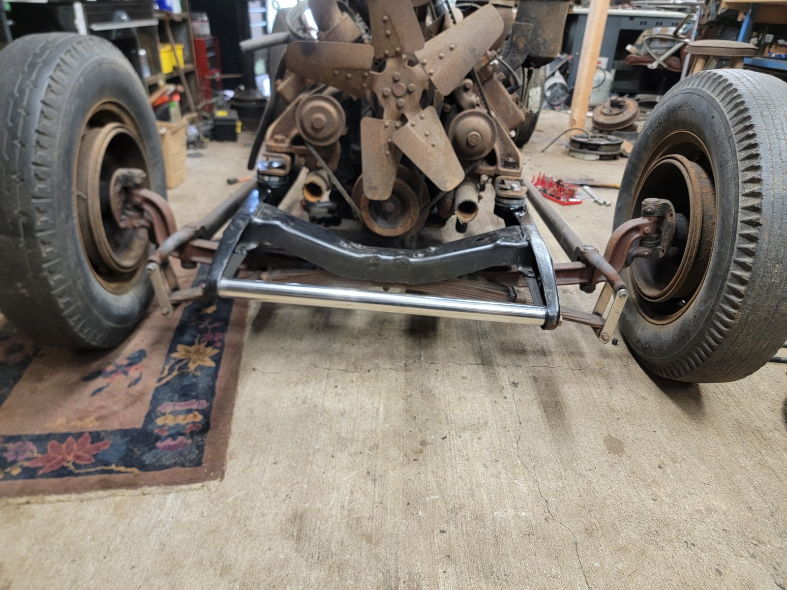

    Got up this morning and found myself in the shop in my pajamas fitting the front crossmember. ADHD is a ***** haha 20231113_101908.jpg
    I also slid the crossmember forward about 3/4". Made sure it was even but figured I could use the extra fan clearance and it wont hurt anything

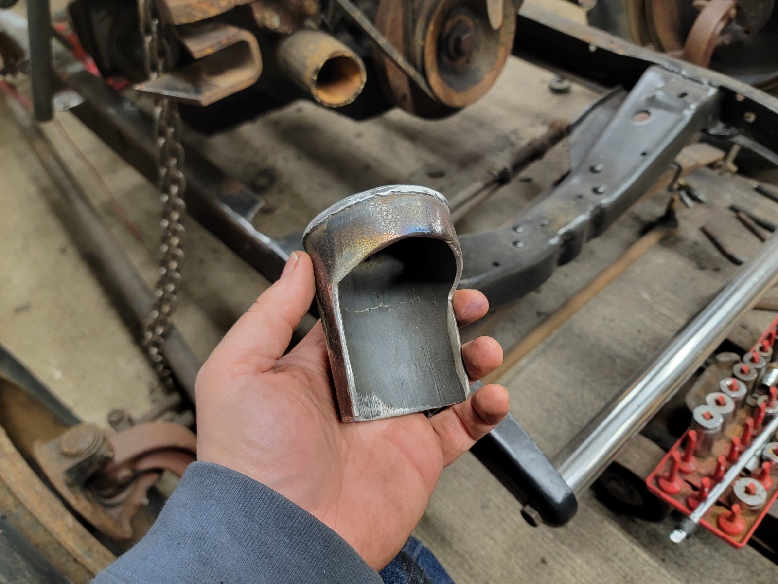

    Its been a hiatus! It all started with me being sick for a month. Coughing myself to death. Went to gnrs. Had a blast! Checked out the mcgee roadster at the petersen and now that I am back I am finally getting back to work on the roadster. Jumped into the motor mounts. I ordered some biscuits and they just arrived so might as well! I started with a hunk of model a torque tube...
    Cut my shape and then welded a cap on that I made out of a flat piece of frame that I ran a hole saw through at the appropriate size
    Its all coming together perfectly! Plus its dripping with tradition 20240218_205648.jpg
