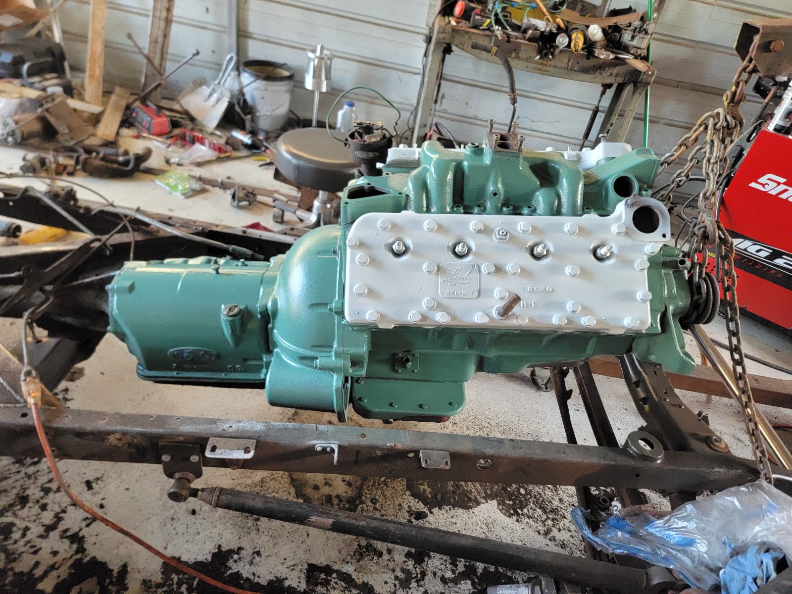

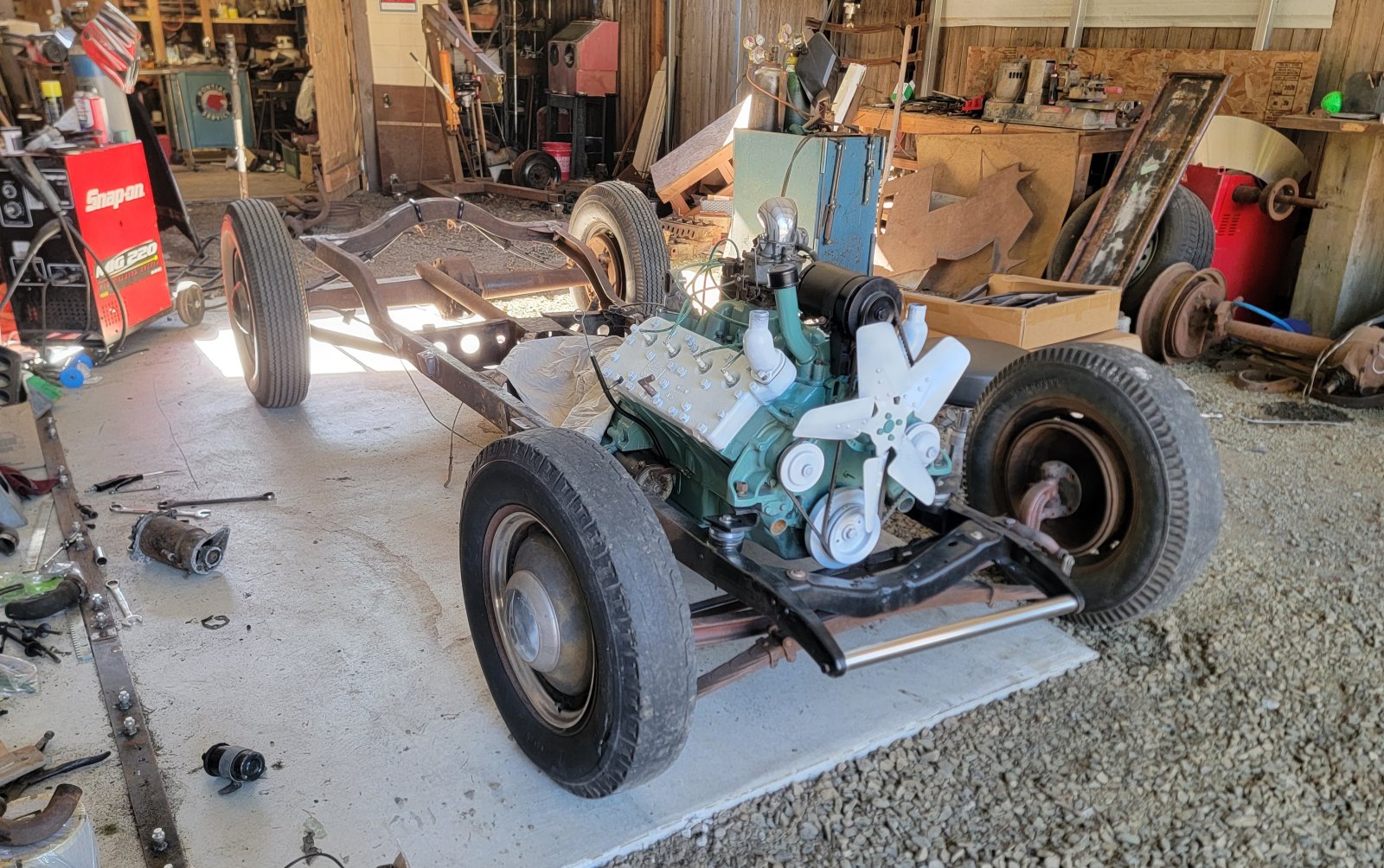

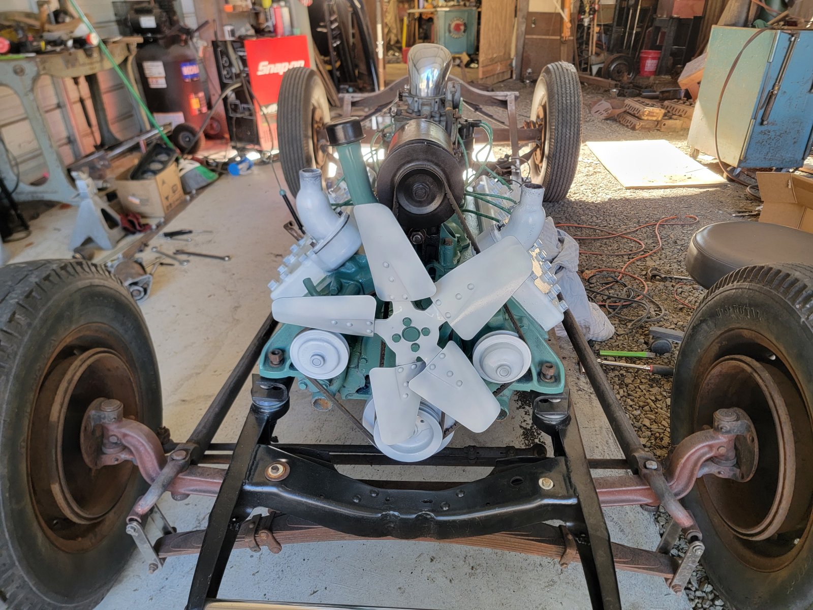

  12. oliver westlund
    Joined: Dec 19, 2018
    Posts: 2,859
    oliver westlund
    Engines a wrap for now! On to the frame!
    Squablow, Tim_with_a_T, brEad and 3 others like this.

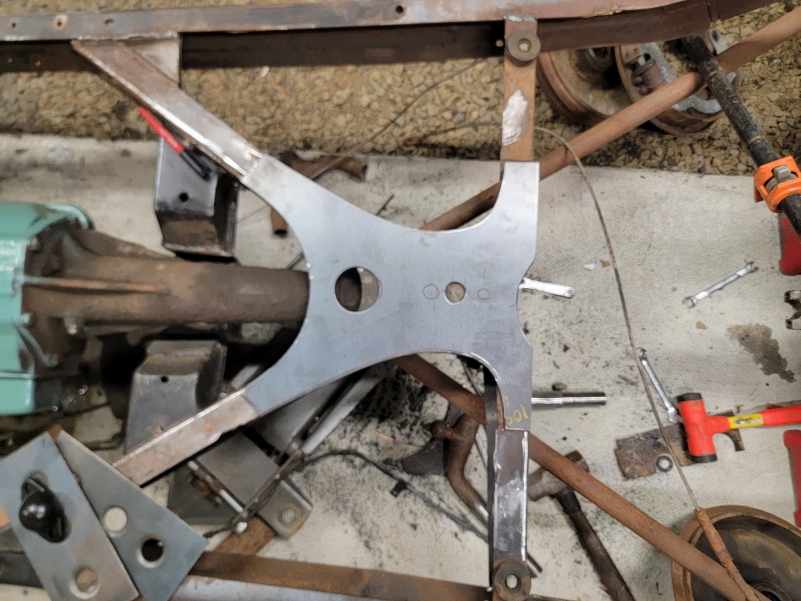

    Roadsters k member which is the modified 49 lincoln x member is getting beefed up and finished
    You can see the leg on the left is the final product minus paint of course. It is also getting a bigger and thicker top plate.
    With how abusive Skratch and hudson Joe have been telling me these 337s can be to a model a frame I want to make sure I dont cut any corners
    brEad, Squablow, Six Ball and 5 others like this.
  20. Six Ball
    Joined: Oct 8, 2007
    Posts: 6,979
    Six Ball
    from Nevada
    Nice! That should do it.

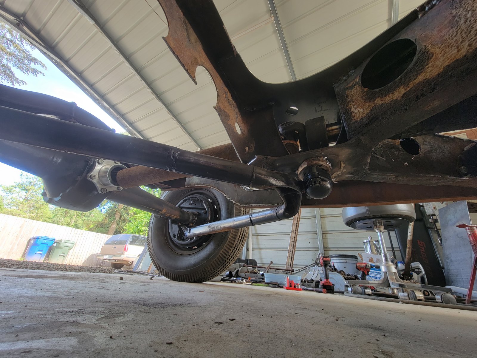

  23. oliver westlund
    Posts: 2,859
    oliver westlund
    Today I got this far!
    That was before deciding the bushings were toast and the bushing hole on the drivers side is ovaled. The rear wishbone needed shortened an inch as well.... so its all apart again and parts have been ordered...one step forward ten steps back. At least it will be right!
    Squablow, Six Ball and dwollam like this.

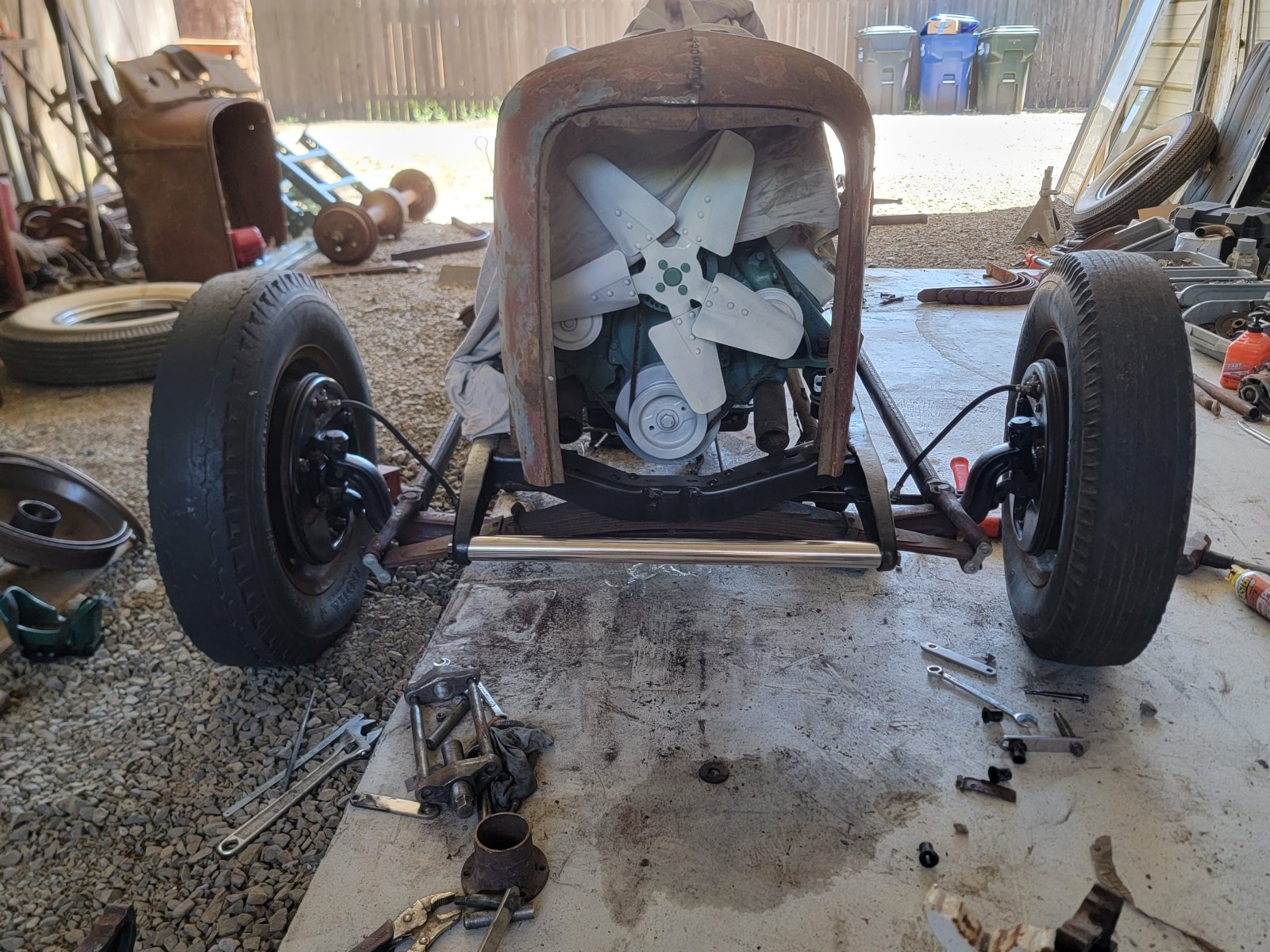

    Started boxing the frame today. 20240605_192829.jpg Got the front brakes all rebuilt and wrapped up, rears need some parts 20240604_105805.jpg
    Also got the rear wishbone wrapped up and the rubber ball on. Checking things off the list! 20240605_122045.jpg
    I put some standard shackles on and am waiting to see... so far I think the front looks too high now. Wont know for sure until the rear is in place and can push it outside and stand back to get a good look

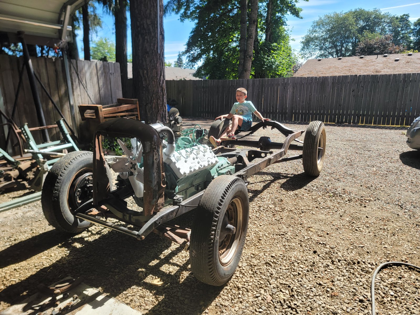

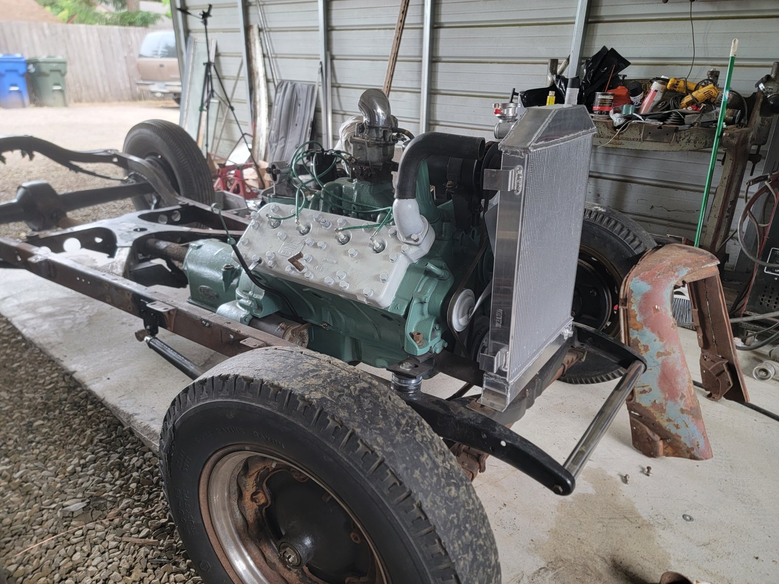

  25. oliver westlund
    Posts: 2,859
    oliver westlund
    Progress all over, rear end is in, spring packs together, rear bones are attached and seem to be working how I wanted. New bushings and shackles om the rear. Starting to come together! Has definitely had its share of struggles but that was somewhat to be expected with a car as outside the box as this one.
    Even started test fitting the radiator
    brEad, Squablow, dwollam and 2 others like this.
