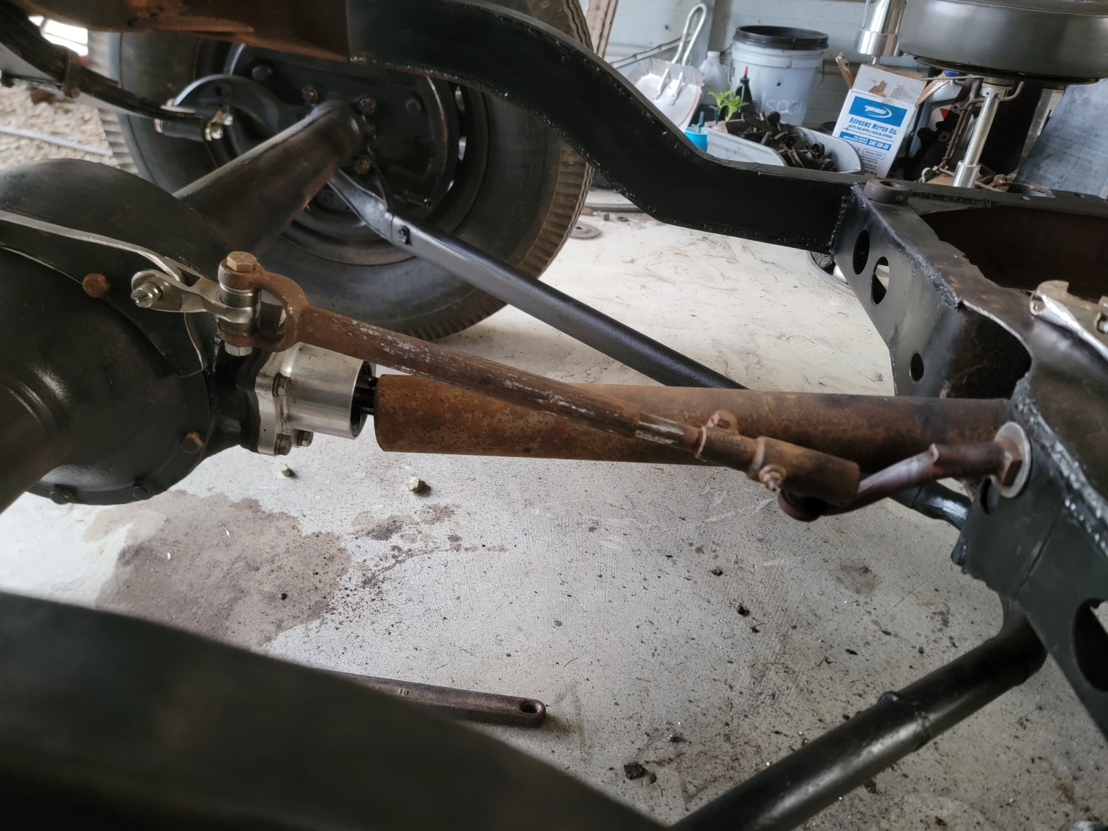

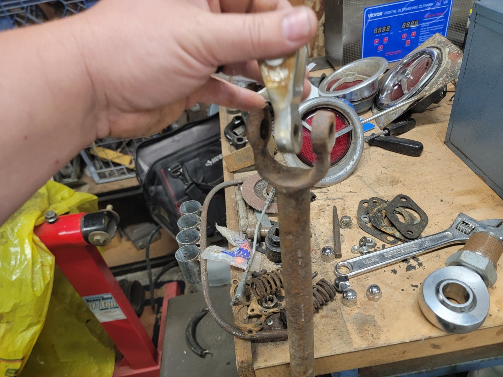

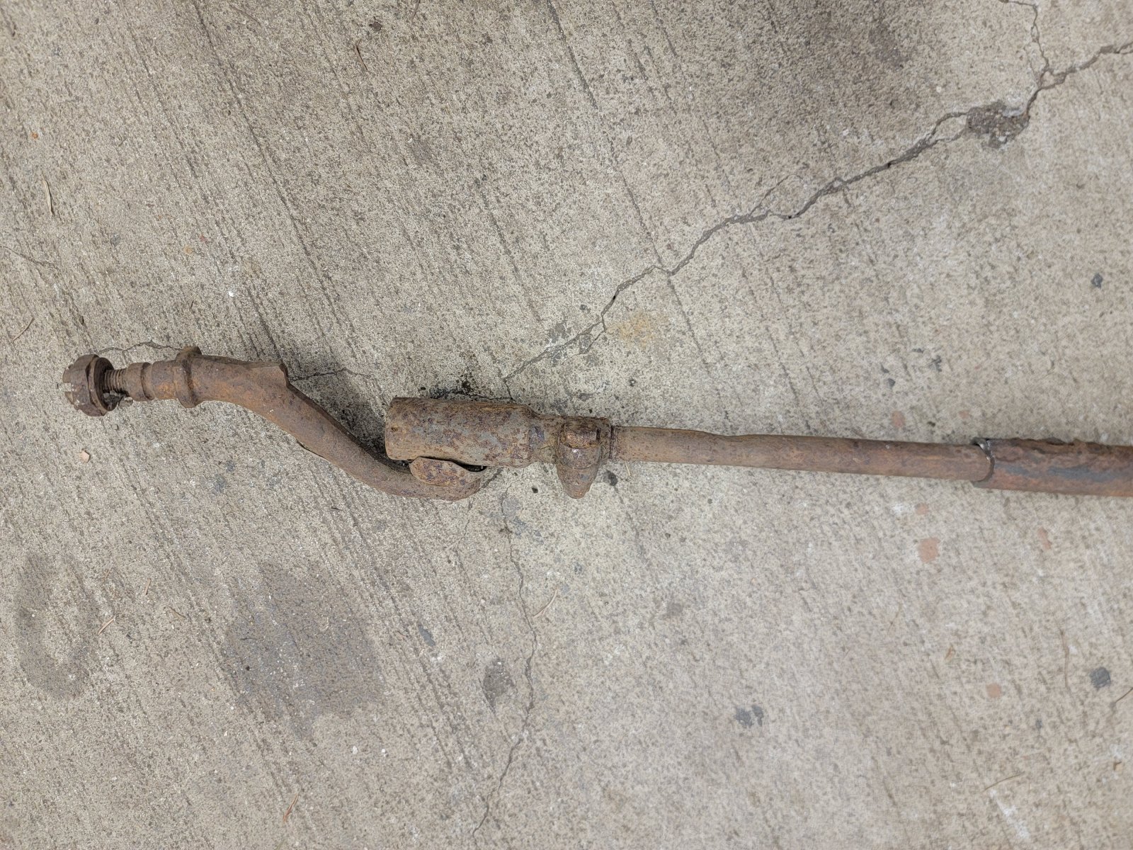

    Okay, so I got part of it done. I think enough so you will get the idea. Step one was finding the bar I wanted to use. I have a pile of em. I found a steering bar off of some 20s or teens car... 20240617_103452.jpg I already had this little stainless bracket (off of a sail boat I think) so next I had to make some bushings to center it. 20240617_103507.jpg

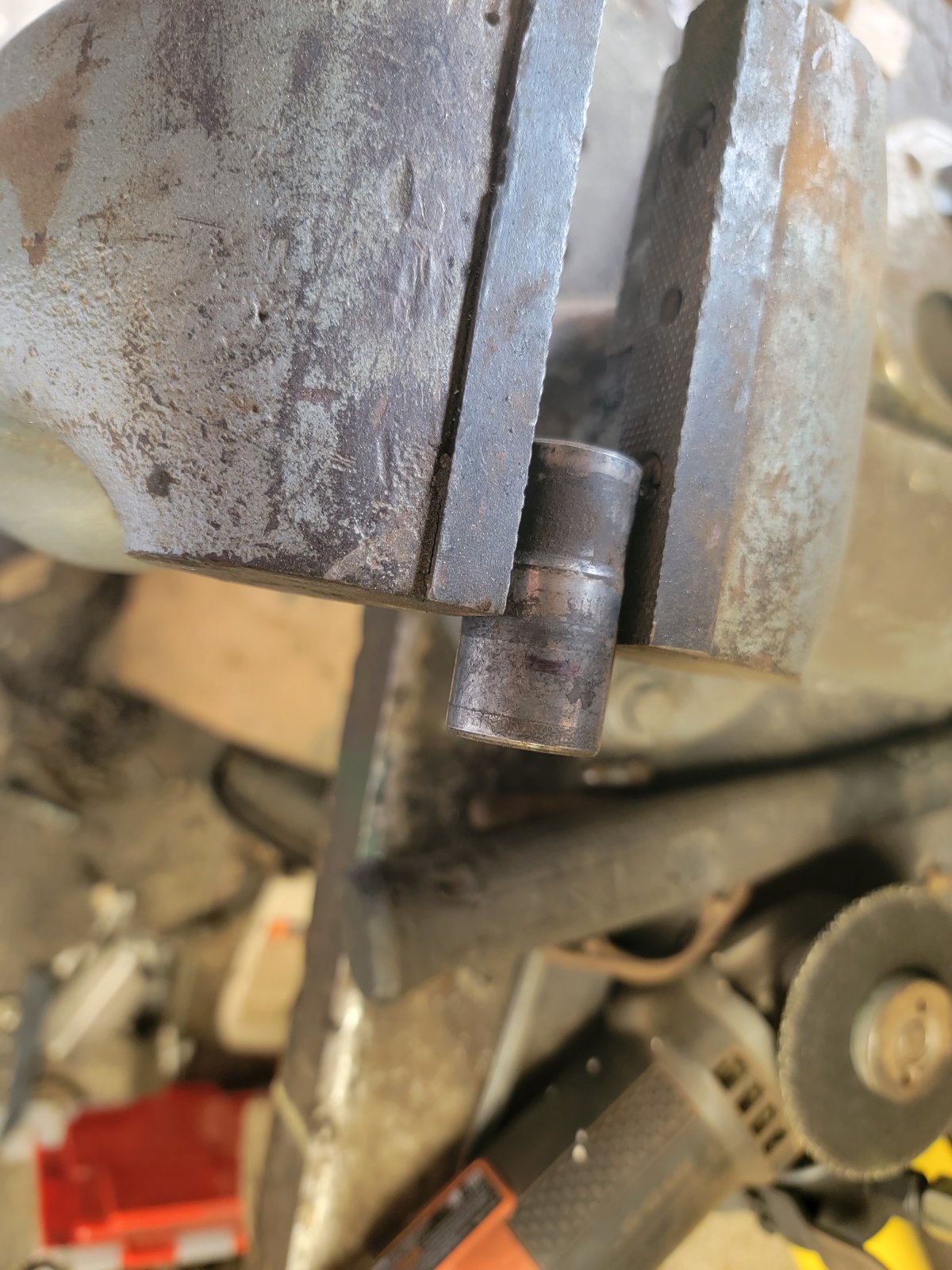

    I recently scored 150 poumds of hardware from a lawn mower repairman for 10 cents a pound so my bushing bucket is FULL! I found this one that matches the diameter of the grade 8 bolt I will be using. 20240617_103748.jpg
    Then just had to cut it down into the pieces I needed
    I flap wheeled em smooth and only needed one washer for an ideal fit.
    I started this bracket a while back that bolts to the top of the banjo center section that the bar will hinge off of. The joint allows up and down and side to side. The other end will have to allow some rotation to prevent binding. The idea is that the distance forward to back always stays the same blocking rotational torsion from breaking my bones

    Okay next segment on the same subject.. this ford drag link fits perfectly inside the other rod....lucky me!
    I'll drill a bunch of holes and rosette weld it in once I figure the length. It should allow rotation enough to eliminate any binding. In the mean time I made some progress on the center section mount.
    20240617_161513.jpg 20240617_161518.jpg 20240617_161539.jpg 20240617_161541.jpg
    All seems to be working out as planned and even better, I can drive that ford drag link down all the way essentially making it a solid shaft and beefing it up!

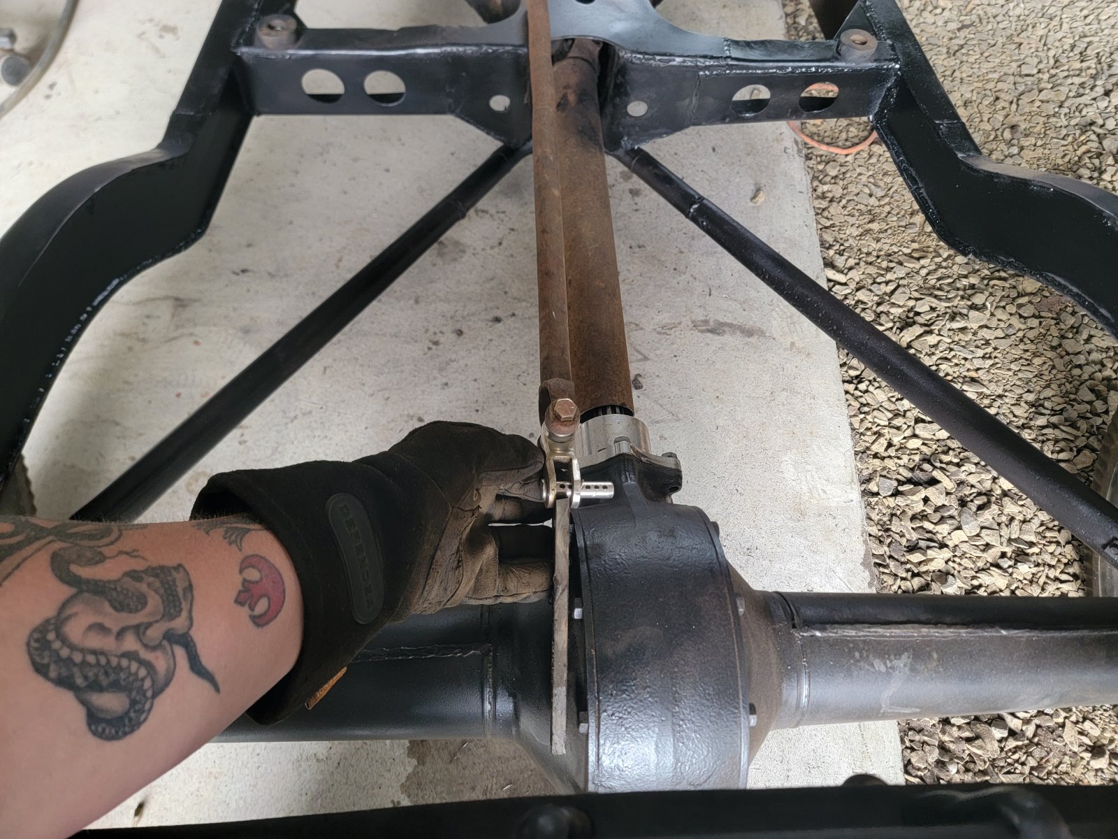

    Ended up switching it to the other side. Got it all mocked up
    20240617_191902.jpg I didnt like the spacing to the driveline so out came the torch...
    Now Im diggin it!
    Pinion angle isnt perfect but its doable..
    brEad and Six Ball like this.

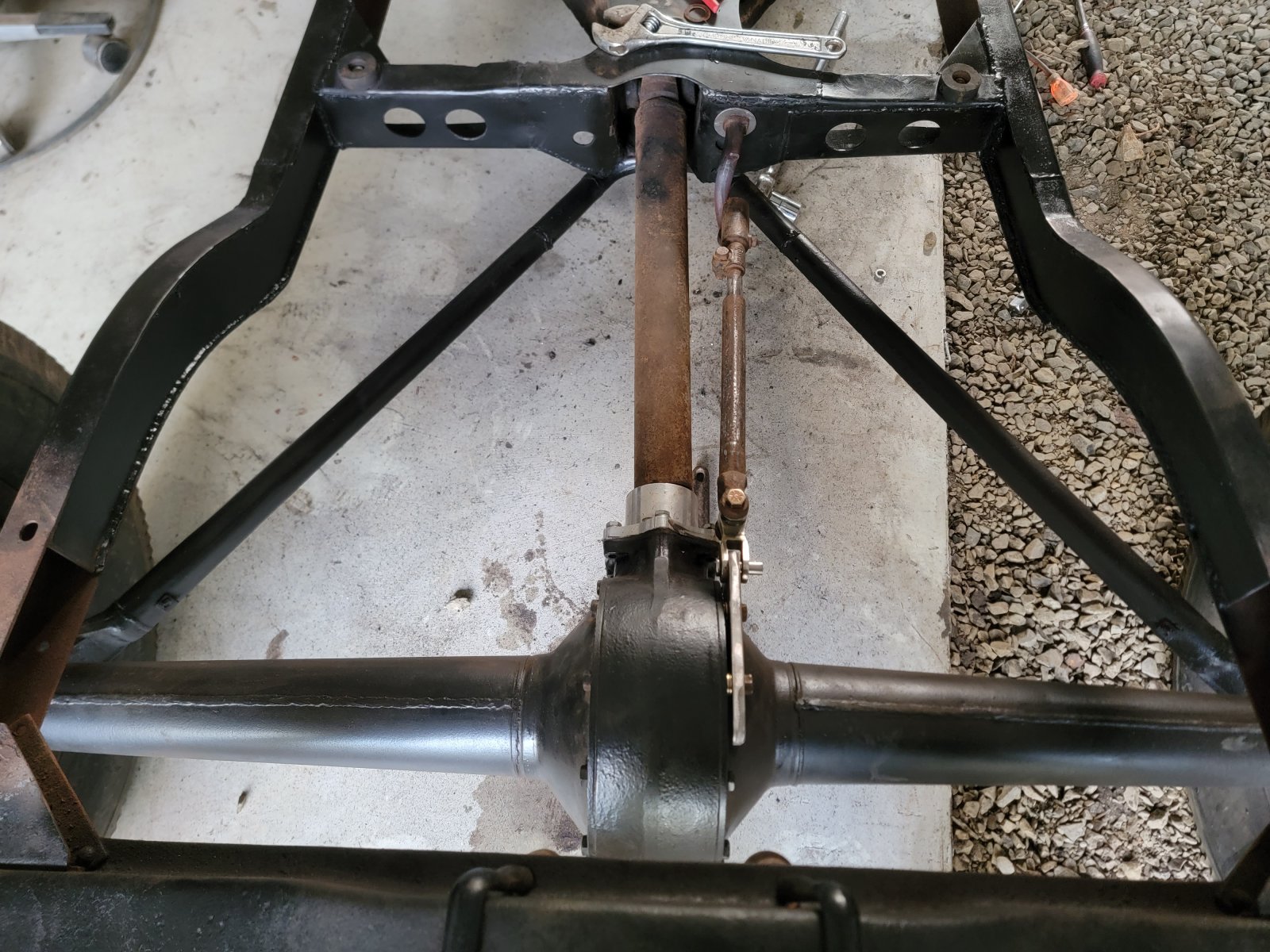

    Well.... after all of that I now see the bind I created. In the s**** bin it goes haha going to run the bar from the center section down to the bones. Solves everything!
    Squablow and Six Ball like this.
  6. oliver westlund
    Joined: Dec 19, 2018
    Posts: 2,839
    oliver westlund
    Heres the solution. Bar from the center section down to the bones. No binding and no rotational torque

    Yeah the floor curves with the sweep of the frame evenly across so anything under the rails is under the floor

    The way it mounts now it doesnt need to allow any movement because its a part of the fixed triangle of the axle and the bones. I just got too ambitious to be different before.

    It prevents torsion. Made sense in my head haha

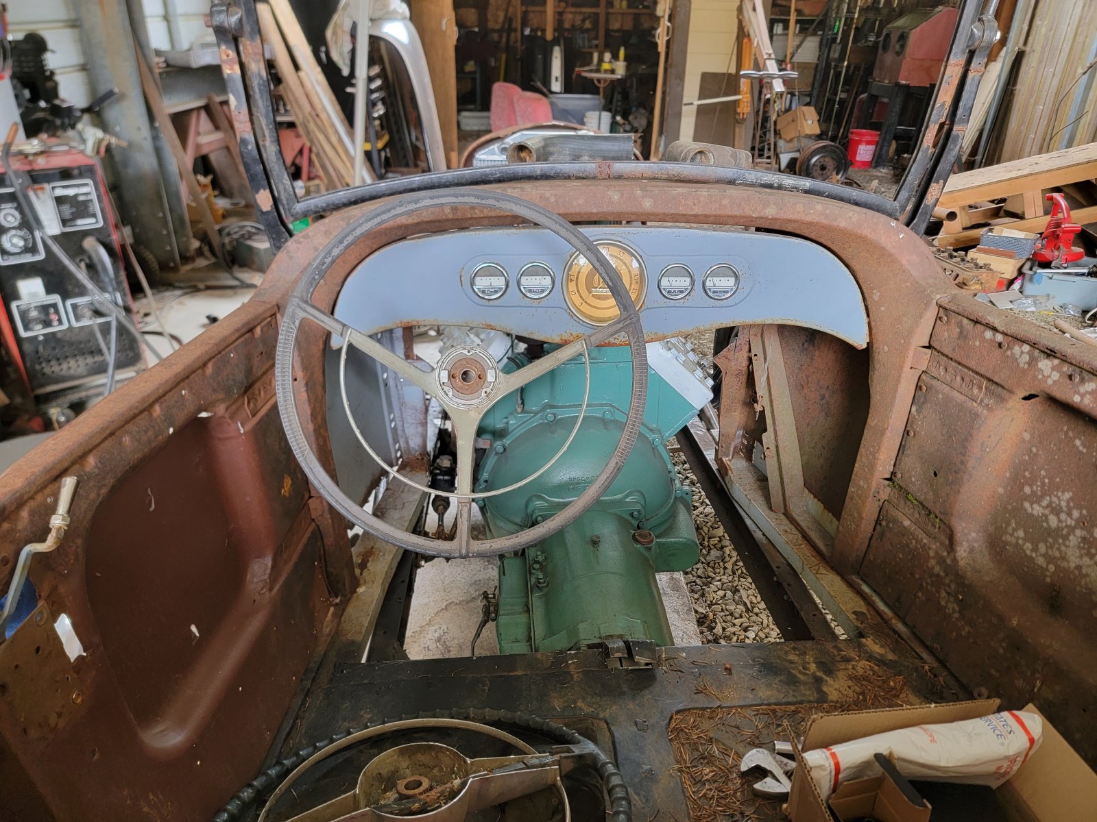

    Big progress day! Today the roadster got steering and a brake pedal/master cylinder! Been a long time coming and there is ZERO extra space next to that 337! 20240621_165155.jpg
    Steering is courtesy of a 39 olds, saginaw cross steer box
    Brakes were harvested from the same 49 lincoln and only slightly modified
    Its really starting to look and feel like something

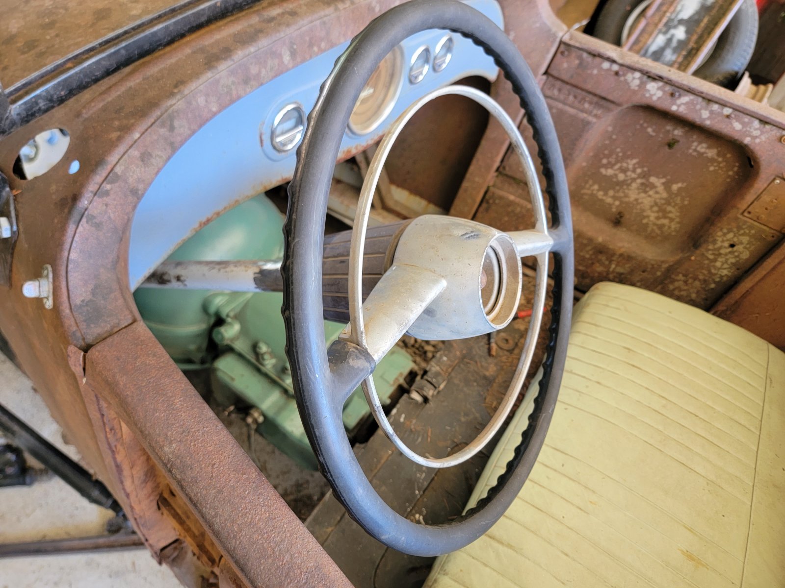

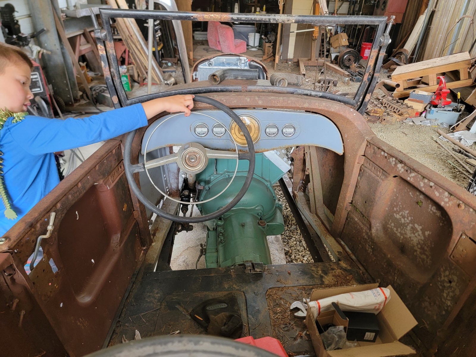

    Wheel choice was made! 52 nash it is... will have a video coming out soon on how to adapt a steering column

    Can always put a smaller ring on it. The nash wheel is a touch big but its cool!

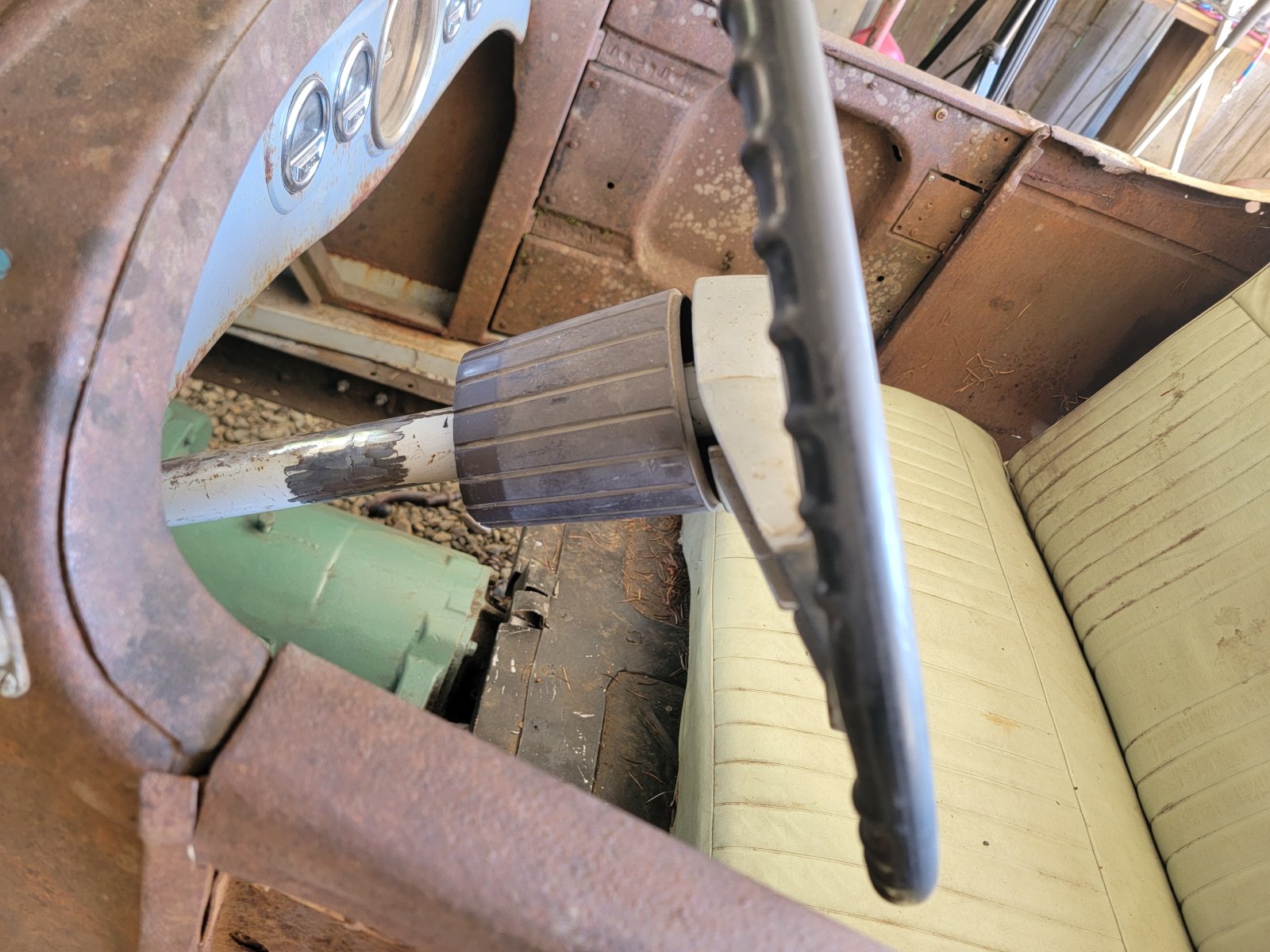

    I robbed the trim piece from the 62 ford column to make it all look a bit more intentional

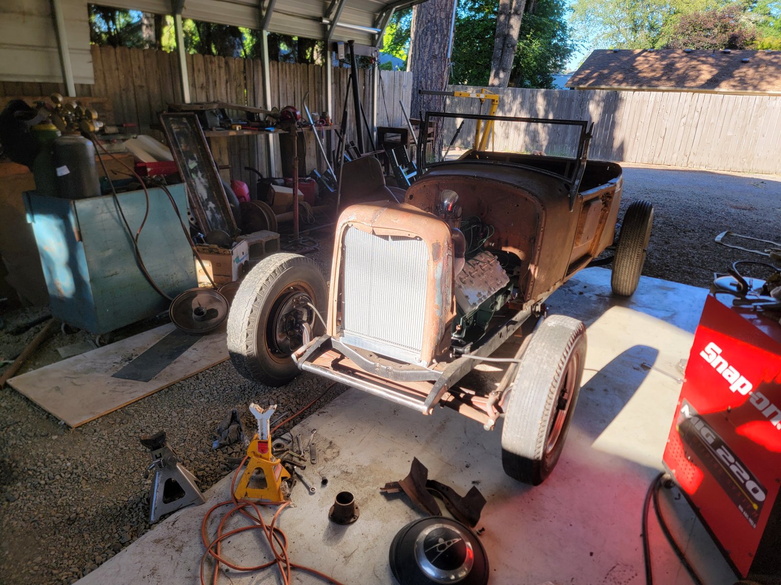

    Chins on the shell...
    Also got the headlights on. Also decided on a new name. Scott had the brilliant idea to stick some oliver tractor badges on it and call it an oliver. I dig it...so it shall be!
