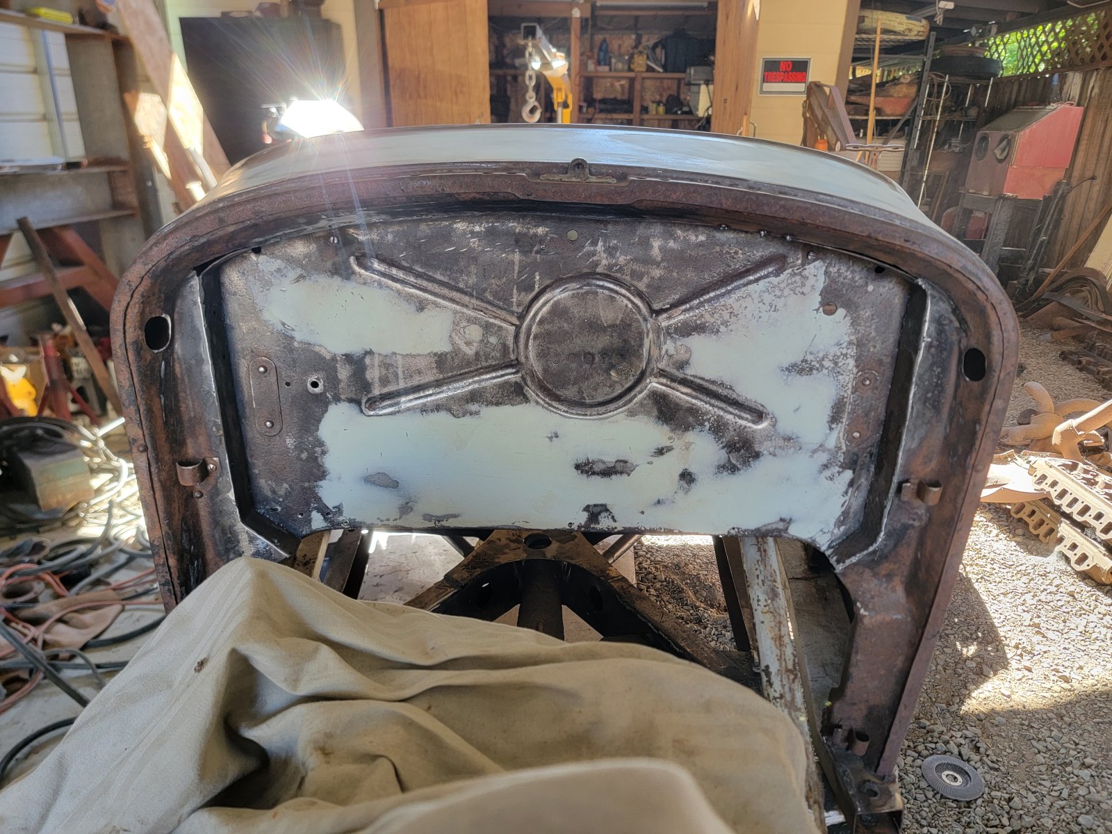

  3. oliver westlund
    Joined: Dec 19, 2018
    Posts: 2,839
    oliver westlund

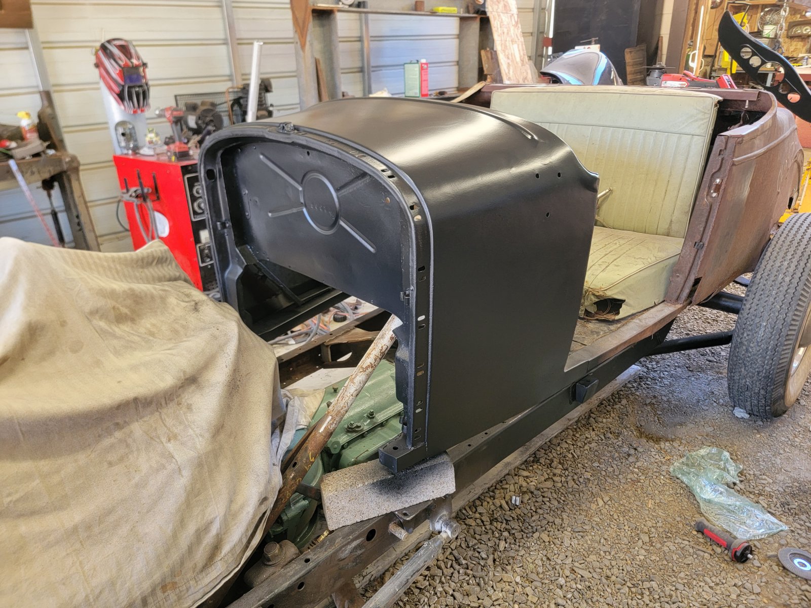

    Firewall is recessed and going in. Hopefully shooting primer tomorrow!
    osage orange, brEad, scotts52 and 2 others like this.

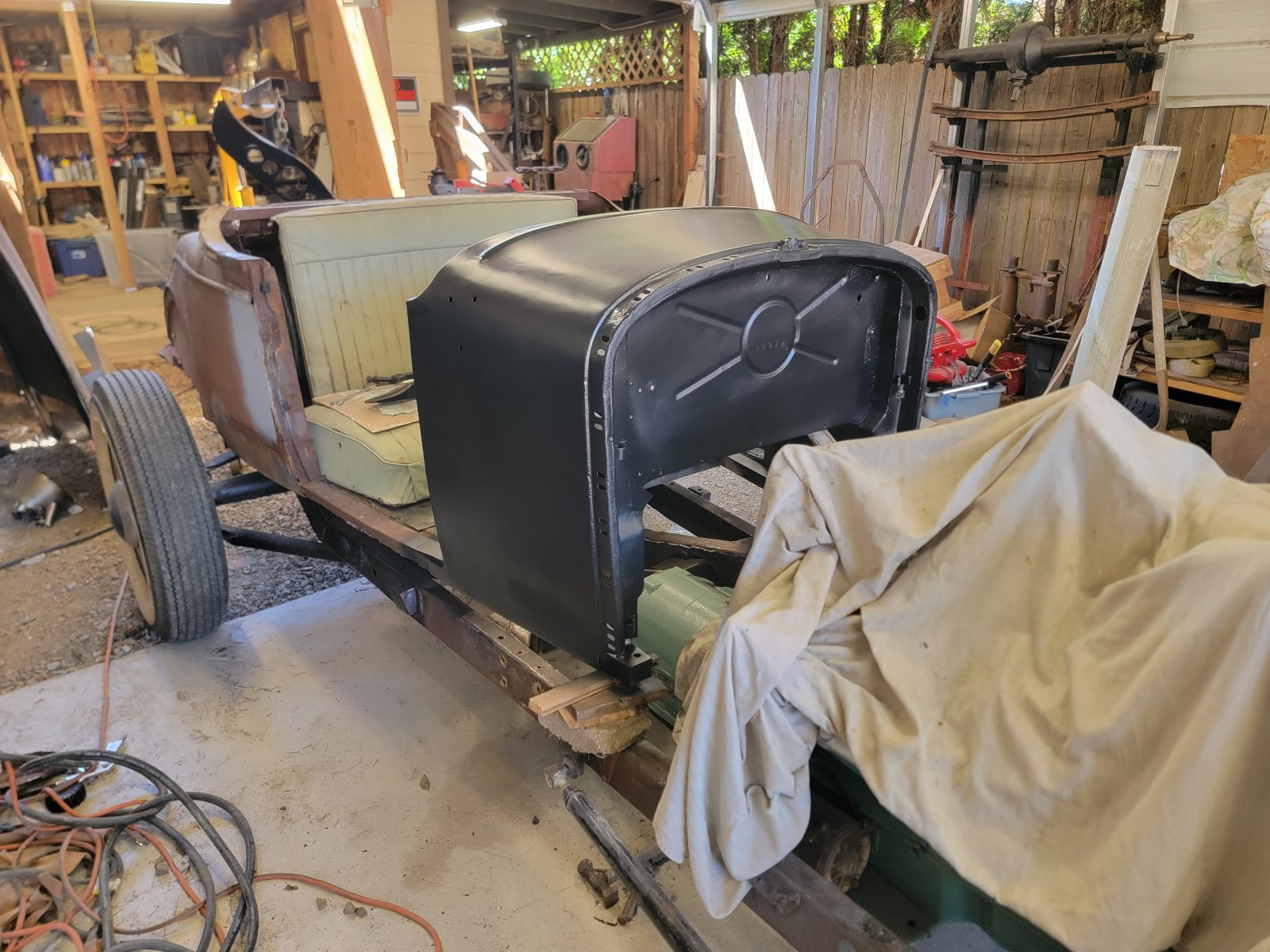

  4. oliver westlund
    Posts: 2,839
    oliver westlund
    Primers on! Gonna stick it back together and get a windshield template made! 20240704_145933.jpg 20240704_145921.jpg 20240704_145937.jpg 20240704_145942.jpg

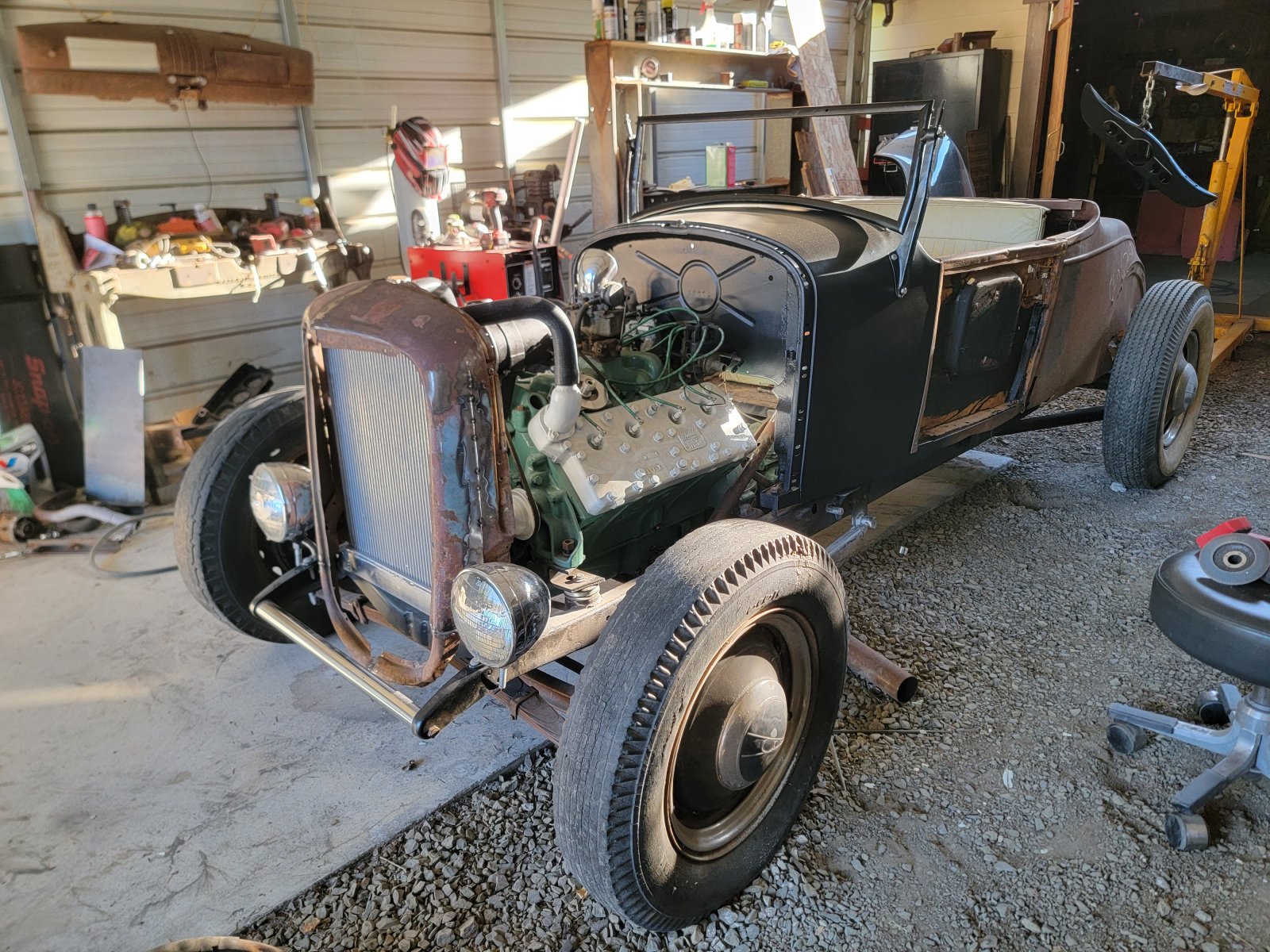

  6. oliver westlund
    Posts: 2,839
    oliver westlund
    Thanks! Here are a cpl more
    Feels good having it look like a car again

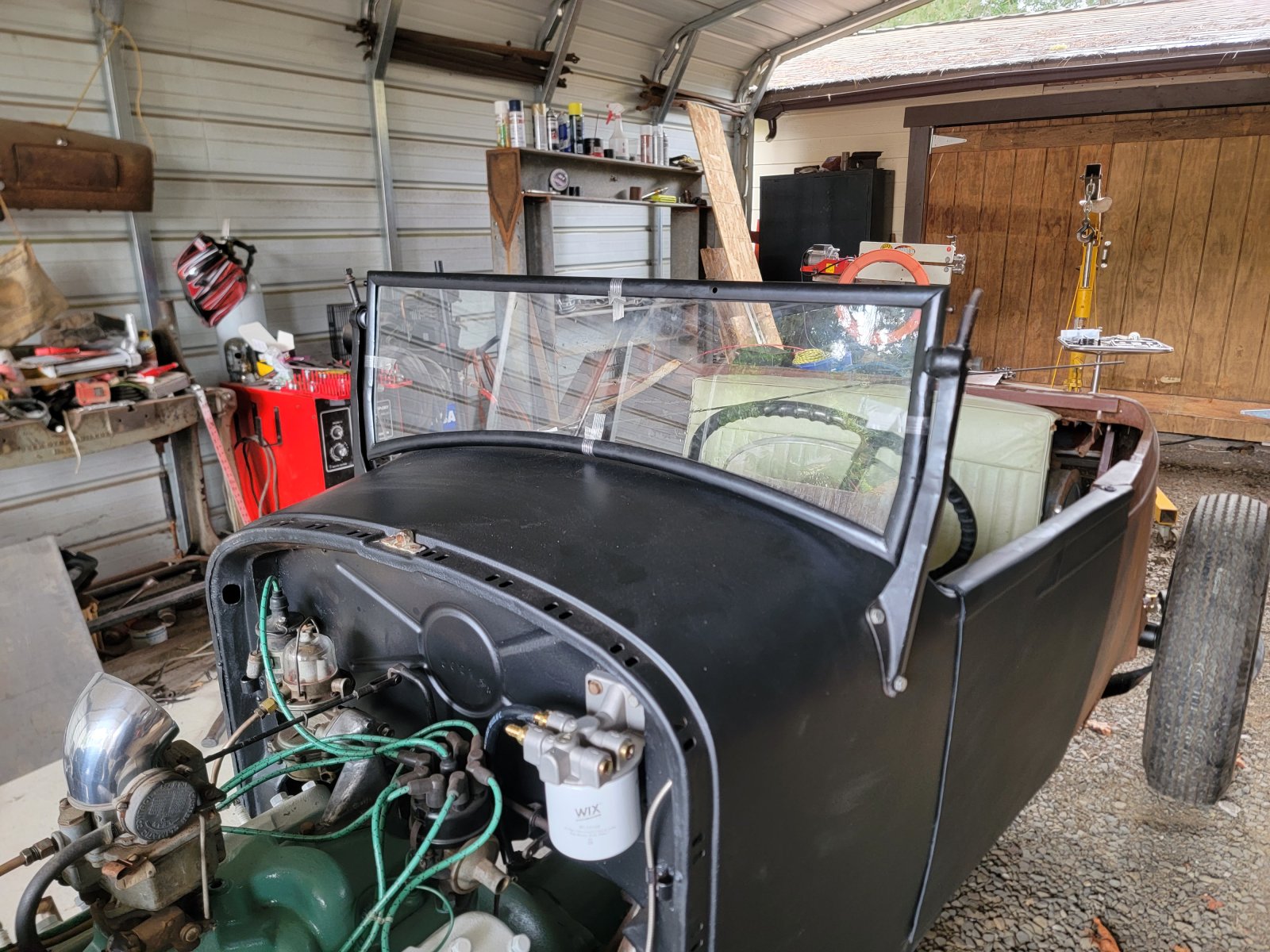

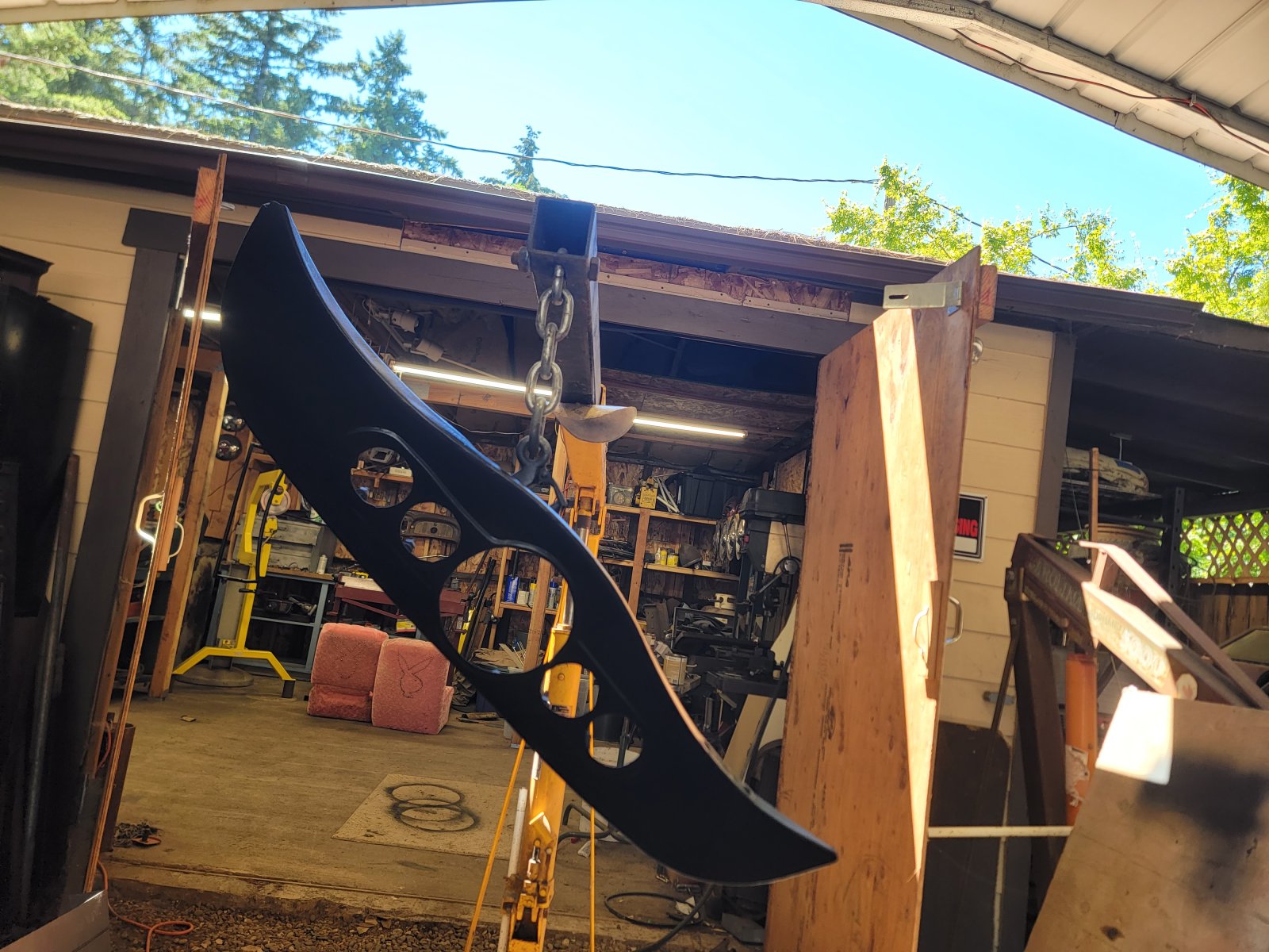

  7. oliver westlund
    Posts: 2,839
    oliver westlund
    Made the template for the windshield today and sent it to the gl*** shop. 20240705_102607.jpg
    Also installed a bunch of little things, coil, remote oil filter, bent up some fuel line. So many little things left to do! 20240705_120553.jpg

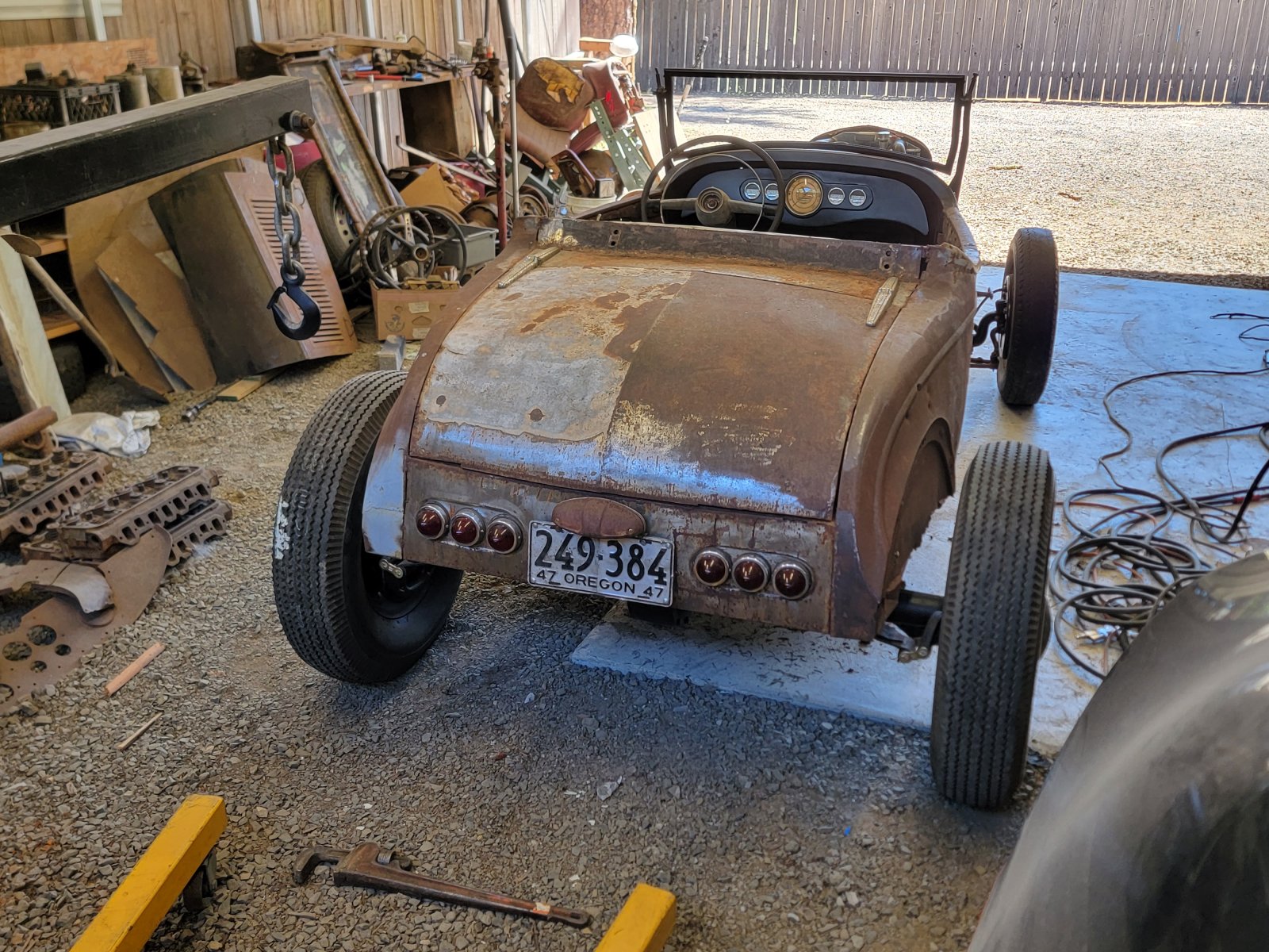

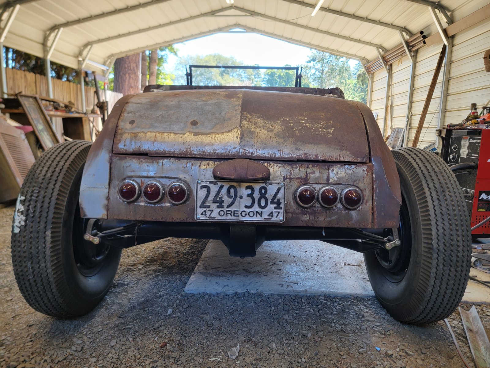

    Got a license plate on it today, mount is 1952 renault dauphine 20240708_103651.jpg 20240708_102616.jpg
    Turned out pretty good

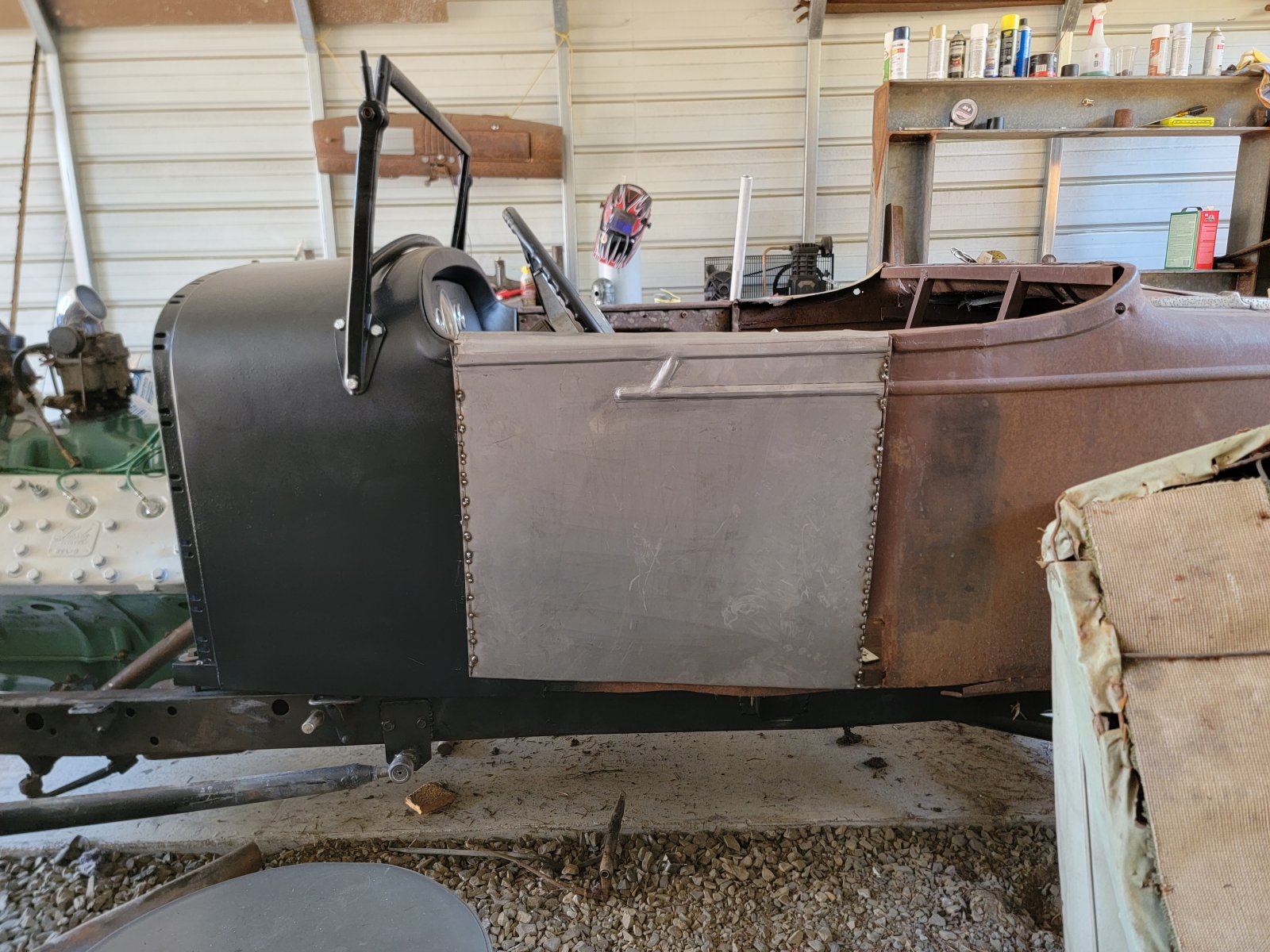

  11. oliver westlund
    Posts: 2,839
    oliver westlund
    Did a lil somethin today, turned out pretty good if I do say so myself
    Had to make a decision on the body line, I dig it

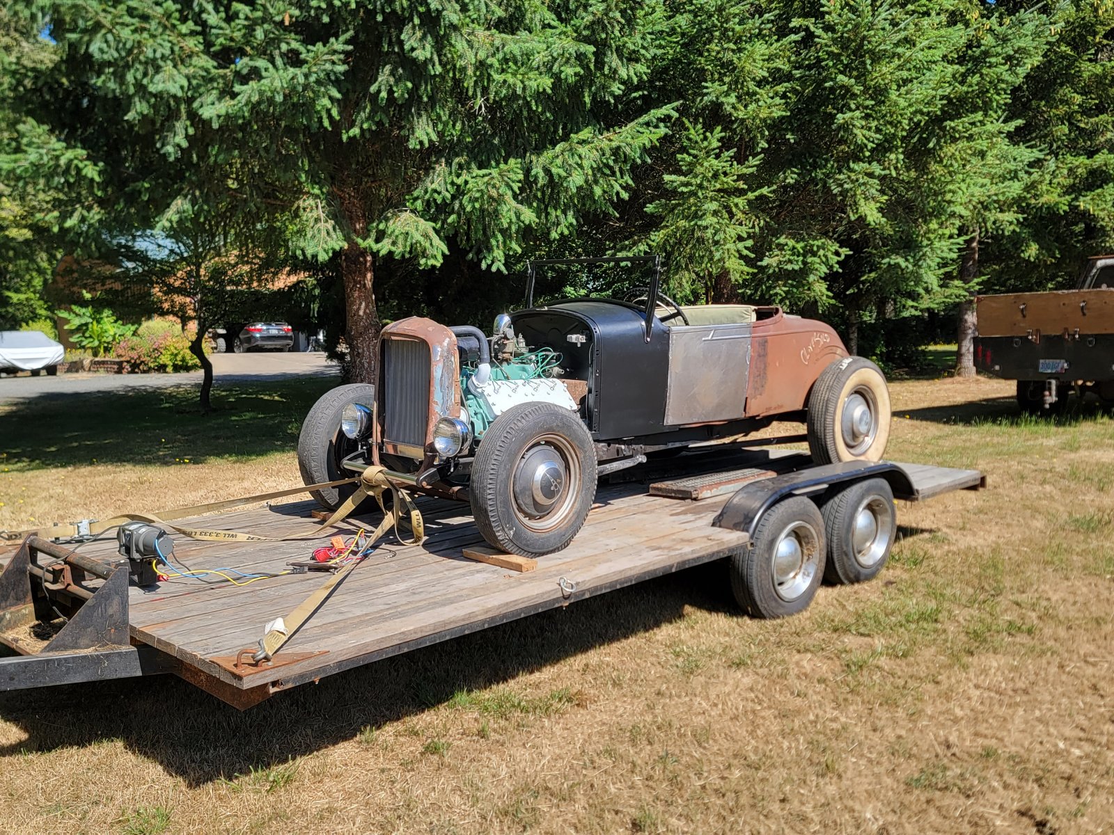

  12. oliver westlund
    Posts: 2,839
    oliver westlund
    All loaded up for the show at the end of the month. Wife, kids and incoming twins need my attention til then

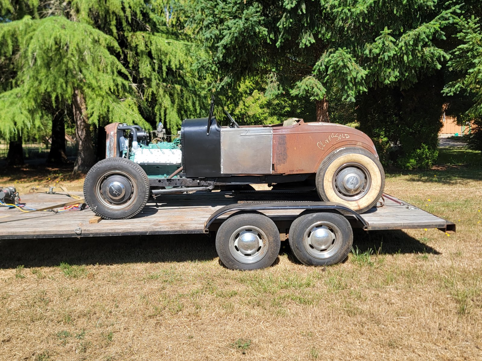

  17. oliver westlund
    Posts: 2,839
    oliver westlund
    The Shakedown was fun! Everyone seemed to be diggin the roadster and most were genuinely confused by it

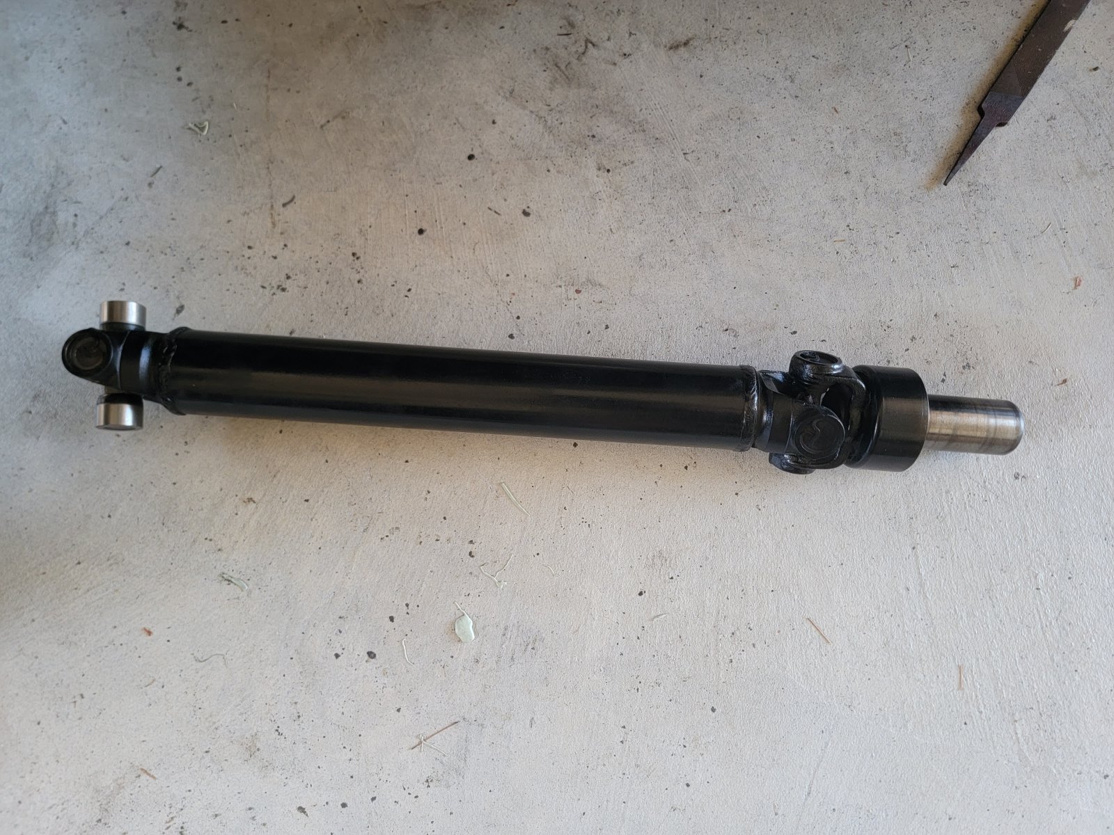

  23. oliver westlund
    Posts: 2,839
    oliver westlund
    Gl*** is cut, big shop day coming up tomorrow, will make a video on both! 20240823_135814.jpg 20240823_135809.jpg 20240823_135805.jpg
    Lifes been hectic with 5 kids and progress has been slow but Im still here and Im still chuggin along!
  24. oliver westlund
    Posts: 2,839
    oliver westlund
    In case anyone wants to see how I did the driveline.
    brEad and scotts52 like this.

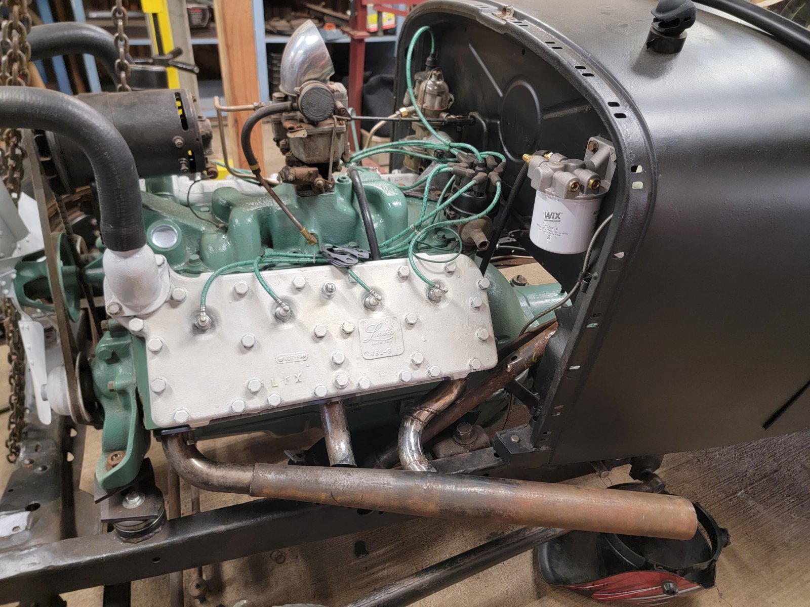

  26. oliver westlund
    Posts: 2,839
    oliver westlund
    Okay had a great cpl of days for progress. Got custom header flanges made up by lc kustoms 541-497-0719 they can make custom header flanges on the plasma table and send them wherever! The cone is a true 36 ford driveline just like in the day! 20240910_091508.jpg
    Clearance around steering has been TIGHT!
    hfh, dwollam, brEad and 3 others like this.
  27. oliver westlund
    Posts: 2,839
    oliver westlund
    All welded up! Thinking powder coat them white maybe?
