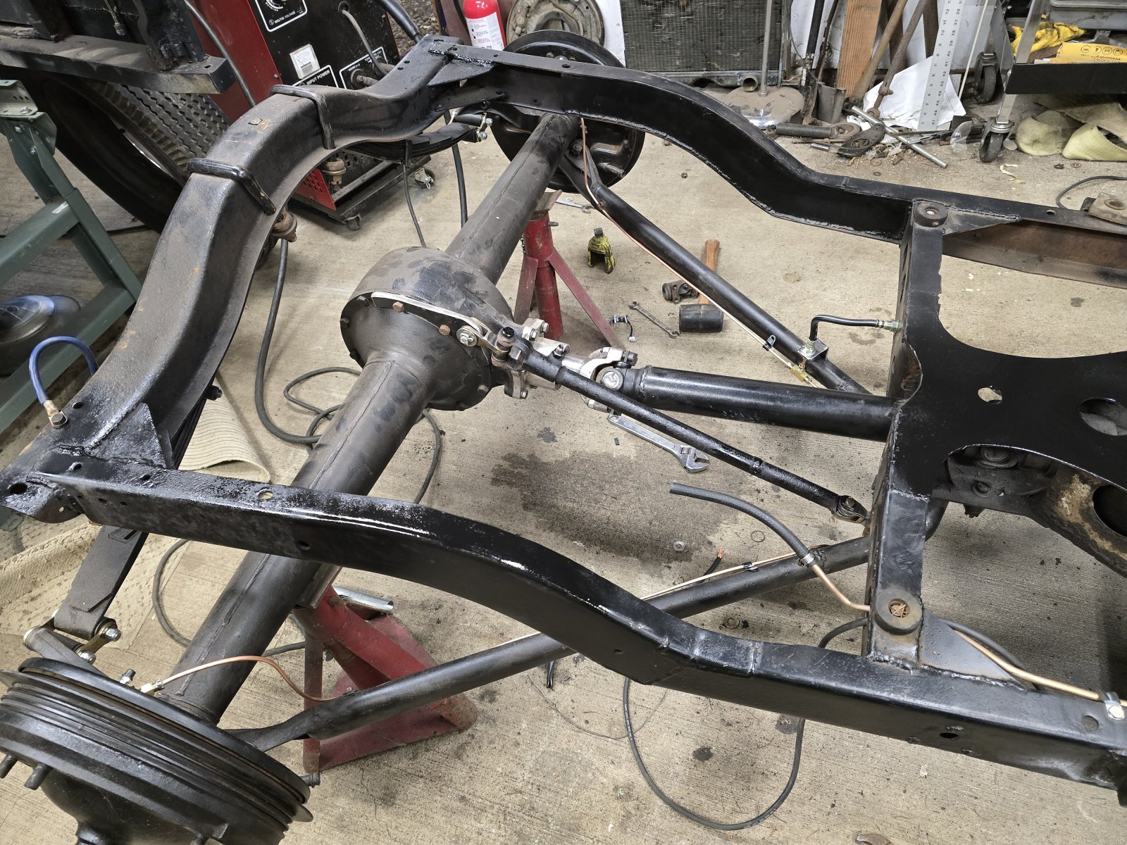

    Another shop day underway. Brakes plumbed in, torque arm finished up, hopefully a handful of other odds and ends by the end of the day! 20241005_171623.jpg

    End of the day. After chasing down 10 leaks and a lot of bleeding both of the brakes and my fingers...the car has a pedal! Going to leave the body off for a day or 2 and clean up a few other things then it goes back on and the fuel tank gets hooked up! Then wiring... next friday I pick up the front tires. The list between me and driving this thing is getting shorter and shorter!

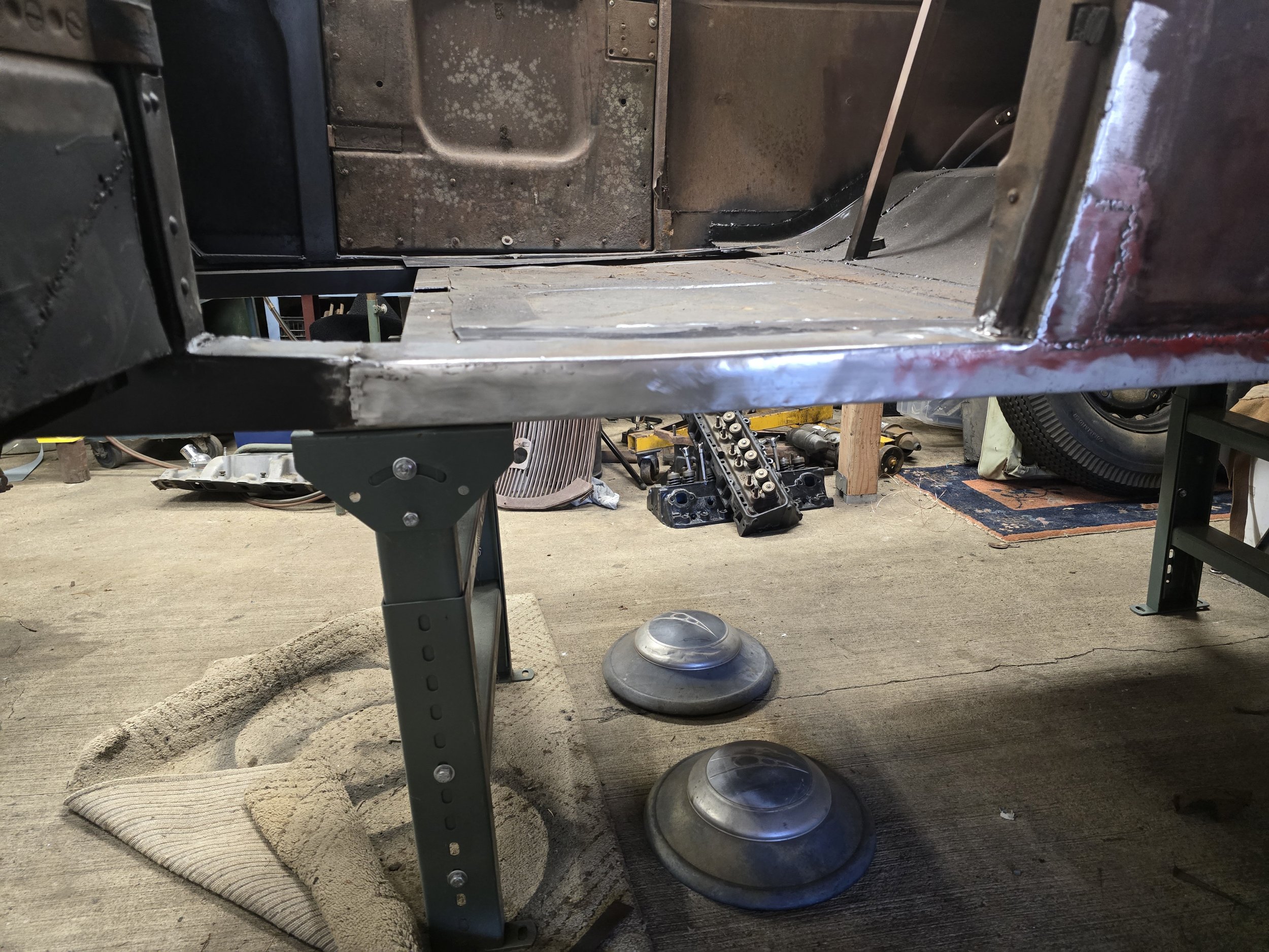

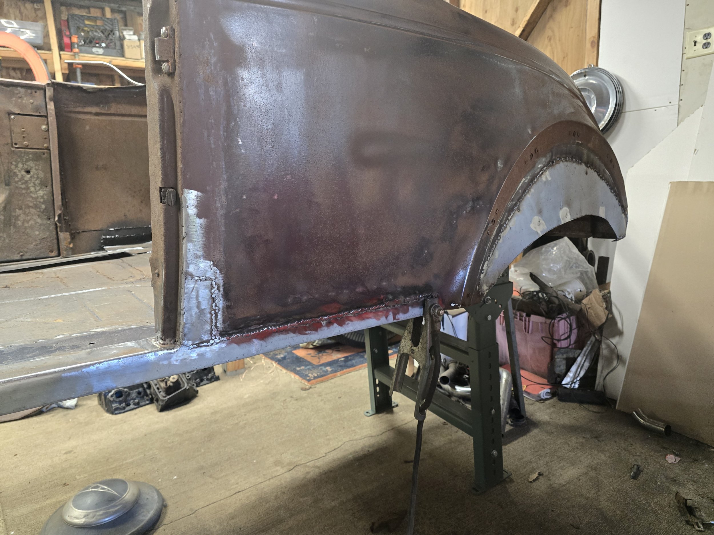

    While the body is off, I decided to tackle some of the basic bodywork that needs done sooner rather than later 20241017_160522.jpg
    I fixed the bottom of the drivers side all the way back and then I fixed the wheel well. Neither is going to get blocked and worked all too much before some primer goes on but I wanted to rough things out better 20241017_160524.jpg
    The progress looks good so far

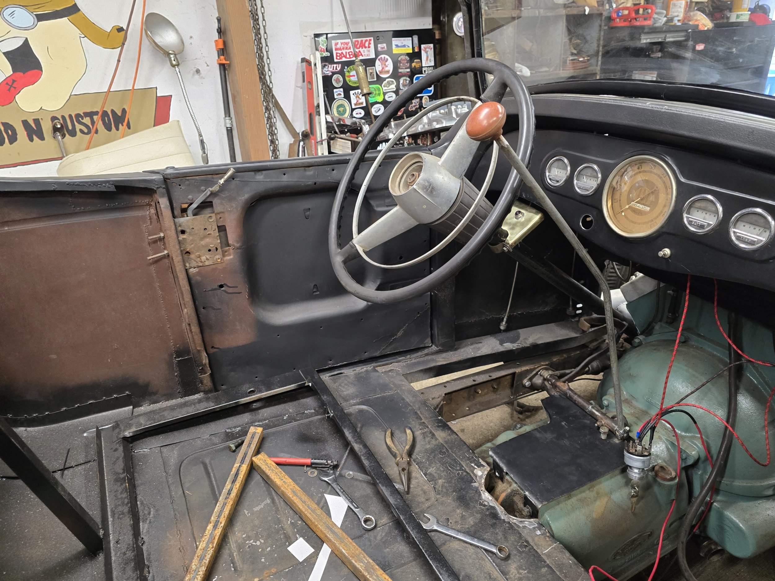

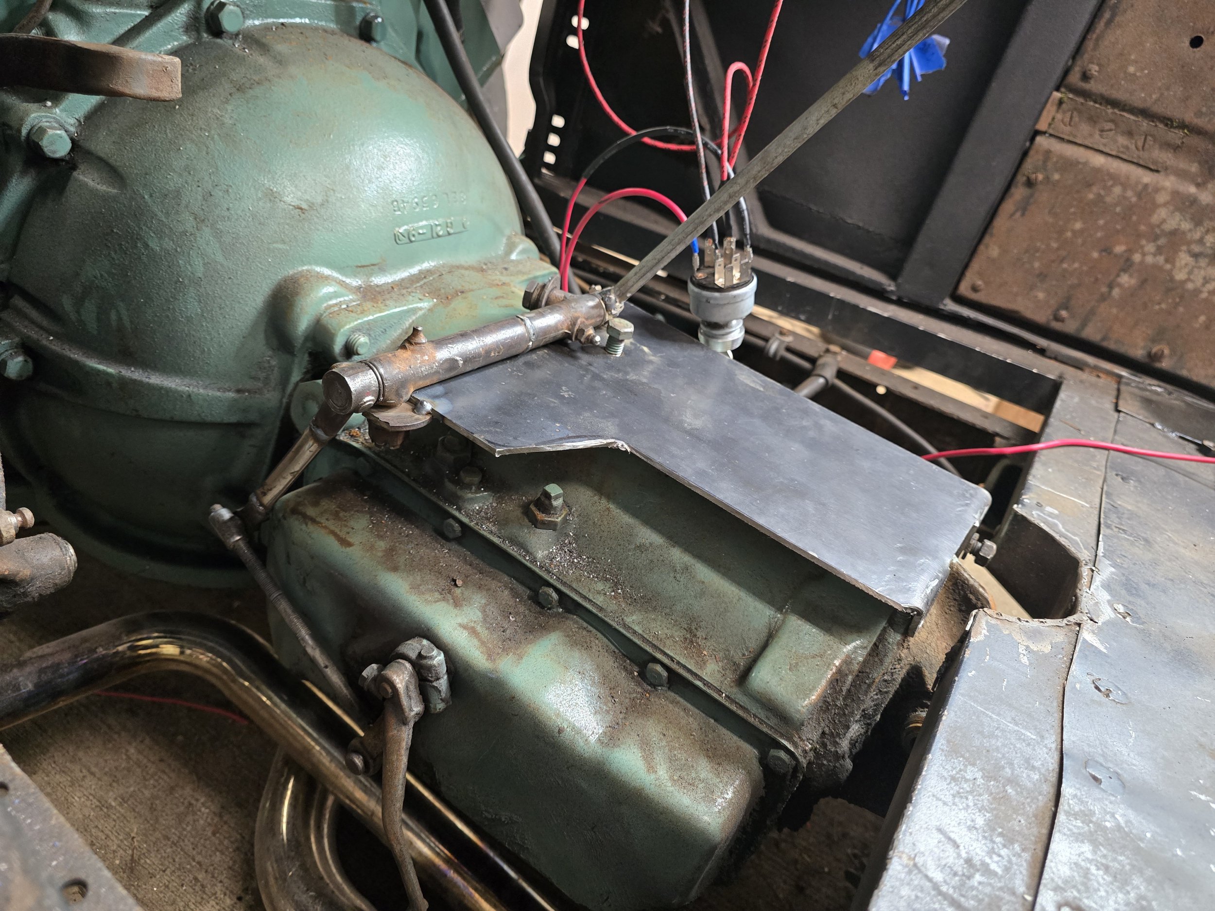

    Made a shifter yesterday out of a cpl of model a mechanical brake pivots and the old locking bar off of our gate haha
    Catches all the detents and doesnt hit the dash or the seat. I am thinking about adding a guide plate with additional detents to keep it from falling out of gear or getting easily bumped
