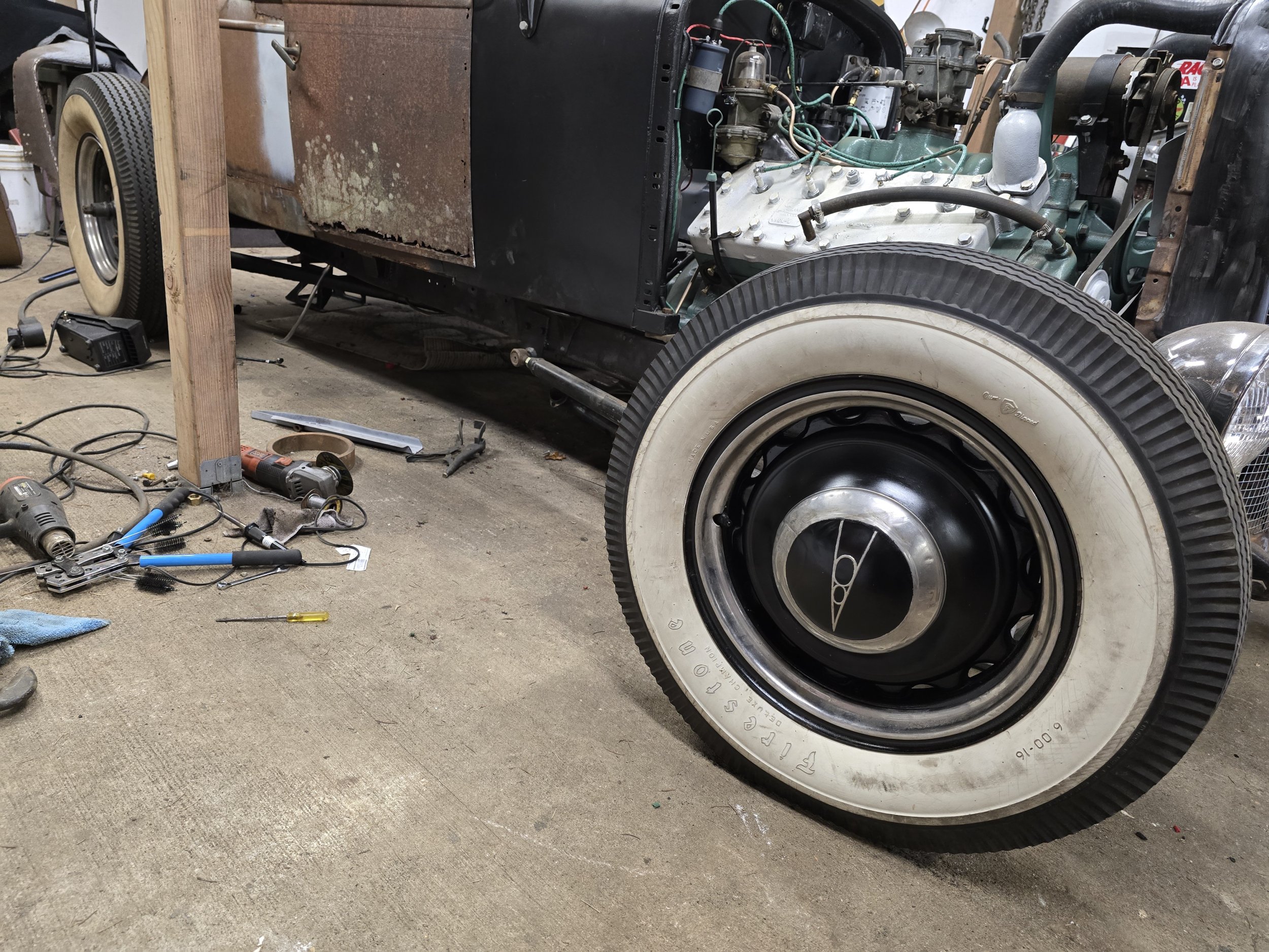

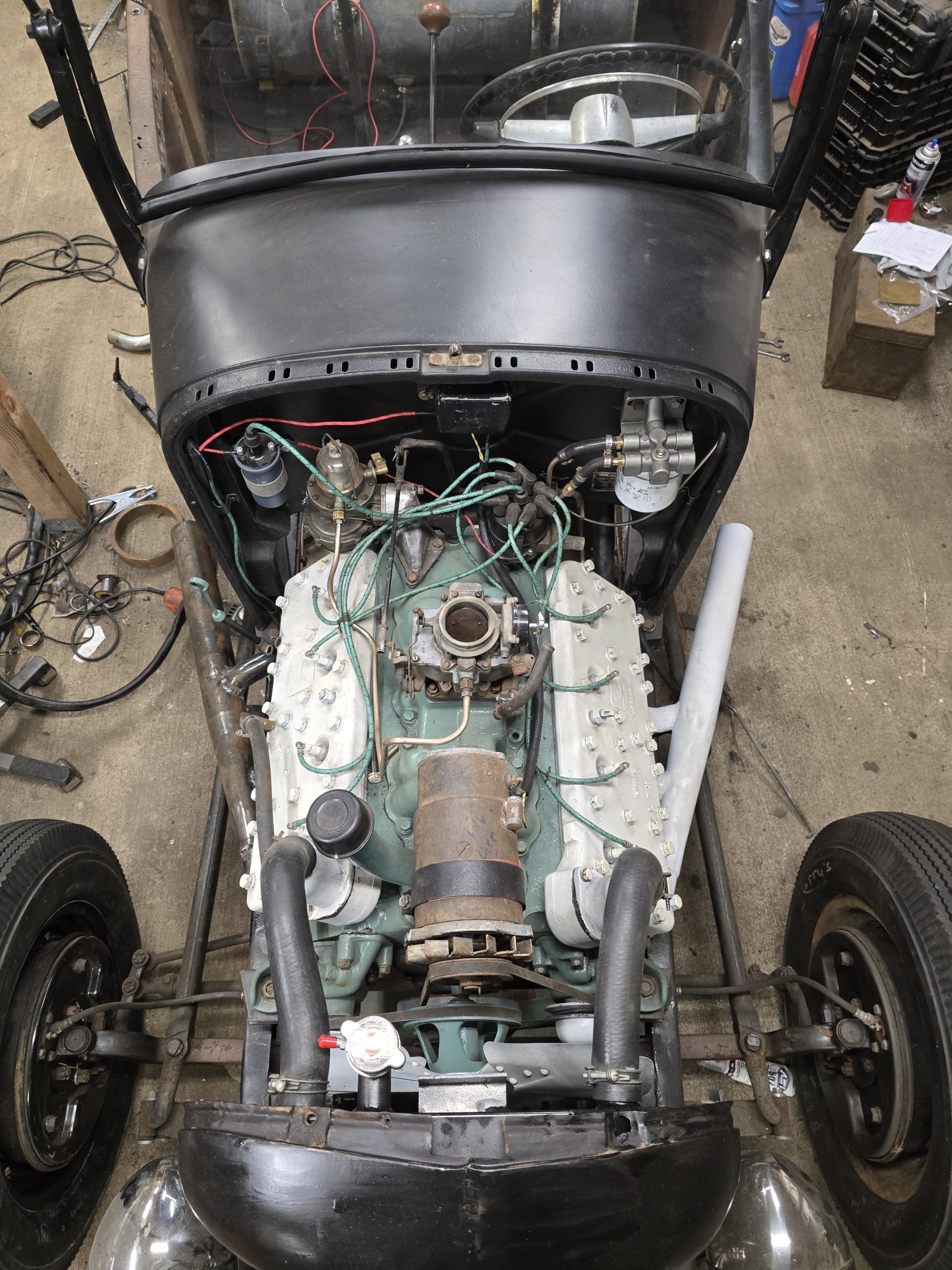

    Today got the p*** front tire changed out finally and made the p***enger side header. Both have been on the list for quite a while and was nice to get em checked off. Tomorrow I will paint the header. Next I will dive into getting the parking brake to function now that the lever is on there and then I can finish the floors. Gettin down to it!

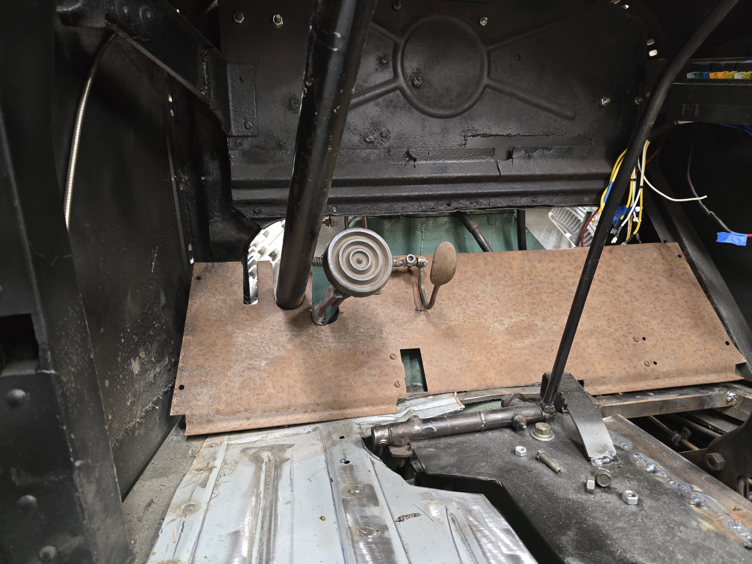

    Modified the brake pedal into position, modified a s**** pedal to work the opposite direction so it will function with the linkage on the 337. Also snagged a toeboard I've had laying around and trimmed it to fit the pedal placement! Chuggin along!
    Yes, I did flip the pedal so it would actually work
    Toms Dogs, bchctybob, brEad and 5 others like this.

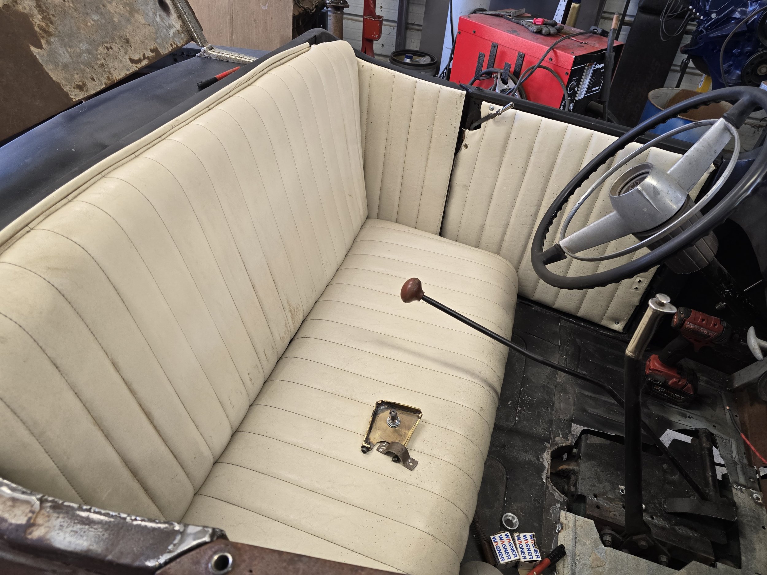

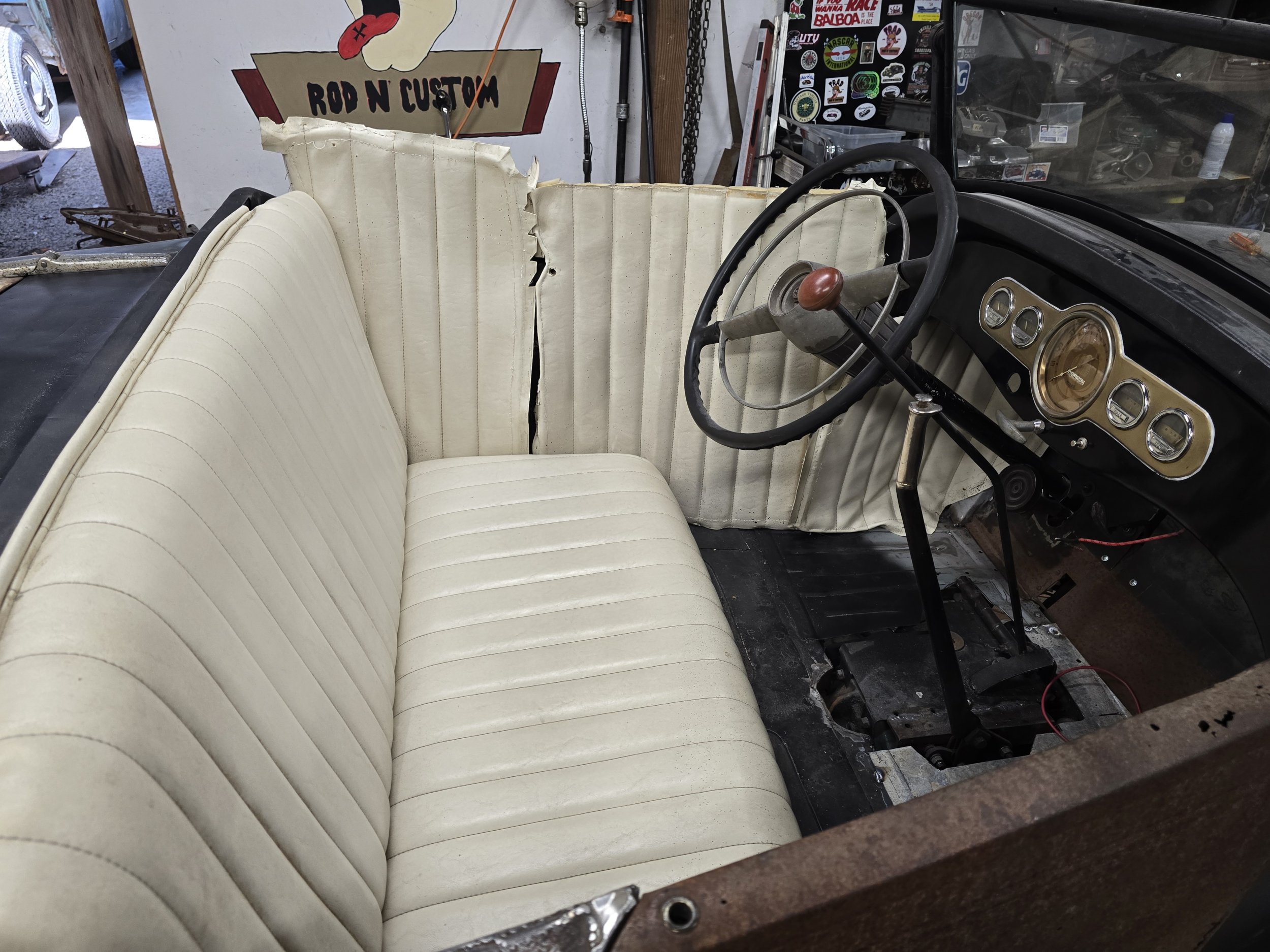

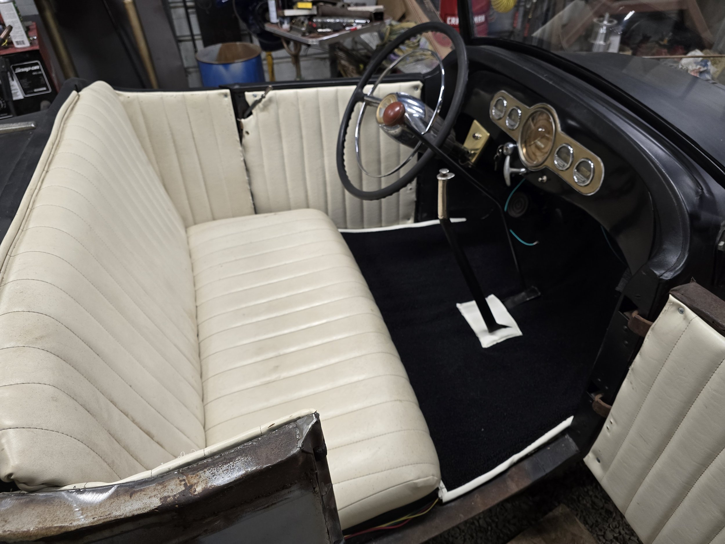

    Hahaha exactly... I like the latches cause I can still lock the trunk with a padlock if I desire... I polished br*** screws to mount em. Today has been a whirlwind I tried to film but it was a challenge. 20250526_143641.jpg
    Floors went back together, still need to make a shifter cover.
    Choke got mounted to the dash!
    Seats back in.
    Started monkeying with interior panels. Its all falling together!

    Joined: Mar 2, 2001
    Posts: 20,252
    Tim
    from KCMO
    Man that interior really elevates the car, looks great!

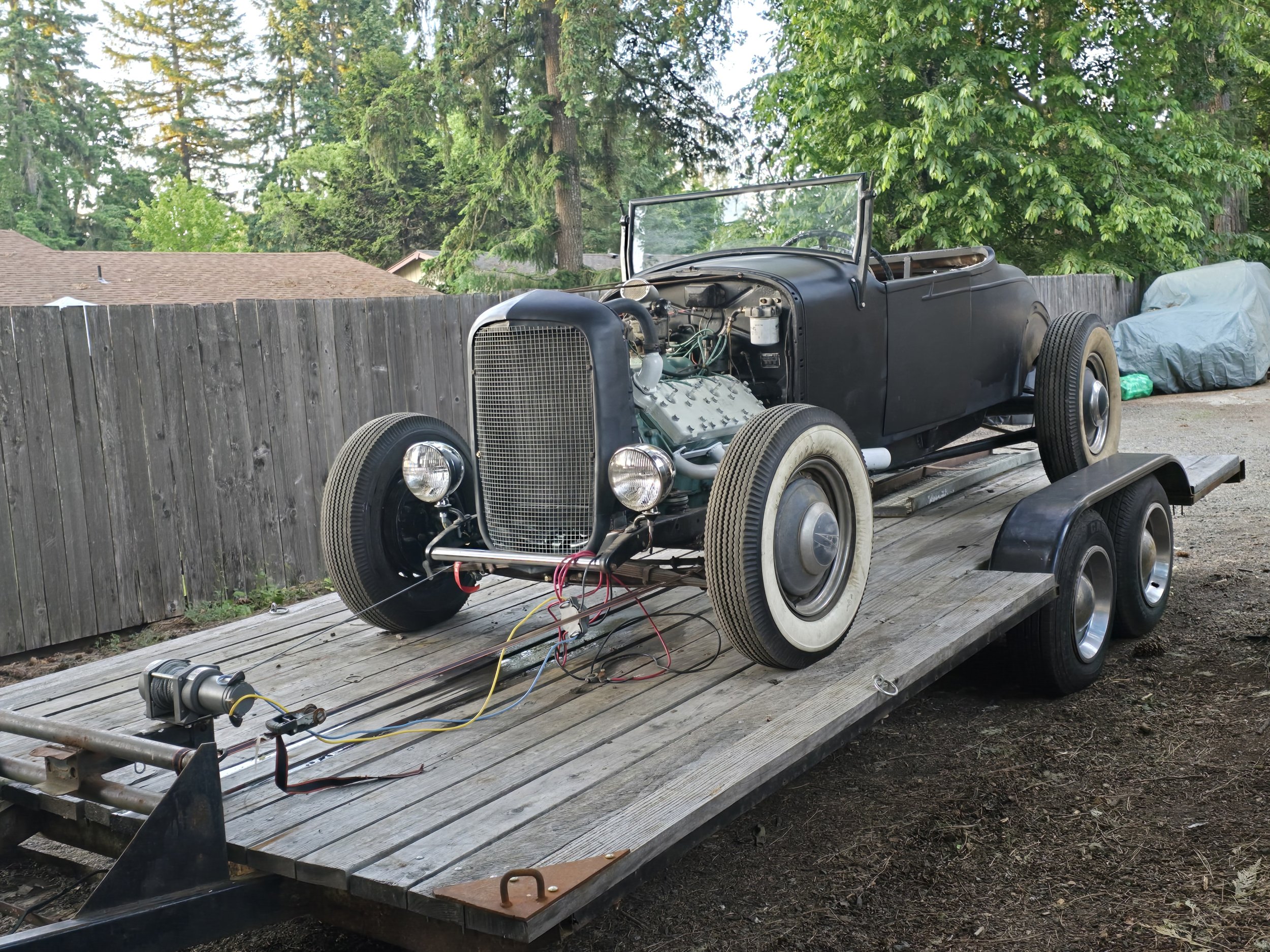

    Well... at 3 am I got it on the trailer... did everything I could squeeze in! 20250531_014732.jpg

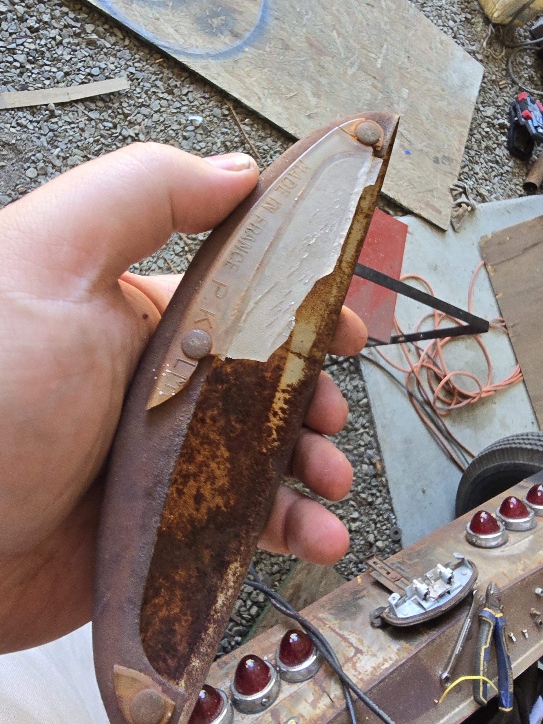

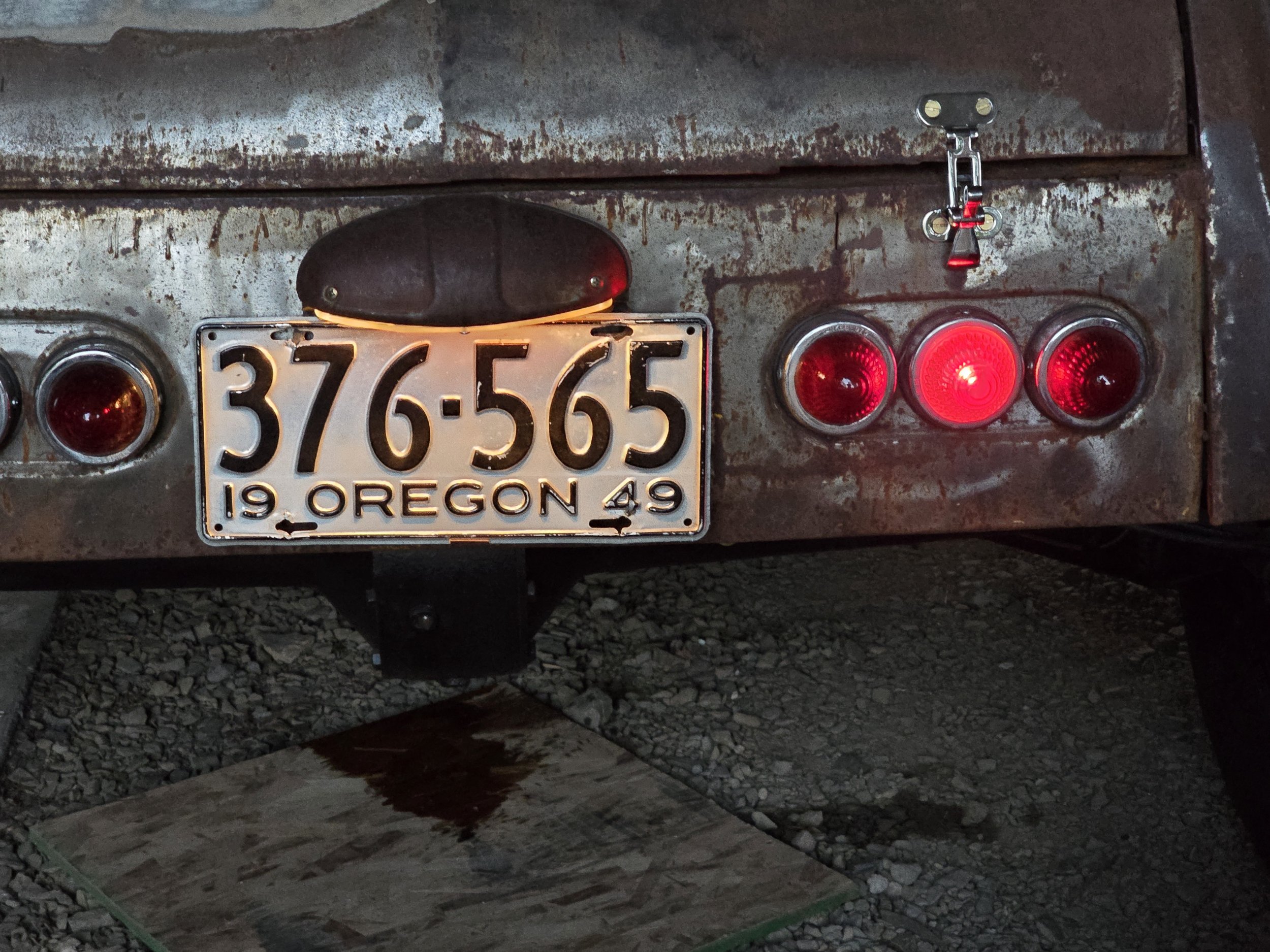

    The lense on the license plate light was toast so I used some plexi
    Toms Dogs, bchctybob, dwollam and 2 others like this.
  28. cfmvw
    Joined: Aug 24, 2015
    Posts: 1,101
    cfmvw
    Nice job on the lense! If you quickly/lightly run a torch along the edges you can smooth out the sanding marks and make it clear for a more OEM appearance.
