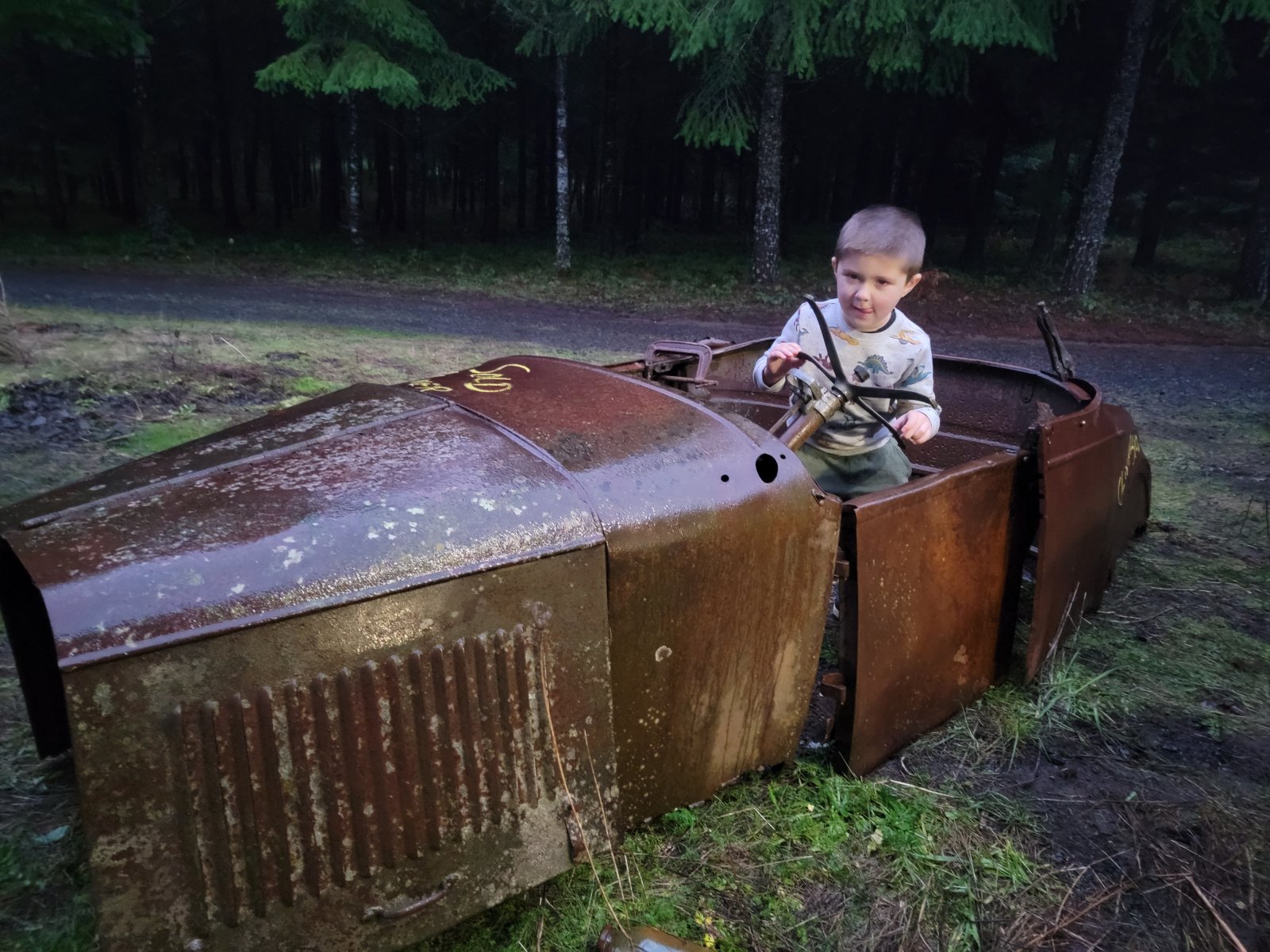

    Got out for an hour this evening and made some small progress, got it inside and out of the snow, fixed the p***enger rear quarter a little bit and got the body tacked together. I think a cpl inches need to come out of the middle of the seat back beacuse the cowl sits right on the a frame like its meant to be there but the back is waaay too wide IMG_20211226_202031.jpg 20211226_190052.jpg 20211226_190141.jpg

    Wheelbase on an a is 103.5 i believe. Went out and did some cutting, narrowed the seat rear as much as it felt like it would allow, trimmed the quarters and tack welded em in, 1.5" narrower at bottom of trunk than tge top now, might just widen the lower filler to make up the difference, starting to look better 20211227_161300.jpg 20211227_161037.jpg
  25. oliver westlund
    Joined: Dec 19, 2018
    Posts: 2,845
    oliver westlund
    Se
    Seems to have lots of room as it sits, im 6'1 1/2" and i fit in it

    20211227_160057.jpg 20211227_160955.jpg how the cowl sits on the a rails 20211227_161319.jpg

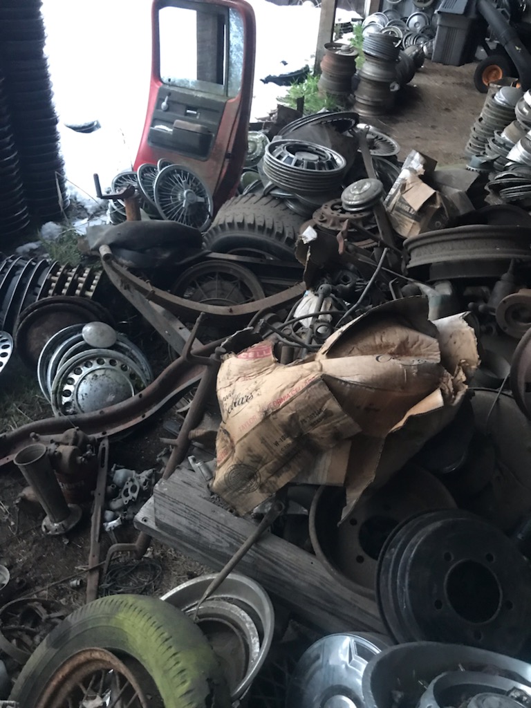

    Well i have a bud with a huuuge pile of parts im gonna go look through this week, a 36 rear end with wide 5 wheels is on the list, a model a front axle also on the list then by my understanding i can get some late 40s brakes for both and i think ill get some wide 5 adapter plates and run juice brakes with the wide 5 wheels if i can find the whole set, only saw 2 in the pics. Also will be hubcap hunting, steering box hunting, column hinting, steering wheel perhaps. Not exactly positive what im looking for haha, i do think ill use the 36 ford leaf spring setup and stretch the a frame back 6 inches with a different crossmember when i z the frame

    Been pickin these pics with my eyes! Get to pick it in person tomorrow!! Lots of stuff i need/want thatll help me with this project! IMG_4653.jpg IMG_5047.jpg IMG_5048.jpg IMG_5049.jpg
