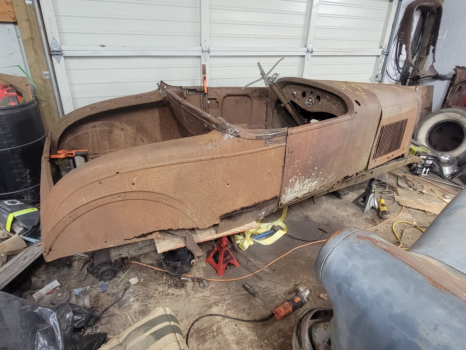

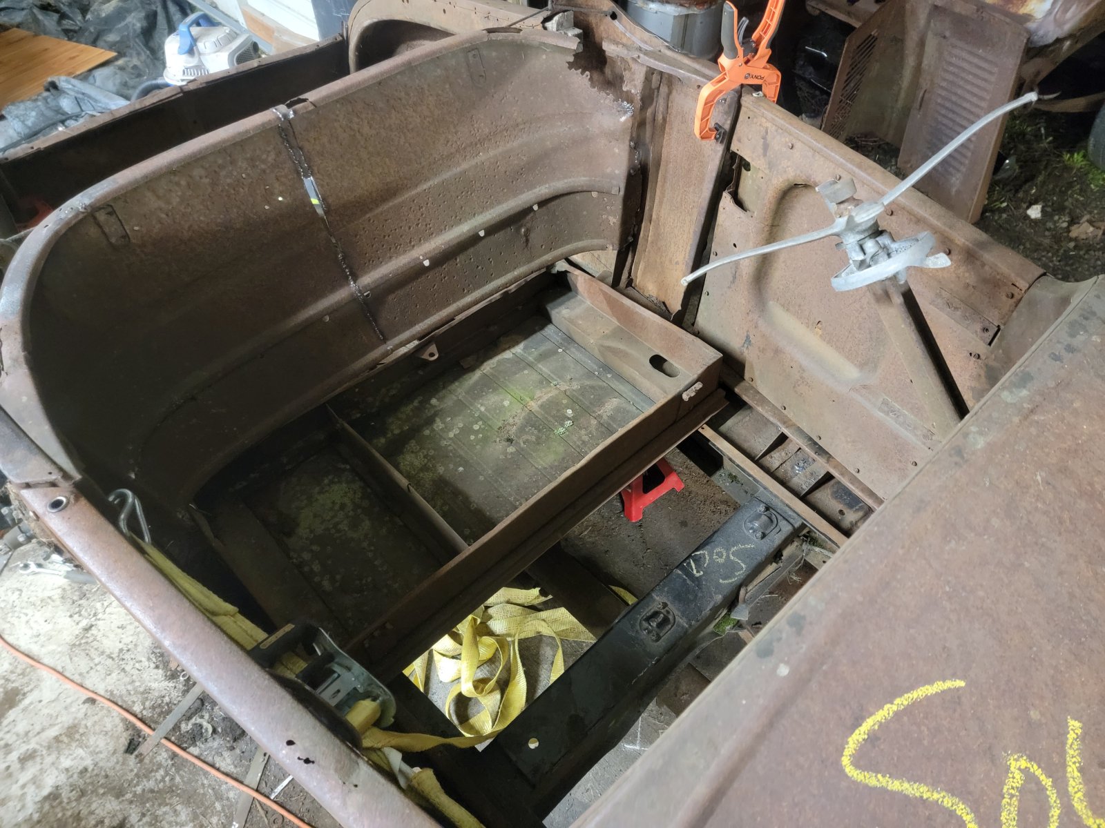

    Welded in some sub frame tonight, also got a patch in the p*** quarter, also got the drivers quarter welded in, starting to take shape! Also all of the wonkyness is starting to work itself out and things are squaring up. The doors are going to need work regardless since i changed the width of the dodge tub 20220109_203701.jpg 20220109_201408.jpg 20220109_203106.jpg

    Seat riser last night, not sure what its out of, model a maybe? Set the 46 rear in but its too wide! Surprise! So im going to pick up that 36 ford rear from my buddy and stick the juice brakes on it with the wide 5 drums 20220112_185310.jpg 20220112_192453.jpg

    Little more progress, started to form a piece to go across behind/part of the seat back. Idk if its a package tray or whatever, will be inside the seat, made a cardboard template so i can make sure everything is the same side to side. Also cut down one stanchion for the windshield. I dig it as of now, may go lower or may try to make a hallock windshield since this thing has a major ****pit look to it 20220114_001637.jpg 20220114_001648.jpg 20220114_004808.jpg 20220114_013641.jpg

    Little bit o work tonight, started by pulling the body, its rigid enough to move now and a lot of the work i need to do to it would be better if my frame is sorted first! 20220119_170131.jpg

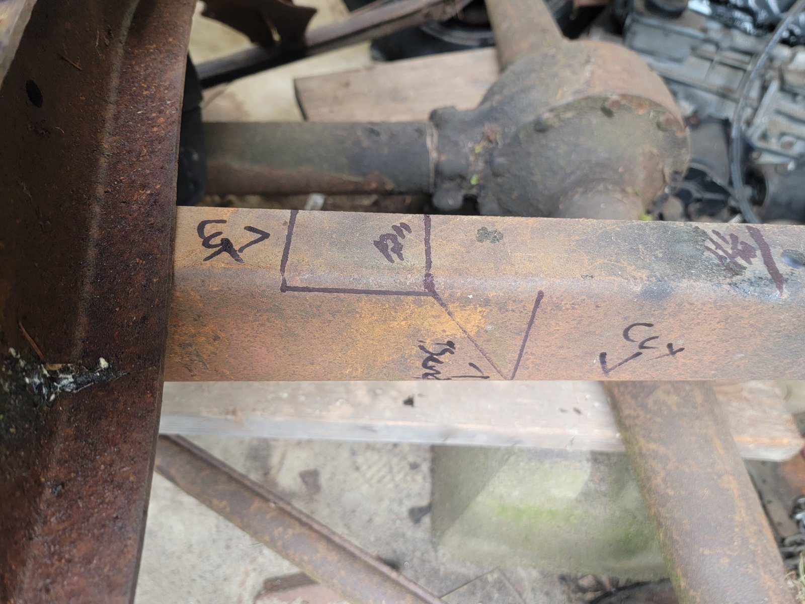

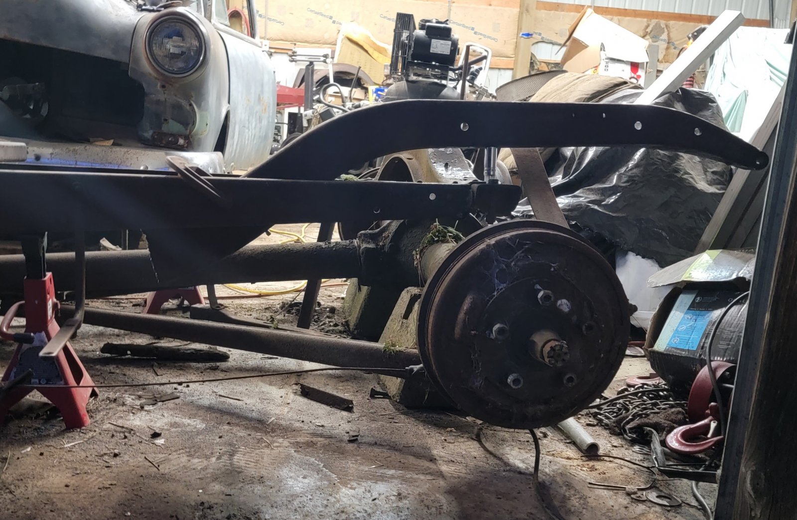

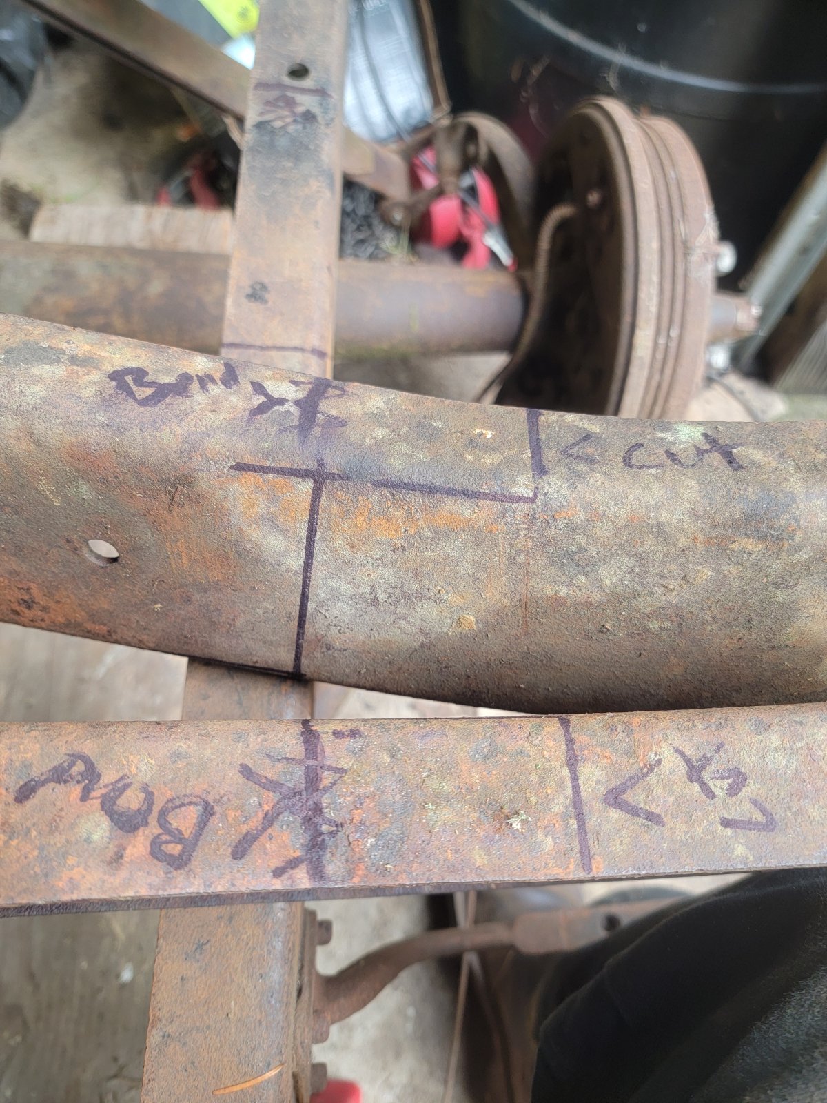

    I really like pauls 27 T roadster and the sweep he did to the rear frame. I may still need to clearance some for axle travel but wont know that for a bit yet. I just so happen to have a cpl 27 chev rear frame horns which have a nice sweep to them already! Since I will be mounting my rear crossmember to them I tried to keep the section of the chev frame parallel to my a frame. It will get the crossmember installed before where it dips back down. I am also adding 10 inches to the frame for a spring in front front end and a spring behind rear end. 20220119_172440.jpg

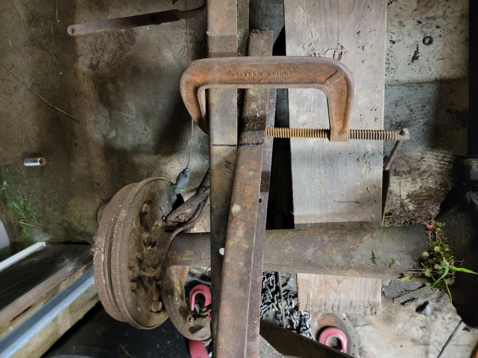

    Lots of measurements, going to use a diagonsl c
    Not sure what youre talking about lol you must think you have some insights into my plans? You dont...you COULD ask if you wanted to know instead of casting disperaging remarks from judgement mountain :)

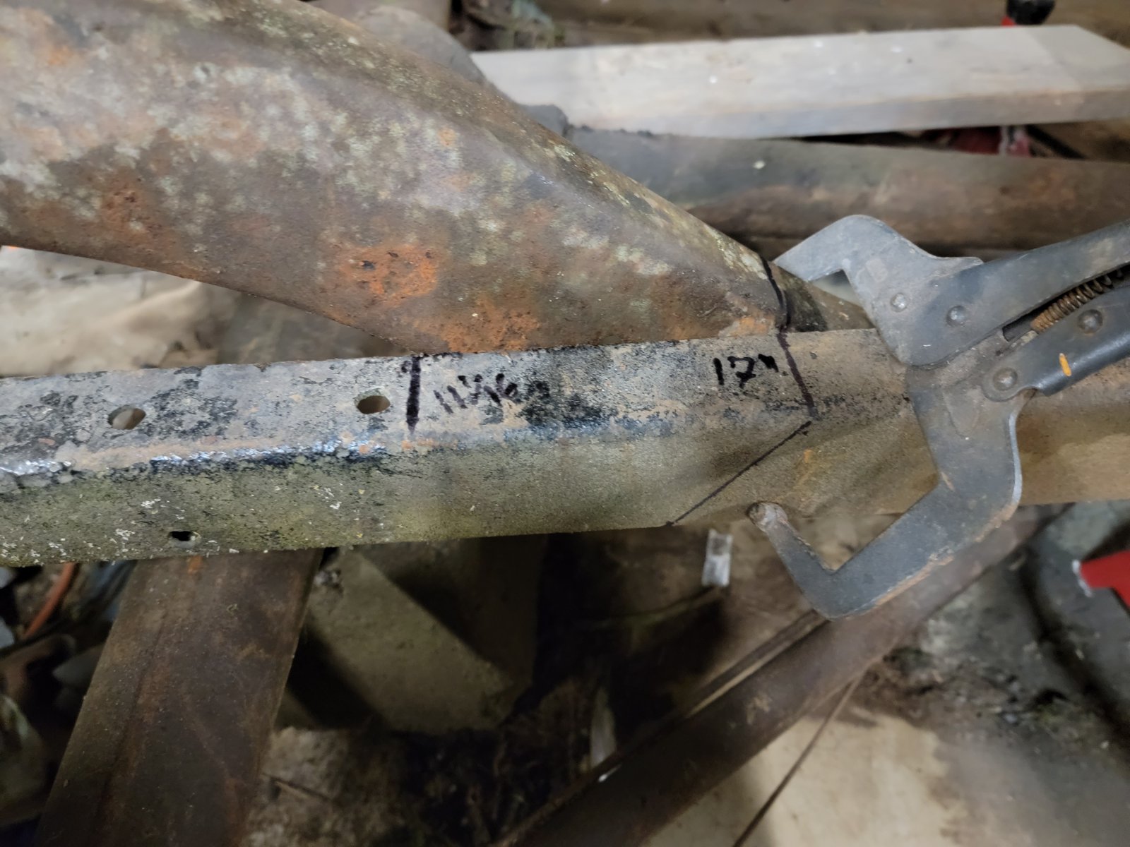

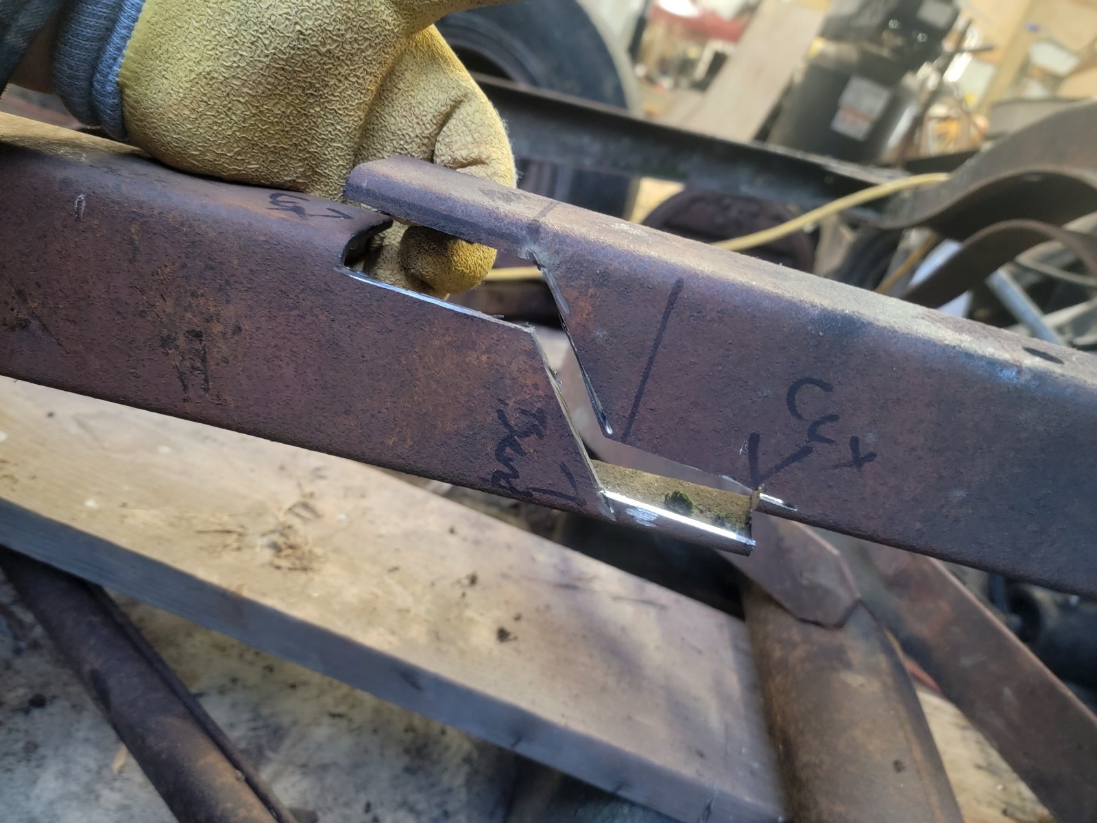

    Lots of measuring. Double checking, clamping and more measuring. I marked the intersecting points where the chev horns p*** the a frame, gave me a 50 degree angle which should be plenty for strength, measure 10 inches from the center of the rear crossmember to account for my spring/axle choices and maintain my wheelbase 20220119_180356.jpg

    Lots of work ahead but the mockup pictures show a pretty nice profile, well worth pursuing I think.

    Doing more thinking and measuring, going to overlap the splice top and bottom, will allow me to make the transition look smoother as well as stronger 20220120_122308.jpg 20220120_122313.jpg 20220120_122355.jpg

    Ive done it "better" and "best" before several times each. I havnt refused any advice from anyone. What you have pictured is a straight frame to straight frame extension, im adding an angled piece, my rosettes on my fish plate will be staggered, i actually was drawing it out last night but didnt see a need to post the drawing. I appreciate advice! What i dont appreciate is ego flexing by keyboard warriors. I dont appreciate negativity like #hackjob im building MY CAR. Im building it safely and while i dont know everything and im certainly no expert, i am doing this better than some of you are ***uming. Feel free to give advice, feel free to pm me even! But dont come onto my build thread and start trashing on me without having all of the facts and expect me to hump your leg and thank you profusely for it. Nobody would, yourselves included

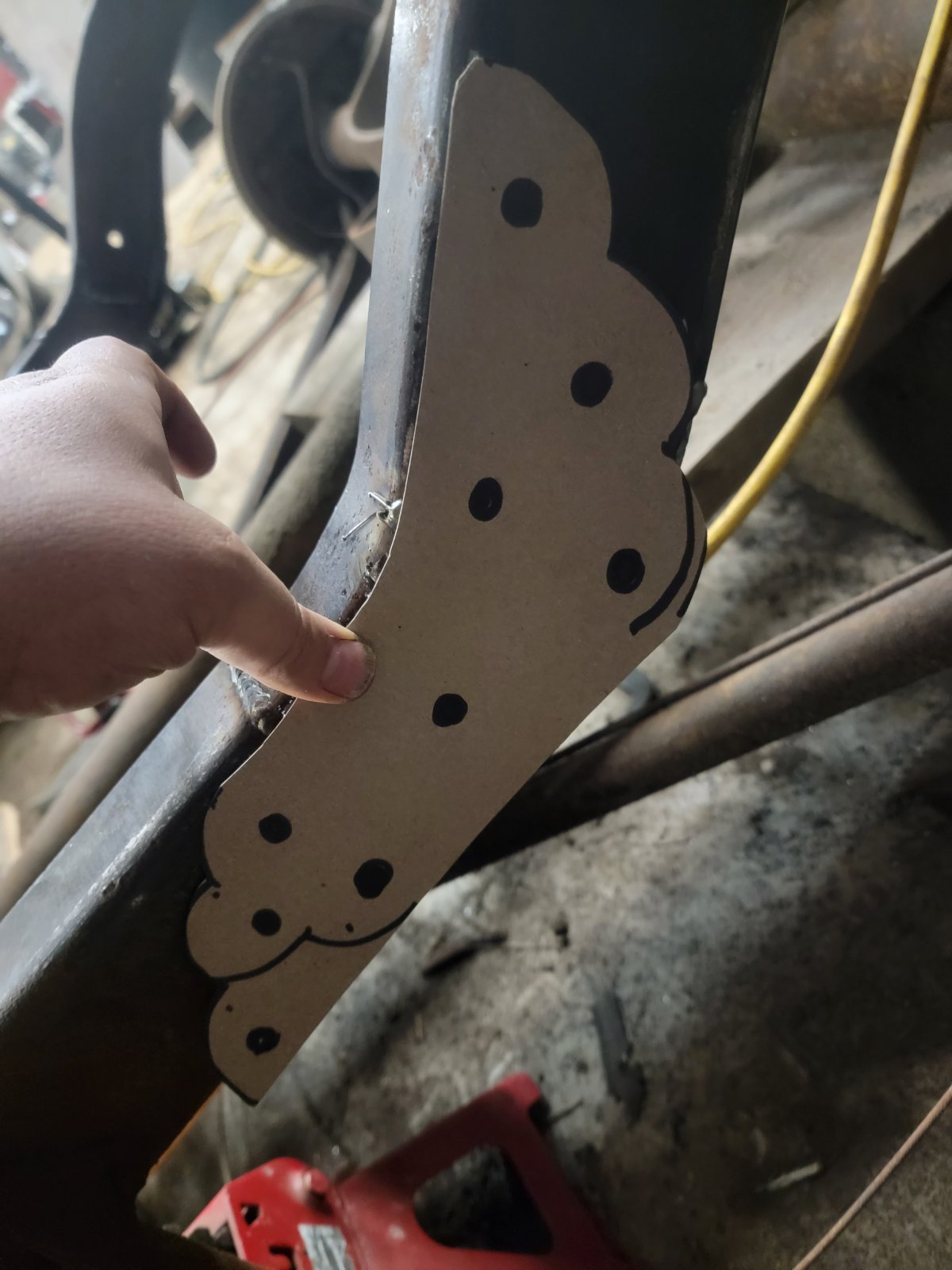

    Anyway... moving on. Lots of cleaning cutting and welding tonight. Angle finder says its perfect side to side, angle also matches the lower (original) rails, level says its level side to side, measuring tape says the lengths are even and straight edge says i got it on running in a straight line. Last pic is of the stencil i plan to use to make my fish plates for the outside. Inside plates will be less interesting looking. Then the frame gets boxed 20220121_165409.jpg 20220121_173243.jpg 20220121_183327.jpg

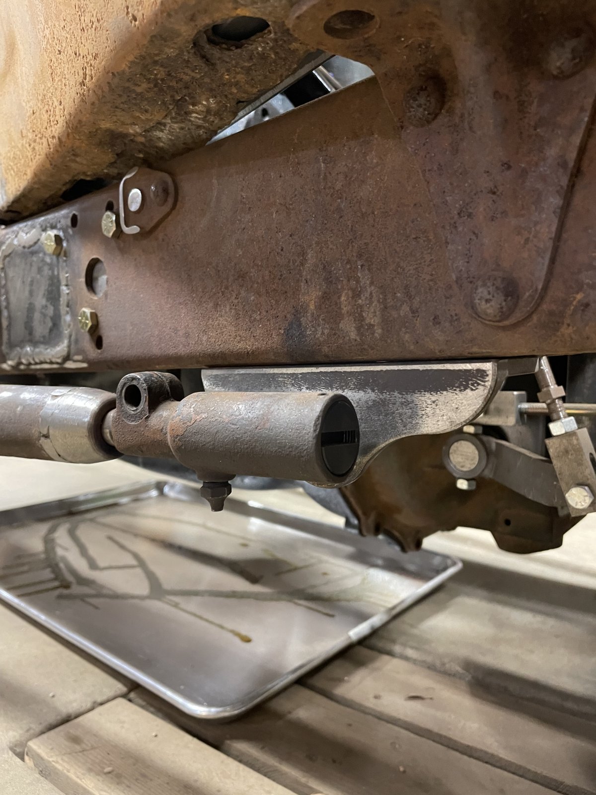

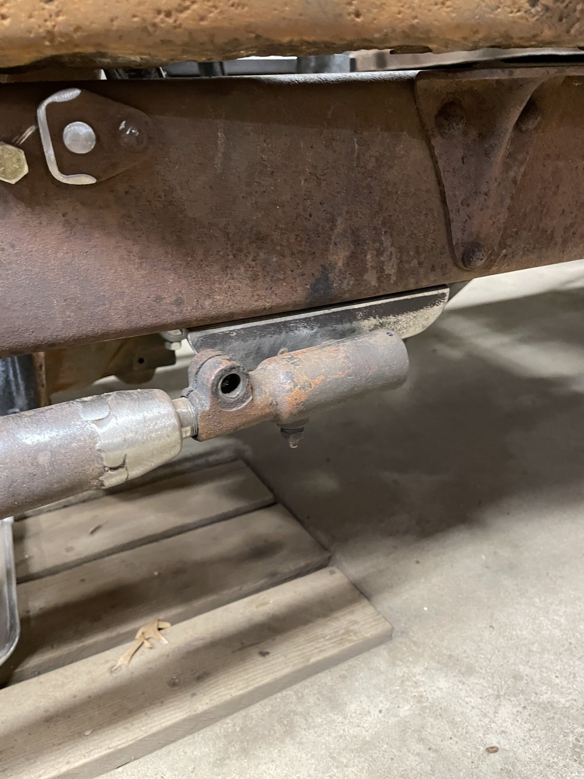

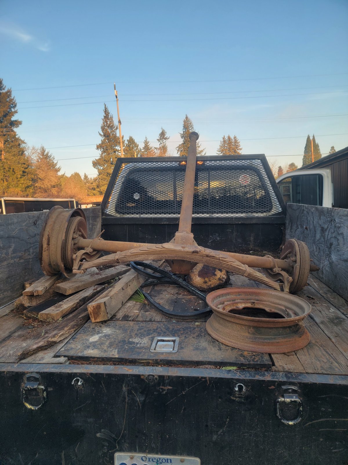

    Got some parts today, 36 rear! Cpl model t door latches im gonna see if i can get to work and a neat chrysler badge 20220126_164323.jpg
  29. Damn! why would anyone torch 36 radius rods like that?
    oliver westlund likes this.
  30. oliver westlund
    Joined: Dec 19, 2018
    Posts: 2,858
    oliver westlund
    No idea, i think it was done a long time ago. Gonna mix and match with the 46 rear i have
