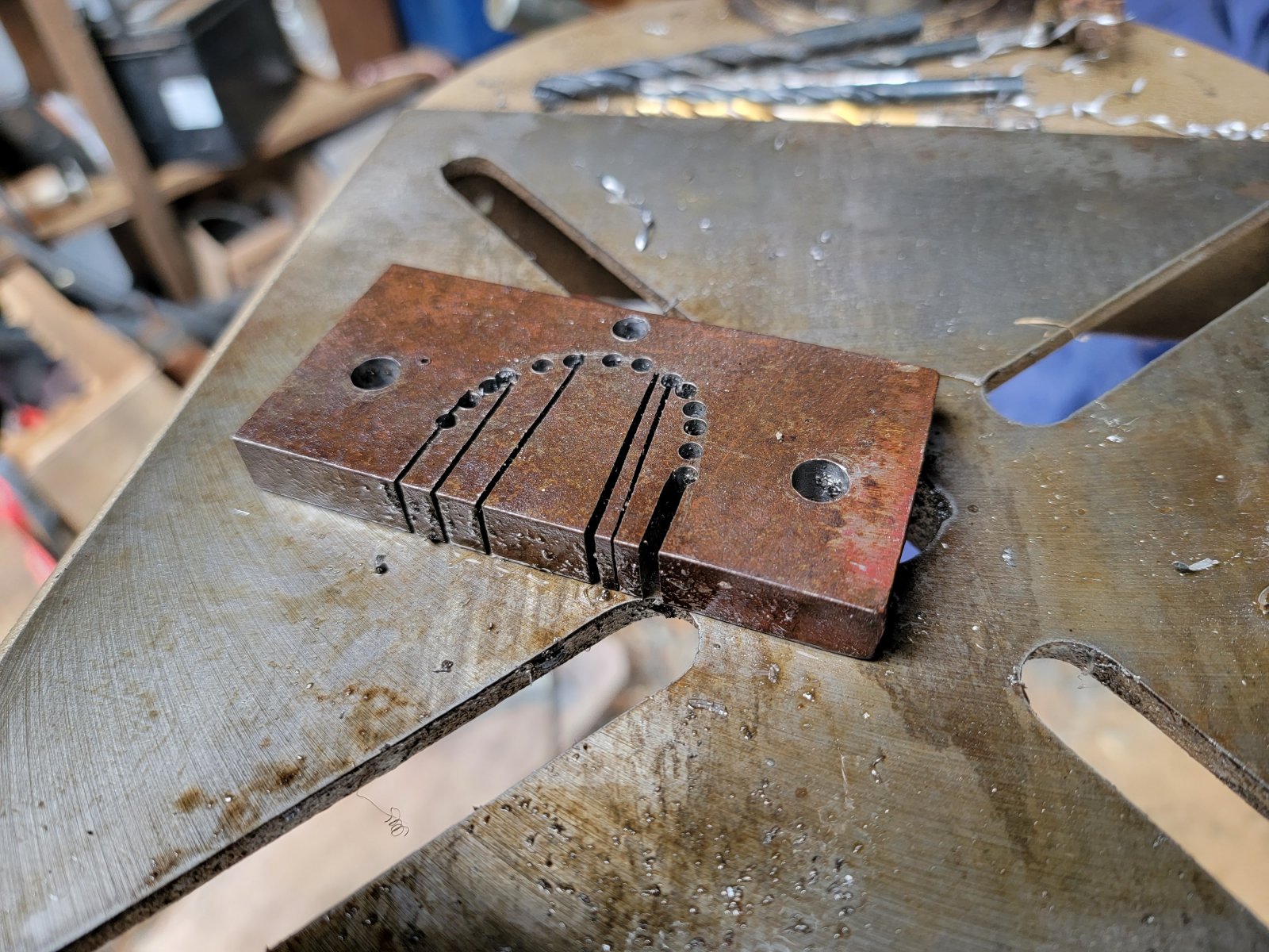

    No luck pulling the wide 5 drums with my 3 jaw and im too cheap to spend 80 bucks so im making my own puller. Good excuse to use my new 50s craftsman! 20220615_121251.jpg 20220615_124253.jpg
