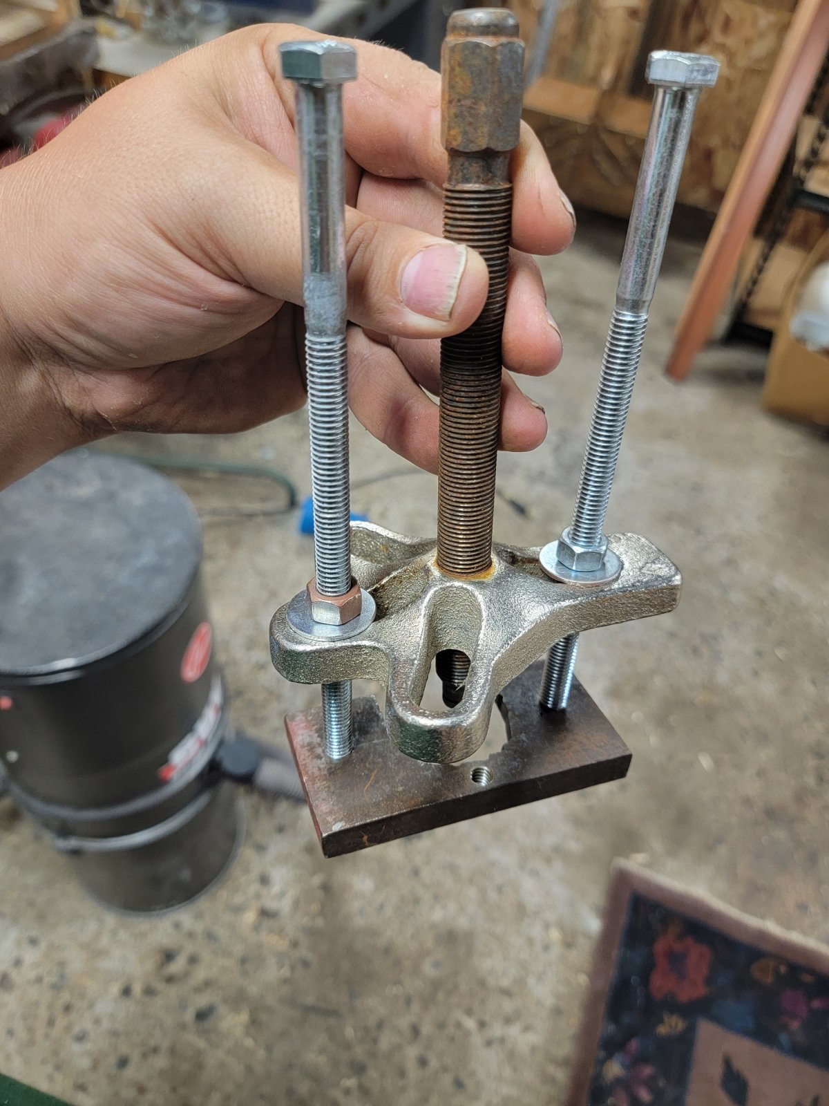

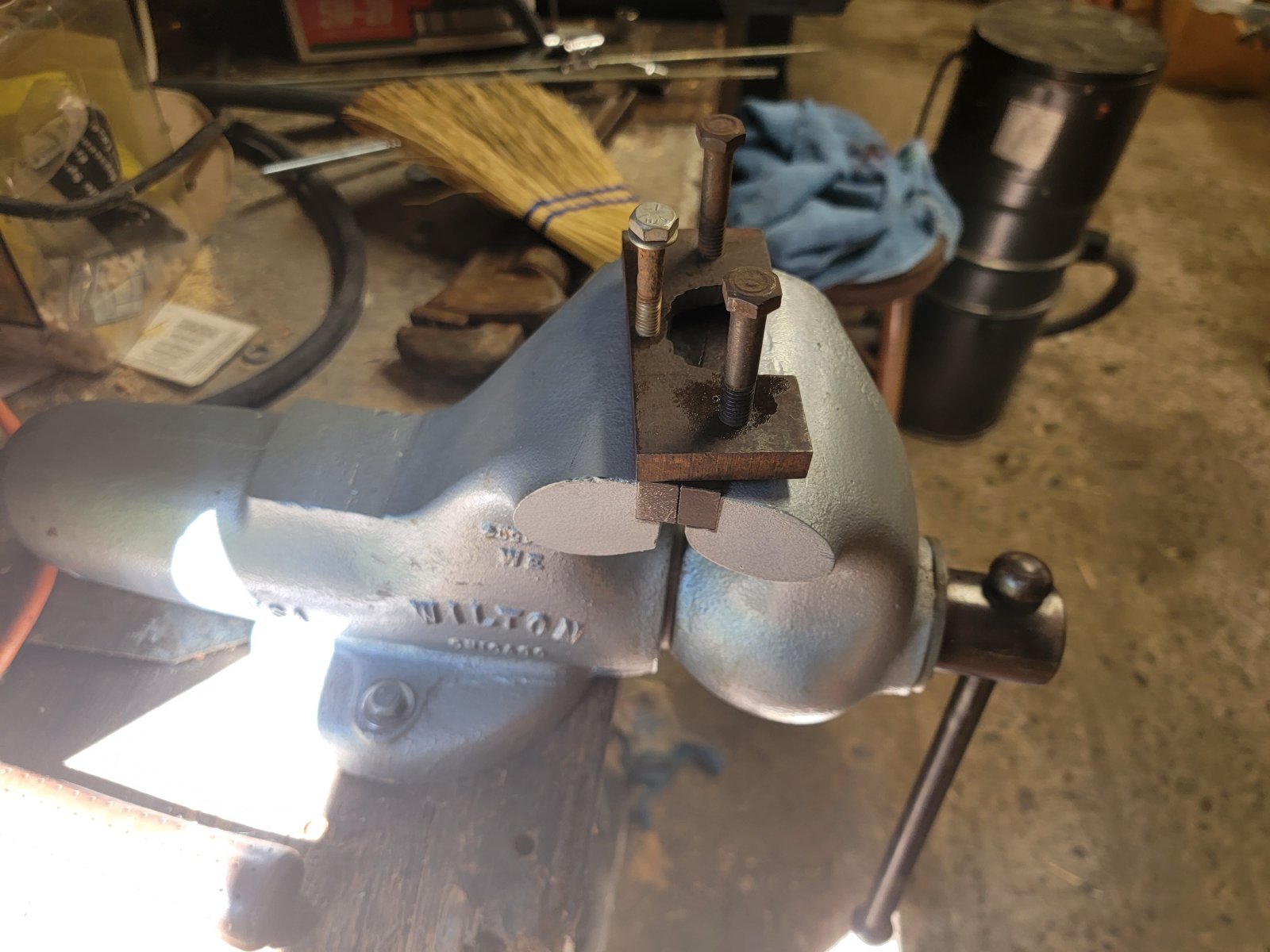

    Finally back on my homemade drum puller... juuust about there 20220814_112555.jpg 20220814_114343.jpg

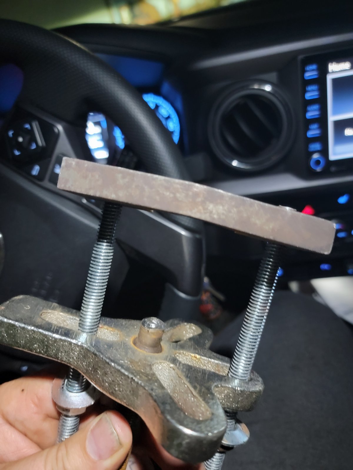

    Kind of thinking about going this route...gonna give it a trial run in a bit 20220814_173812.jpg

    Well shucks haha....didnt budge an inch! I worked it til it mashed the tip of the puller and bent my 1/2" thick contraption. Hit it with a sledge. HARD, nothin 20220814_211923.jpg 20220814_211926.jpg

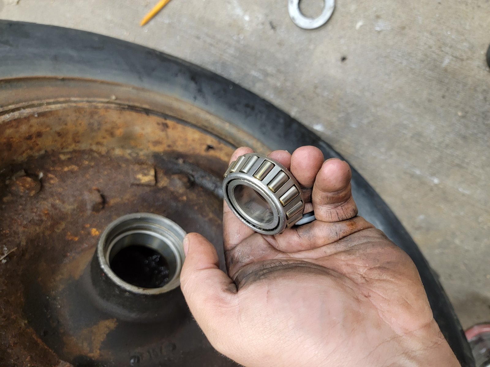

    If at first you dont succeed, hit it with a hammer some more... 20220815_104705.jpg
    Then came more issues.... so i had read somewhere that 36 ford drums dont work on the fronts with juice backing plates. I also read that 37 ford rear drums were the same part number as fronts and that those would work which spurred all of this nonsense. Well...they definitely dont fit on the front.... 20220815_105430.jpg
    So i suppose this means I am on the hunt for some wide 5 front drums from 37-39? On the plus side, the drum I pulled looks to have lots of meat and be in good shape, even had nice shoes! I stuck it back n. After I move it to the new shop I'll tackle putting a set of juice backing plates on. I'd like to run the 36 housing instead of the 37 though so I can use the 36 style arms (I've always loved the swooping look of em) mine need to be repaired since some dipdinkle cut em off but I think I can handle that. With the 36 being siezed I think its all gonna come down to swapping the 37 internals into the 36 housing then juice backing plates with the 37 drums! It will all come together

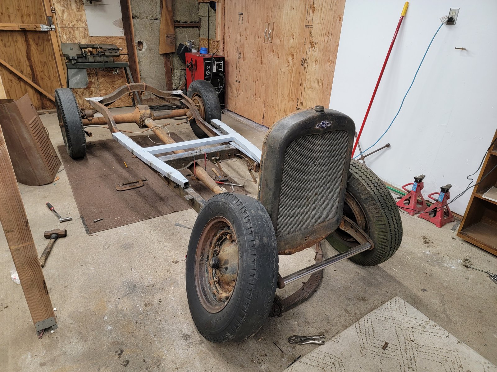

    Well....progress!! Little insulation, little drywall and a model a frame! 20220822_162002.jpg

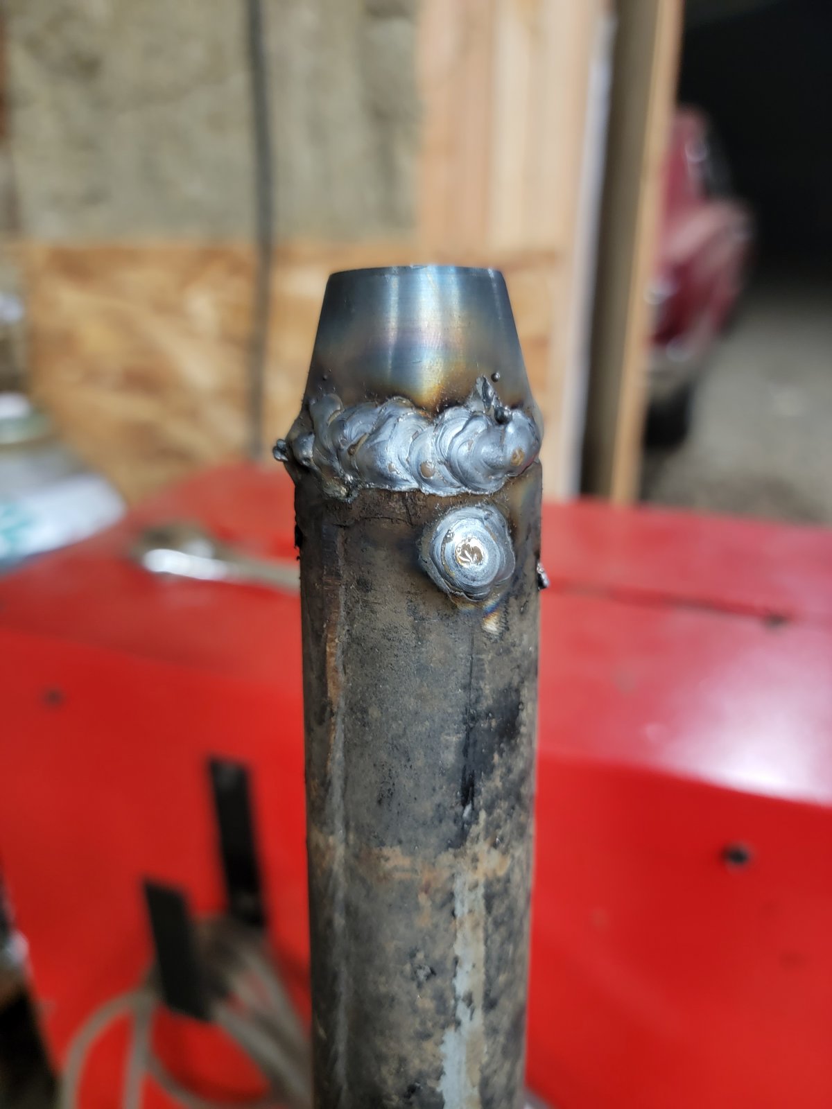

    Finally got my welder moved to the new shop and 220 hooked up for it so away we go! Started off with an easy one! Welded in my bungs 20220907_203917.jpg 20220907_203926.jpg 20220907_204240.jpg
    Okay so im not a proffessional welder but my welds penetrated well and thats why we have flap discs! Preview of coming attractions! 20220907_204629.jpg

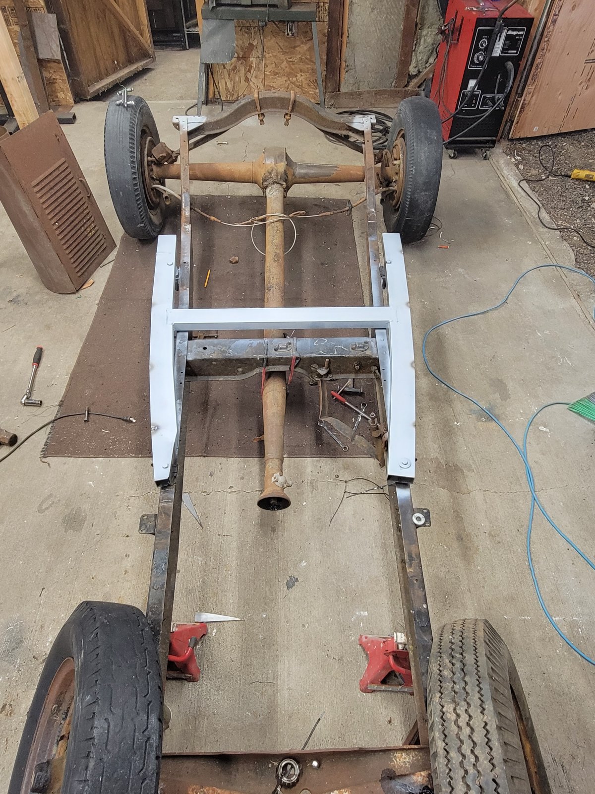

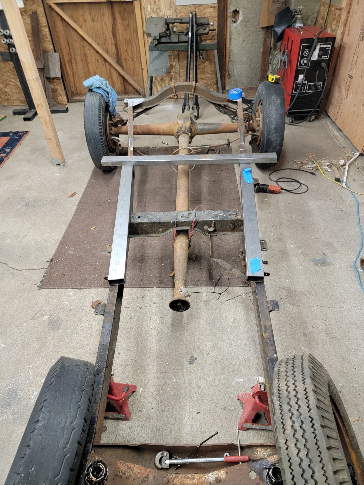

    Sub rails/ floor are started. Lots of measuring and pie cuts 20220908_105407.jpg and I have my profile. 20220908_113200.jpg My plan is a cross support at the rear and then cut out and bead roll the back half of the floor pan. Then I can cut the old sub structure off of the body, set it on and attach the new floors. The more I look at the pics of this thing the last time it was mocked up the more I am.leaning toward and inch or two of channel up front to bring it down over the rails. In the end I want a very slight rake so this should help get me to that look since the rear is already low and I am chasing it a little

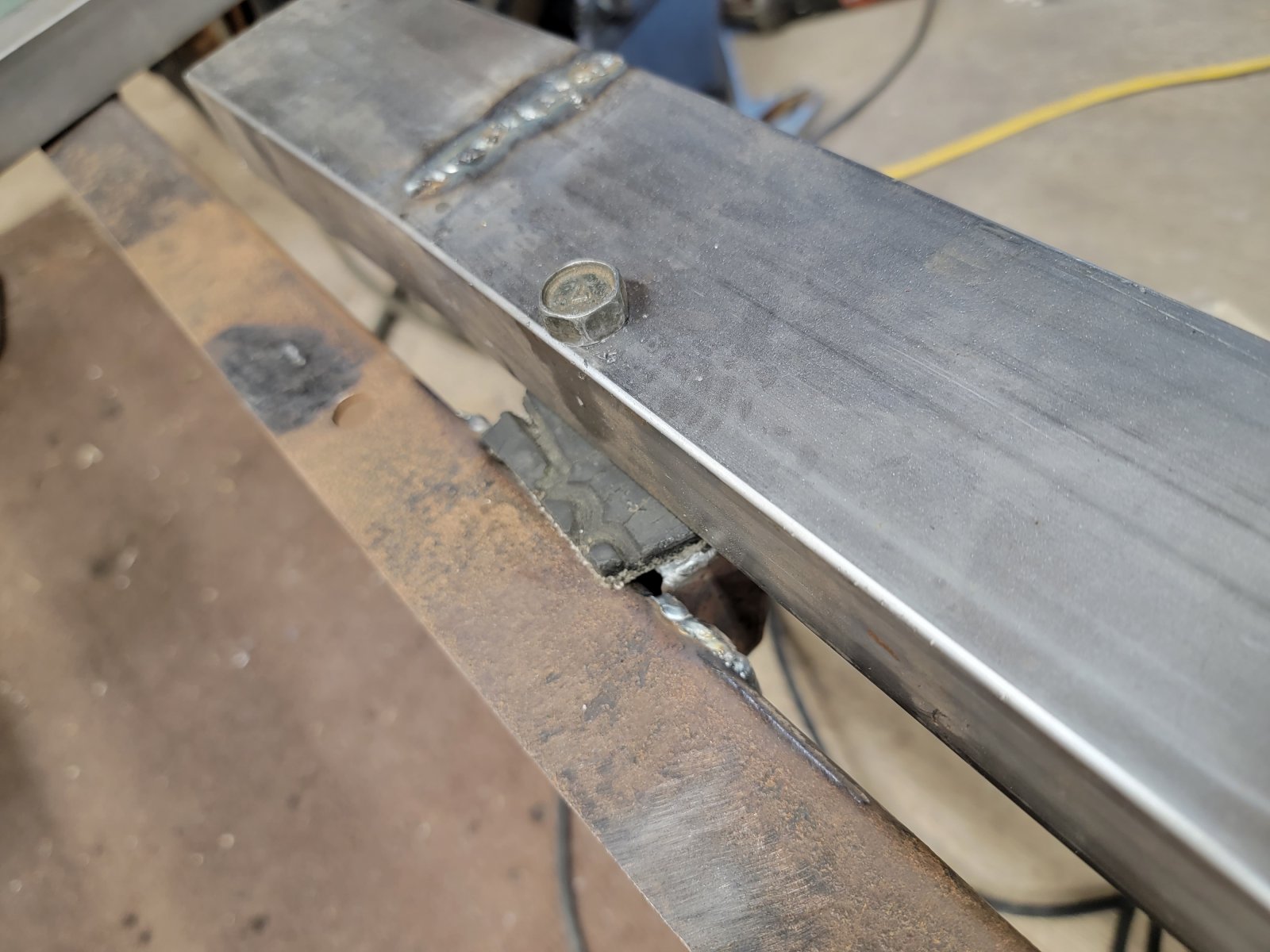

    Went back out and made a little more progress. Tapered the front of the pass side (still need to do drivers side)
    20220908_181854.jpg cut up an old 21" tire and made some body mounts.
    20220908_181905.jpg Also robbed these mounts that were on some rusty junk in the scrap pile and made some additional body mounts for a little more support since this things a bit wider than an a! 20220908_181814.jpg 20220908_181842.jpg
    Felt like the traditional thing to do, grab some junk I had and grind and weld until I have what I needed 20220908_184837.jpg 20220908_190013.jpg

    Pluggin away. Finished the duplicate body mount in the rear on the pass side and got the cross support in! 20220913_183727.jpg My welds were half decent this evening.... 20220913_182635.jpg also figured I would hang up my pretty stop light since I finally got it wired to a plug! 20220913_185504.jpg
