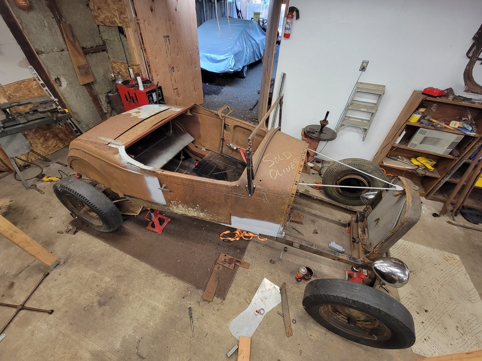

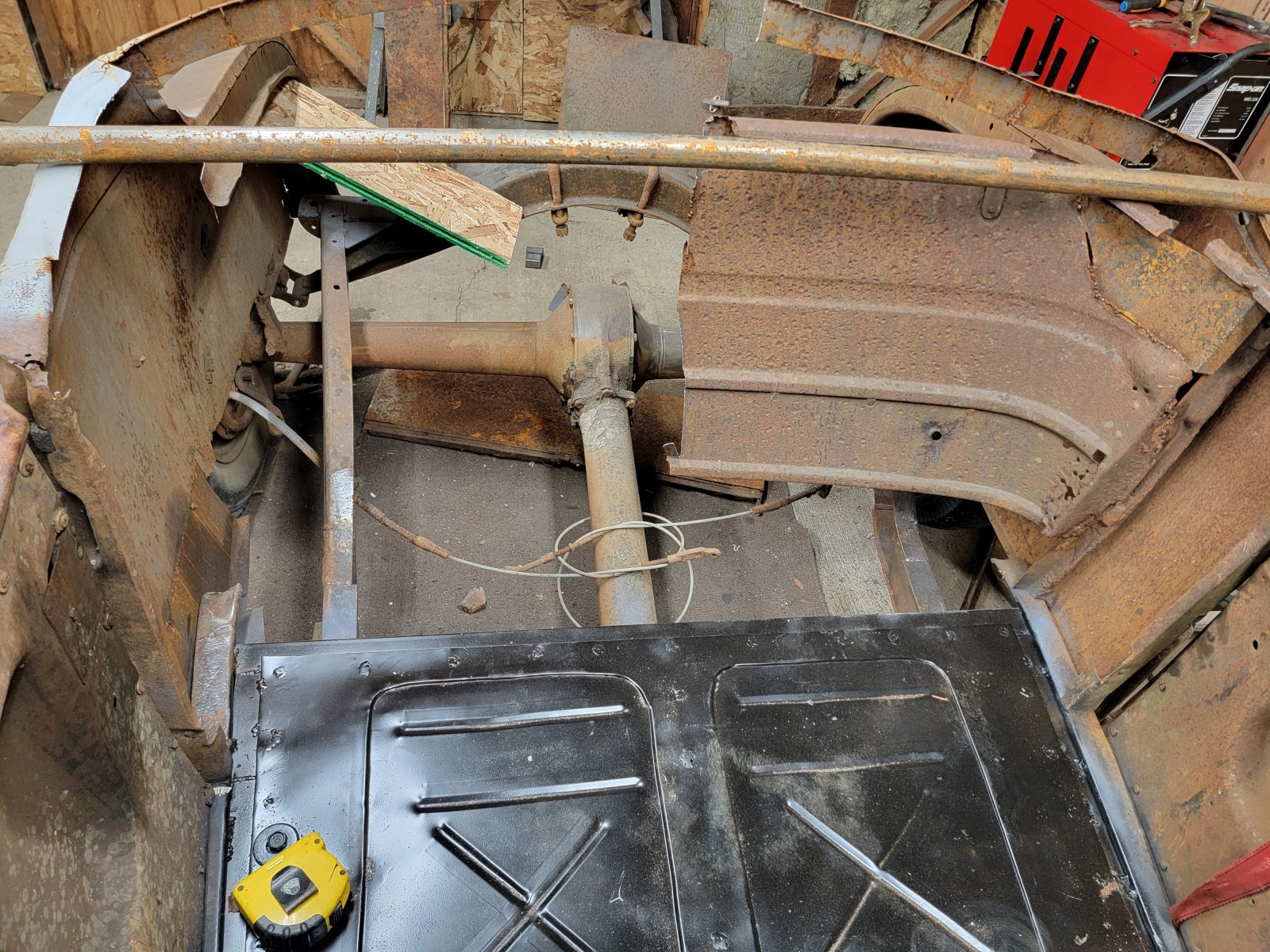

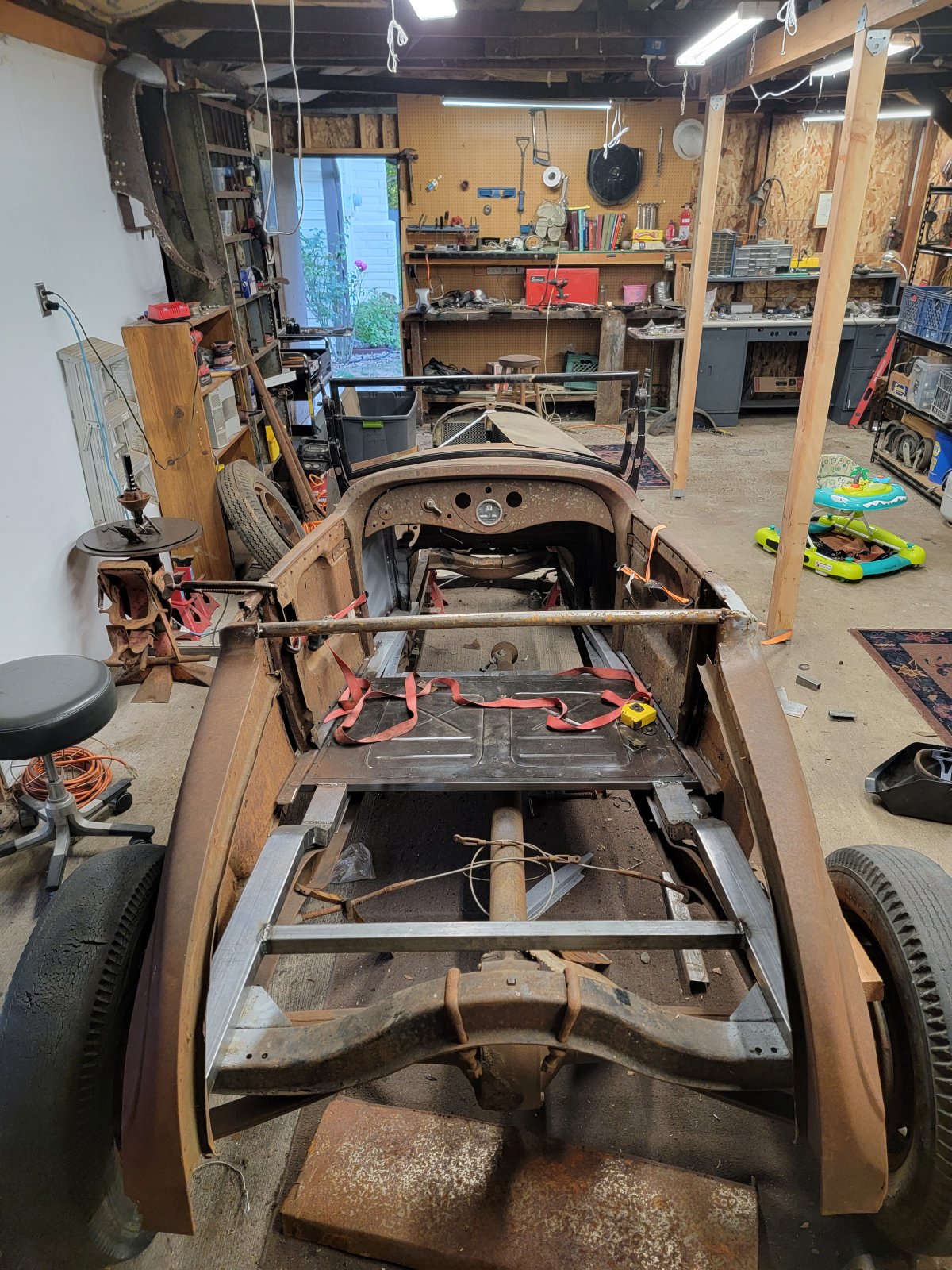

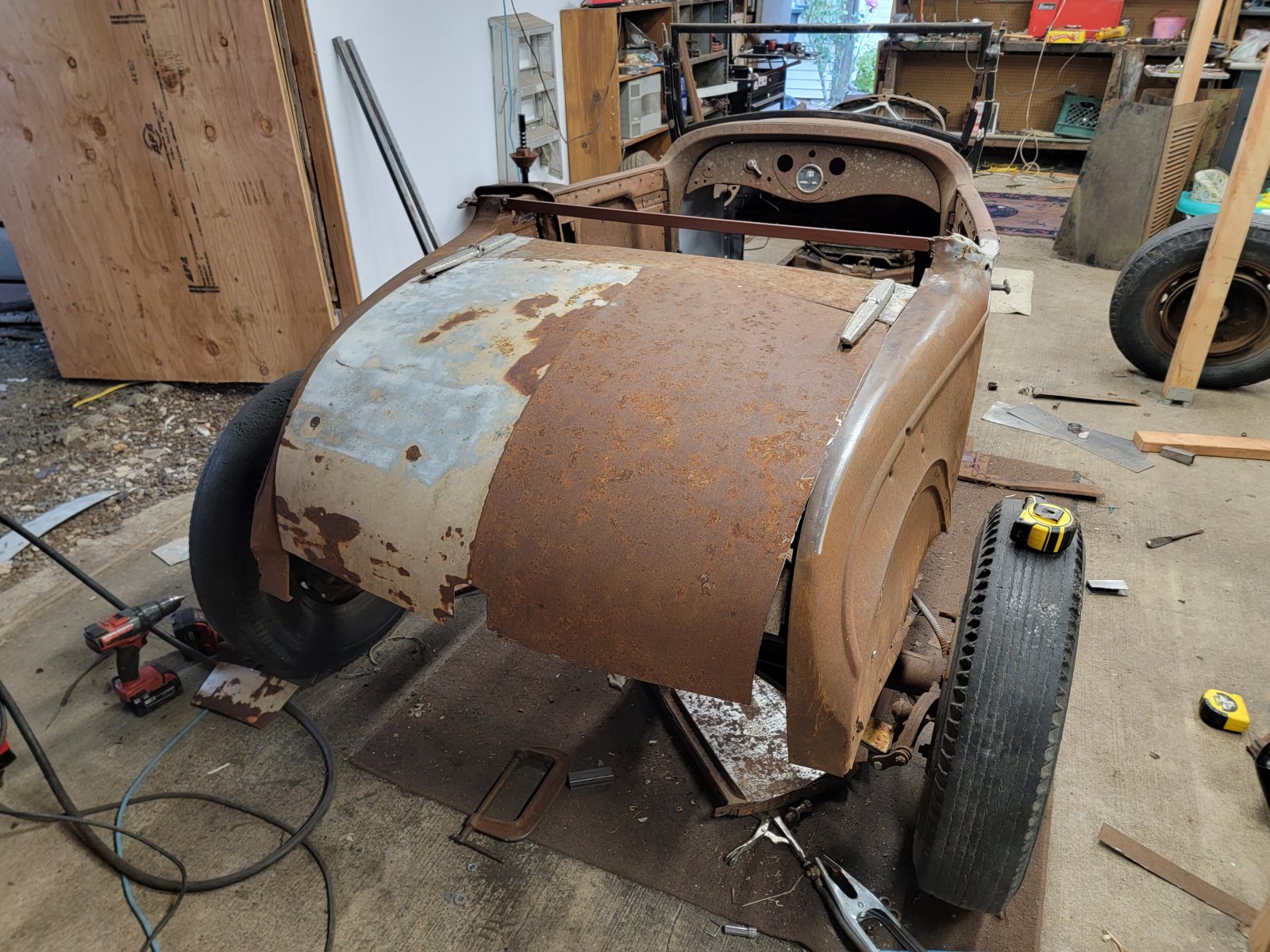

    Well....I cut the drivers rear quarter off. 20221011_164302.jpg It was about a half inch north of where it needed to be and an inch west, got it tacked back on in place. 20221011_173547.jpg Some sub frame in, will get some floors made and some permanent structure to get this floppy body secured. It had to be done! Ive known for a while that it would come to this and I definitely was putting it off...

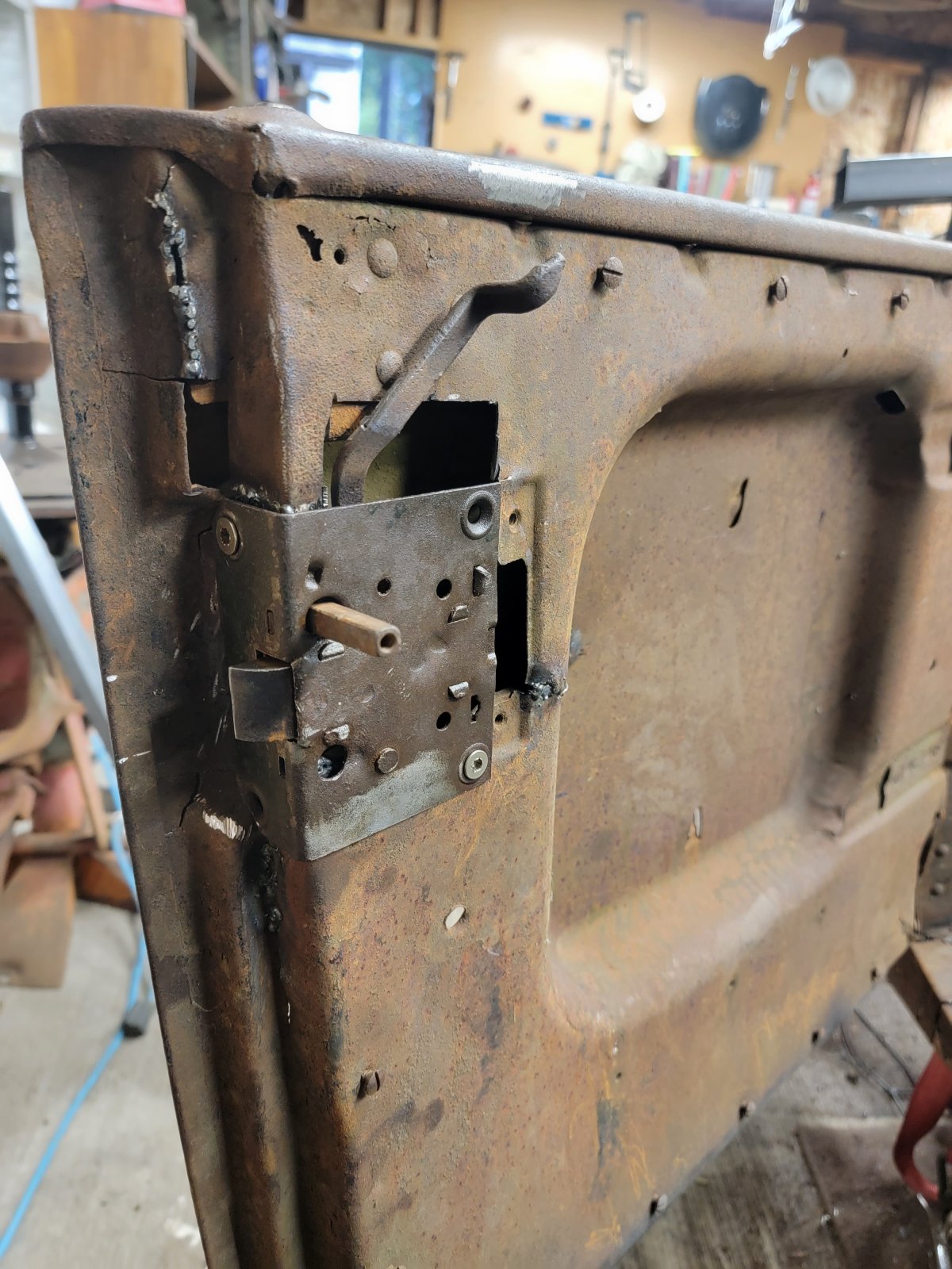

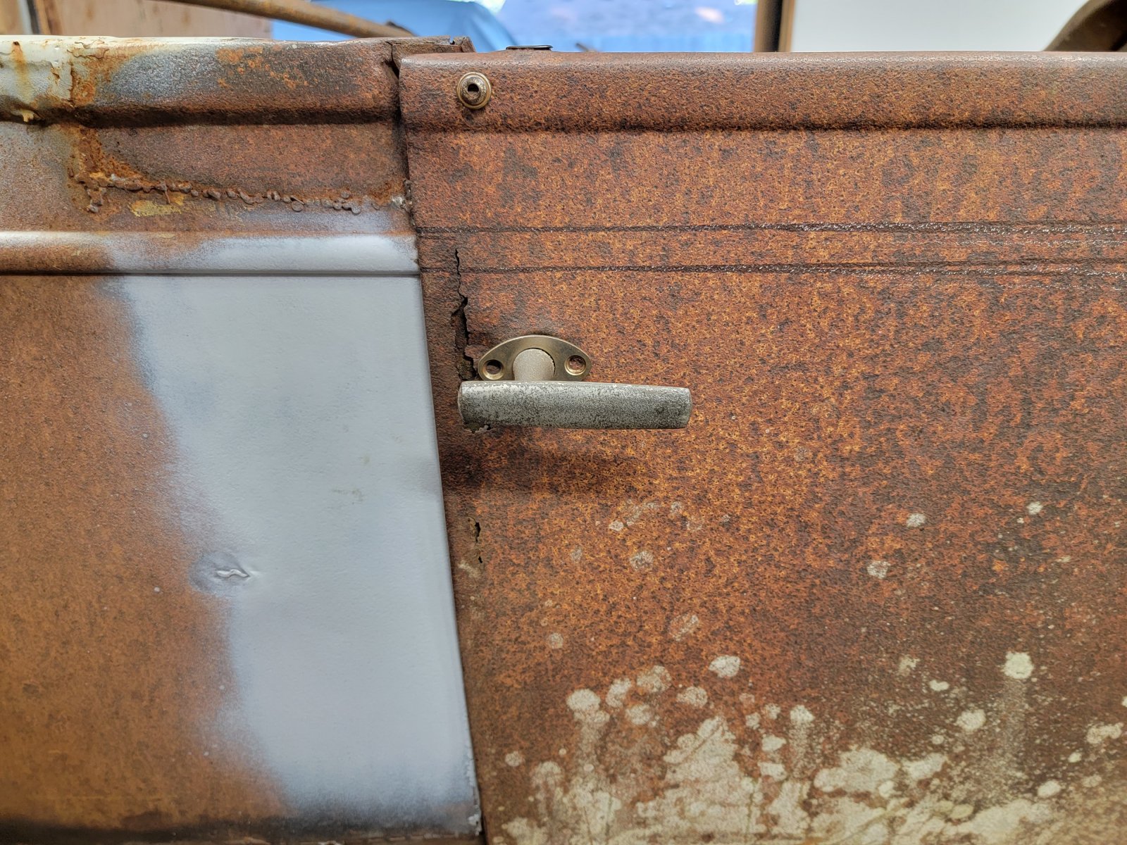

    Little side mission today, diss***embled door latch and fitted some random handle to it. Grinding, filing, sanding, wire wheeling and cursing later and I have a functioning door handle! It has been one of those little annoying things that slows me down every time I need to open it. At some point I will have to address the nightmare on the drivers side. 20221012_172224.jpg 20221012_172422.jpg

    If anyone has a handle that matches that you can part with give me a holler! I thought I had 2 but it appears I was wrong

    Eons ago, when I did my '32 5w, I didn't have the oem handles - inside or outside. Since it was a severe-low-budget-build, what I found to work well, was to use acvw inside handles, both the door latch & window(from a karman ghia circa 64 ,almost a perfect fit on the square shafts, & they look good, too). On the outside, I used the locking-handle version of a generic aluminum-pu-topper latch handle. The square-shaft was also almost a perfect fit into the latch. The mounting holes were slightly different, so I just made a thin adapter to allow the machine screws to angle in easily. No cross thread issues. If I hadn't wanted to *not* alter either the pristine doors or the chromed handle-base, it'd been easier. Both were inexpensive, looked period.
    Which look similar to your handle.

    Good idea! Thanks! I found a few on fleabay that match but theyre around 50-80 each. Im sure at some point I will get a nice matching set as this is going to be a bodyworked and painted car but i figured maybe someone has a junky one layong around til then. I wouldve given the one Im using away before I found a use for it! I will look into the volkswagon handles

    Early acvw stuff is getting spendy, but if you're lucky... :) . The early handles used nice small white tapered knobs, not the ugly clunky black discs later ones used.
    Those latch handles worked surprisingly good. & were very cheap, like ~ $10 usd, maybe...
    You could also look at the-repop modelA outside handles = almost perfect copies of each other. ModelA being a whole lot more expensive, & since you're modding the sheetmetal anyways, <shrug>.

    I might go with these...i kind of dig em Screenshot_20221013-200645_Chrome.jpg

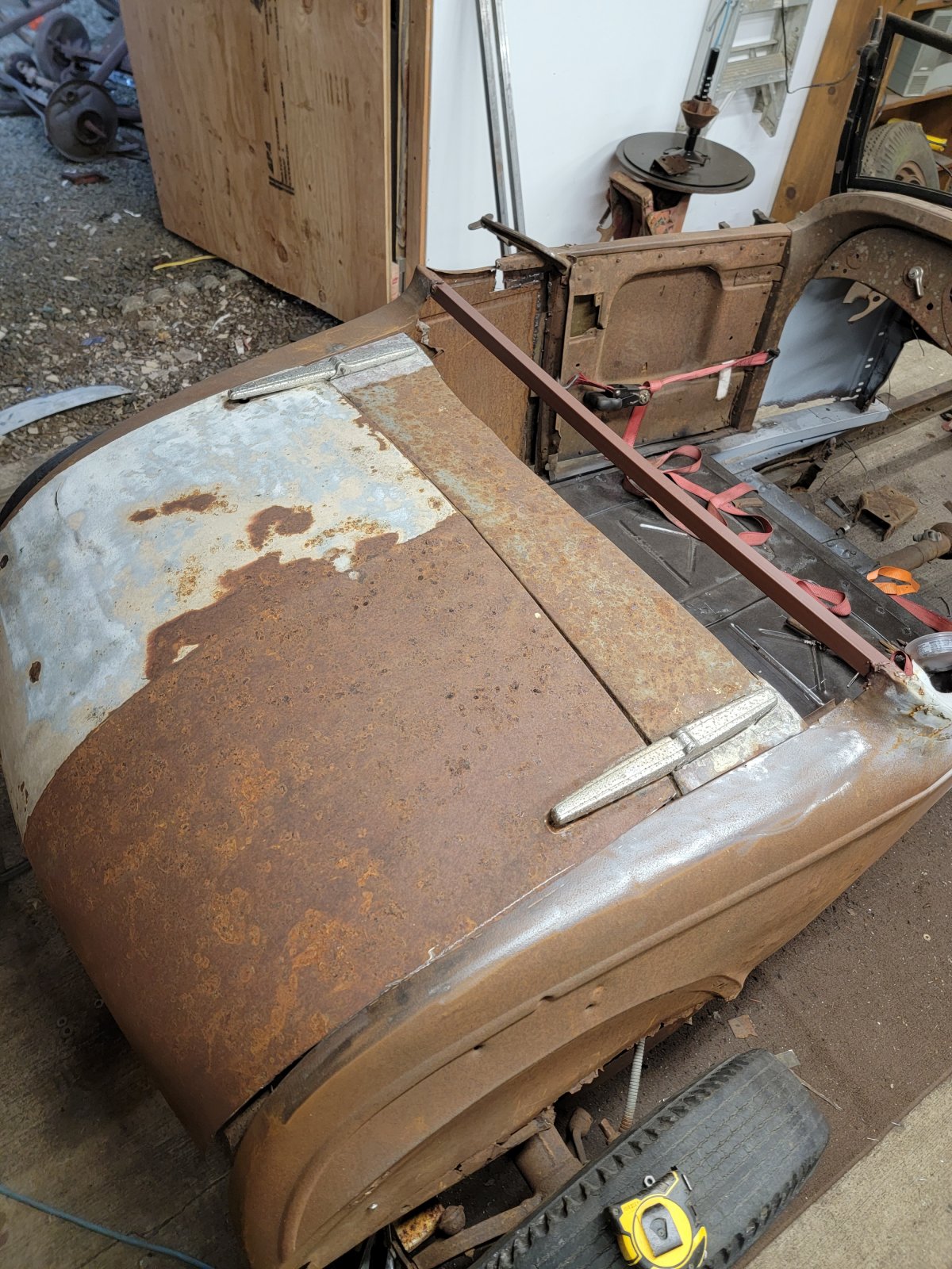

    The 49 lincoln trunk lid was calling to me, i dig the inner structure 20221016_191330.jpg as well as the ridge down the middle. 20221016_185946.jpg 20221016_190358.jpg Will have a bit of clean up and m***aging to do before its a trunk lid but I think its on the right track. Also replaced an earlier patch I did with a better one, the previous patch didnt have enough contour and was causing a buckle. 20221016_204144.jpg Definitely little by little. Have a cpl options for hinges(49 linc and some exterior hinges off of a humpback) I think it will end up with a really neat look! Slowly looking more and more like a car and my vision

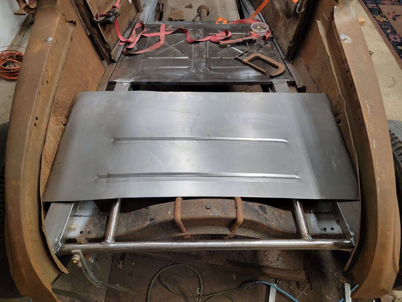

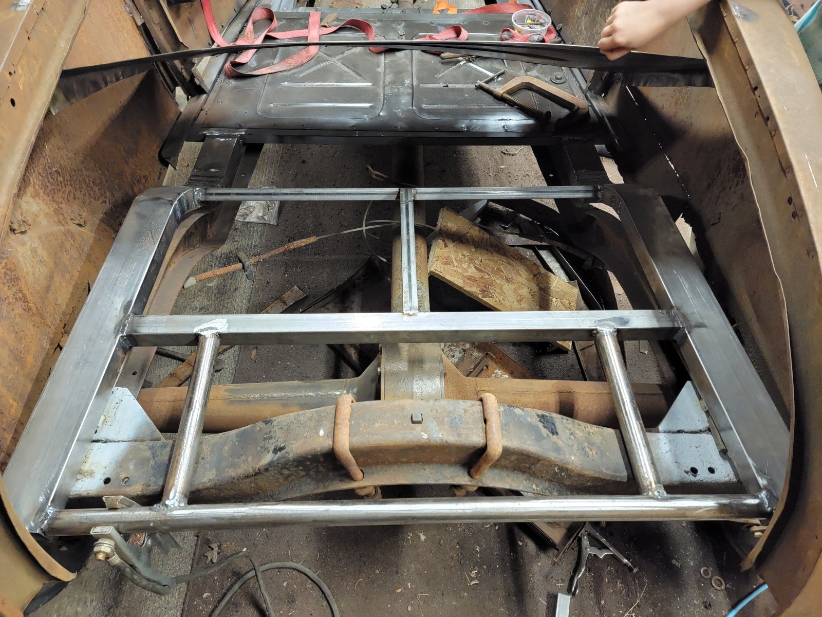

    Little more sub frame, 20221017_210236.jpg beginnings of rear floors, 20221017_203921.jpg gotta get some more weld through primer tomorrow and clean up the insides of the quarters before I put the floors in permanent. Also want a good coat of weld through on all the sub frame so rust doesnt start next week. After rear floors go in I can add some quarter supports that should really tighten this thing up. Not gonna be any wood in it so it needs a lot of structure added

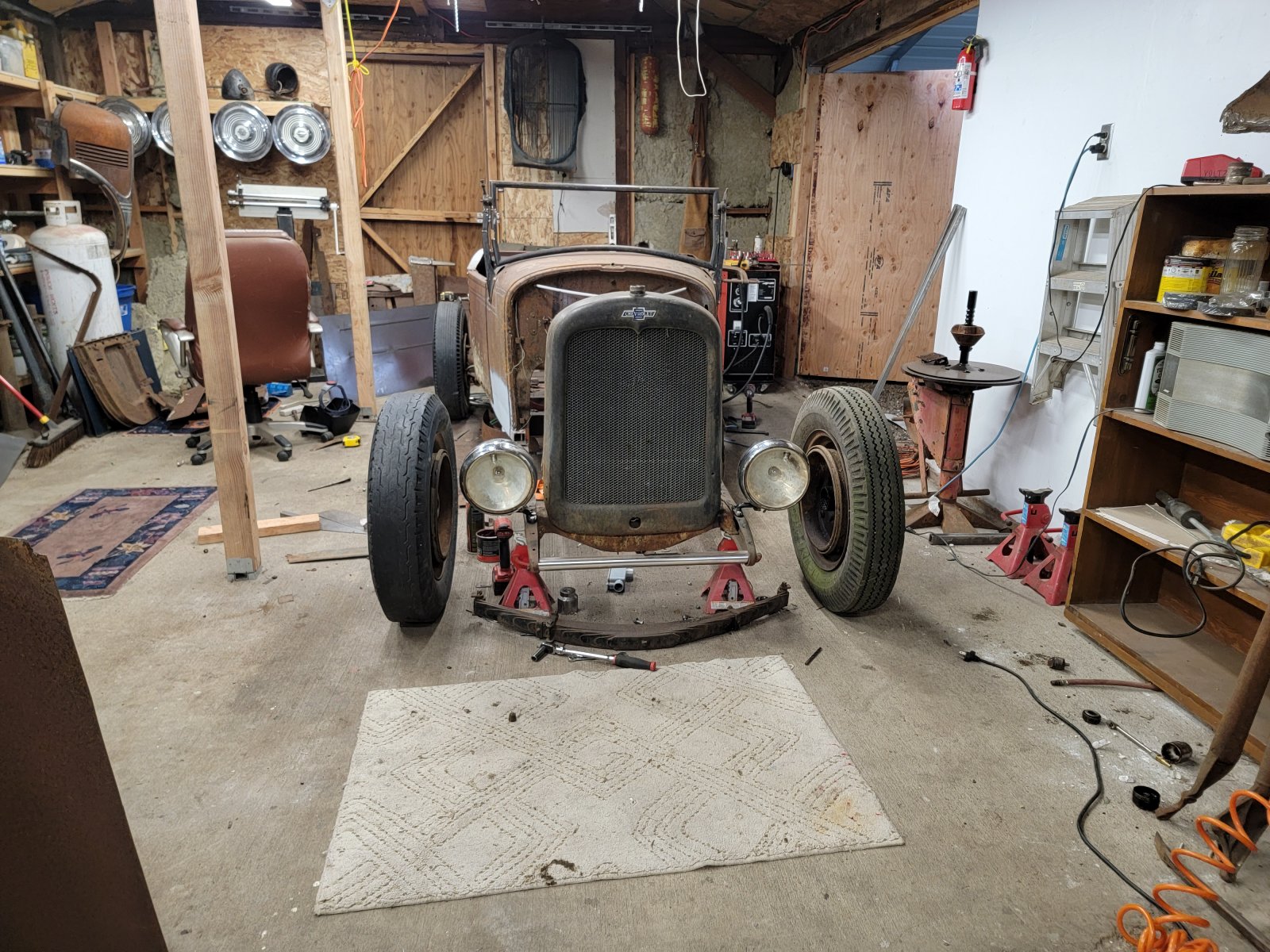

    Will need some t******* and fitting but I really dig the look! 20221018_171858.jpg Also tried a low headlight mount. I dig it, not sure I am sold yet but used an existing hole and a bolt so no harm no foul. 20221018_173706.jpg Headlights are chevy, I dig the big chrome. I dont want too much chevy on it but they do look good on there 20221018_173713.jpg 20221018_173716.jpg

    some states have height requirements.

    Good tip! Oregon has many laws this roadster violates. Cops dont tend to enforce em though, I will likely chance it. The stands came off another oregon rod anyway

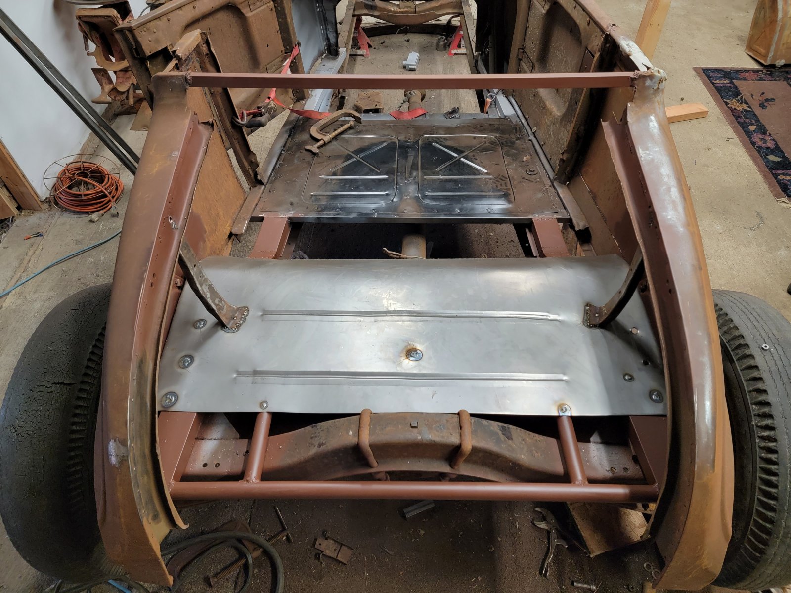

    Knocked some rust off and sprayed some primer on. 20221018_212606.jpg If I find time tomorrow, Ill do the other side and perhaps even get the rear floor in!
  26. oliver westlund
    Joined: Dec 19, 2018
    Posts: 2,858
    oliver westlund
    Started off today by knocking the crusties off the p*** side. Got it sprayed in red oxide and then tackled the floor 20221019_144617.jpg The floor is primered on the underside; once I got the floor spot welded in, I added two rear quarter supports. 20221019_154447.jpg Pretty amazing to have a semi solid car to work with! More supports are in order and more floor but pretty big steps today! 20221019_155924.jpg Also mocked the trunk and tires back up as well as raised the rear to where I think itll sit... it will get shorter front tires as well 20221019_161648.jpg 20221019_161636.jpg 20221019_160017.jpg 20221019_160659.jpg
