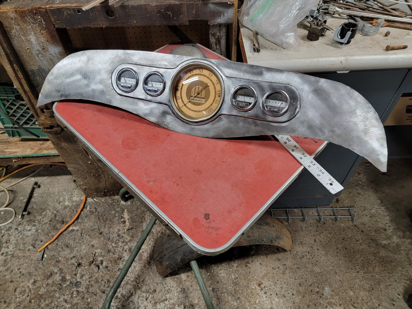

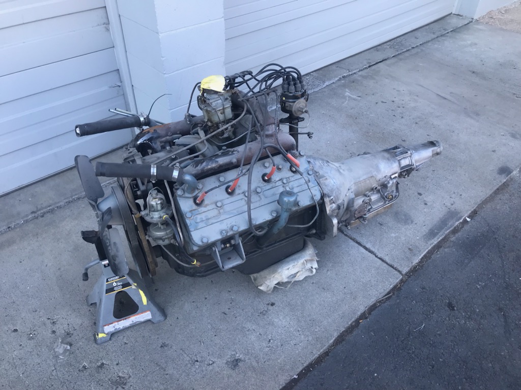

    Found a neat piece from idk what that I will run over the 1x1 behind the seat! 20221025_112635.jpg Also figured I would post the car that inspired the lincoln 337 engine going into the roadster Screenshot_20221028_145212.jpg ...no, its not a 337, its a cad flatty but from 40 yds away you could tell it was unique and looks like a beast, the lincoln should satisfy the same look

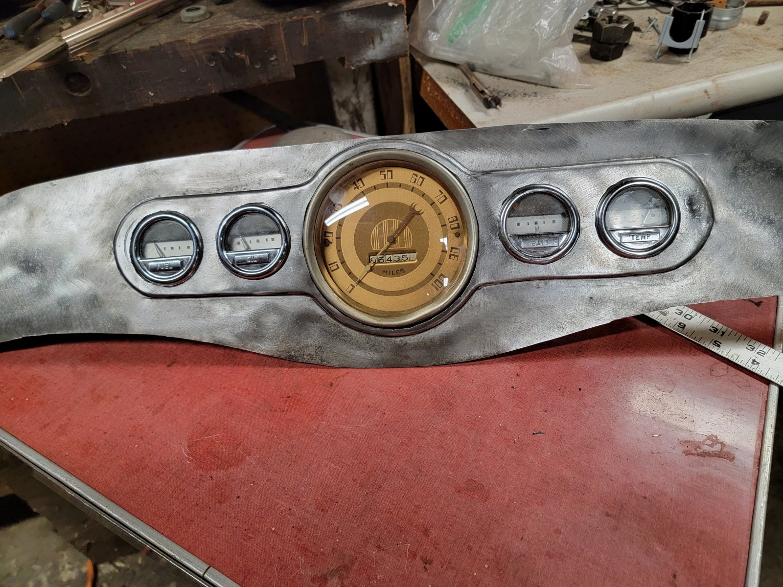

    oliver westlund

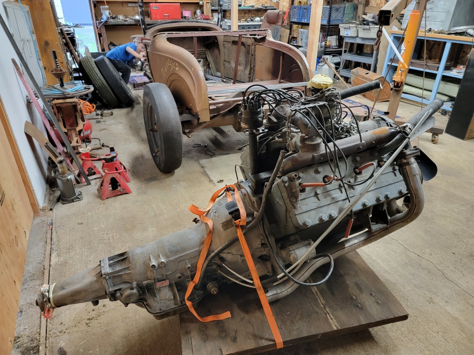

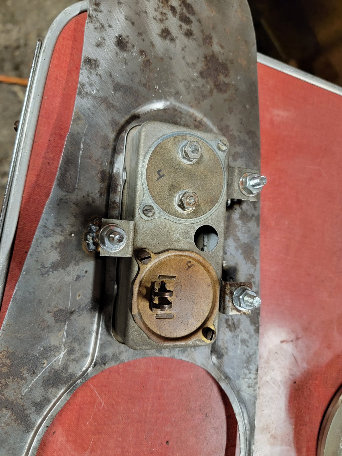

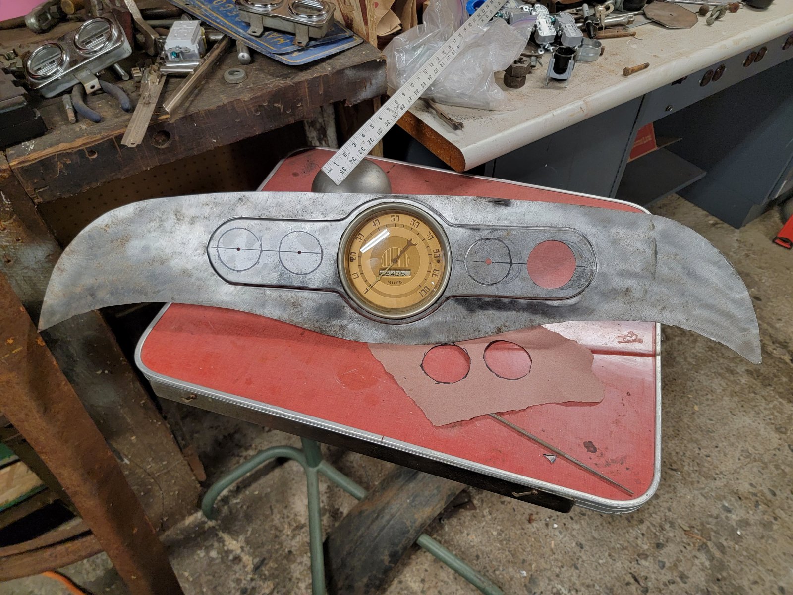

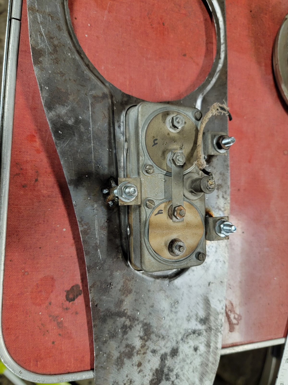

    Stayed up until about 4:30 this morning in the shop. Managed to make leaps and bounds with the dash and guage project! 20221101_012245.jpg 20221101_012253.jpg I got the other side of holes cut then I tacked on some bolts to mount the pods. 20221101_014717.jpg 20221101_014719.jpg Really happy with how thats going. Its not perfect but I think its cool. I think when its done, the raised part around the guages that looks like a bezel I am going to have powder coated silver then paint the rest of the dash.
    With the cad flatty I also got a rebuilt 47 merc front end and rear end. 20221101_025126.jpg I got to looking at the drop, did some measuring, removed the sway bar and panhard bar and stuck my 39 front spring pack on it.....the punch line is it looks like a gasser! 20221101_025130.jpg Oh well...I tried! Looks like I still need to order a drop axle! I think I am still goimg to push forward with the 49 lincoln flathead for this rod. If I run into major issues I can always still run the cad flatty

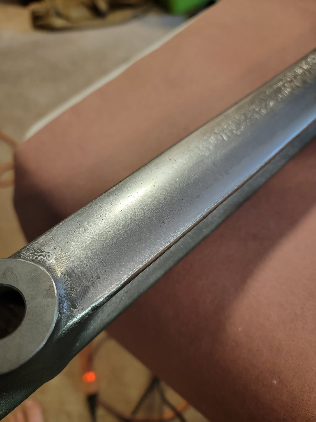

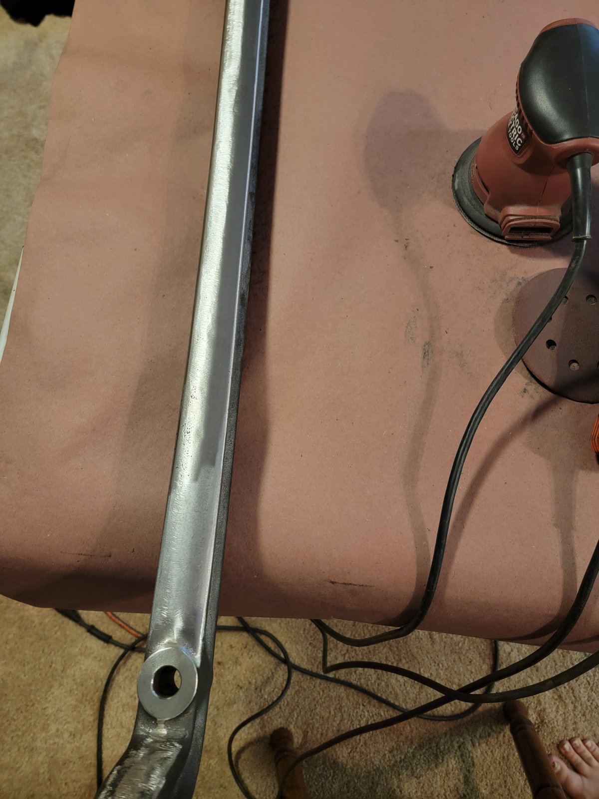

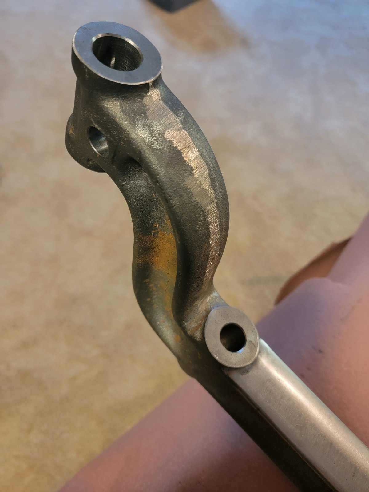

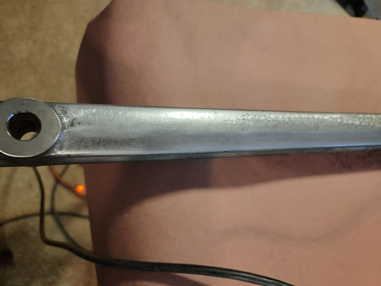

    Made some progress finally... 20221127_111447.jpg couldnt get over how ugly my new drop axle was (its cast and they hacked and ground off the seams) so i cleaned it up today. 20221127_114723.jpg 20221127_120510.jpg 20221127_121104.jpg 20221127_121713.jpg 20221127_121725.jpg After quite a slippery slope of how far should I go with this, I spray bombed some red oxide on 20221127_123430.jpg then stuck my in need of being dropped spindles on. Pulled the 47 front end out and took a break. 20221127_154248.jpg Looking forward to seeing this thing lower!

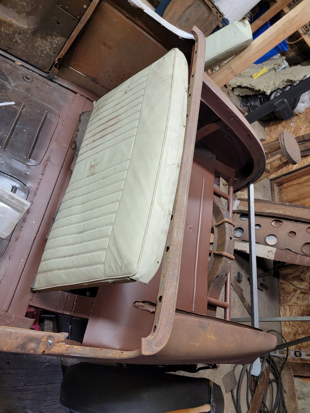

    Picked up potential seat option...not sure if i wanna go buckets or not but i kinda dig em 20221210_104159.jpg

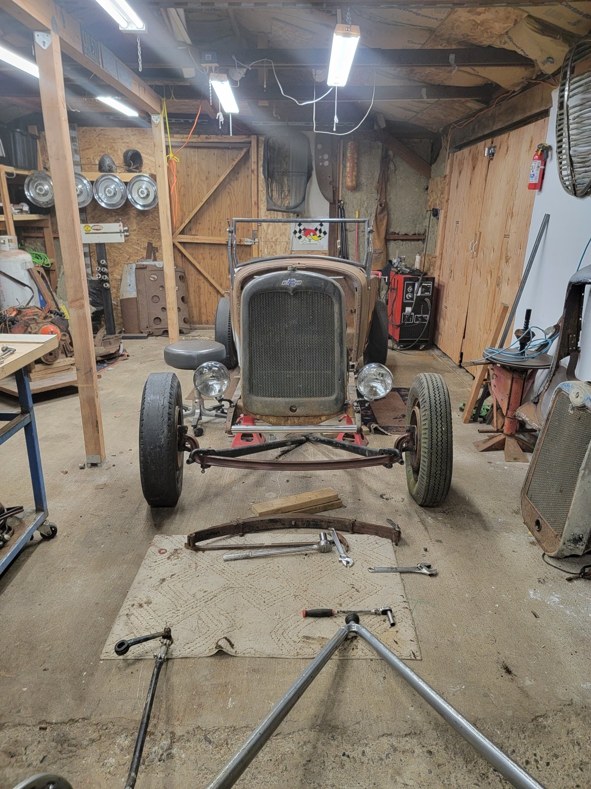

    oliver westlund

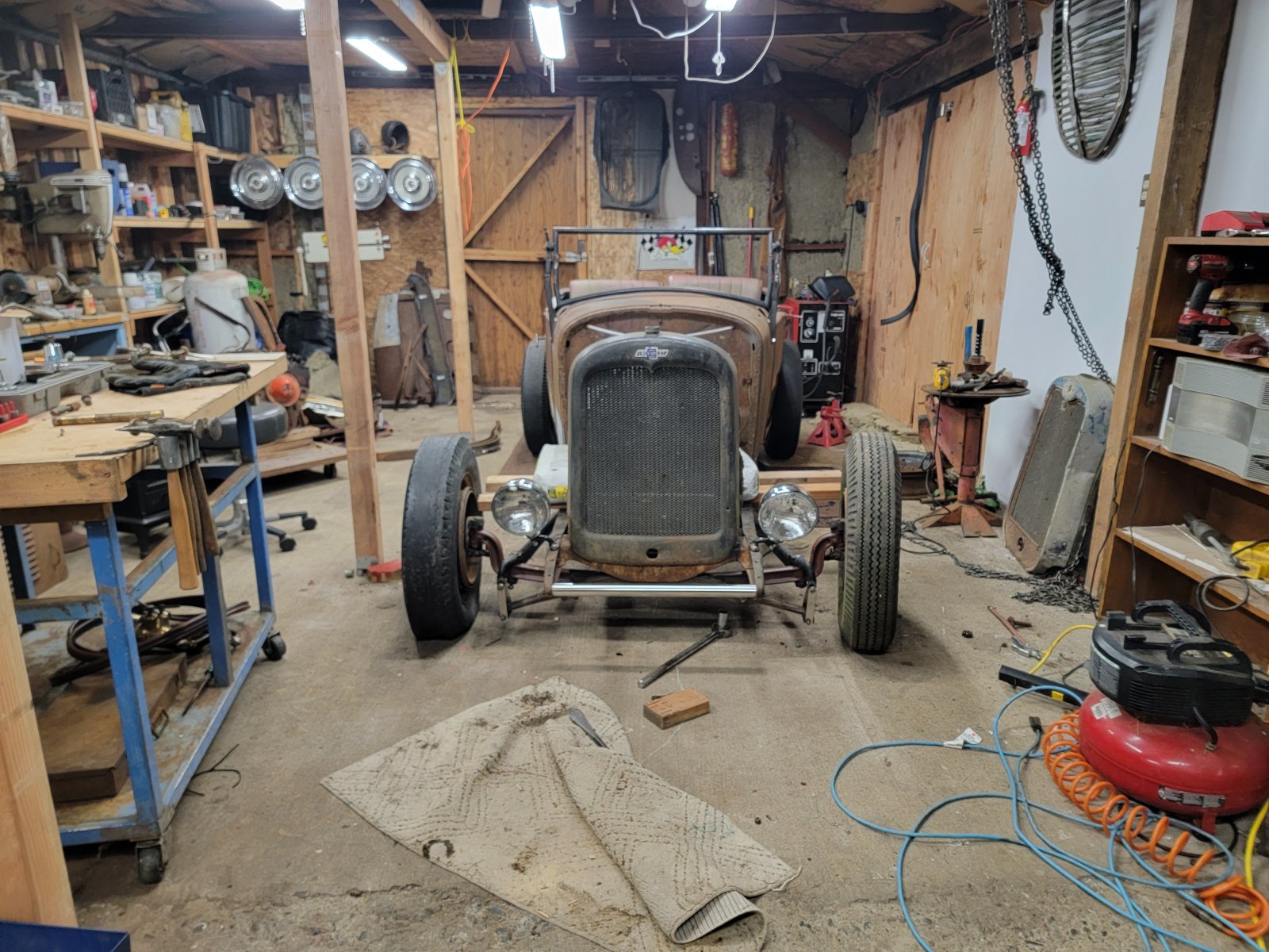

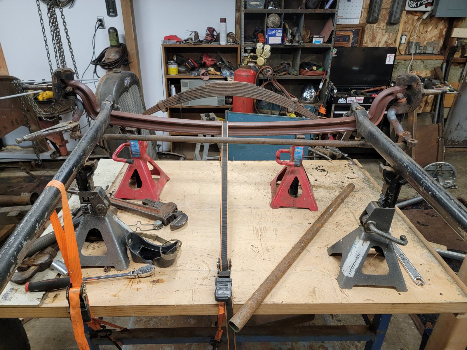

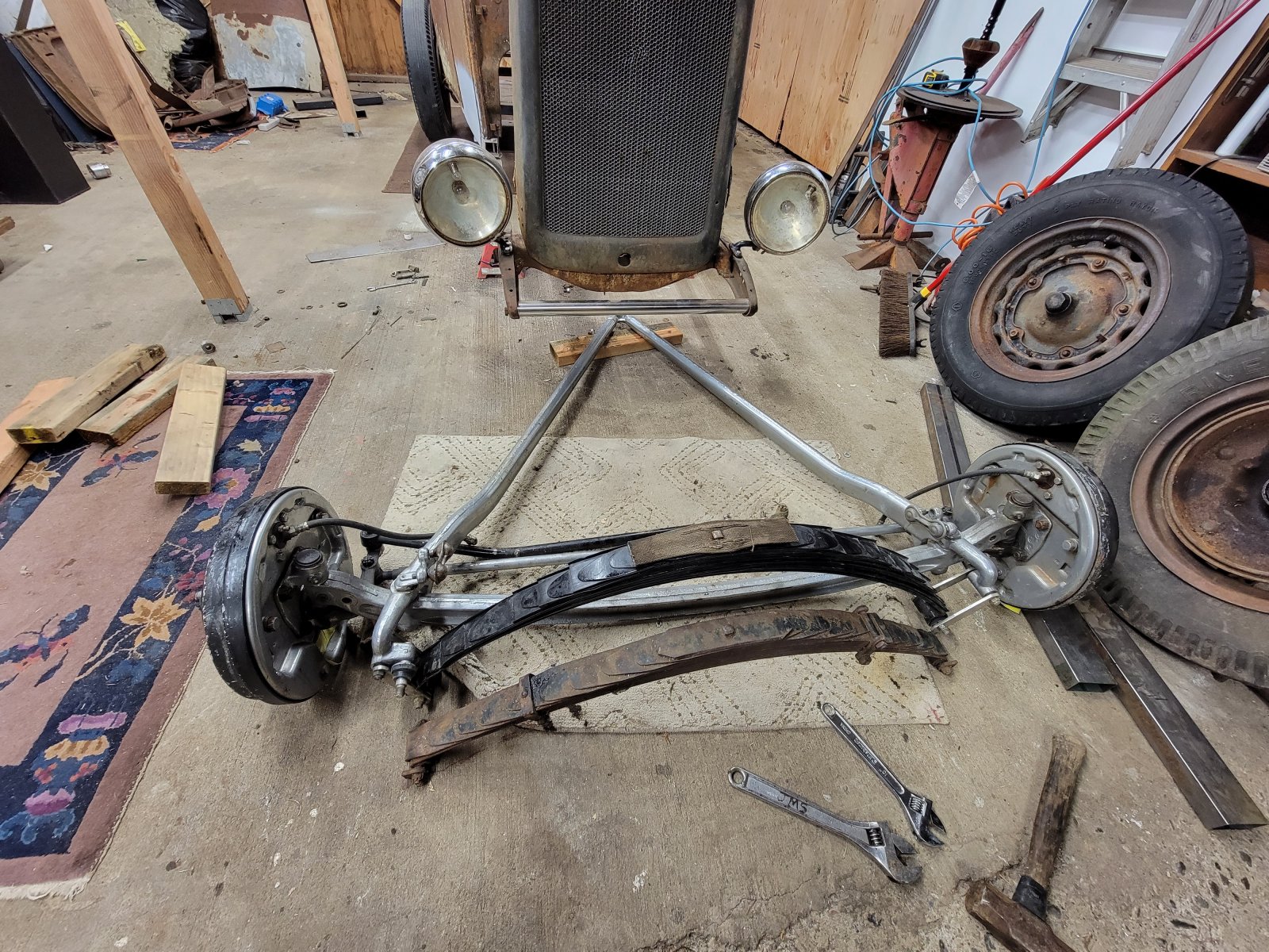

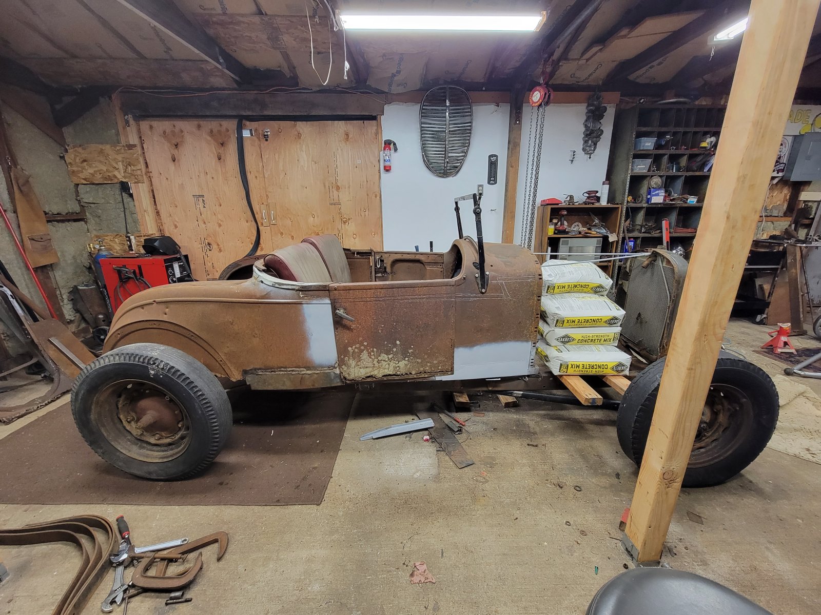

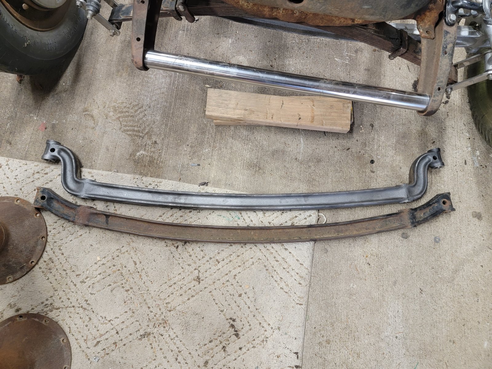

    Supports in! 20221214_104656.jpg axle underneath 20221214_112118.jpg Need to shorten the drop shackles, the angle is too extreme to run without a panhard. Next will stick the new rear spring pack in and see if that brings the booty up the inch or 2 needed for the rake I am after. Also would like to set 850 lbs on the front of the frame to simulate the engine
    brEad and scotts52 like this.

    oliver westlund

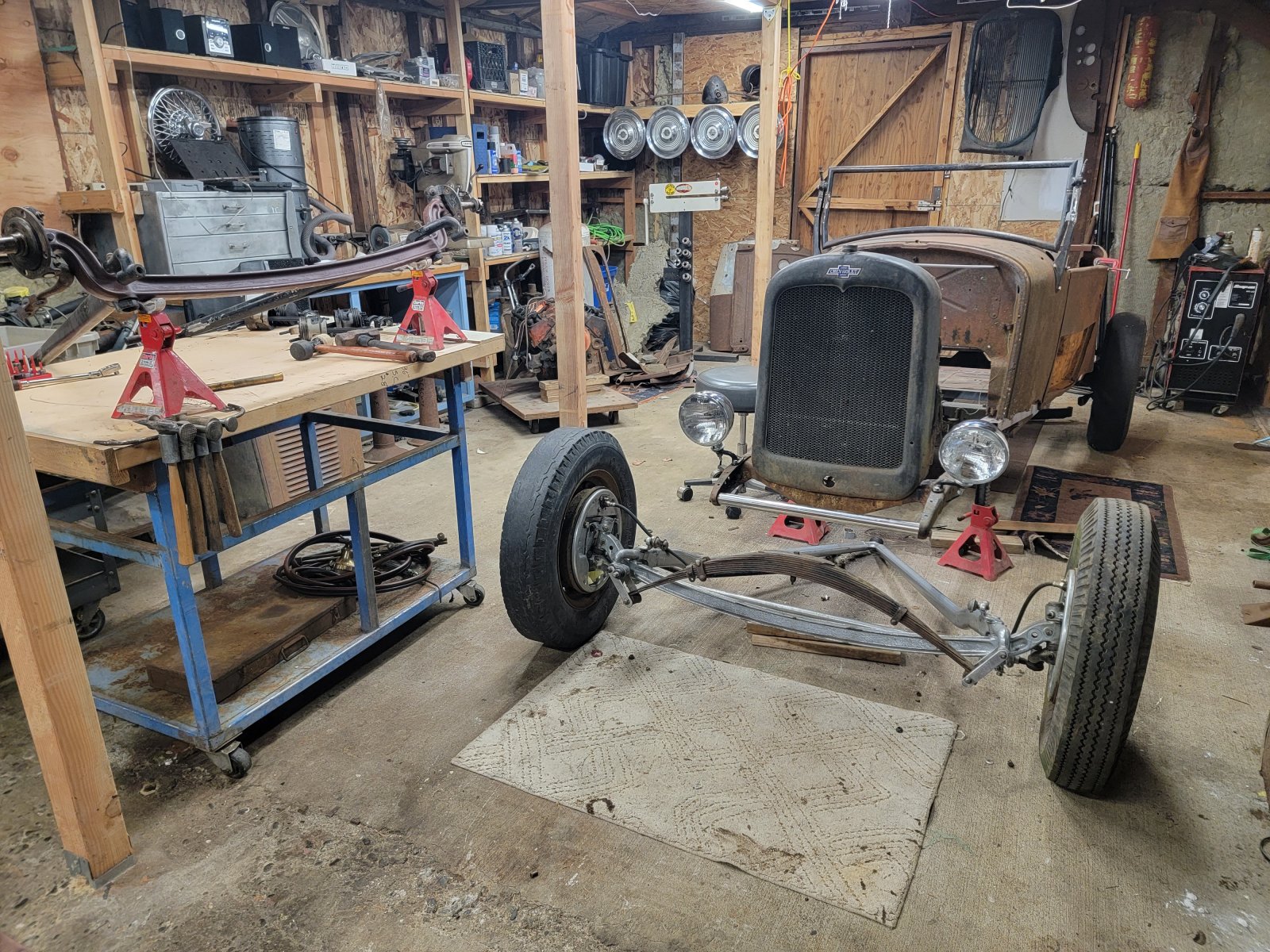

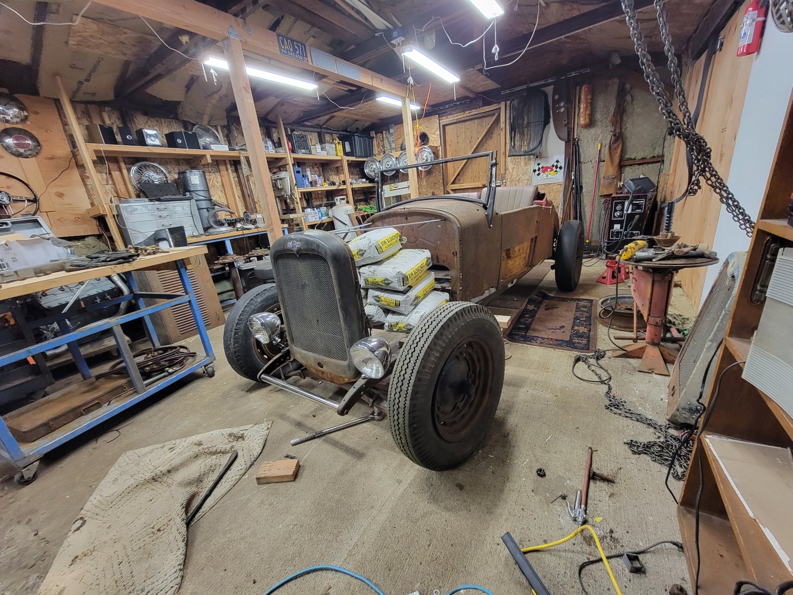

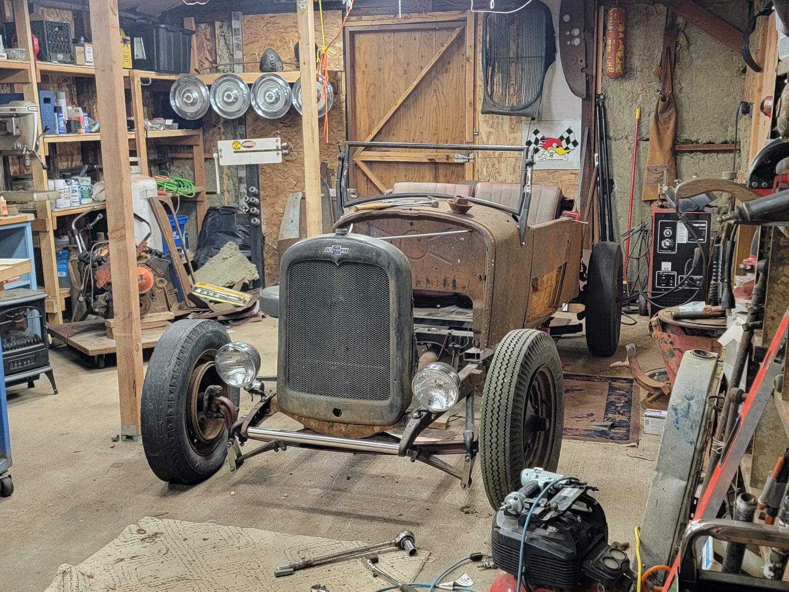

    Well....still about 500 lbs light up front hahaha but its lookin more like its on purpose with every move. 20221214_180606.jpg Also will be going taller rear tires and shorter fronts, should help 20221214_180420.jpg 20221214_180552.jpg

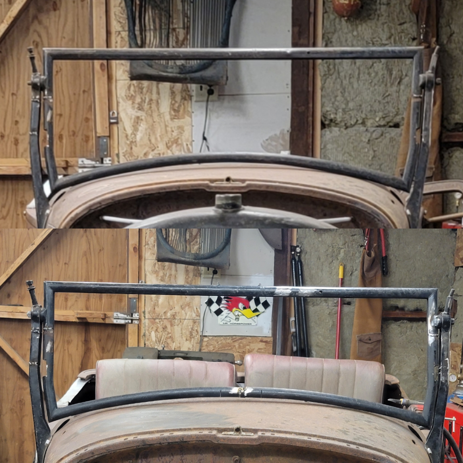

    oliver westlund

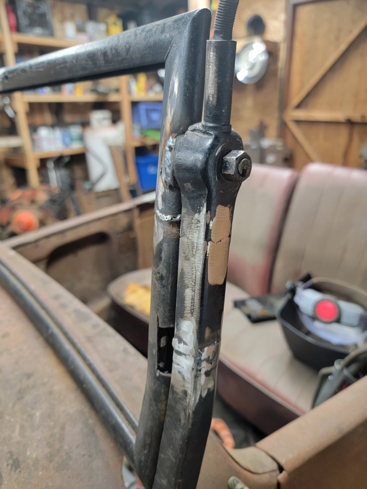

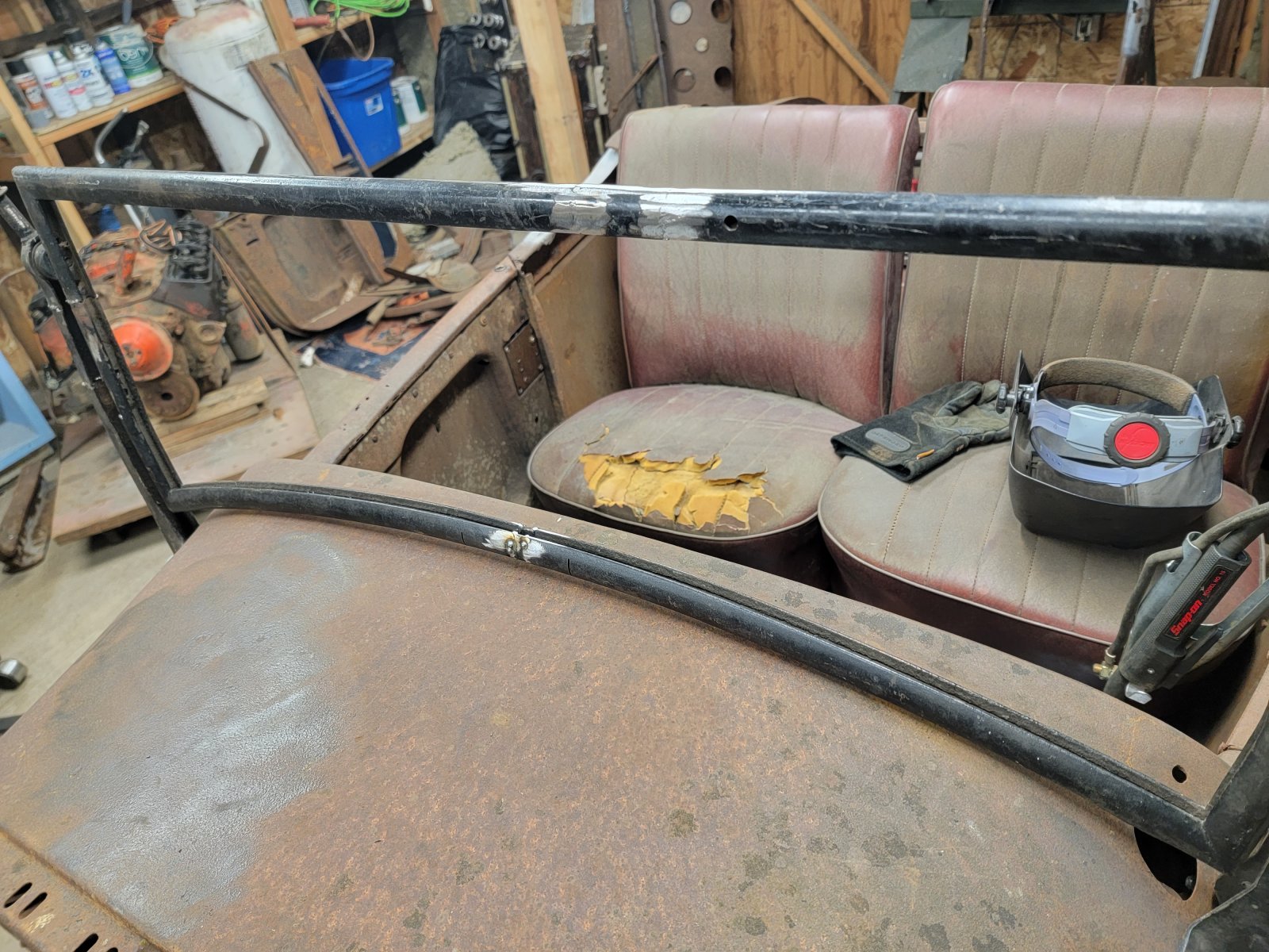

    Been bugging me for a while and I know its silly but the windshield was a half inch too narrow for this cowl... most people would probably never notice but I saw it constantly so I added a half inch tonight. IMG_20221216_214849.jpg 20221216_212328.jpg Within that repair, I cut out a .22 cal bullet hole also and replaced that entire area on the top. After I did that I raised the drivers side stanchion a 32nd of an inch... 20221216_212312.jpg again, not a huge deal but it was buggin me. There are some other issues as well but I am undecided on the best way to approach them... I am going to open up the diagonal seams at the top and add brackets to make the top removable for installing glass. When I do this, I may remove another half inch of height. Not positive yet, needs a few more hours of staring...

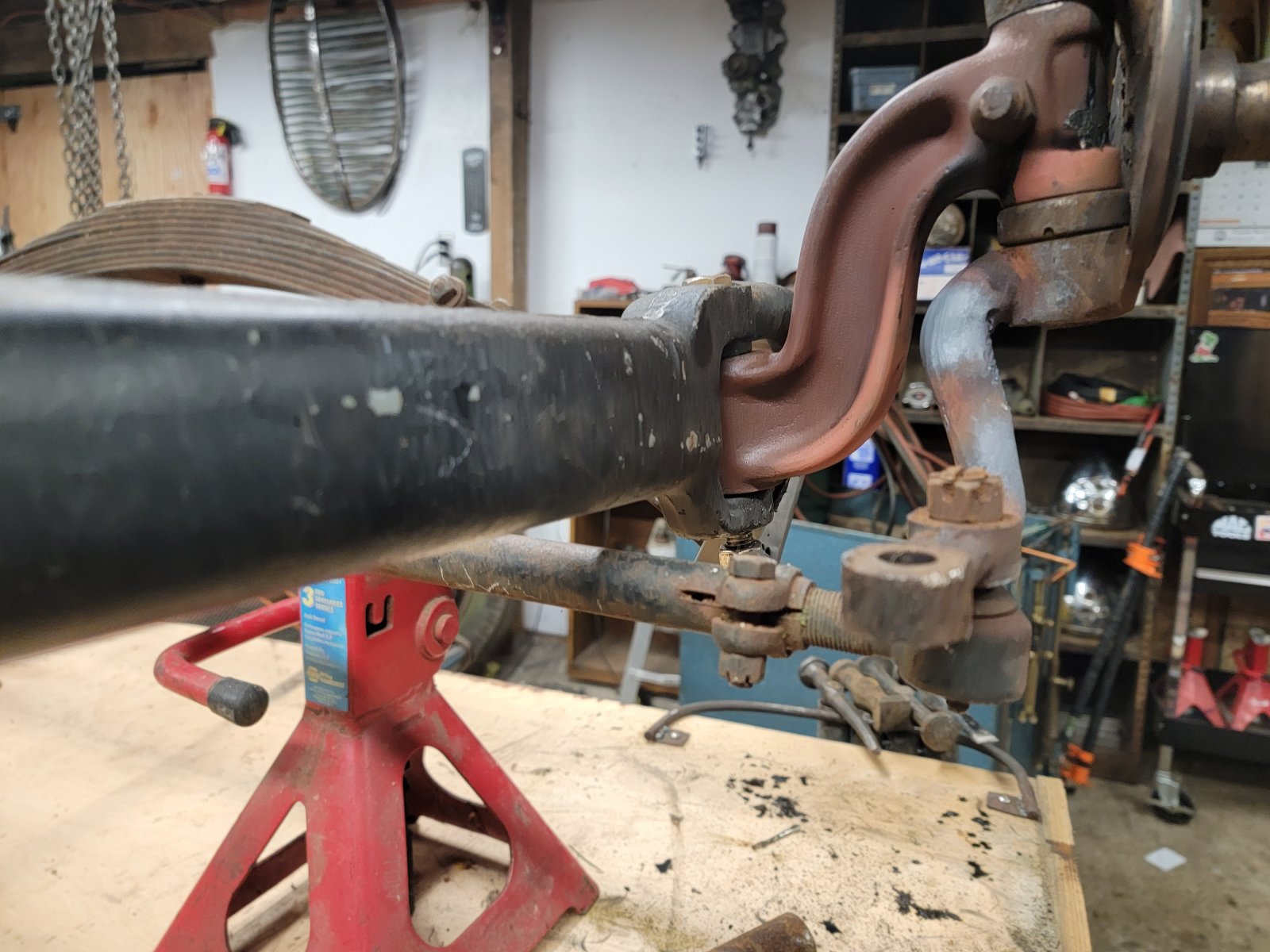

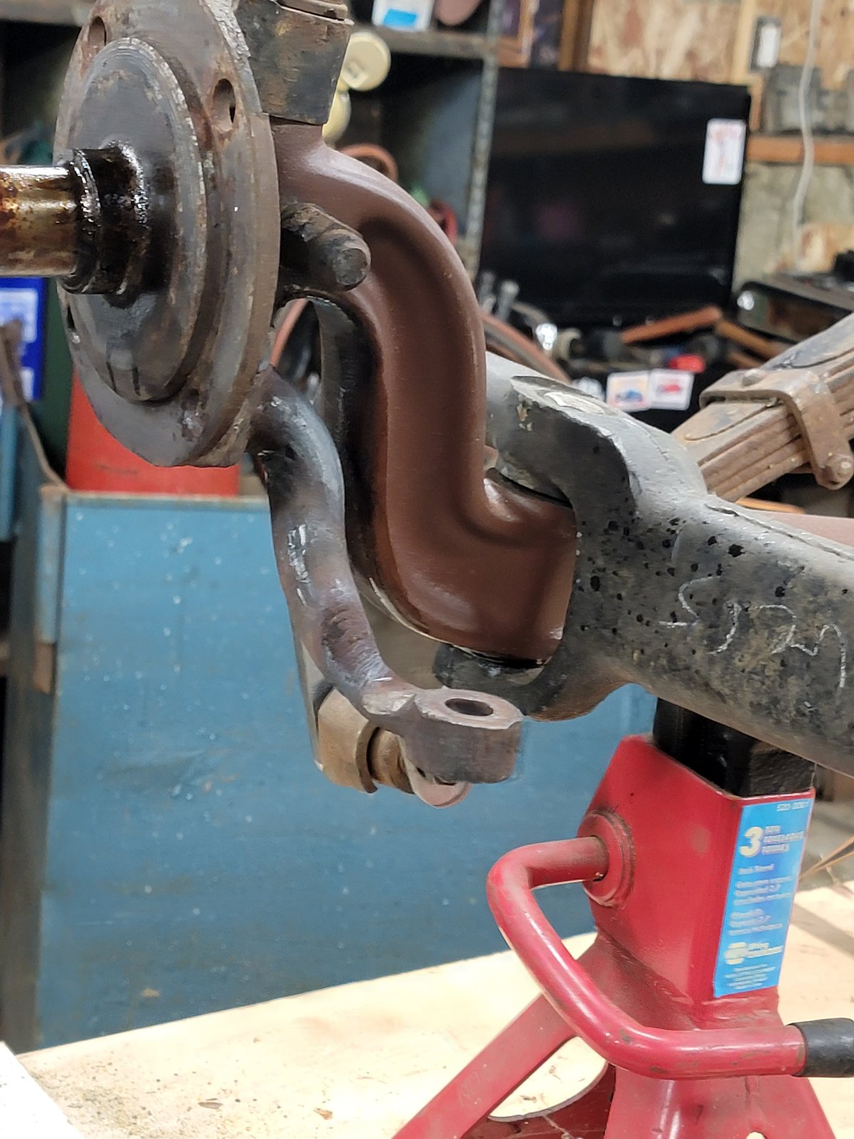

    oliver westlund

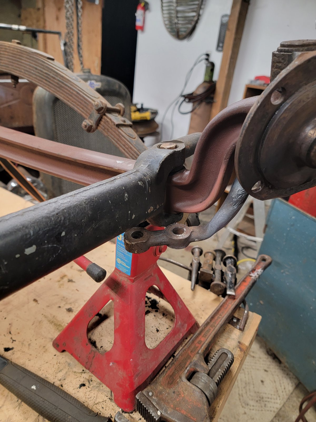

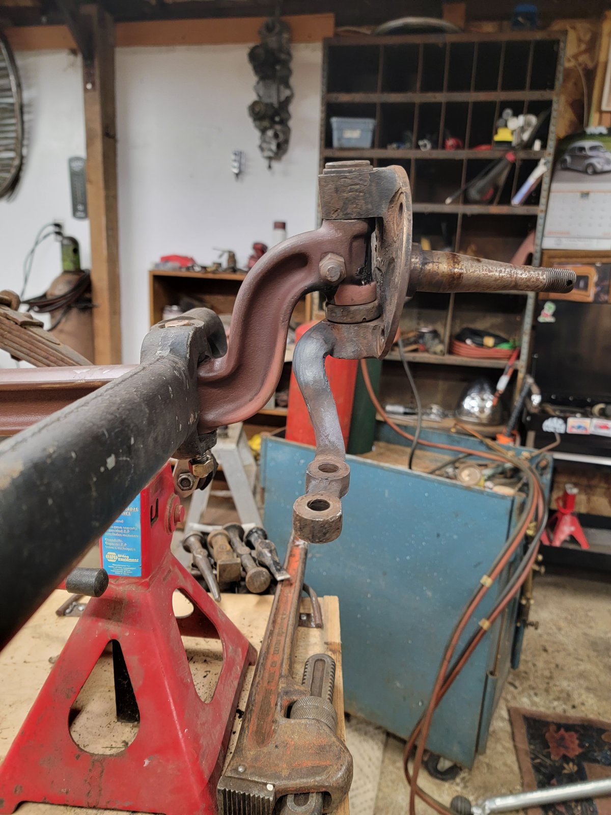

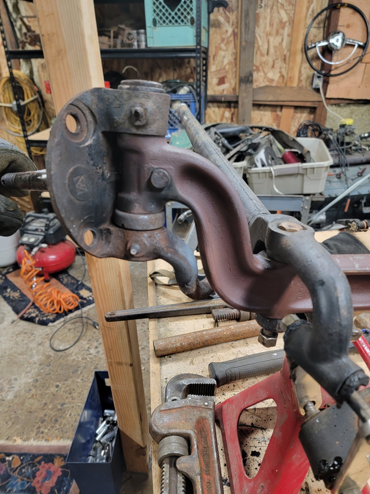

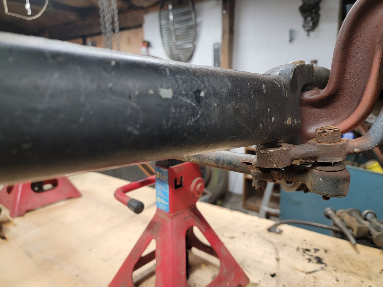

    This ought to do it...will mount tie rod from the bottom 20230106_163606.jpg that sure is an upper body work out! Wish i had a second set of hands! 20230106_170107.jpg first I twisted. 20230106_170848.jpg then I bent down and rotated the eyes back upright. 20230106_170853.jpg that left me with lock to lock rotation and plenty of clearance from what I can see 20230106_170912.jpg
    The tie rod nut MAY make contact just before full lock but thats a pretty extreme turn. I doubt I will see major issues here 20230106_170903.jpg

    oliver westlund

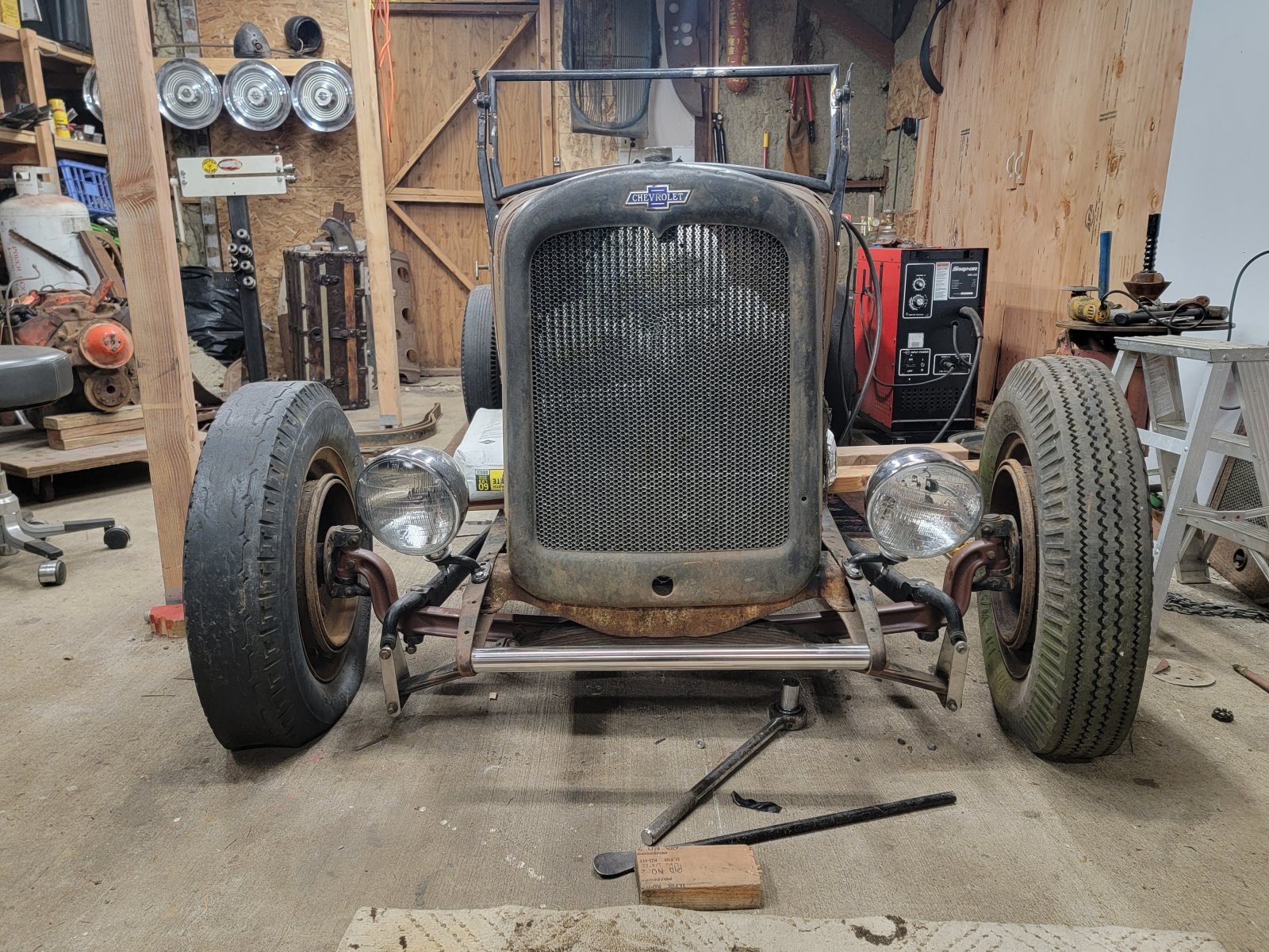

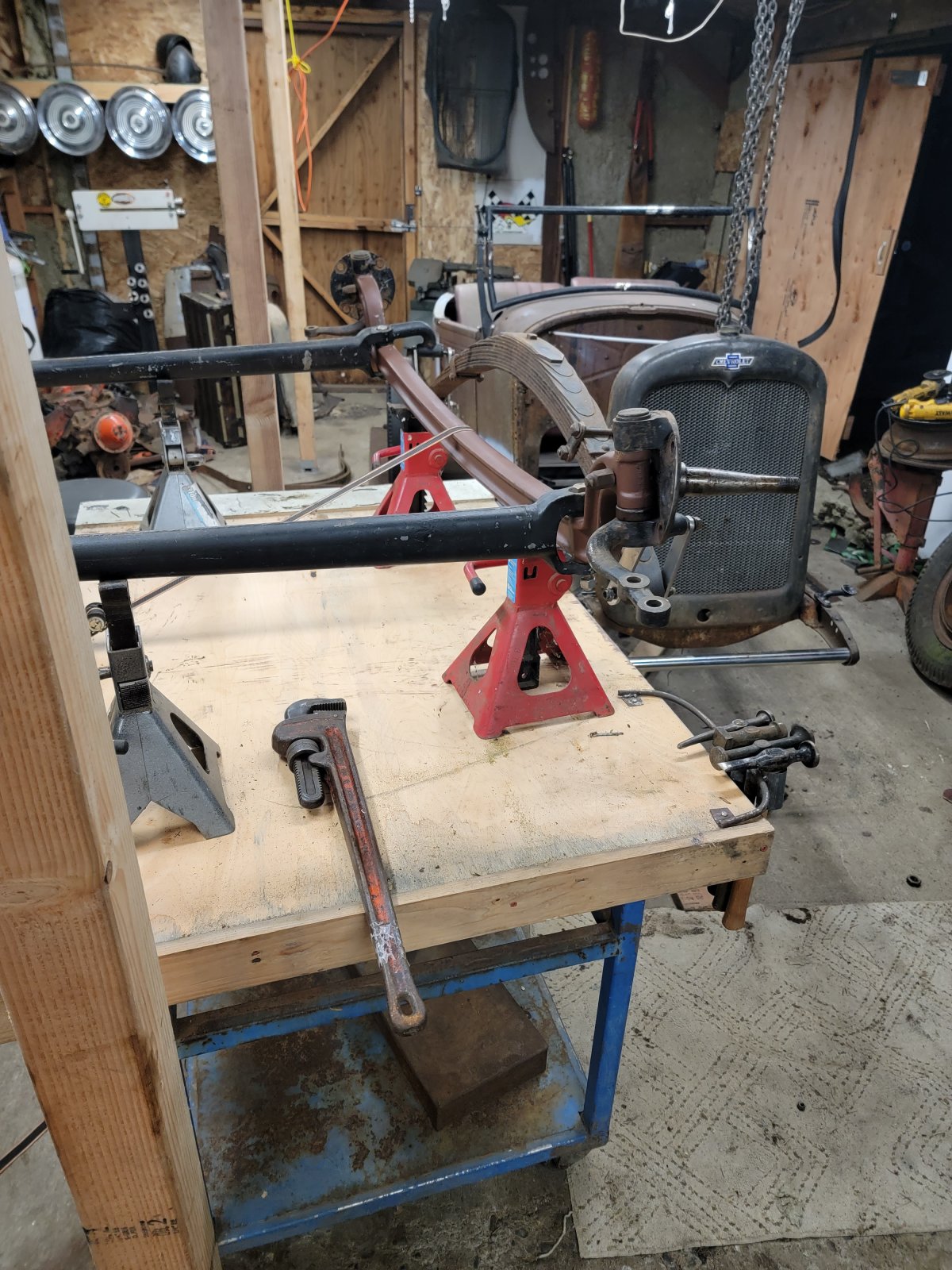

    I am sure the steering arm nut will hit but JUST before full lock....thats not a huge issue right? 20230106_175027.jpg
