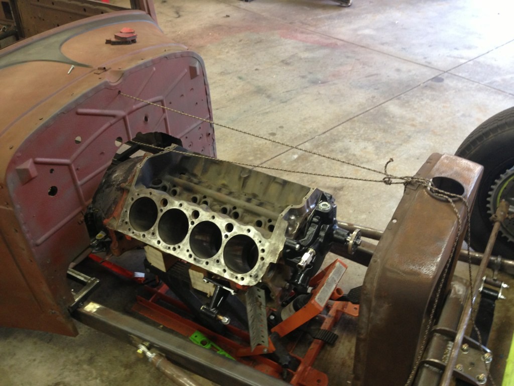

    Tore down the 350 yesterday so I could use the block for mock up, motor isn't bad, going to hone it, re ring it, put new rod and crank bearings in it, throw in a thumper cam and tappers, and rebuild the heads. ImageUploadedByH.A.M.B.1377448753.457043.jpg

    Getting motor mocked up, I used the speedway mounts but made the lower pieces, not done yet, want to add a little detail bling to the pieces.

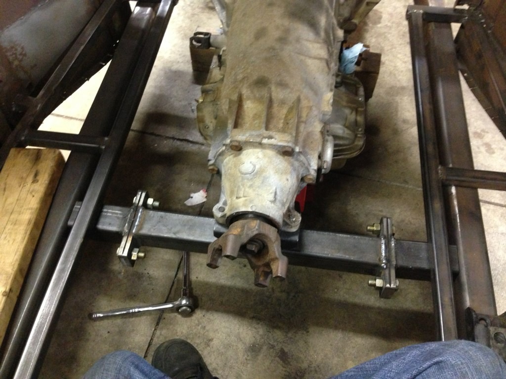

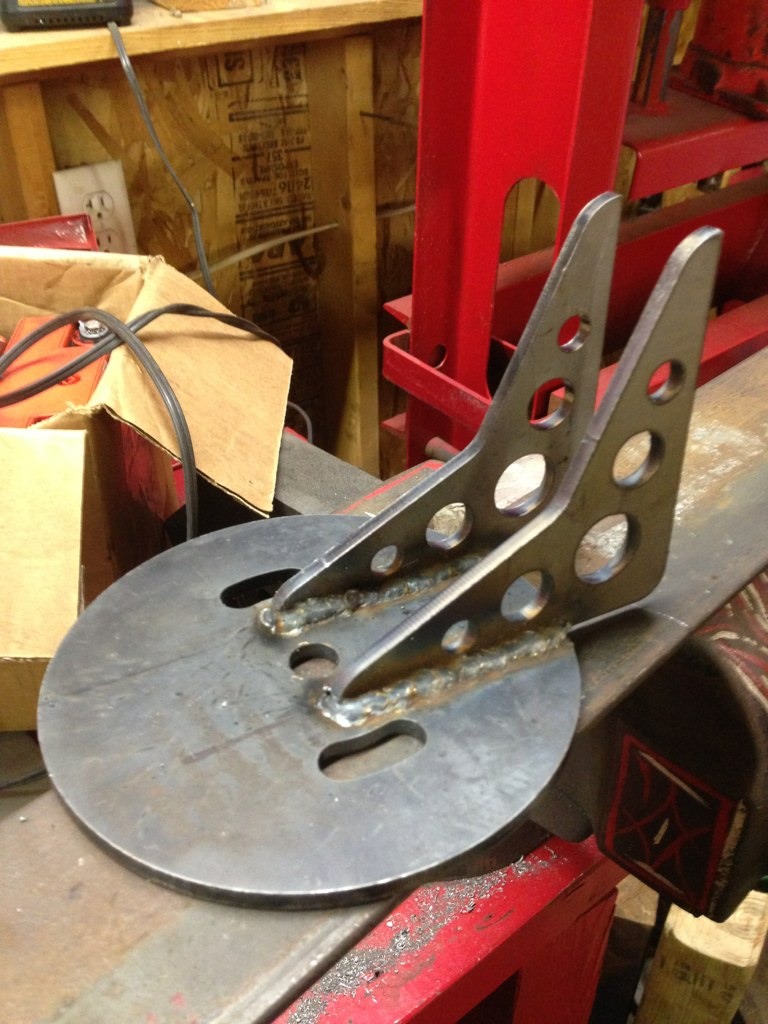

    Got some more work done, picked up a ford 9" for $90 :) and got my trans mount fabbed
    Cut out and drilling out the plates
    All welded up except to the frame. going to weld it to the frame tonight

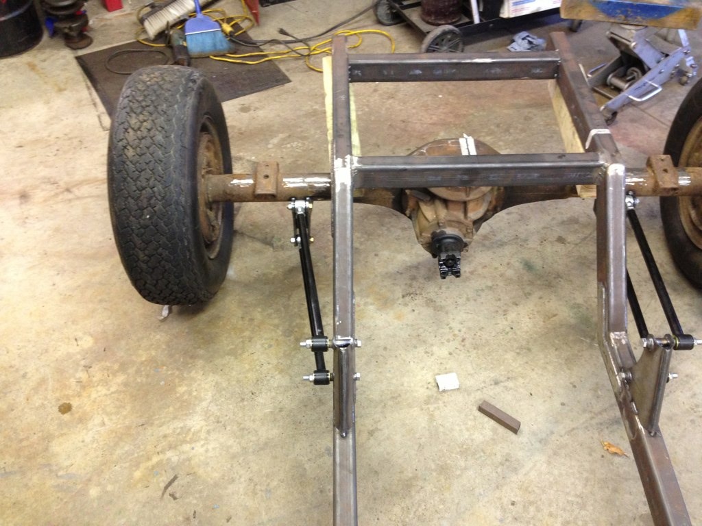

    Mounting the 4 link, had to redneck lift the body off lol
    I may have to modify the frame piece that sits right above it
    Body is back on, had to do some t******* to the front link mount but will be adding more metal after mock up is done

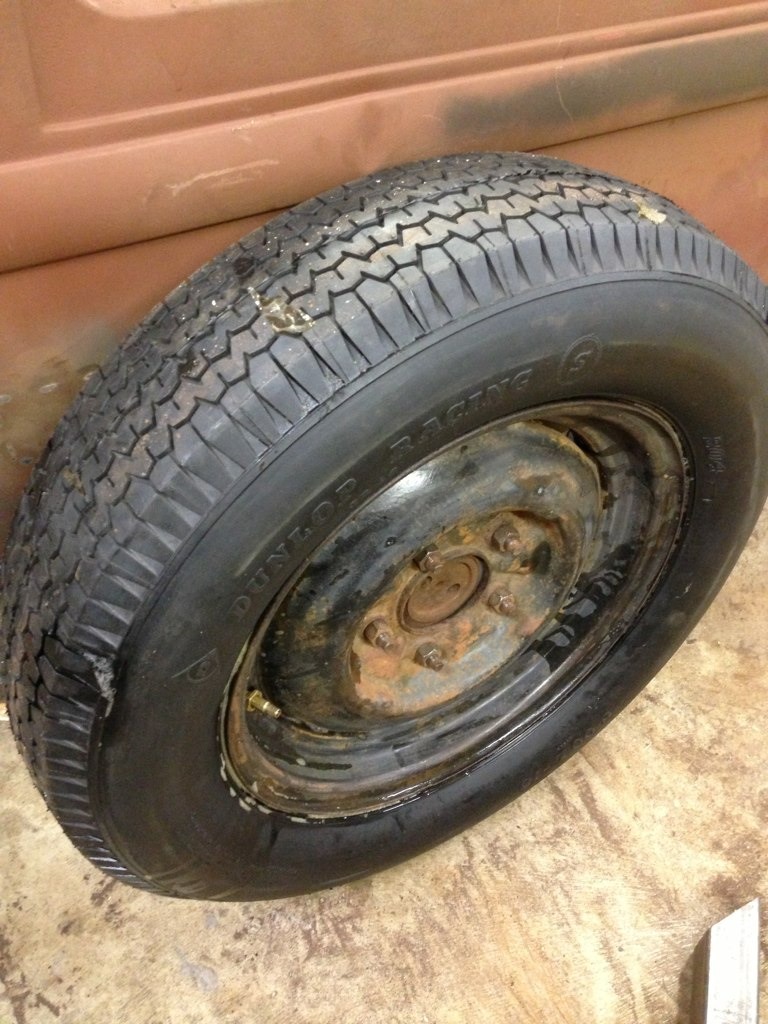

    Does your work happen to have anymore of those Dunlops?? Would love to find a pair for the back of my coupe..

    which tires are you referring to? the ones i have on the front are these: http://longstonetyres.co.uk/page/550x16-r5-dunlop-racing.html
    the ones that i have on right now are these michelin XWX: http://longstonetyres.co.uk/page/215-70vr15-michelin-xwx.html

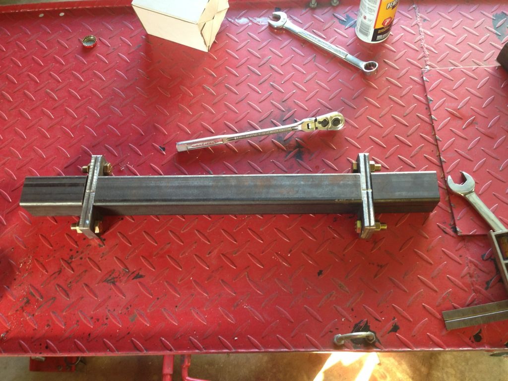

    Made my rear bag brackets, the gussets i used came from ballistic fab.

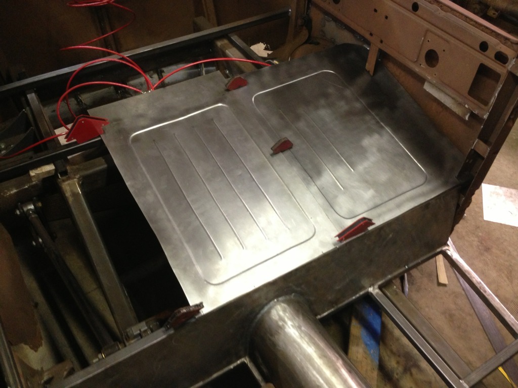

    from Wisconsin
    Scored a bead roller from a friends dad for cheap, after messing up a part of the floor pan I decided to do it in smaller sections and it turned out pretty nice I think ImageUploadedByH.A.M.B.1385498958.810256.jpg

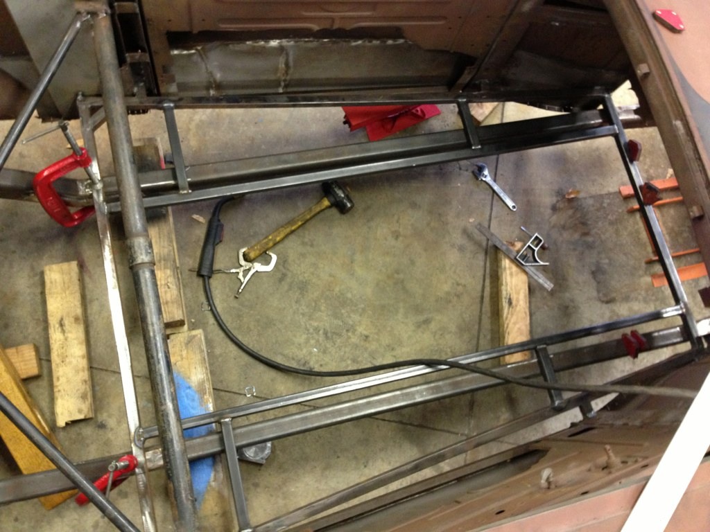

    Got some warm weather this weekend so I got some quality time spent in the garage! ImageUploadedByH.A.M.B.1385950398.622138.jpg
    Mocking up the lower half of transmission tunnel
    Tacked in place
    Got the step up floor finished
    Waiting on more parts and material for floors, brakes, And steering

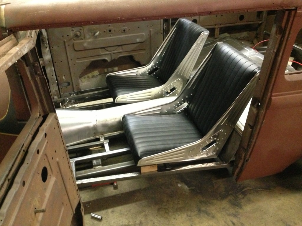

    Big thanks to Rotten Leonard's. The seats are great, delivery was fast, and price was unbeatable. I went with 16" wide seats which are 2" narrower than the standard seats he sells. Wishing it was spring so I could get out in the garage and continue working, looks like I will be collecting parts until I get the garage insulated

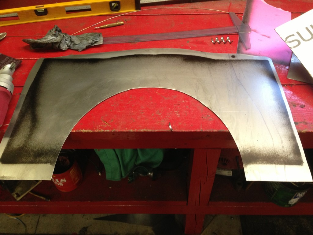

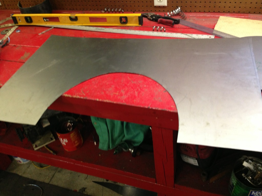

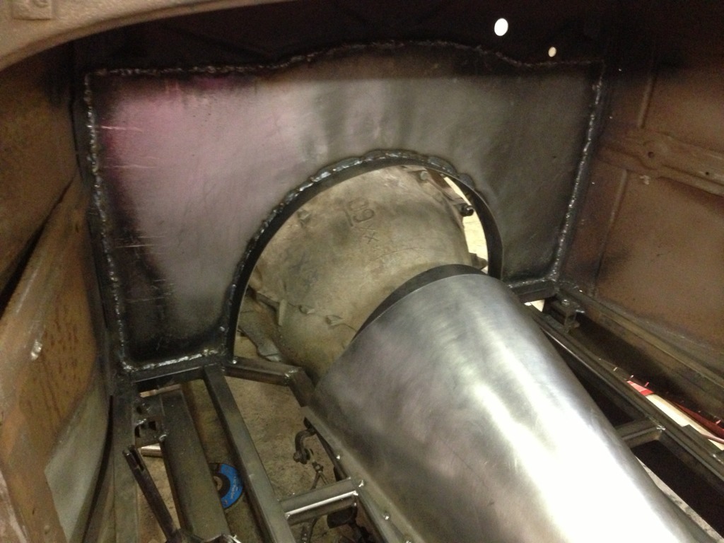

    Well I broke down and fired up the propane heater, couldn't stand sitting around in the house. Started on my firewall.
    I liked the top portion with the rolled designs so I decided to keep that portion and make only the bottom half and blend it together
    Old cut out
    Here is the top portion I will keep, as I said I like the design
    Cutting out the hump
    Marked it from the inside by misting primer to give me the cut line
    Started tacking it in going to hold off on welding it and blending it until I get the other portion of my trans tunnel done

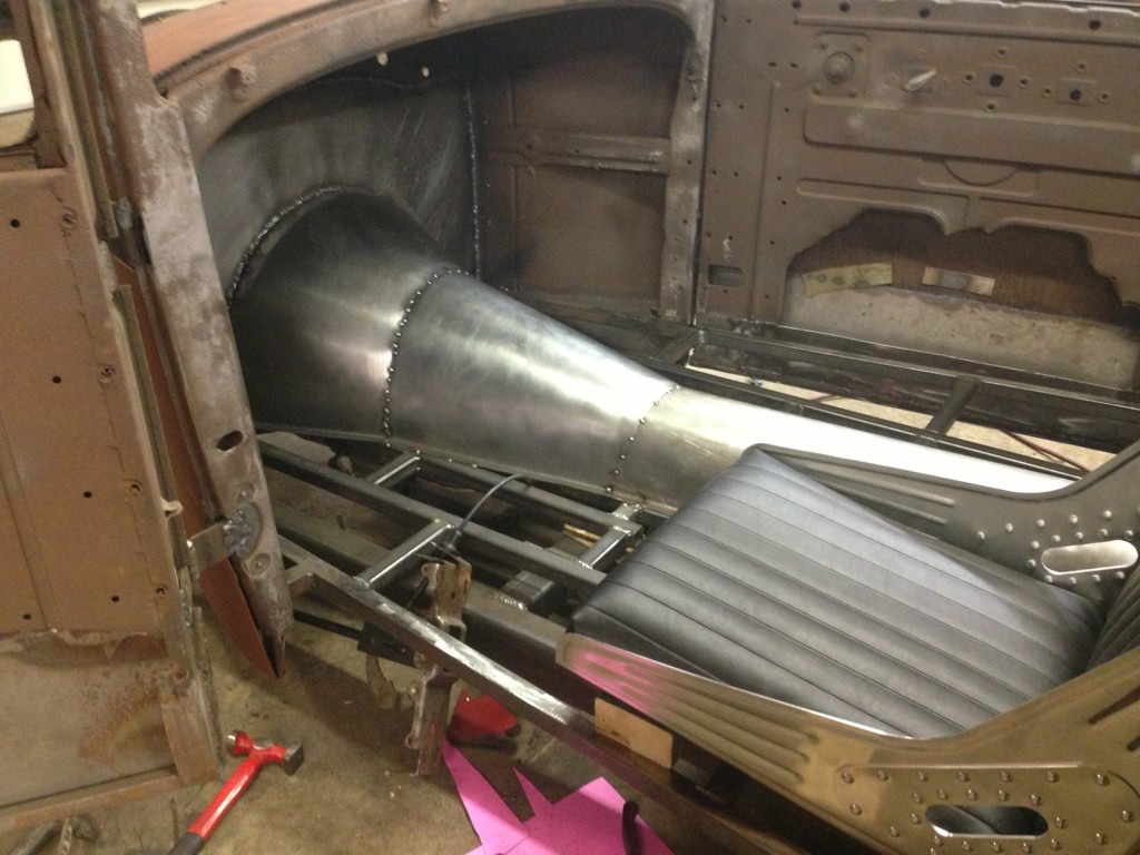

    Finished up the firewall and ****** tunnel
    My nice pink template!
    Used the brake to make the ends line up with the rest of the floor
    All tacked in

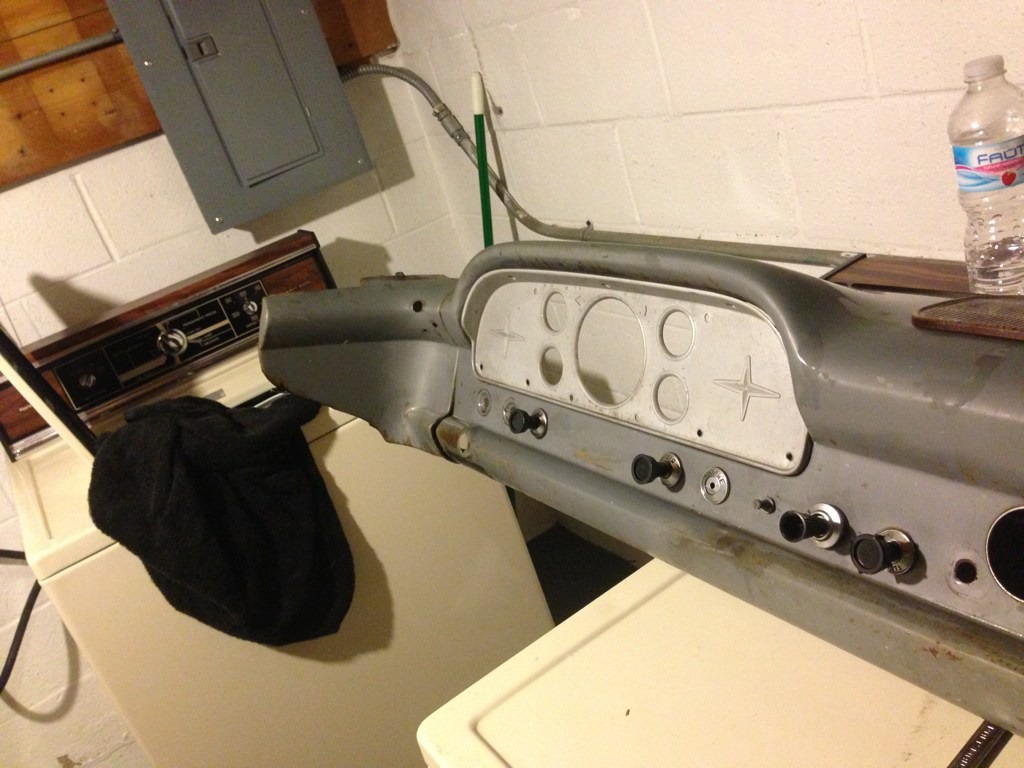

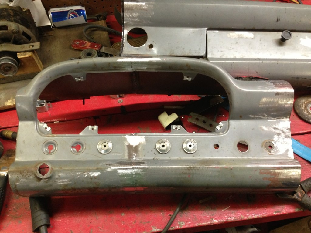

    Well I got the dash, hopefully going to get it mocked up and cut to fit this weekend. 1958 ford truck dash
  27. charlesincharge09
    Joined: Nov 1, 2012
    Posts: 280
    charlesincharge09
    from Wisconsin

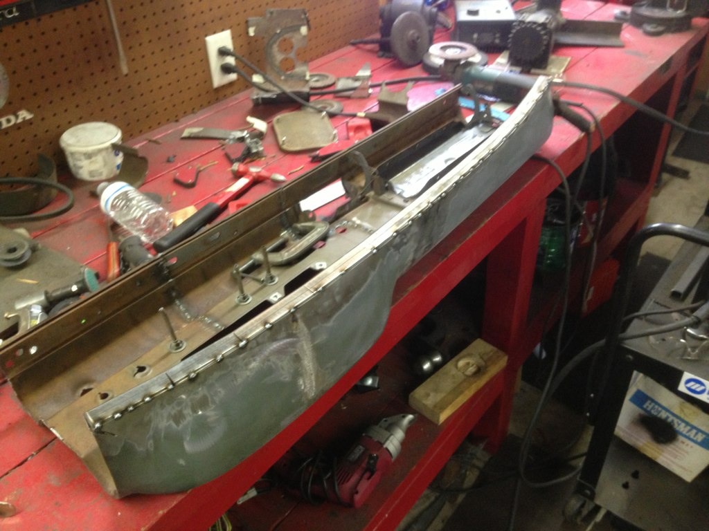

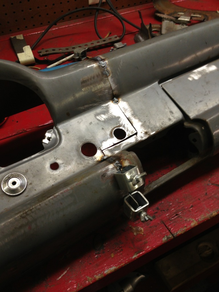

    Started by section inch out the middle gauges and shortening it
    I wanted to keep the ashtray and the globe box so I had to stager it when I sectioned it
    Took a piece of 1x1 and copied the lower part of the windshield area and then shrunk the dash down more and tacked it together. ImageUploadedByH.A.M.B.1389560448.633223.jpg
    Here it is clamped in place

    Made up some deer brackets to match my seats
    Even with the slope back It still will be tight
