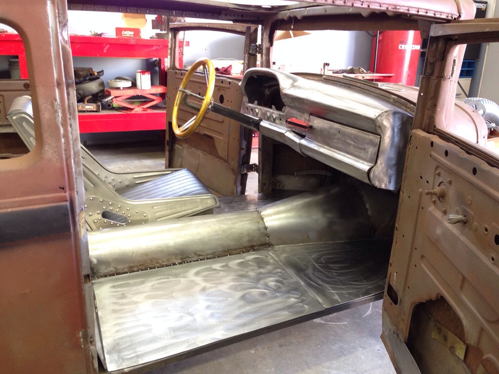

    Mounted my steering box,
    made my column (still need to mount dash and figure out a clamp setup for the top of the column. Got some work done on the floor.
    Mounted the master cylinder, still need to tweak the arm depending on gas pedal. Got driver side bear claw latch ***embly done.

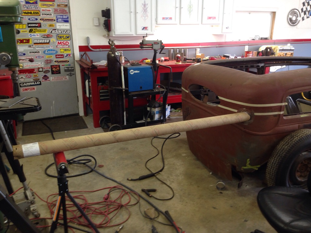

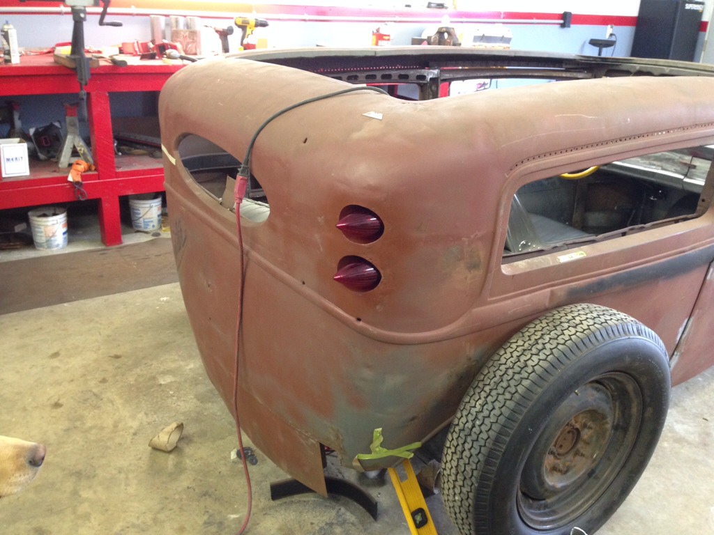

    Started my taillights
    Once I figured out how to cut the hole I used a cardboard tube to make them level ImageUploadedByH.A.M.B.1398643089.328828.jpg
    One down tone to go
  5. charlesincharge09
    Joined: Nov 1, 2012
    Posts: 280
    charlesincharge09
    from Wisconsin
    All done
    Used clear plastic to make a template to transfer to the other side
