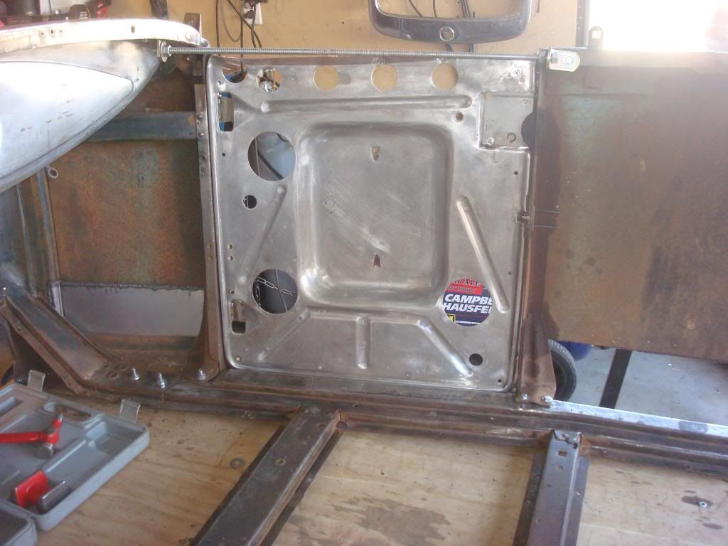

    Finished getting the inner door weded up, put it on the car just to make sure it all fit. I coated it with por15 and will skin it later this week.

    I finished the POR15 party and managed to paint the subrails and most of the inner panels that will never see paint. With that done I was able to get the door back together. Its still needs adjusting but I am happy with the result. I am confident I can get all the beads to match up, its just gonna take some beating.
    So I have to use a piece of threaded rod to spread the cowl from the rear quarter to get the door to close. I am sure the subrails have a bow in them. If you look at the pictures of it sitting in the barn, without doors you can see how this could have happened. But the rails seem to sit flat on the table? I think they may be bent right where the cowl and door meet. Anyone got an idea of how I could check this?

    Once you fit the body to the frame with the wooden body mount blocks it will be solid and you can adjust the gaps that way. My roadster body was like a wet noodle until it was mounted
