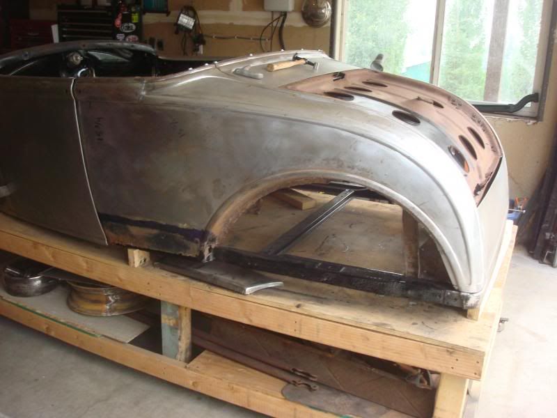

    So everyone who as said these are a PITA...is correct.
    I happy to have them in, I will beat them into shape later.
    I also cut out the wheel wells to gain access. There were muliple layers of patches in there. Its going to take some work to get these right but, I am not going to worry about that until the 32 frame I am ordering is ready.

  10. Cool project! Looks to have the "A" typical rust!
    Great idea using threaded rod to hold the door opening!
    Subscribed for sure!

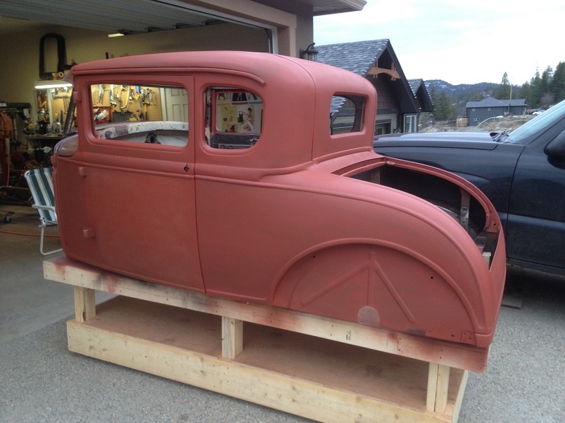

    FYI
    One of the weakest points on a Model A roadster body is the area behind the door where it bends around to the back. After years of slamming the doors and pulling them open this area becomes work hardened and starts to crack. I took 1 1/2 angle iron and pie cut it, about 100 small slits, and formed it to the body under the lip that goes from the door to the rear deck. Once this was all shaped correctly I welded it all up and bolted it to the lip. You can't move the panel for love nor money now

    Thanks Fuzzy. That is a great tip...and also explains the repair work in that area.

    Mine is cracked on both sides after welding up the old cracks. I like this idea with the angle iron.
