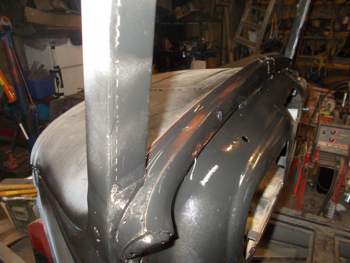

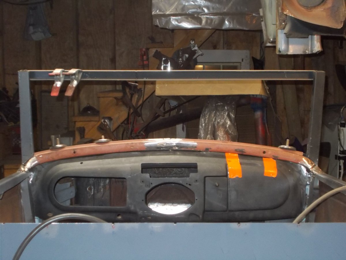

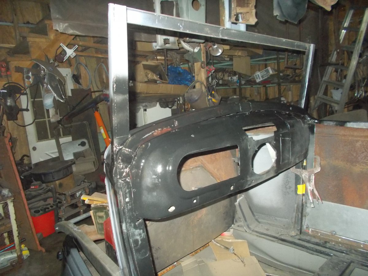

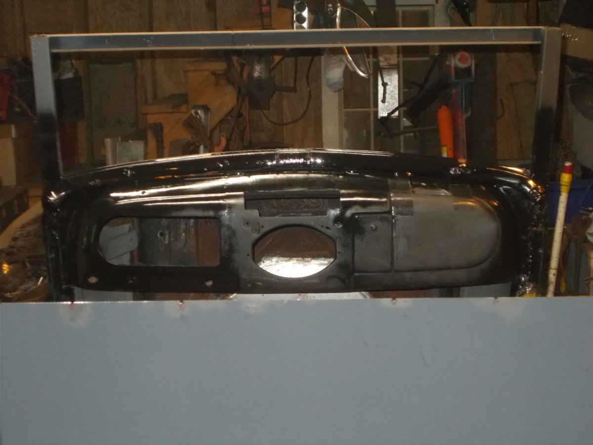

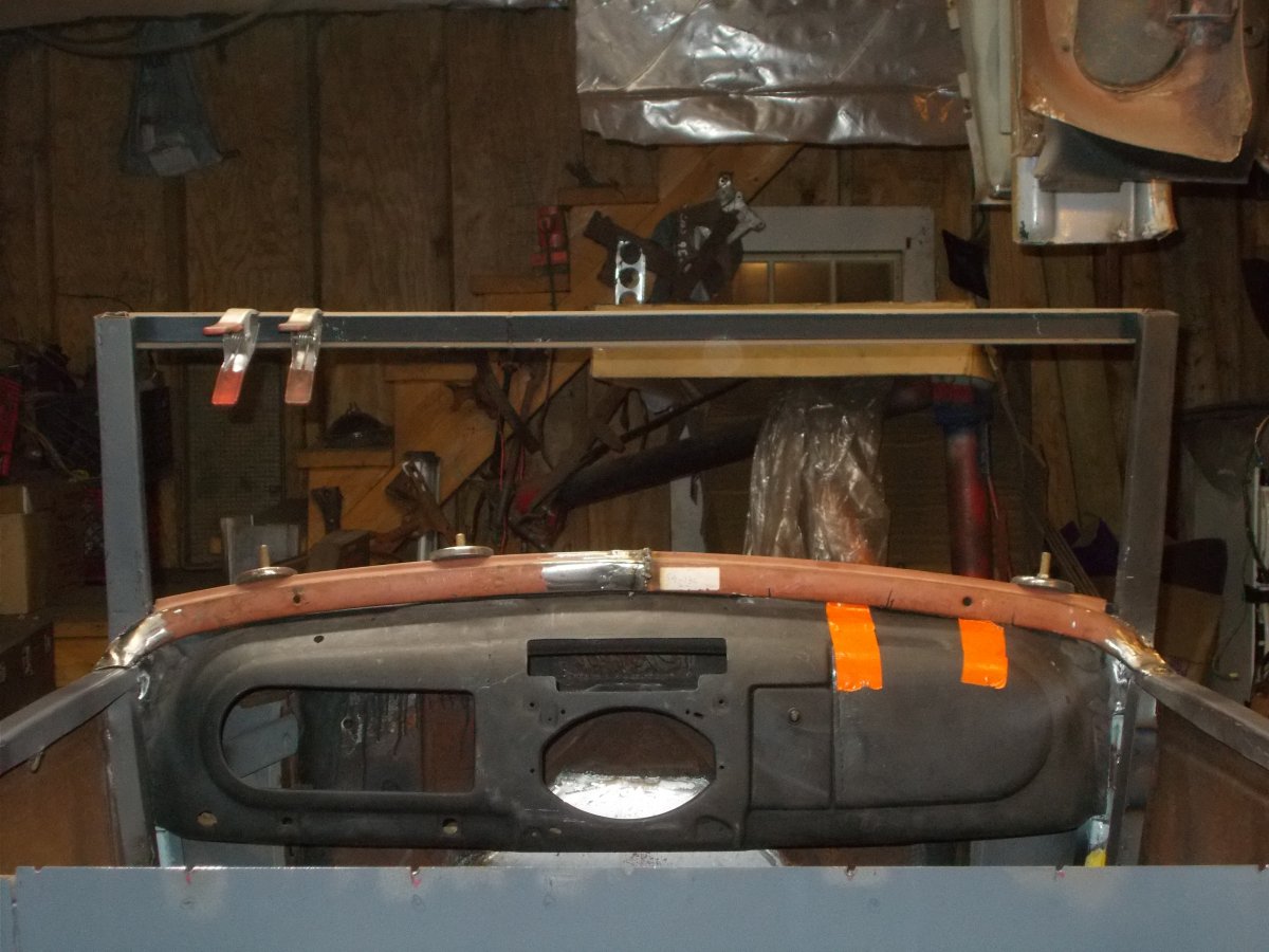

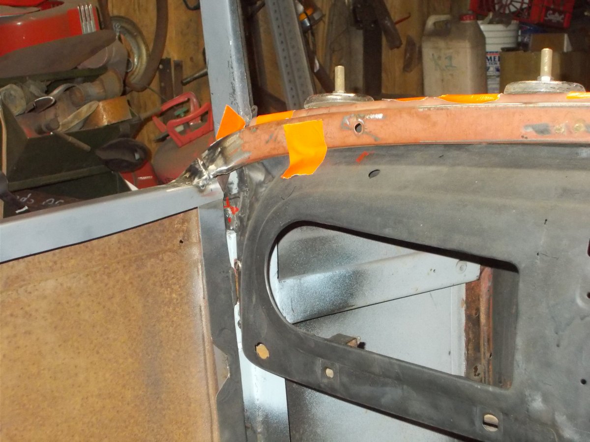

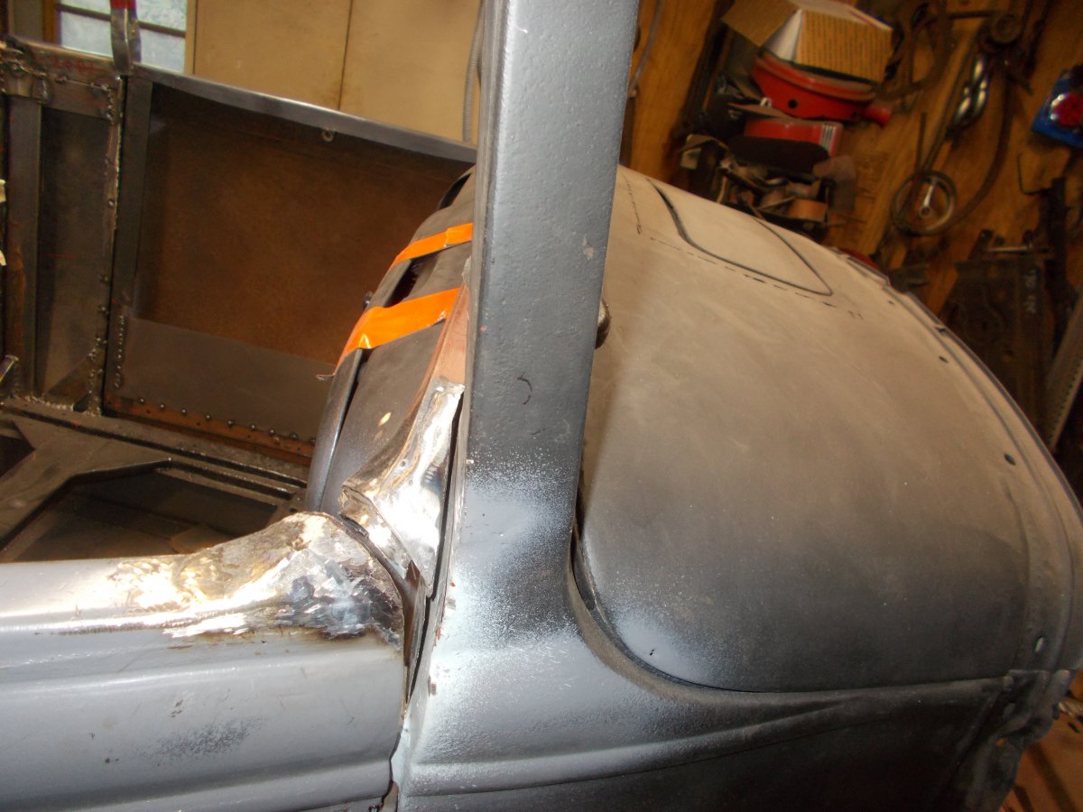

    trimmed the A pillars and added to the dash to let it fit flush with the A pillars... added extra to start and now the dash will get trimmed to hide behind the roadster dashrail... DSCN4768.JPG
  4. sloppy jalopies
    Joined: Jun 29, 2015
    Posts: 5,256
    sloppy jalopies

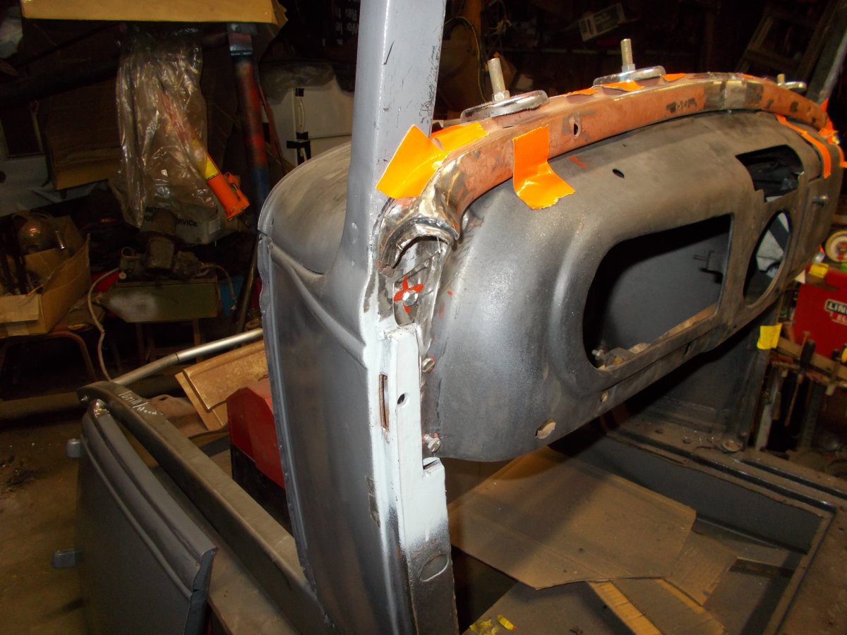

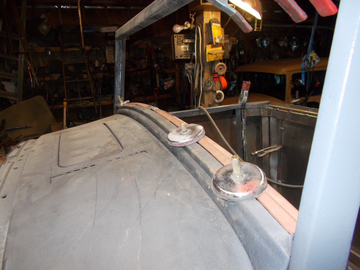

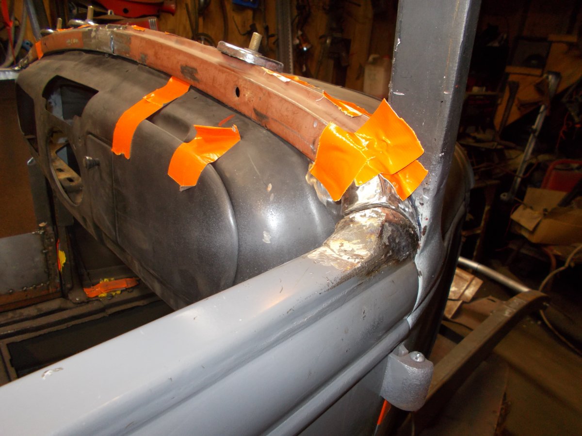

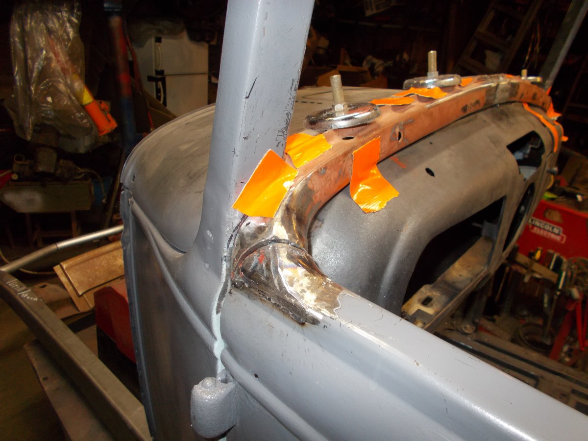

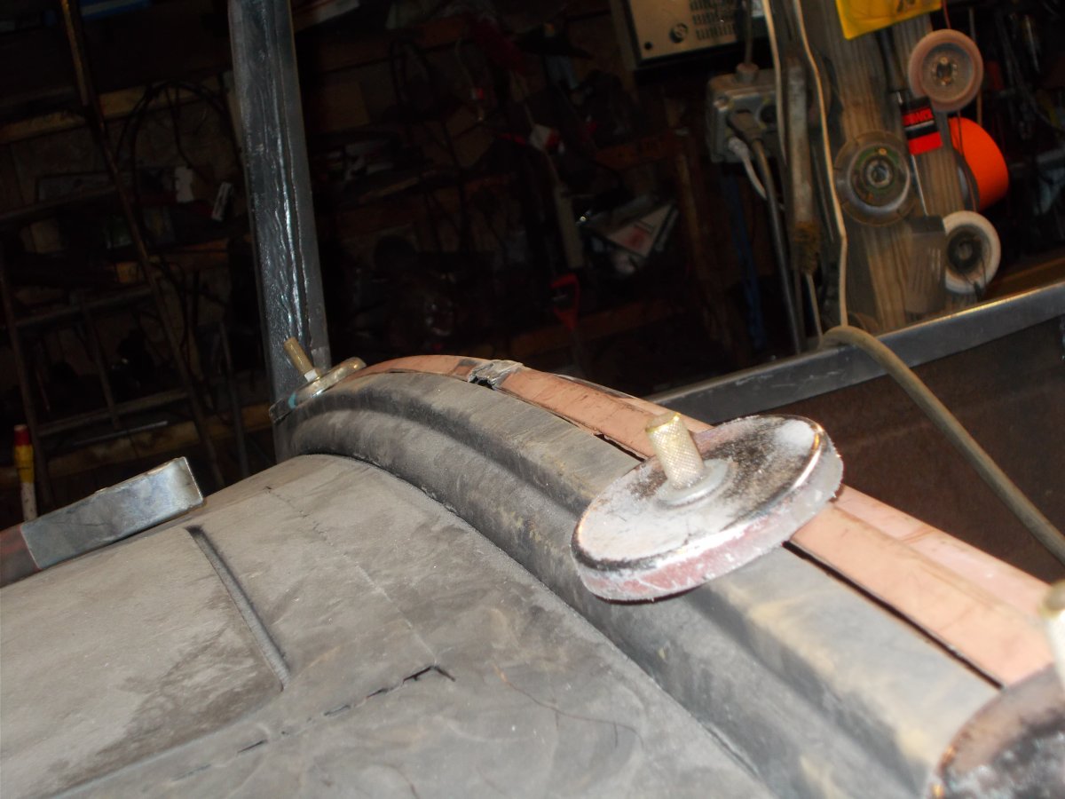

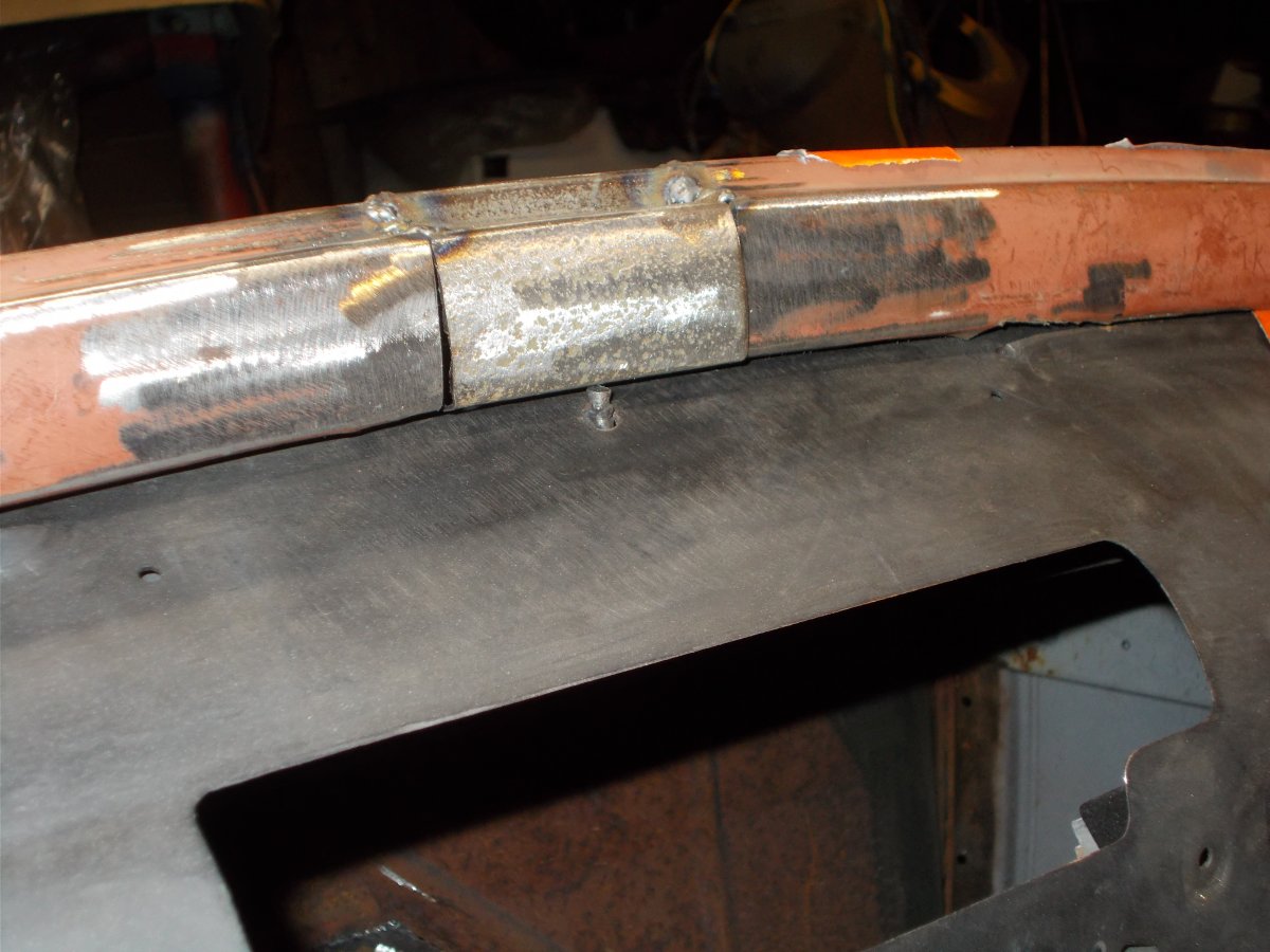

    Extended the dashrail 1.5" in the center, still needs grinding...
    added about 1.25" of curled end from another dashrail [thanks hamber] to each end of mine to let it curl down to the door top... DSCN4772.JPG
    cut curled and trimmed the panels to connect the dash to the door top...
    going to cut the door from the dash at a convex radius, the upper half will be part of the dashrail, lower half stays on the door...

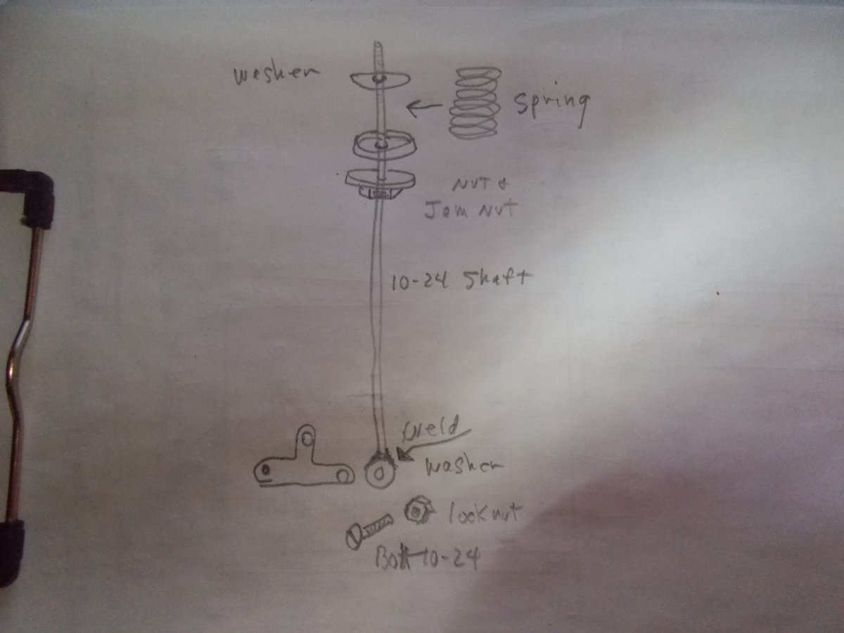

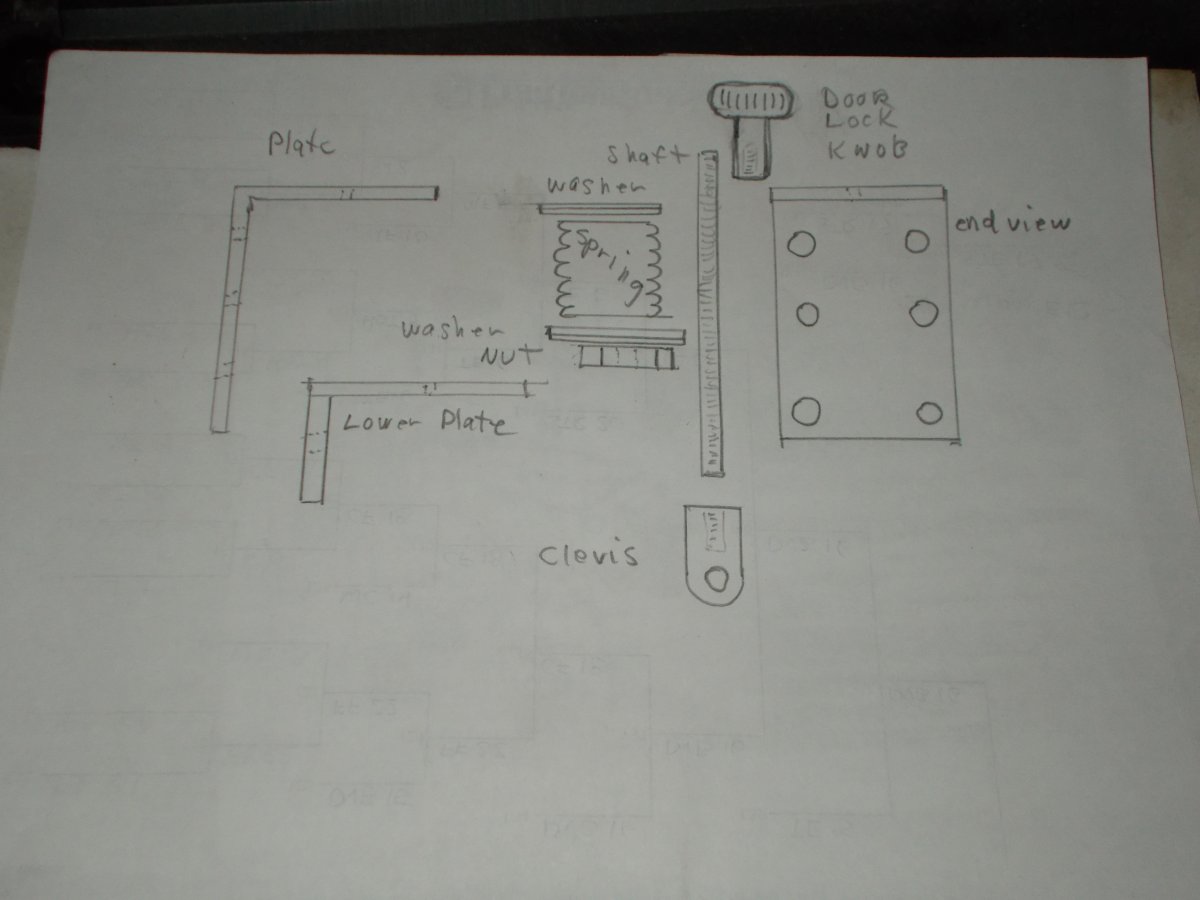

    Just bought a .75" dimpler…
    will run it through the door cap, where the stock side curtain anchor goes....
    a 3" long 10-32 shaft ...
    upholstery retainer washer" then a spring, another washer and finally a 10-32 lock nut...
    will screw a door lock knob onto the top of the shaft...
    a clevis screwed to the lower end of the shaft that will connect to the bear paw latch...
    what seems like unlocking the door will un-latch it...
    will be mounted about 2" from the B jam...
    pix when I build them...

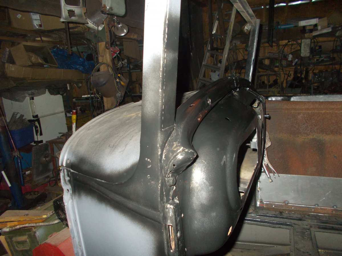

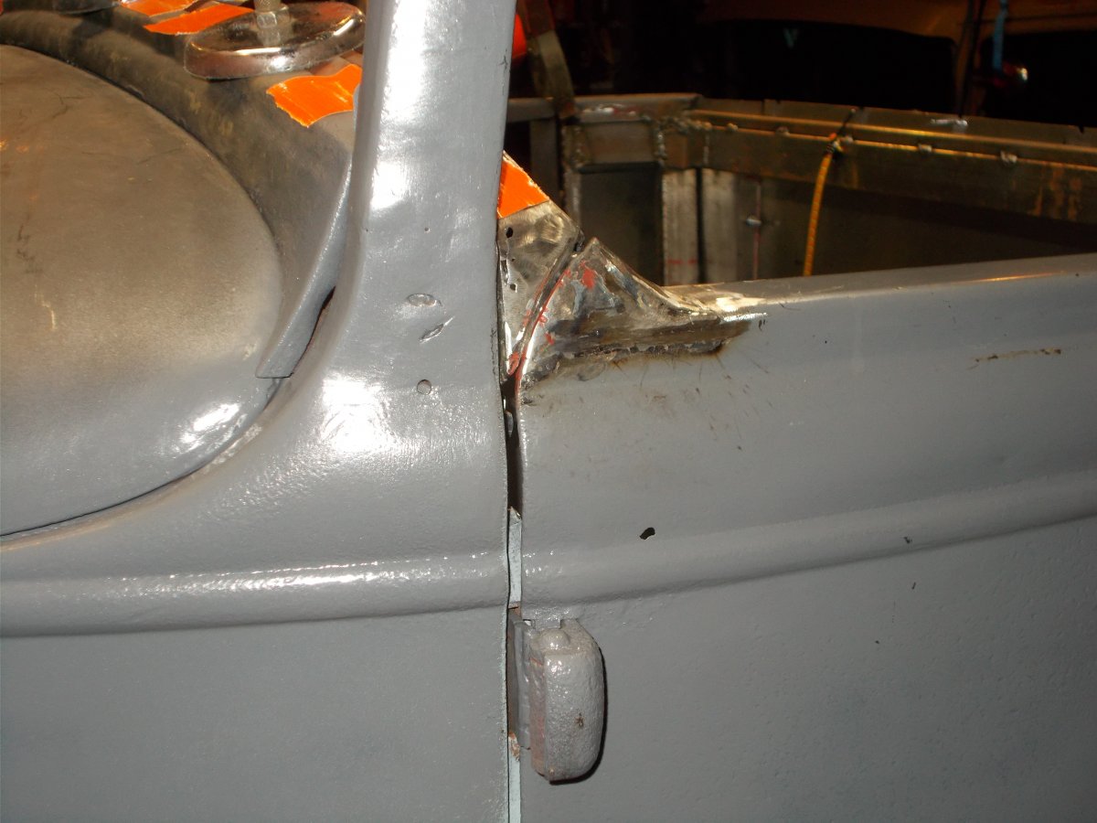

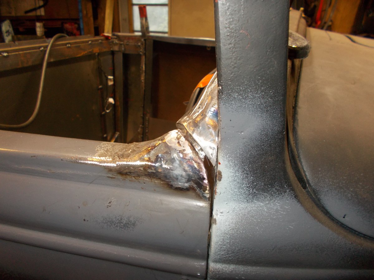

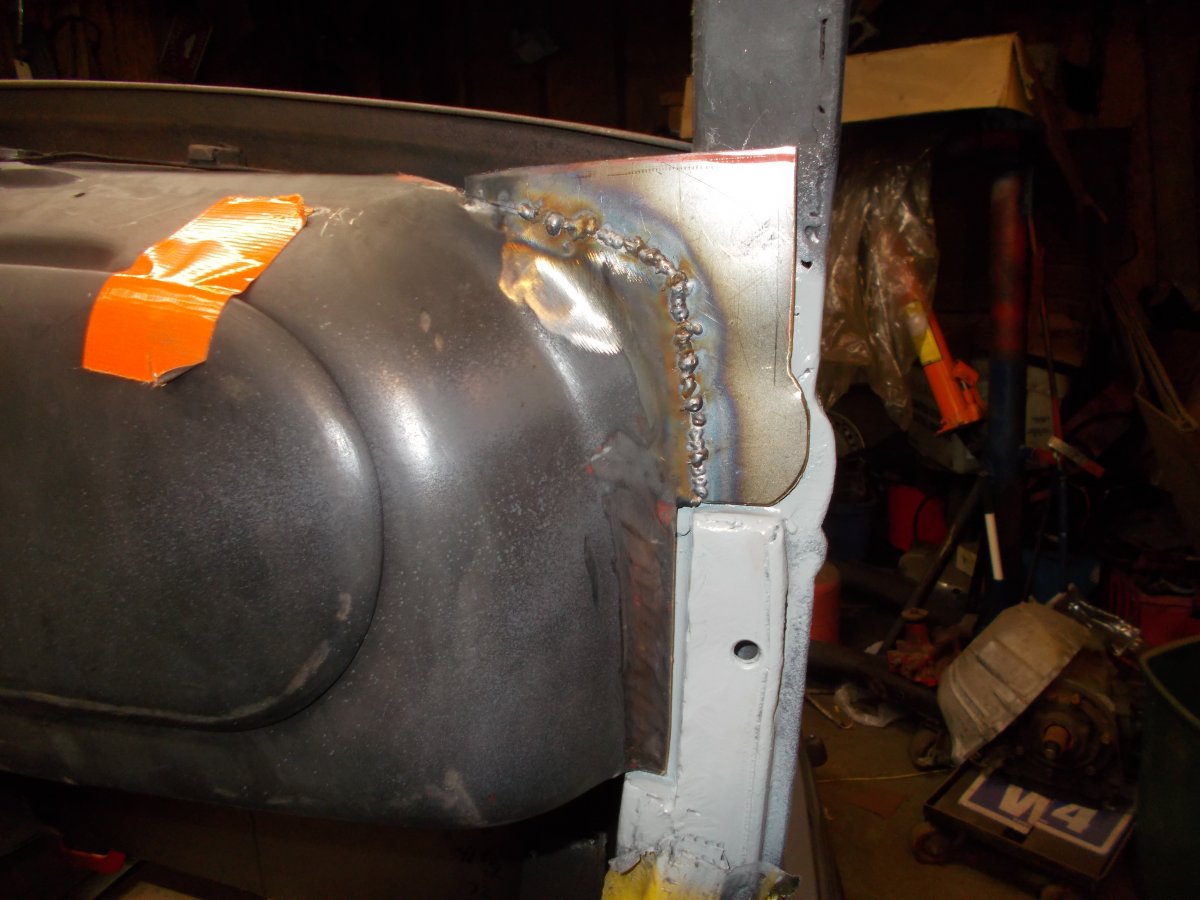

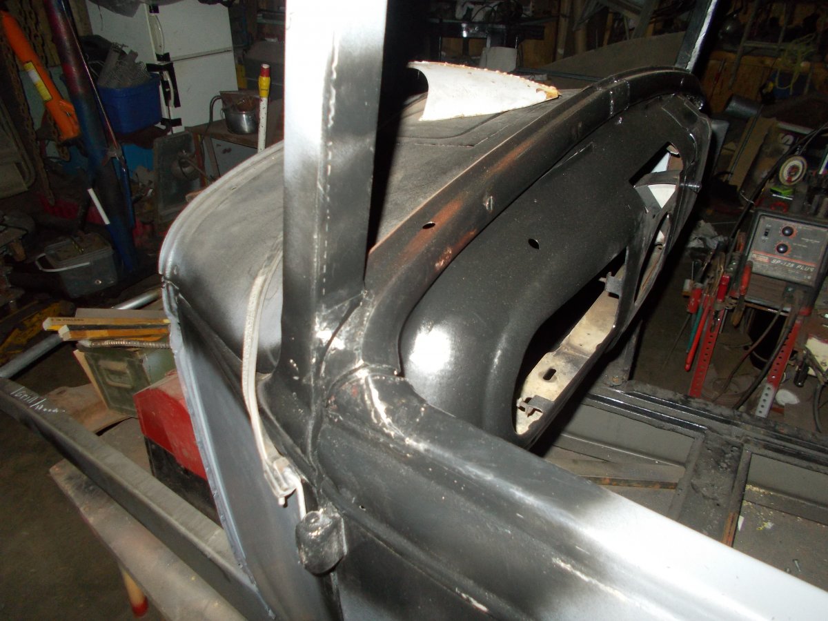

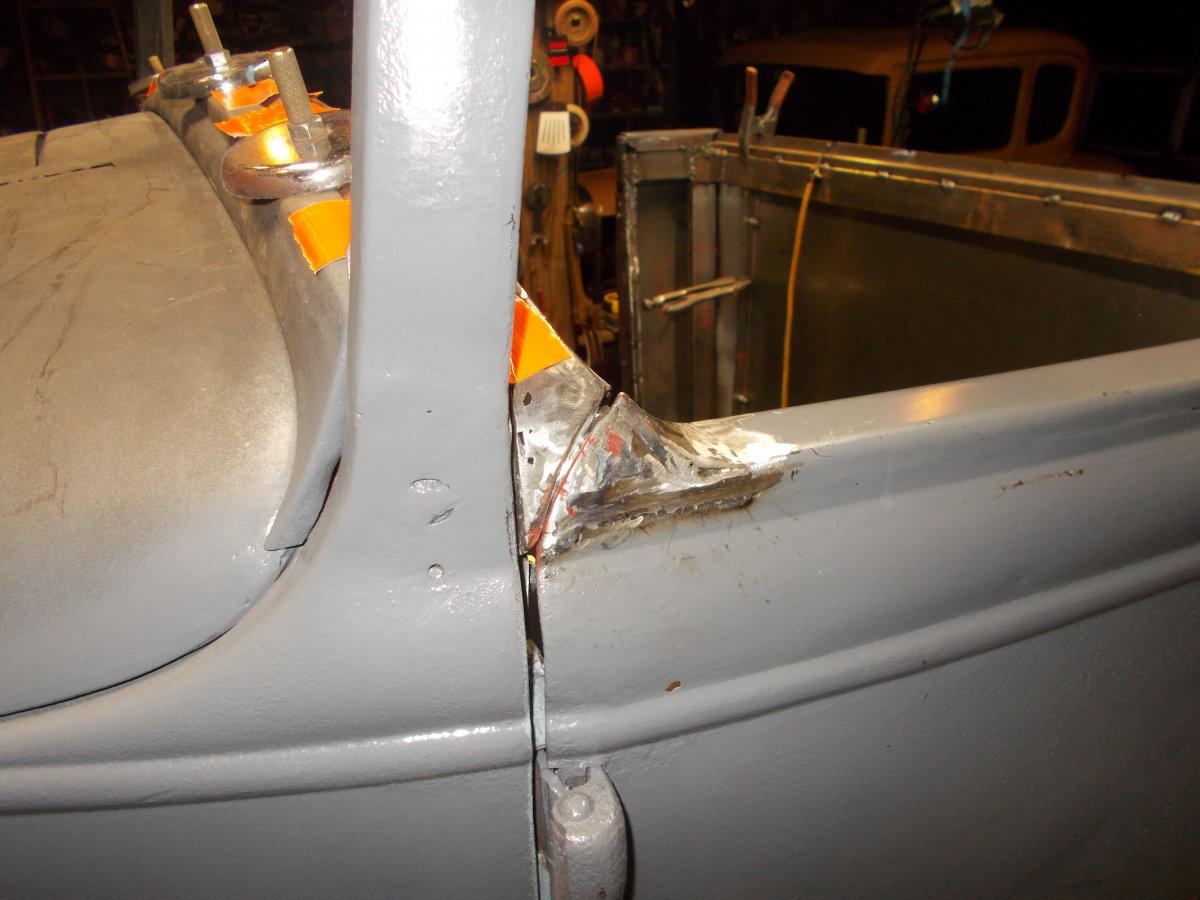

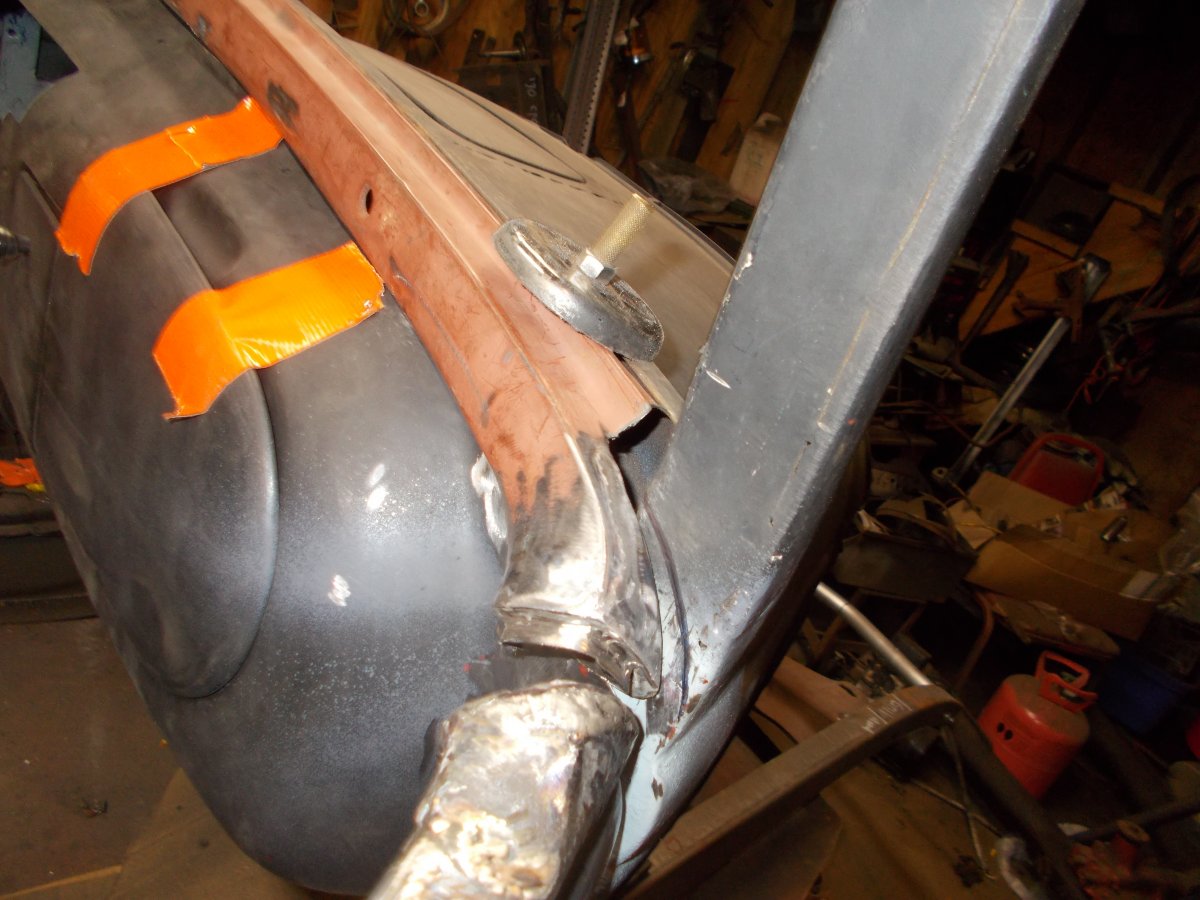

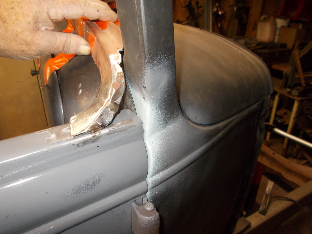

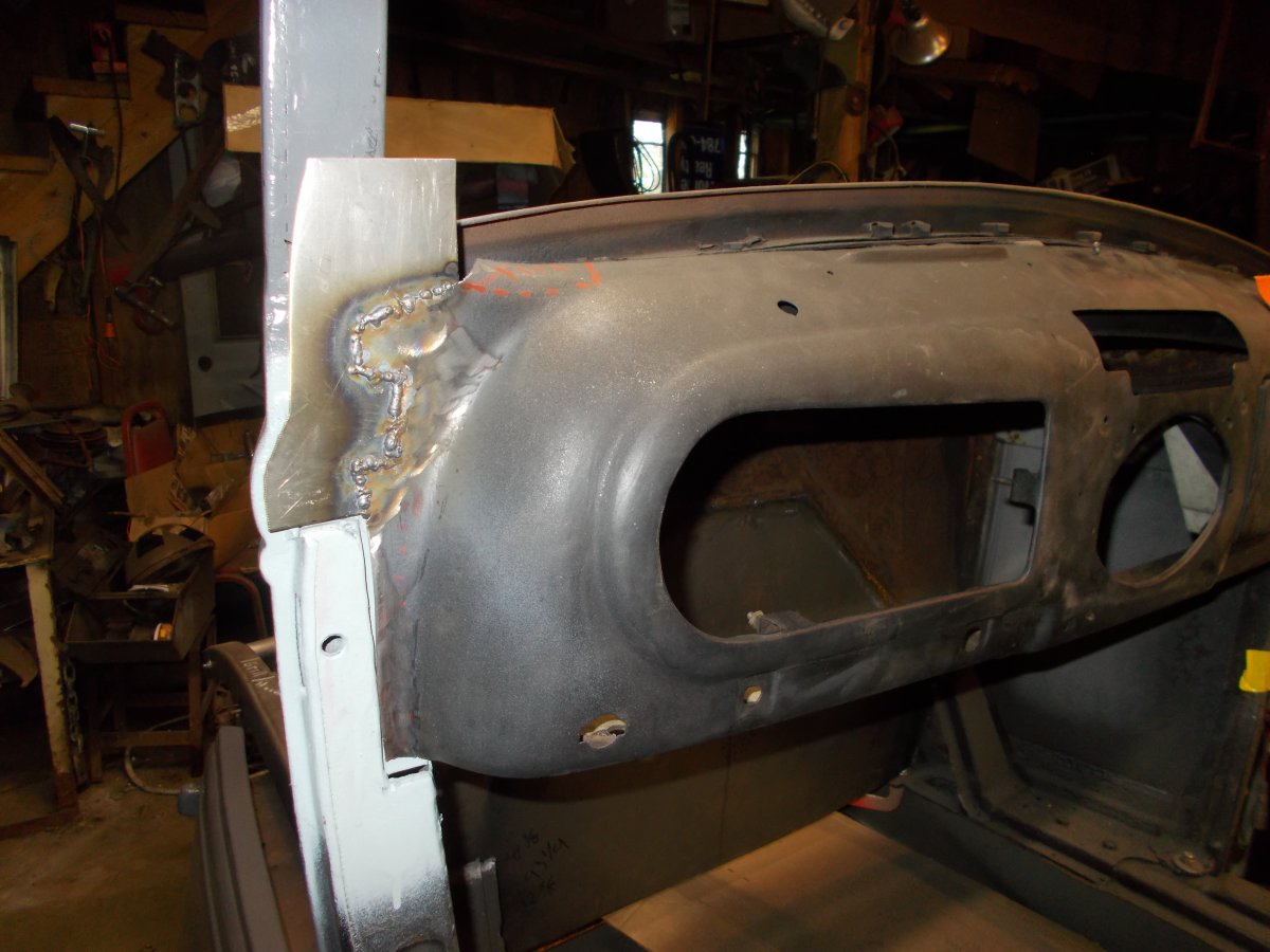

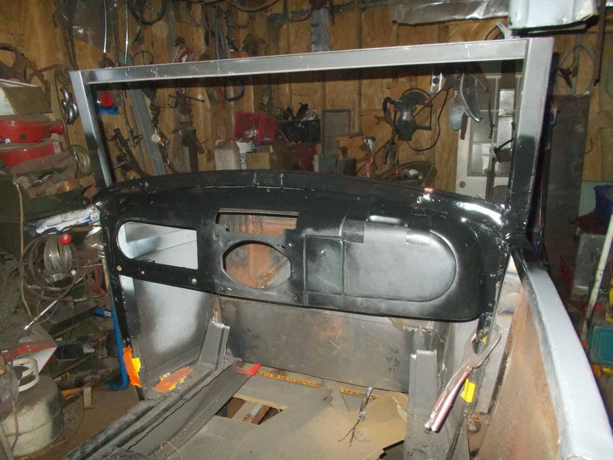

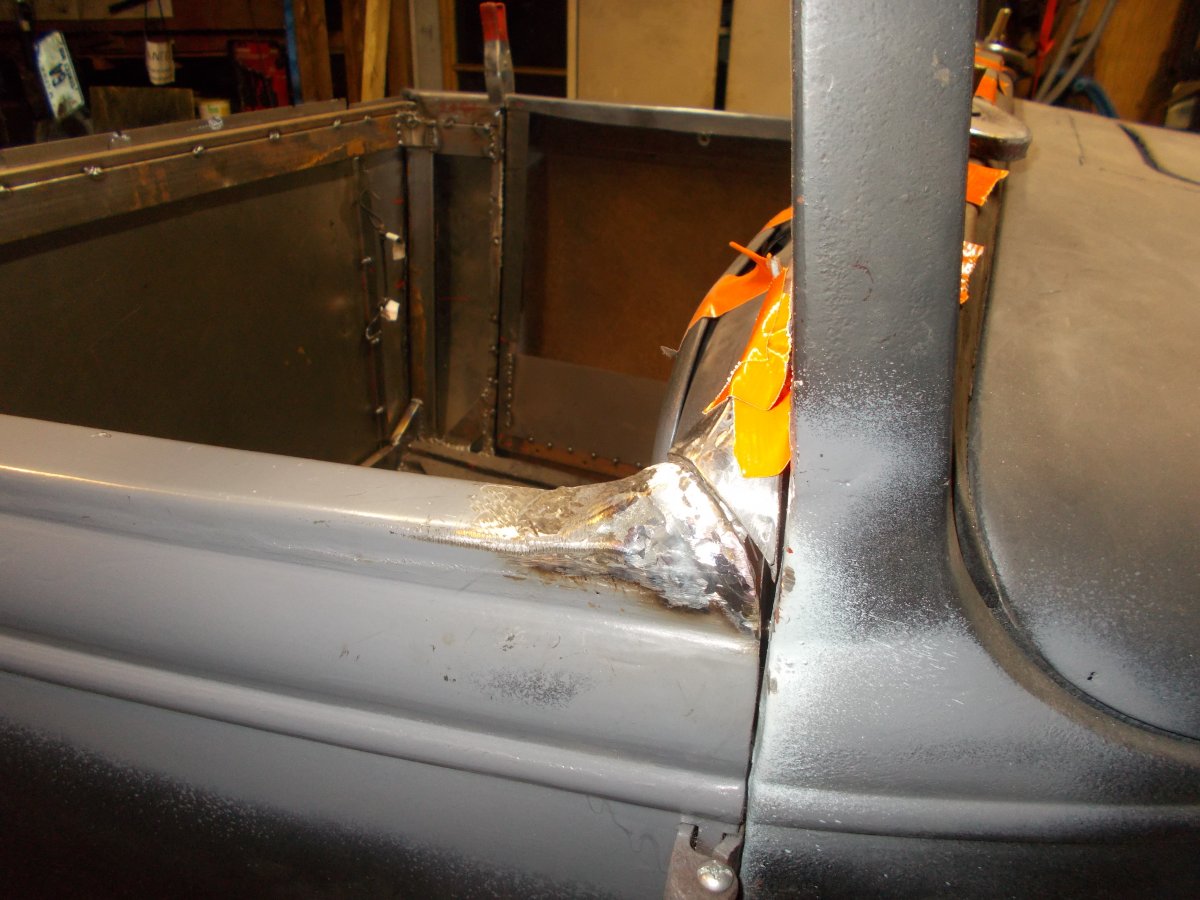

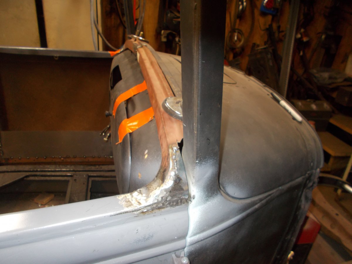

    I cut the gap on the right side, built a double layer of weld under the dashrail as a spacer, welded in a step, this gives clearance for the doubled up sheet metal door end to overlap it and still sit flush with the door cap... DSCN4796.JPG
    going to make a smooth strip to box in the step...
    ship luck but the Vicky panel between the w/s frame and the tank has the same radius as the dashrail...
    left side welded, will cut it, weld it, step it and box it tomorrow …

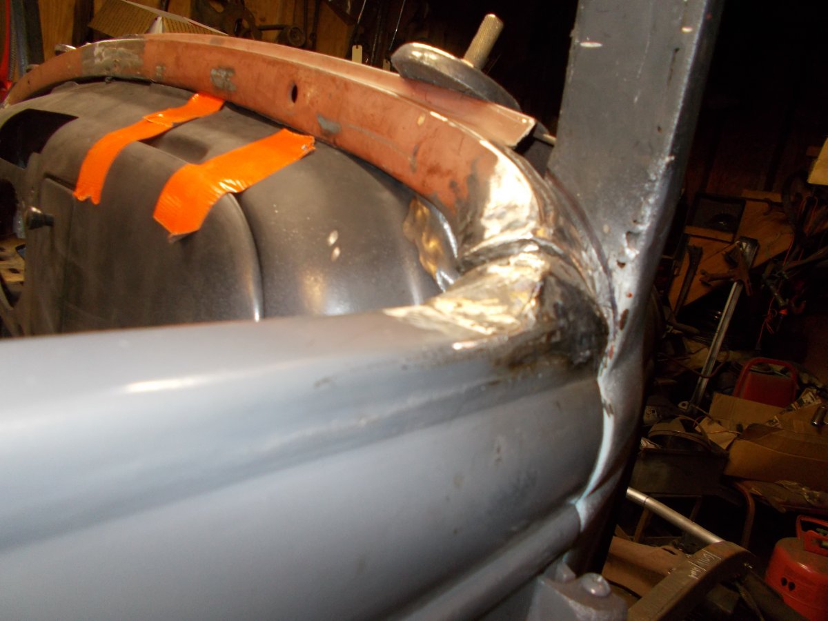

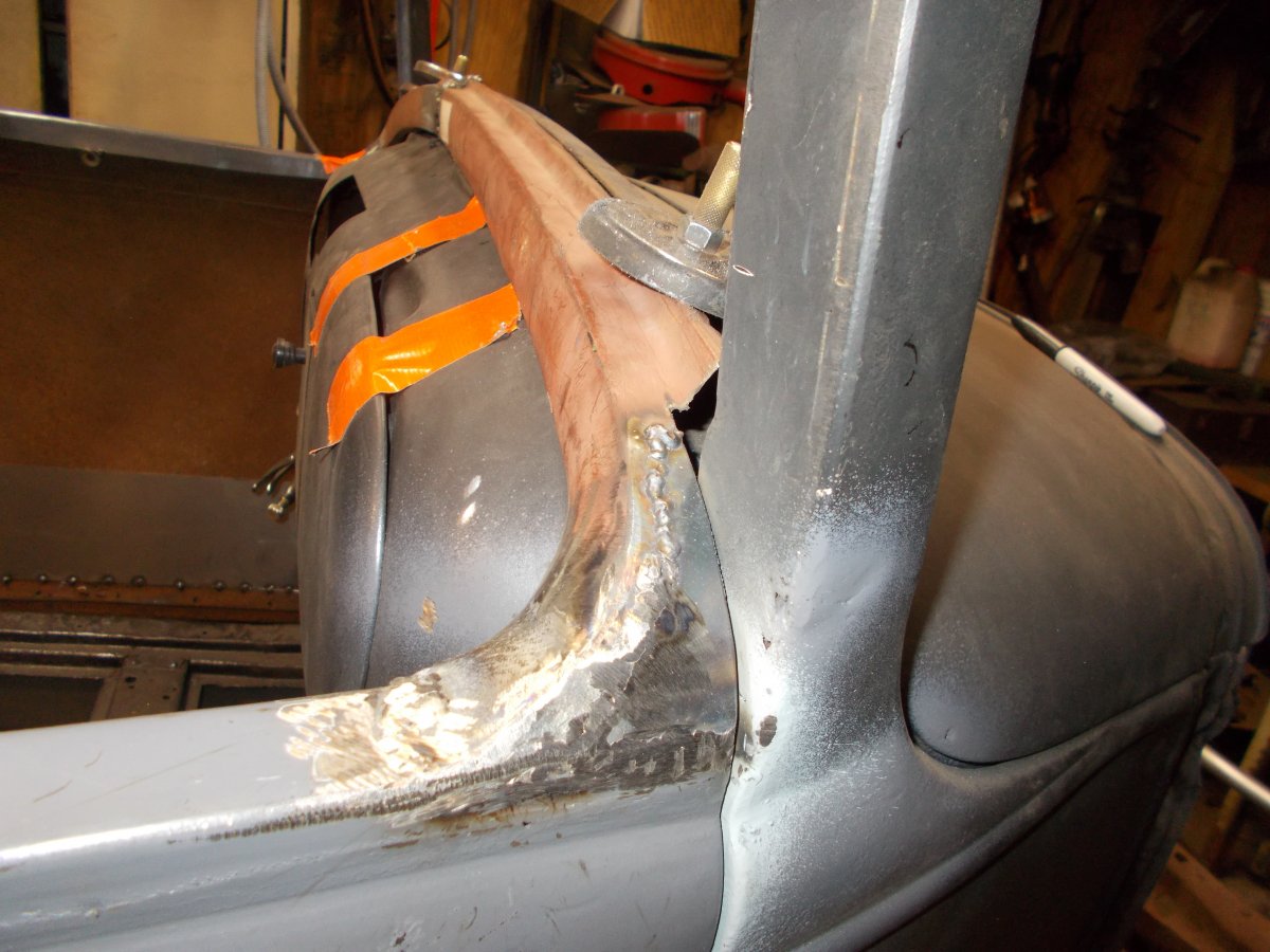

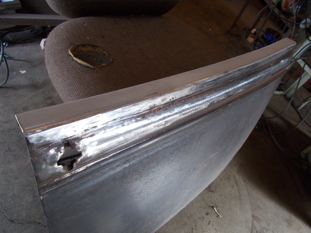

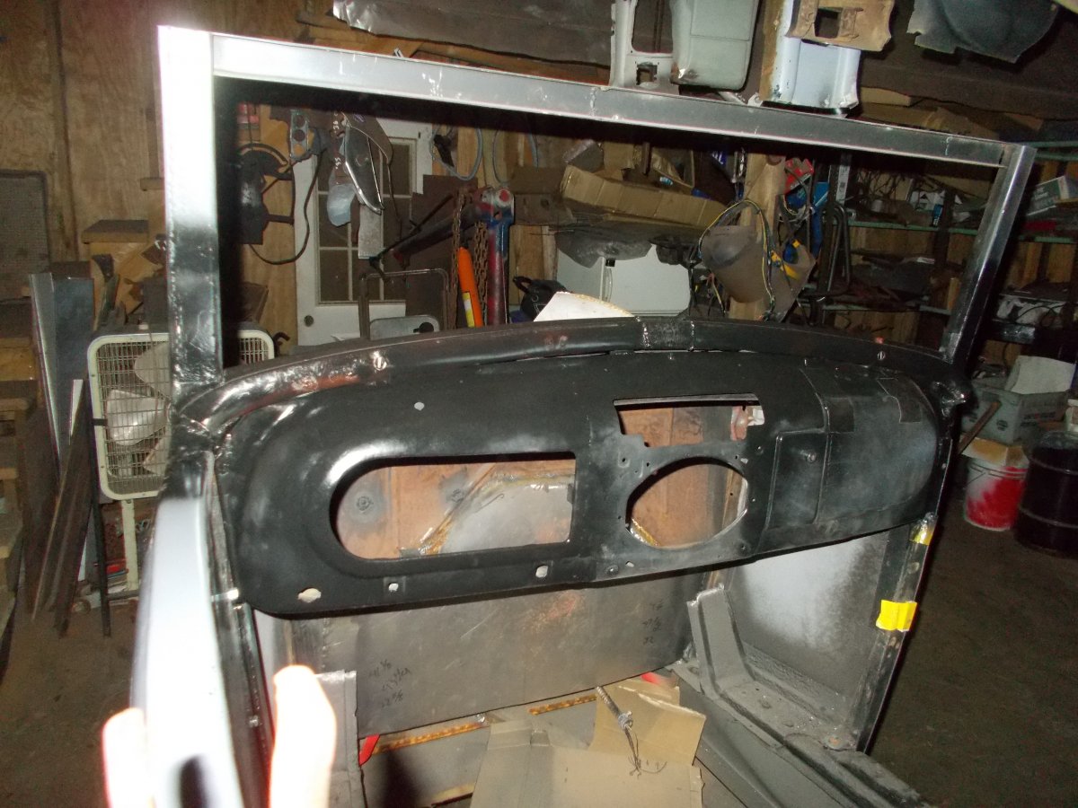

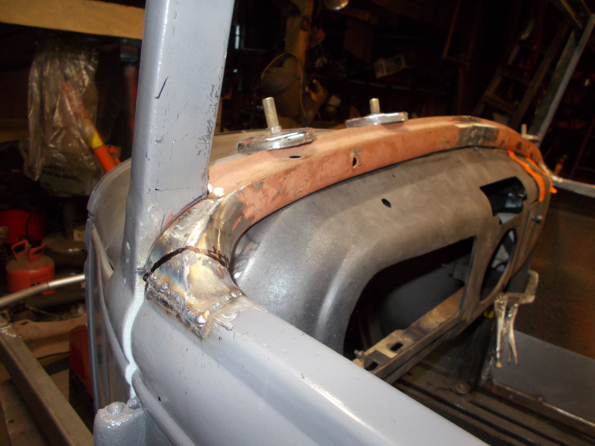

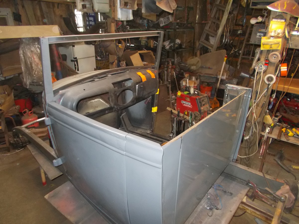

    cut the left door to dashrail gap, welded double row under the door half, double weld and a step welded to the dashrail end...
    had to add to the total width... maybe 3/8" or so.
    adding to the width gave me a chance to improve the gap on the right side...

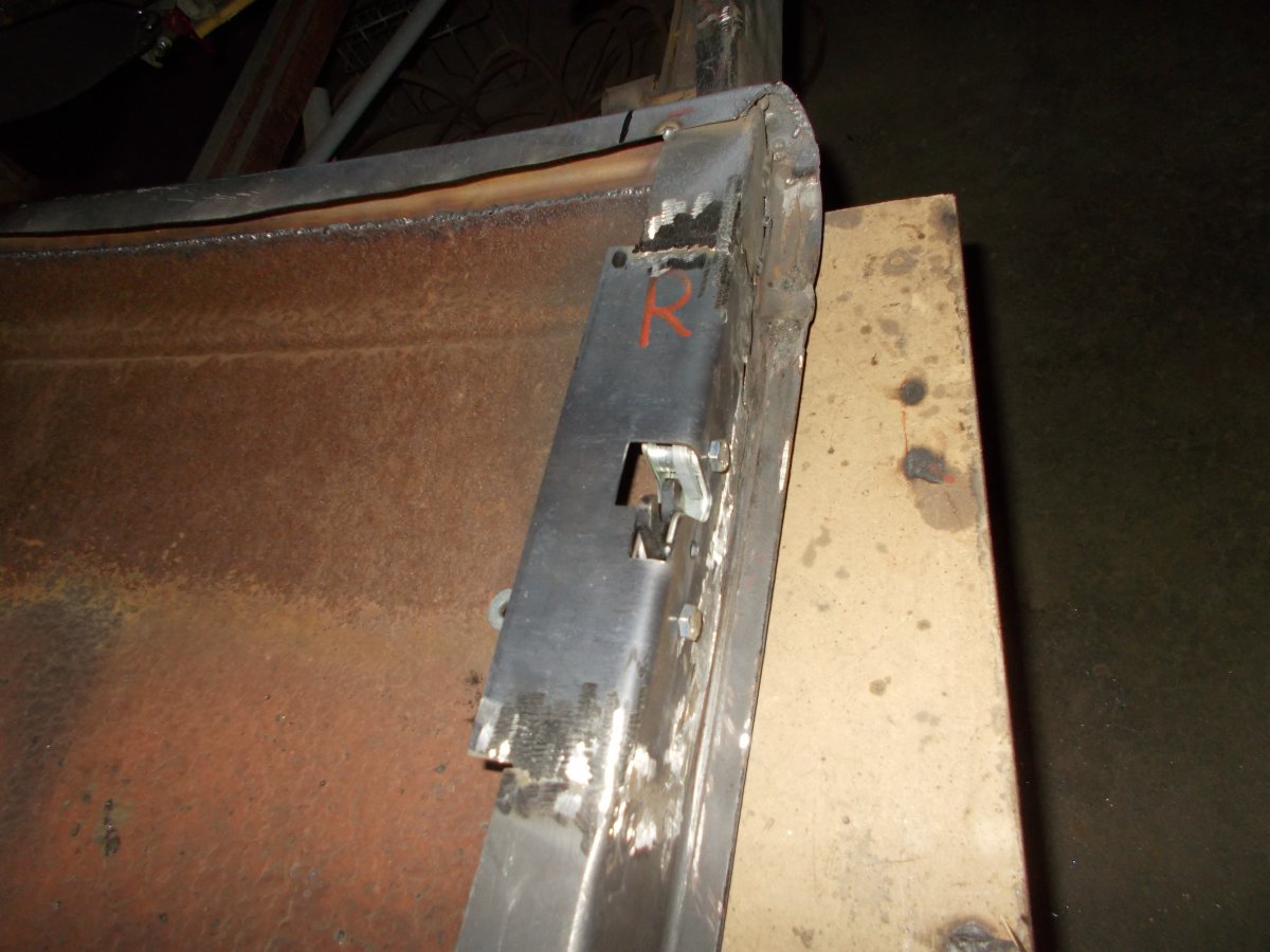

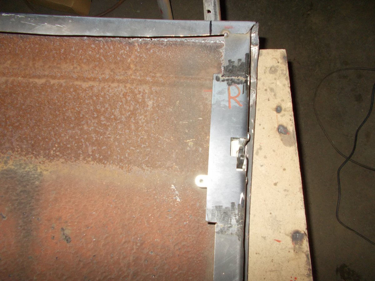

    Welded the bear paw latch panels into the B jams, latch pins and door latch openers next...

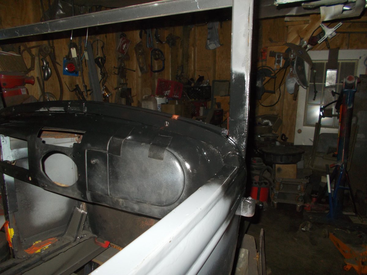

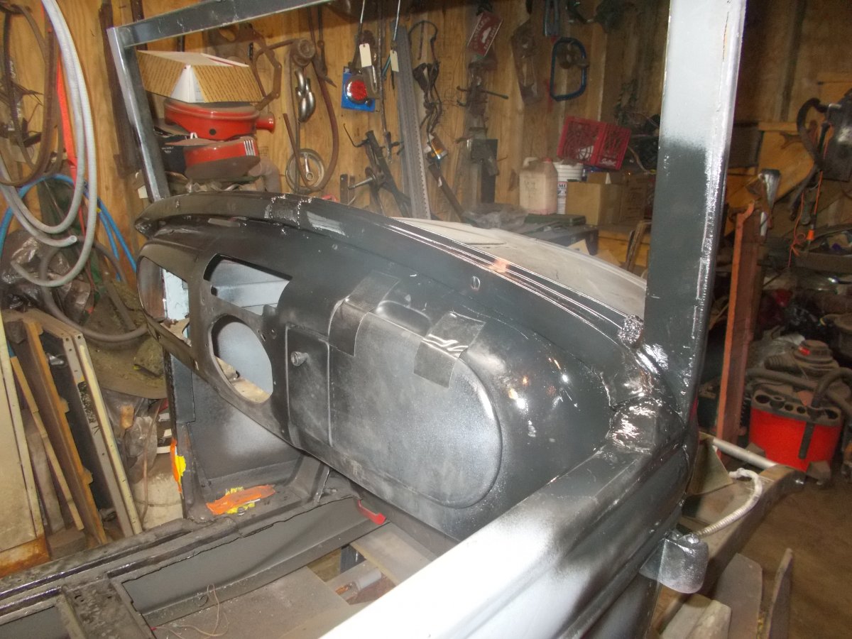

    Welded end caps on the dashrail ends...
    added a flat washer and then drilled and tapped for a 1/4"-20 thread... to bolt to the A pillars...
    welded T nuts to 2 tabs that align with the 2 outer countersunk holes in the dashrails face...
    then welded the 2 tabs to the top of the '48 truck dash...

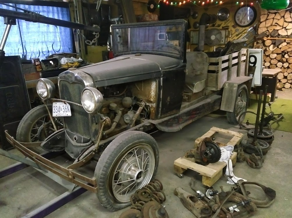

  15. I like your build and have been contemplating the same thing ever since acquiring my Model A. I repaired the doors and built cab corners but trying to keep some of the metal work to match the previous. Mine is a cut down tudor that was used a as truck on a friends berry farm, was last licensed in 68 and has sat for 40 years in the barn. He was killed in a tractor accident two years ago so I want to finish it close to the way he drove it for years to market. Eventually build up the ch***is with hydraulic brakes and warm up the banger. One thing I need to complete the back panel is the measurement across from door to door at the top of the door jamb. With all the drawings available it does not include the width. Keep up the good work when you can, we should have listened to take care of ourselves younger and now pay the price.
      177 KB
      337
      149.7 KB
      348
      200.9 KB
      328

    got to weld the latch pin panels into the B pillars...
    ship luck, the planned location for the lock knobs in the doors [2" from the rear edge] is right over the latch actuator...

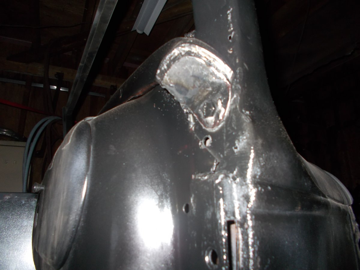

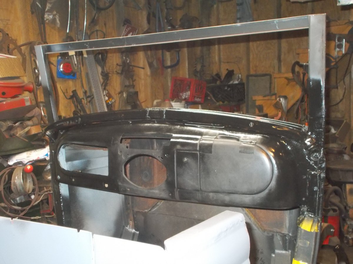

    DSCN4831.JPG boxed the back side of the dashrail ends...

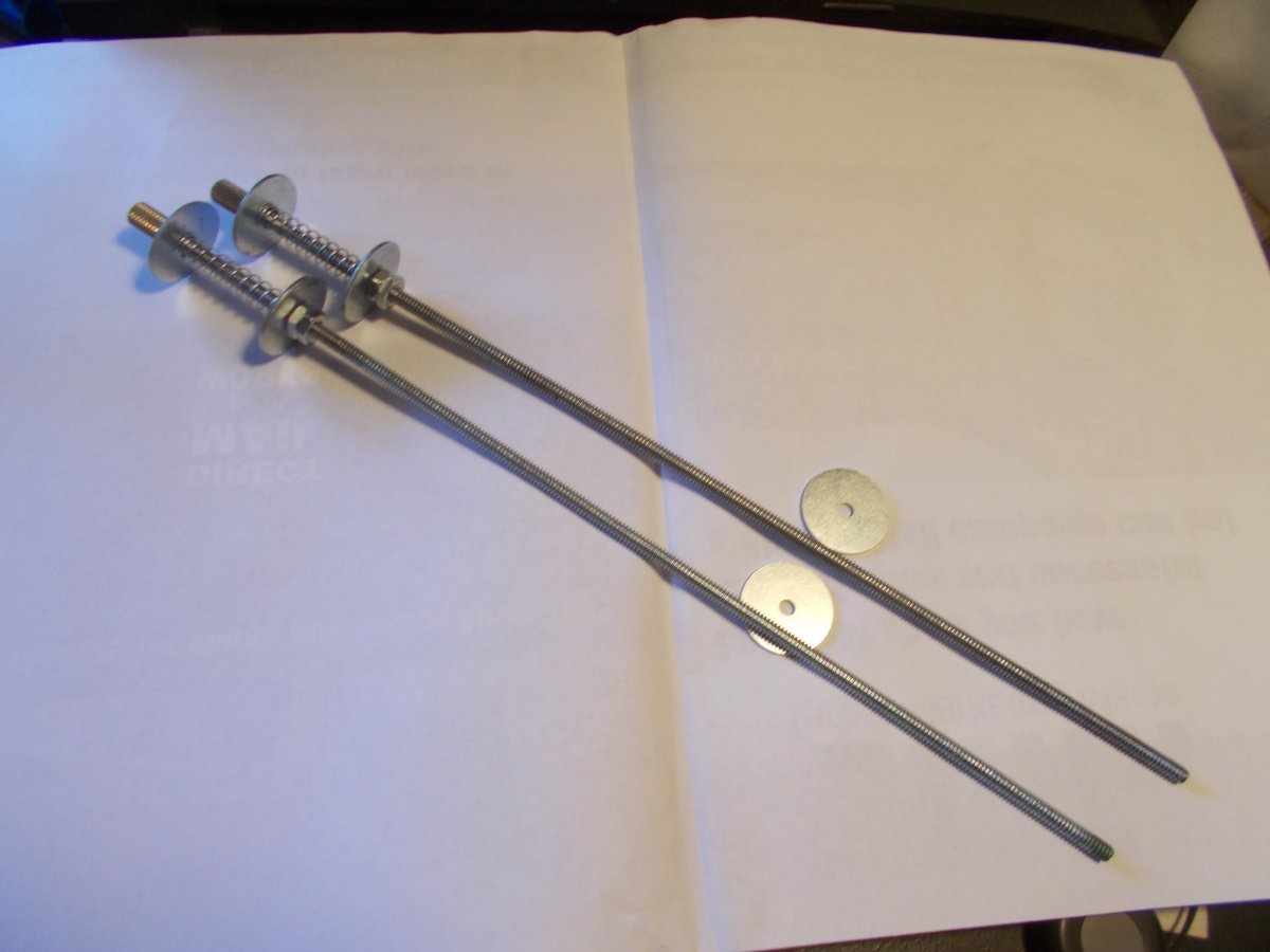

    ship luck... I found a spring, 2.5" x 7/16"... cut it in half... a model A upholstery washers from the A pillars are a perfect fit... work as retainer to keep the spring centered around the shaft...
    soon as usps gets the "dimpler" to me I will ***emble and install the door openers...

    so I fabbed up the linkage while I wait...
    [1]10-24 shaft, [2] 10-24 nuts, [2] small hole flat washers, [1] spring... each side.
    Adjust the shaft to have the threads rise above the door top enough to let the knob screw on, and put a little tension on the spring, when all is set, double measure and then weld another flat washer on end so it aligns with the latch's actuator holes...
    retired from GE 20 years ago, stumbled onto the [2] br***, knurled, blind , end caps... they were 10-32, but because I got them from GE, I re-tapped a 1/2" on the shaft end to 10-32... screwed 'em on !

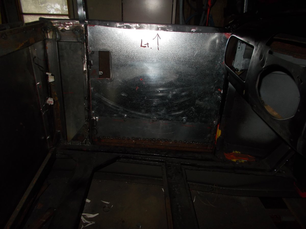

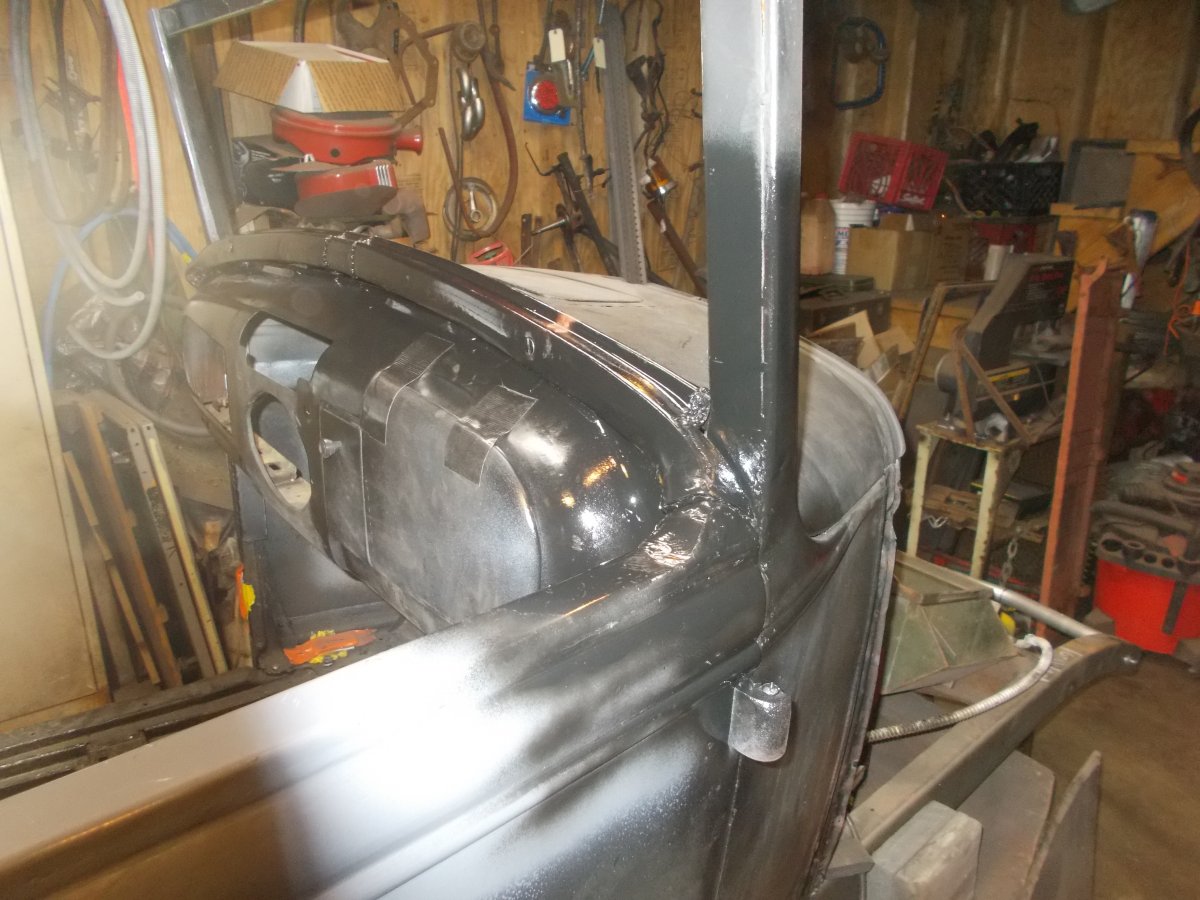

    boxed the underside of the dashrails…
    welded in the bear paw latch mounts...
    roughed out an inner door skin...
    sharpie line is where the door opener shaft will stick through...
    the door opener knob will be directly above the actuator's hole...
    my linkage will slide up through the dimpled hole and then mount to the actuator hole and has adjustment nuts that keep the spring pressed up against the inner door top... DSCN4846.JPG

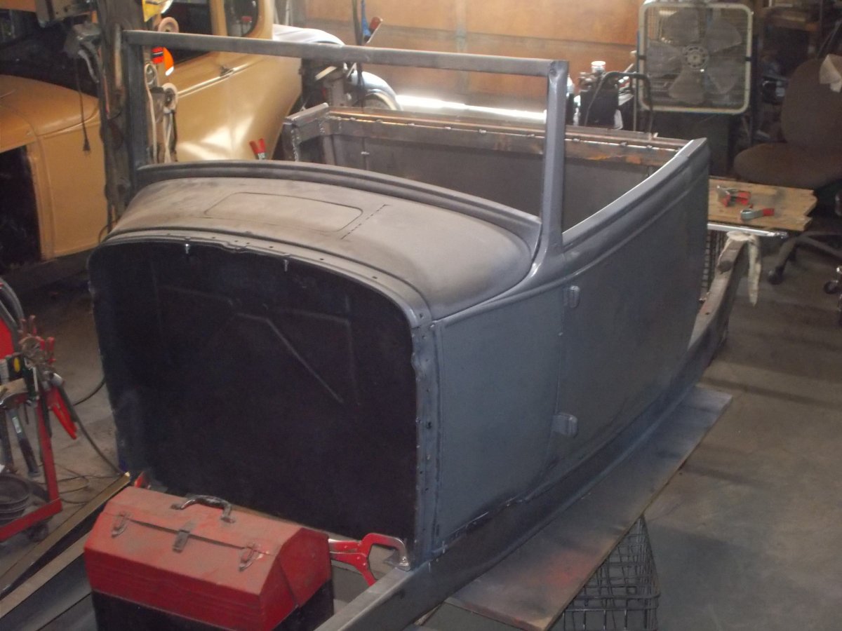

    Picked up a pair of school bus seats as my cab is narrower than stock, need 2 to make it wider and they have thin backs... bellyroom !
    also got a line on the back half of a '30-'31 coupe... made an offer, fingers crossed...
