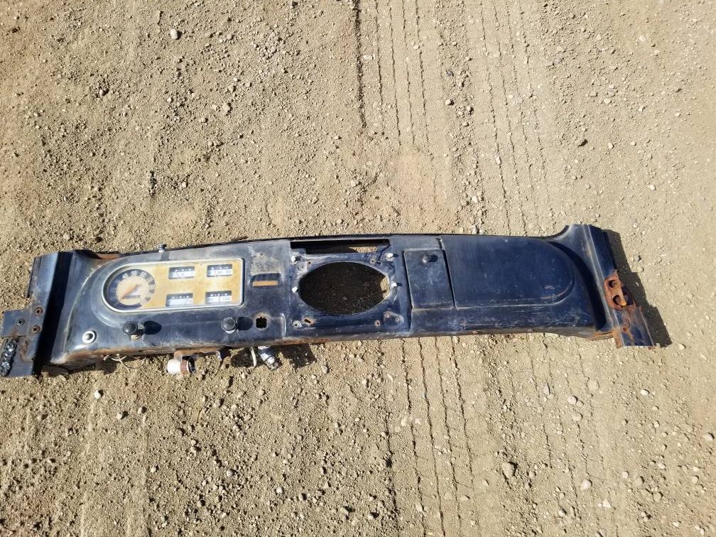

    DSCN4728.JPG thinking another '48-'50 truck dash ;
    has been narrowed to fit in a '30 coupe cowl...
    DSCN4005.JPG time worn cluster ;
    s-l1600 dash.jpg get "arountoit" soon as I can ...

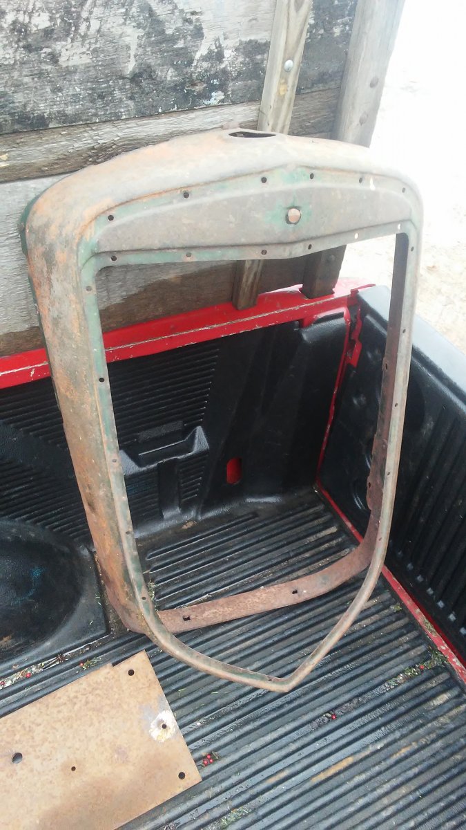

    just spoke with a nice fellow on the phone, he has a '34-'36 International grill...
    I want to run it on my roadster - esque truck...
    fair price, looks ok... got it... go Fastenal go...
  9. sloppy jalopies
    Joined: Jun 29, 2015
    Posts: 5,256
    sloppy jalopies
    Grill is a '34 - '36 International truck,
    it is 24" wide at the top,
    a '30 Ford grill is just under 20"...
    the Int is 28" above the frame...
    the A is 27"... it won't be too bad in front of a hoodless, home made roadster pick up cab...
    a little trimming on the sides should lower it an inch or so...
    I think I can live with it being wider...

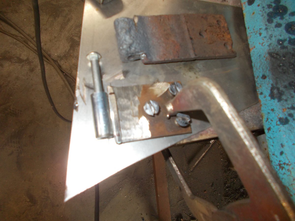

    going to need [4] male/ cowl hinges...
    the $1.20 - 1/4" ID tube slides into the $1.45 - 3/8" tube making the tube just smaller than the stocker...
    bought 4' x 3/16" x 3" cold rolled for $10.00 with a little luck and some labor should be able to make the hinge halves I need... I will probably use the odd [extra slot] style hinges, cut off the extra slotted tube and weld on my hardware store double tube... easier ?
    yup...

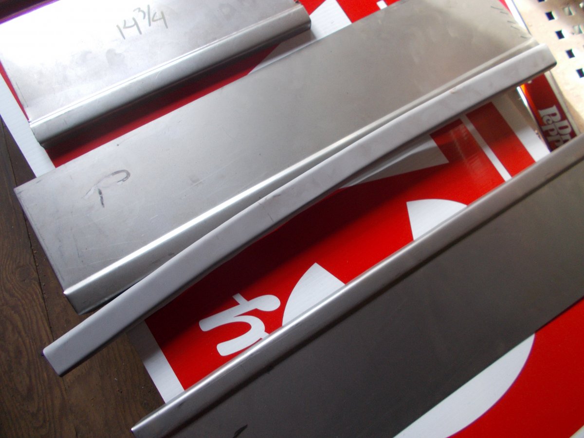

    bent a couple 47" sections of 19. ga. as bedsides $30.00 Marden's …
    for a rough rod project I can bring to the topsham swapmeet early may...
    my brake didn't have the beef for it...
    I had to help it with a hammer on the tight bends at the top... edges look hammered.
    I was going to slide 1/2" x 1/2" tubing into them...
    now I will cut off the bad bends and weld the tubing on by itself...

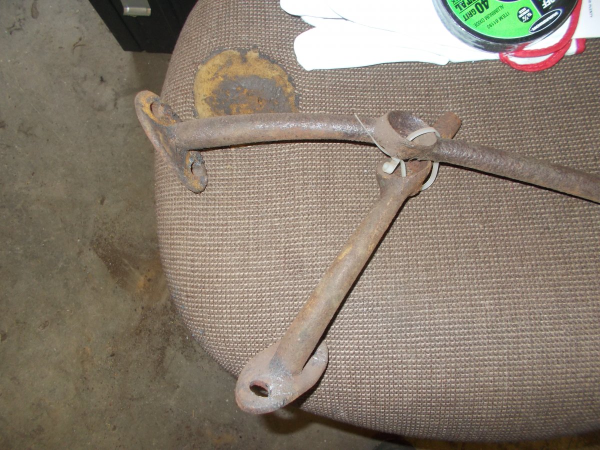

    yup... lazy over genius... I need [4] male / cowl hinges for the '30 cab...
    but instead of heating, bending, cooling... heating, bending the other way, cooling … then weld the new tubes on...
    I have some of the oddball [murray] style hinges that I will cut both the sleeves off, weld on the new tubes, ream to 1/4" and use the oversize hinge pins...
  27. sloppy jalopies
    Posts: 5,256
    sloppy jalopies
    DSCN5499.JPG DSCN5494.JPG grabbed a murray hinge...
    cut the 2 murray tubes off …
    slid the hardware store 1/4" tube into the 3/8" tube...
    marked and cut them to length...
    tacked and checked it...
    welded it...
    ground it...
    sanded a 1/4"-20 Philips a little to be a temporary hinge pin...
    gonna work... DSCN5486 - Copy.JPG DSCN5488 - Copy.JPG DSCN5493.JPG DSCN5494.JPG DSCN5487 - Copy.JPG

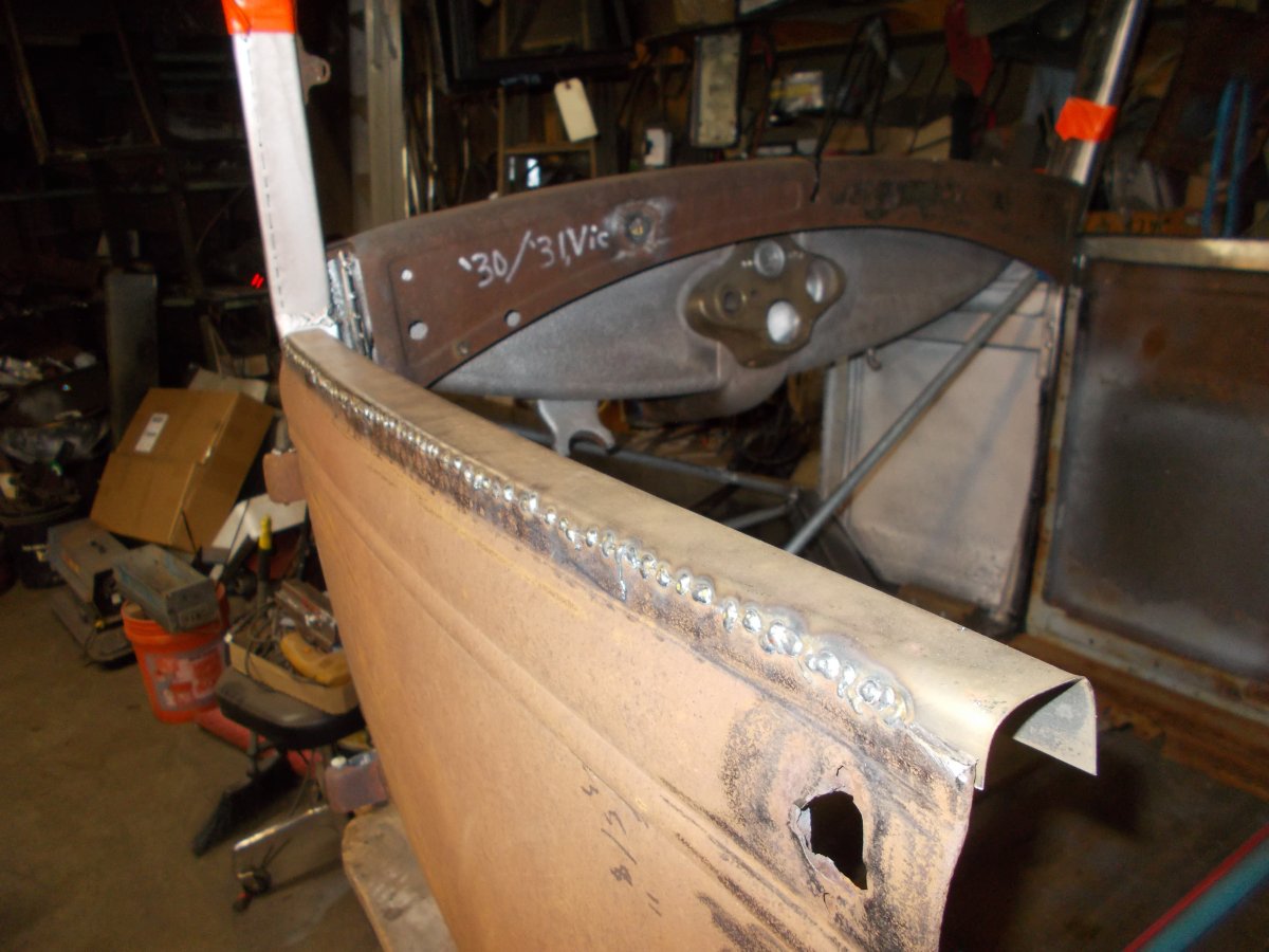

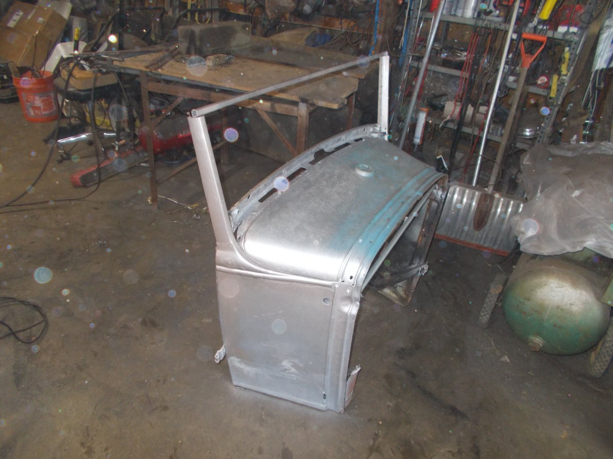

    Tack welded the right side door [top, cap, armrest] on... whatever its called...[pix]
    Screwed on the door hinges to get the cab length, minus the cab back...
    needed to invent the subfloor from the cowl back to where I cut off the roadster-esque p-u's subfloor...[pix]
    going to cut and splice it in, but will leave it a little long and trim till it is right...
    roughed it out only to realize that the radiused flange under the doors are different widths...
    on a thousand stich home made body I am not going to cut it out... and I don't have the correct section,
    so, let it be...

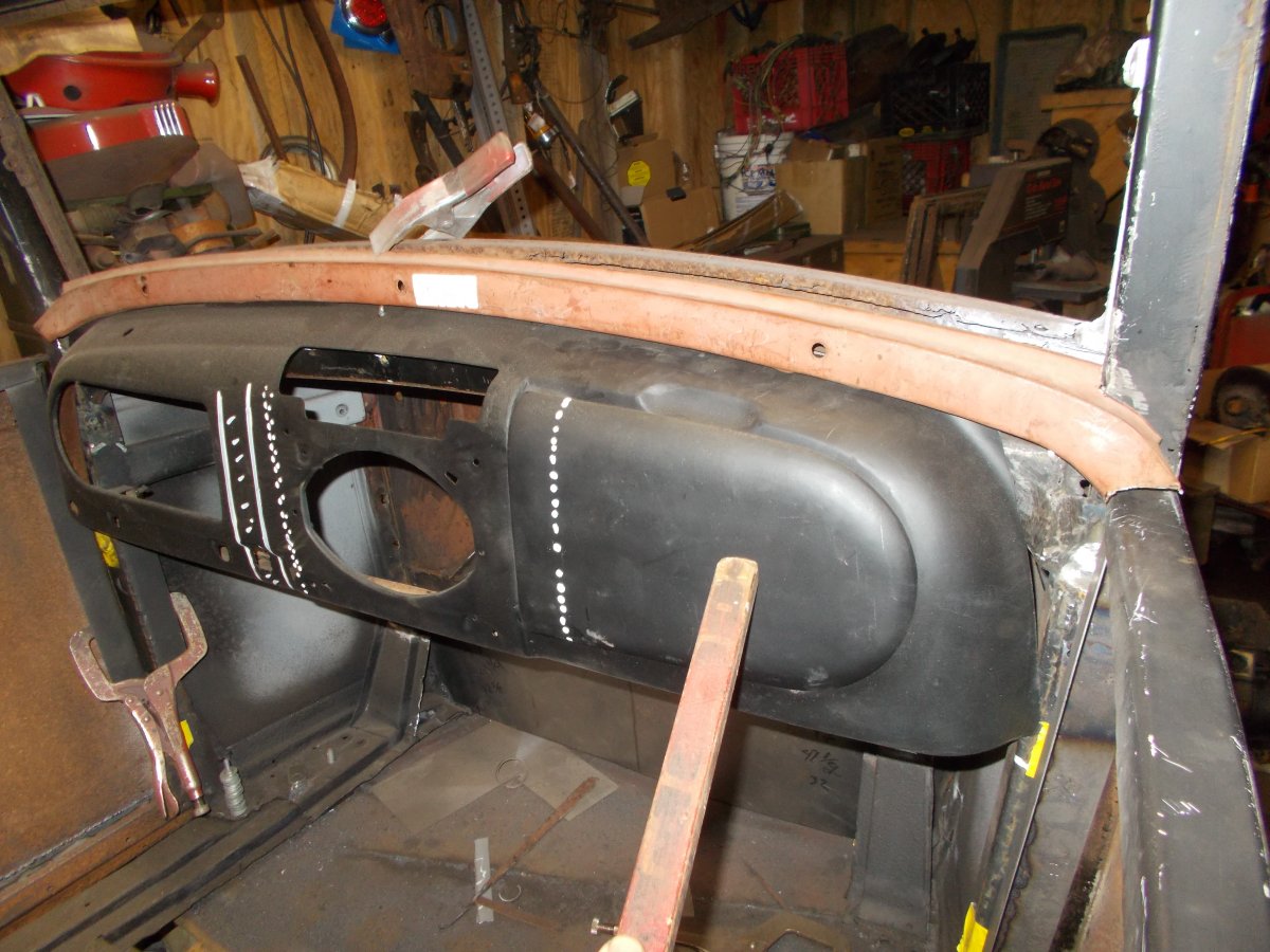

    simple dash ; going to add about 1" to the outer edges of the Vicky dash to better flow into the A pillar and the inner door edge...
    the slant window dashes are about 1" narrower than '30-31 coupes...
