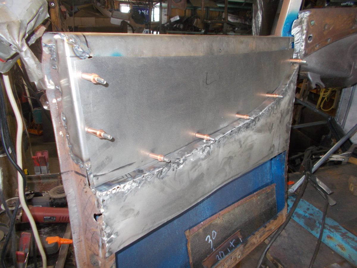

  2. sloppy jalopies
    Joined: Jun 29, 2015
    Posts: 5,256
    sloppy jalopies

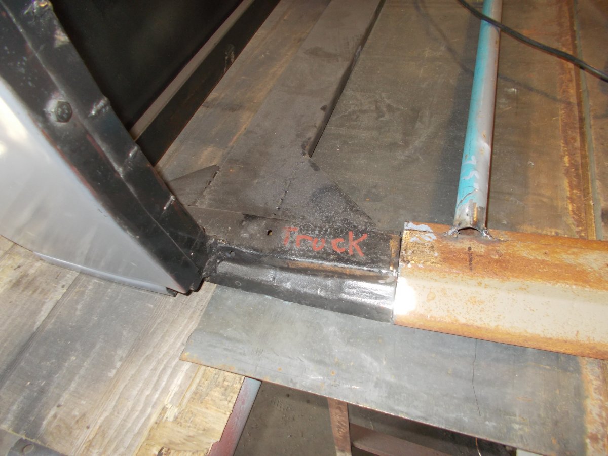

    DSCN5540.JPG DSCN5543.JPG DSCN5545.JPG Spliced, [welded] the subrails together... reamed the [4] hinge pin holes to 1/4"...new pins...
    welded extensions to the dash... it still needs some t******* and [11] drilled holes filled... nap... DSCN5539.JPG DSCN5541.JPG DSCN5540.JPG

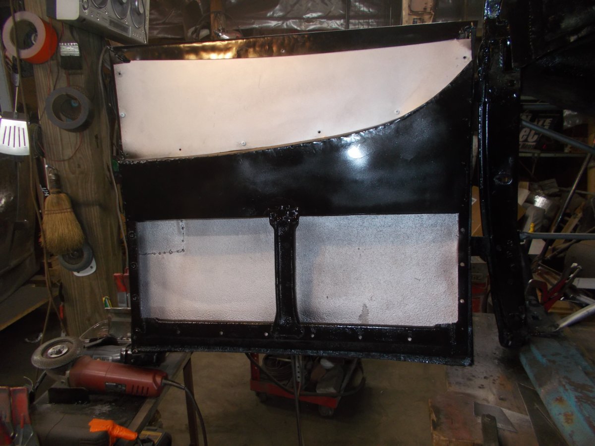

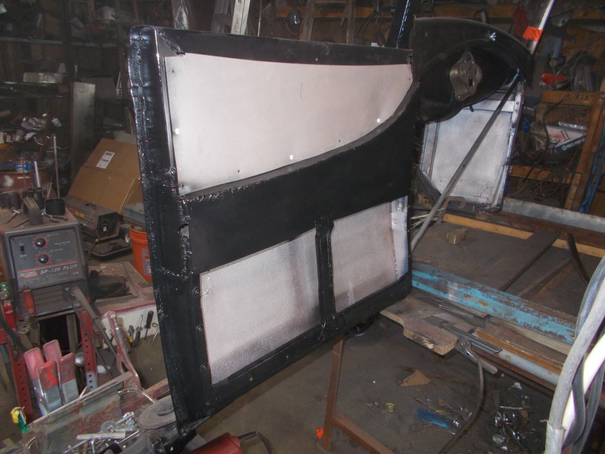

    built the door offset that mounts the upside down garnish molding...
    the lower panel is welded in, will weld in the shortened center vertical inner door brace...
    the bear paw latches will mount above the offset just below the cleko...

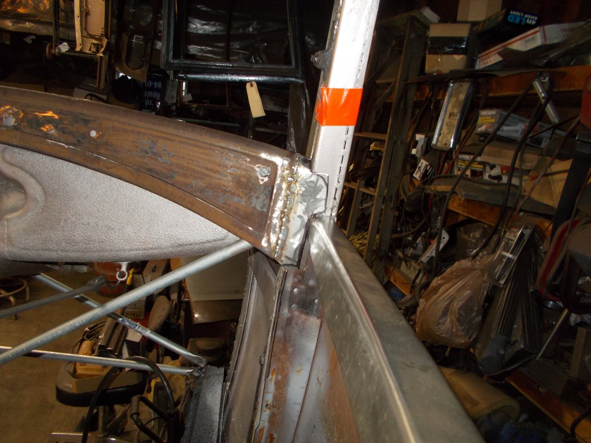

    Welded in a B jam patch left door...
    patches behind the hinges, [8] holes in the dash face... ground the door top cap welds right side door...

    The work on these doors was a relatively easy way to heal a coupester's black eye... door tops !

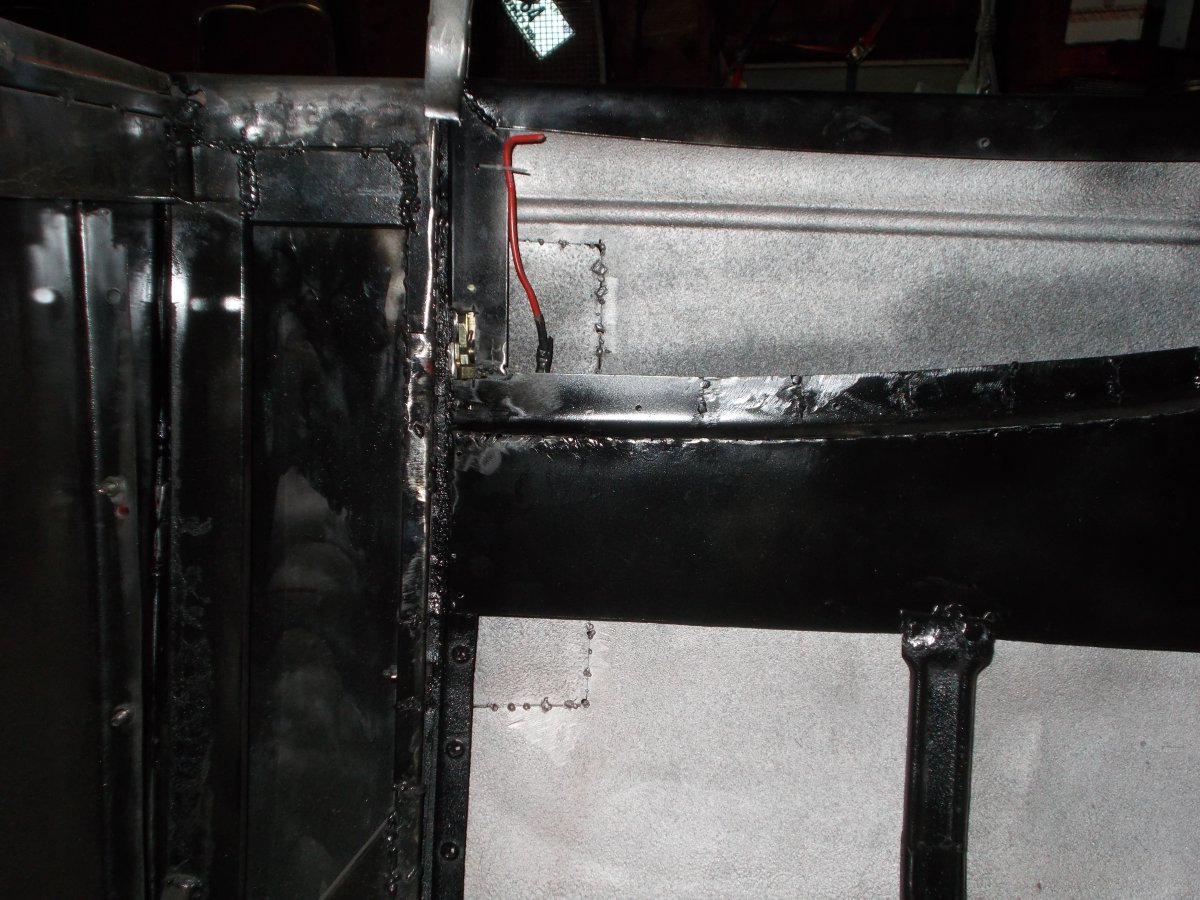

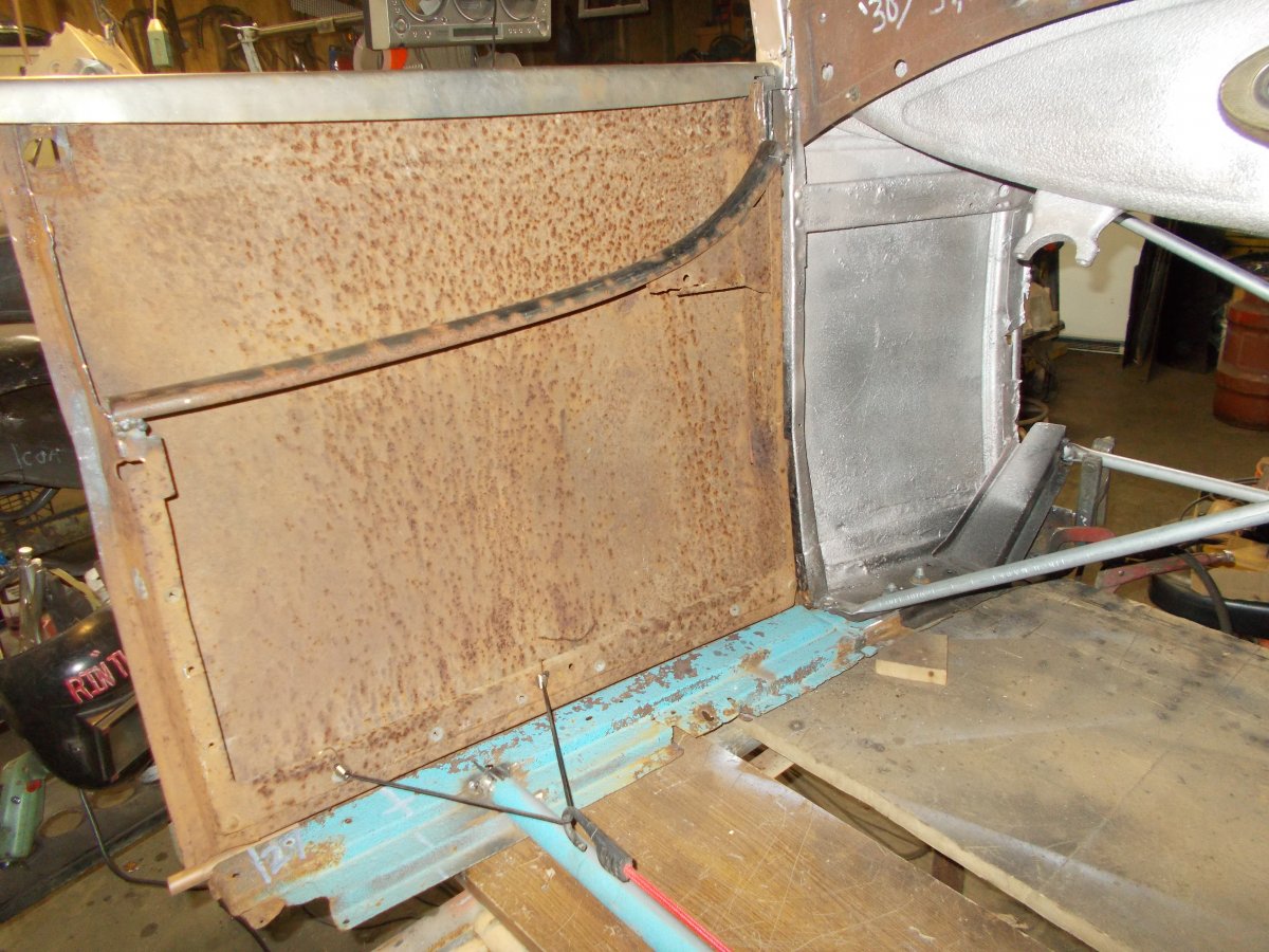

    Welded and ground a dozen small rust holes through the right subrail…
    replaced about 5" of the outer arched right subrail… ground - sanded...

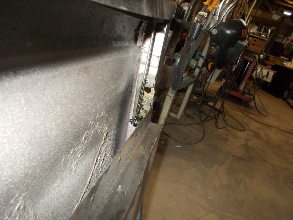

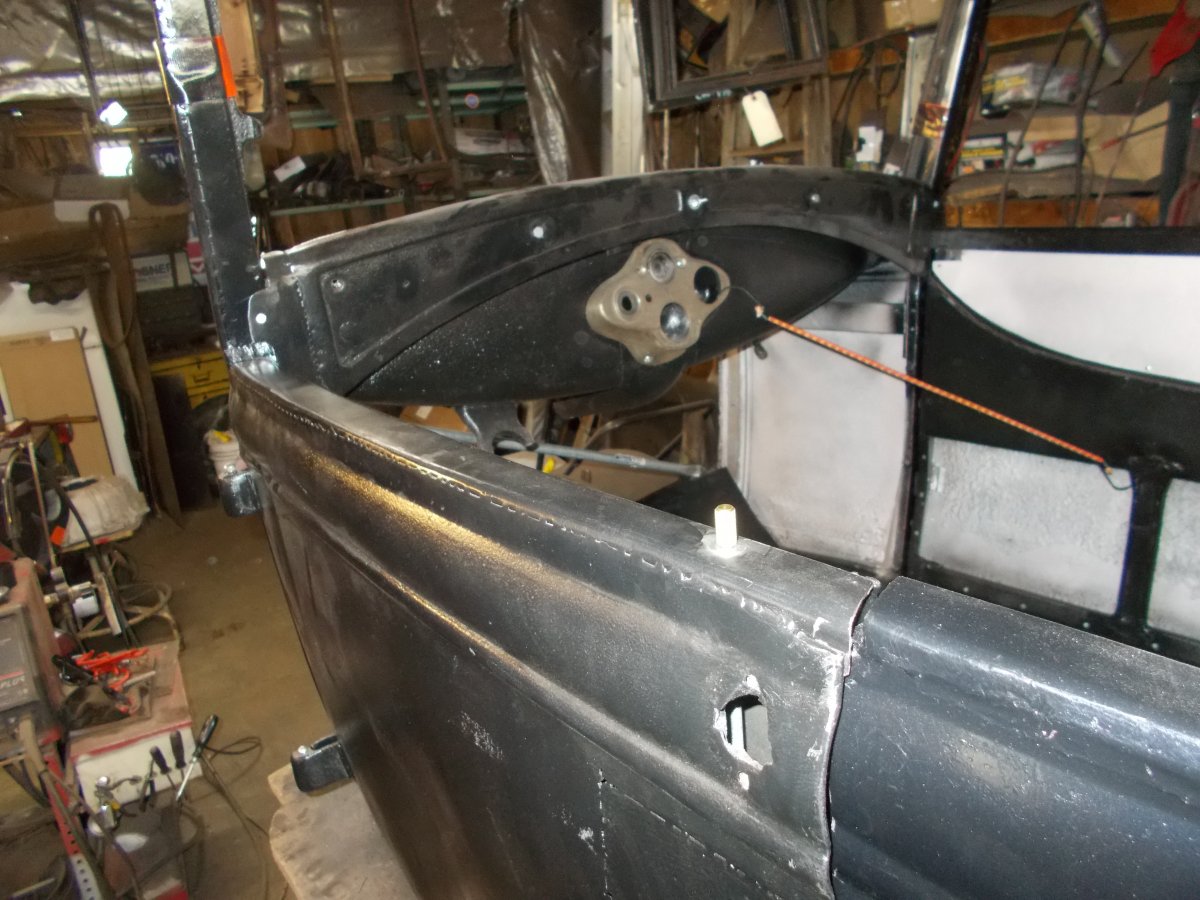

    Cut, fit and screwed in both of the small bear paw latches …
    pull up on the red cable opens the latch, going to use '60s door locks as openers...
    latch pins in the B pillars, door lock looking door openers on the list... DSCN5596.JPG DSCN5604.JPG

    The linkage that lets a '60s era door lock knob unlatch the door...
    lift knob to open...

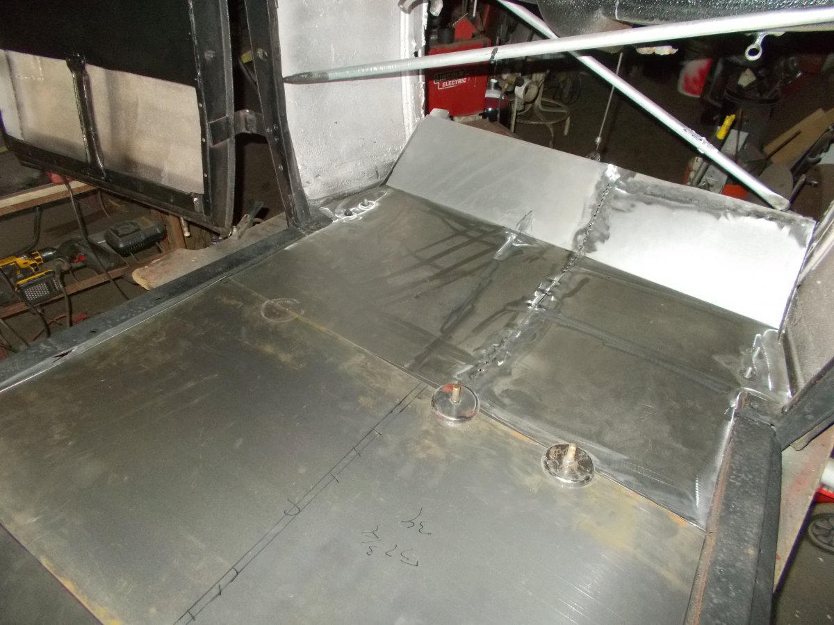

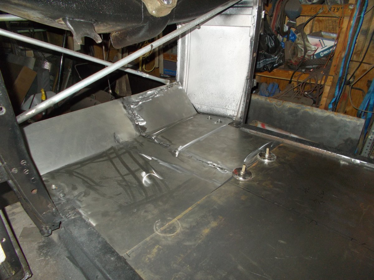

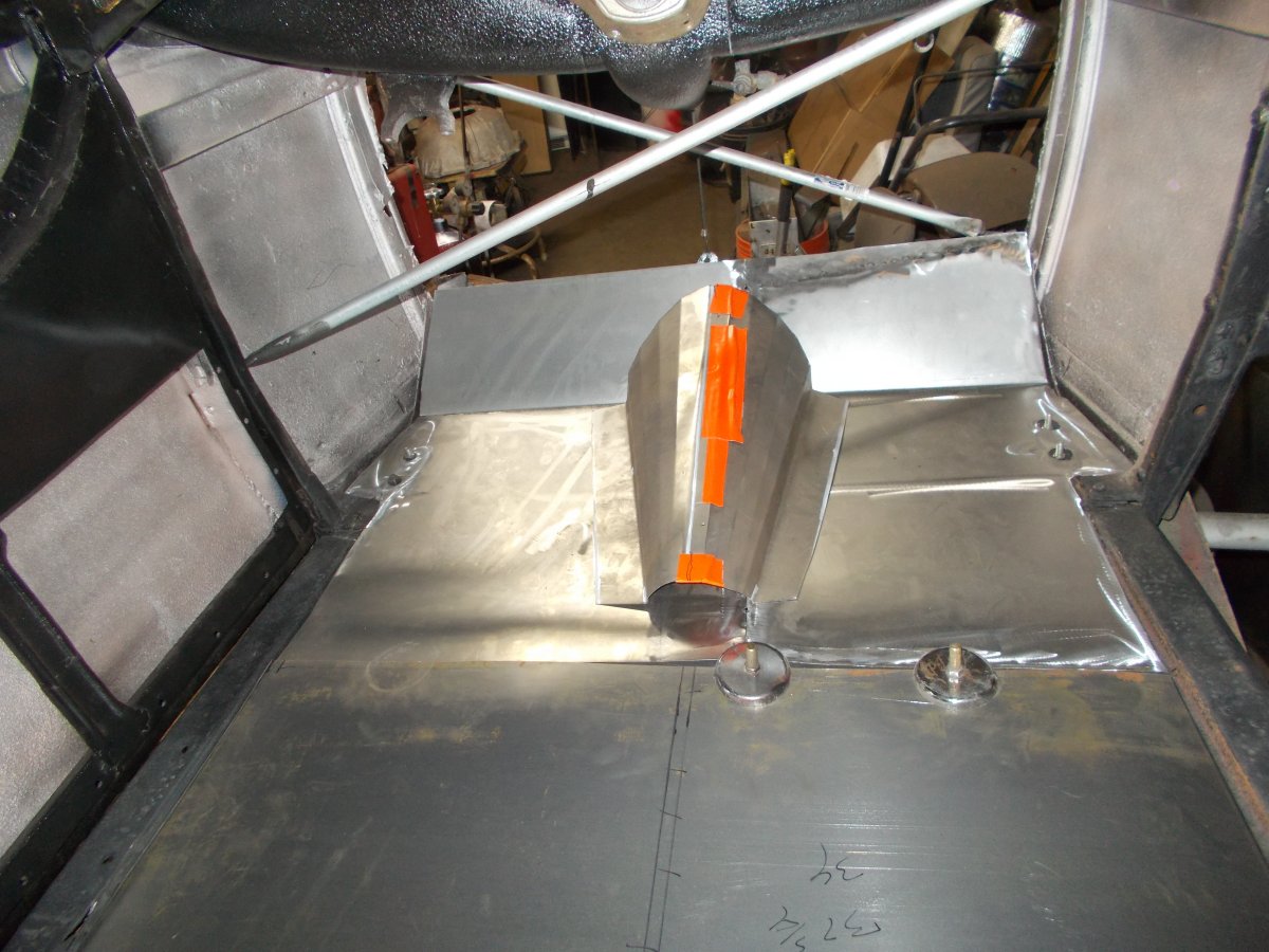

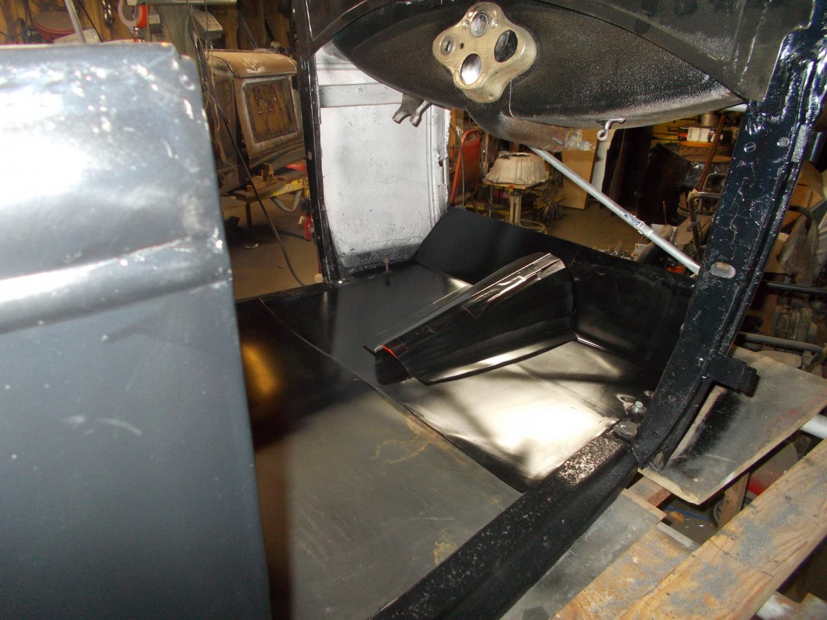

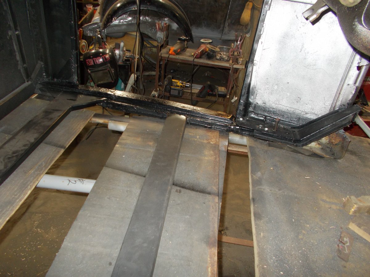

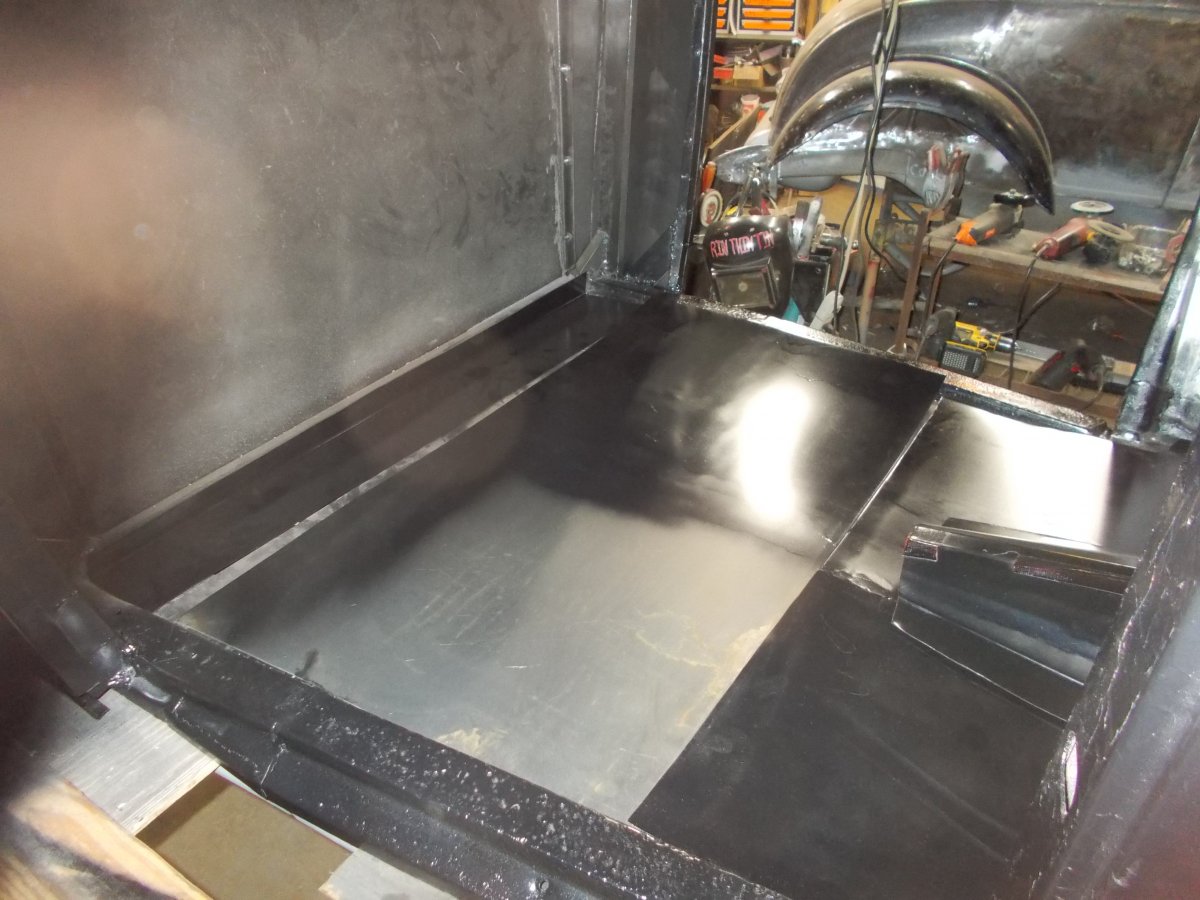

    DSCN5621.JPG DSCN5620.JPG View attachment 4606753 View attachment 4606751 DSCN5622.JPG Bent, cut, welded and fit the cab's [3] floor pans... getting there.

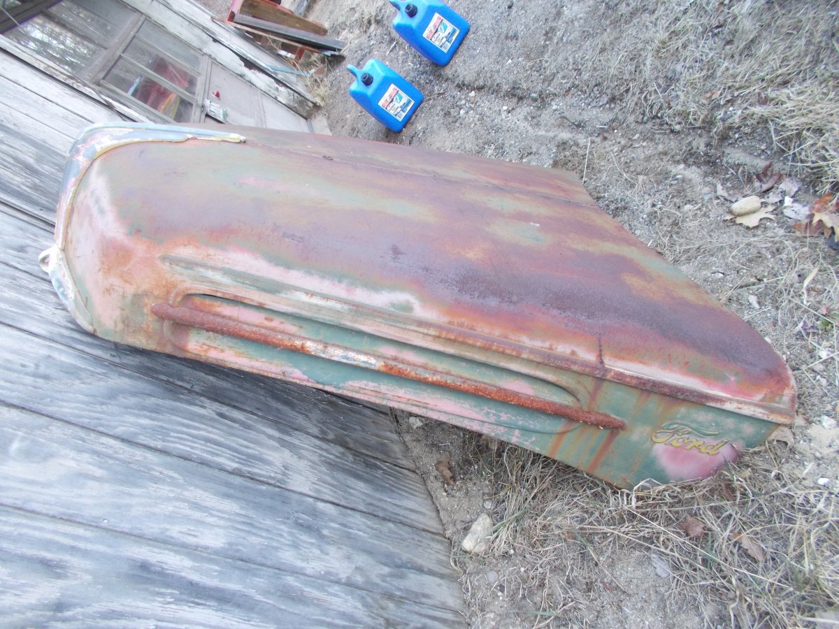

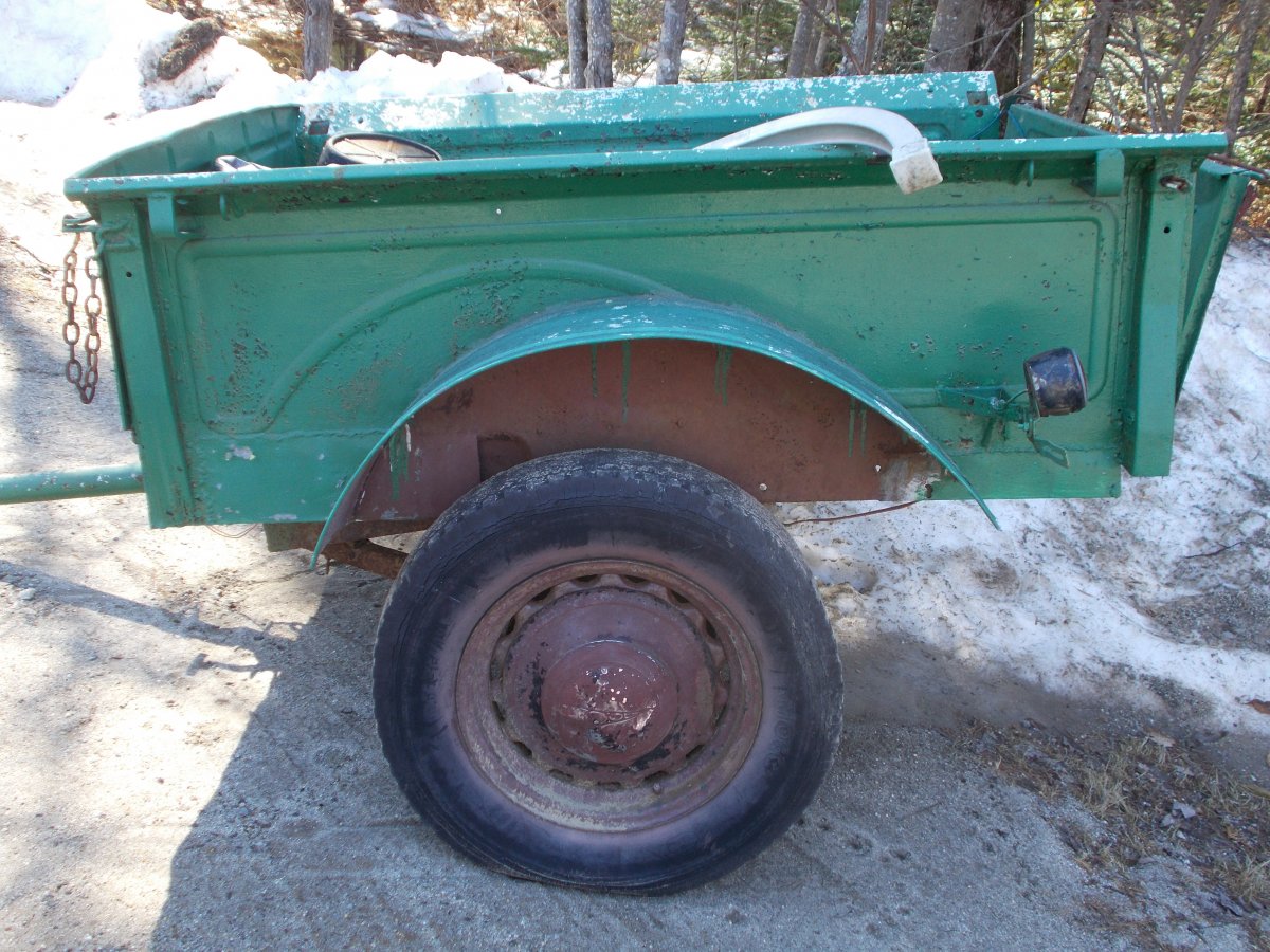

    bought a '31 wide bed tag along trailer and a '47 truck hood... DSCN5637.JPG DSCN5638.JPG DSCN5642.JPG
    won't need the '36 wide 5 brakes, hubs, drums, rims, '36 axle, spindles, spring, rims, hubcaps...

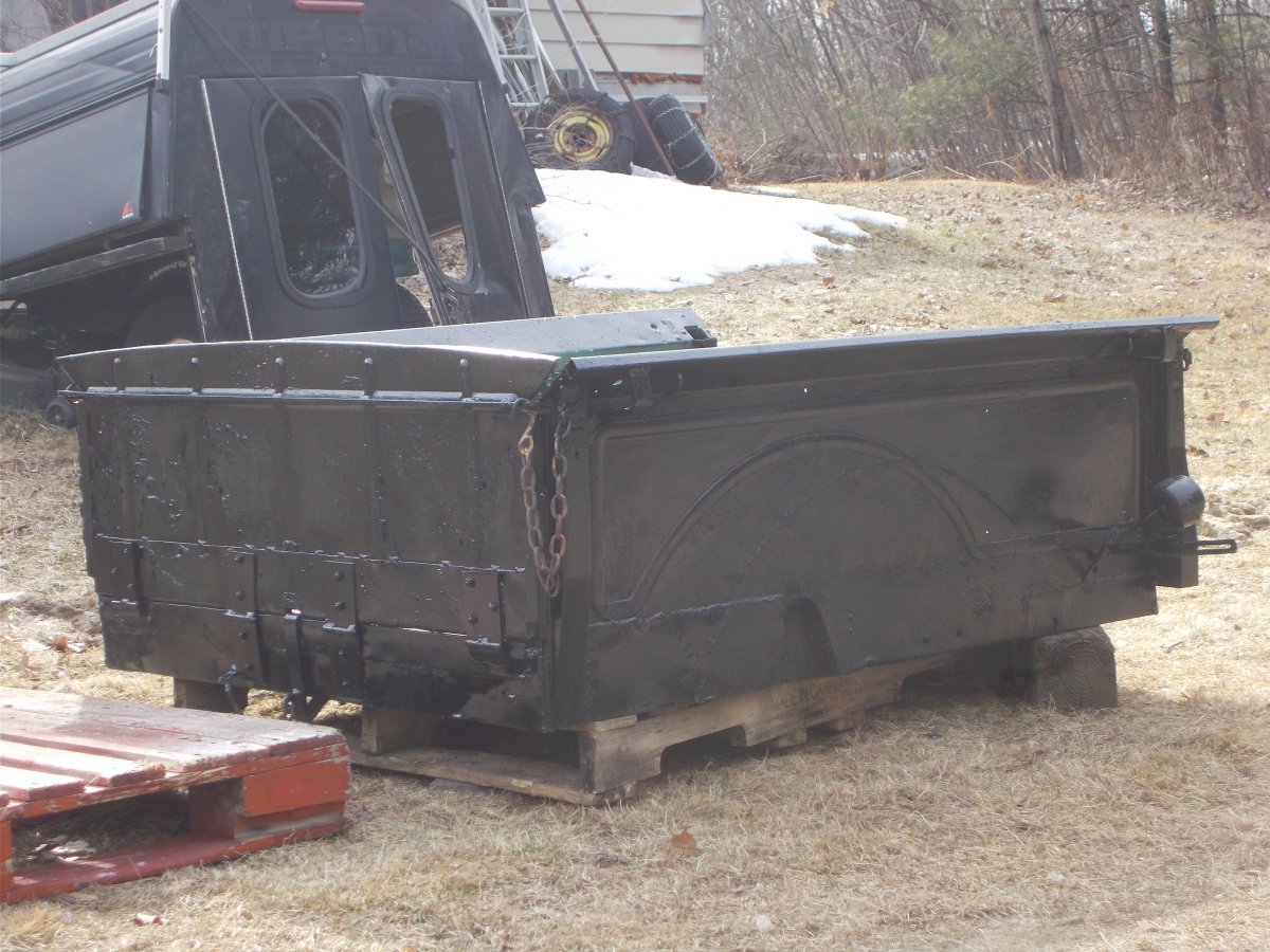

  12. sloppy jalopies
    Posts: 5,256
    sloppy jalopies

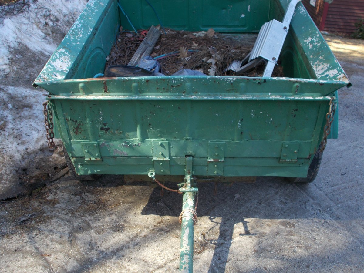

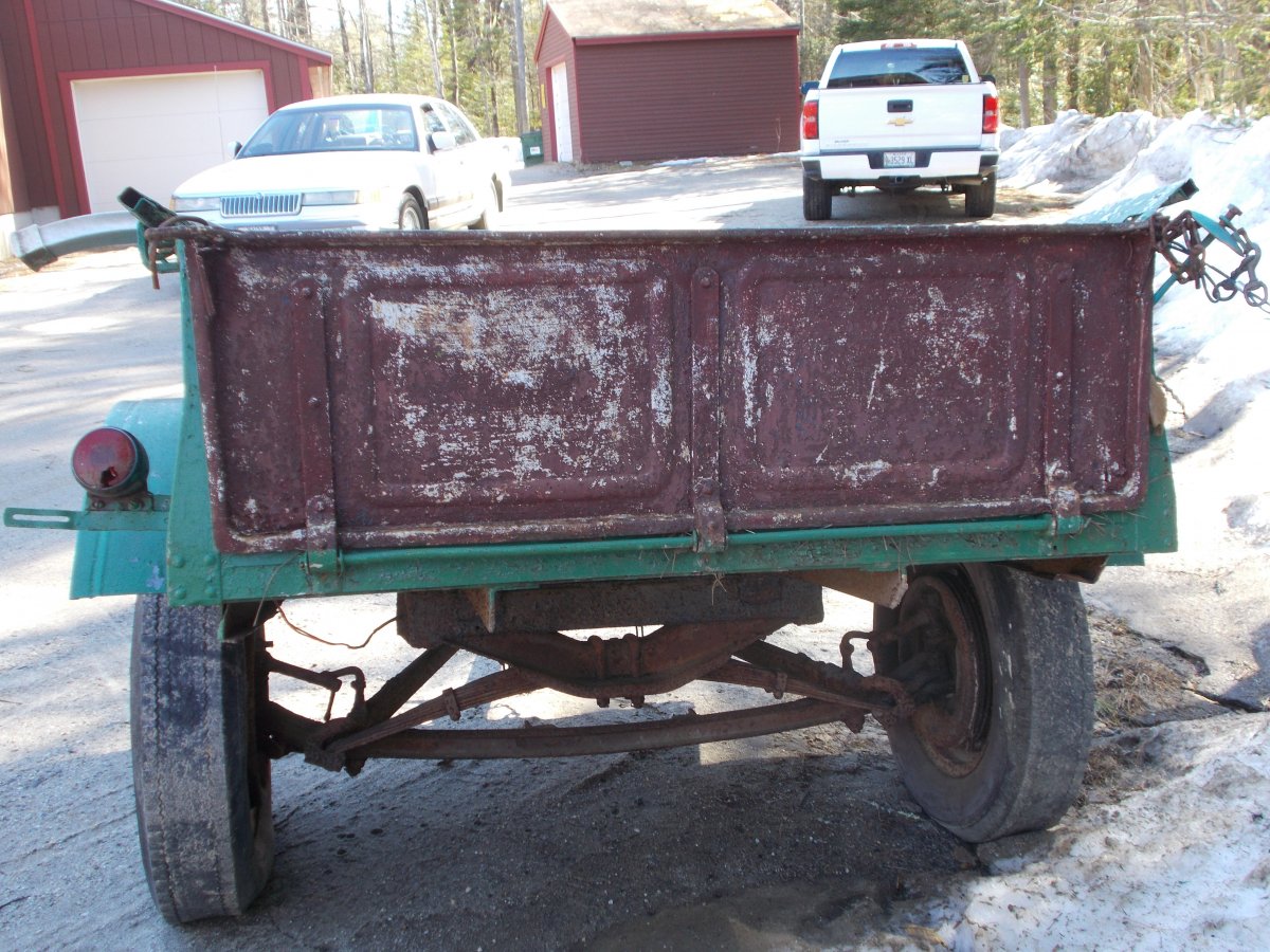

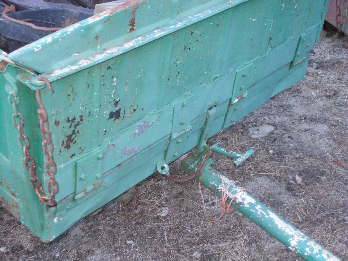

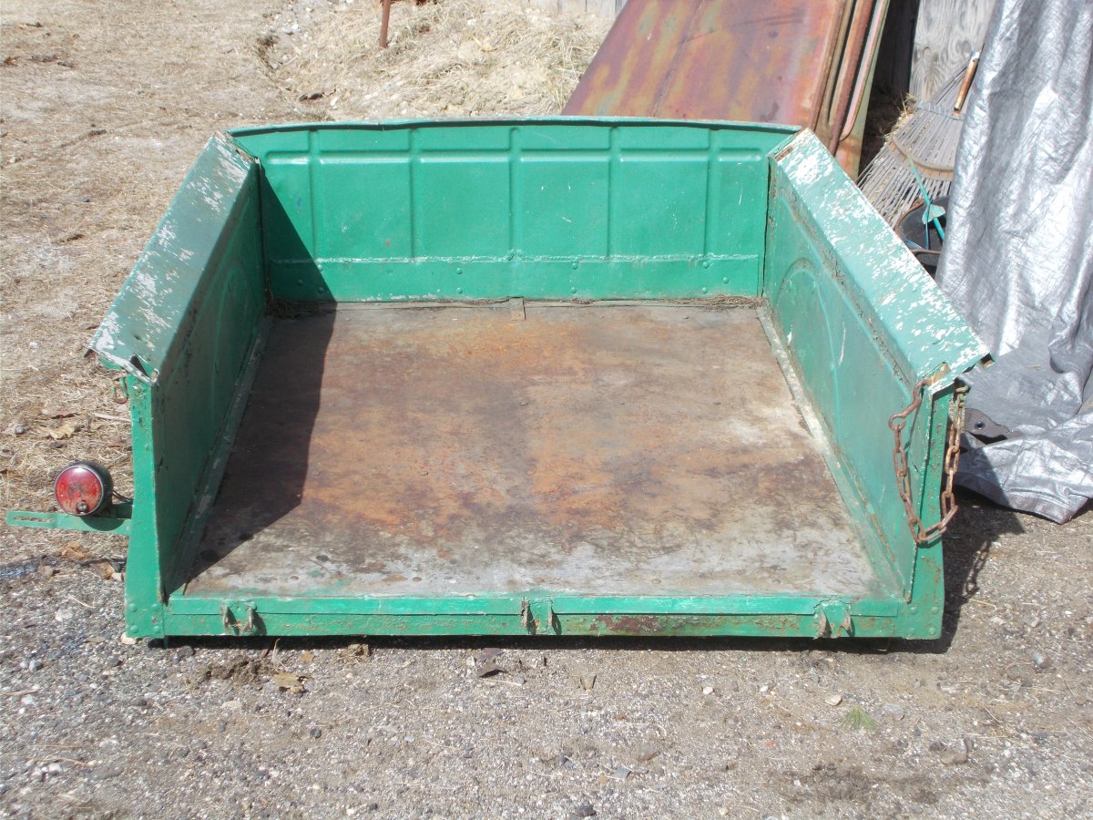

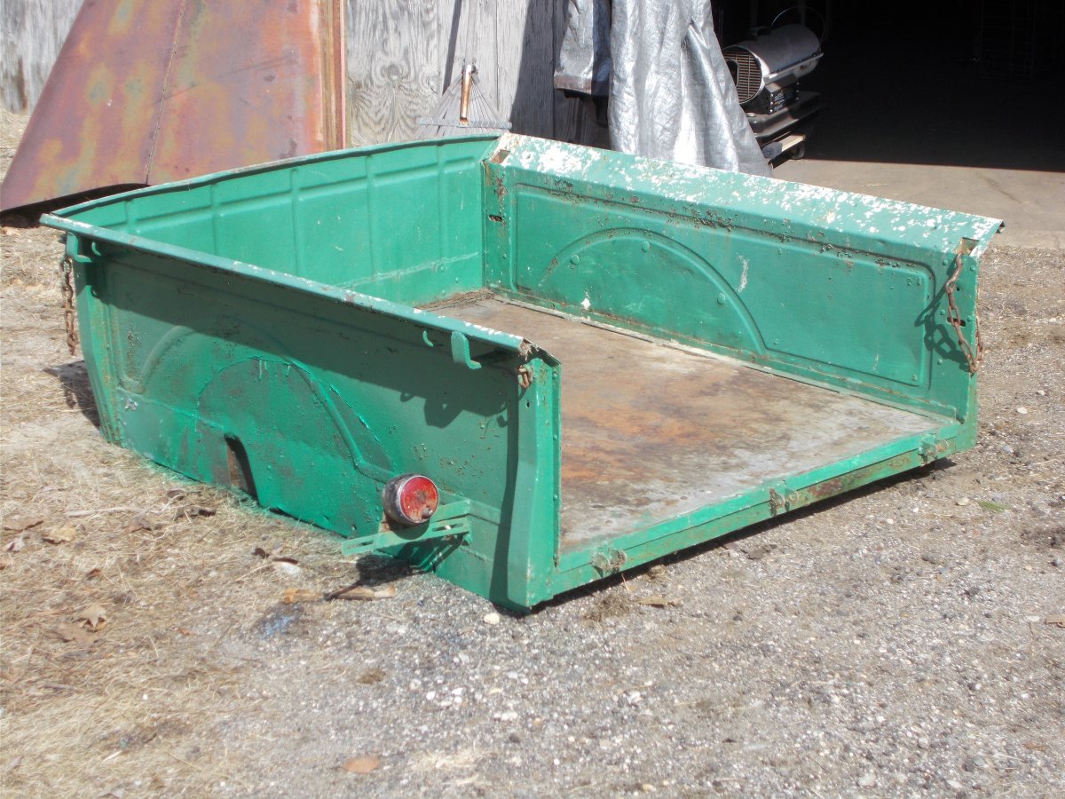

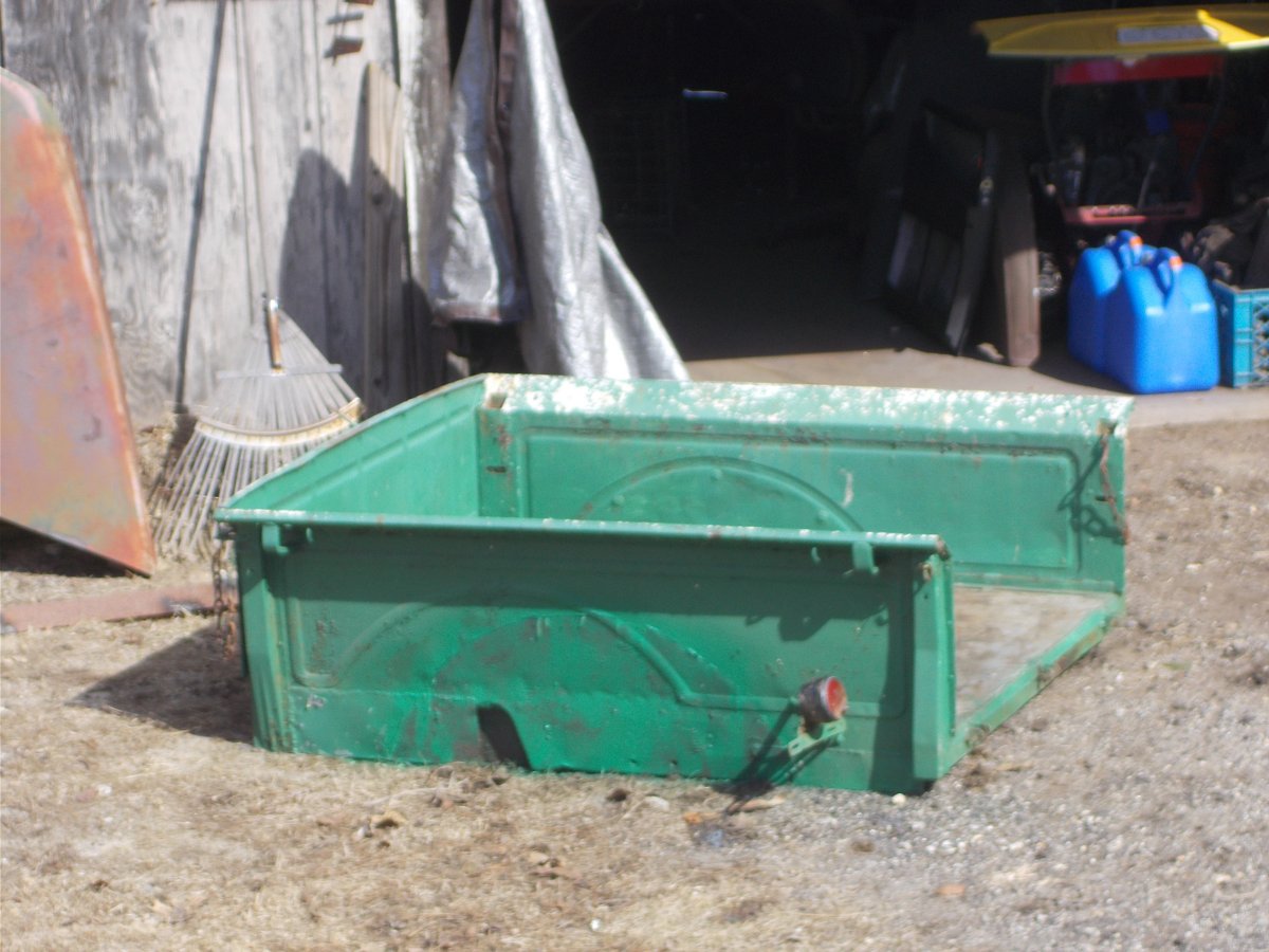

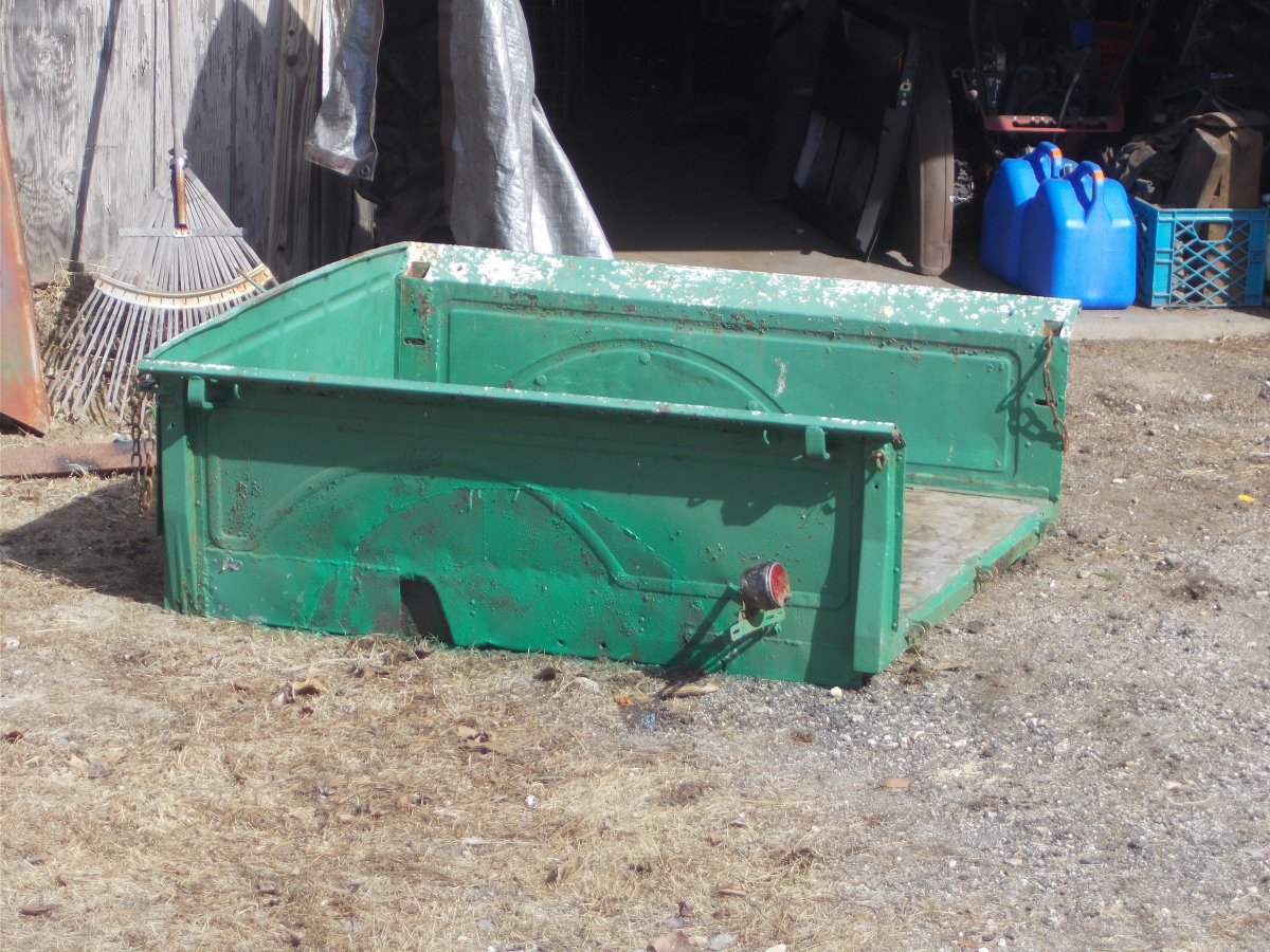

    stripped the '31 wide bed … bed dumps... note the 4 hinges along the bottom of the headboard... tailgate on each end ?
    before ;
    after ;
    shame... too rare of a bed to weld into a trailer... oh, well.
  13. Loving your work mate. Its coming together nicely. Is that an I beam and transverse spring chucked under that trailer? Was really put together from somebodys parts bin wasnt it!
    Cheers,
    Josh
  14. sloppy jalopies
    Posts: 5,256
    sloppy jalopies
    It is a '36 front suspension, crossmember and frame rails..
    wishbones and the tie-rod cut , the ends bent in and welded to the axle...
    the thing was well thought out... builder had fab skills... wish he hadn't made the headboard tip down like another tailgate...otherwise ?
  15. On the up side at least you can recycle it. Probably would have been s**** if never turned into a trailer! With your skills Im sure you will have that head board looking the part in no time.
    Cheers,
    Josh

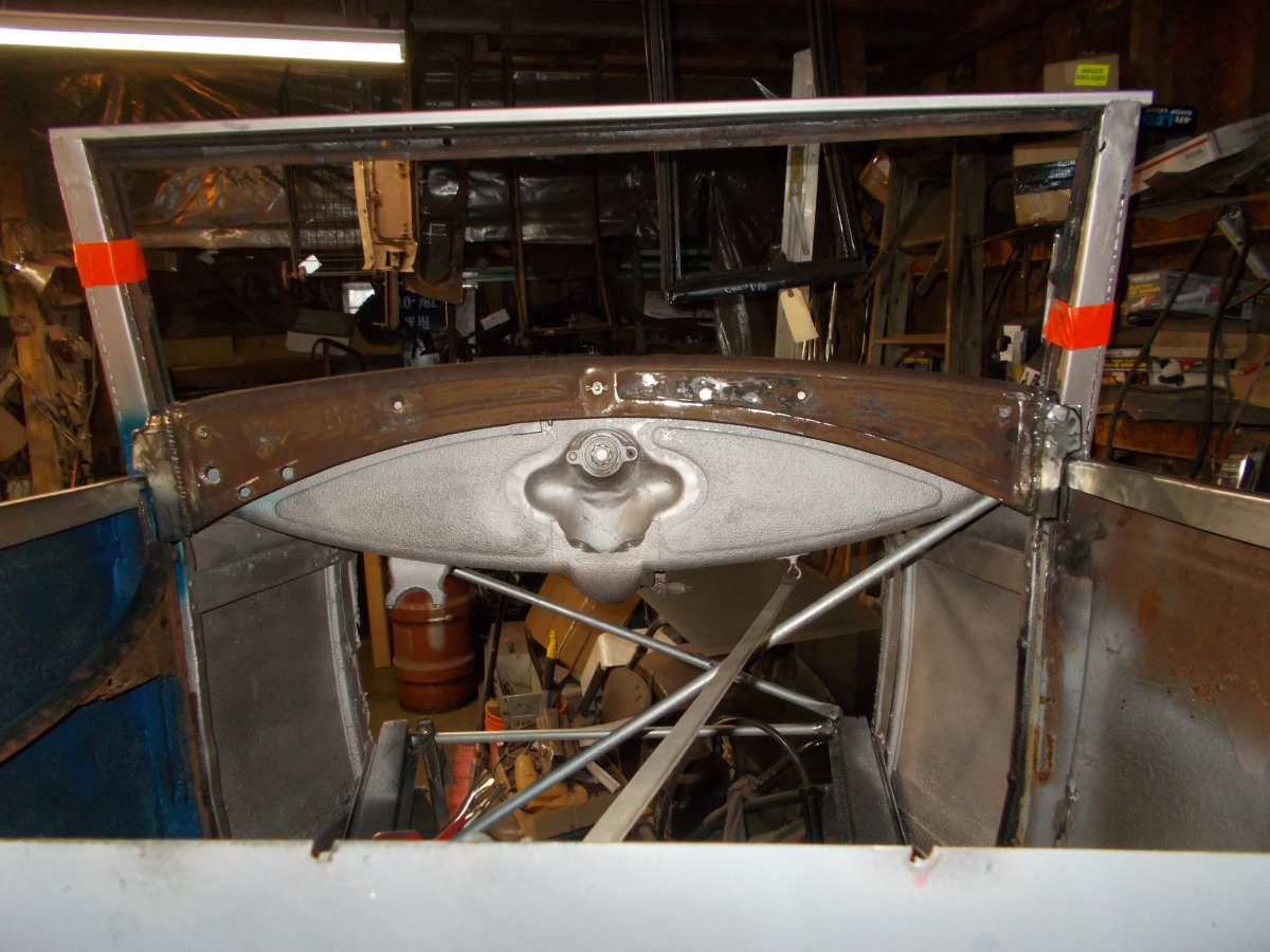

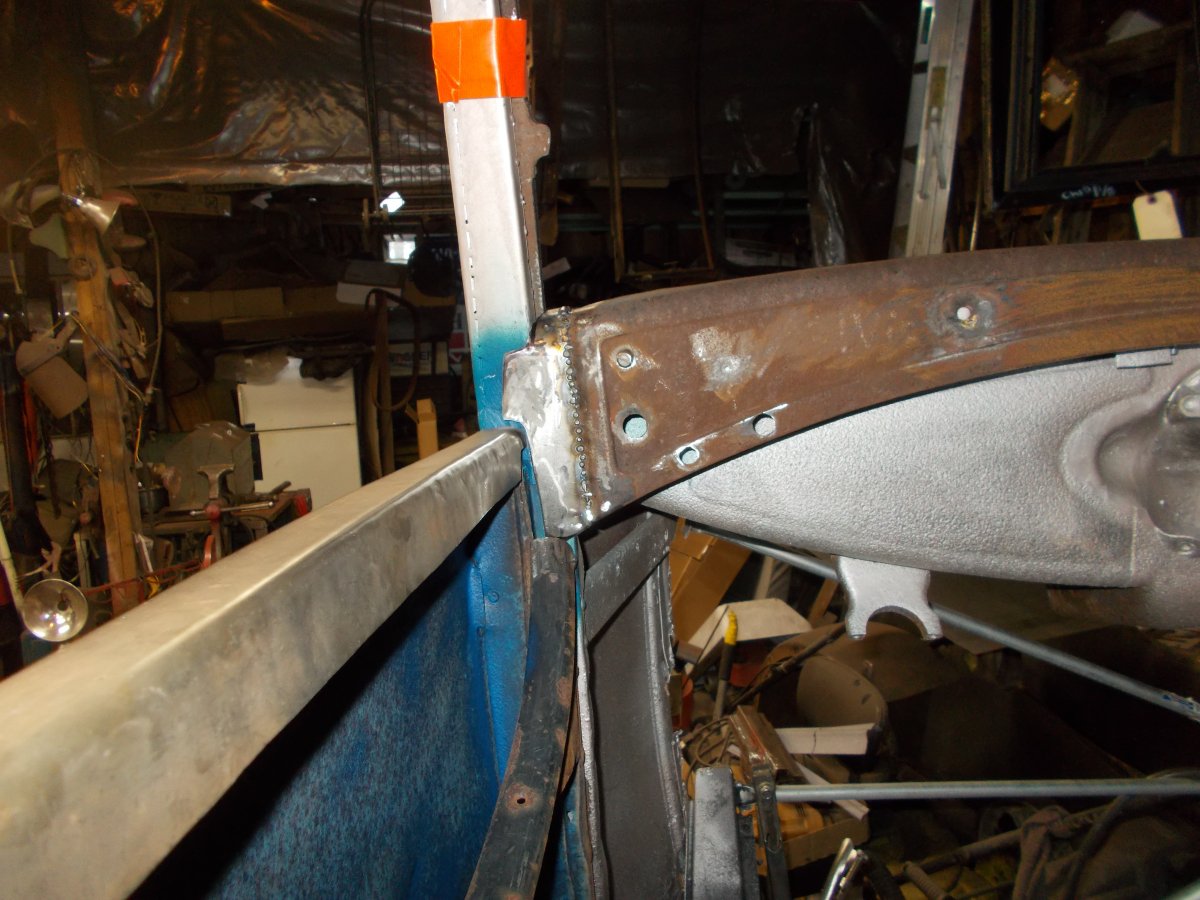

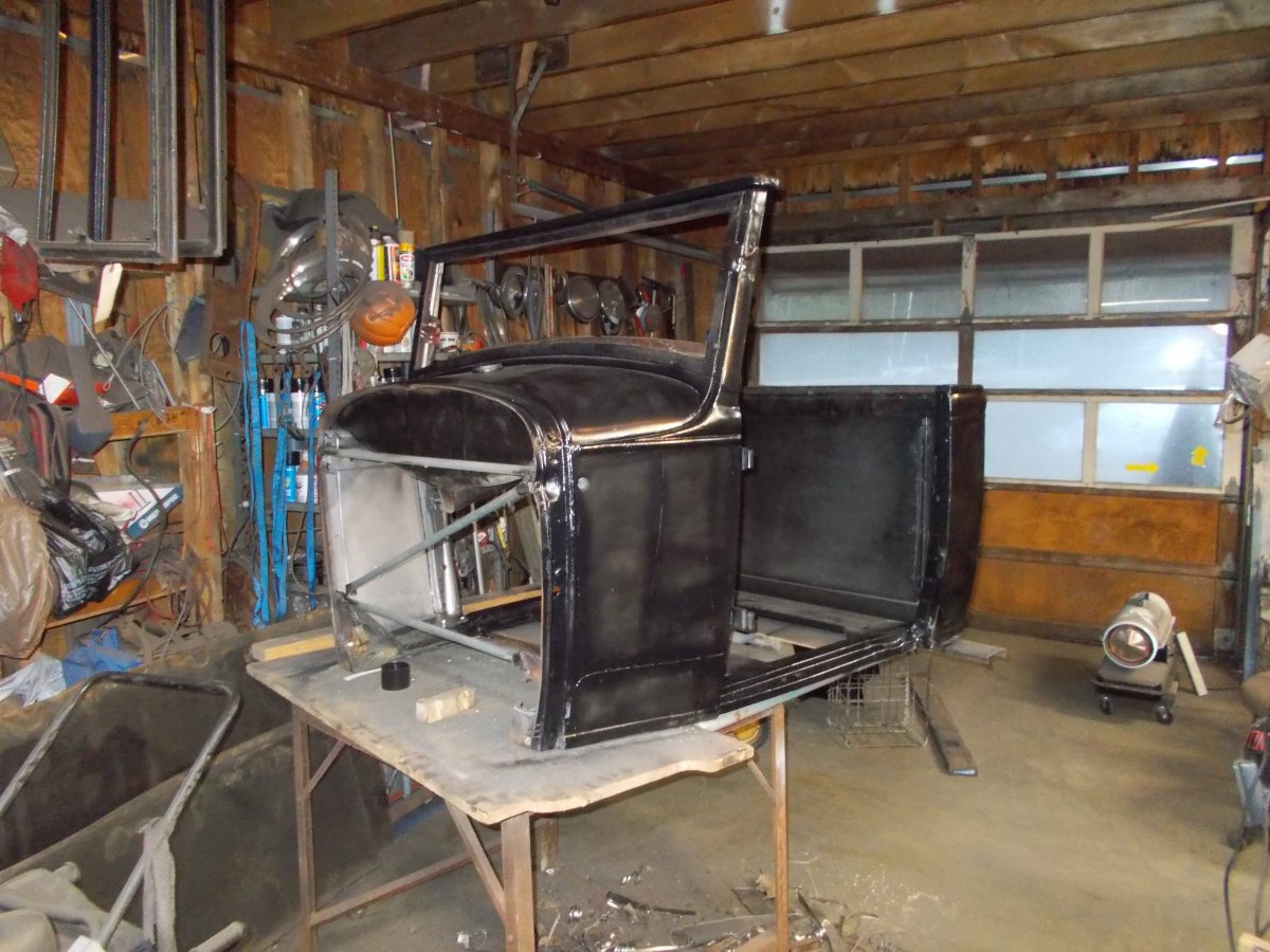

    Separated the cowl from subfloor, flipped the cab onto its back, welded and ground any unwelded joints under the subfloor...
    filled a hole at the inside edge of the RT. side dash bar to A pillar...
    drilled and tapped a couple 1/4" x 20 holes in the dashbar to help mount the Vicky dash board...
    [mounting holes don't line up with those on a '30-'31 closed car cowl]…
    wood screwed the cowl's wooden mounting blocks under the subfloor so they stay aligned...

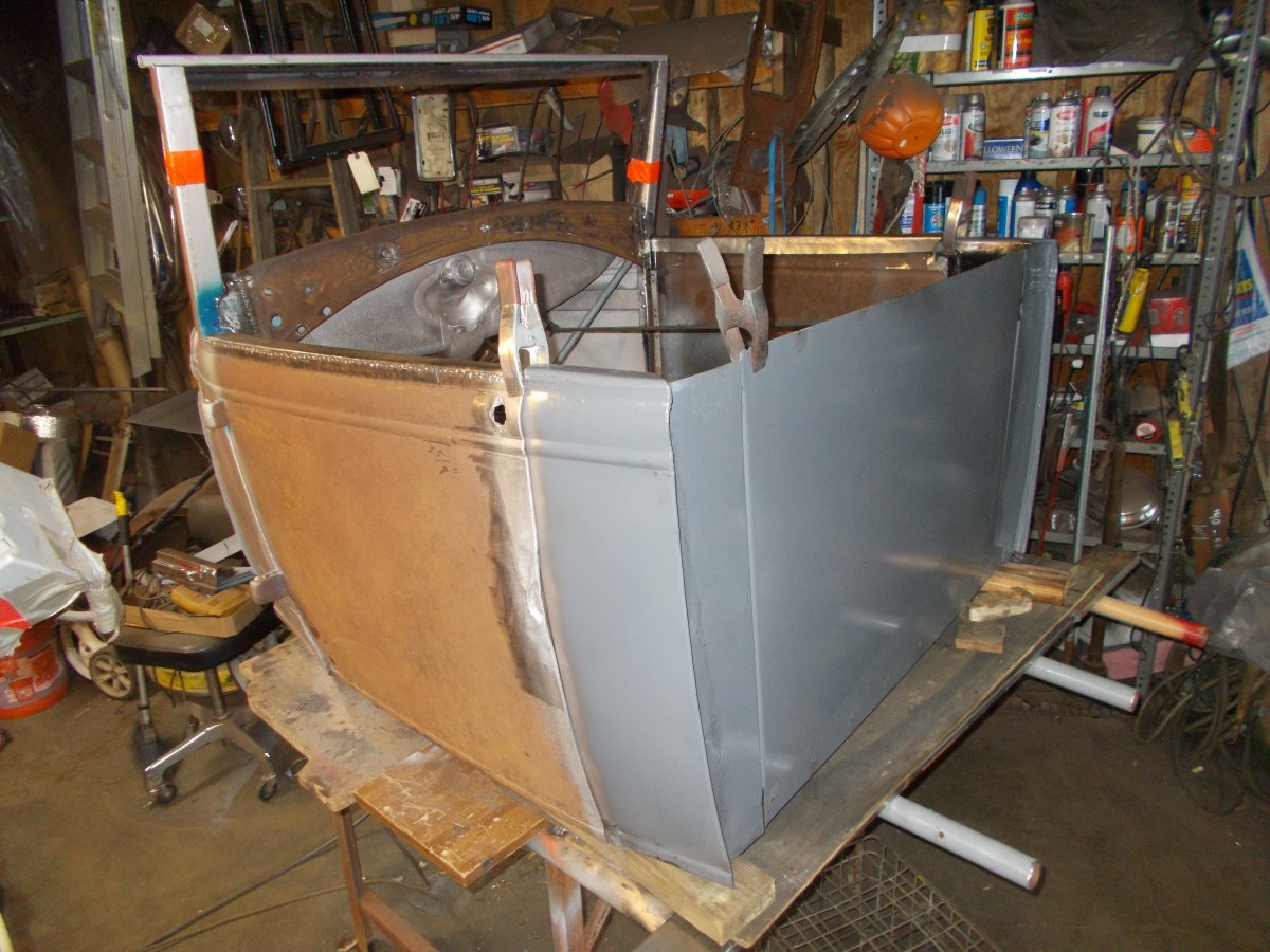

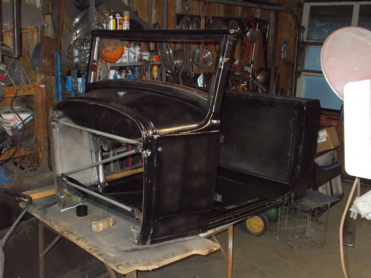

    A few more tackwelds, little grinding and cheapo spraybomb…
    starting to wonder if there will be an early May swapmeet ? DSCN5667.JPG DSCN5657.JPG DSCN5655.JPG DSCN5663.JPG

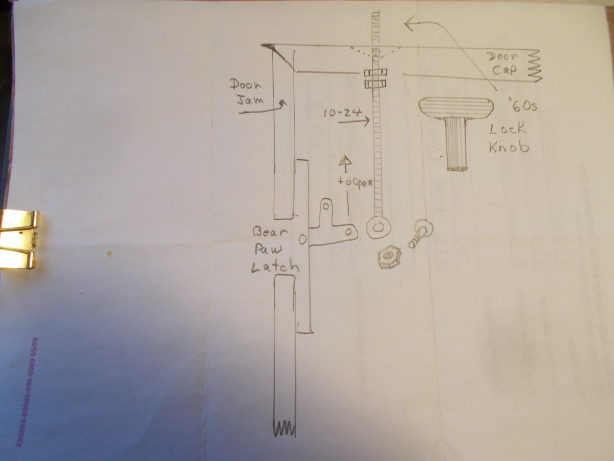

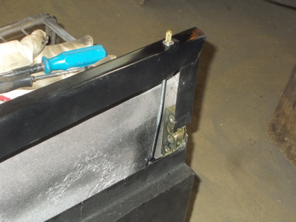

    Drilled the hole for the "opener" in the door "cap"...
    Stepped it up to 3/8", measured how long the linkage needed to be...
    Welded a flat washer to the end of the 8.25" threaded rod, sanded it and removed the knob and small flat washer from the linkage...
    Depressed the spring, slide the 10-24 rod up through the hole in the cap...
    Dropped the washer on the exposed 10-24 rod, threaded the knob back on...
    Used a 1/4"x 20 lock nut, flat washer and bolt to anchor the linkage to the Bear Paw latch release...
    Screwed the inner panels on the doors...
    Friggin' thing works great ! … love it when that happens...
    Now I have to plot, drill and install the large Bear Paw latch pin...
    DSCN5671.JPG DSCN5673.JPG DSCN5674.JPG DSCN5675.JPG View attachment 4614405

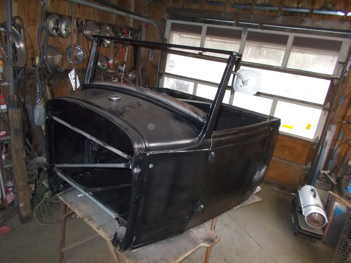

  22. sloppy jalopies
    Posts: 5,256
    sloppy jalopies

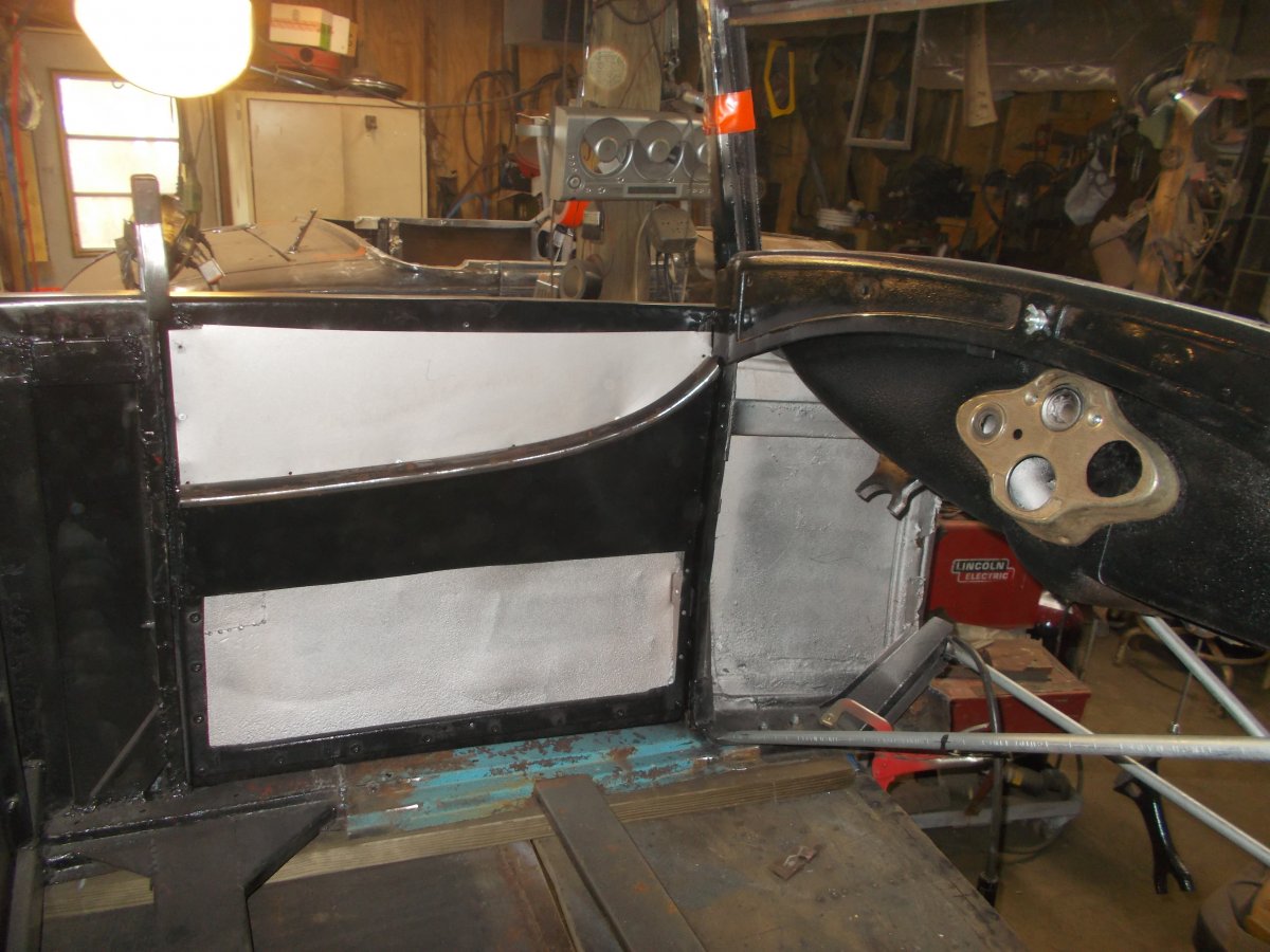

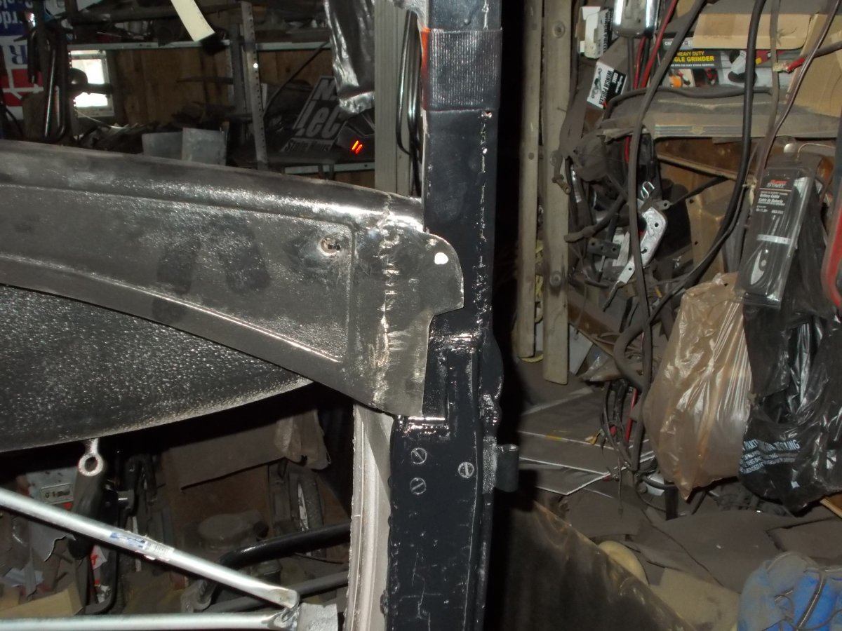

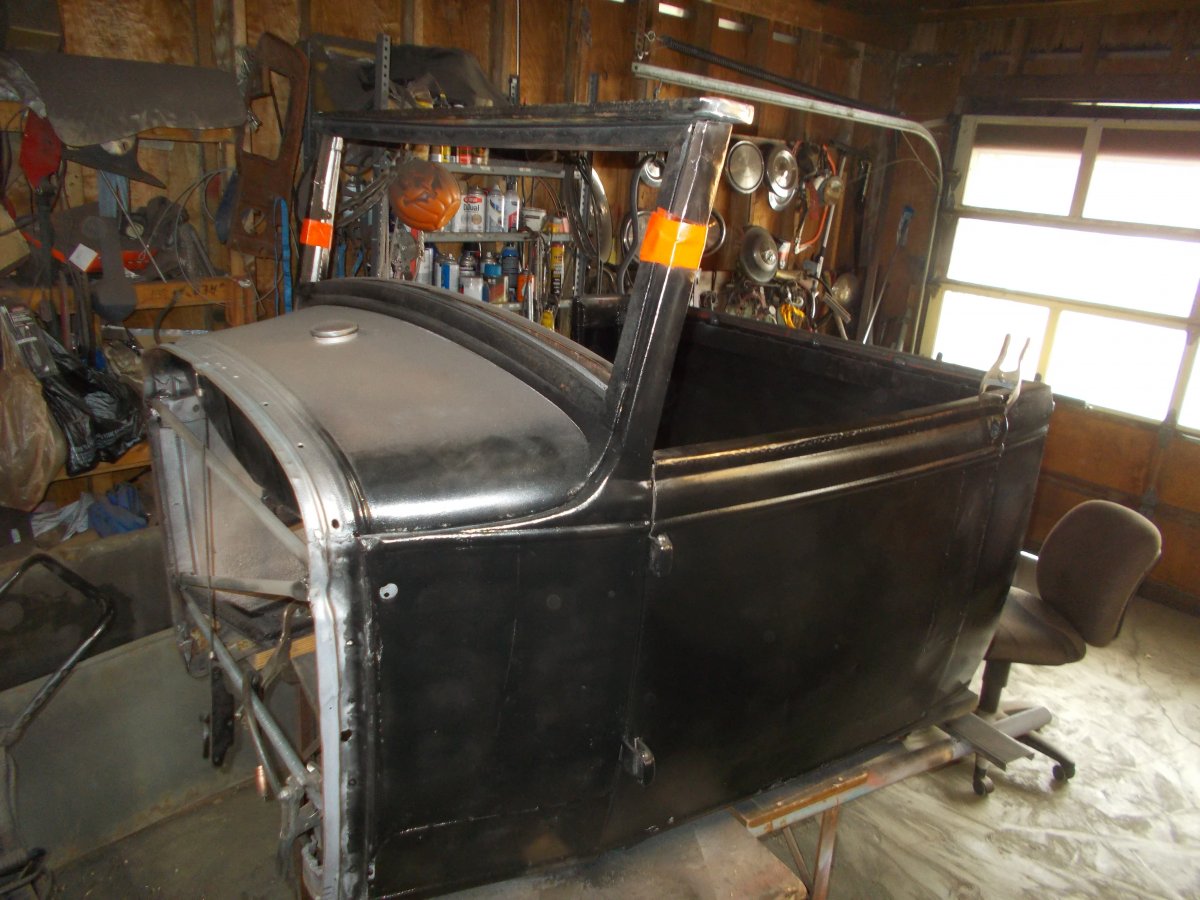

    Bear Paw latch pins installed... swinging and latching doors...
    chopped the windshield frame... clamped in...

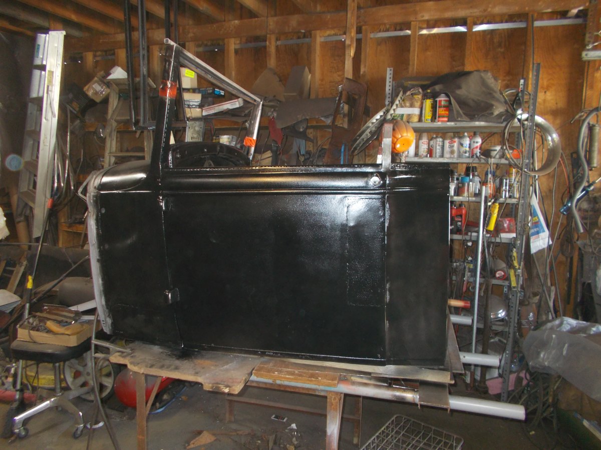

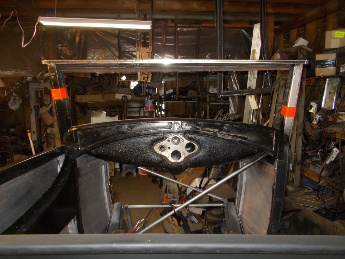

  25. sloppy jalopies
    Posts: 5,256
    sloppy jalopies

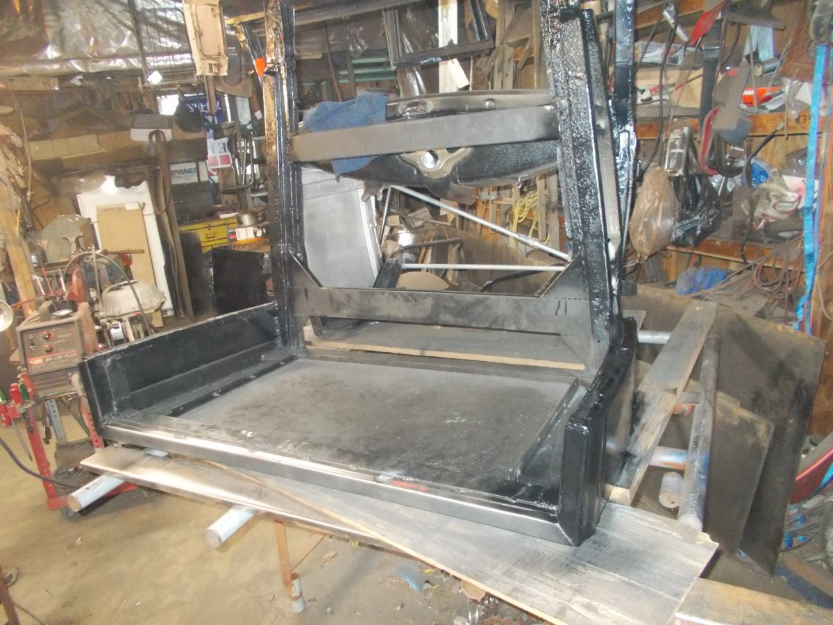

    Flattened and put 90* bends on each end of a 38" piece of 1/2" conduit to form a brace from the center dash screw hole to a hole drilled and tapped in the upper rear cab rail to re-enforce the cab for transport... will carry it 25 feet to a pallet outside, near the garage door...
    . quick coat of cheapo black..

  26. sloppy jalopies
    Posts: 5,256
    sloppy jalopies

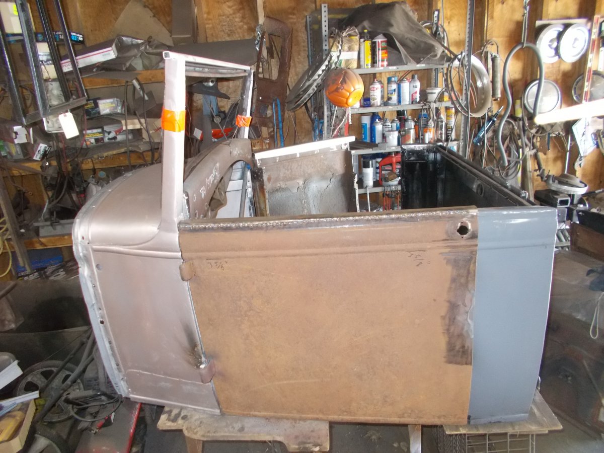

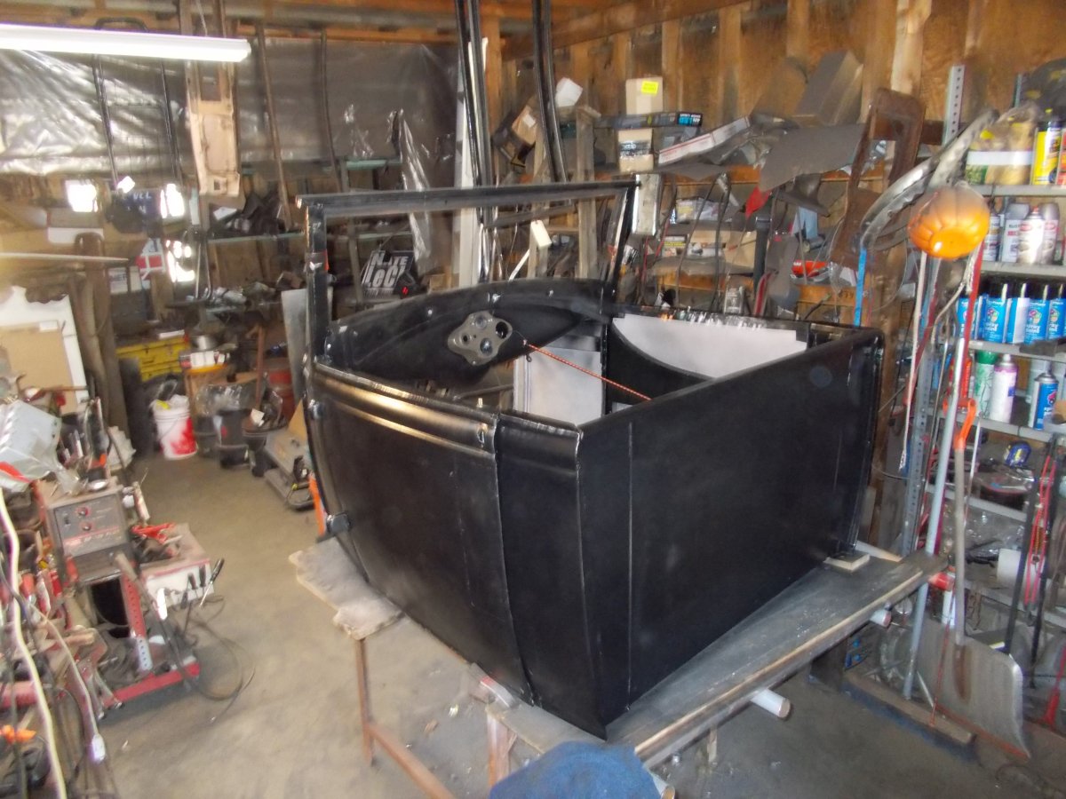

    Swap-meet Sally... if we have one ?

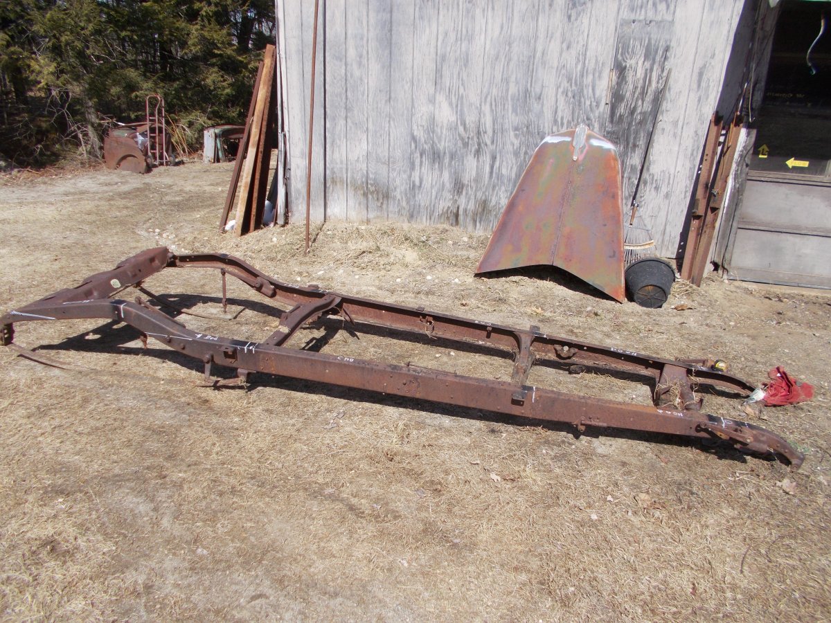

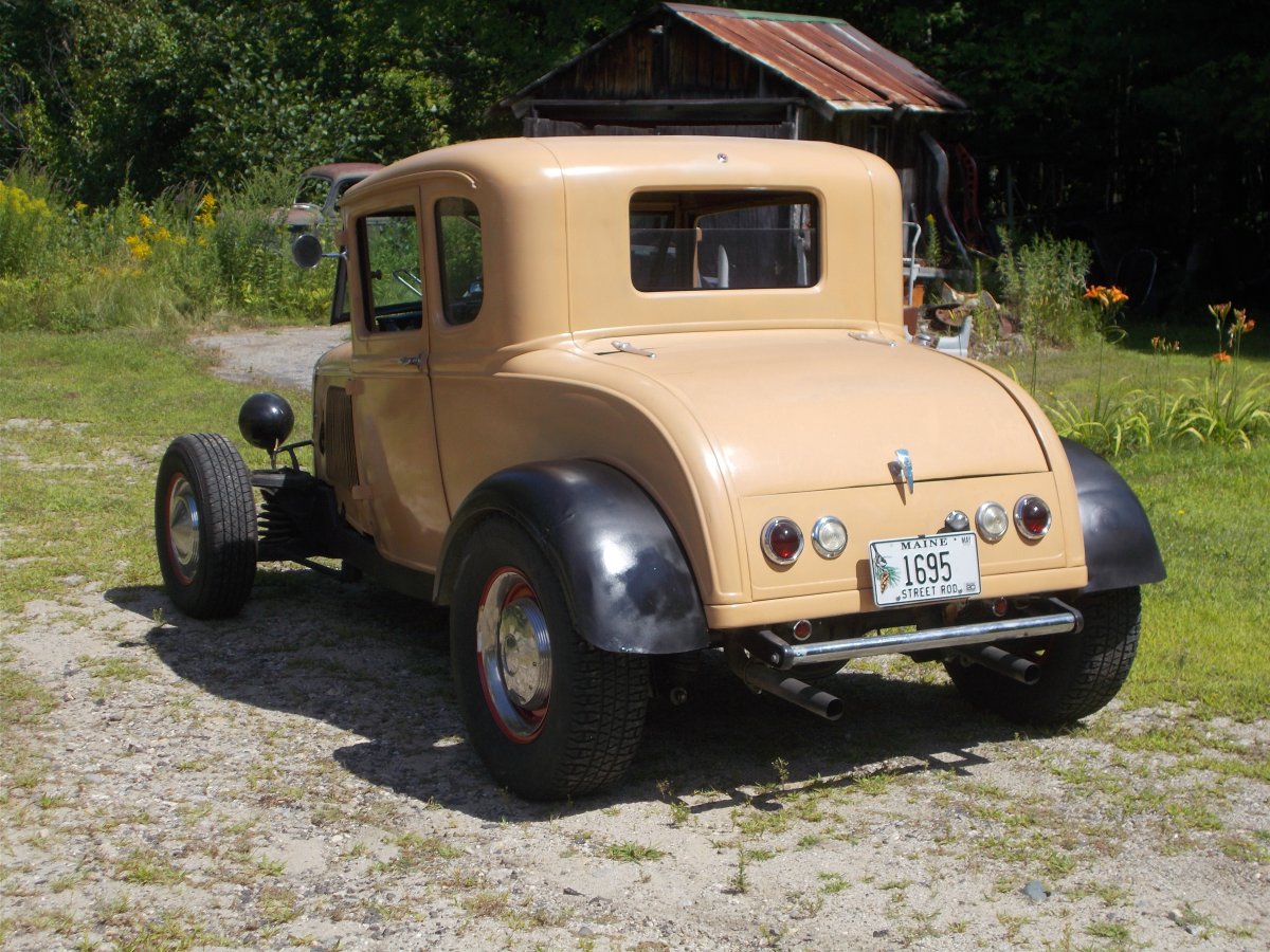

    Had a pair of 3' long A frame rails... going to use the front 15" of them flipped upside down and welded to the chebby frame's rear end... they will flow down and then curl up to about level... spreader bar between them... they will extend the frame 3" beyond the tailgate to give a little protection...
    pic of the same set up under my coupe...

    model A frame rail cut offs.. will be welded on upside down to extend the '29 chebby frame rails about 15"...
    will mount the spreader bar behind the bed...

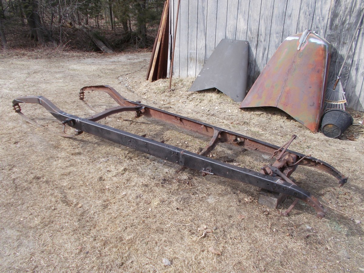

  29. sliceddeuce
    Joined: Aug 15, 2017
    Posts: 2,981
    sliceddeuce
    Looks like fun.
  30. sloppy jalopies
    Posts: 5,256
    sloppy jalopies

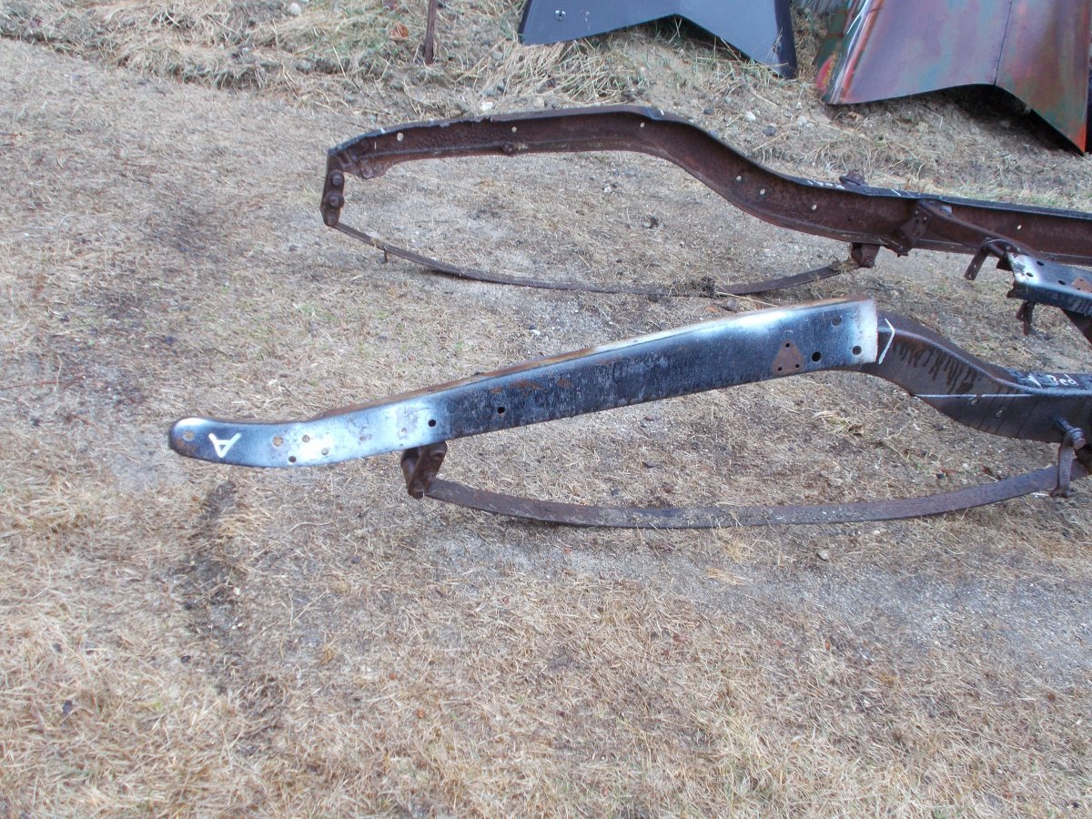

    Seems I have stumbled onto a decent model A frame, for the truck...[ '29 chebby goes back out back]...
    he is a recently retired Ford mechanic who also has a good running Ford OHV 4 cylinder, for the coupester..
    now to find a complete "automatic" ****** set up from a baby Ranger or Aerostar van... joe brown bought the half rails...
