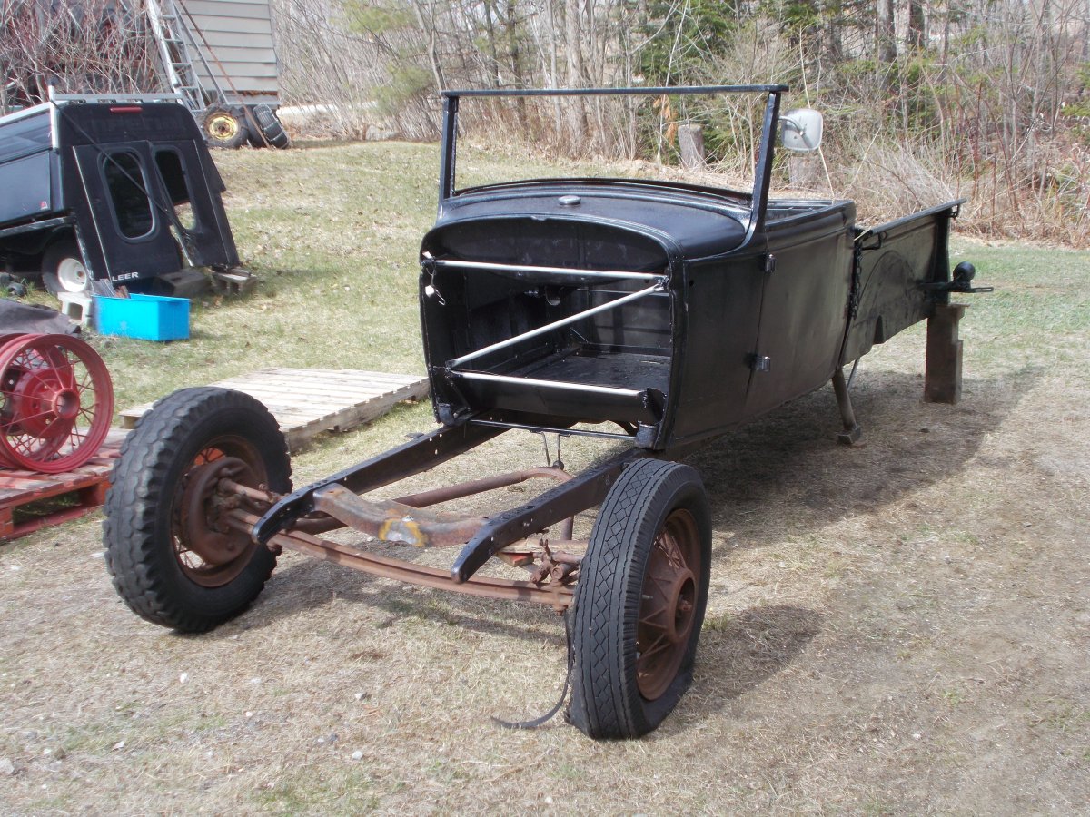

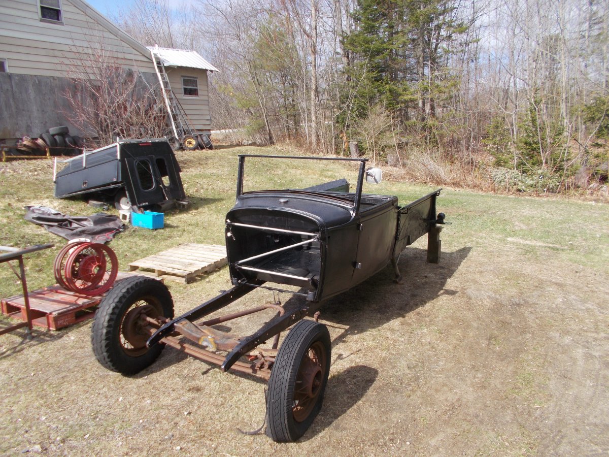

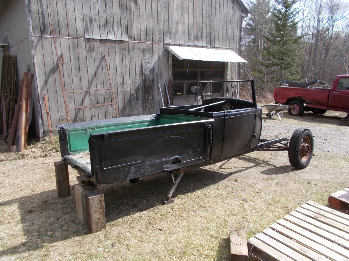

    Only cost me $10 but the pick up is on the frame...
    add a grill, lites and a hoodtop and she is for sale...
    . DSCN6100.JPG DSCN6101.JPG DSCN6103.JPG DSCN6107.JPG DSCN6108.JPG DSCN6109.JPG
