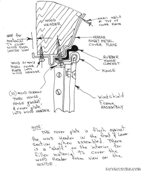

    I just installed a new wood header in my 30 tudor. I put the metal header cap on and am getting ready to install the windshield frame. I noticed though the the holes in the header cap don't fully cover the wood header the header doesn't extend over the full hole. is this a common issue? Do you install the frame hinge screws on an angle into the header? Thanks Chris.

    Here is a picture someone posted on here, don't remember who so forgive me.
    But hopefully it will answer your question, I used it when I put my header in...

    I actually have that saved also, it looks like the screws point rearward. Was this the same for you?

    @novaskilling yes, I followed the above pic.
    I had found other actual pics and the installation was the same. It worked out well!
