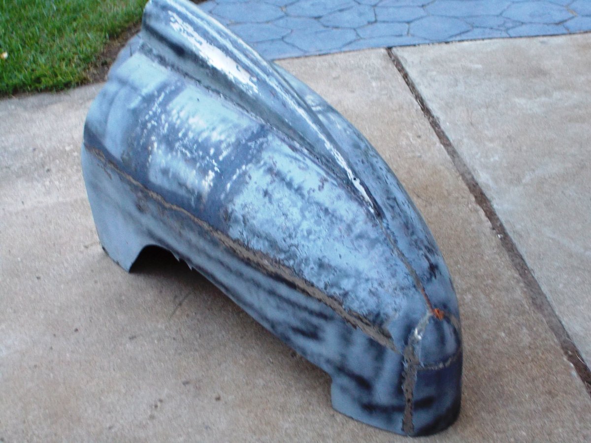

    EDIT 7/8/17: I loaded new pics (not off photobucket - I'll try to edit previous posts soon)
    Buck headrest 24.jpg The headrest is "nailed down".
    I made a little 2-wheel dolly to move big body sections around.

    Buck headrest 26.jpg Buck headrest 27.jpg Before welding, I used a Dremel grinder with a cutoff wheel to cut a .035" root opening between the pieces of metal. I joined them together in a similar fashion to the two headrest halves, previously discussed.

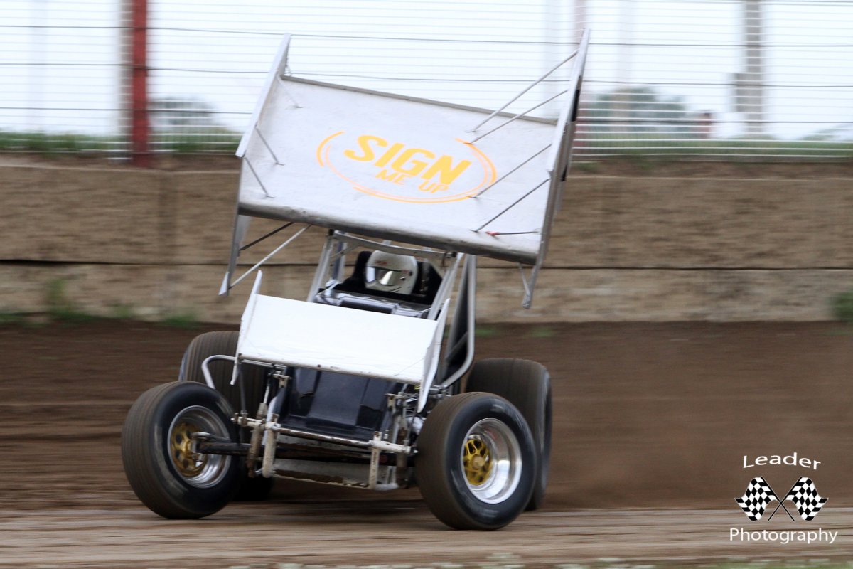

    Can't believe I lost track of this thread! This is what I meant by steering angle. IRA-Sprint-Car-Racing-Action.jpg

    Amazing... only an oval racer can figure out how to get the entire car to lean into a turn at opposite lock! Gary

    Aerodynamics my friend. Yours would lean that hard too, if you had sideboards that big on top of it. ;-)

    OK, forgive my ignorance, I'm still trying to put my finger on what you mean by steering angle because the photo you posted shows examples of many angles involved in getting that car around a curve:
    The body/ch***is is rolled axially to the inside of the turn. I guess that is what CoolHand is referring to when he speaks of the effect the big wing has.
    The side slip angle of the tires vis-a-vis the track surface (what kids today might call "drift" angle) is also quite apparent.
    The angle that the front wheels are clocked.
    or
    The caster angle on the front kingpins. What I originally thought you are referring to.
    I'm not trying to be contrarian here. I just want to know more about these machines so I don't make some kind of avoidable mistake. Which angle did you originally ask about?
    Thanks for posting that picture ThirdDodgeBrother. I studied it and am learning from it.

    P.S., I know I am usually a "form follows function" guy and I see better because of that pic how the wing is shaped to help the car both corner better AND stay glued down on the straights - but to me those wings are just plain ugly.

    From a technical standpoint, "steering angle" is the measure of how far the face of the front hubs deviate from the long axis of the ch***is, usually measured in degrees.
    In that pic above, that sprinter has got 50°+ of steering angle to the right, which is very likely full right lock on the box.
    I don't know if that's what the guy who originally posted the words meant, but that's the technical definition (more or less).
    Modern dirt racing cars (modifieds, late models, sprints, midgets, etc) are all so ugly that they're beautiful, at least to anyone who's driven one. Kind of like a face only a mother could love, they're beasts only a driver could love. ;)

    Sorry for the confusion. I meant to include this image to make my point. sr_040.jpg sr_040.jpg
    I don't know if you've had a chance to drive on a snow-packed country road, or slide a motorcycle around a flat track, or do long donuts in an icy high school parking lot, but that's some of the most fun you can have with a car. What the sprint is doing is called "backing it in." Steering is reversed, the whole car is hanging on the throttle and that big right rear. One of the best feelings you can have. The worst is to run out of throttle or steering lock and back your puppy's hand formed tail into the wall!

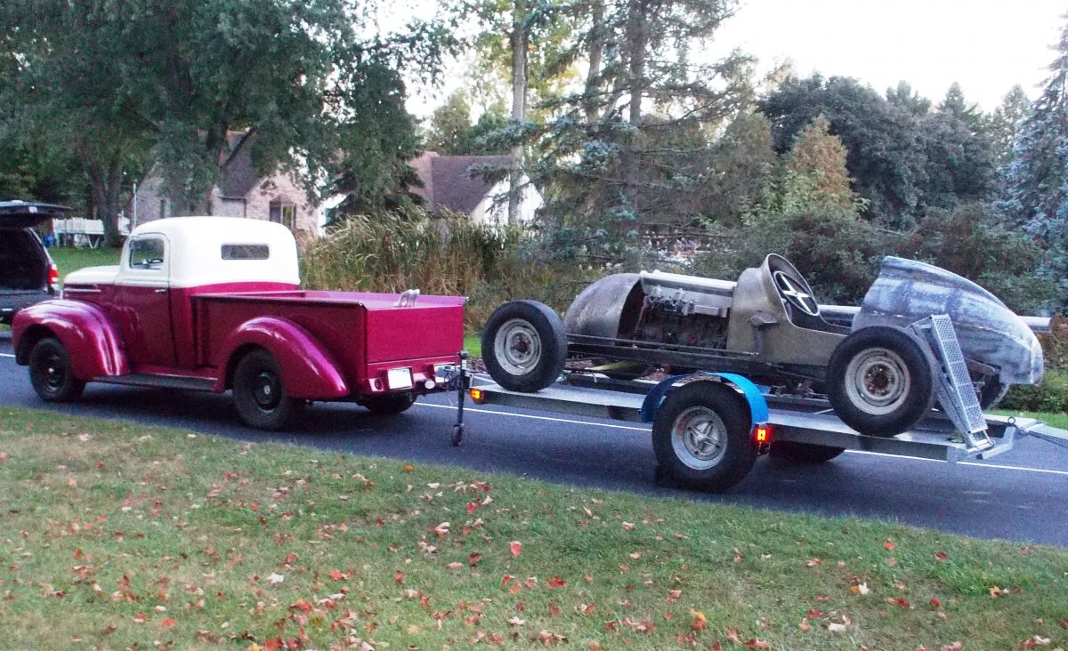

    sr_071.jpg sr_072.jpg The champ car came back to my home shop today, reunited with the '46 Ford push / tow truck and its own trailer. This build has been going on a long time, but the truck and trailer got finished in the mean time so I suppose that signifies some progress of sorts.

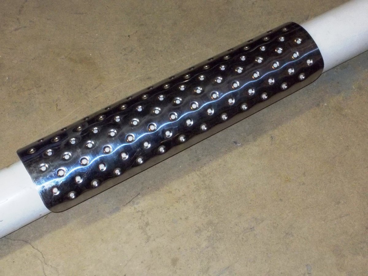

    sr_073.jpg sr_074.jpg sr_075.jpg In these old replicas there are a lot of little "visual delights" that can make a car interesting to see. I thought I would make one of those little visually appealing details today. A heat shield for the exhaust pipe. First I cut a blank of sheet stainless, laid out some cooling holes and rolled a curve in it. Then I made a small belling tool for my DiAcro press so I could put a bell mouth on the holes. This is needed to prevent the shield from becoming a cheese grater on my body parts should I come into contact with it during an upset. I just need to make some stand-off nuts to weld it in place when the time comes.
