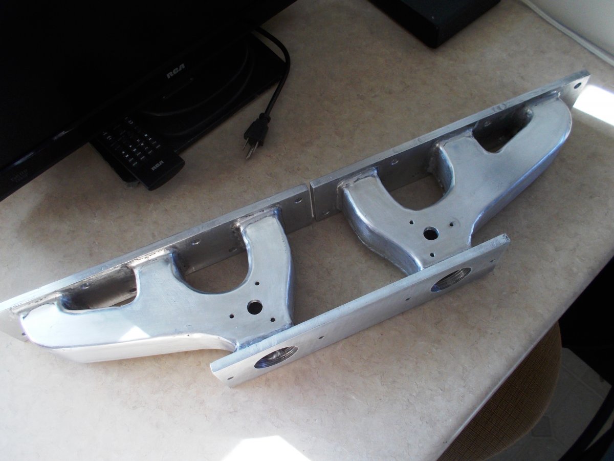

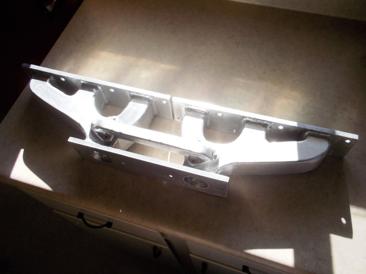

    I did a little more clean up on my intake manifold, first smoothing it with abrasive tootsie rolls in a die grinder then smoothing it out a little with some abrasive compound. I ground down the welds on the flange but lest some get concerned that it will weaken it no worries - I welded them on the inside of the runners too.
    Truth be told I have a bunch of parts that need attaching to the ch***is and lots of finish welding to do, but I am putting it off until I can re-wire my garage for more ampacity. My new (to me) Miller TIG machine has been tripping the breaker when I try to weld aluminum on higher amp settings. I've put up with it for long enough. sr_048_3.jpg sr_048_4.jpg

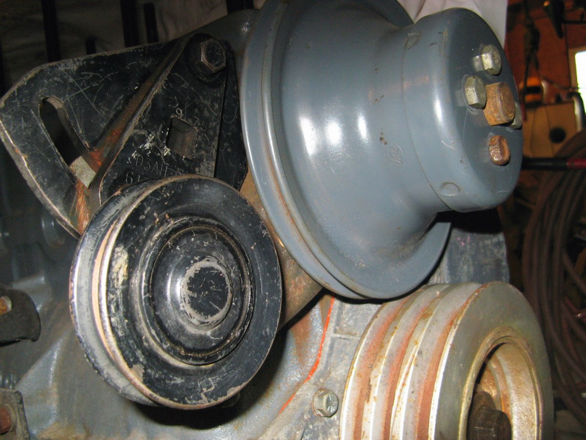

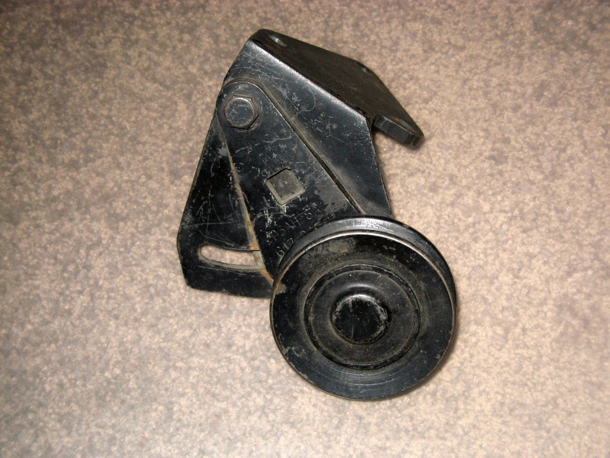

    A couple more details for the engine test stand.
    The water pump needed an idler for the belt. I built this so I can eliminate the alternator / charging system. The dyno stand is self powered. If you would like to build a similar idler try using a '73 Ford idler ***embly part # D3AH-8S617-BA. It will allow you to adjust the belt tension.

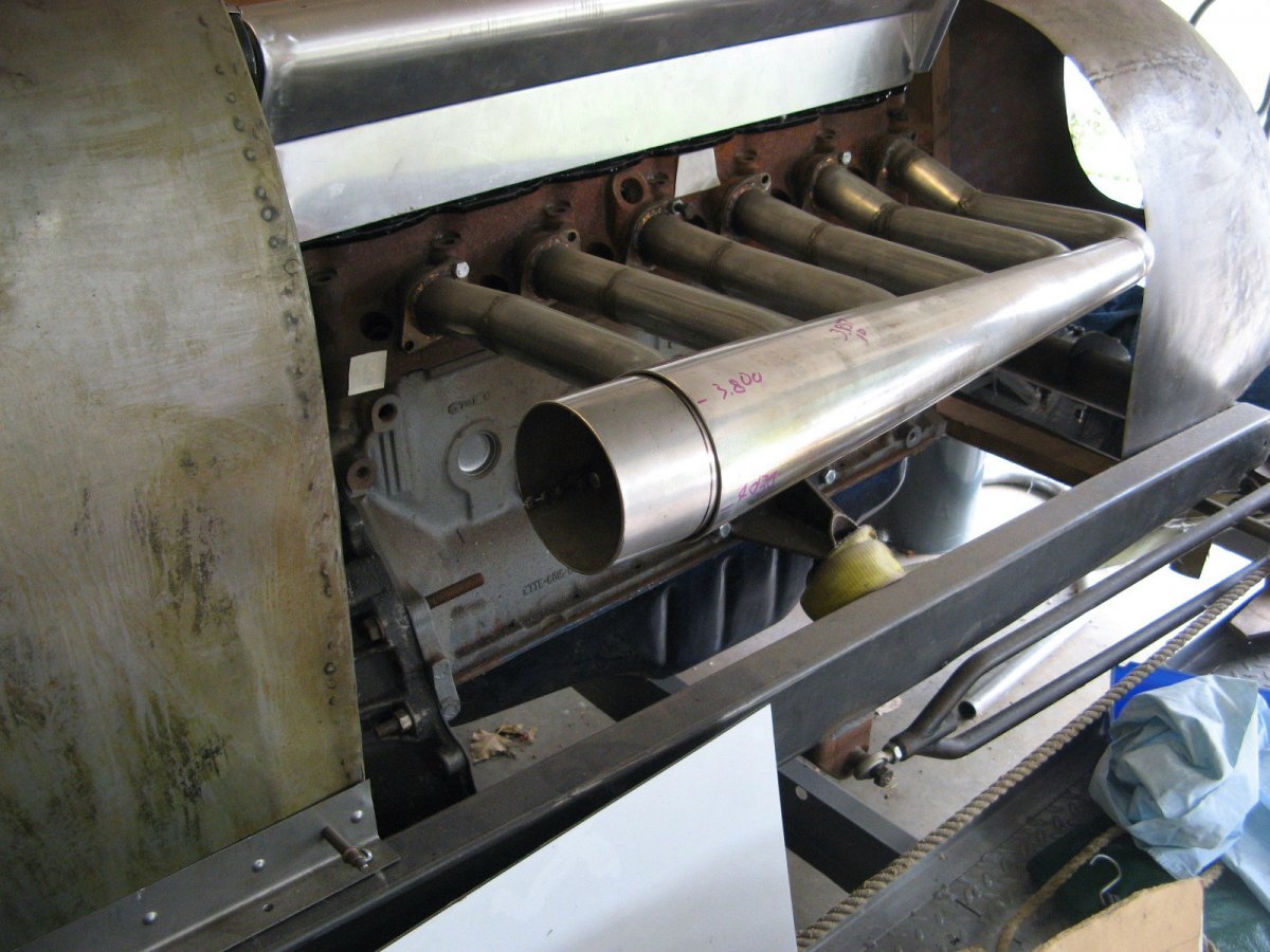

    Another item that was needed was a male outlet sleeve off the end of the header. That will mate up to the tail pipe or in this case a shop exhaust system.
