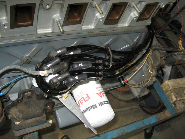

    A 240 Load-a-matic distributor fits under the twin SU intake manifold. The wires will be routed around the rear of engine, up under the headers. I have two of these - one with an iron gear for flat tappet cams and one with a bronze gear for roller cams.
    On the other side I found some vintage right angle phenolic plug terminals that will allow me to route the wires under the headers. Note the high placement of the exhaust ports off the deck surface.
    I have this thing for casting flash. It bothers me and I grind it off where I can, like this t-stat housing. Also, I like to resurface the sealing surfaces and note the STO temp on the housing.

    What's the long piece of metal attached to the distributor? Looks like a hole in the end maybe for a mechanical advance and retard?
    On my cobrajet I made one from and old lawnmower throttle control. Spaced the distributor hold down clamp out so the distributor would rotate freely but stay in the block. Had the throttle cable on my shifter and when hitting high gear moved the throttle lever pulling the distributor into less advance.

    Yes Loudbang, it is to play with the spark advance from the control console position while the engine is running. The load-a-matic distributor had no centrifugal advance - just vacuum advance. I locked out the vacuum advance and will manually advance the spark if necessary by a piece of welding wire thru the hole on the end..

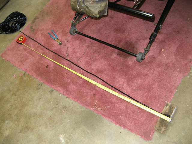

    Today I made spark plug wires. I used just a little less than a quarter mile of wire. Maybe I'll advance the timing a few more degrees because the spark has such a long way to travel.

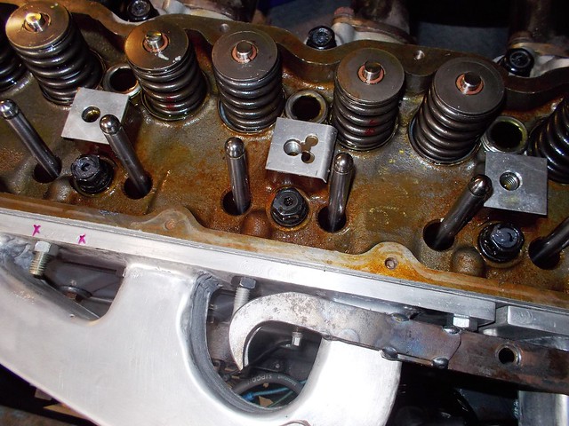

    One of the intake valves is hanging open a little. I checked collapsed tappet gaps and that valve had none, so I may shim the rocker stands for more hydraulic tappet clearance. But it sounds like it is going to be a strong runner. We'll see.

    I also made a collapsed tappet checker and found out the #4 intake valve was hanging open. So today I made up a set of rocker shaft pedestal stand shims to raise up the rocker shaft slightly.
