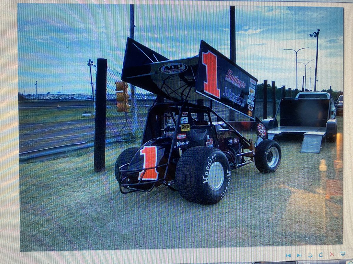

    1966BB24-F1F6-4069-81BC-2079BCD6FEB0.jpeg I like the #4 on our car. We have used 1,77,6,4,2 and several others

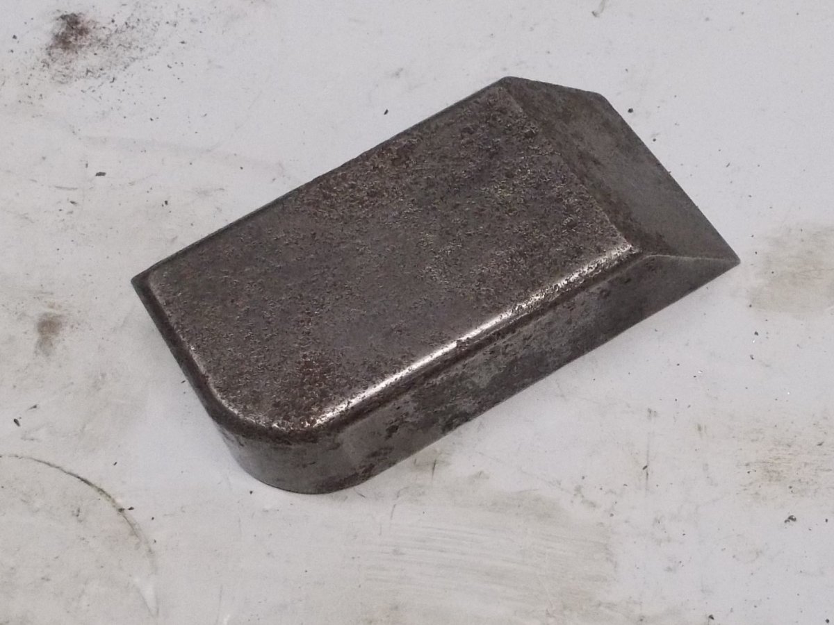

    Since my last post I have done literally tens of thousands of hammer tappa tappas on the tail. At first I did not think the basic shape was going to "come in" but after much hammering and some slapper and shrinking disc (thanks for the idea mgtstumpy!) I have it to the point where I will not need a hogshead of Bondo to get a smooth skin.

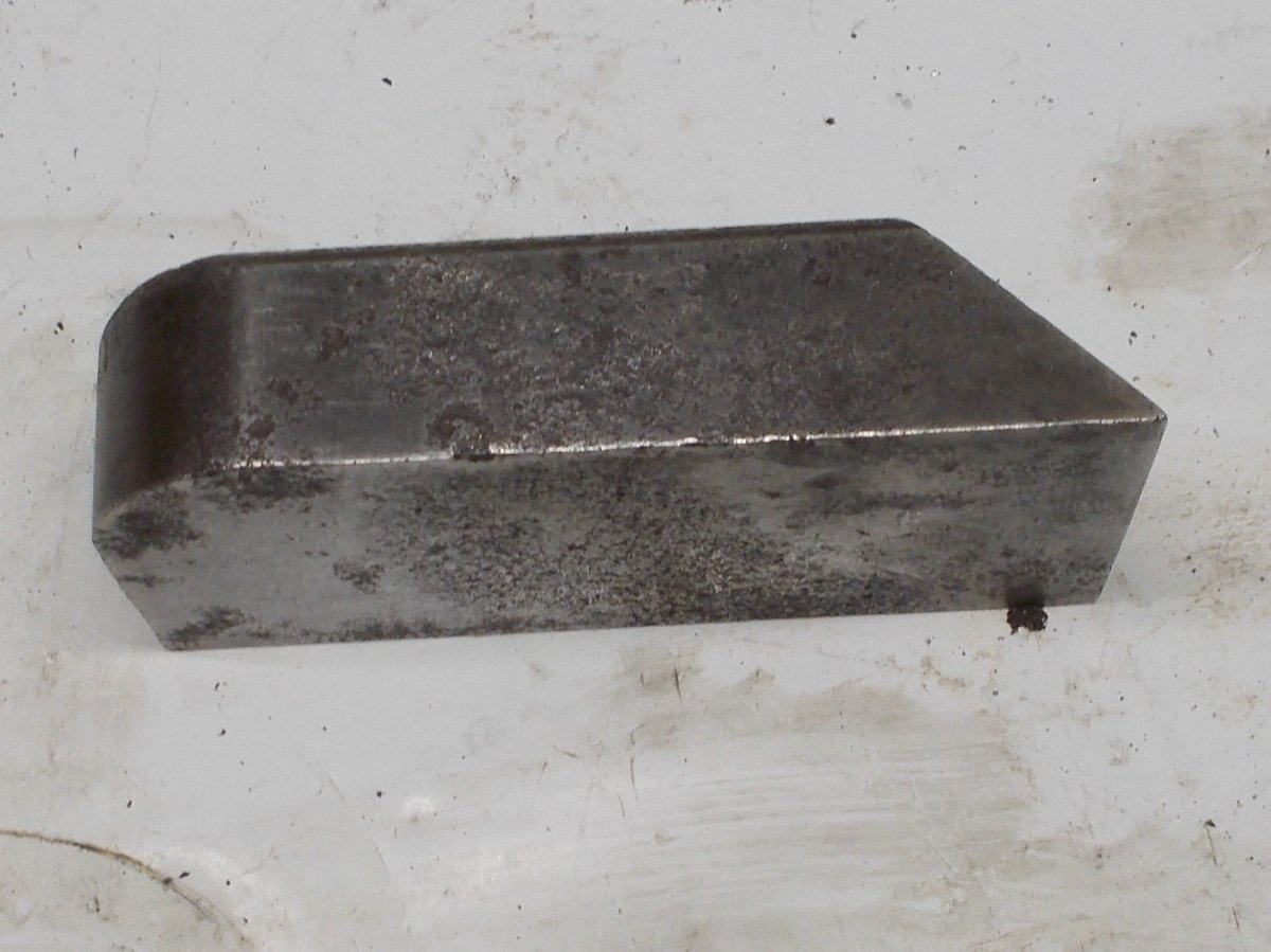

    I do have a show-n-tell item for today. I made a dolly from an end cap for a welded stainless steel 3" pipe. It is schedule 40S - .216" wall thickness - so it will take a lot of abuse. I turned down a flanged wooden plug and pressed it into the back side for use on a bench top if need be. It is easy to hold with the wooden plug.
    The other wedge dolly is one I fished out of the local community college dumpster at years end. It is a marvelous shape - useful for tipping flanges and other forming tasks. That one and this new end cap dome dolly are becoming my "go to" dollies for lots of jobs.
    I need to get some weld-thru primer so I can join the mounting flanges to the tail section and minimize the risk of rust between the two. Dolly 1.JPG Dolly 2.JPG Dolly 3.JPG
