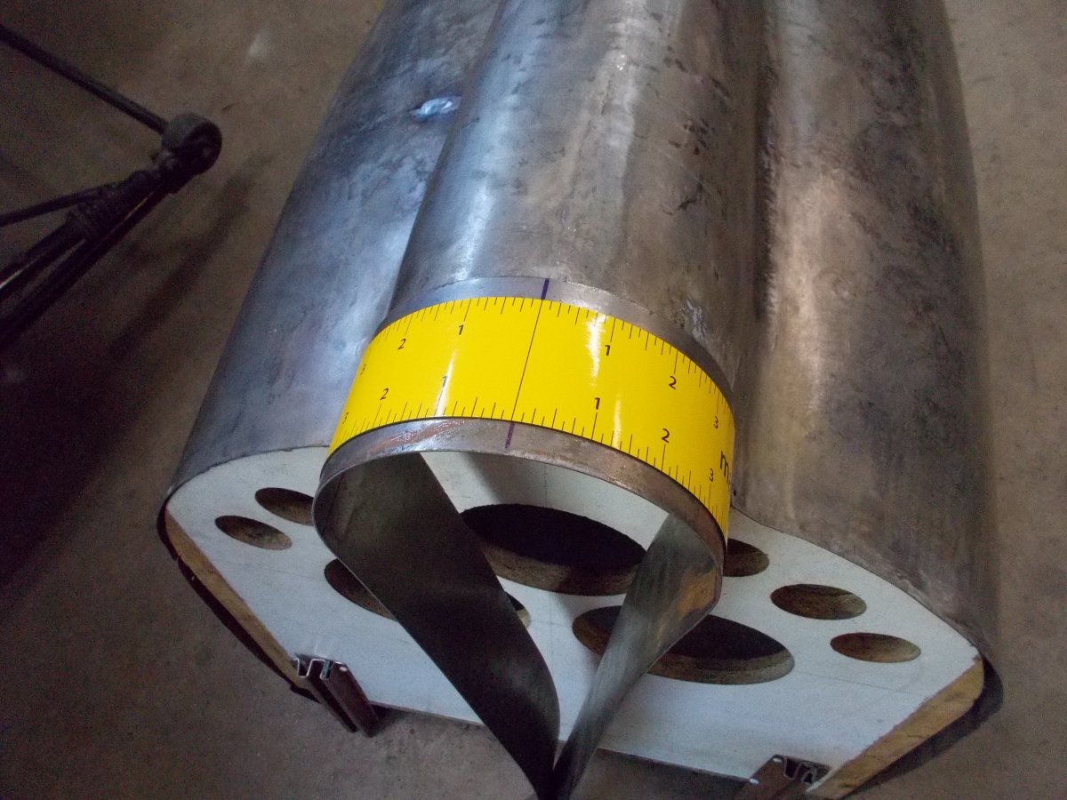

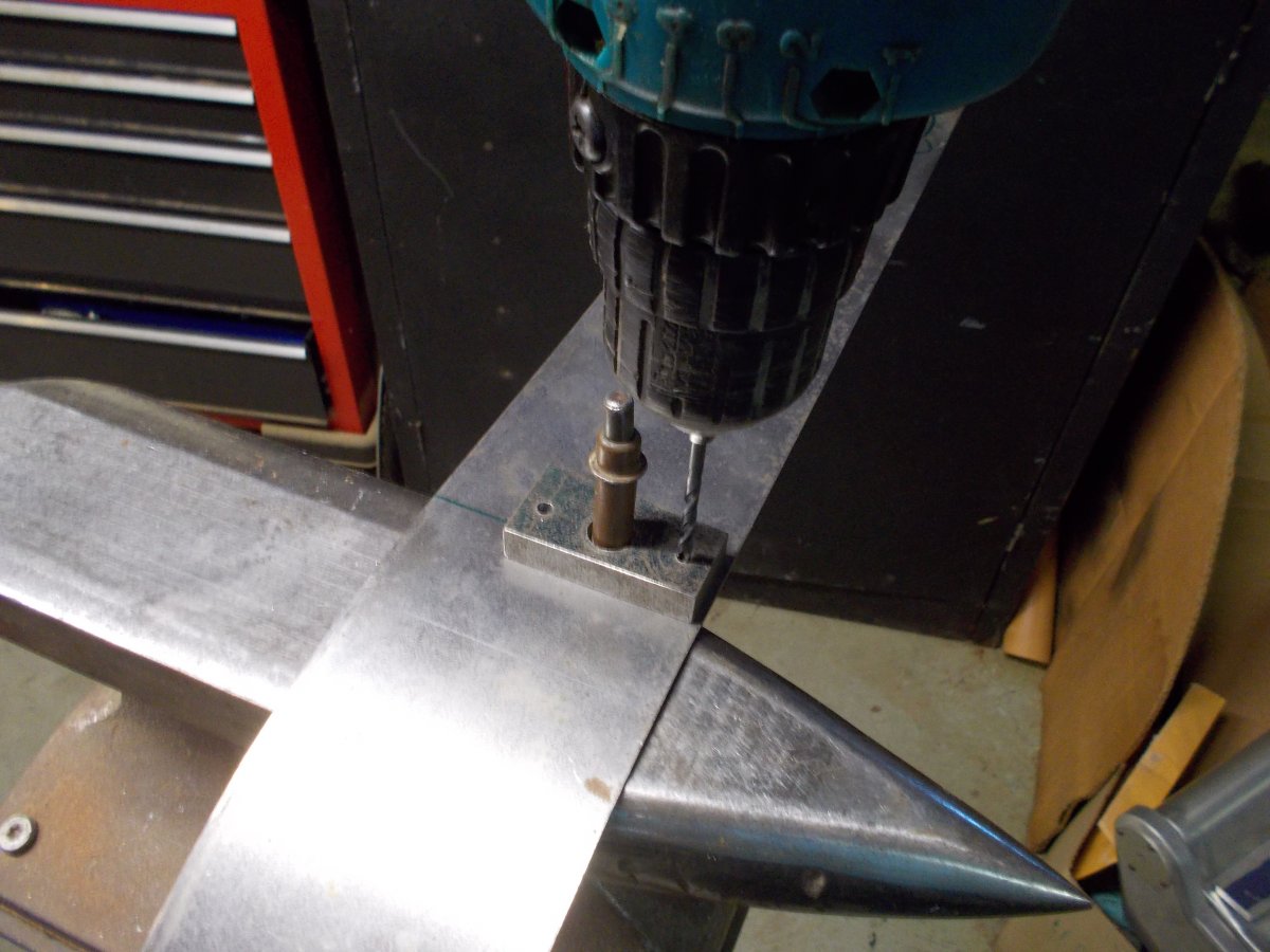

    After struggling with this tail section for several months I made some real progress over the last week. I married the tail to the hold down flanges. I ended up cheating a little by making three pie cuts to get the sides to lay flush inside the flanges. I'll weld the pie cuts next. Before I plug welded the two together I put rustproofing on both the inside of the flanges and the outside of the tail where they join to prevent rust from developing inside the sandwich. I cleaned off the rustproofing locally before I welded each plug weld.
    For now I will continue to use Clecos to hold it on to keep the alignment precise. I still want to do a little more smoothing on the skin. Later it will be converted to period correct pan head slotted screws.
    Next comes affixing the seat back panel to the tail section. Additional structure will be placed behind the seat to hold the anchoring system for the 5-point harness.

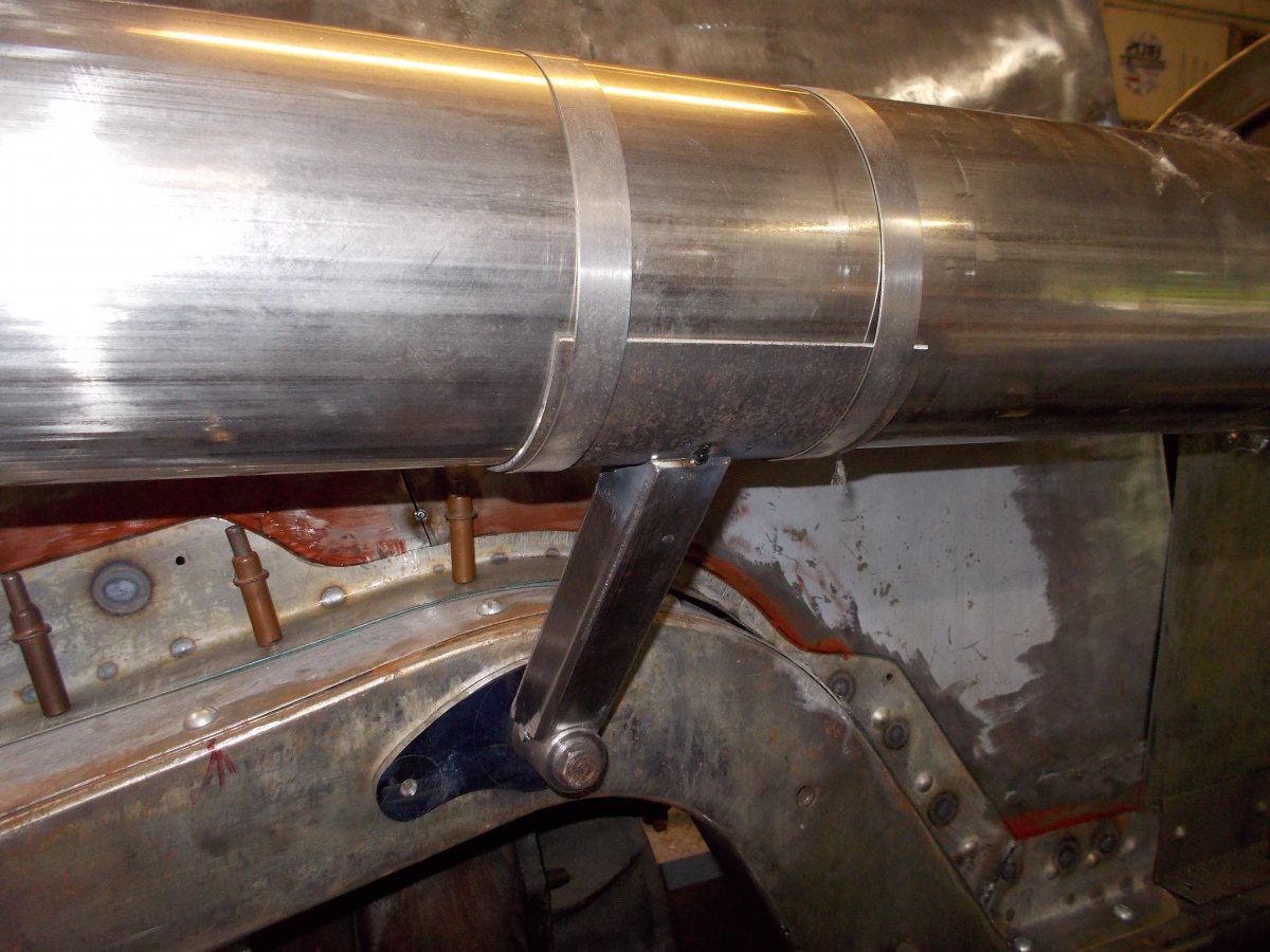

    As long as I'm working near the tail I think I'll do something about the temporary exhaust pipe support. I fabbed one up of steel tubing, turned a bung, and rolled a saddle to hold the 4" pipe. I made a little "paisley" anchor plate of 3/16" to steady it. sr_082.JPG sr_083.JPG sr_084.JPG

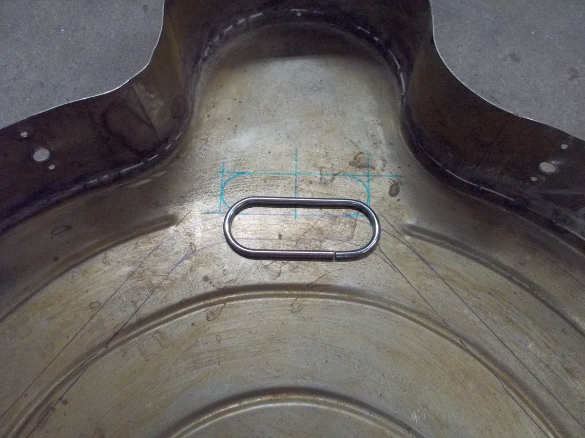

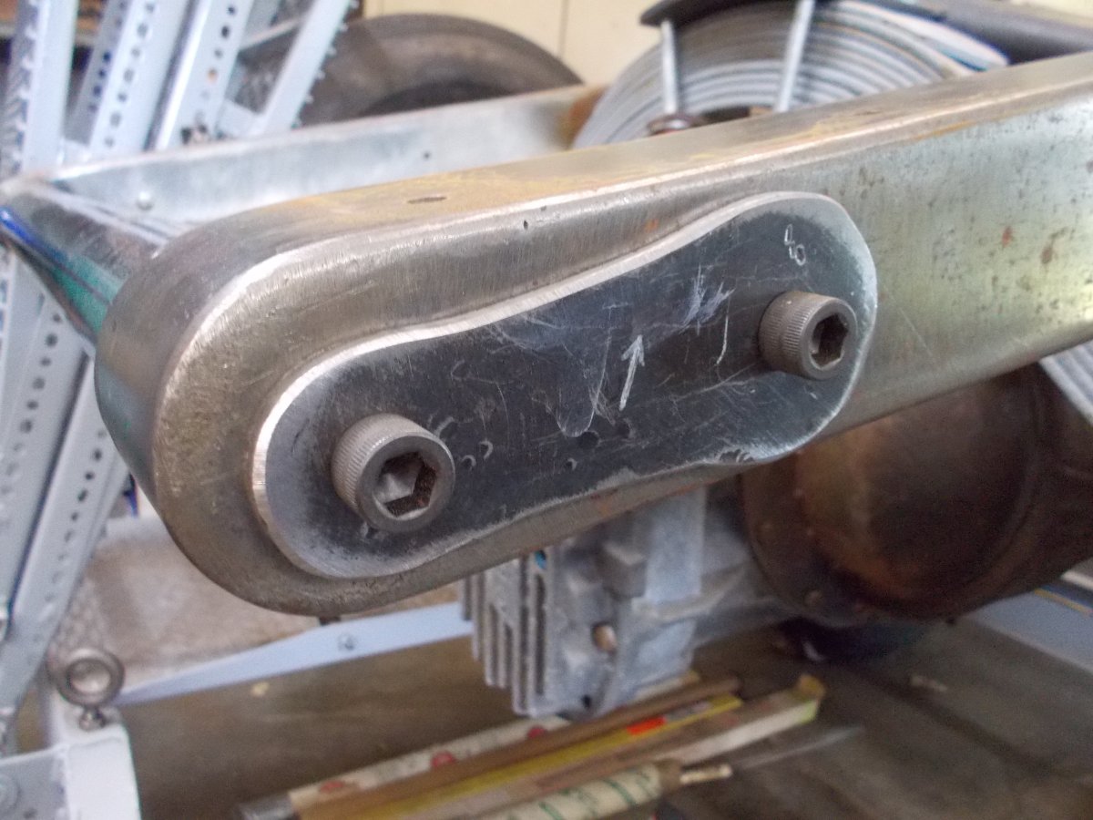

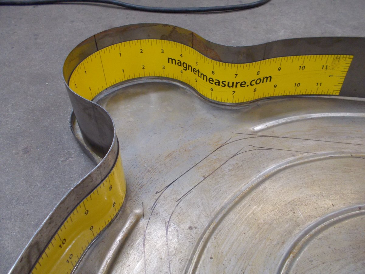

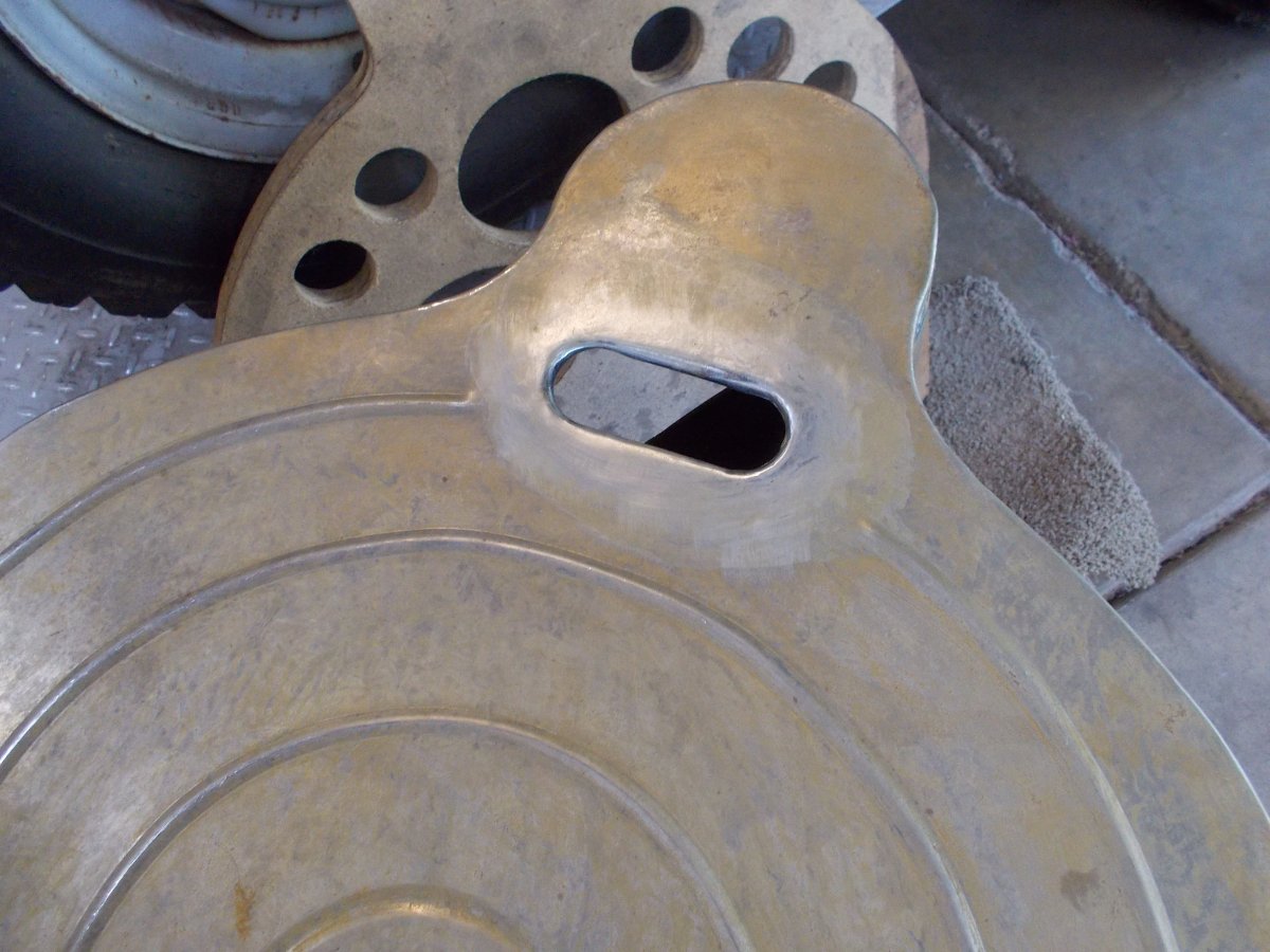

    The valve cover for the crossflow head had an oil fill cap on a tall standpipe at the front of the cover. It was going to interfere with hood clearance. I removed it and relocated amidships at the lowest point of the cover. Now I will have enough room to mount the DOHC cover.
    Progress for the last few days:

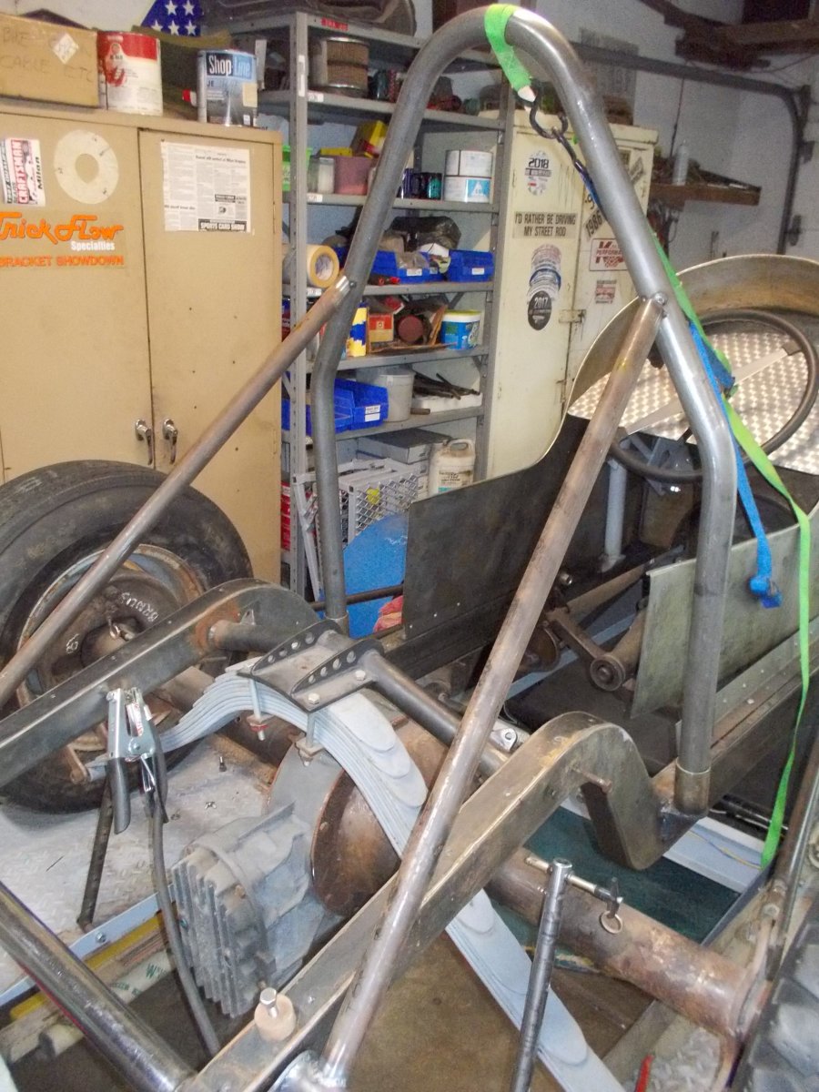

    I installed the main 5-point restraint hoop and the roll bar main hoop.
    When I weld in receptacles to hold roll bars I have found it useful to wrap tape around the roll bar so that it is a very snug fit inside the mounting receptacles. That way if the receptacle cup wants to shift or distort during welding the tape acts to hold the pipe firmly centered in the middle of it so dis-***embly and re-installation is easier once I remove the tape.

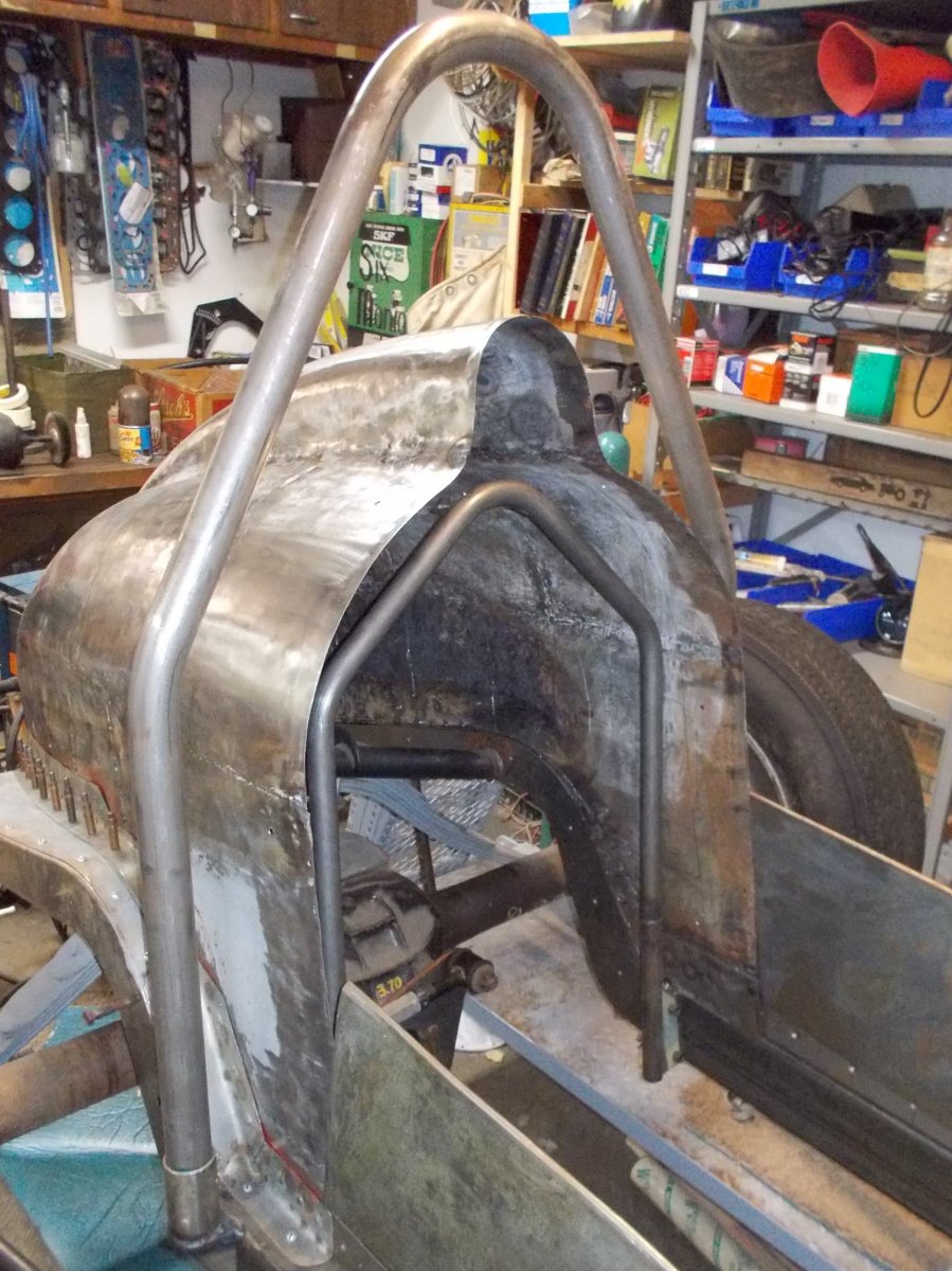

    The harness restraint mounting bar struts are spotted in. I spaced them outward in hopes the 8-gallon fuel cell I have will fit but I have my doubts; its hard to say without the bustle in place. Maybe turned sideways, but the fuel pickup location would be a bit wonky. I better look for a smaller (5-gal?) tank. Next I need roll bar diag struts. I can't decide how they should be mounted to the frame so the bar can be removed.
    seat back 3 - harness tube 11.JPG seat back 3 - harness tube 12.JPG seat back 3 - harness tube 13.JPG

    I did study some old cars and chose a mounting technique for the roll bar diags and made up the patterns in wood. Tomorrow I make them in steel.

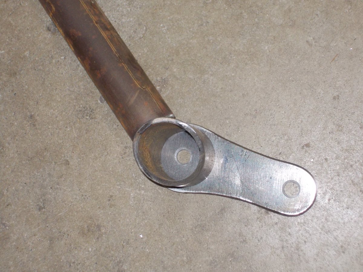

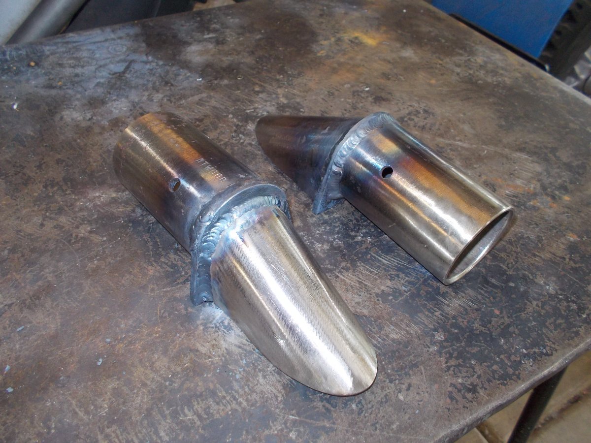

    Roll bar diag mounts:
    I copied a design I liked from older cars. It looks safe to me (I saw some attachments that sure didn't).
    I like curved surfaces. It looks artsy to me; almost evokes an aeronautical vibe to things. I made these brackets with curved edges. It would have been easier to chop them off a piece of flat bar stock.
    There are two weld nuts inside the rear of the frame for mounting these. And the rear crash bars.
    The diags get fish-mouthed and welded securely on both ends. This time I'll check to be sure they clear the exhaust pipe.
    I think a couple of round wooden discs turned down to fit inside the skived tube ends will precisely align them to the mounting plates.

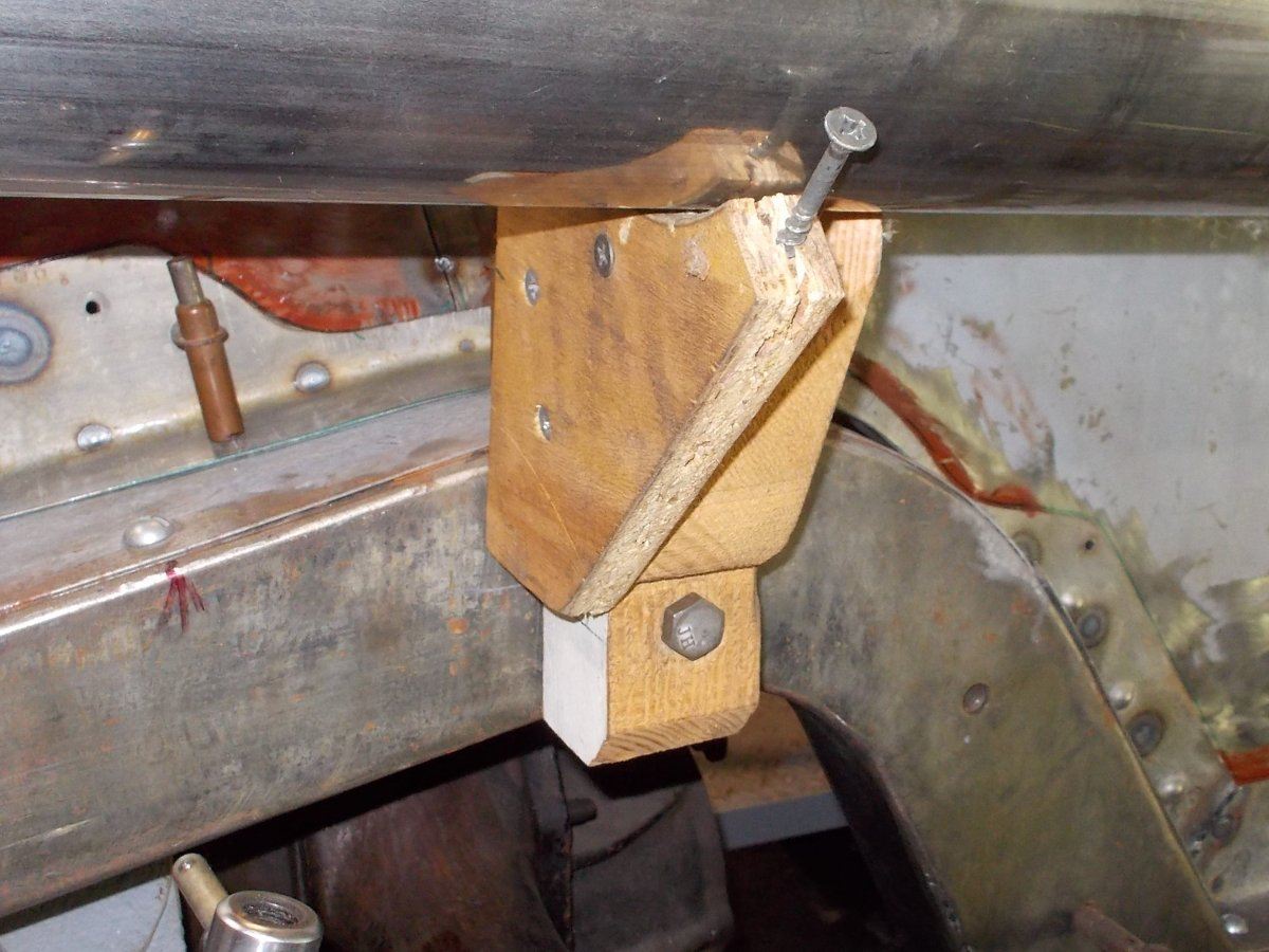

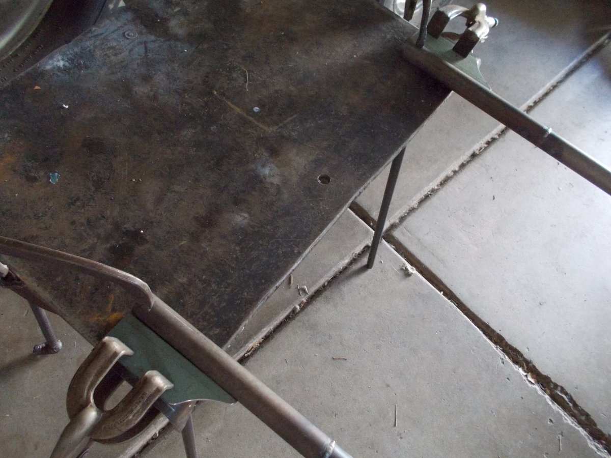

    I installed the roll bar re-enforcing diagonals. I finish welded the harness hoop.
    Once the roll bar gets finish welded the rear of the ch***is'structure is effectively complete. I can begin to move forward into the driver seating area to lay all that out as ergonomically as possible.
    One near OOPS was the fact that the roll bar attachment points just barely clear my trailer ramps when the ramps are in the stowed upright position. I will have to reposition the ramp locking arms so they don't interfere, but that is a minor rework.
    The blue spacers sandwiched between the frame rail and roll bar are there to simulate the mounting pads for the rear crash bars which will attach through the same holes and will be fabbed up later.
