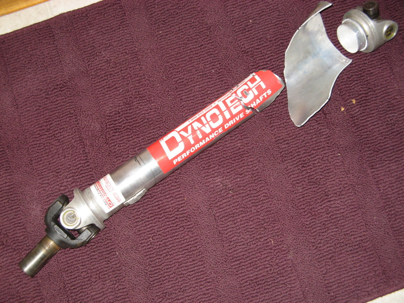

    Moving into the ****pit I first want to determine the location of the driveshaft. I need to figure the upper and lower limits of travel so I can design a driveshaft tunnel. I do not know if driveshaft tunnels are de rigueur in circle track, but coming from a background of drag racing where driveshaft impact loading is the norm it makes sense to me to have one. I needed one once. Sitting on the line with my foot to the wood and released the trans brake when instantly between my legs I felt the driveshaft snap.
    BAM!BAM!BAM!-BAM!-BAM!--BAM!---BAM!----BAM!----Bam!----Bam-----bam-----bam------bam----thunk...
    My **** pucker was Level 10 praying for that driveshaft guard tunnel to hold until the pieces came to a halt.
    Which thankfully it did.
    So I made up a dummy shaft from s**** wood and PVC tubing to set stuff up.

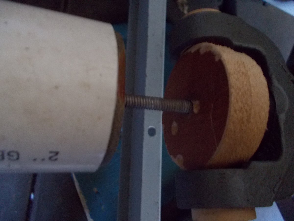

    A simple wood plug in place of the pinion gear carrier determines the D/S centerline at the rear. Rather than try to jack the axle up to determine the upper limit of movement I put a hole on the pinion centerline two inches above the center which will set the upper travel location.

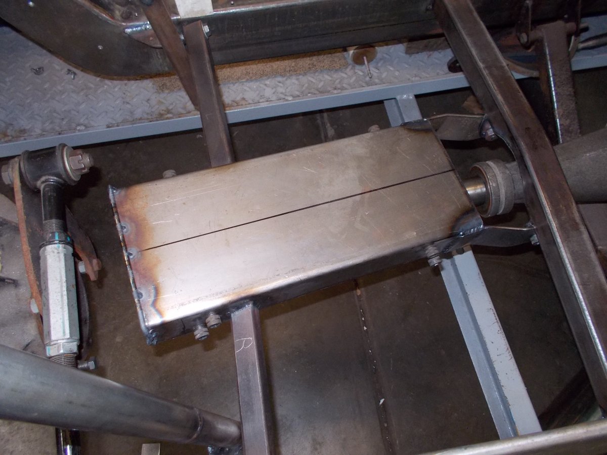

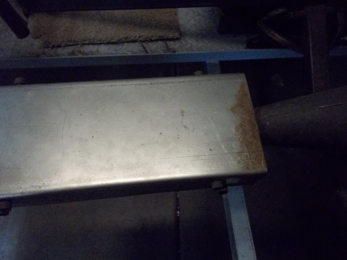

    I bent up the tunnel. Still need to weld in the nuts. I think I will wait to bend up the rear strap until the driveshaft is in place and I can get a better measurement on how far it hangs down. I want to keep it to a minimum for road clearance and loading.

    I ruminated on the best way to attach the tunnel and decided on one crossmember to hold up the front of the tunnel, support the front edge of the seat, and serve as an anchor point for the crotch strap. I'll use tabs up front - that way If I have to remove the driveshaft it will be easy to unbolt and slide the tunnel forward. Likewise if I have to remove the trans I spaced the crossmember high enough above the tail shaft to allow the trans to slide backwards and tilt upward in front. sr_090.JPG sr_091.JPG
    A piece of PVC conduit cut to the desired length served to align the two tabs and keep them parallel and properly separated.

    The tunnel is in. I now have a place to sit to do further work. The roll bar clears my head by 3" (good) but the foot space is tight for a hoodlum my size (6' 6") so I'll have to be creative making a foot box and eeking out every last millimetre around the trans.

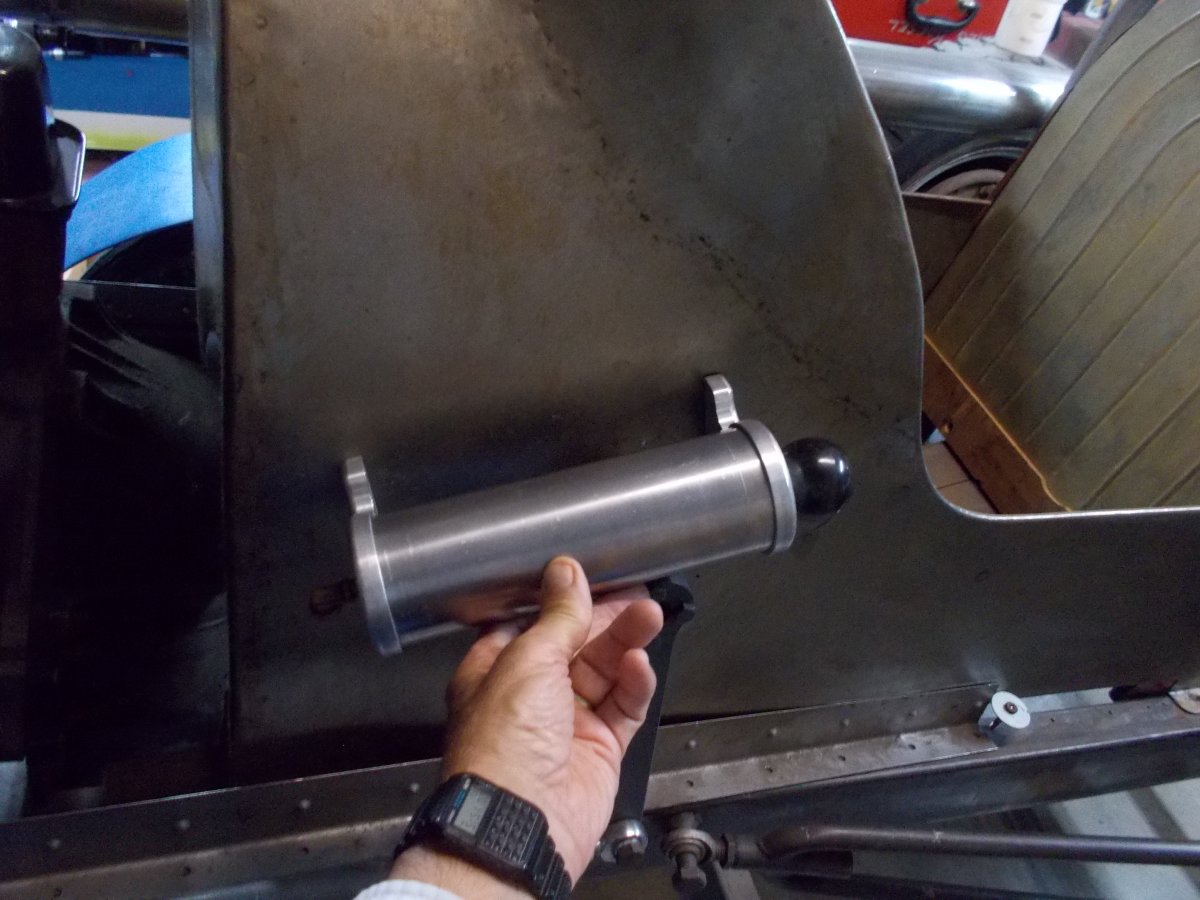

    Here's my pump with a proper knob and feed pipe.
    patmanta, Thor1, loudbang and 2 others like this.

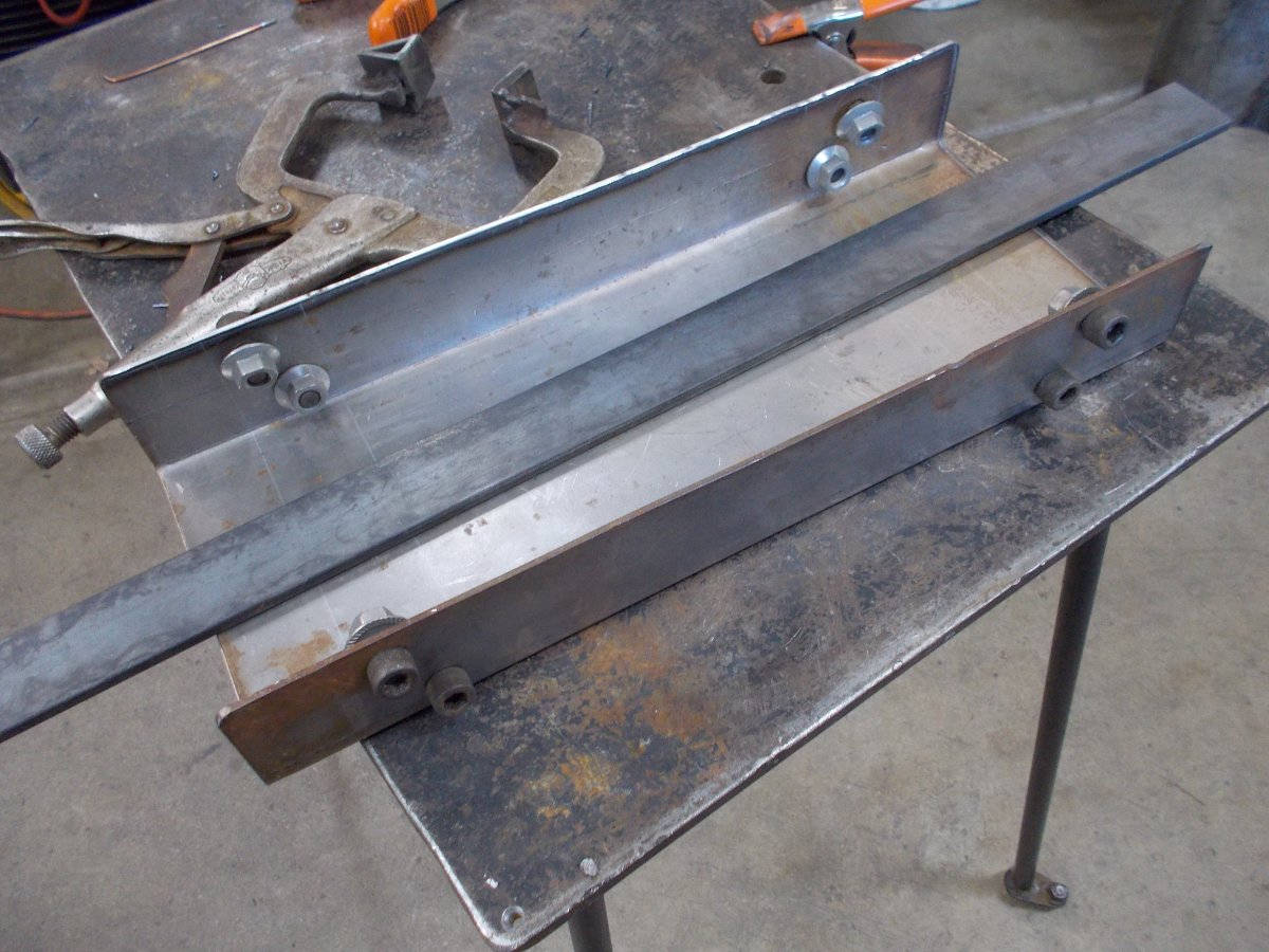

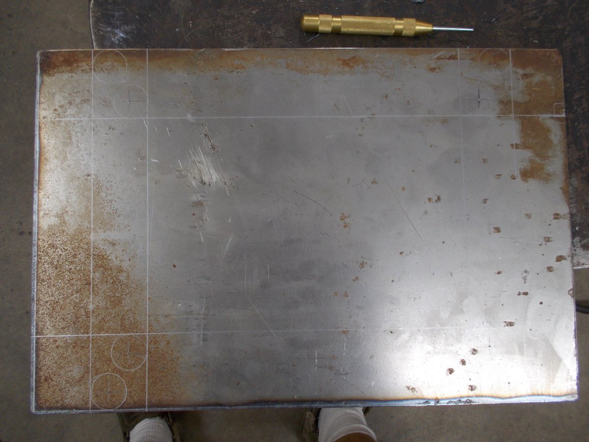

    I finished my square tube bending die and did a tryout on it . It looks like it will work in my homemade bender. I need to make some square shoes for the outer rollers so the bar does not get marred. But overall success.
