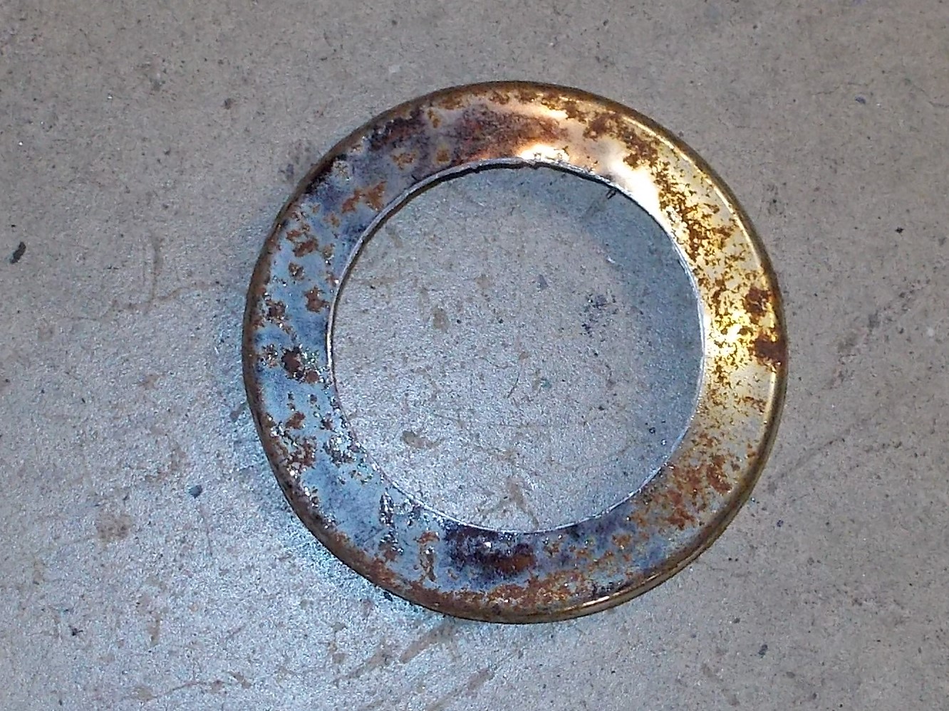

    tube beader 1.JPG After HJManiac posted that photo of an aluminum tube with a bead on the end I decided I needed a tubing beader so I made up this small die for starters. It screws on to the end of my bead roller instead of slipping over the large diameter shaft. Now I have to make a receiver die and try it out on some tubing. It will work for tubing as small as 3/4" I.D.
    I'm going to find a piece of aluminum - an electrical conduit, a piece of lawn furniture, etc. - and make a right angle stat outlet.

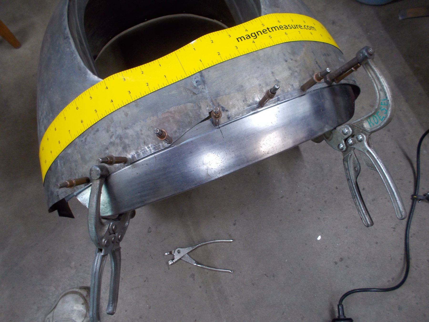

    I made a codpiece for the lower part of the nose.

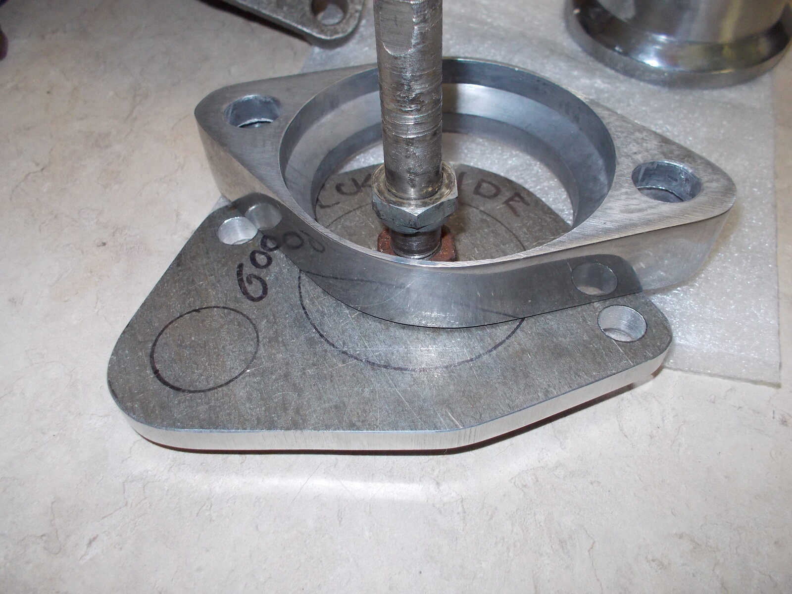

    Since I did not have a piece of metal that was big enough to make the receiver die for my tube bead roller I just grabbed a die from my Diacro bender and turned a bushing insert just for a proof-of-concept tryout. It works.

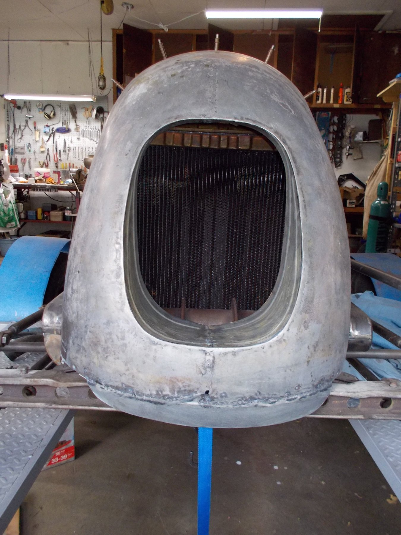

    As I stared at the rat hole in the front of the nose I had planned on welding it shut at some time, but then I thought it might look better if I put a cranking hole in it and my question is
    -did any cars have a cranking hole - or were they all push started?
    -or did some have starter motors?
    I'm talking late '30s early '40s.
    I'll add a hole if that is historically accurate.

    Looking at the cars from '37-40, (and excluding stock-block and foreign-engined cars), most don't have a visible hole for a starter, but a few do.
    Since they came either way, do what you think looks better.

    I think I will plan to add a hole - with a shiny bezel around it.
    This got me thinking - were the holes for an electric starter, i.e., an advancement over push starting the car, or were they used for a hand crank, a throwback to earlier years of the br*** era where most cars were hand crank started?
    The pic with the taped up grille openings is interesting. I wonder if it was done during qualifying attempts? I guess everything in racing has been tried before.

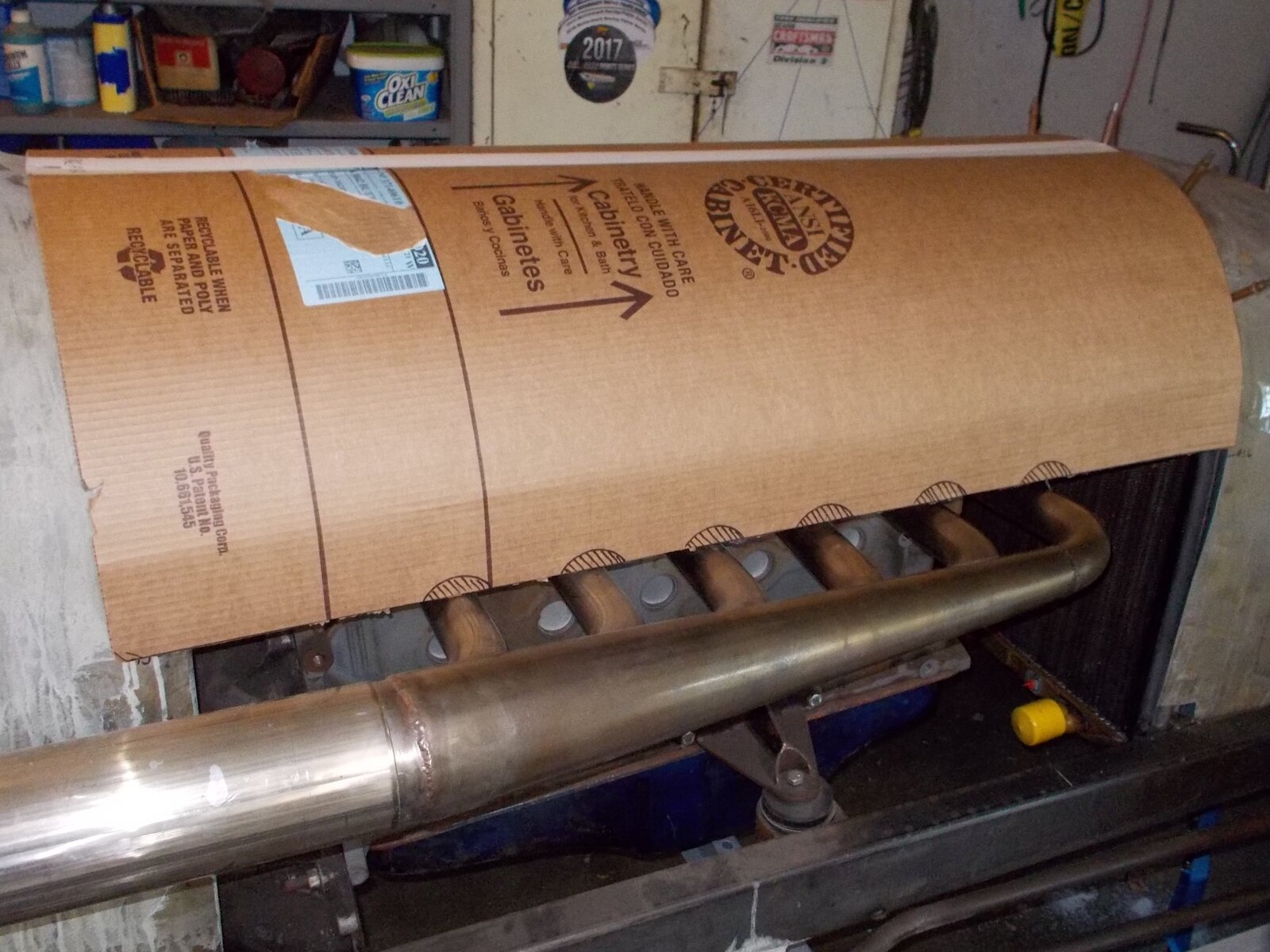

    I did manage to make a preliminary pattern for the hood. It is a t****zoidal affair. Plans are to make it of aluminum for easy removal. To retain it I'll use leather straps with buckles and springs. The pieces under the header and carbs will probably be fixed in place with bolts - or hidden Dzus fasteners.

    Hoods are a tedious build because WE tend to be more critical then "Its just a racecar" press 013.jpg

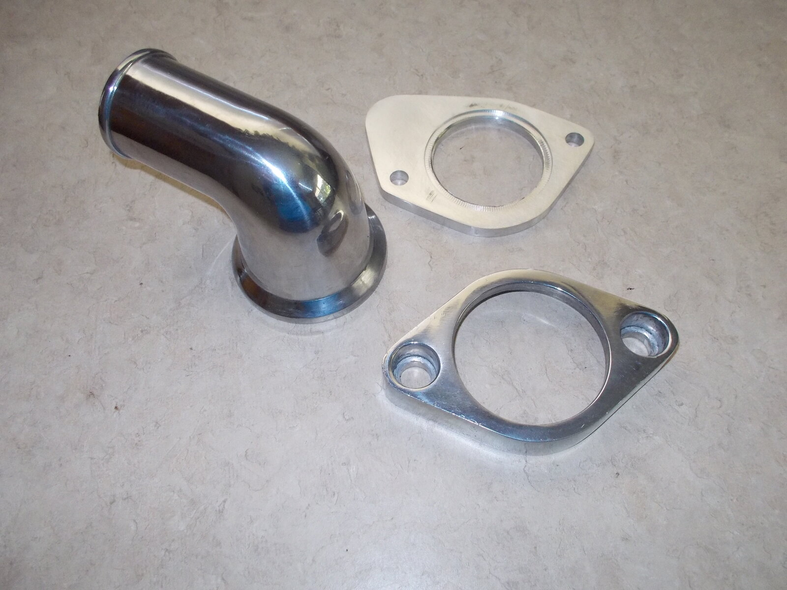

    THERMOSTAT EXCITEMENT
    I found a universal right-angle thermostat housing for a small block chevrolet on line. I decided it would save me a lot of fab time to buy the kit and hack up the right-angle piece to weld to my Ford stat housing plate.
    When the part arrived I had an idea. Maybe the entire piece could be used by sandwiching my heater opening block off plate between the head and the chevy mounting plate. I measured the C-C distances of the attachment bolts. The chevy holes are spaced .190" further apart than the Ford stat housing holes.
    But... The chev uses 3/8" diameter bolts. The Ford head uses 5/16" diameter bolts. With a little additional wiggle room on the bolt holes the chevy part just may bolt up to my Ford head, saving me fabricating and welding time. I laid the Chevy part over my adapter plate and lo-and-behold - the holes align! There is even enough room on the counterbore for the 5/16" Allen head bolts to clear without having to spot face a larger counterbore.
    That was a lot easier than I expected. Sometimes its much better to be lucky than good.
    thermostat 01.jpg thermostat 02.JPG thermostat 03.JPG thermostat 04.JPG thermostat 05.JPG thermostat 06.JPG
    Traditionalist b*llet haters don't go nutz. This is a polished casting not a billet.

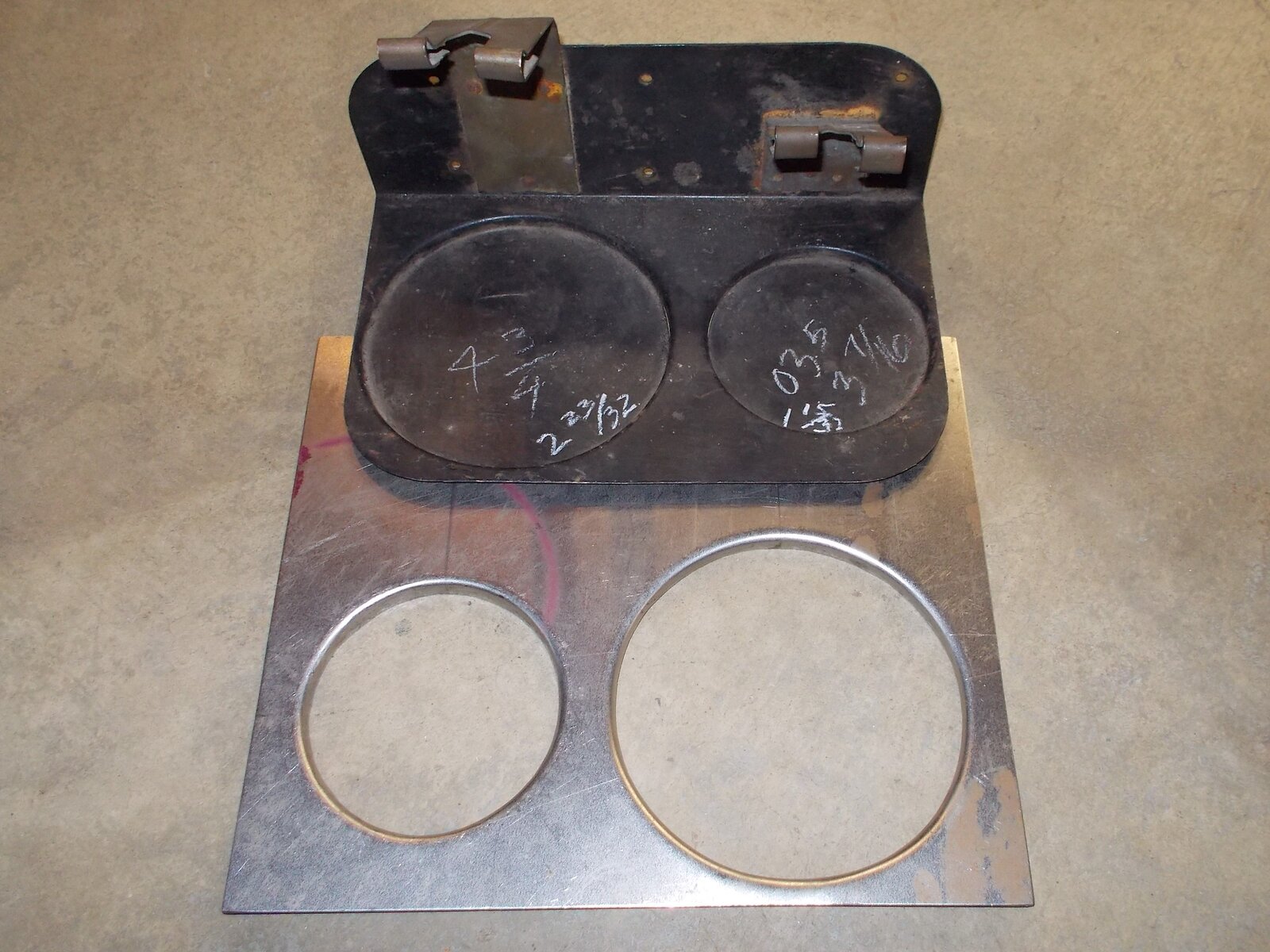

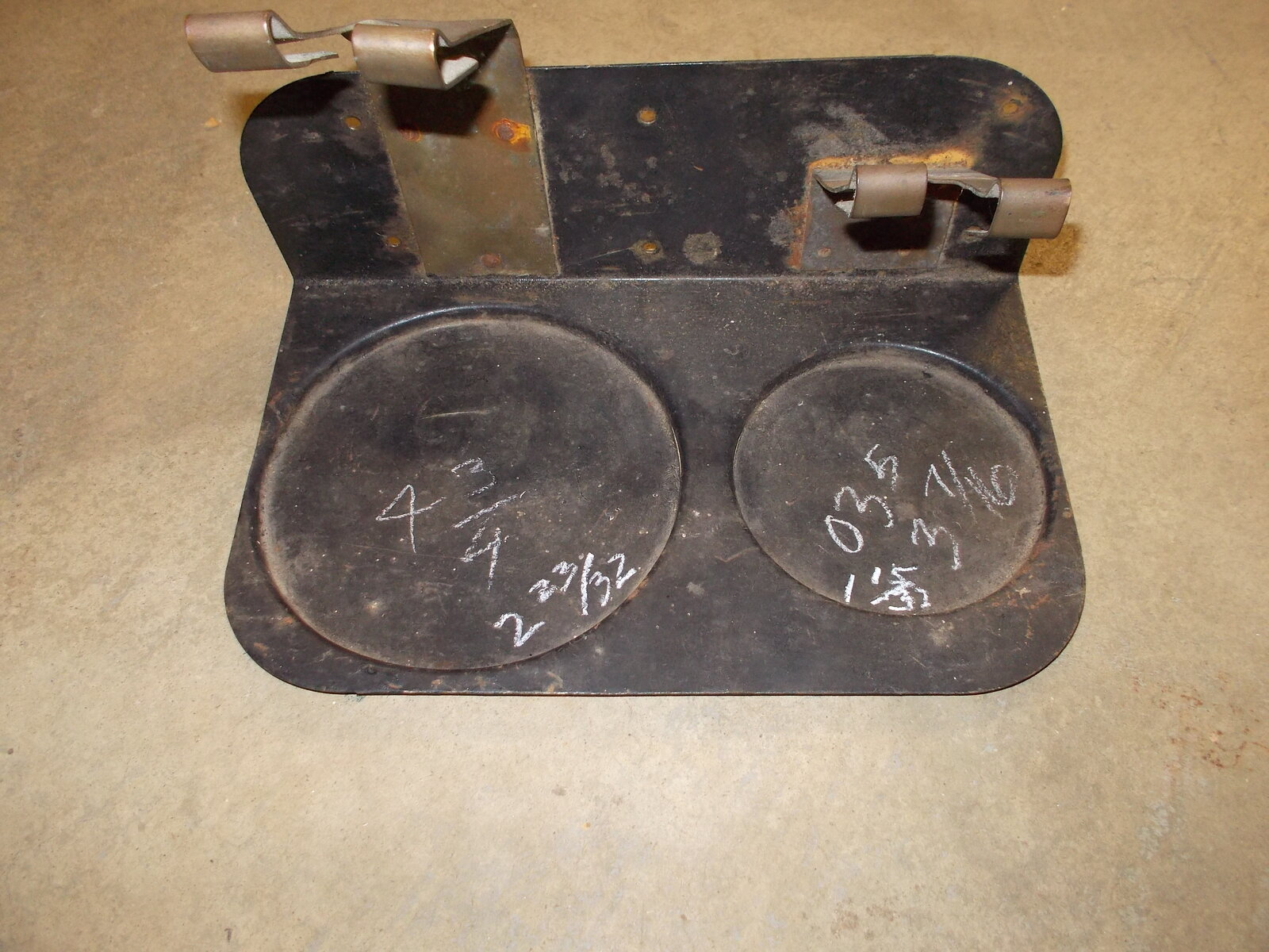

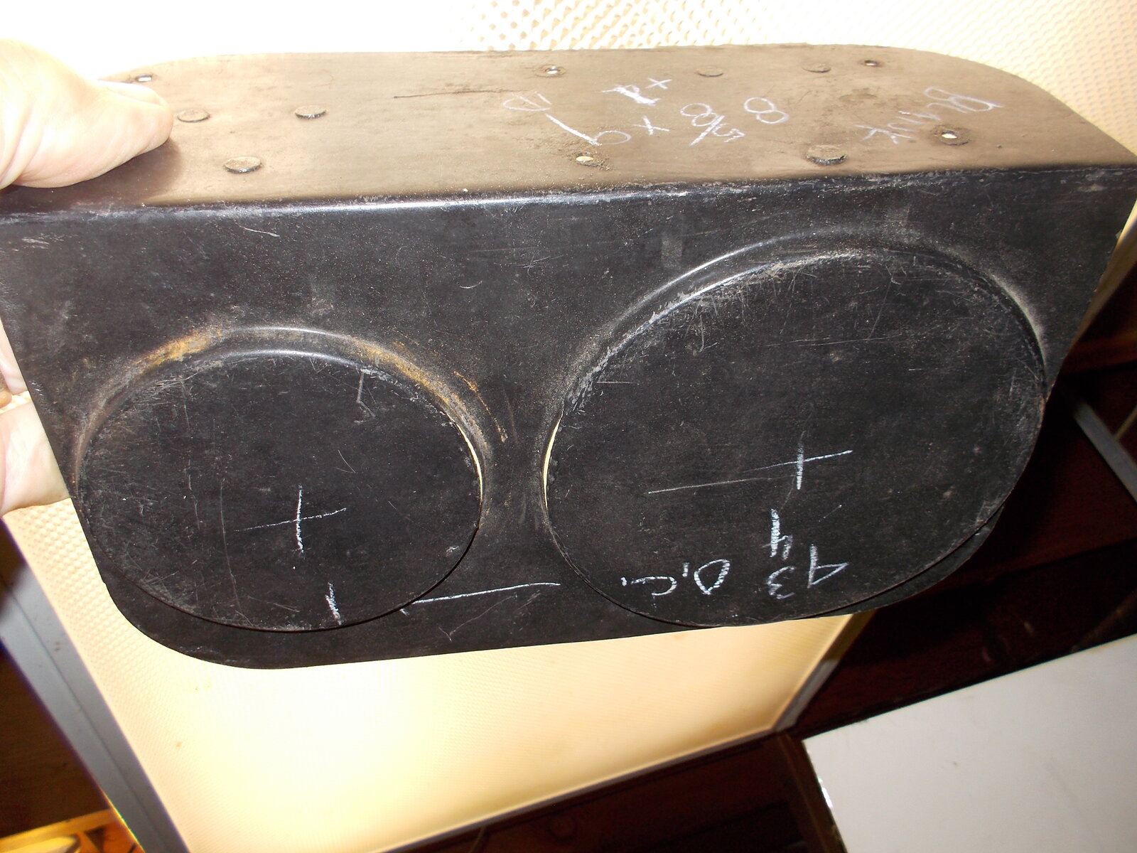

    Here is a little humor.
    I was asked by a friend to make a running board caddy for a Br*** Era 1904 Rambler. In fact he wanted ten of them. [I didn't know ten 1904 Ramblers even existed, much less that they all needed a running board caddy, but they do and they do!] This thing held oil or acetylene or kerosene or some such, in little stamped depressions retained by br*** spring clips. I explained the hardest part of making this part would be the depressions in the base. Even the original example had die breakout in two places. I tried making a stamping die. No good - it puckered the surrounding metal. I tried bead rolling. No good - the dies interfered with the adjacent depression. I finally decided to hammer form the depression and weld in the bottom.
    After I successfully made the depressions in the first part blank I went and got the original to see how my depressions compared.
    How did I do?
    DUH!
    Anyway, back on the champ car.
