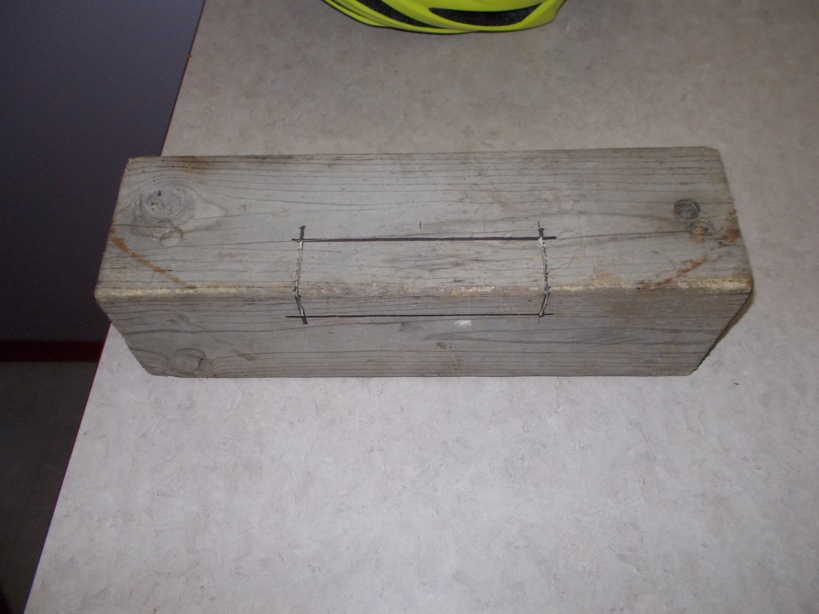

    Except I made it backwards LOL. I got it right with the second one.
    Tim, tomkelly88 and loudbang like this.
  2. loudbang
    Posts: 40,346
    I thought you just had it like for the photo then turned it correctly before welding LOL. :)

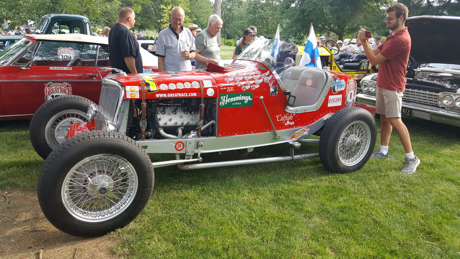

    Taken from 65Pacecar's posting on "what did you see today"
    KiWinUS, wicarnut and loudbang like this.

  7. HJmaniac
    Joined: Jun 11, 2006
    Posts: 5,388
    HJmaniac
    Did you notice the draglink/pitman arm steering arrangement.
  8. THE FRENCHTOWN FLYER
    Joined: Jun 6, 2007
    Posts: 6,084
    from FRENCHTOWN
    Yes, it looks like they used half a wishbone for the drag link. I'm not real crazy about how they did the flathead exhaust. And the wire wheels look better to me than the disc wheels on the grey car with the hokey hub spinner adapter. I guess if you plan to drive across the nation some compromises are prudent.

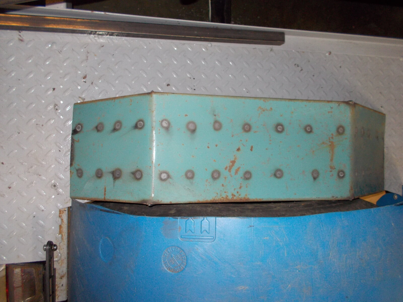

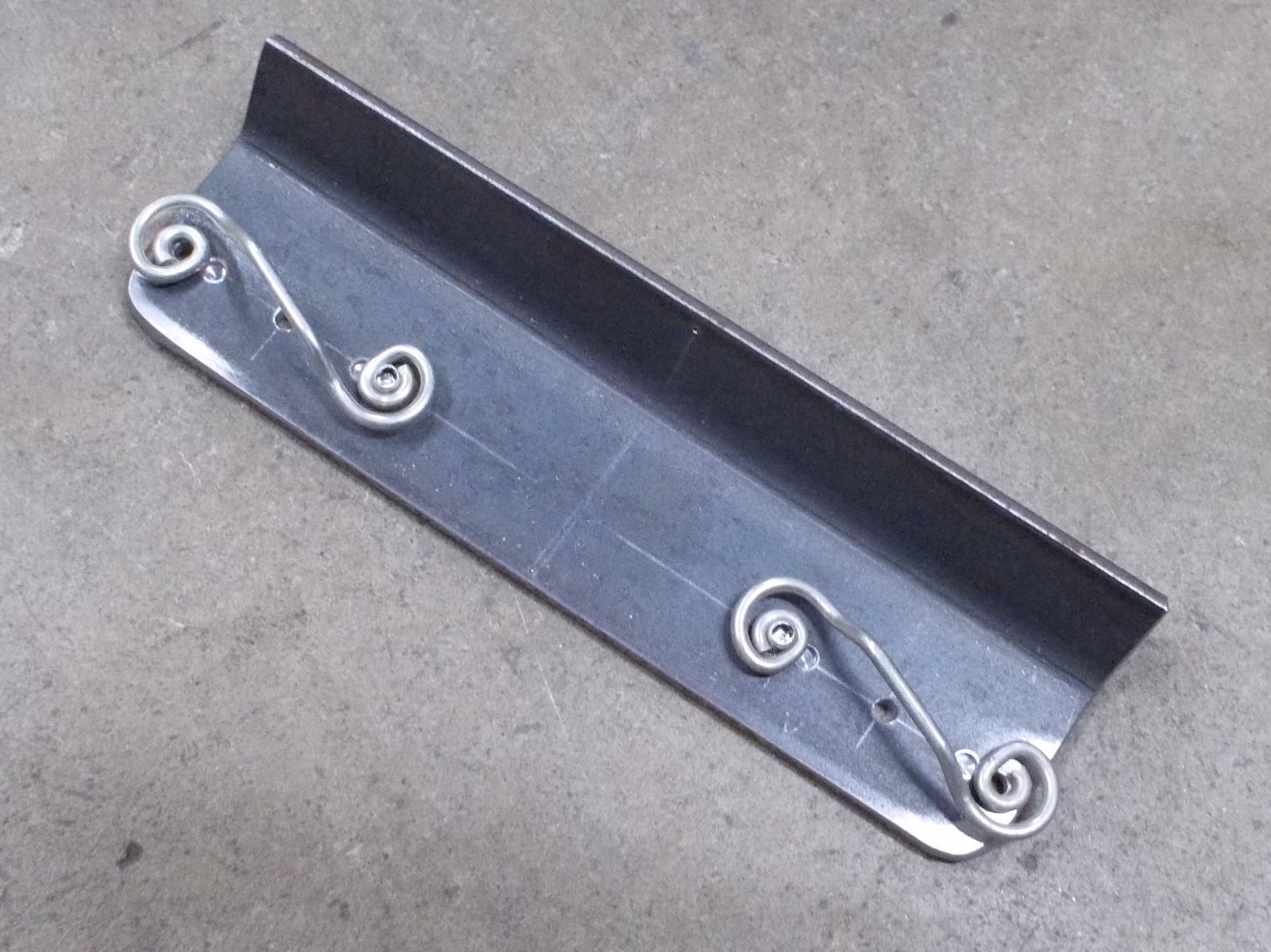

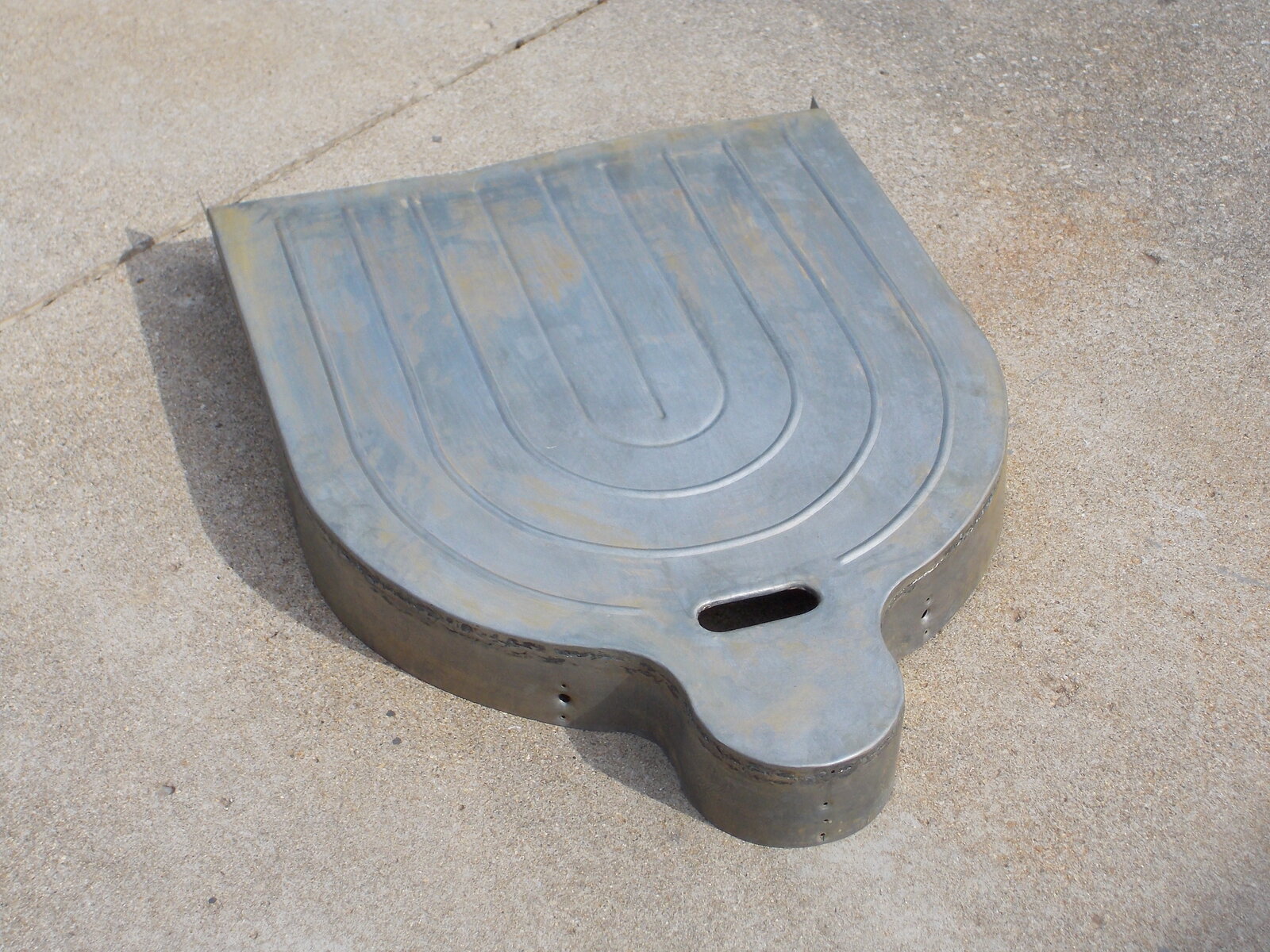

    Today I finish welded the seat back. I need to add lap belt cutouts and two Dzus springs and its ready for paint. seat back 03.JPG
    wicarnut, loudbang and HJmaniac like this.

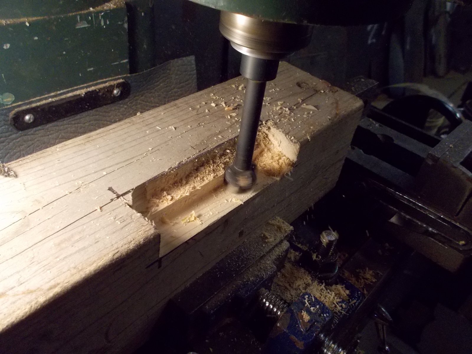

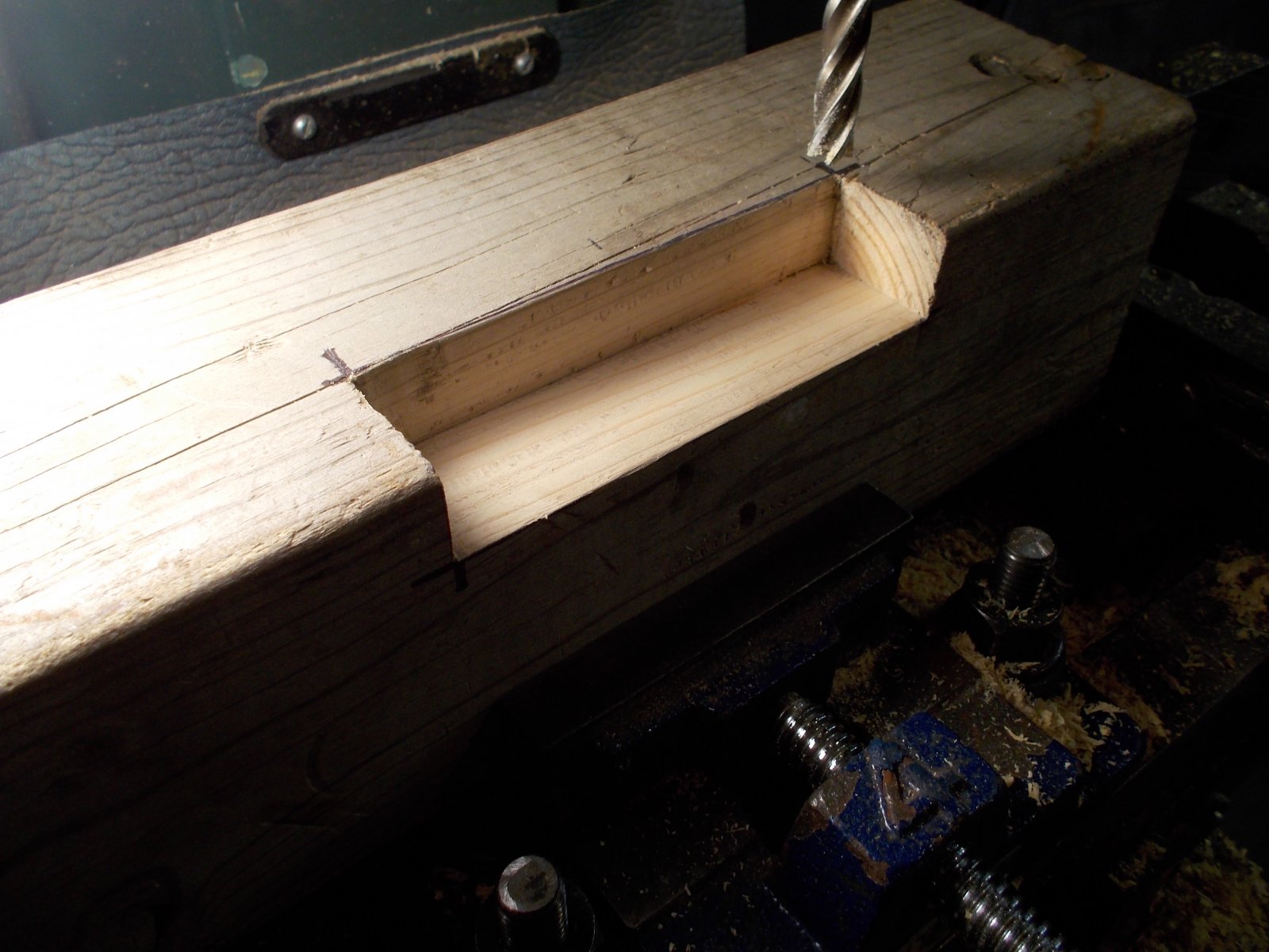

    This from the "Things-I had-to-do-on-the-way-to-doing-other-things" file.
    I wanted to add depressions for the Dzusties but my tool was too big to fit in the curved space on top so I had to make a smaller tool to do the job.

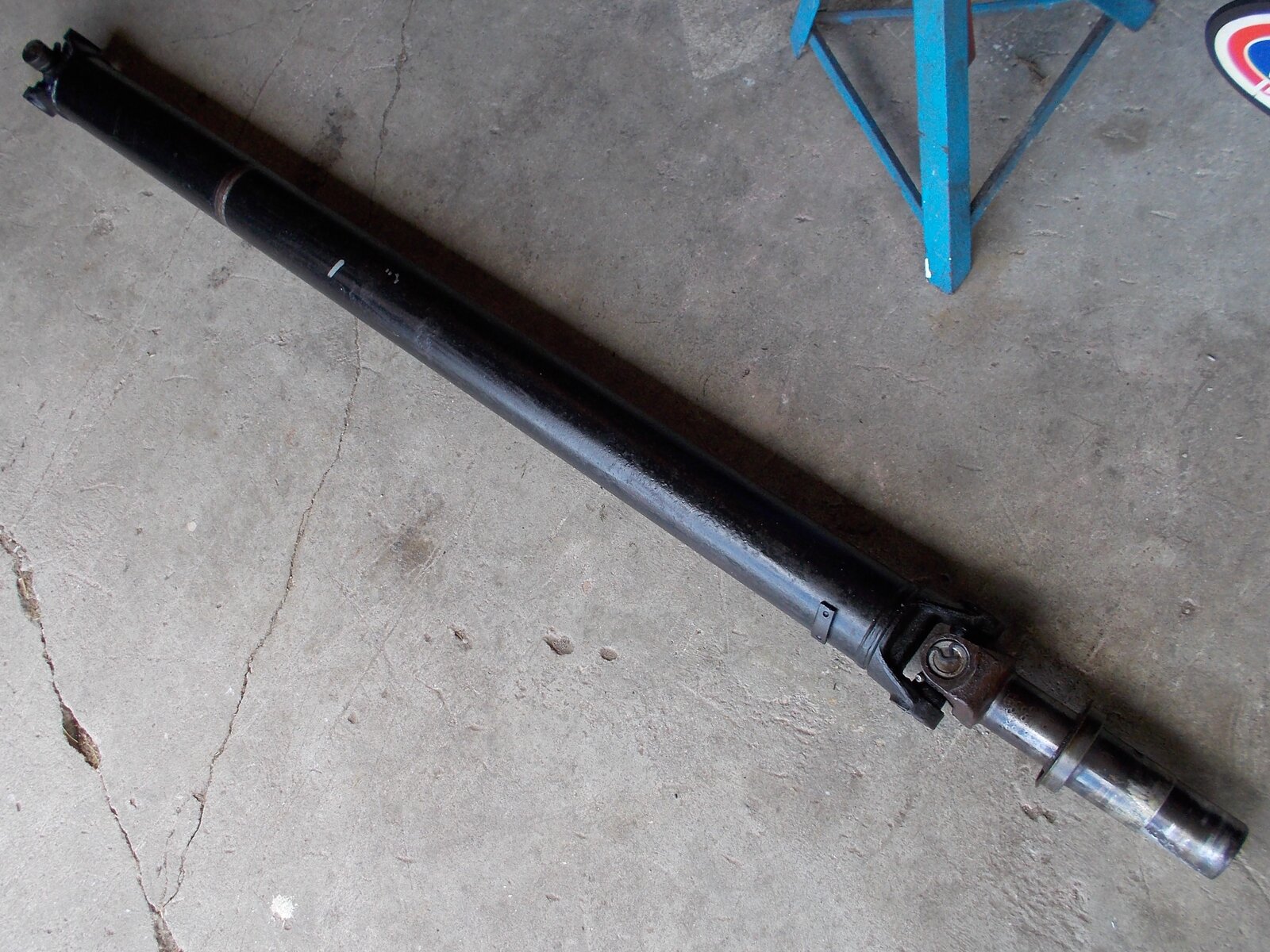

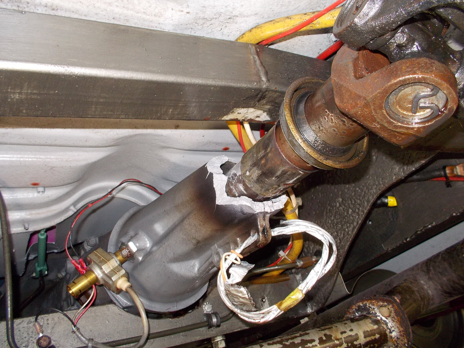

    Well this has been a summer of annoying little setbacks. A broken g***er, a flooded ba*****t, and last week a catastrophic failure on the '46 tow truck for my champ car. I was on a 80 mile trip cruising down the interstate at 75 mph when vibrations started to build in the drivetrain. It culminated in a jarring vibration accompanied by billowing smoke out from under the truck. I somehow nursed it the last ten miles home and here's what I saw underneath. The last six inches of the C6 tailshaft was GONE!
    More work for Greg and another delay on the champ car build.
    loudbang and Asphalt Demon like this.

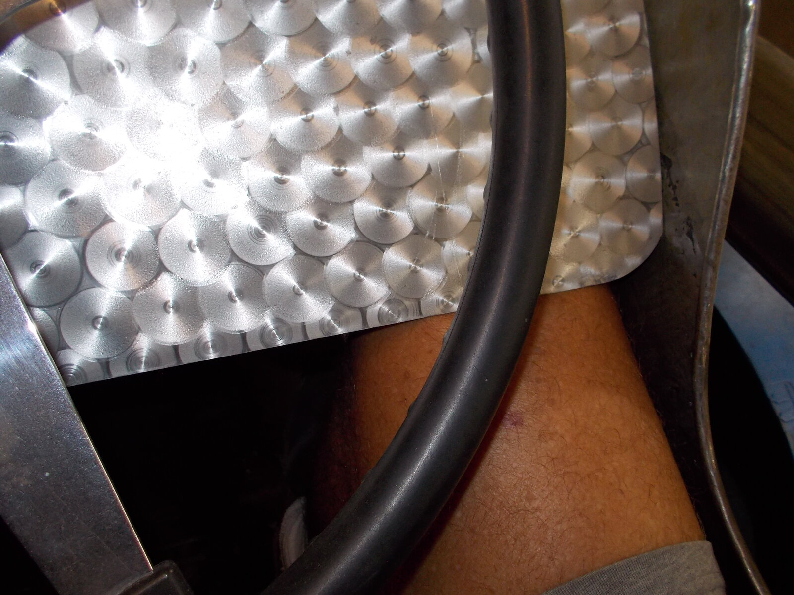

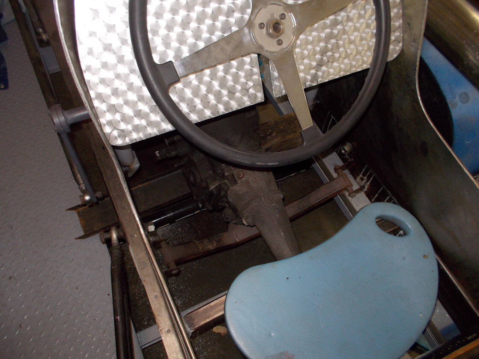

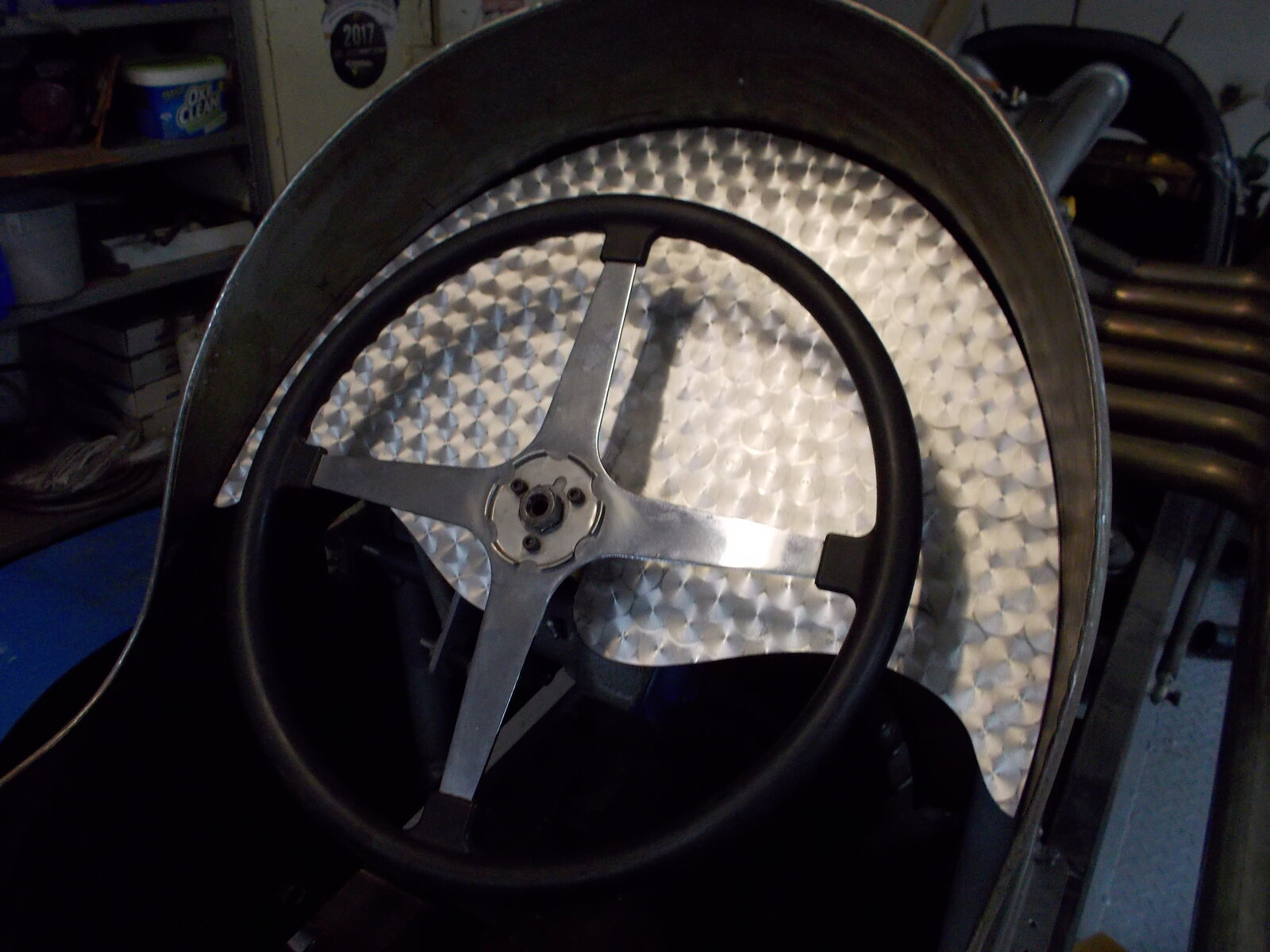

    I am going to package myself inside the car. That means steering wheel placement, instrument placement, leg and hand placement.
    For the foot placement I need a foot well. I plan to make it no deeper than the trans rear mount which is six inches below the frame; no further, to reduce the chances of bottoming out and for ease of loading on the trailer.
    For legs I just don't have enough room. So I trimmed the bottom 4 inches of the instrument panel off. inst panl 05.JPG inst panl 06.JPG
    I suppose since this a site for hot rod **** here is the requisite crotch shot.
  19. THE FRENCHTOWN FLYER
    Joined: Jun 6, 2007
    Posts: 6,084
    from FRENCHTOWN
    After a little sanding and filing I now have room for my gloved hands and gauges and switches. I am waiting to get the cowl completely mounted in place before attaching the dash board permanently.

    Based on your truck's failure, I hope you build a shield for your tailshaft and driveshaft there...or you might end up more like that squirrel!
    Any idea what happened with the truck? Bad u-joint started the vibrations and took out the trans?
  21. THE FRENCHTOWN FLYER
    Joined: Jun 6, 2007
    Posts: 6,084
    from FRENCHTOWN
    Well [he says sheepishly], the truck did have a driveshaft guard. And therein lies the problem. When I first got it running I topped out the suspension and the driveshaft whacked the driveshaft loop. In the picture of my truck driveshaft I posted you can see the ring of paint that got removed from the shaft where it hit. I put new springs in. Add to that the fact that the previous owner flat-spotted the rear tires when he neglected to fill the rear axle. As in many disasters it was a confluence of factors that created the accident.
    weak rear springs
    flat spotted tires
    driveshaft hit loop
    I had convinced myself that the driveshaft looked straight, and that the random vibrations I experienced was when the flat spots on the tires occasionally aligned with each other. I put replacing the driveshaft on a rather lengthy list of 'things-to-do'. Bad move. The C6 trans is a very rugged unit. Look at the thickness of the tail housing. Beefy. The driveshaft almost ***uredly was bent and caused the failure.
    The champ car got a driveshaft tunnel.

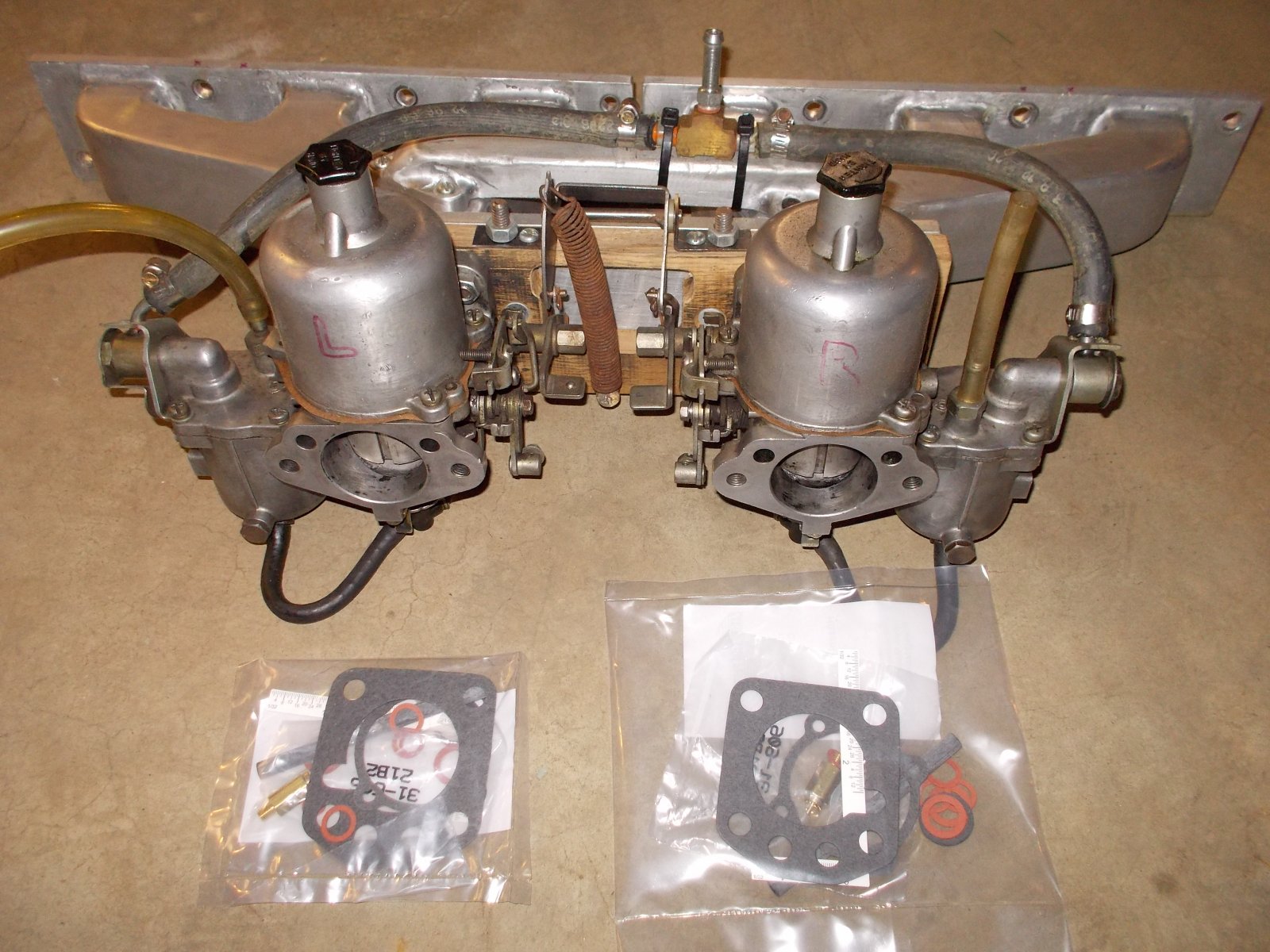

    SU 05.JPG The carb rebuild kits arrived today. There's a good rainy day project.

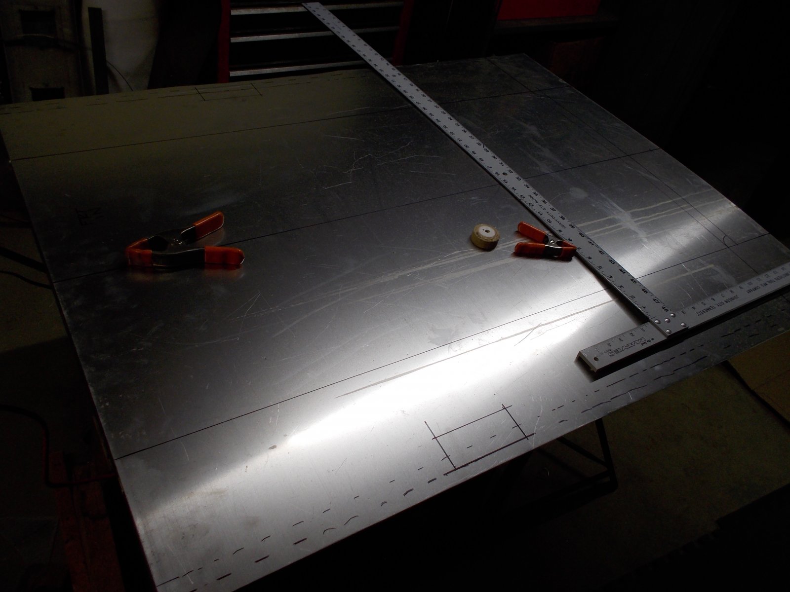

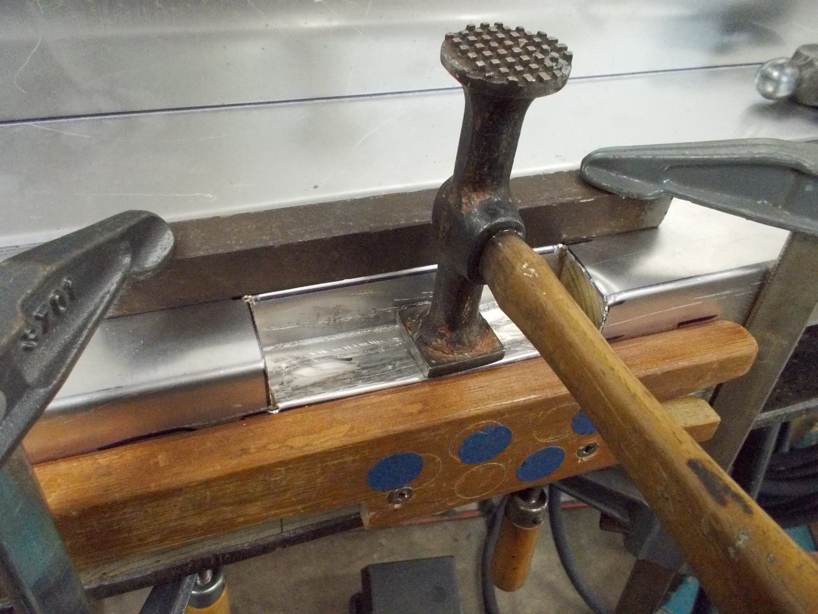

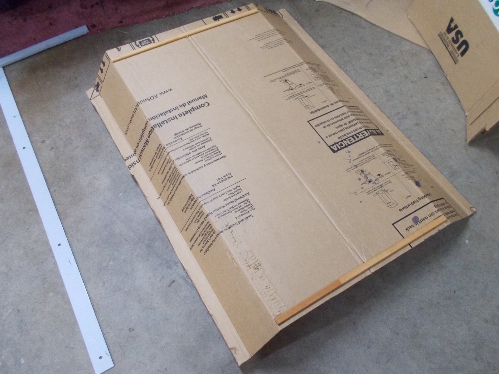

    I started on the belly pan, followed by a throttle pedal. Made preliminary cardboard patterns. I plan to put a rolled edge on the front for esthetics.

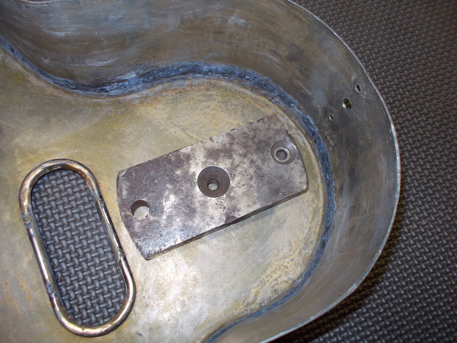

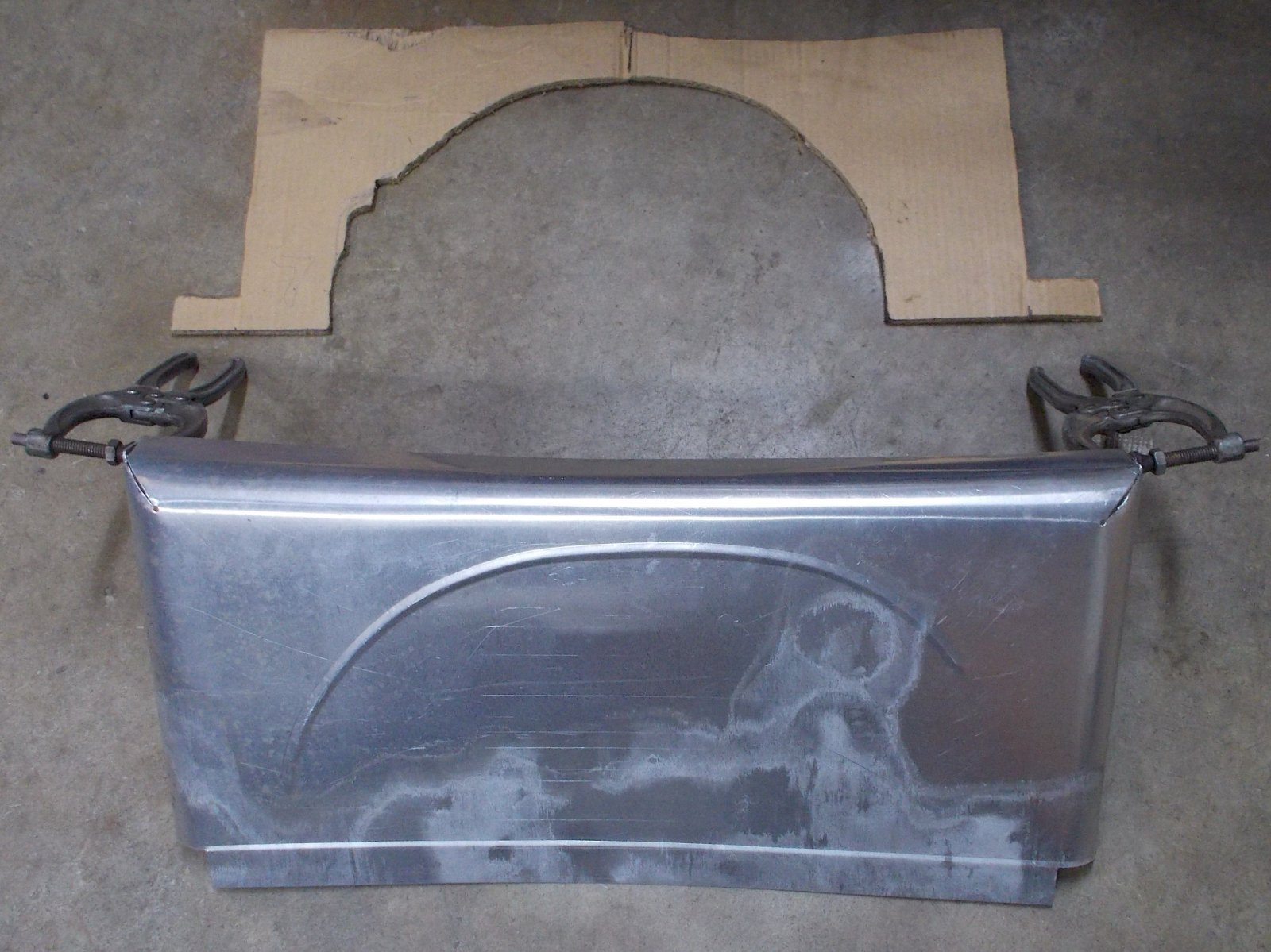

    I made the front piece of the belly pan. It needs welding in the corners and a cutout to clear the flywheel area.
  25. THE FRENCHTOWN FLYER
    Joined: Jun 6, 2007
    Posts: 6,084
    from FRENCHTOWN

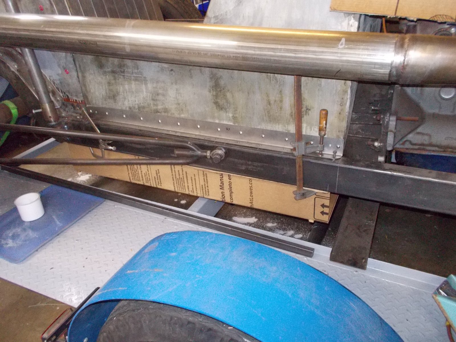

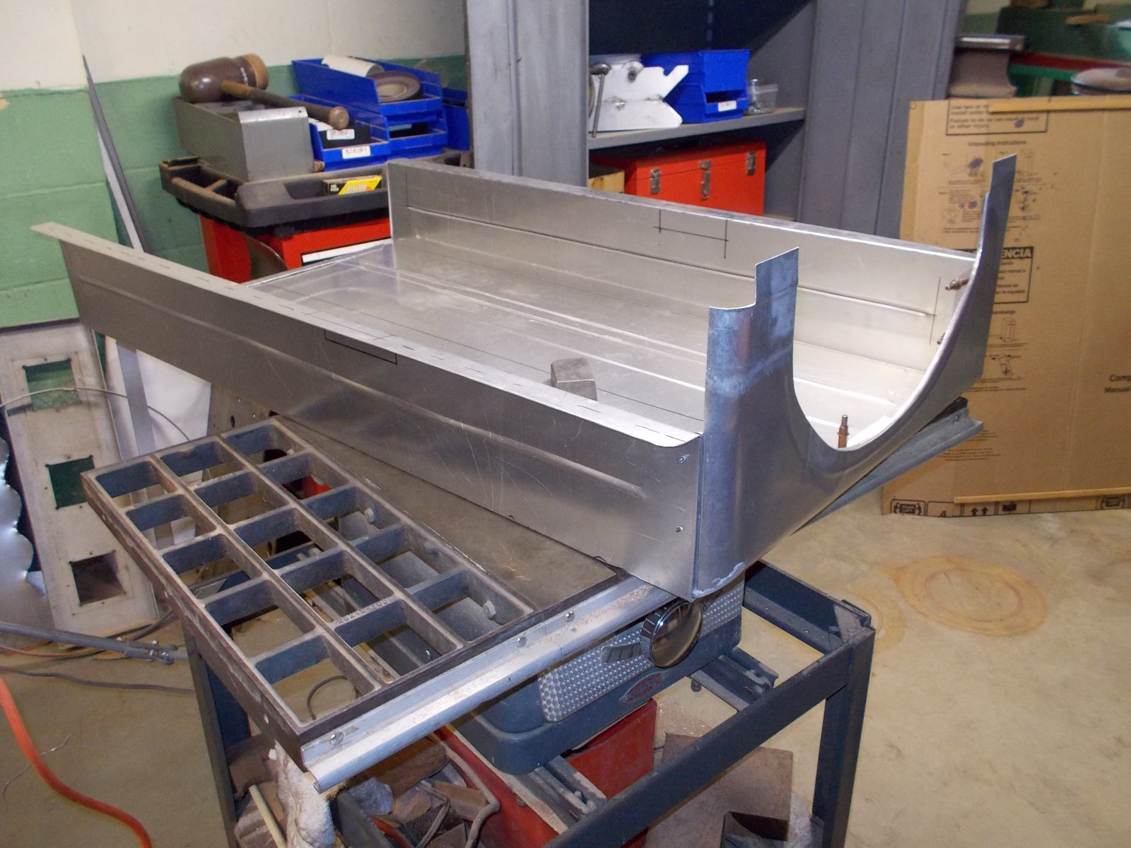

    Here is the footwell / belly pan front piece. I slid it into the cardboard pattern and it looks like it will fit up well when I get the belly pan made.
  26. THE FRENCHTOWN FLYER
    Joined: Jun 6, 2007
    Posts: 6,084
    from FRENCHTOWN
    More progress on the belly pan.
    It still needs two divot cutouts to clear the trans mount tabs.
    loudbang, HJmaniac and jaracer like this.

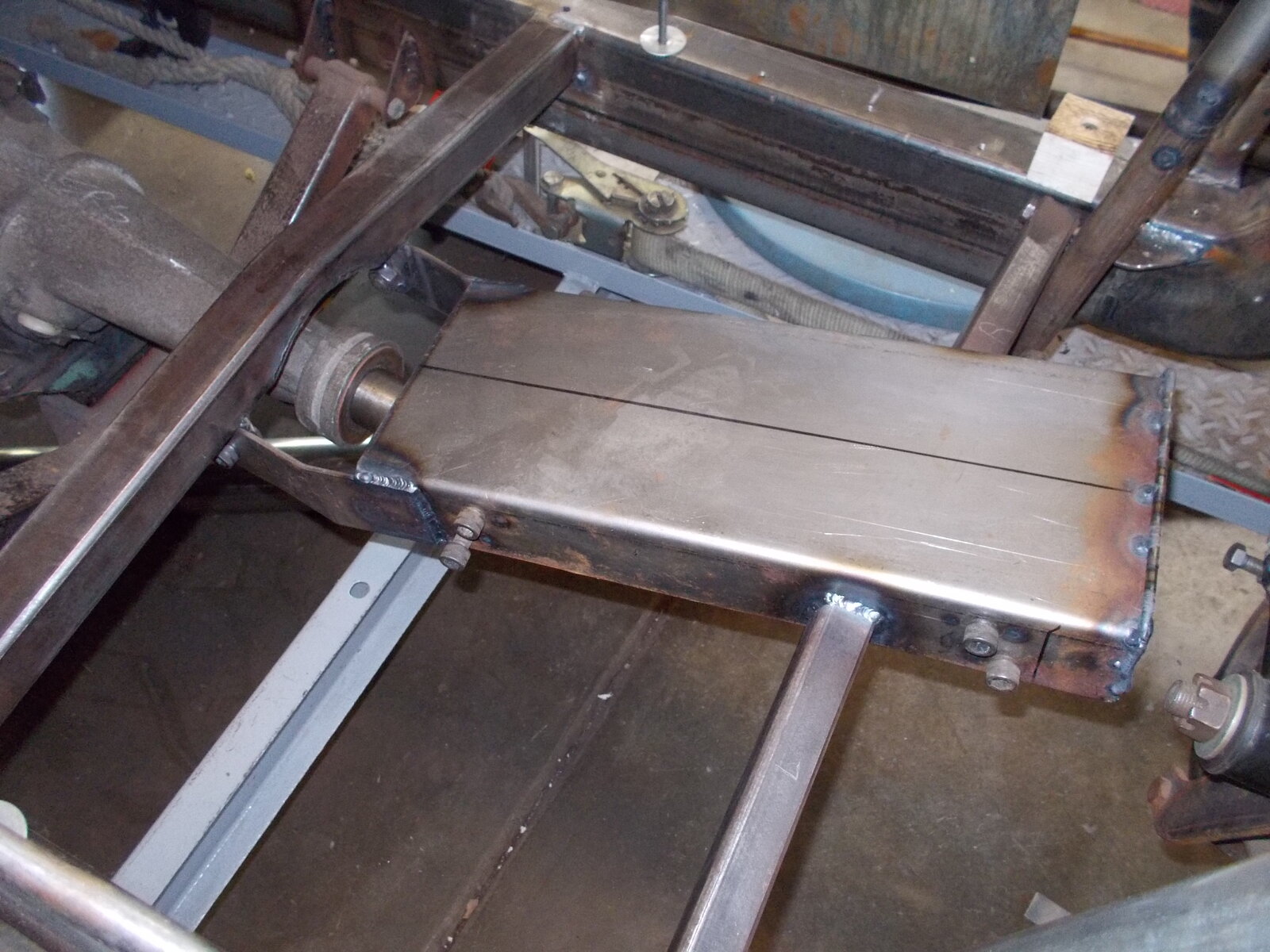

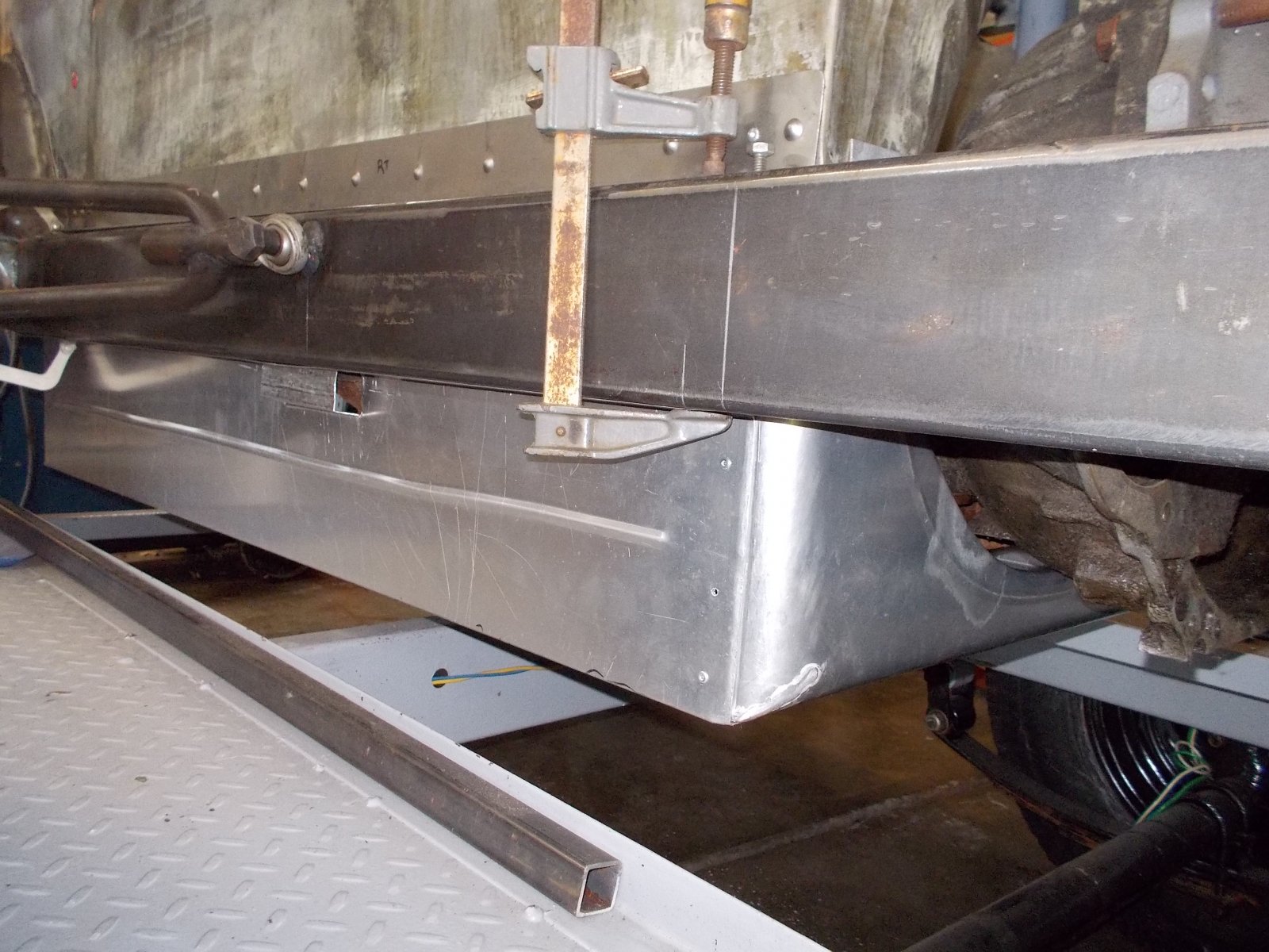

    I made a center pan mount to get welded on the back of the transmission crossmember. It will support the belly pan bathtub from the center, as well as being supported at the front and along the sides.
    Tim, loudbang and HJmaniac like this.
  29. THE FRENCHTOWN FLYER
    Joined: Jun 6, 2007
    Posts: 6,084
    from FRENCHTOWN

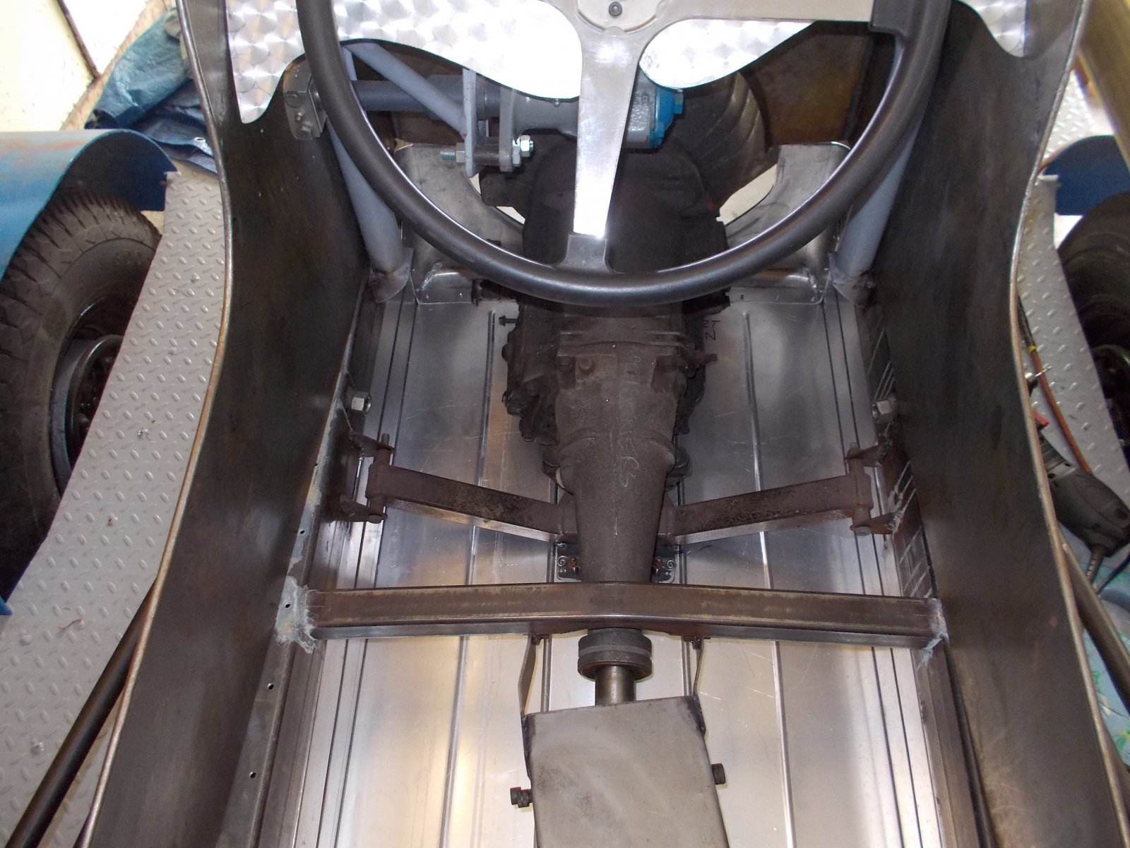

    Belly pan / footwell installed.
    jaracer, Shadow Creek, hfh and 3 others like this.

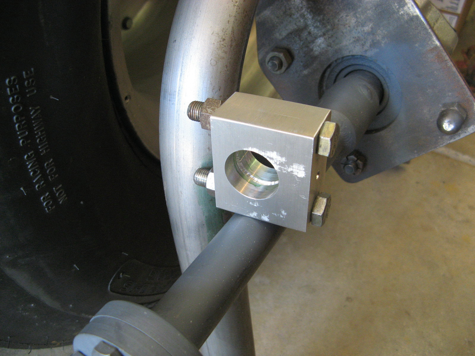

    The cowl and the nosepiece have to have flanges and / or tabs added to secure the hood and nosepiece. I had to remove the steering to get the cowl off so I decided to remove any sharp edges and counterbore the attachment bolts that I may contact to make the driving experience more enjoyable. Here is before/after pics. SteeringMount03.jpg SteeringMount10.JPG
